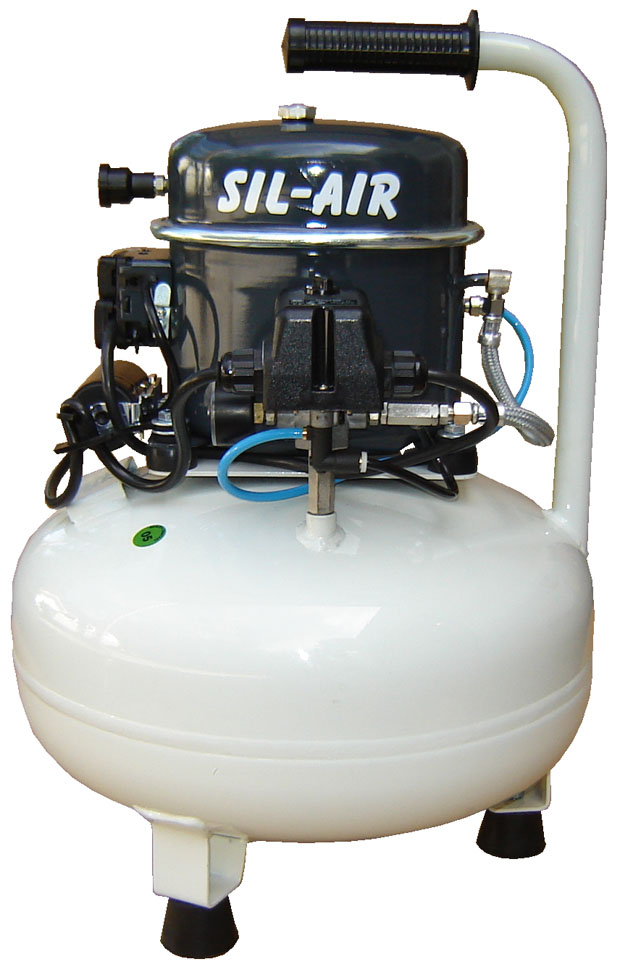

  • Get a silent one. A cheap good one in EU that I am aware of is unfortunately twice your budget (Bambi 24). You might find a cheaper one if you look. Generally the refridgerator compressor types are the way to go imho for quality of life reasons that is worth the extra money you spend. You can recognize them by the pump (see picture below). There are a bunch of vids and DIY articles on how to convert a trash fridge pump to an airbrush compressor, but that's up to you to decide if it's worth your time.

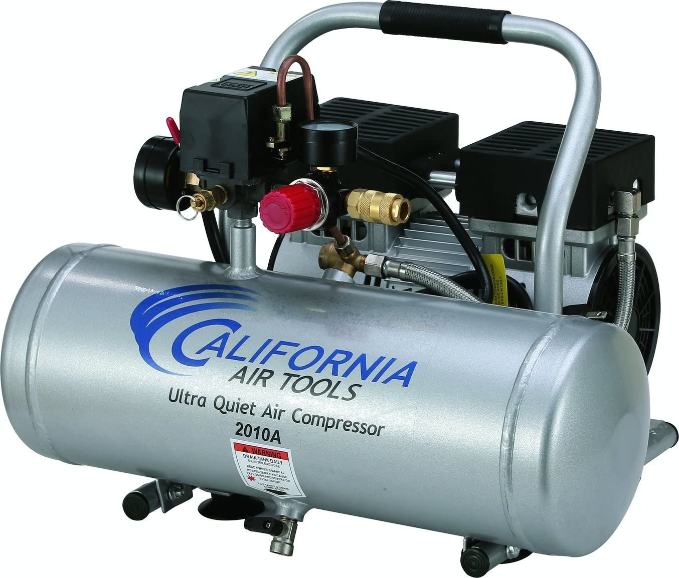

I'm very happy with my California Air Tool compressor that is so much quieter than my old Harbor Freight one.
