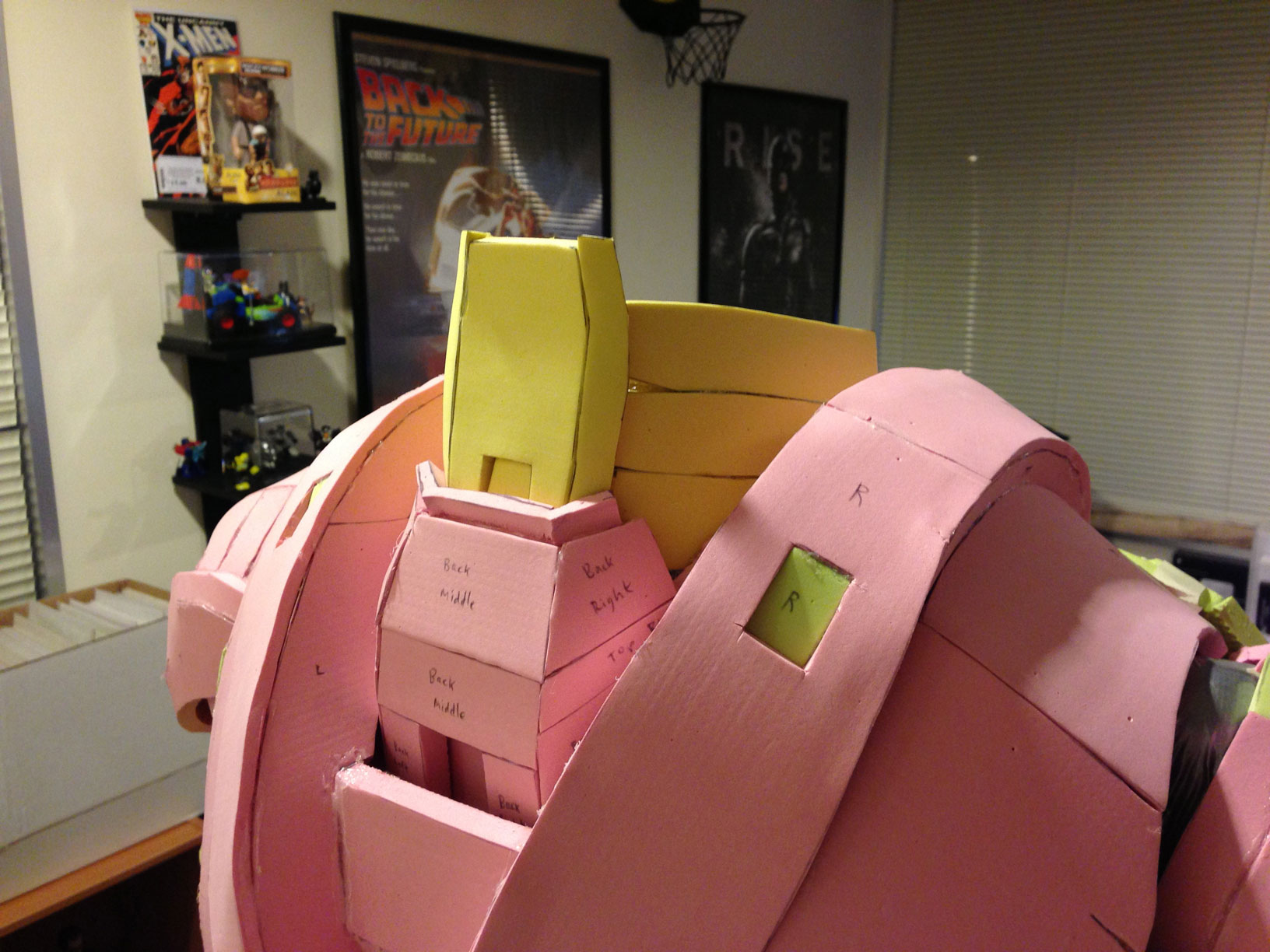

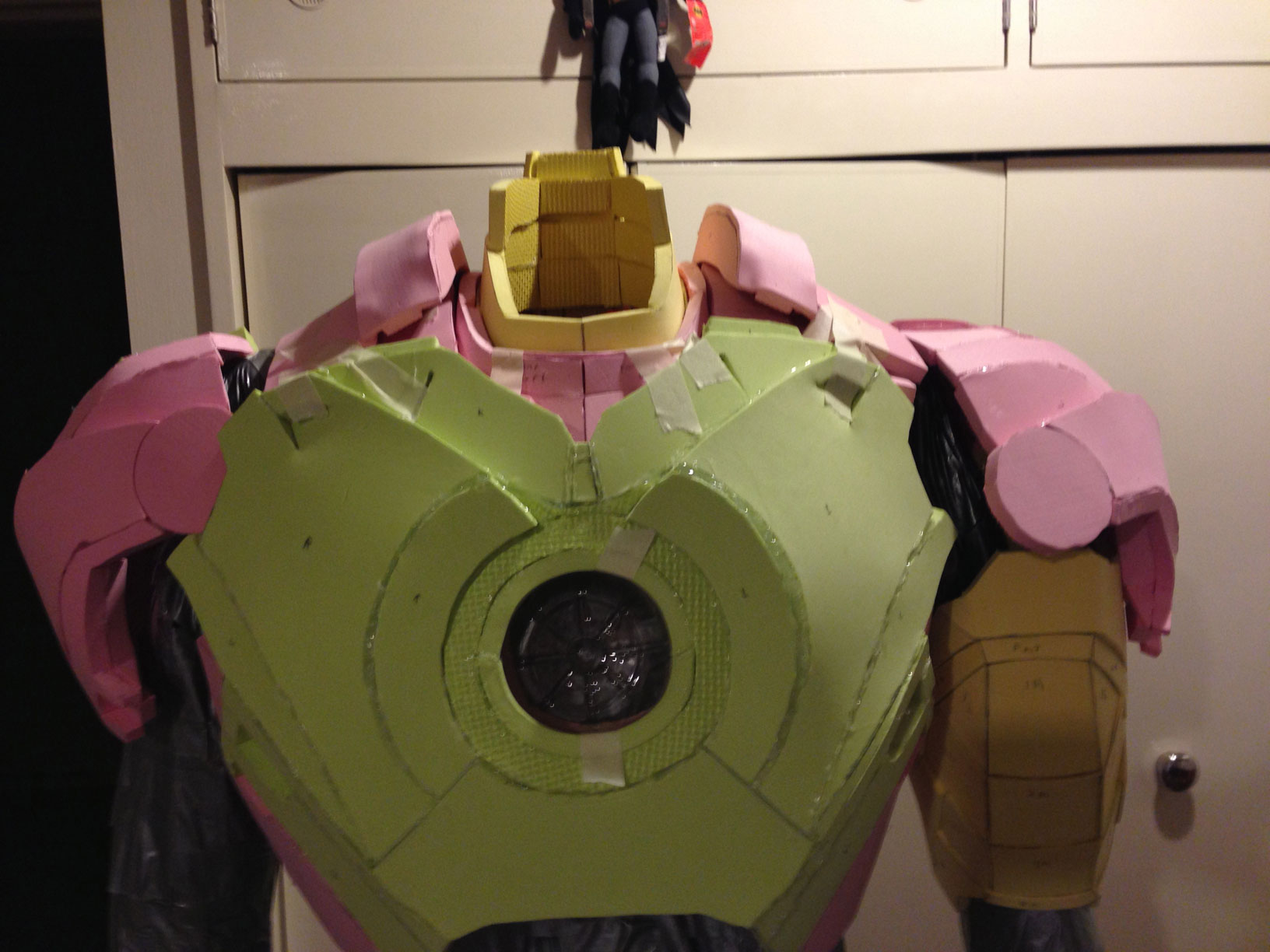

Small Update- Finished the collar plates. Put the suit together in a quick fashion to snap a photo to get the look of it so far but again, I don't know if that is right or not. I like it (Borat voice).

Use the two small collar parts you have created to connect the chest piece to the back piece. The sides of the chest and back then also connect, although for at least one of the side parts youll want to create a velcro or snap lock opening to allow you to put the armor on. If you look at my thread (Page 2) there are a few pictures of the chest/back piece of armor on its own where its easy to see how they connect.
I didnt make a brace, but ones Ive seen are just glued to the inside of the chest and back, making the chest/back/brace one piece of armor.
The neck seal doesnt attach to any other pieces as you want to put this on before you put on the chest/back. You can however use small pieces of velcro to ensure the neck seal doesnt shuffle around too much, but it probably isnt necessary.
One thing that I noticed, is that your neck seal needs to go behind/underneath the weird pokey uppy part that sticks up out of the top of the spine. See page 4 of my thread where there is a shot of me wearing the armor from behind.

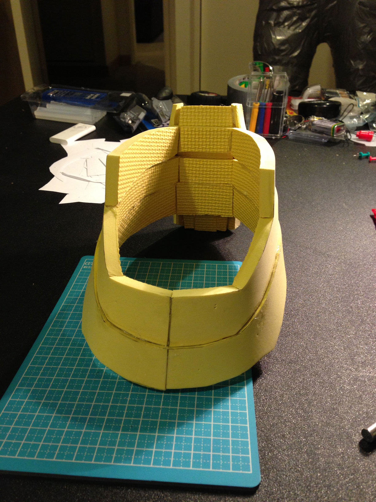

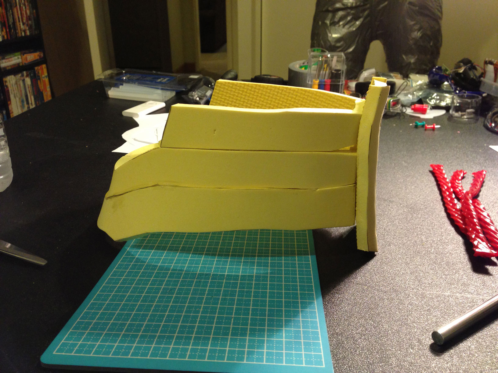

I actually just tried that and it didn't work. Here's it all taped up without the seal though.
I'll try to take more and add them soon. I still need to figure out the neck seal lol.

I think the issue with the neck seal is that the one you are using is originally from Dancin_Fool's MK3 - Everyone prefers the detailing on that neck seal and it looks good - however for it to fit with the MK4 from Robo3687 you need to tweak and adjust both the neck seal and the brace for them to fit or possibly merge them together - replace the head hole of the brace with neck seal from Dancin's files. Otherwise possible make Robo3687's neckseal which is designed to fit with the brace etc or.or.or.or.or. the templates are just really good guide lines but tweaking and personalising it what separates your suit from everyone elses..

I had a look at Stealth's thread for the MK4/6 foam files which are the ones you are using (I think) and on the first page the original link is correct in saying that it is dancin_fool's neck but the actual file when you download it is mislabelled as "iron man - neck - created by robo3867 - foam edit -stealth - a4 version.pdo" - Like wise for JF's foam pieces, the neck seal is also mislabelled as Robo's.
I have upload my re-arranged version of Robo's file for foam (I hope he doesn't mind)
A4 - - http://www.4shared.com/office/vjMEENdt/Neckseal_IM_robo3687_-_FOAM_-_.html
Letter - - http://www.4shared.com/office/M-QFW0JN/Neckseal_IM_robo3687_-_FOAM_-_.html
When I tested the neck seal ages ago I used really thin 2mm foam, it was nice and flexible but probably not very durable however it is a simple enough piece to redo if needed and thinner foam is the way forward.
There is a gap between the neck seal and brace that does need some individual tweaking to hide (where the arrow is pointing).

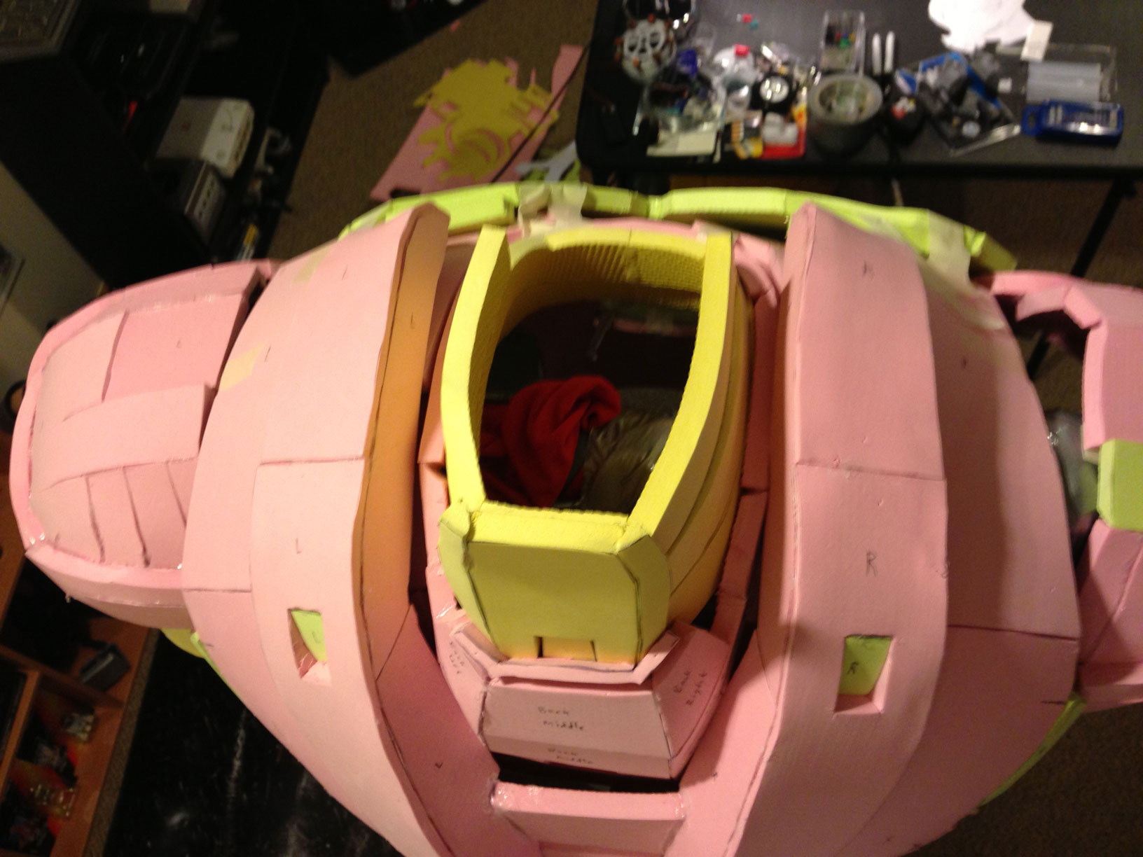

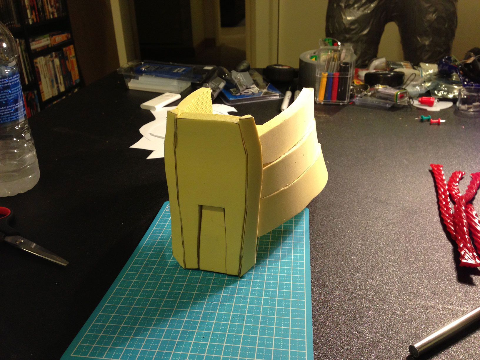

Update time. I have built the left bicep and a new neck seal that fits and looks perfect. I am very happy with it. Thank you Governor. If anyone wants to make it, look up a couple post to where he posted the pdfs.
What do you guys think of the bicep? Is it too big or does it look proportional?

Nice, glad it turned out decently. It's definitely not as detailed as the other neck file but it does what it is supposed to -

I actually like this piece better. The other neck seal had way to much going on below the actual seal and it would've been hidden under the brace anyway (since the neck seal goes on first). This one fits better and looks better IMO.

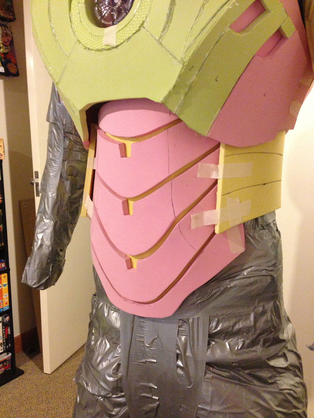

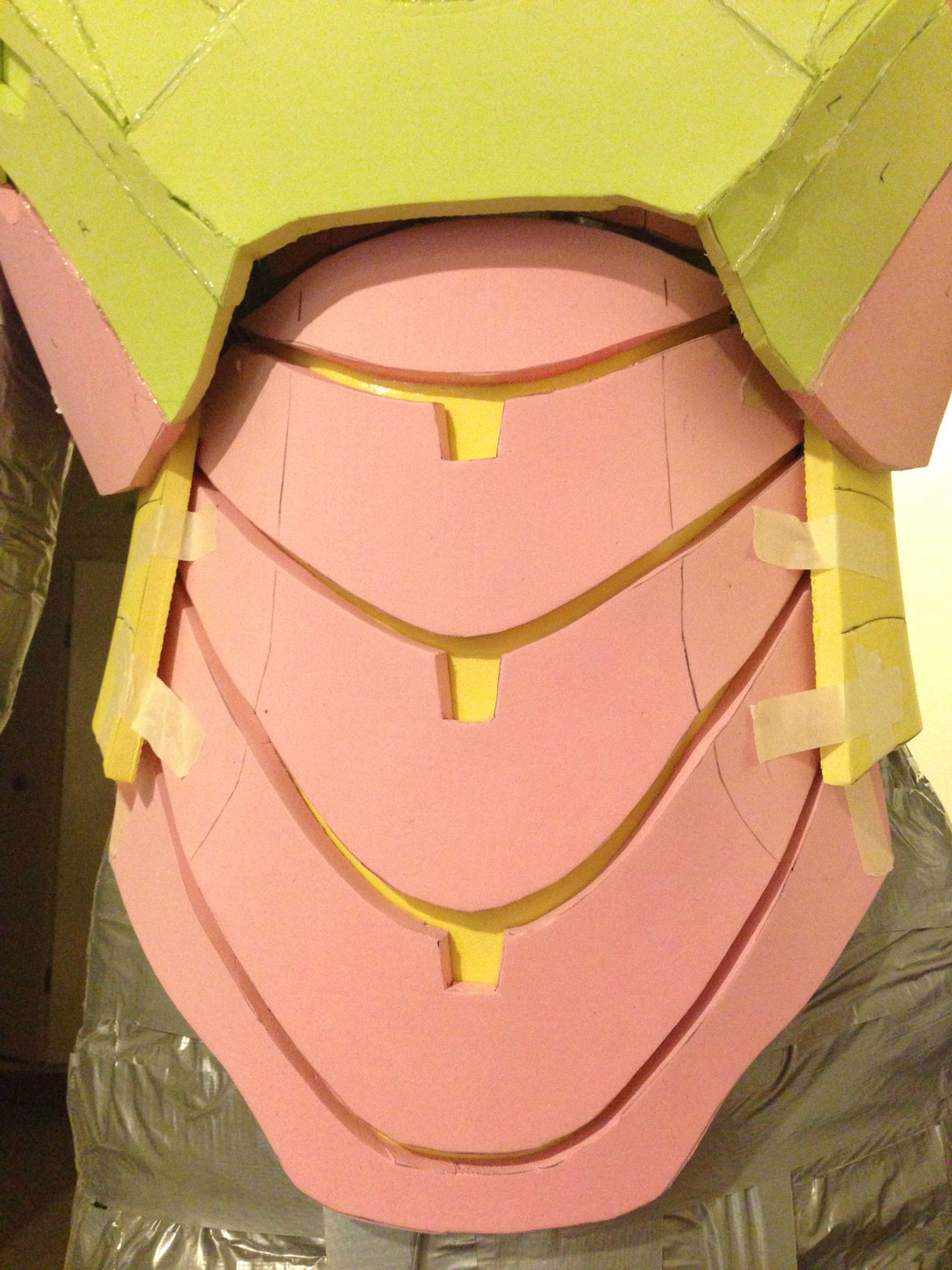

Air Force Iron Man Mark IV Foam Build (Abs done)

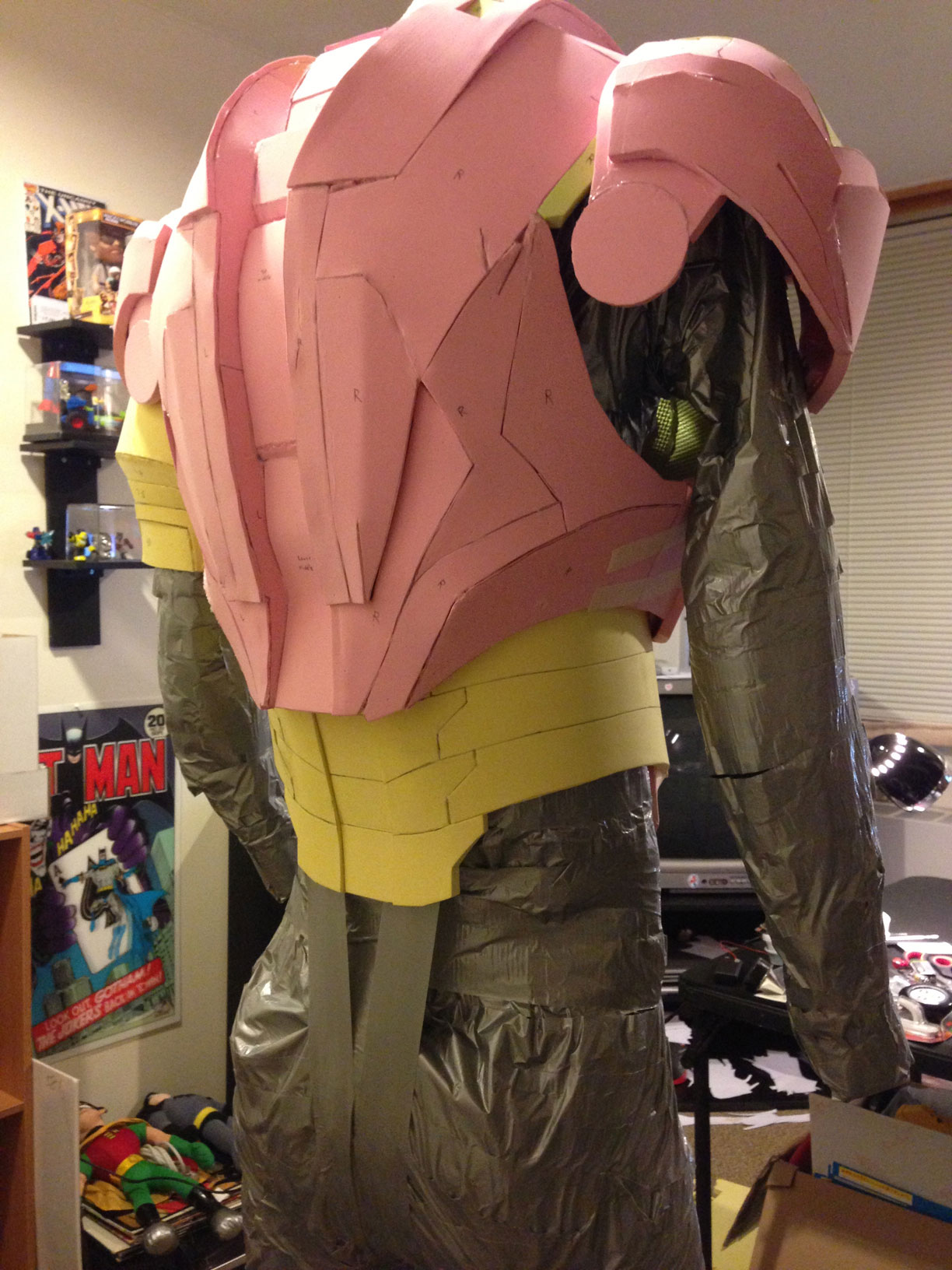

Update time: Well I didn't do the right bicep or the helmet but I had a go at the abs and this time I used JFcustom's abs file and it was very easy to build especially with the larger pieces from taping the templates together.

Another small update: I finally got around to doing the right bicep. I used a mix between Robo3687's files and JFcustoms and I think it was a little easier to do it this way.
I am currently working on the left forearm and I am doing it the same way, a mix between the two. Some parts are easier to make with one person's templates and vice versa. Who else does this? Mix and Matches?

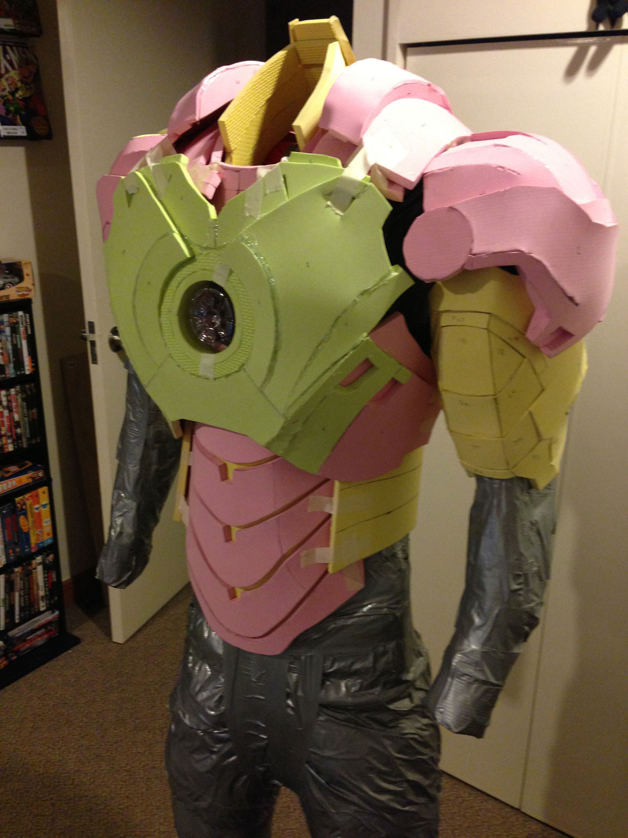

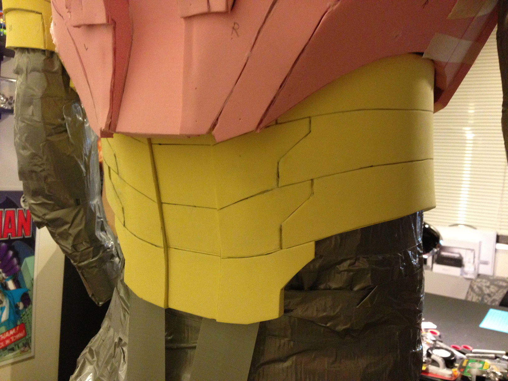

Re: Air Force Iron Man Mark IV Foam Build (UPPER TORSO ALMOST COMPLETE)
For those of you still following along at home(hopefully some of you still are :)), I have completed the upper body. It has only taken me about 2 weeks to get to this point. My skills have improved 10-fold and I am really happy with how it is coming out so far.
I am going to re-do the entire left arm and maybe the left shoulder. I used a different template for those and they are slightly bigger than my right arm which came out way better. Plus, the left arm looks like poo.
