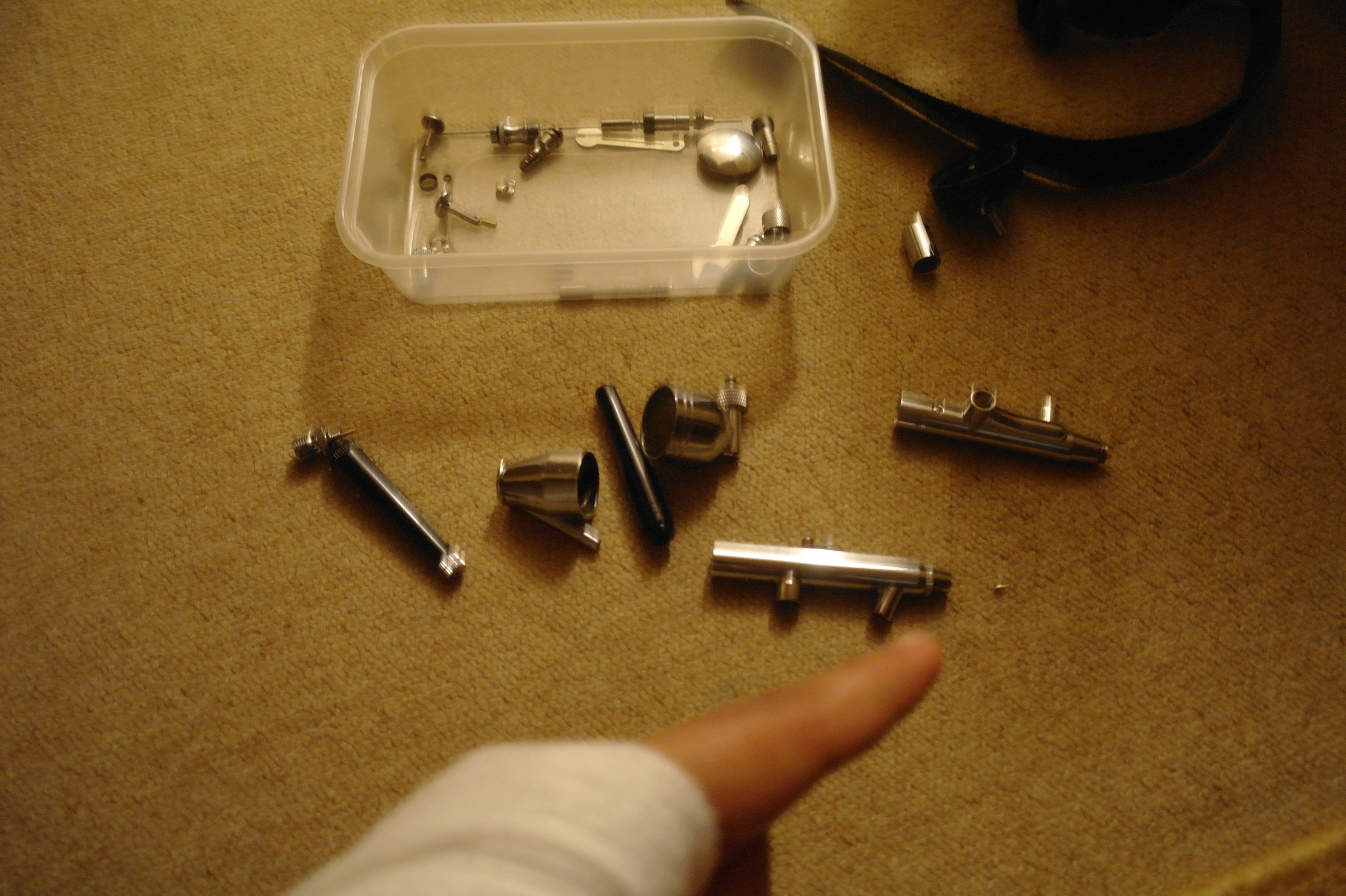

Can u post a picture of the airbrush maybe we can talk you through the issue?

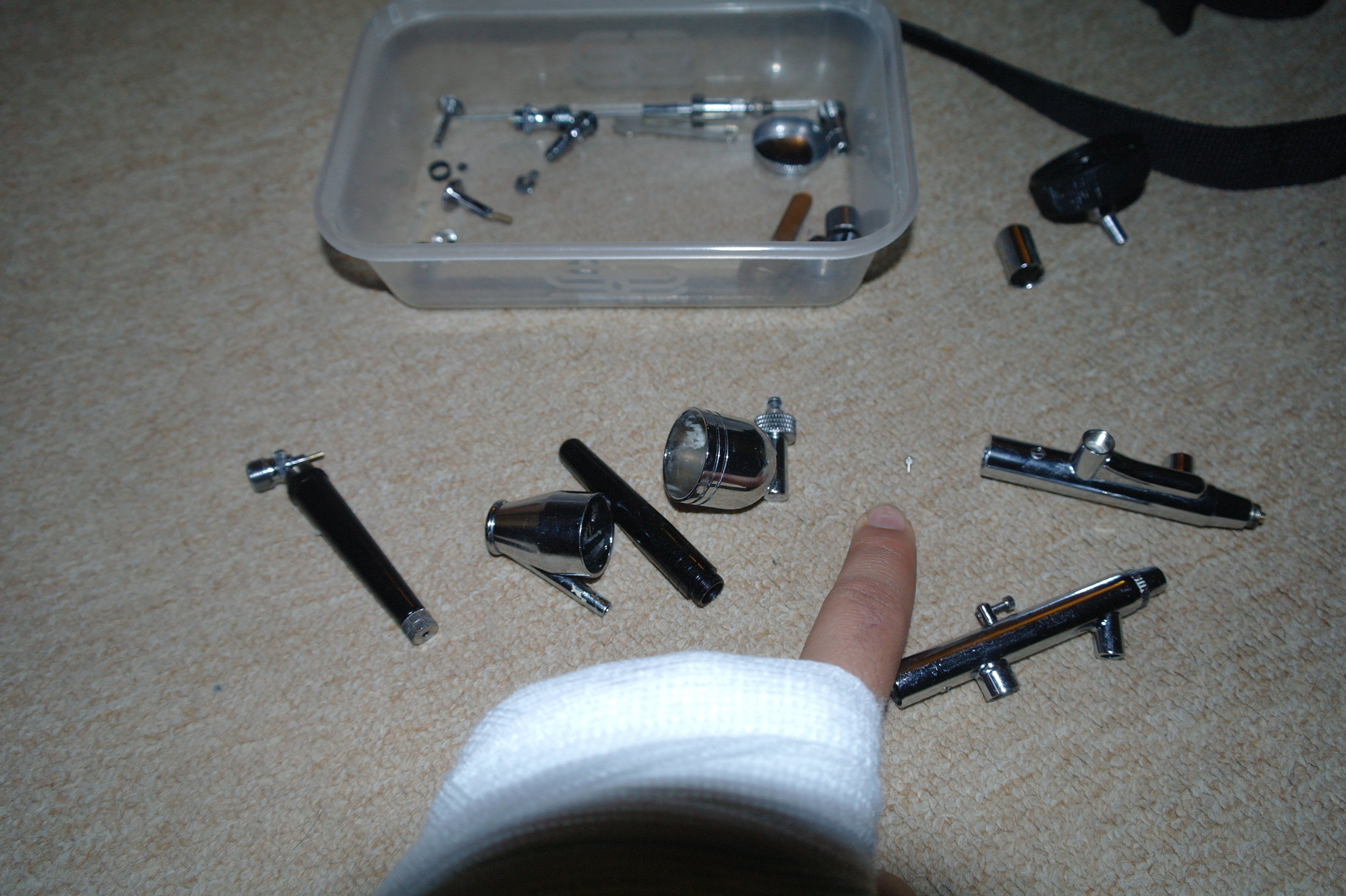

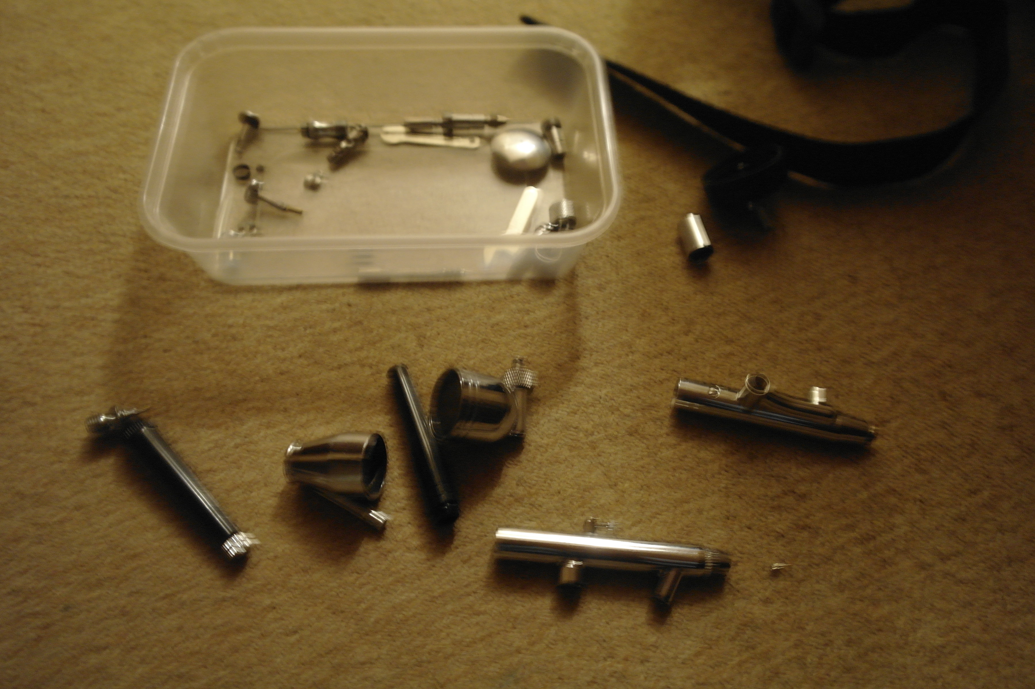

From the picture i see 2 different style guns make shure your not mixing up the parts for starters and usualy the order is airbrush, nozel then nozel cup. The nozel cup normally holds the nozel snug in place

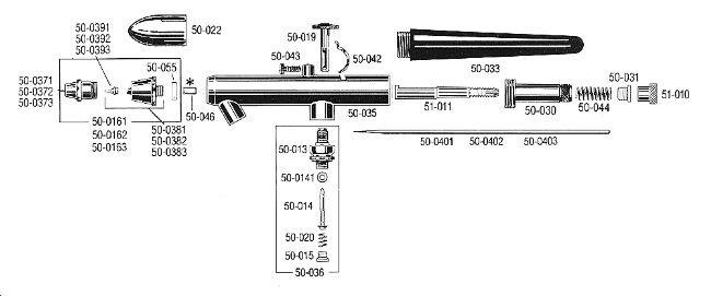

now i have however seen screw on nozels and if this is the case then you may have stripped the threads and that may be your issue otherwise i have this diagram hope it helps let us know
I don't know if this is the one you have but these diagrams can be found online easily

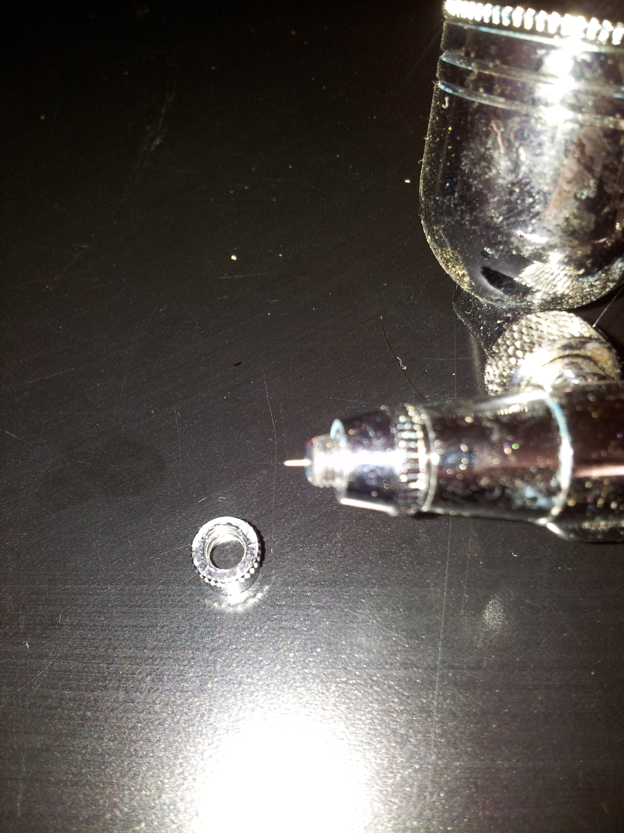

I took a quick photo before I went to work. The end just screws on, I cant get a better close up without it going blurd
View attachment 126456 I took a quick photo before I went to work. The end just screws on, I cant get a better close up without it going blurd
The piece in this picture is a needle cap. The sole purpose of it is to protect the needle from getting hit or damaged. The airbrush should work fine with or without this part i purposely take that piece off my airbrush before use. I feel like you can get closer and better detail with out it...
My opinion...
Thats right it doesn't stop the brush from spraying at all but probably best to keep it on when not in use so you dont damage the needle
