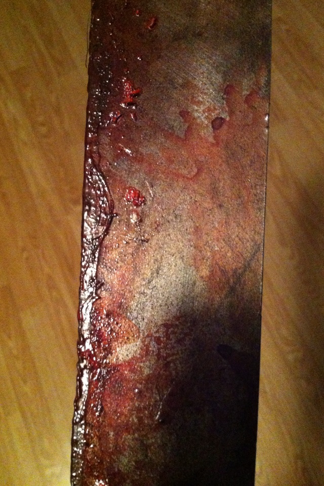

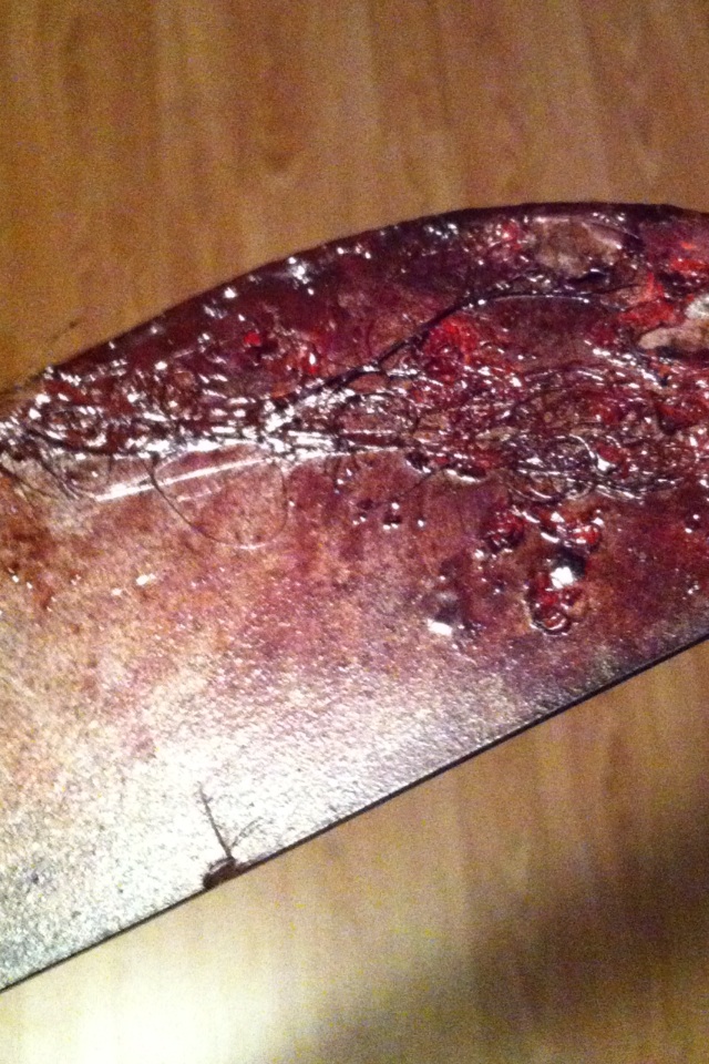

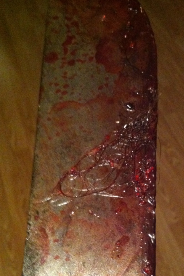

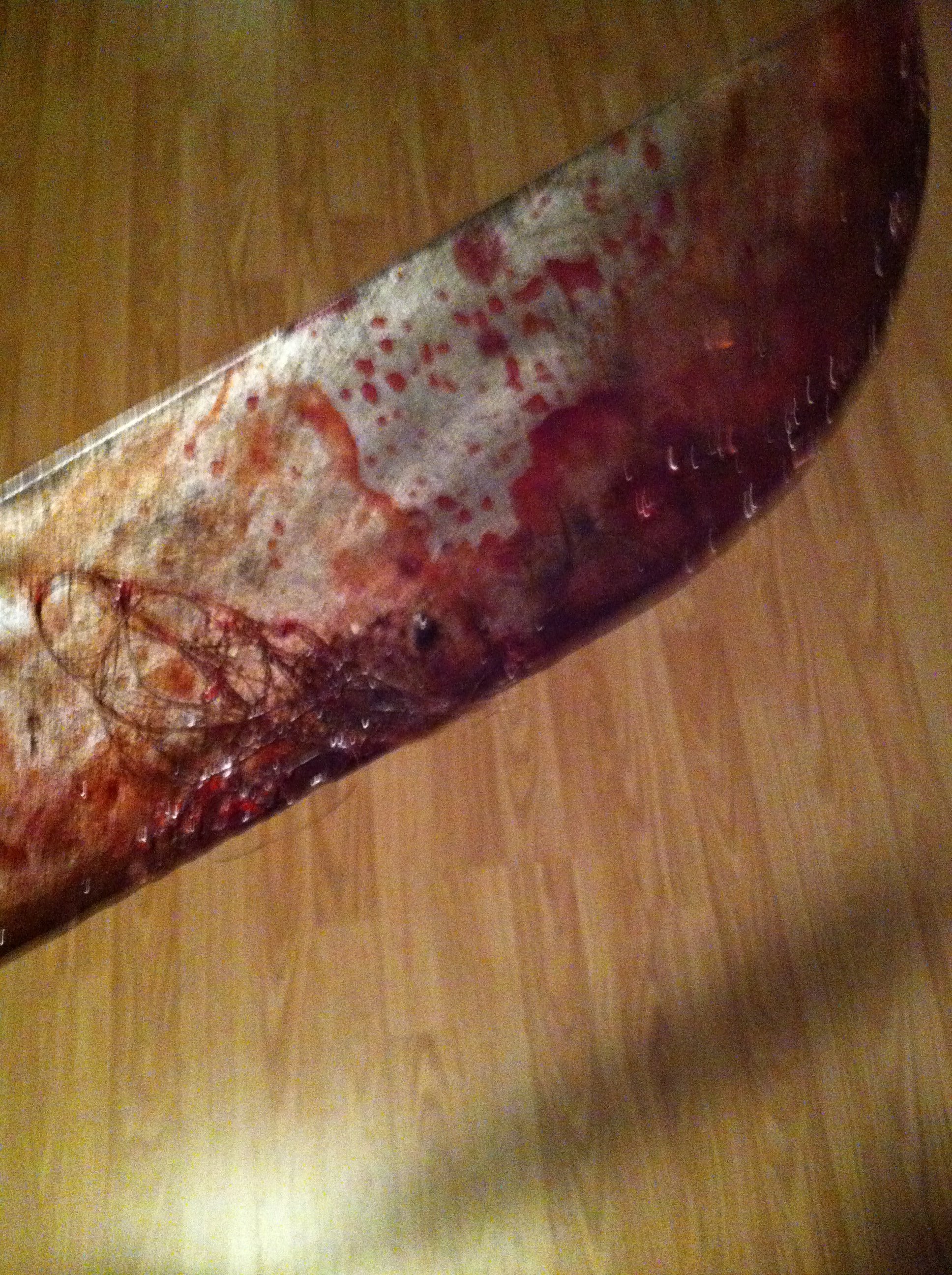

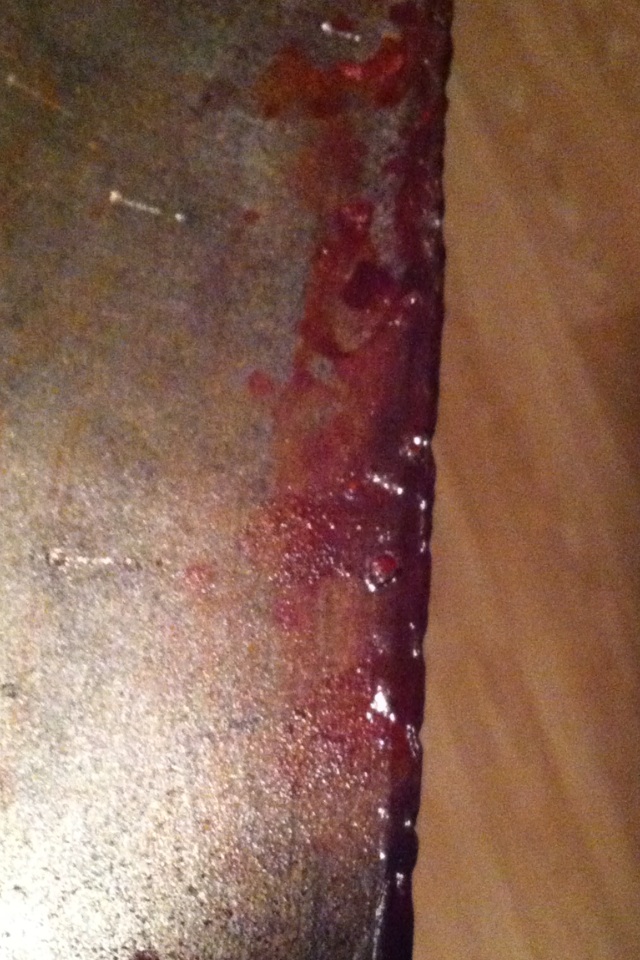

Here is a machete I did. This was done 4 years ago and still looks wet ;)
What I did was take red theater blood and splattered it on for the lightest layer of blood.
I then took more blood and mixed in some black paint. I then splattered that on.
I then took that blood/black paint mixture and mixed in dry OATMEAL, some dirt and grass and human hair.
I then caked that mixture along the blade edge and random spots. The oatmeal really give a good clot look and maybe brain matter.
I then let it dry and then hit the blood areas with a Krylon Triple Thick Glaze spray. It ties it all together and makes the red blood look richer and deeper in color. It looks slightly wet, but gives it a dry blood color and feel too in spots.
That looks ridiculously realistic. I'm a fan.:thumbsup
