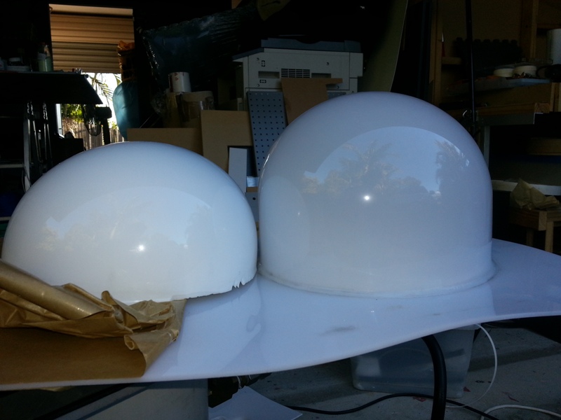

Here is my tests on "female tooled" vacuum forming.
attachment.php
I did these smaller scale test pulls made from 3mm (1/8th") Perspex. I didn't have clamping plates, so the sheet bowed and eventually broke the seal. The taller dome is thin, but optically clear at the thinnest parts. I want to make a small jig and see if I can't make bubbled lenses for Stormtroopers this way after seeing how bad the "male tooled" vacuum from parts look (to look through) andhow clear this dome is.

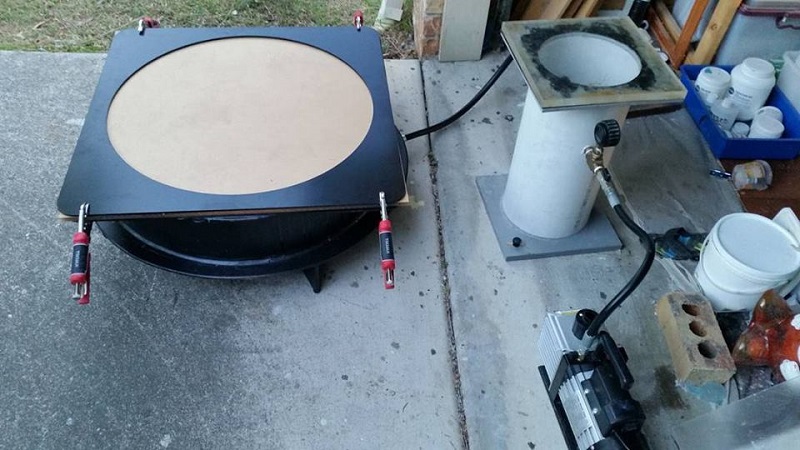

My new rig, scaling it up from 250mm to 700mm.
attachment.php
I did my seal tests (3 times) yesterday and all worked a treat, so off to get the fan forced heater built. That is 10mm Perspex on the form.

When Vacuum forming, the mark-off from a "female" tool and a "male" tool on clear material would be the same, just on the other face of the plastic. In real industry this is often referred too as "first surface" and "second surface", as the surface you use (the one seen) is the surface touching the tool (1st /female), or not touching the tool (2nd/ male).
If i understand your tooling, you seem to be describing "Blow forming". This would result in clearer lenses, as the plastic never touches a colder surface.
If you have to vacuum form you lens, the one advantage in a first surface tool, is this puts the mark-off is on the convex side of the lens, allowing easier sand and polish to remove the distortion.
The domes shown technically were "untooled" apart from the chamber they were pulled into. So I guess you could say blow formed, except these were done under vacuum. I took the 2nd done to 20"HG from memory. Both are made from the same 3mm white Perspex, just the 2nd dome (the taller one) I decided to go all or nothing and wanted to see how far I could go before it tore. It didn't tear, but is paper thin at the top.
The big rig is just a bigger version with steel rings to hold the plastic edges flat.
Hopefully I get do some work on the heater today. I am using halogen lights. Instant heat and they get really hot, like they will start a fire type hot. Before I knew the risks of working PVC, I used the heater on some sheet of the 3mm PVC. It was vaporing in under 3min!
