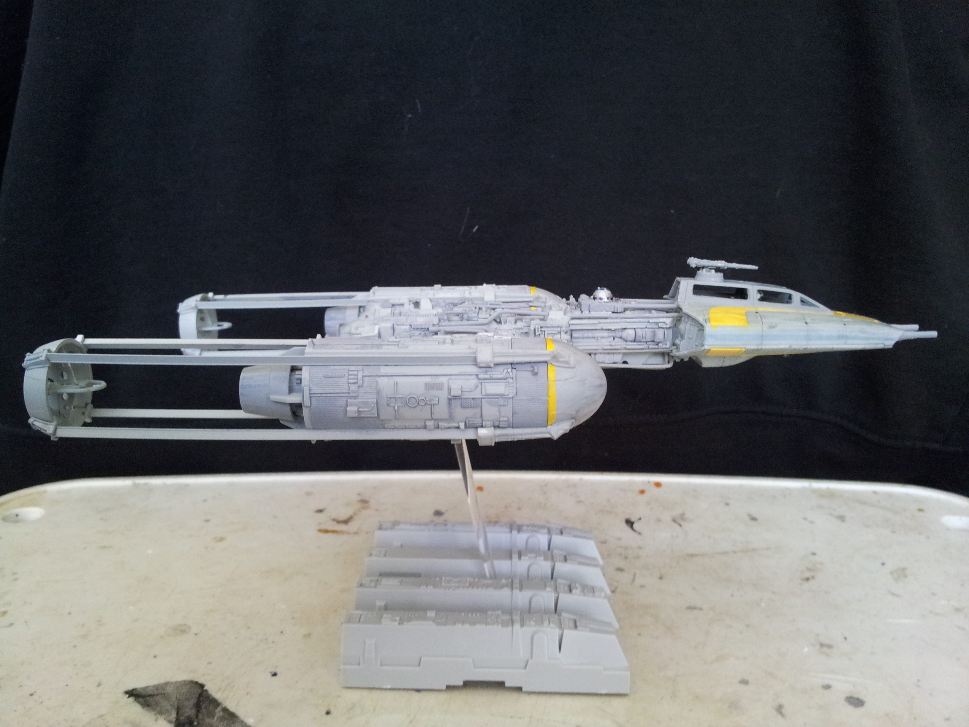

I would say that the best course is just common sense. I think acrylic/water based paints work great, or pick the ones you like best. I love Apple Barrel and Folk-Art, very inexpensive and excellent quality - But there's lots of good paint out there. I think sub assembly painting works good - For instance, on the Y-wing kit i just started, I built the cockpit pod minus the little cockpit detail parts, they're small models, so it's easier for my bannana sized fingers to hold the thing if some of it's together. On this one, I'll put the main fuselage together first, minus the piping parts, to make it easier to do some weathering and washes, then add the piping. What ever makes it easiest for you, that's the right way! Just have fun with it! By the way, you cannot go wrong with the Bandai stuff, it is absolutely remarkable.

The Y-Wing is for sure the trickiest of the Bandai kits so far. I used Tamiya spray and enamel for the bits I brushed. As long as you use good brushes it won't look crap. I also used panel line. I painted the base colours while still on the sprues.

Shadowlova - Beautiful job on the Y-Wing! You're right about the brushes, good ones make all the difference, also a couple of thin coats instead of one thick coat makes a difference, especially with acrylics.
