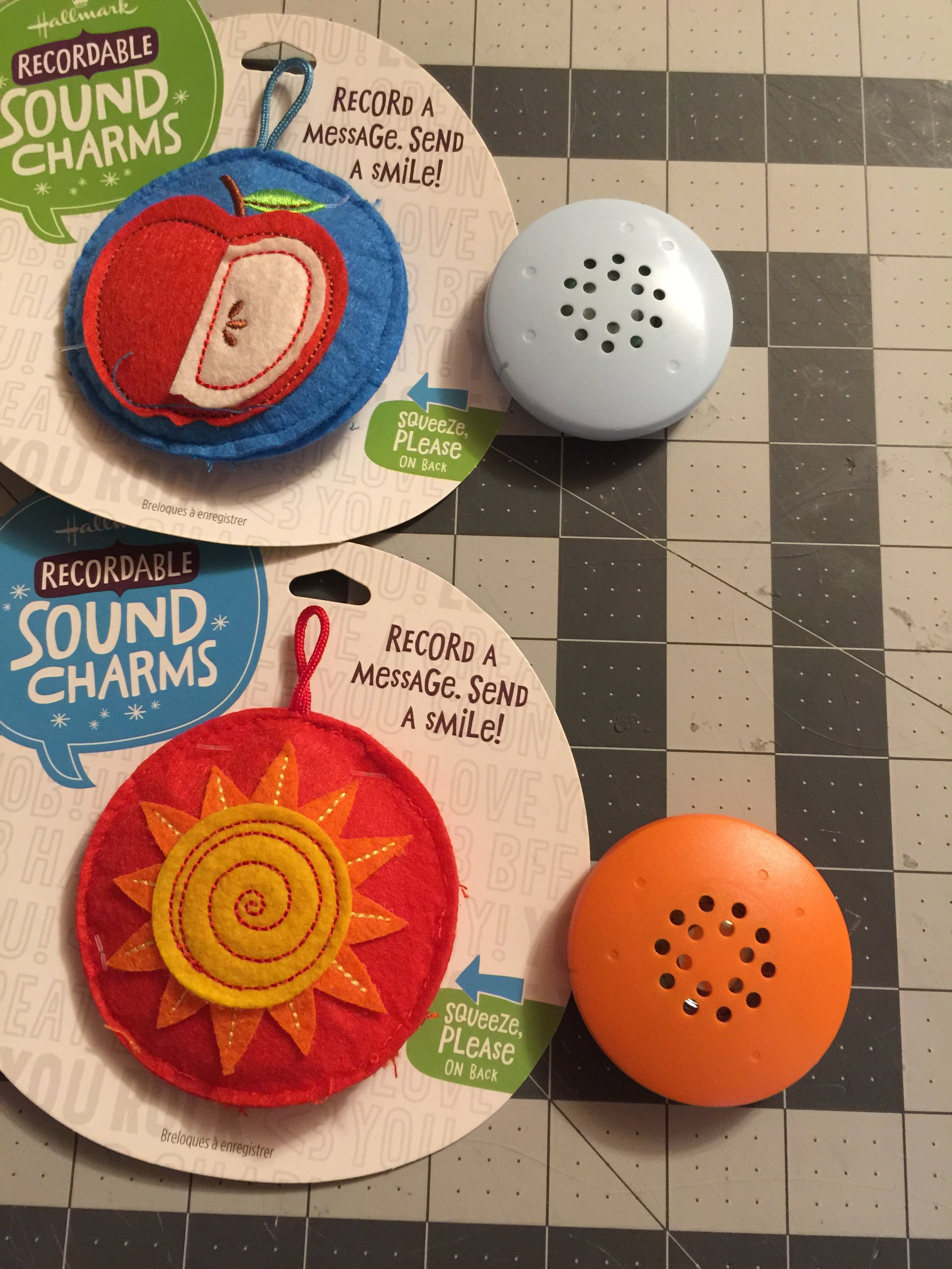

There are several "plug-and-play" options out there. The kind of boards found in toys can be found on eBay and similar for under $10 -- a little more for ones that include amplifier and battery clips in one convenient package. They tend to be limited to a single sound sample and the playback quality is low.
