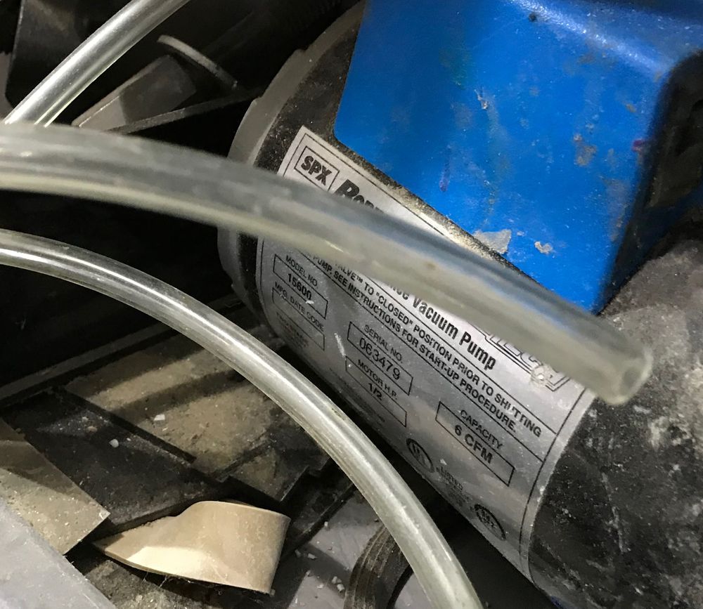

In case it helps, here is a photo of a few adapters I have handy.
Looking at the pump (couldn't open the link on my phone, can on PC) and I will suggest that one of the three is a 1/2 thread, one will be 1/4" thread and anyone's guess for the 3rd. My pump only has the two, 1/2" and 1/4".
What hose are you intending to use? In the end, I got steel reinforced hose as the plastic stuff that I was told would be OK crushed after 20"Hg. The guys at EnZed fitted spinning attachments that allow me to attach and remove the hoses.

Yep that is what I was told too, and then it crushed in on itself at about 20"Hg. Some small vacuum systems (those 4.5ltre kits with the 3cmf pumps) come with that and it works fine. Not in my case.
I don't know why you had trouble, maybe it was your hose didn't have sufficient wall thickness. We use 2 commercial 220v two-stage Alcatel pumps that are far from small vacuum systems, have pulled hundreds of gallons of rubber, and never had a hose collapse.
Haven't had trouble for years (about 2 now?) since replacing the clear hose with a proper steel reinforced hose. Yeah, maybe the wall thickness was not thick enough. A non issue now and taking the system to the guys in the know, gave me a full working solution that has served me well.
