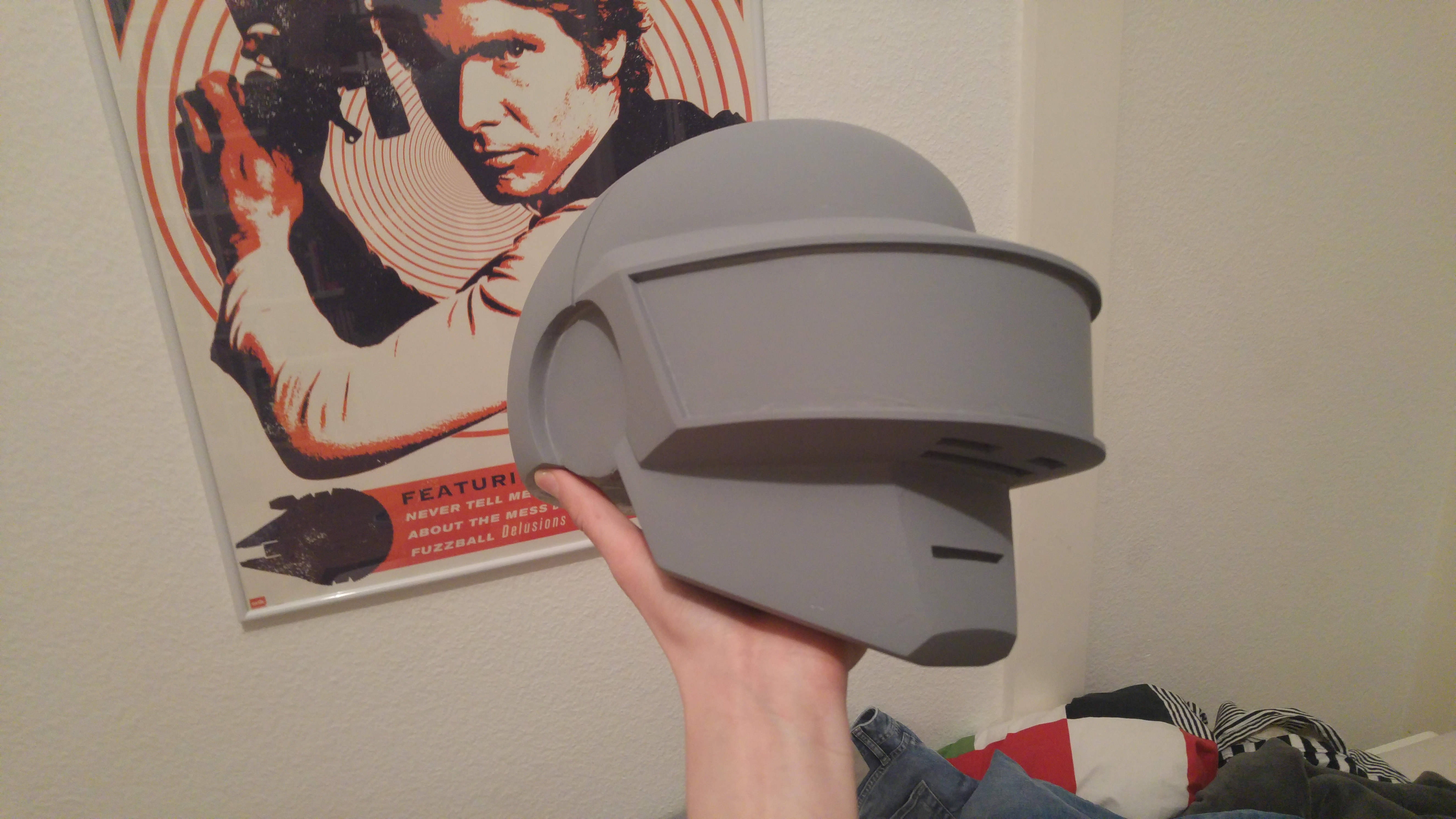

Btw this is the project I am currently working on:
Thomas (But not Bangalter)
