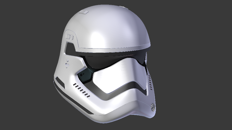

Some details on the model:
- Since I couldn't decide which helmet style I wanted to go with (Episode VII or VIII) i made both of them.

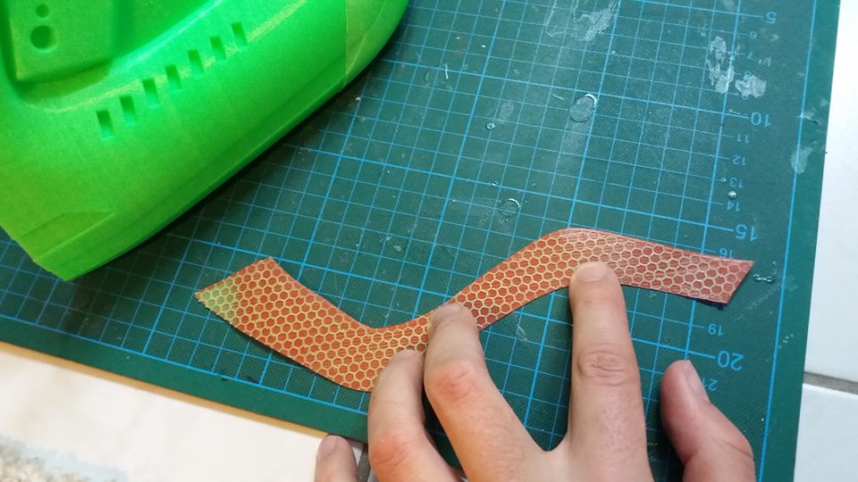

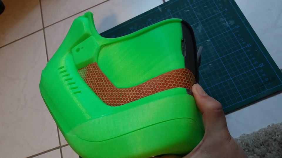

- The hexagonal structure on the Helmet would have been really hard to model and post process, so I came up with two 3d printer-friendly solution.
First: A glue-on solution: The hexagonal structure is printed flat and then glued in place.
Second: The hexagonal structure can be inserted into a small undercut and is held in place by the "Nose"-section.
If you don't understand what I mean, look at the pictures.
- Visor-Stencil: I have a vacformer but I figured, since it is not a requirement for the 501st approval to have a bubble lens. I could just as well make a cutout for the visor since that is easier to apply a black tint to. So I made a stencil that would fit just right.

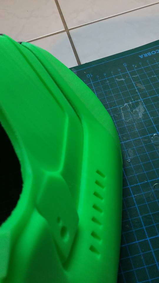

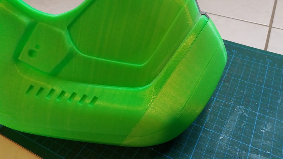

And here are the first pictures from my first test helmet. Probably going to reprint this since i tweaked the design a little. At least you get the idea behind the Hex inserts.

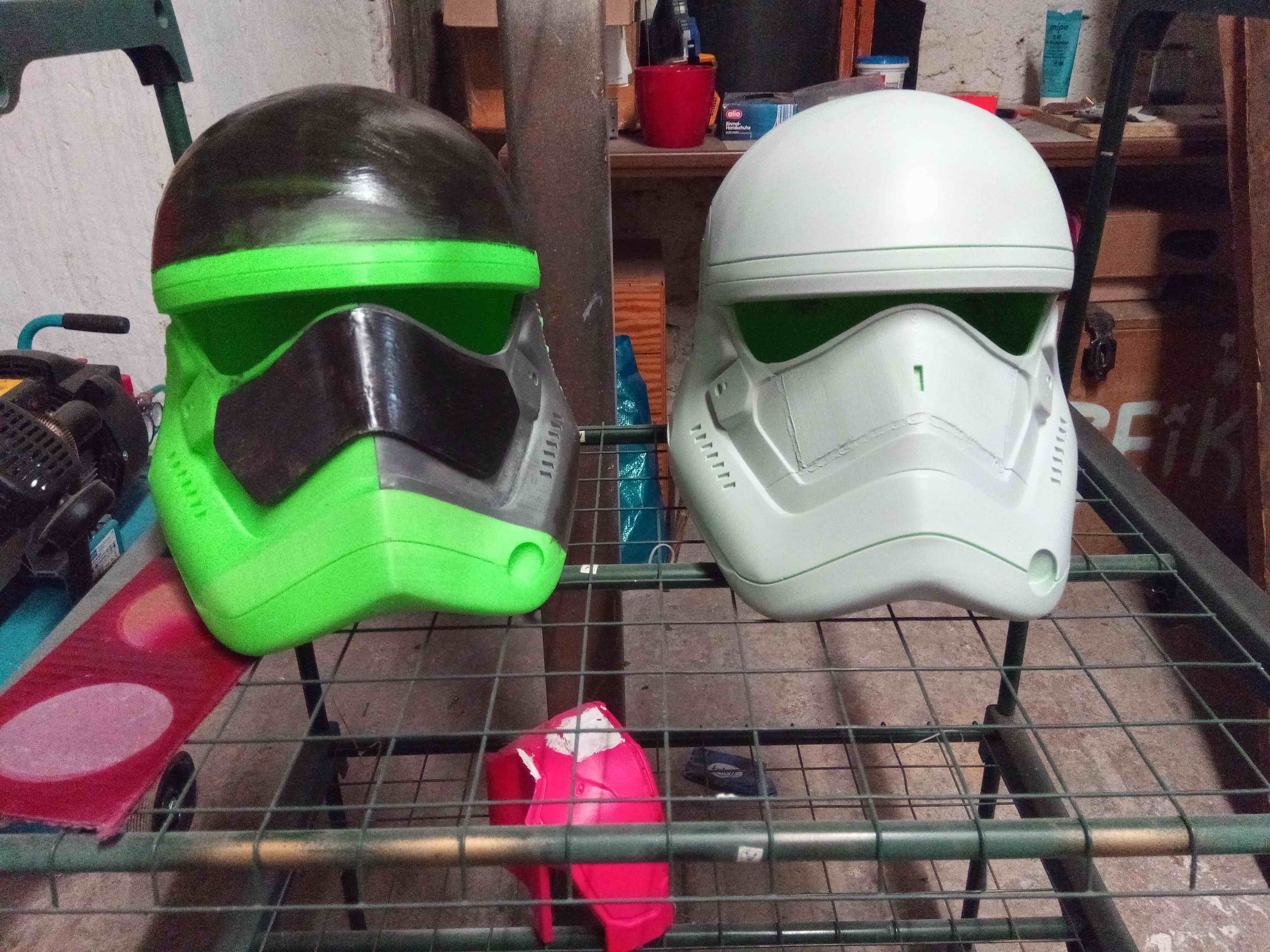

Busy with the Helmet at the moment. On the left was my first test-print with some black epoxy on the dome and the nose. On the right the ABS version. Here you can see the registration indentation for the nose piece.
Looks fantastic! How many parts did you split your helmet into? Can't wait to see them painted, great work sir!
