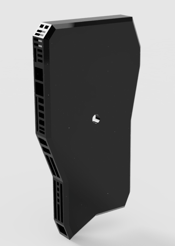

Okay so it's been awhile since I posted anything in here. This is because we've been so busy on other projects that I haven't had the time to mess with this at all but being that it's the 4th of July weekend I've had some free time to get my geek on and to get a little more done on this project.
Here are a few renders out of Fusion
A lone module with greeblies added.
A stack of modules with mechanical joints.
View of the inside, each module is hallowed out with a space to fit our gears and torque transfer module.
Basically a motor will transfer motion to that central shaft, since each of the 60 modules has it's own gear box torque from that drive shaft will spin each unit to a pre-set location, and also be able to return each module to it's full up-right position.
