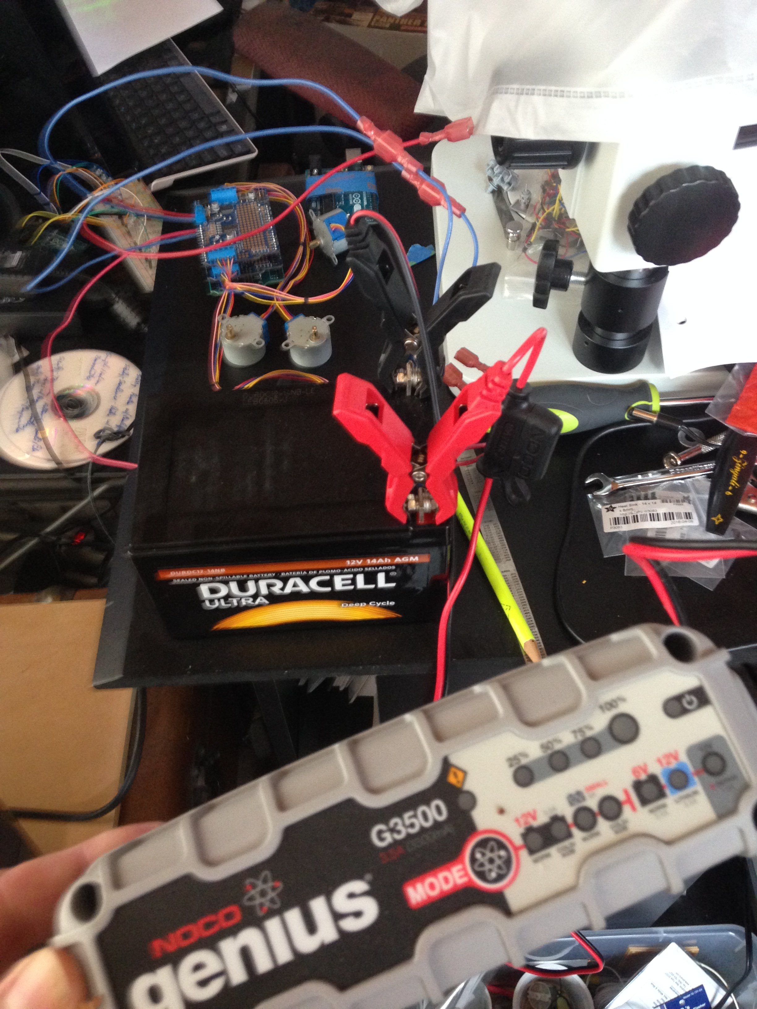

My son designs his circuits for 12v. The "standardization" on 12v came about early on, as some of the contests we go to are a week long (IPMS) and we don't necessarily stick around town the entire time (we sightsee while in that part of the country) and can't be there to change the batteries. 12V came about since its easy to power not only LEDs but stepper motors and arduinos off of 12v. The first year or two he used regular D cells. But later we standardized on 14ah gel cel batteries. Invested in three of those and a very good charger that can bring the batteries back from a below 3v level, and are able to charge the batteries overnight. His latest model has 3 (maybe 4?) arduinos controlling lighting. About 30-40 LEDs, 4 12v stepper motors + an arduino and the associated motor controllers piggybacked on board. Obviously in this model the steppers are the main consumer.
When we're at home, he uses 12v wall warts while building and testing his designs.
