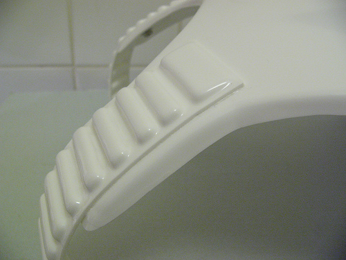

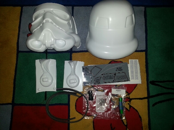

My wife and I recently joined the 501st and we are now in the process of trimming and assembling white ABS parts that will become our armour. Given my wife has a much smaller frame than me, we were advised to buy AP armour for her. We also decided to buy and build her armour first (I bought the AP bucket - first image) and then I will probably get NE (light kit, no bucket) for myself as I am told it is slightly larger. In fact I find parts of the AP kit a bit small like the shoulder bells and even the chest plate.

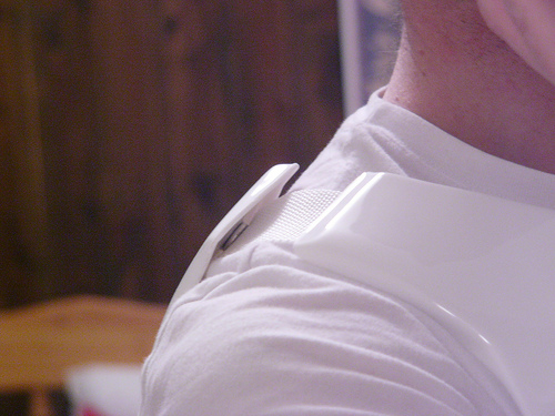

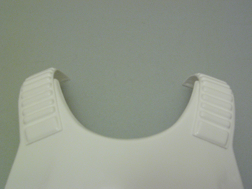

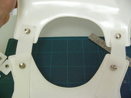

Here are some reference photos I use. (Note: This is Stukatrooper's TM kit build not mine). See how he has a white nylon strap snapped to both the chest plate and back plate? It snaps on the underside of the plates out of view. The styrene/abs "strap" with the ridges then gets glued to the chest piece but not to the back plate which is why it is "free floating." Hope that helps....
hidden nylon strap reveal.jpgstraps glued to chest.jpghidden nylon strap.jpgglued shoulder strap.jpg
Oh...and about 5 ridges
Re: ANH TK Armour
It does help. Thank you very much. So if the 4th image is of the chest plate, then the straps can go further forward if required. It looks in that image as if the strap is positioned so the 5th small ridge is level with the edge. And I guess there has to be some allowance here as no two people will have the exact same frame.
Re: ANH TK Armour
The strap should only have 5 ridges in the front. It can be longer in the back.
Re: ANH TK Armour
Thanks for that tictoc as that is the answer I have been after :)

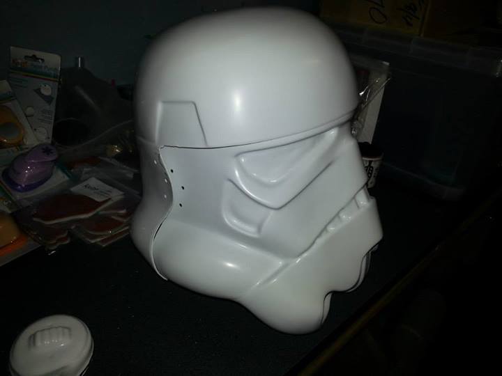

Got the ears done, though they might need a bit more trimming. Then I can start the eyes and frown. Hopefully over the weekend I will get this almost finished.
Re: ANH TK Armour
Had some help tonight and got this far...

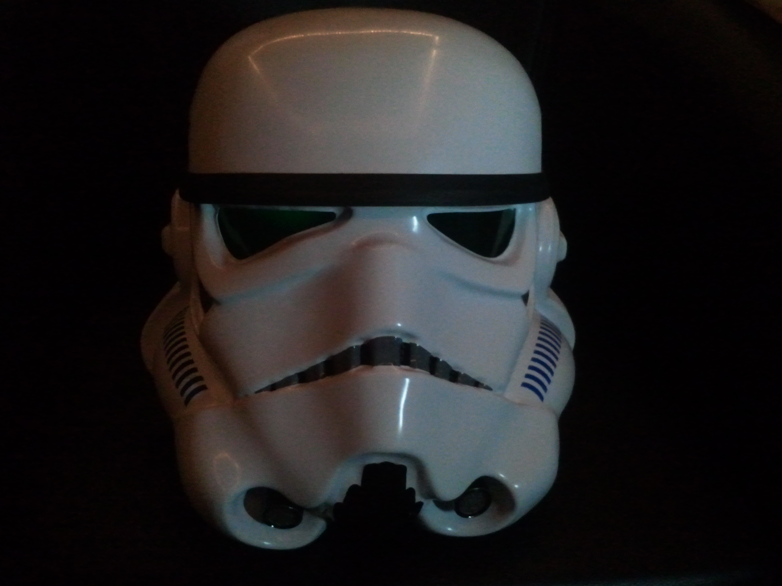

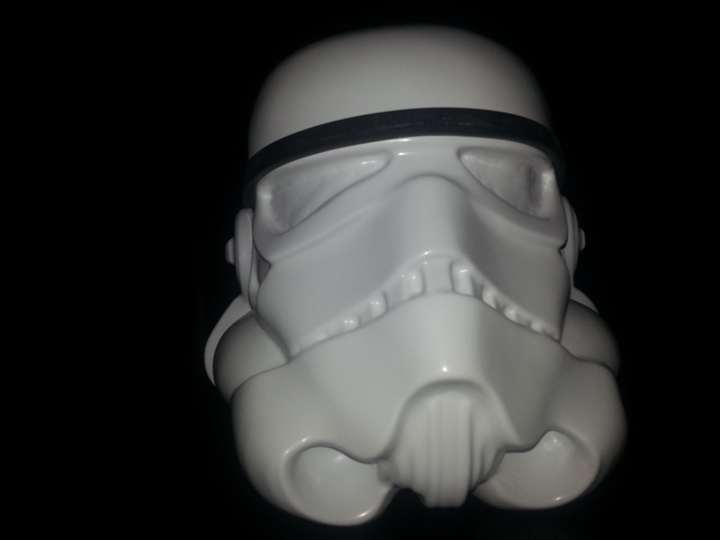

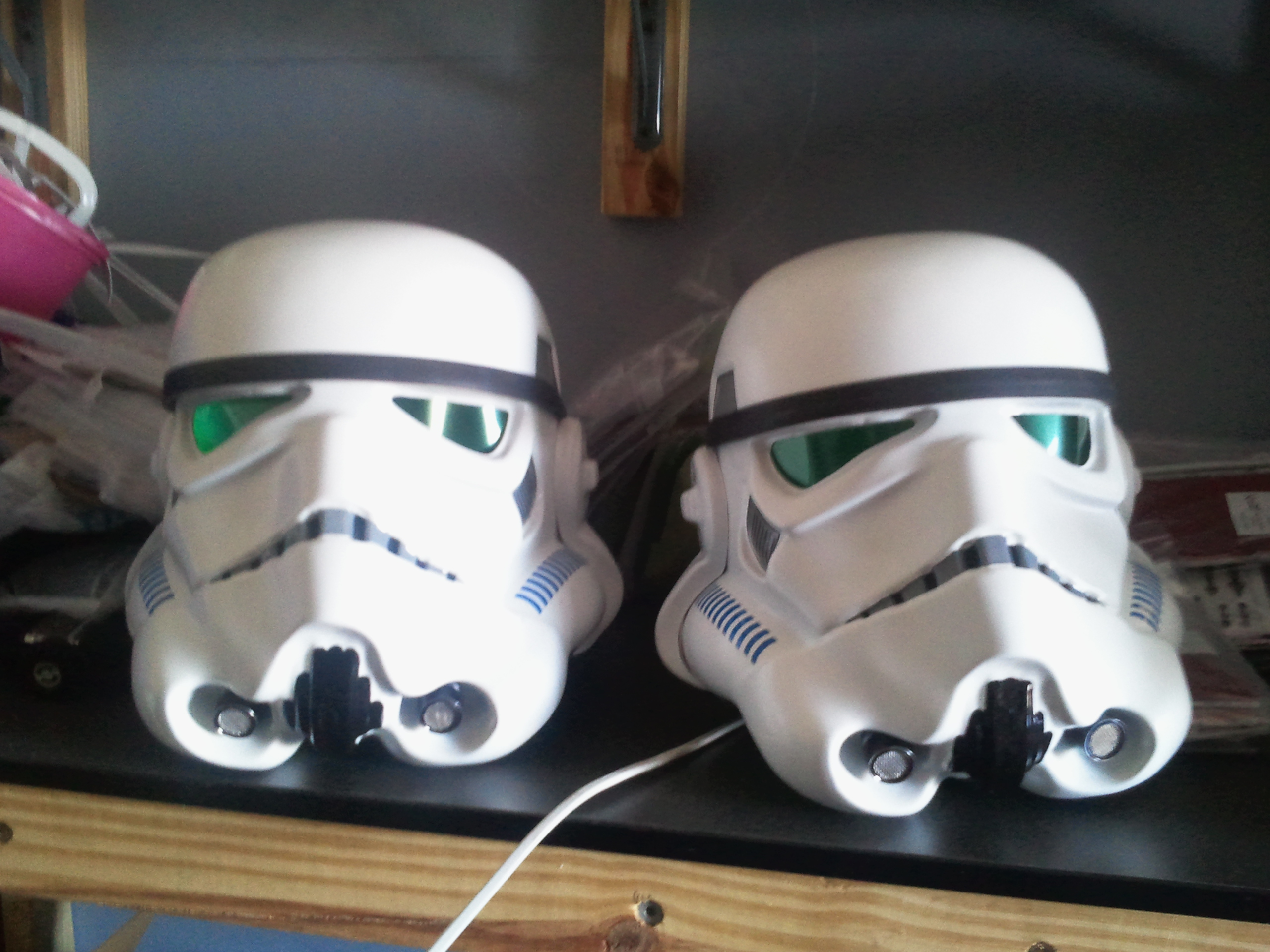

Thought I better update this. Slowly slowly, getting there. My wife must really love me as she hand painted the frown and "coder" after I kind of stuffed mine up. She also said that she will remove the stick on decals and hand paint the traps on the lid as well.
Re: ANH TK Armour
They look great. What a great kit. Most people over paint (make it cover too much of the teeth) the frown. One of the most important parts in the assembly is how the shoulder bells hang after being attached. If the are not attached properly, the "open up" in the front and leave too large a gap.

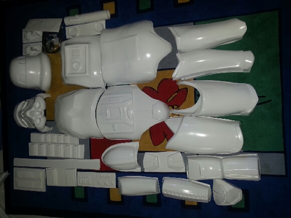

Quick update:
Thermal Detonator and arms are done. This is my wife's TK and there was a massive amount of plastic to be cut off the forearms to make them actually fit. Most of the legs are done, just a heap more trimming to do there.
