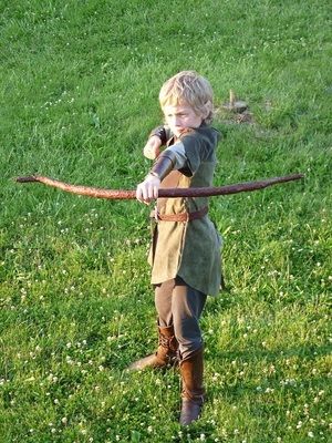

First video: How to make Craft Foam look like Leather
From this thread: Little Legolas
From the bracers, belt and boots of this costume:

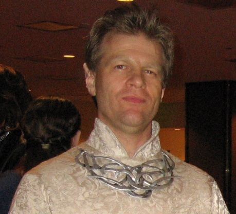

Second video: How to make Craft Foam look like Hammered Silver
No thread
For the necklace on this costume:

Very cool! I had seen heat used to gloss the surface of craft foam before, but hadn't thought of just ironing it. Does the foam warp at all when you iron it? I'm thinking it would be a great medium for the embossed gold strips on my Prince of Persia armor, but if it warps when ironed I might need to iron it before cutting the pieces out and embossing them.
Also, that honeycomb smocking is really cool looking.
Re: 3 Video Tutorials: craft foam to leather, to hammered silver & honeycomb smocking
Glad it'll be useful, FudgeMando! I look forward to seeing the results.
Risu, hey there! The foam does shrink a bit with the heat and so I usually cut it a bit on the bigger side of my pattern, or iron it all first. And it does warp some if you just iron the foam, which is why I really prefer the heat n' bond with fabric treatment because it makes it sturdier and helps it keep it's shape. It may be an extra step and a bit extra expense, but everything I've done that way lasts so much longer.
