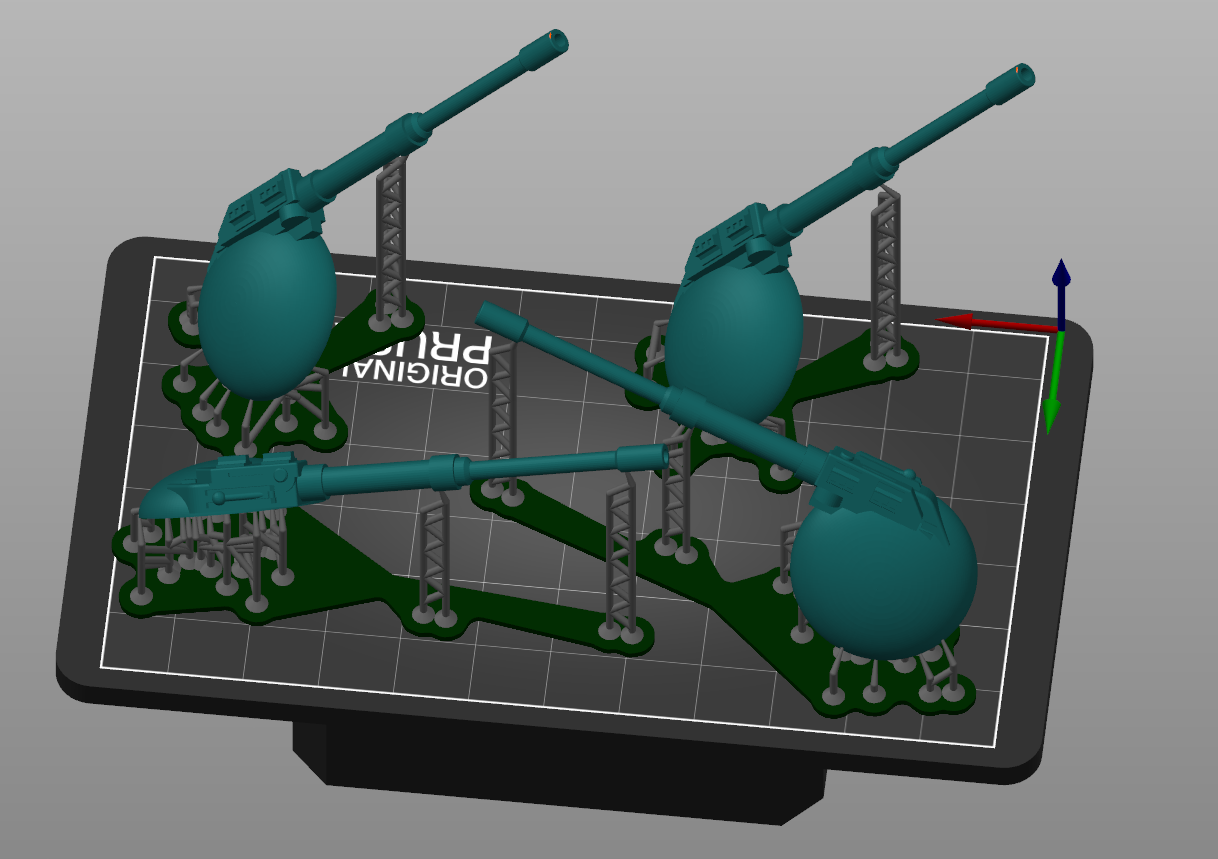

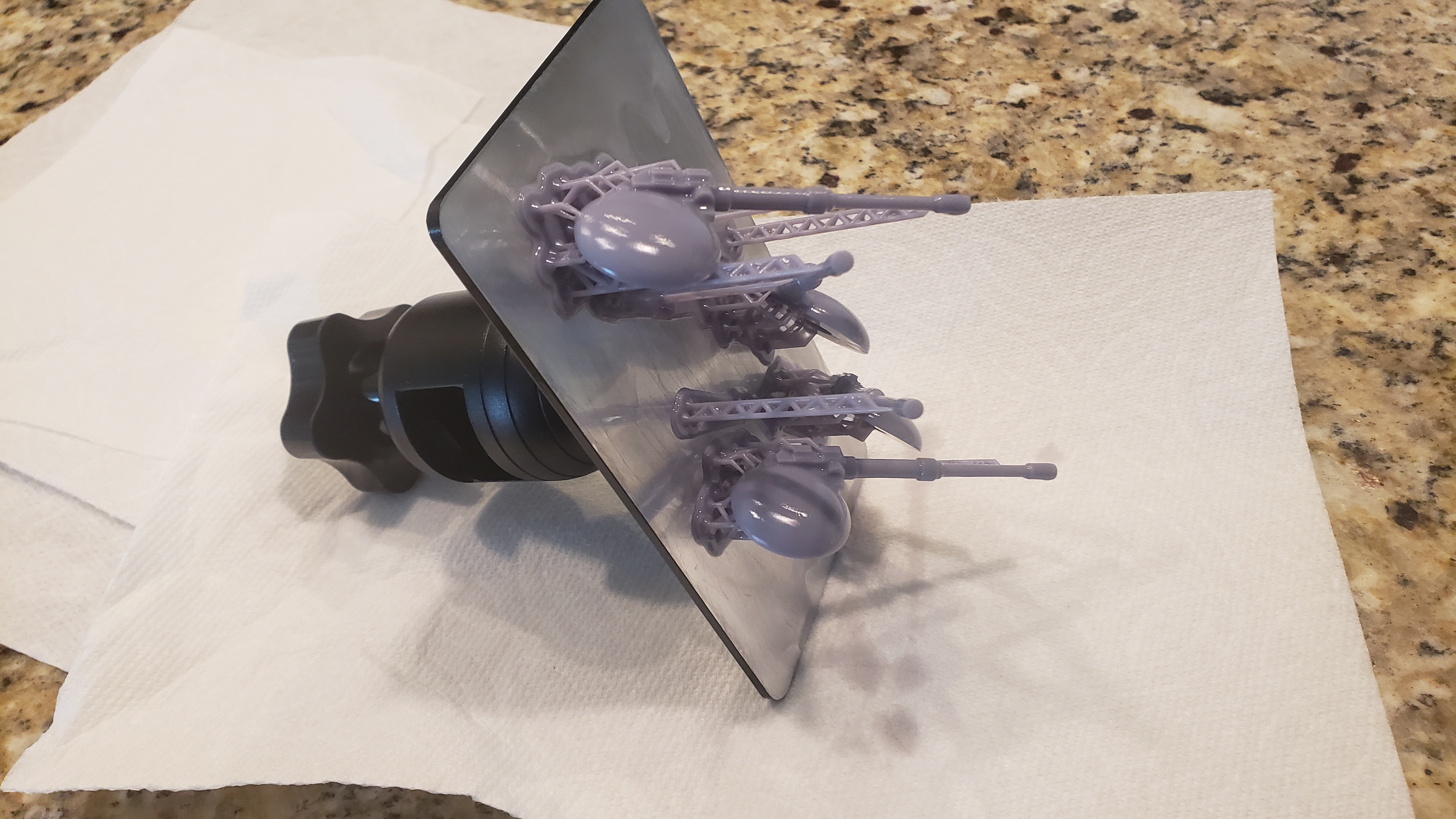

These are among the first things I have ever resin printed and I could not believe how much better they looked when compared to my PLA prints:

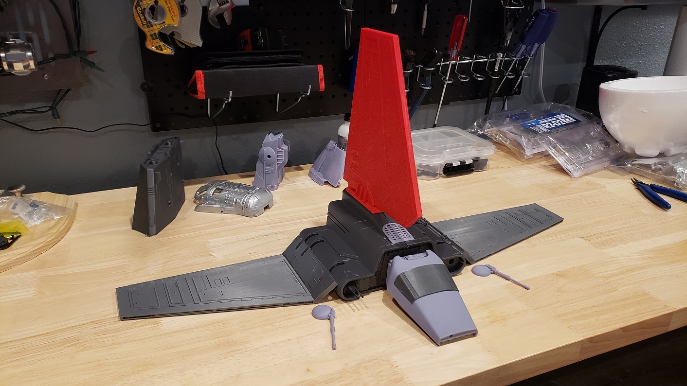

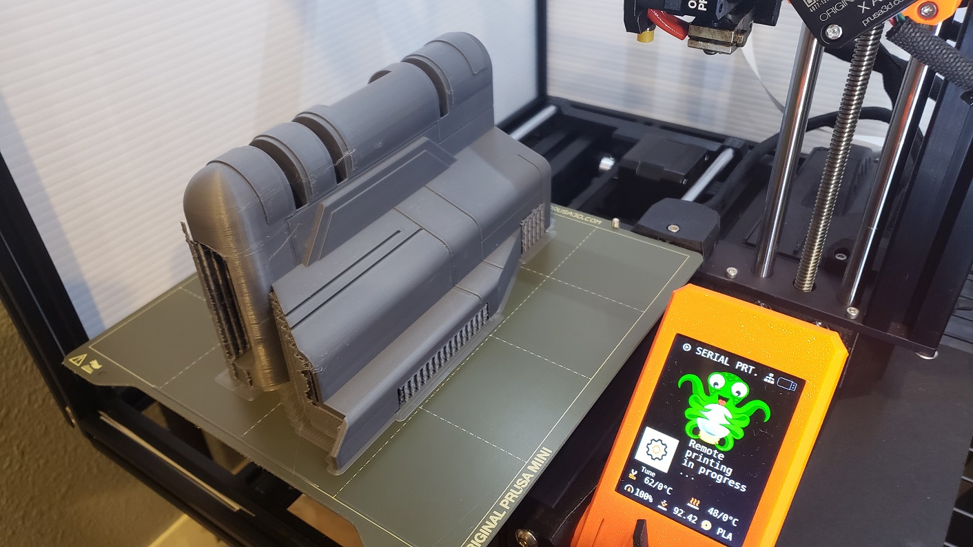

Two of the wings and the front part of the body are done. Even with reducing the size, the top wing is too tall for my Prusa Mini, so I will start printing that part at work tomorrow. I did not really want to reduce the size of the kit any more than absolutely necessary. The printer at my work is an Ultimaker so I will have to do a bit more clean up than usual as it does not print as cleanly as my Mini does, no question.
Half of the main body is done, the other half is about 35% printed. There is not a ton of parts to this kit so I hope to get it done pretty quickly. I am also working on a 1:24 scale B-Wing but that project is kicking my trash a bit so I am taking a small break to work on this and a few others.
The guns look really good. Did you have to do any processing before you prime them?
I wonder whether the PLA parts will take well to styrene paneling? I have been wondering if it would be a good way to hide those printing lines.
Looking good. What scale is it going to be?
TazMan2000
According to the shop I got the files from, it's a 1/70 scale. That is based on info found in Wookiepedia so take that for what it's worth. Actually, if I had known that earlier I probably would have scaled it up just a bit to get 1/72 to line up with a bunch of other models, but as I understand it exact scale in the SW universe is open to a bit of interpretation so at 95% of 1/70 it's close enough for me :)
No, that is straight off the printer, no finishing and since I took off the supports before curing, zero sanding required. That is the beauty of resin for sure :)
I will let you know, I do plan on using some styrene sheets to fill in some of the details. At first, I stated that this would be a super quick build but the more research I have done the more I want to get some of the major detail issues fixed so that is going to take some extra work for sure.

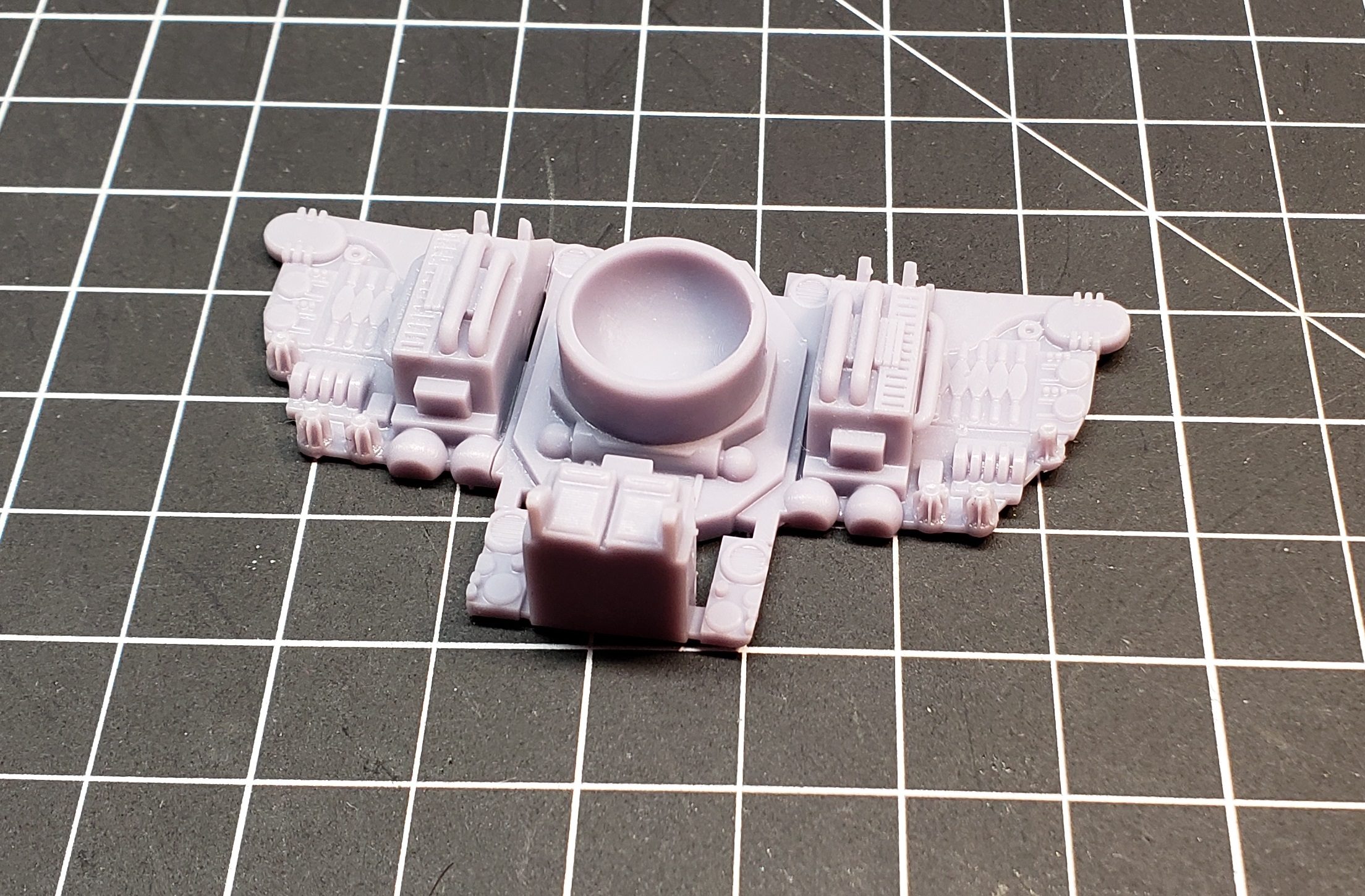

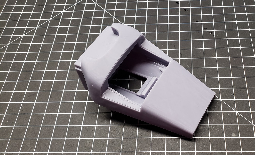

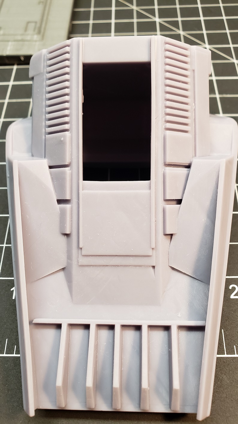

All the major prints are complete. I am just working on a few of the smaller parts on the resin printer and the cockpit. I am still not 100% sure about it and may attempt it in PLA instead of resin. The resin is smooth and looks amazing but it needs a bit of work and I have not been able to re-print it as I think the file has issues. Once it gets to around 25% or so, my printer just stops adding layers. I know it's the part as I have had it fail twice but printed 20 other parts in resin after that.

Have you opened the files in 3d builder and see if they need to be repaired?
I have with the Prusa Slicer, and I have been able to repair it a few times (it takes about 3 to 5 minutes...). But even after the repair, it has issues. I will check out 3D Builder, I have not used that software yet.
