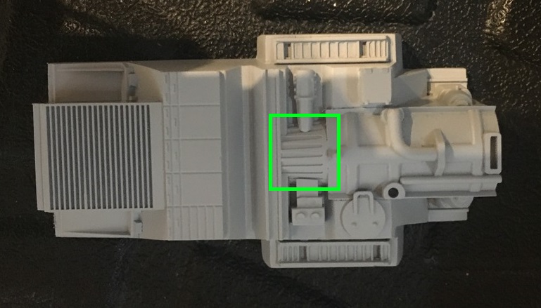

Scott, I never used a pressure pot for casting, only vacuum chamber and that's at work or at my friend's shop.
I dont own one of this setup myself so I never use it for my own project, I don't feel the need to replicate ILM castings (haha), even if they used those setups at least on ROTJ and probably on ESB (but it does not show if they did on ESB, on ROTJ the casting quality has greatly improved).
For the engine plant-on, I did not make the mold like I would have liked (2 parts RTV molds with vents).
The master was very fragile (the thickness of the spots were the parts are glued together is 0.3mm) so I felt more comfortable to glue the whole master on a blank Saturn V can.
I only made one RTV mold to capture te details but no back because I used another blank Saturn V can for the molding process. Of course I used demolding agent so the castings do not bond to the plastic (castings are very delicate and fragile).
This way is not the best way to make casting because I had no vents, resin goes into an enclosed cavity so you can easily have airbubbles (and big ones !) trapped into the mold (see DaveG's thread when he tried to mold the canopy and the scoop without vents, he had that problem :().
It's a bit tricky with to not get airbubbles, the process needs a lot of care and some practice. Fortunatly enough I already made some molds like that in the past so I had no problem to get good result. I pulled 16 castings (more than needed) and I only had one casting with an airbubble in it. TBH it worked better than expected, I was expecting a lot more rejects !

Thanks for the insight regarding your casting methods. I like that idea of using the Saturn V can as the back of the mold!
Re: Y pattern
Only used because I was in a rush and I had to glue the master on something strong, I would not recommand it but regular RTV with vent and pour holes ! :)
