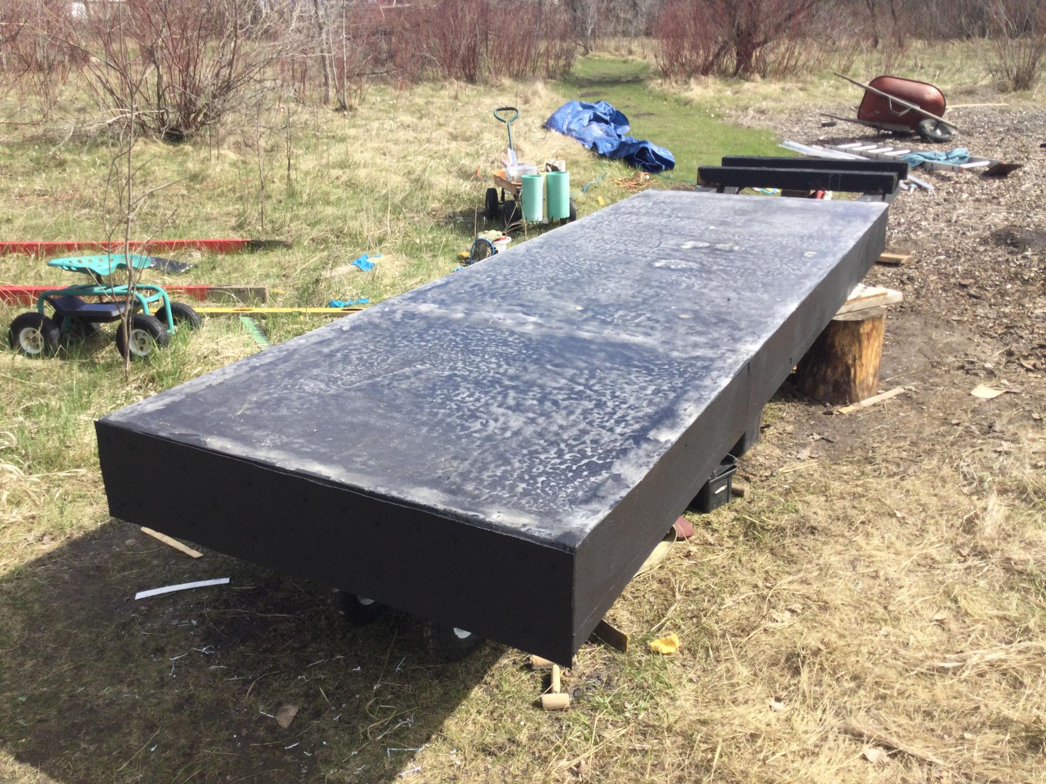

I painted epoxy primer of the sides of the monolith, so they are ready to be coated with epoxy on the next sunny hot day we get.
The only thing left to do is the final coat on the on this side I sanded today .
After that gets its final coat of epoxy I will be all set to drag the whole thing over to the trench I have prepared to receive it and raise it up......(somehow?)

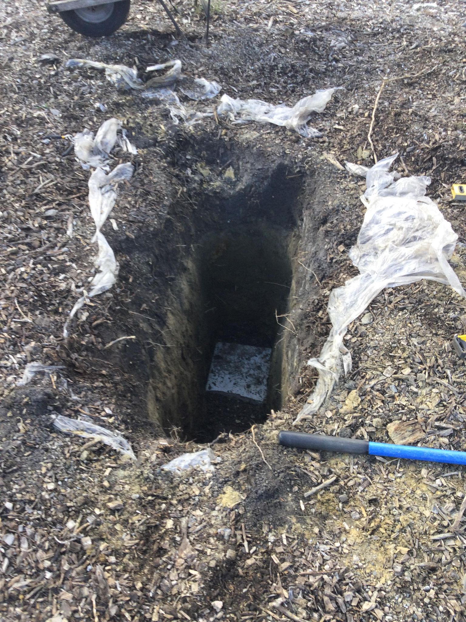

I took the time today and I finished the under ground work in the trench.
I dug down an extra 8 inches, and dumped in pea gravel.
I then found some old paver cement blocks that I dropped down into the trench and then leveled.
With luck they will be where the two legs of the monolith will land when I drop the monolith into the trench and they should help stop the legs from sinking into the ground too much and making it hard to get things level later.
I agree with greenmachines on the paver block and gravel. That will save you a few bags of concrete on the big day! Despite all the rain you've faced lately, I must say you've put in a LOT of effort, and it certainly shows. There's so much enjoyment in watching a build like this come together, and your passion for the project in every post is inspiring! Love it!

Today the rain stopped so I went out to see what things look like now?
I found that the trench that I finished a few days ago was now filled with a foot of water.
While not a great thing to find, I dont think it matters much. I have a lot of pea gravel down there and the cement pavers, .so I may just pump it out when I come to setting the monolith into the trench....

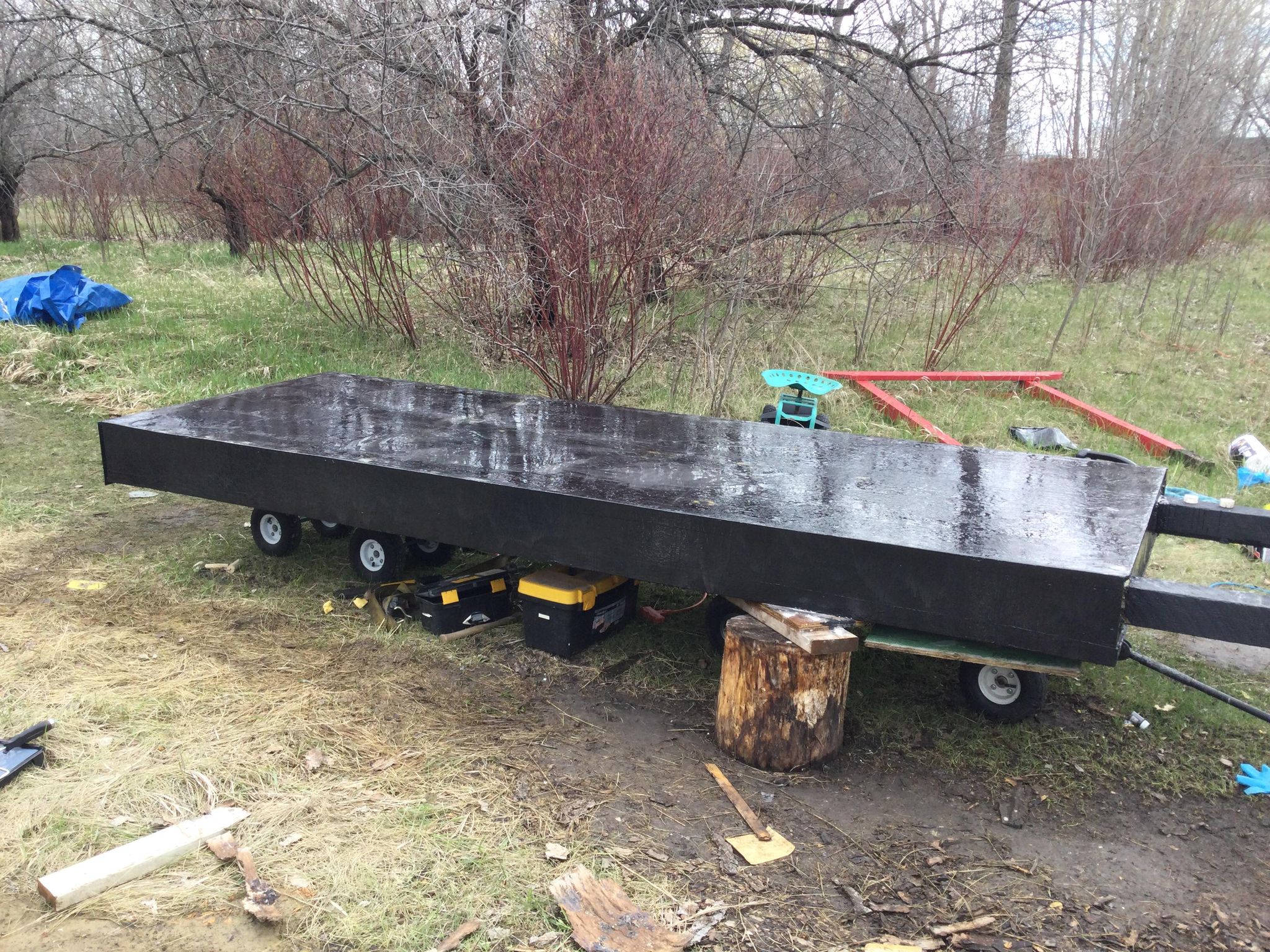

I was able to apply the final coat of epoxy !
This I "think/hope" is the final step before I will begin the work to drag the Monolith over to the trench and try to lift it up and drop it into position.
So today marks the ending of the final "construction" phase of this project...
I think later today once the epoxy is hard I will try to drag everything over to the trench.
All the tires of the two little carts i have things sitting on are all flat...so its going to be a hard pull to be sure for this old man.

The 2nd coat of epoxy will likely take a long time today to get hard due to the cold temps and the lack of sun.
The epoxy coatings will help with the weather, but I really needed them because I have a feeling that dragging the monolith over and into the trench will mean a lot of rubbing on the ground..and so I hope the epoxy will help protect it from scratches.,
Once it is all cemented into the upright position, I will sand everything, and then hit it with some primer paint, and then about 5 to 7 layers of an outdoor house paint.
Then,,,,I may try to paint them stars that I posted on a few days ago...

But the original plan I was attempting to do yesterday when I was working on the trench is to have the monolith sitting so that the bottom is several inches above the ground level.
I was thinking I can always raise the ground up around the monolith if the monolith looks a few inches too high...

Having the monolith sitting a little high would be a good thing for rain draining. You can build up the area around it with pea gravel so rain water drains away from the big boy.
