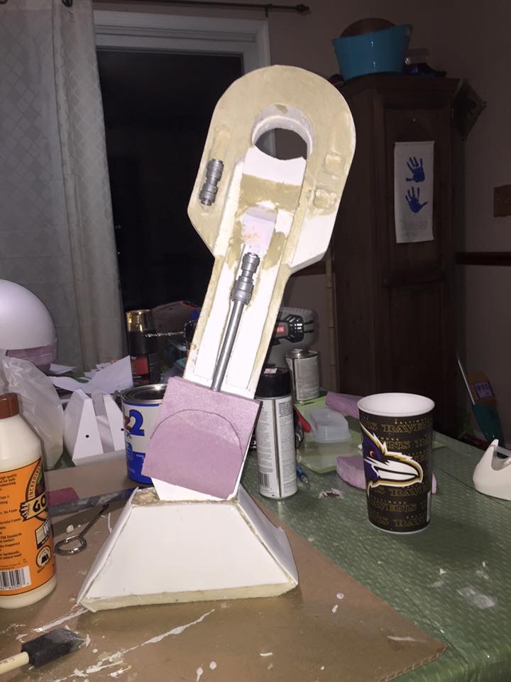

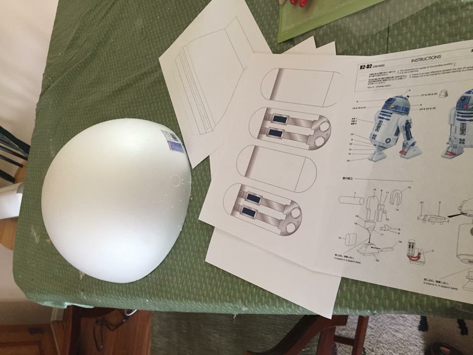

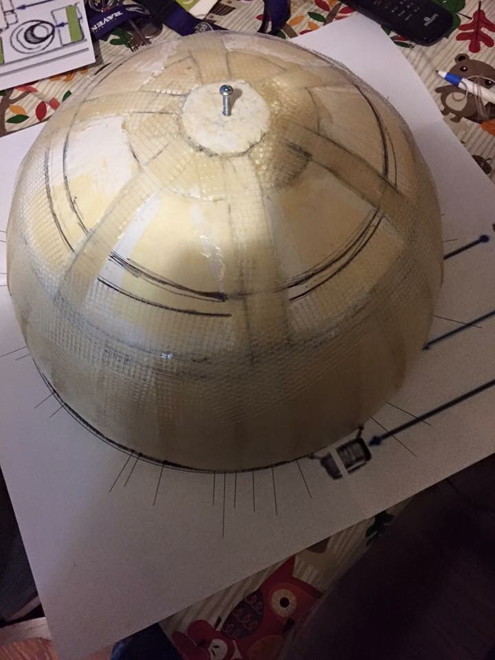

After messing around a bit with Pepakura, fiberglassing, etc. I felt like it was time to start. I ran into quite a few headaches and lessons learned along the way thus far. I essentially took a pepakura paper craft R2 and the blueprints from astromach builders forum and rescaled both sets. This allows me to choose what medium I want to work with given the particular part I'm currently working on rather than doing what most people on the astromech forum do...which is either mdf, aluminum or styrene..not so much of a mix. As you c toan see..my initial plan trying to keep things light I decided to mix expansion foam and paper craft together keeping him as light as possible. Making paper feet and then using the expansion foam to solidify it...followed by making a mold of the foot to reproduce another foam one. Was all going well and the legs I was pretty happy with to an extent too... up till the sad day that I tried to use resin to solidify the foam.... after multiple coats of latex paint and gesso, and they still melted into goop. Was an upsetting day.

So after everything more or less melted with exception to the foam dome and my foam feet, I started looking at other possible options to use instead of the insulation foam. Lucky again, I work at a sign company. Come the end of the year they were pitching all kinds of scraps and it was a treasure trove of materials that I started collecting to bring home and use. The owners even started loading my car up with the extras if I showed the least bit of interest. That said, I got tons of scrap HDU sign foam, 2mil - 10mil pvc pieces, etc. Not to mention my boss told me to go ahead and use the cnc router for anything I wanted to use it for. I've somewhat veered away doing that as I wanted to do as much myself as possible on this project, however, there have been times where that accuracy vs. my steady hand using a saw, has definitely came in helpful. Several parts I tried cutting numerous times with parts being usable but less then desirable looking.
So here is what I've got thus far and have also moved on from cracking open my interactive R2. I decided I wanted to keep him as is..too many memories. That said, I'm looking into possibly using the ezrobot platform to make him autonomous instead. The audrino and raspberry PI boards had also crossed my mind but I'm far from a programming guru. Baby steps getting there as I need an r2 before I have to program anything...

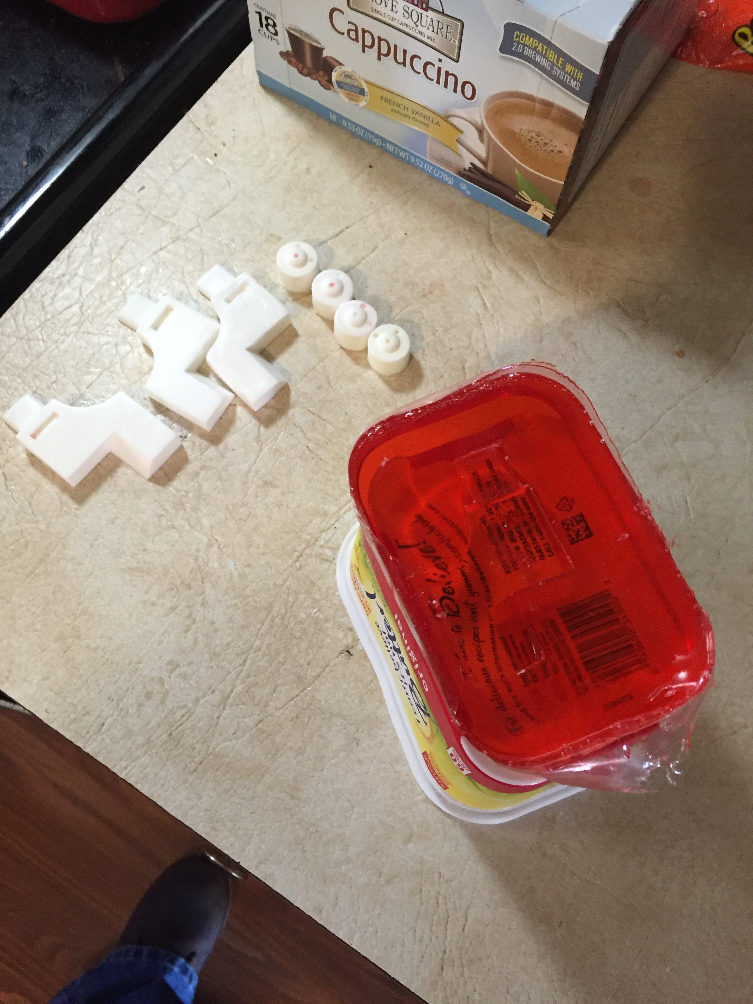

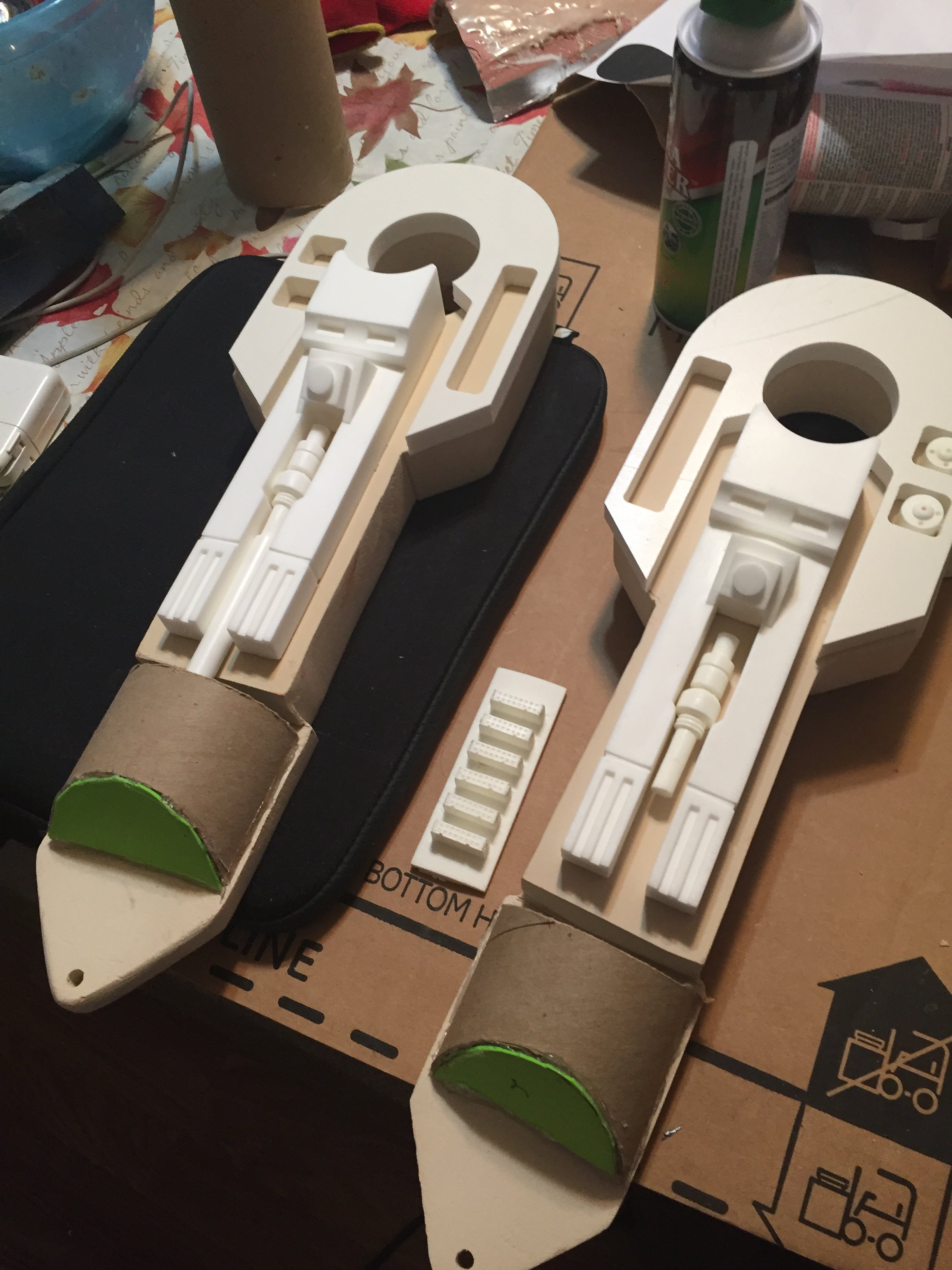

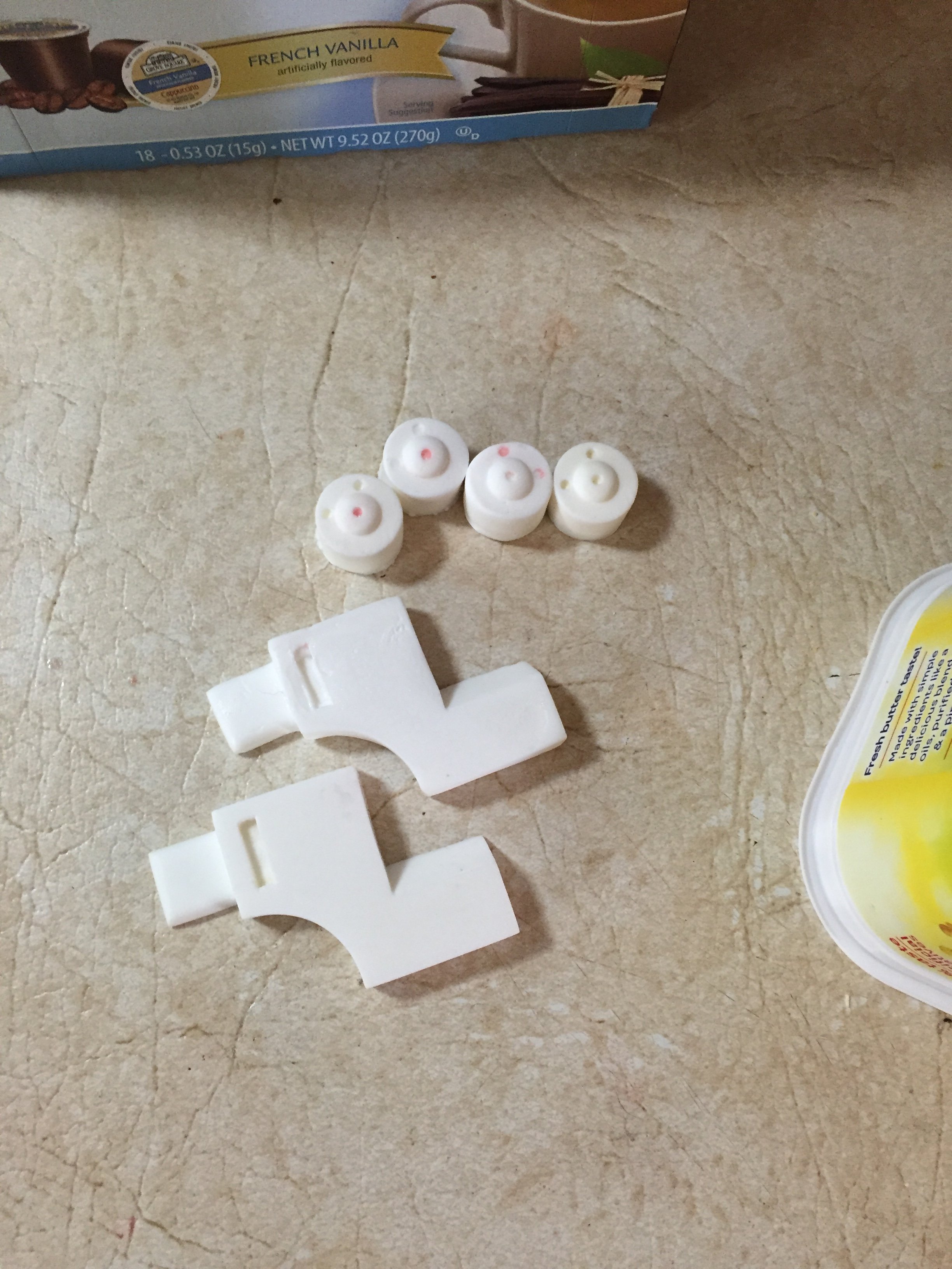

and I broke down and bought a few parts from smuggler.... was a bit worried about parts not fitting even though we both "claimed" to be doing 2:3 scale I never really had much luck nailing scales, etc..... this time everything seemed to be working pretty smoothly however with only a few parts slightly off.

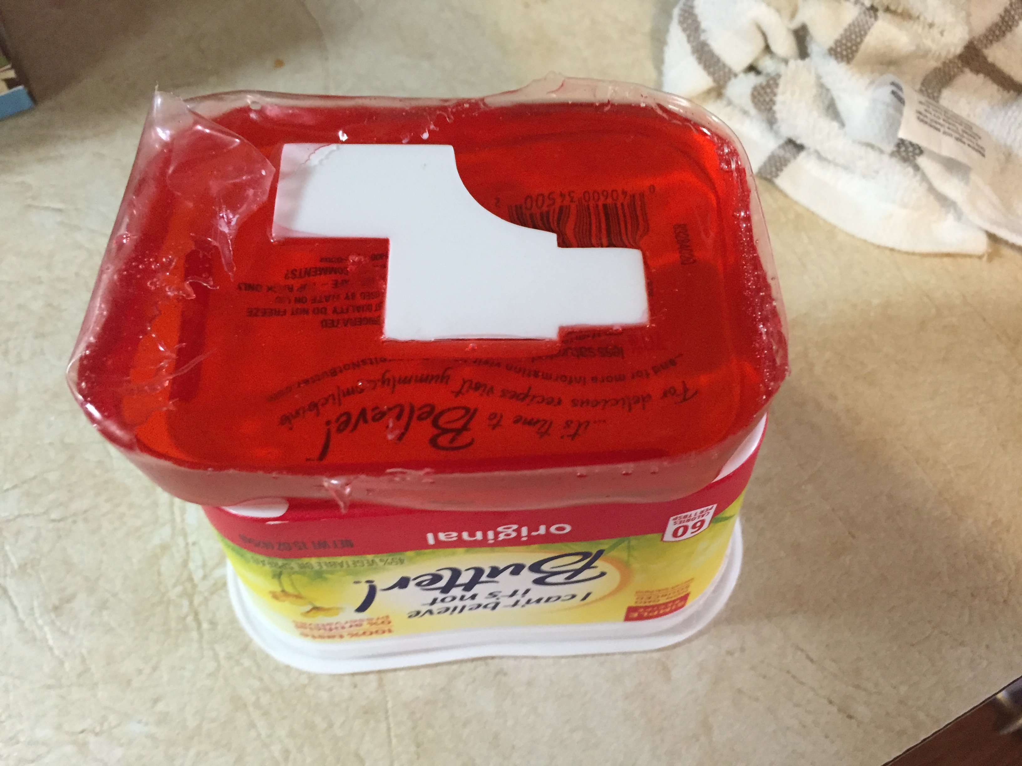

He was nice enough to throw in a few extras with the few parts I ordered too. However, in order to complete those parts I needed to replicate them. I hate using home depot silicone cause the smell makes me sick. Tried it several times as shown above..and it just made me feel worse with each go. Smooth - On silicone is a really nice option, but still a bit pricey. And I kept looking all over wondering why no one has made a mold compound that can be reusable....well, apparently they did! This stuff ROCKS! Not the cheapest stuff, but far cheaper in the long run than any other option I've come across.
Photo Jan 02, 1 42 17 PM.jpgPhoto Jan 02, 1 35 36 PM.jpgPhoto Jan 02, 1 35 33 PM.jpgPhoto Jan 02, 1 27 20 PM.jpgPhoto Jan 02, 8 10 11 PM.jpg

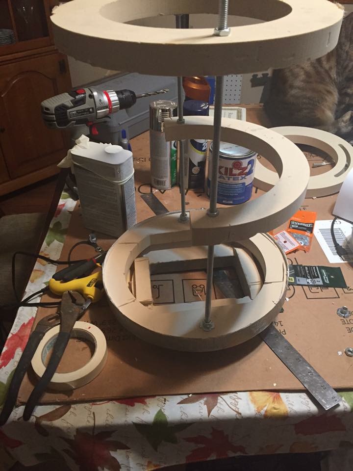

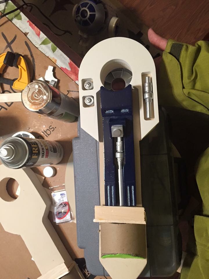

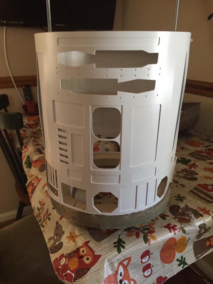

Still a long way to go but here are a few updated pics. I ended up redoing the body skirt cause some of my casted parts bought and made, weren't fitting. Also wanted to make it so I could get inside so I added the threaded rods.image.jpegimage.jpegimage.jpegimage.jpeg
