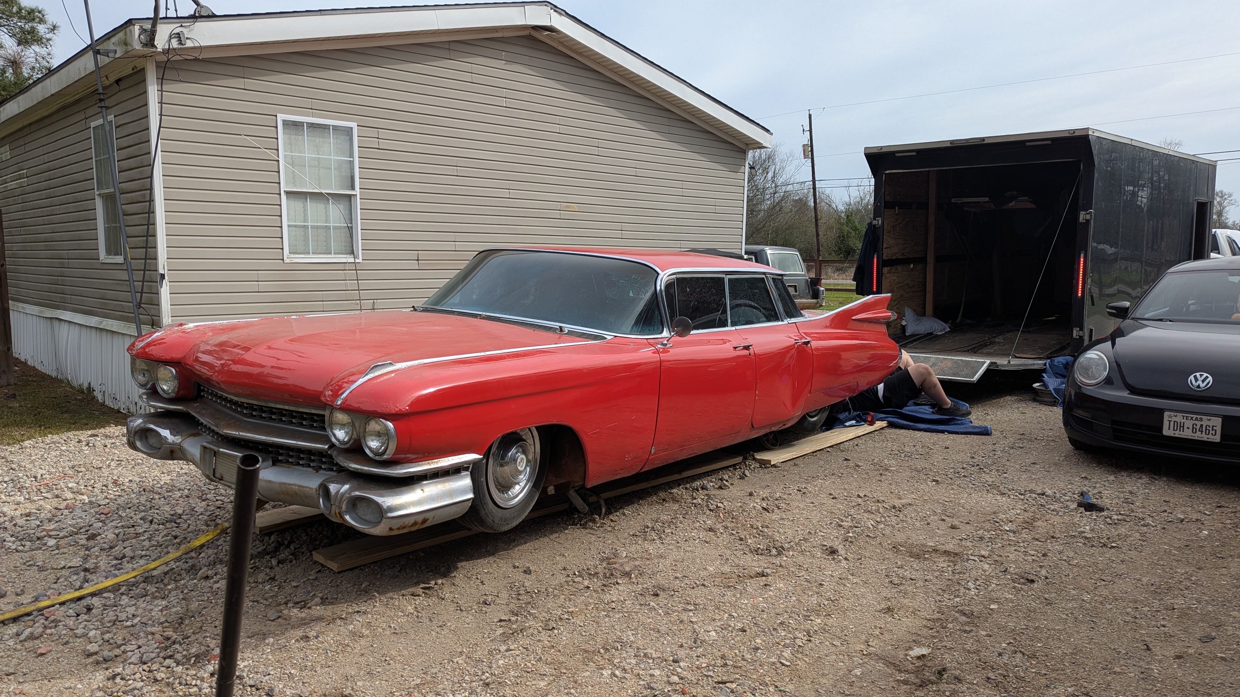

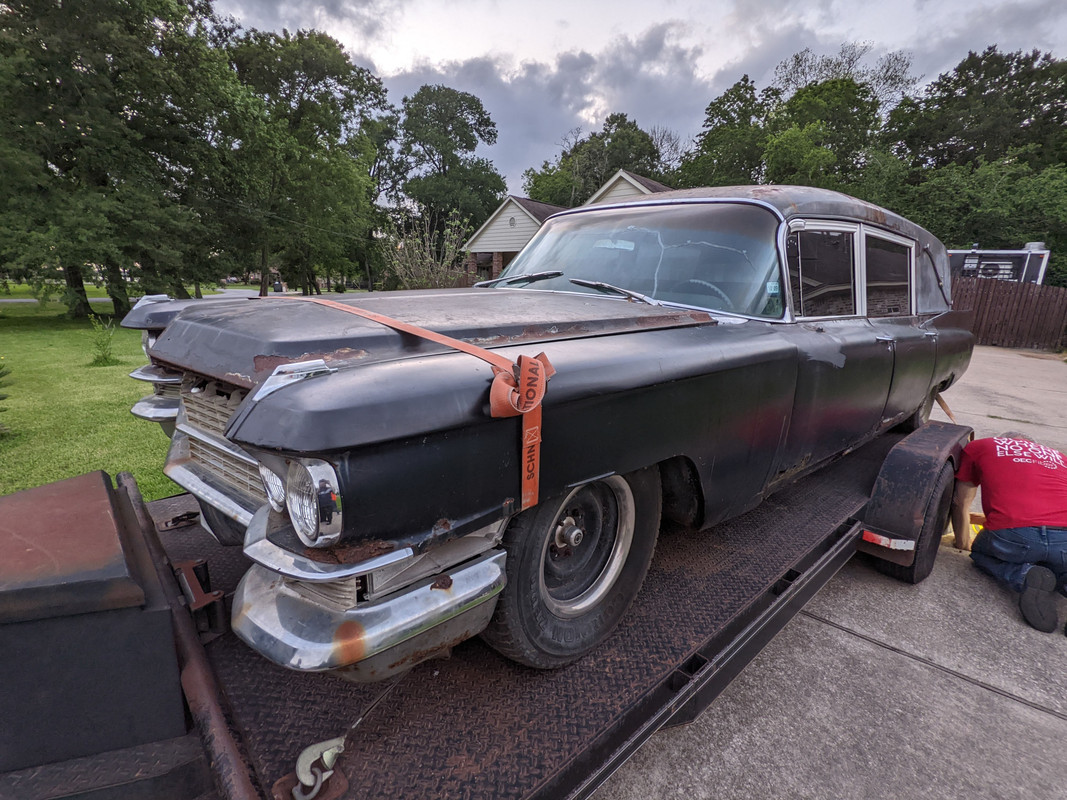

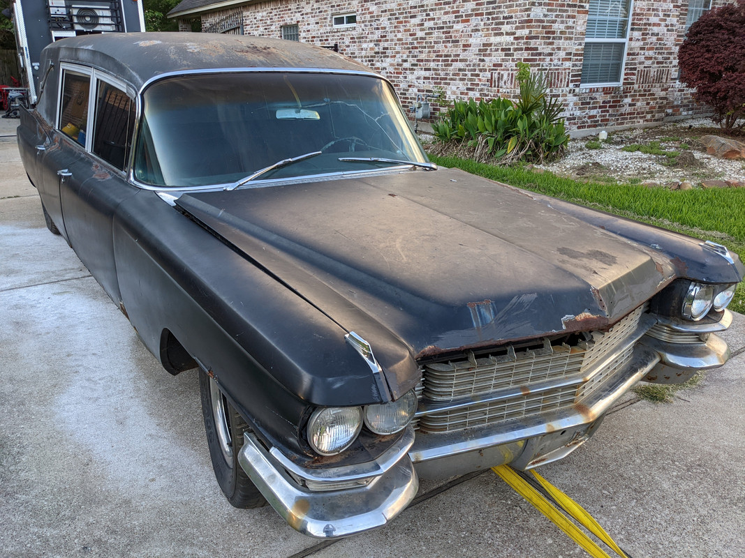

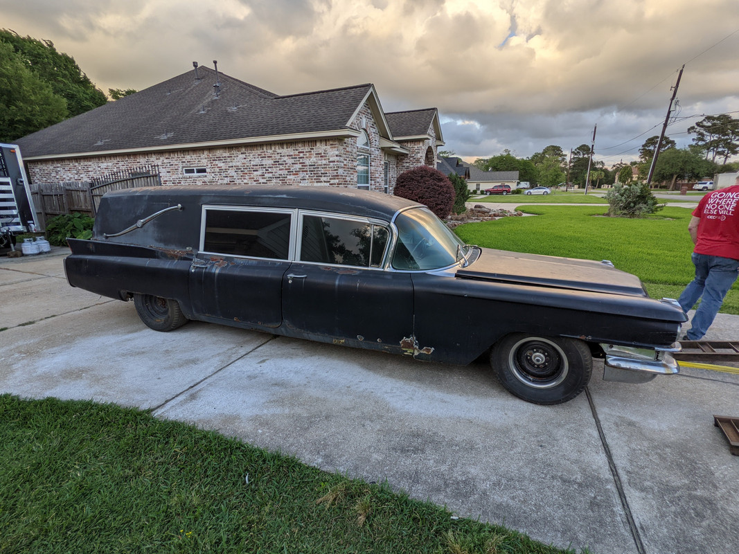

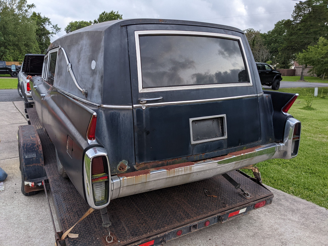

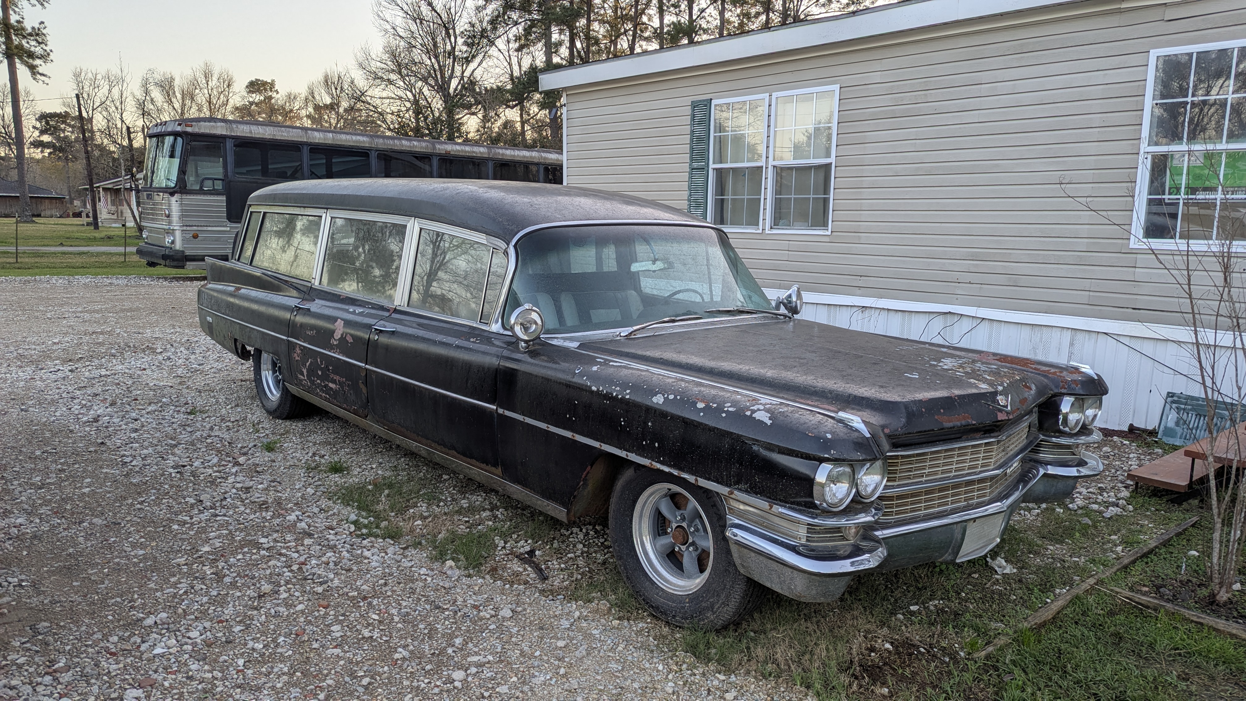

I should probably stay off Facebook Marketplace for a while. I was thumbing through some listings and stumbled across a Cadillac hearse and thought, hmm, that would make a fun Ecto-1 tribute vehicle. I sent the listing to my dad and told him to talk me out of it (he didn't). We sent it to a family friend who specializes in car restorations and told him to talk us out of it (he brought his trailer over). So, after a fast and furious trip down to Houston and back, I'm now the proud owner of a 1963 Miller-Meteor Duplex.

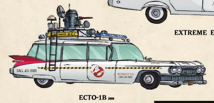

The 63 still has many of the design cues from the 59 used in the films but has the added benefit of being easier on the wallet (well, as much as a 59-year-old project car can be). I briefly kicked around the idea of transplanting fins off a donor 59 Caddy but I really like the smaller, sharper fins that are on there. I also won't feel the need to track down all the hard-to-find screen accurate bits since this is a tribute; I'm approaching with the mindset of business is booming and the boys in grey need some additional support vehicles for other franchises and are using what they can find with minimal modifications to existing equipment. I think my end goal will be something similar to the Ecto-1B from the 2009 video game - the majority based off the Ecto-1 with a few graphics cues from the Ecto-1A and the addition of the slammer trap in the roof rack.

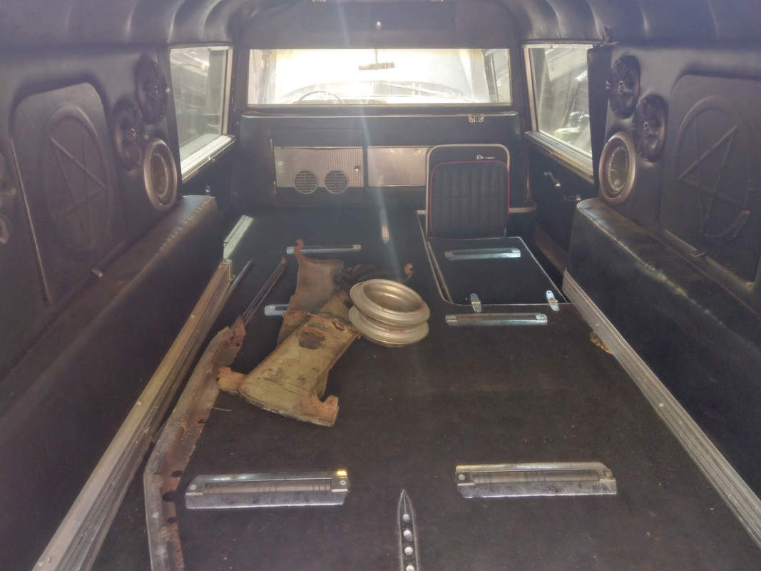

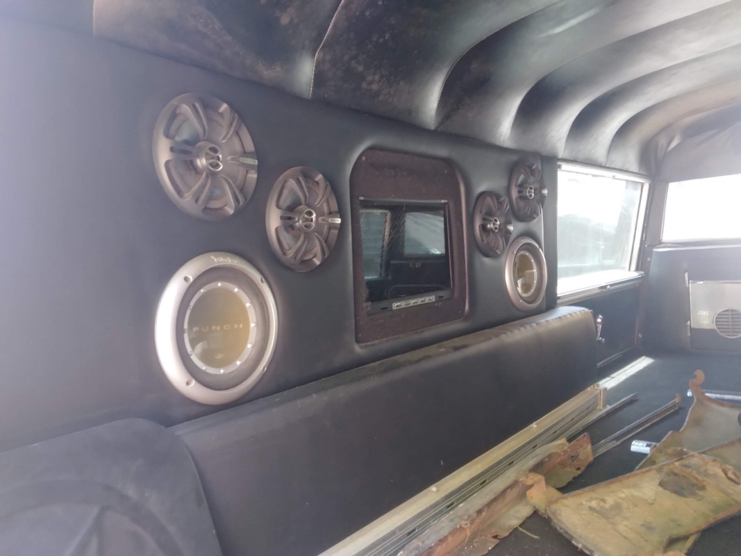

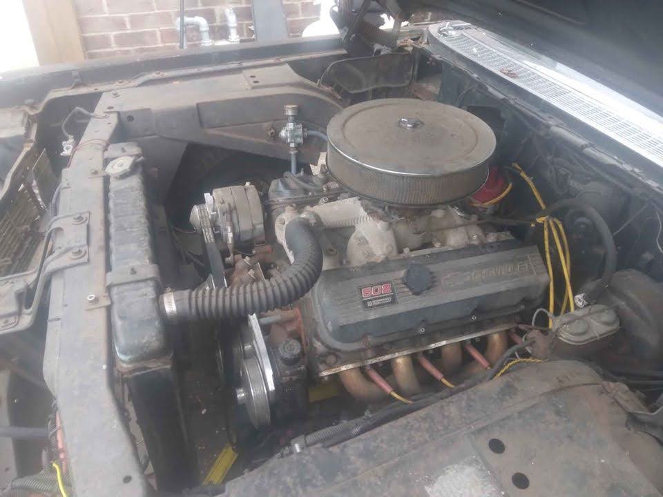

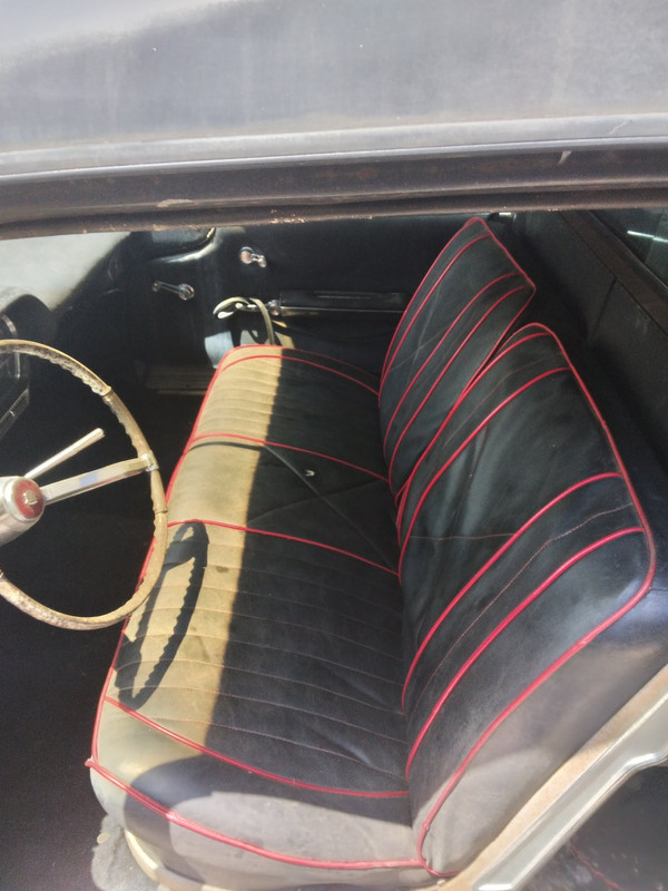

The vehicle has had a number of modifications done to it over the years. The interior had been somewhat redone, a sound system and monitors added in the back, original air conditioner removed, air suspension added, fuel tank replaced with a custom aluminum one, front end suspension/steering/etc replaced with a Ford (and disc brakes) and the engine swapped with a crate zz502. Rodents had chewed away most of the wiring under the hood and it supposedly hadn't run for around 10 years or so.
The next steps are to get the engine running again and go through the cooling and braking system to get it roadworthy. Then it's on to stripping off all the chrome parts to have them re-chromed and my body guy can start working on the sheet metal. I still need to source a replacement hood (the lip at the front has rotted out enough to where there's no way to latch the hood closed or attach the upper grill piece) and maybe a trim piece for the bottom of the rear driver-side door window (might be able to fabricate one from another trim piece I'll probably delete from the back). I'd also like to add in the rear windows but the odds of me finding the correct trim are very slim. This will be a very slow moving project due to the scale and financial requirements (classic car restoration + movie modification, plus the Jurassic Park Explorer conversions that are underway) but I'm super excited to see it take shape.

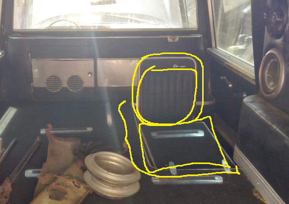

Is there any chance I could bother you for the dimensions of your jump seats and its cutout? Mine did'nt come with it and I'm going to try to fabricate myself. I just need the correct measurements.
Sorry, I fell off the face of the planet for a bit. Do you still need these dimensions? I can grab them next time I'm out working on the car.

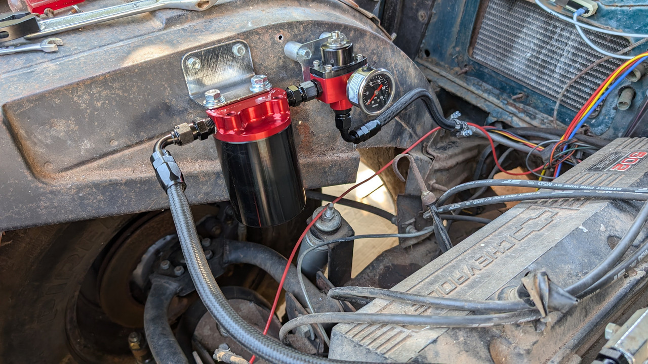

What have I accomplished in the last two-and-a-half years, you may ask? Not much that is visible. I've stripped down the interior of the back end, removed a bunch of dodgy wiring (will re-wire the entire vehicle, don't want to take any chances with 61 year old wiring or the dangerous wiring installed by whomever did the stereo), did a brake job on the rear brakes, installed a new master cylinder, new fuel pump (with filters and pressure regulator), new distributor and carburetor, redid the whole power steering system and added a compressor for the new air conditioning kit. Also discovered that the engine was false-badged; it's actually a 396 instead of a 502. I've found some nice valve covers with Cadillac script on them that should make for nice replacements.
I'm able to successfully start it now and have moved it around the driveway a bit. This car feels ridiculously huge, which is funny because it's roughly the same length as my Dad's truck and weighs about the same as our Excursion. Up next is a trip to the muffler shop and then on to my body guy. He'll spruce up and dress the engine bay while he has it.
I still have a huge list of parts to order just for the car but have been picking up some Ghostbusters conversion-specific items as I go. I'll have to find some alternatives to the Federal Signal C5GB siren and the Propello Ray, those suckers are going for crazy money.
I'll need to order the rest of the air conditioning system, a new alternator and a better electric fan kit for the next round of wrenching. Would probably be a good idea to go ahead and replace the valve covers with the ones I want while I still have easy access to everything.

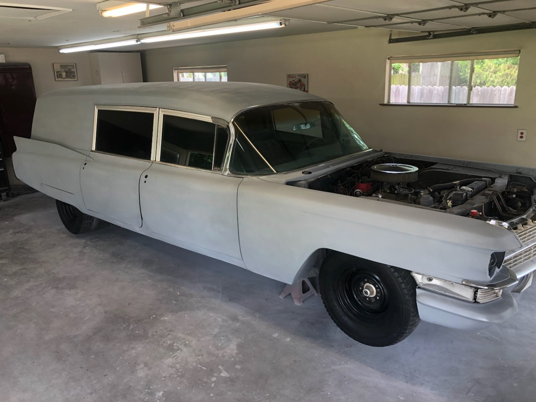

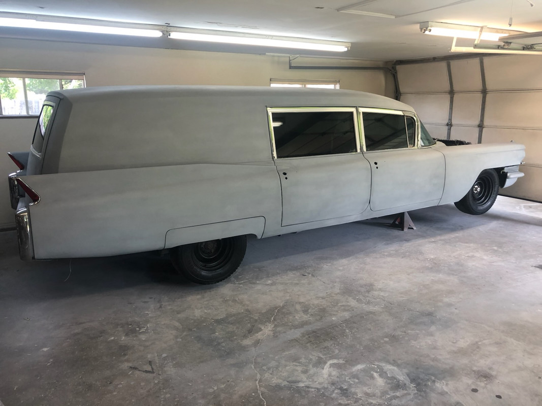

The initial body work is just about finished. There's still some splicing to do on the hood (63 and 64 commercial chassis and limos use a different hood length from the sedans) and I need to get the hood hinges rebuilt. The air conditioning system has been installed and most of the muffler system is done (just need to re-work the tail pipes a bit).
I found it interesting that the build plate listed the car as a Duplex despite not having the rear quarter glass. There was even a rear air conditioning system present. After pulling a bunch of the interior out it looks like some plates had been welded over where the windows went. I don't think it was done at the factory as the metal was quite different, the welds looked positively awful and the outside body work was so poor you could still see the outline of the window cutout. I've been unable to track down the window trim to put the rear quarter glass back in so I plan to use a decal to simulate a window until I can get the parts to splice it in later.
I should have the car back by the end of next week and will start in on stripping out all the wiring and replace with a new wiring harness and fuse panel. I'll also replace the gauge cluster with a new one from Dakota Digital that will retain the vintage styling but offer the gauges I need for the engine. Then it's onward to paint!
