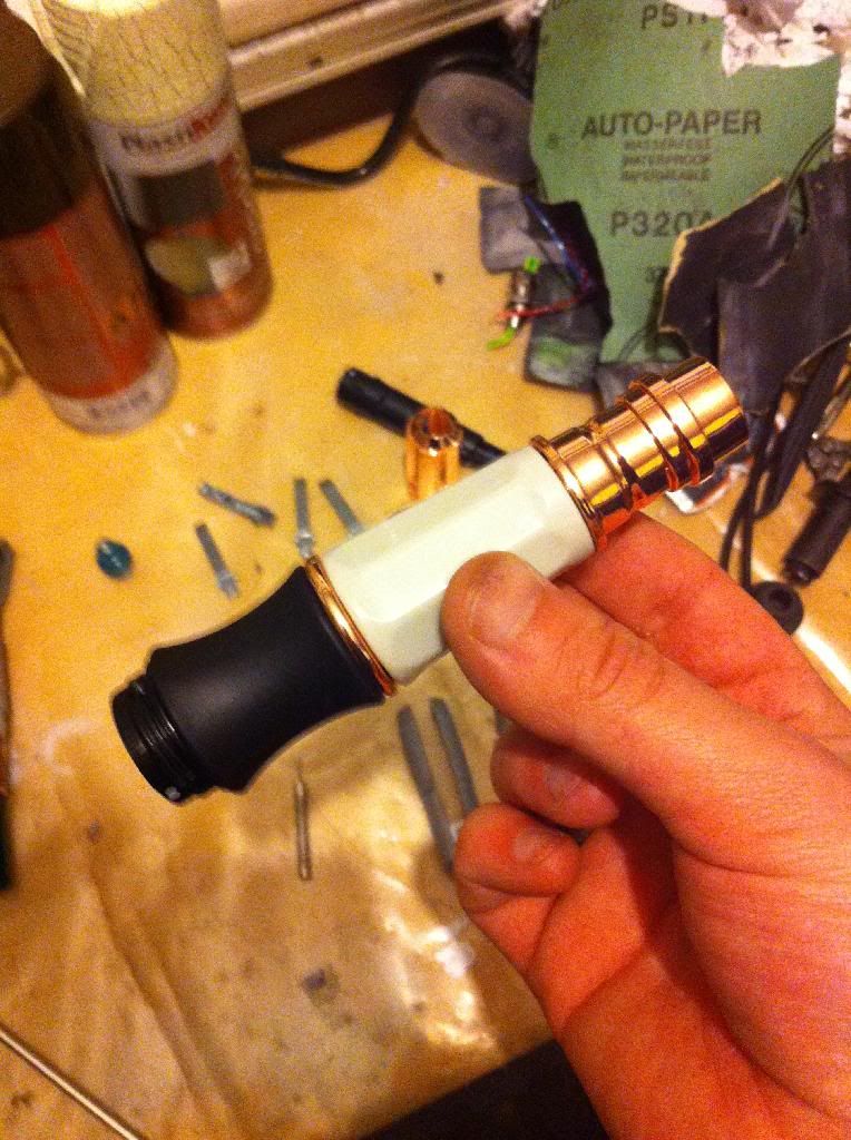

Im in the process of changing my wand company sonic to an extendable version eith CO electronics but have hit a wall , i cant for the life of me work out how to seperate these sections :
Can anyone help please ?

will havoffo pry off the copper end cap. Stick a screwdriver between the end cap and the white handle and pry it off. After you get the End cap off the white handle should slide off. They sometimes glue it on so it may take some force to get it loose.
Thank you that makes sense now :) Il give that a go tonight.

Agentsmith350 If its glued i would suggest to point a hairdryer onto and into the the part for a minute or so before trying to take it apart. company's sometimes use hotglue to glue things together and the heat will make it lose...don't use a Heat gun.
@Agentsmith350 If its glued i would suggest to point a hairdryer onto and into the the part for a minute or so before trying to take it apart. company's sometimes use hotglue to glue things together and the heat will make it lose...don't use a Heat gun.
Thanks , I feel a lot more confident now I have you guys tips

FYI if you end up needing a new white handle drop me a line. I have a few spares. TWC uses some form of super glue which can be a pain to deal with. Though only 1 in 3 I work with have had glue on the handle. If you need ideas on spring loading the claws, my build thread has pictures of the mechanism I use .

Iv ordered a pack of LED's to try , cut the hande off in the end was expecting to reveal a way to remove the insides of the handle but cant see how , do you just hack/drill the insides out ? Need to make some room for the CO bit
What exactly did you end up using to clear out the inside of the base?
