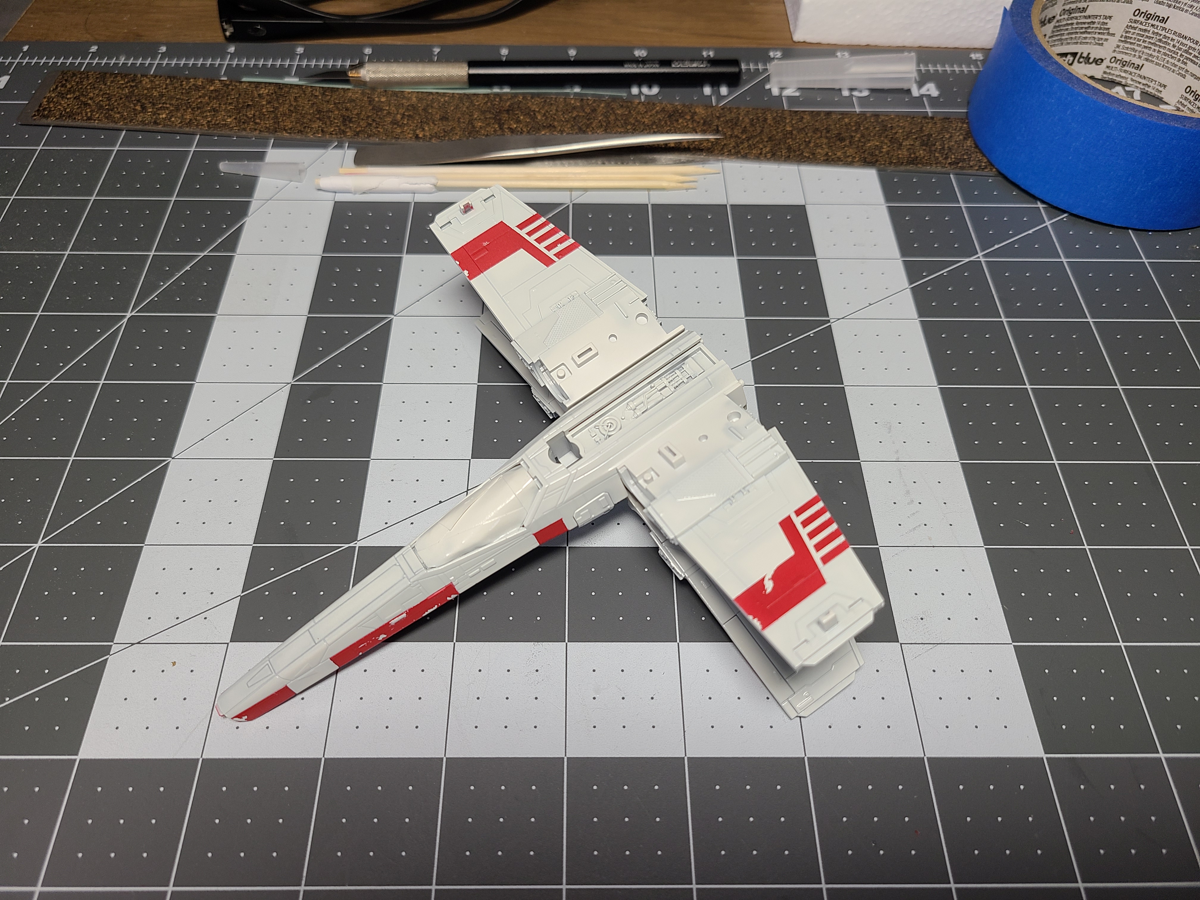

I picked up the Rogue One 1/72 and 1/144 X-Wing set and am building both as Red 5. I've got the small one based out in Mr. Color Off White (C-69) over a black undercoat. It's seems like it's slightly more neutral than Archive X Reefer White or Tamiya Insigna white, but after weathering I think it will be a good color (plus it seems to me like the film shifted everything considerably towards a cooler color temperature anyway).

1/144 after base color coat:
Upper hull, pic is slightly out of focus :(

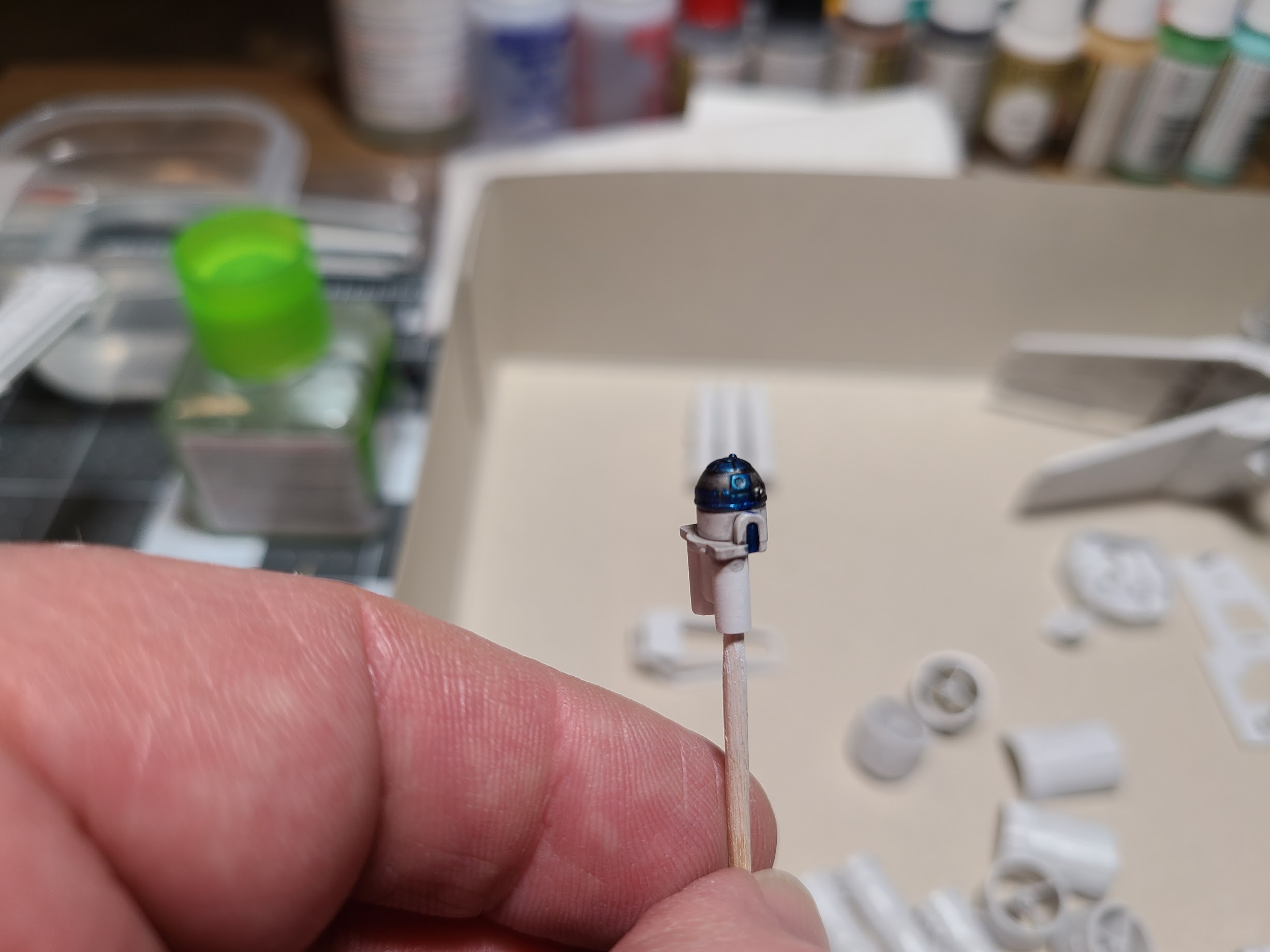

R2, that stabilizer's broken loose again...
I need to dry brush the silver and metallic blue to brighten him back up.

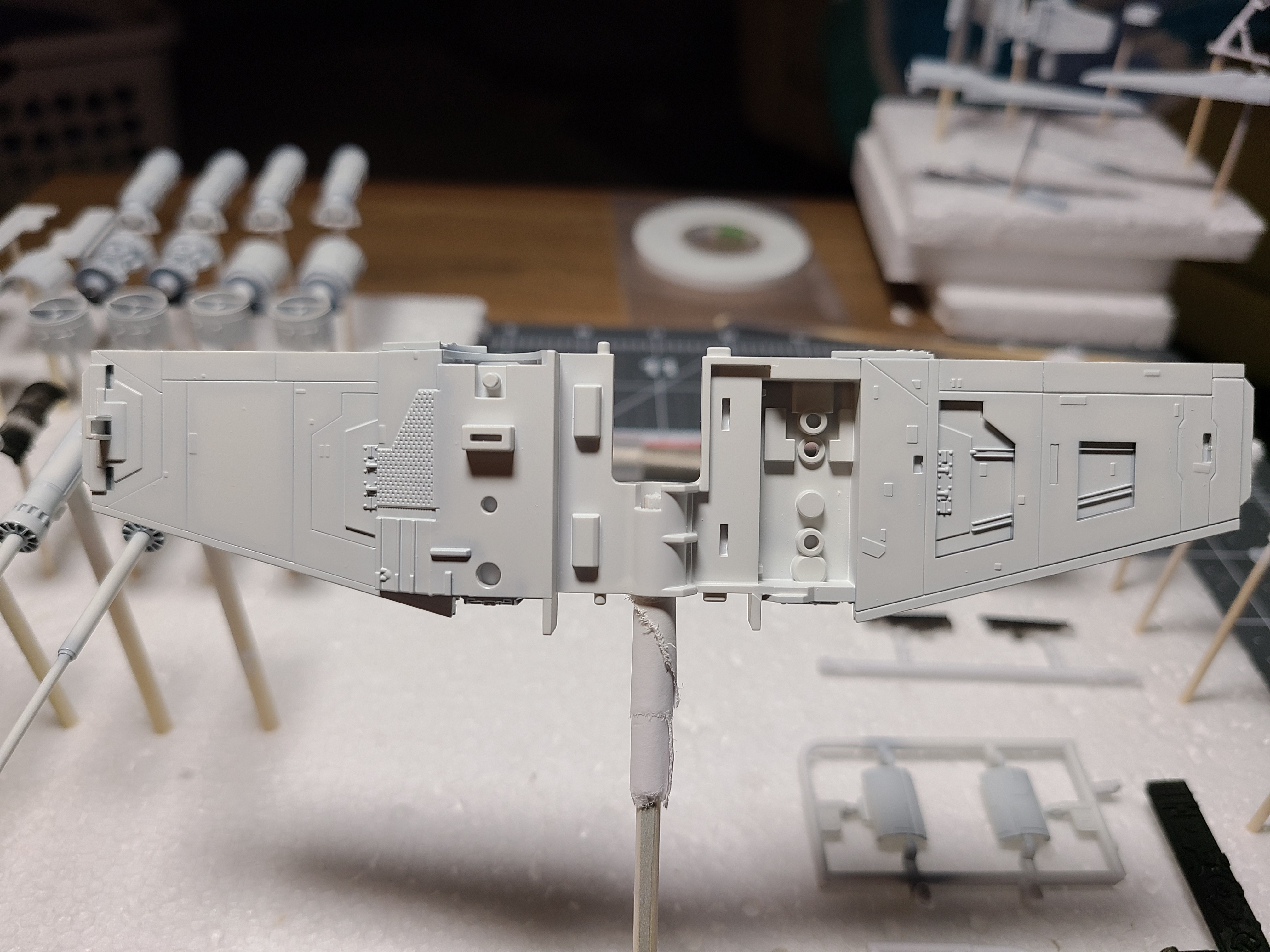

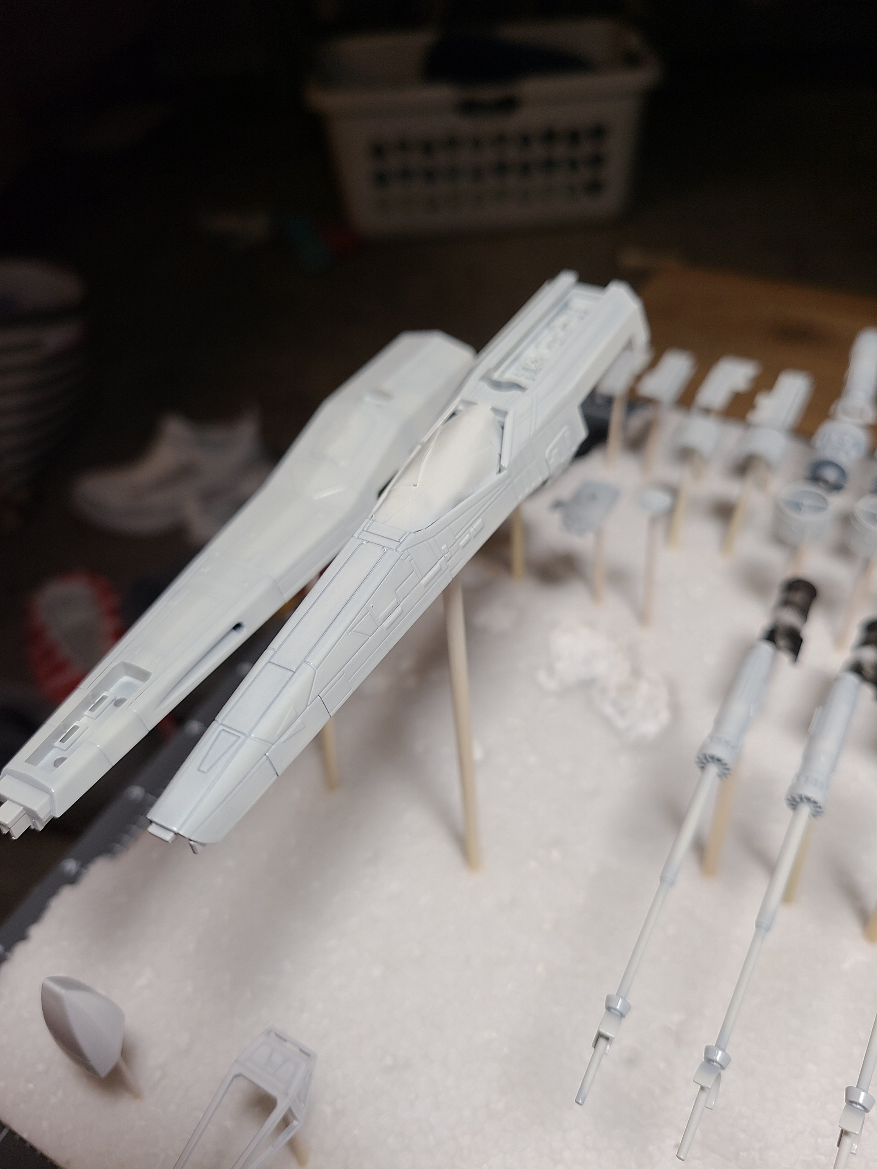

All of the subassemblies glued where applicable, sanded, and ready for paint. I left a few parts on the sprues where the gates won't be seen.
Upper hull after two coats of primer. I'm debating on whether to give it one more or not to kill the remaining touch of red plastic.

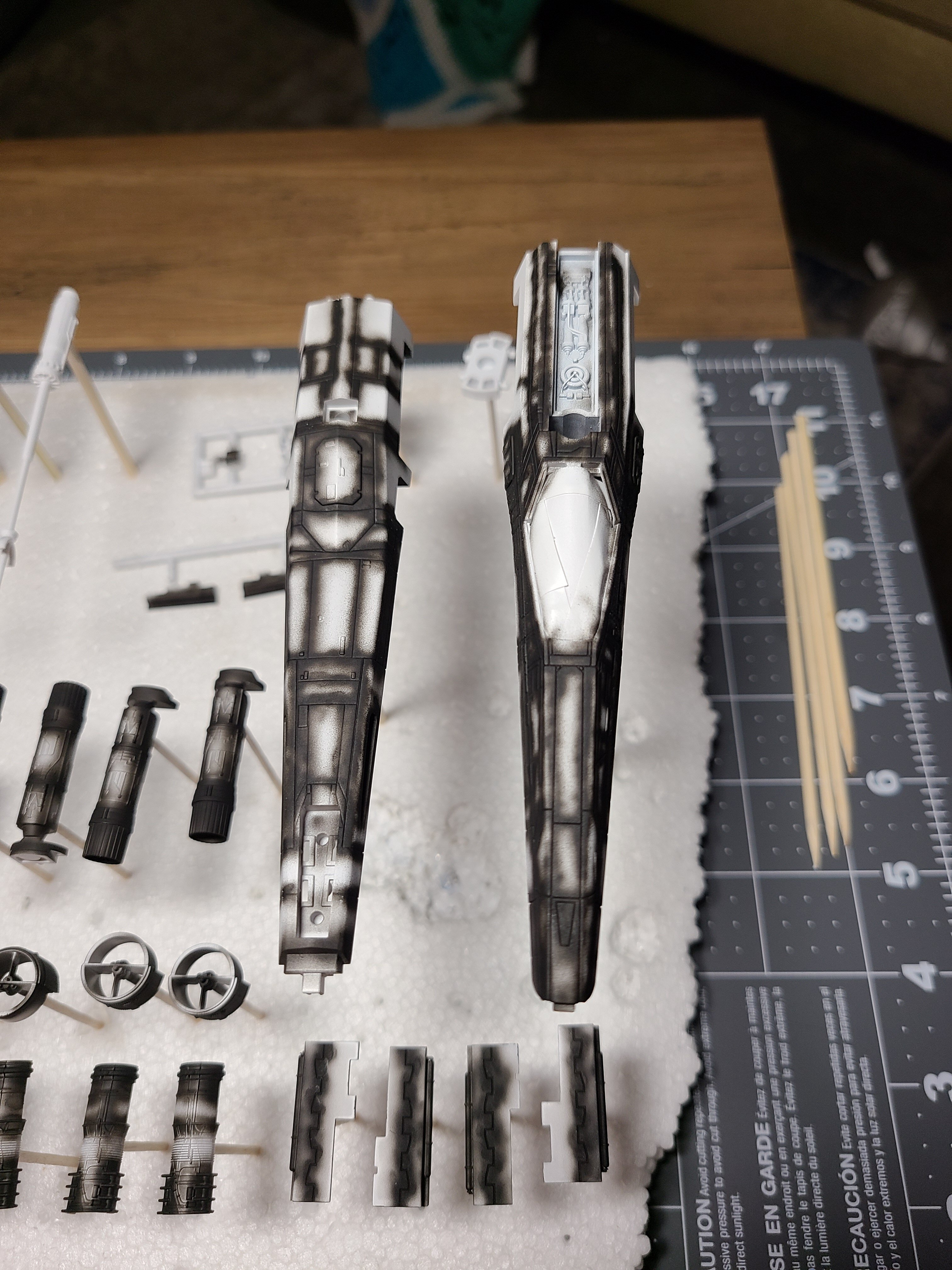

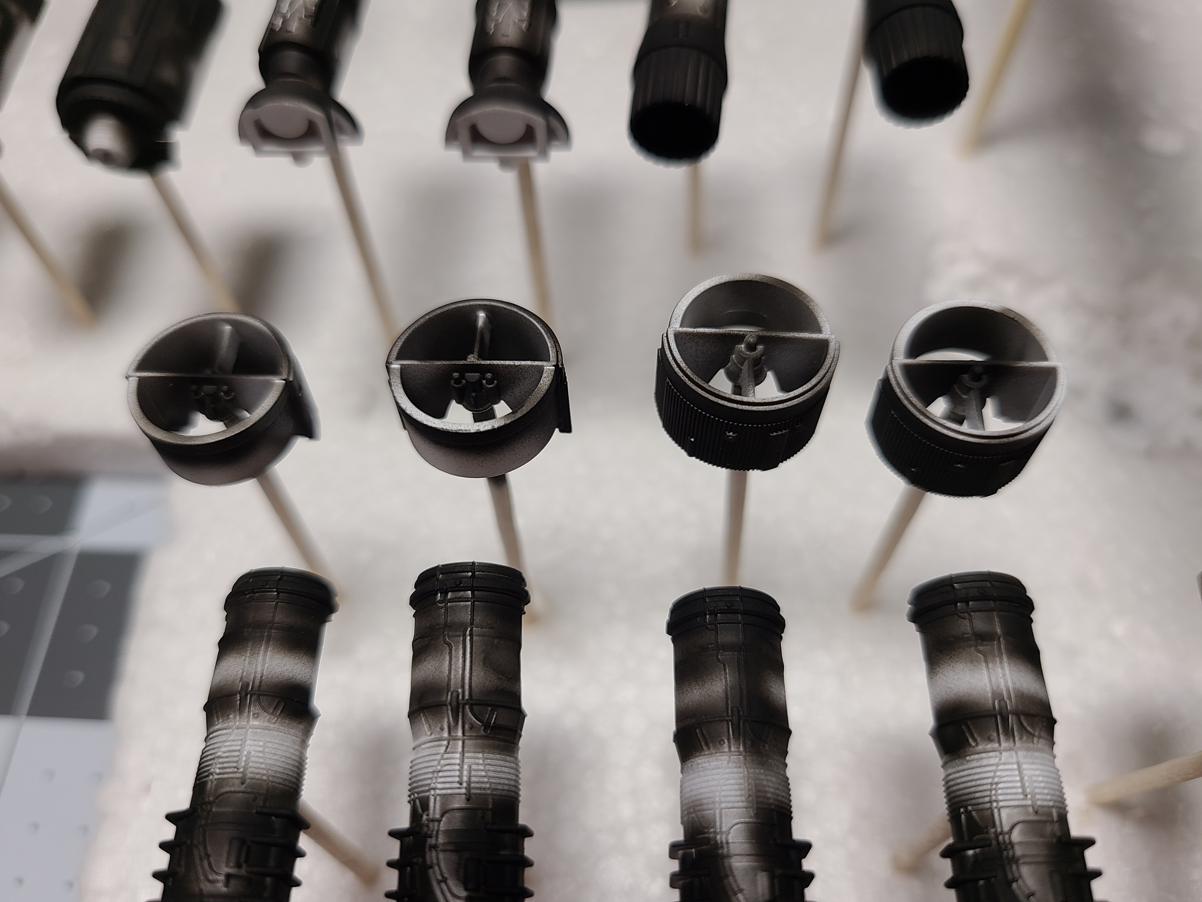

More progress from tonight. I spent two hours on the airbrush and got a big chunk of black sprayed for the preshading.
I think it's not bad for my first time, there's lots of room for improvent, but fairly happy so far. The proof will come when I gey the base color on.
I started on the less important bits and worked my way up to the fuselage halves. I still have to do the wings and laser canons tomorrow. I also had a little oops and splashed some thinner on the canopy frame and nose cone when I was cleaning out my airbrush. I'll have to wipe them down, sand if necessary and repaint them.
Fuselage halves:
Engine bits:

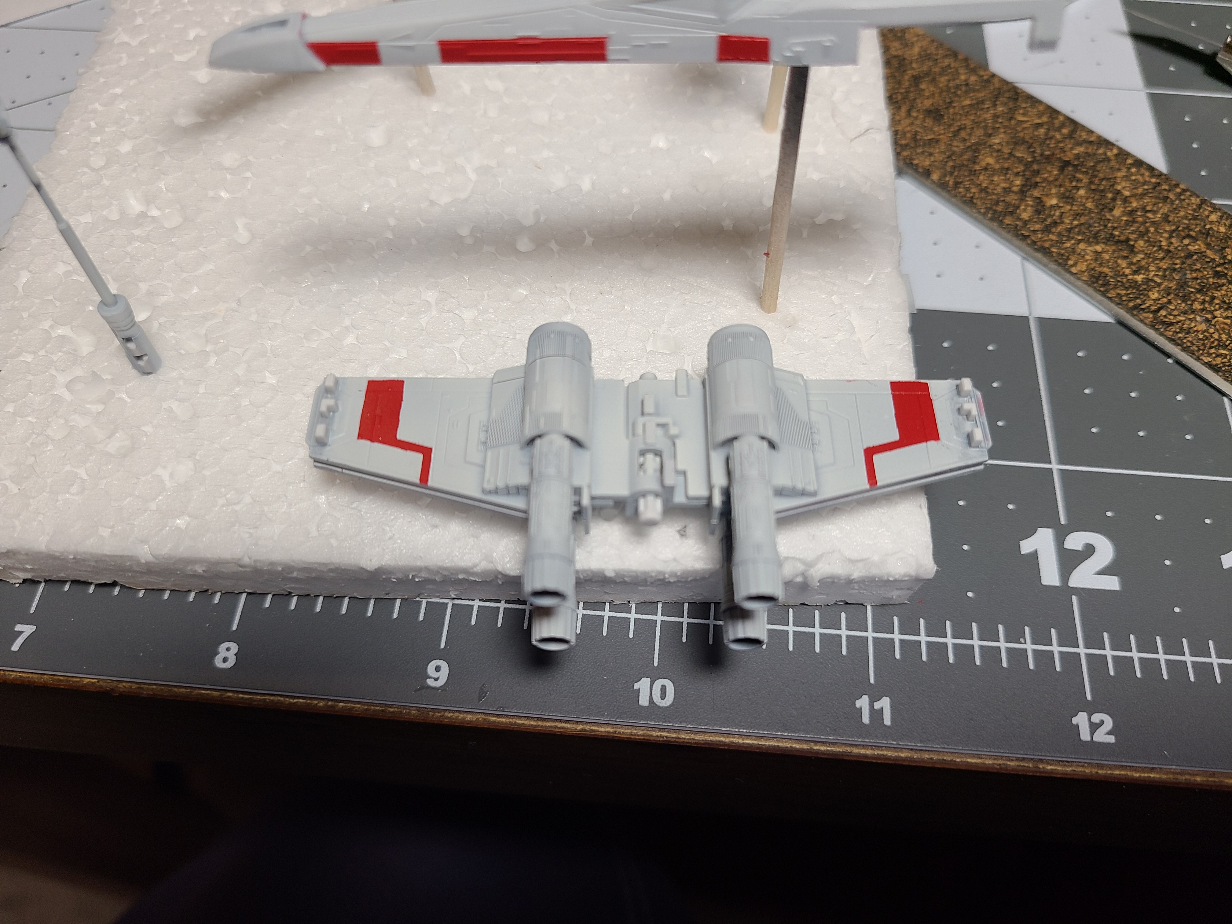

I got the majority of the red sprayed on both models with Mr. Color C89 Russet. It's much lighter and more saturated in the pictures than it is in person. I used the negative side of the stickers for the masks on the small one and I still need to figure out a strategy to mask the remaining four stripes on each wing. While the bigger one was still fiddly to mask off, I was able to do it all in one shot. I also used liquid mask for some paint chipping. I'm really happy with how it came out, especially the larger one.
1/144
1/144 wings. I need to paint the remaining stripes and put the gap back into the first ones.

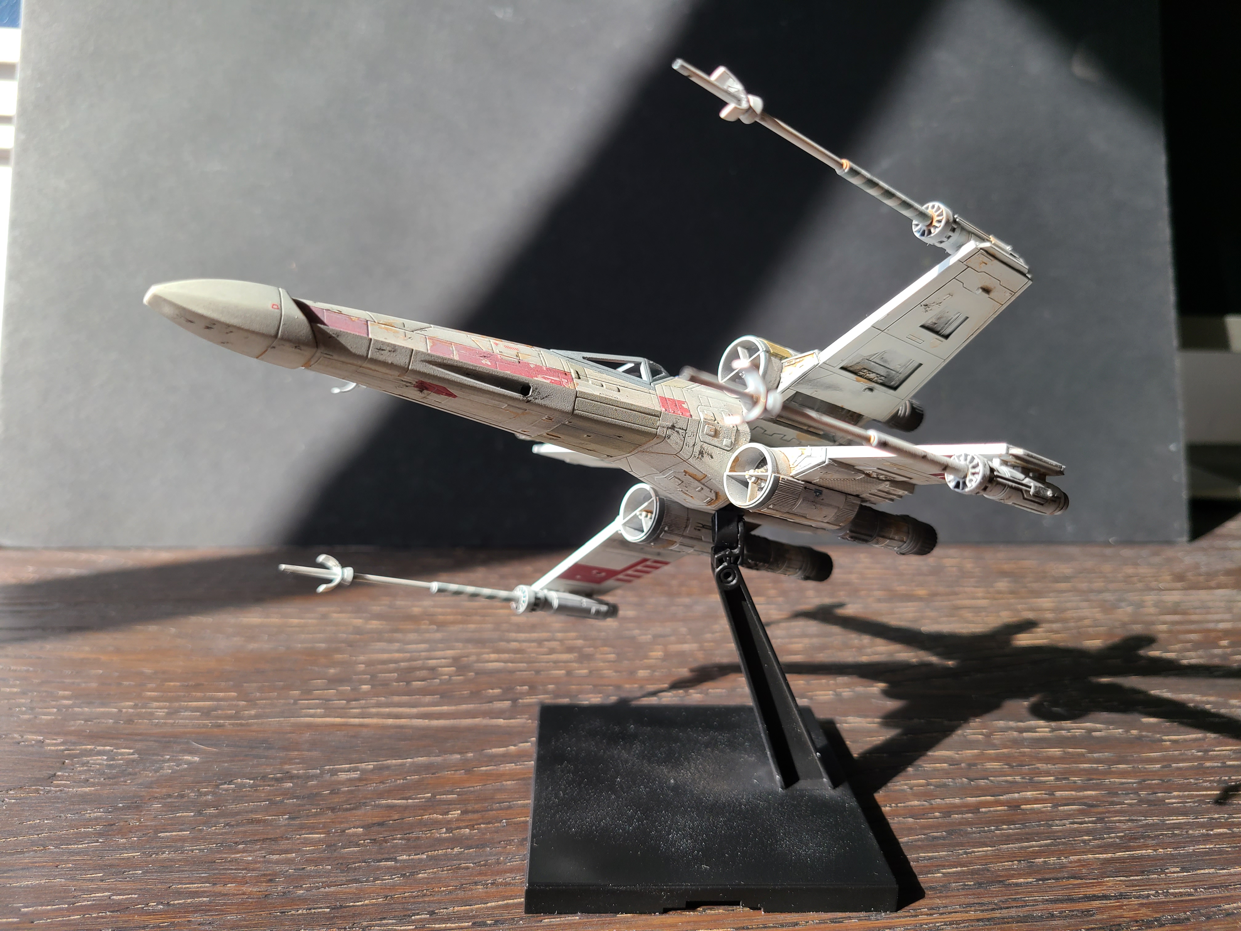

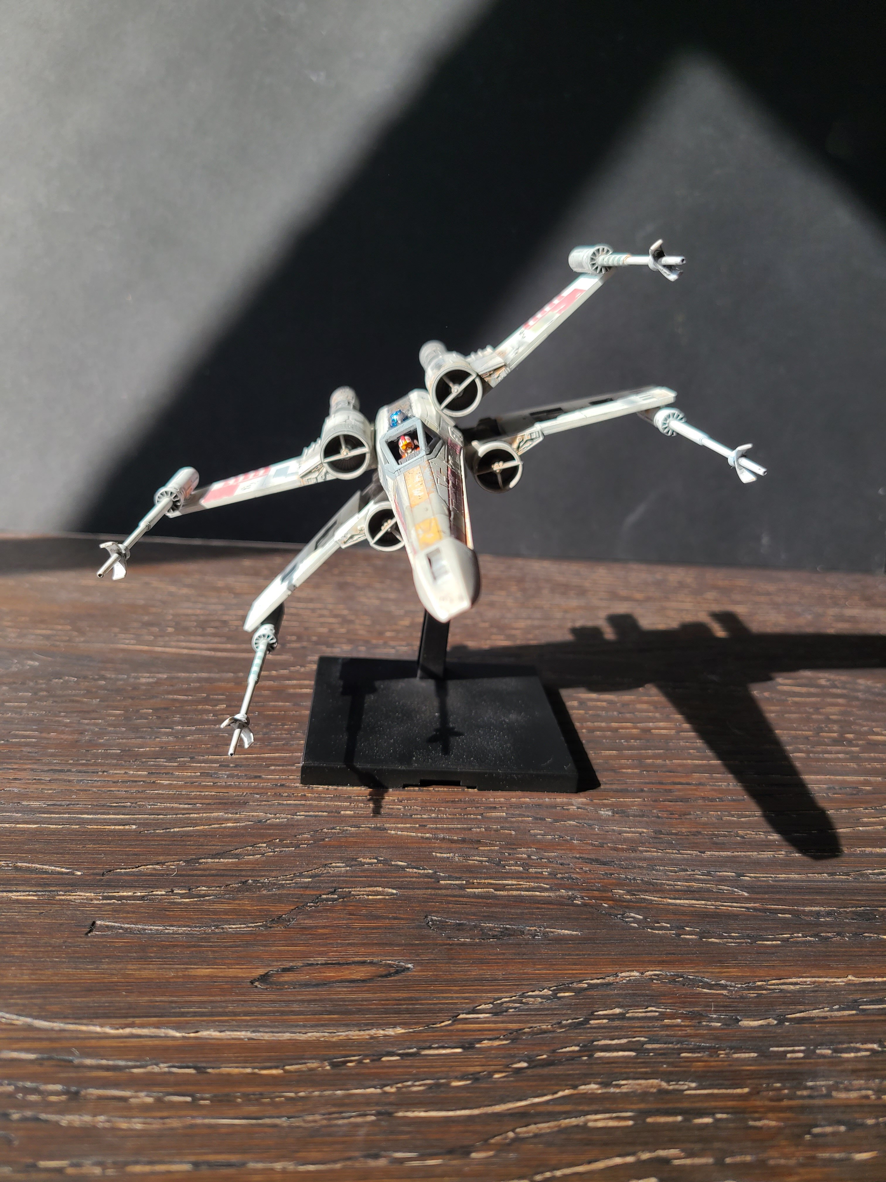

Speaking of more pics, I'm calling the 1/72 model done. I may touch up some of the weathering later on, but I'm pretty chuffed with how it came out. It looks like it's ready to murder a couple hundred thousand pipe fitters, iron workers, and storm troopers on the Death Star.
Now to finish the teeny tiny 1/144 version.
Excellent work,
I love the nice faded/muted tones rather than the strong contrasted tones you often see
Helps it look more in scale and it blends everything together
Thanks! The weathering knocked back the saturation a fair amount. I used a combination of washes and AK Interactive burned jet engine and city dirt pigment powders. The city dirt is a light grey and really helps to blend everything in and give it that "lived in" Star Wars look. I gave it a final base color mist coat that brought it down the rest of the way. I think I went a touch heavy on the mist coat on the nose, but it's a minor thing.

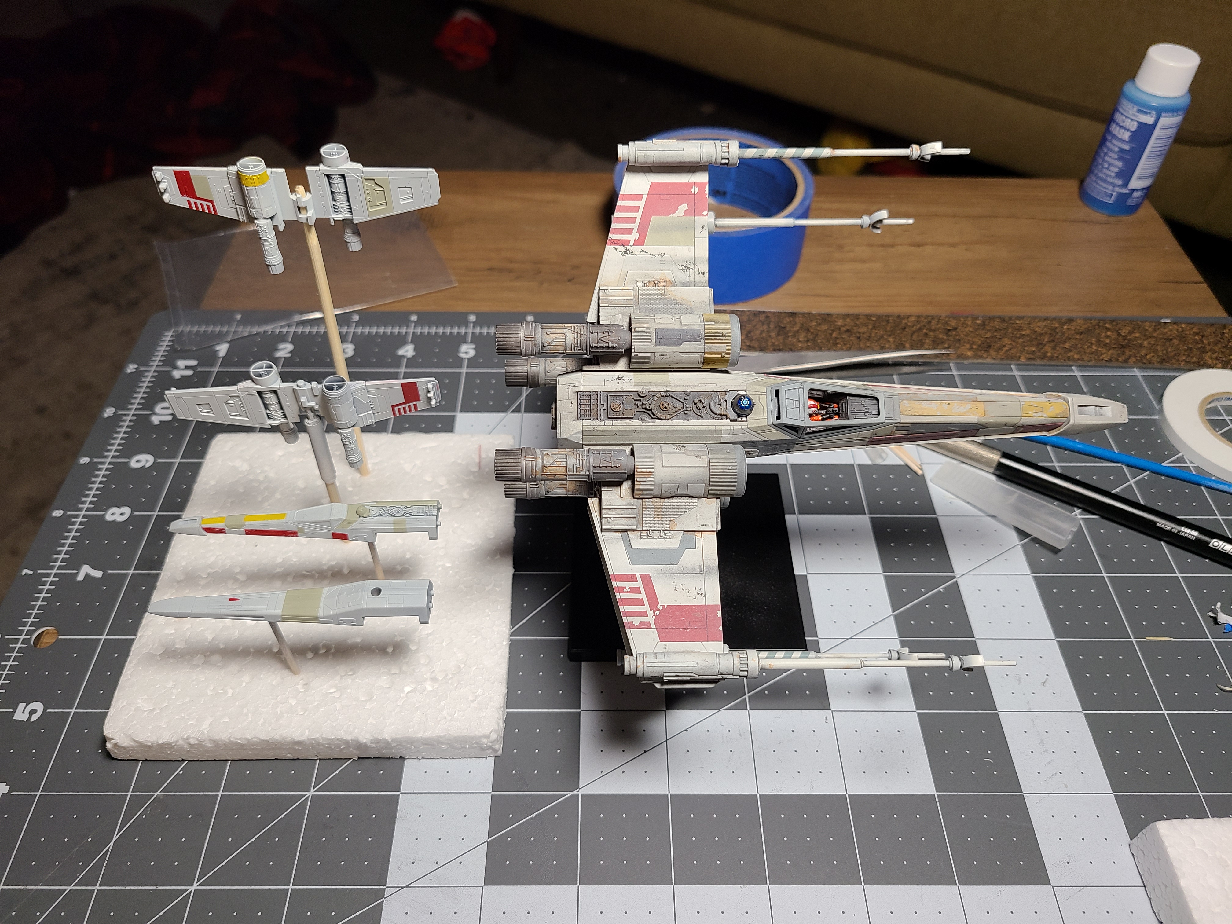

I'm making progress on the 1/144 model. I've got about half the colors masked and sprayed. This is the most fiddly masking I've ever had to to, but it's kind of fun. :) I still need to fix the first red stripe on each wing, but that should be pretty easy.
Parts lined up next to its big brother.
