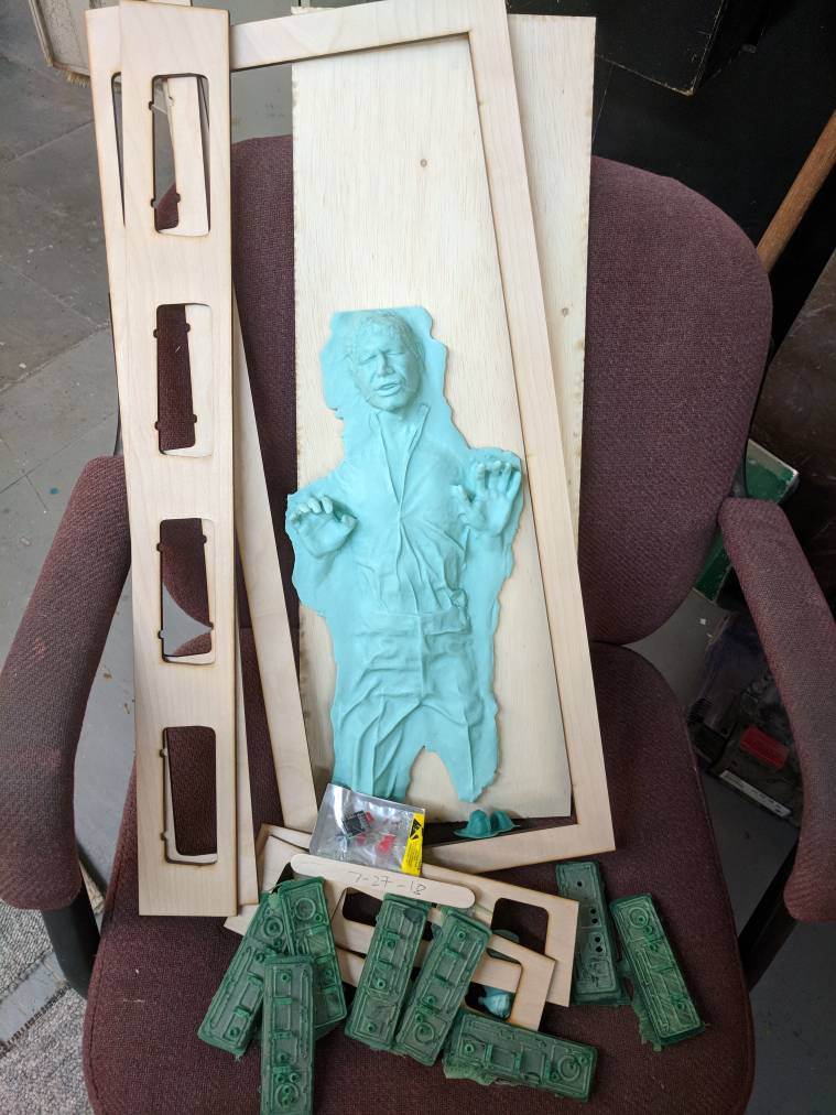

I received my package and had a couple questions.
First, do you have a parts list and directions for the electronics? The plastic bag that contained my panels and electronic pieces had a hole in it. I found some electronic pieces in the bag and some loose in the box so I would like to make sure I have everything. It also seems I am missing a wiring harness and battery pack. Given the past posts and I thought those were to be included and the hole in the bag wasn't big enough for these to fall out of.
Second, are the panels the correct size on the 1/3 scale? It could just be me but they look slightly smaller than the original ones shown. They definitely look smaller in relation to the box when compared to the actual prop.
Third, any suggestions on how to best deal with the print lines on the panels? I understand that there were issues with getting these cast in resin. However, these have some rough looking print lines. I really don't want to end up losing some of the raised detail if I try sanding them.
Thanks
zenix
I didn't make directions yet. It's basically 5 leds (4 red, 1 green), 5 resistors, pins, and the board. Power supply by a usb phone plug will work. I can get you a battery pack since I said I would. I forgot that I said I'd include it. I drop-shipped one to you and Tim. Ivan, if you need one of these too, let me know. The directions are basically, solder the pins to the board, put one resistor per led, and solder the resistor to a pin, and the led back to ground. There's 5 pins that are controlled by the chip, and only 5 controlled pins, so basically any will do. One was designed specifically for the green since it blinks steady, and the other 4 are for the 4 red LEDs. I'll make a more detailed instruction describing and showing what to do exactly.
yes
Thanks
Well technically I did only plan and say I'd make these in resin if I had enough interest, and we didn't meet those numbers, and was planning on charging a higher price for the 3d printed version, but charged you guys the lower cost resin version anyway to be nice. The printed versions do take some elbow grease to get nice. The best way is to use filler primer, high build formula, and then sand that down. Don't try to sand down the plastic, since that won't work.

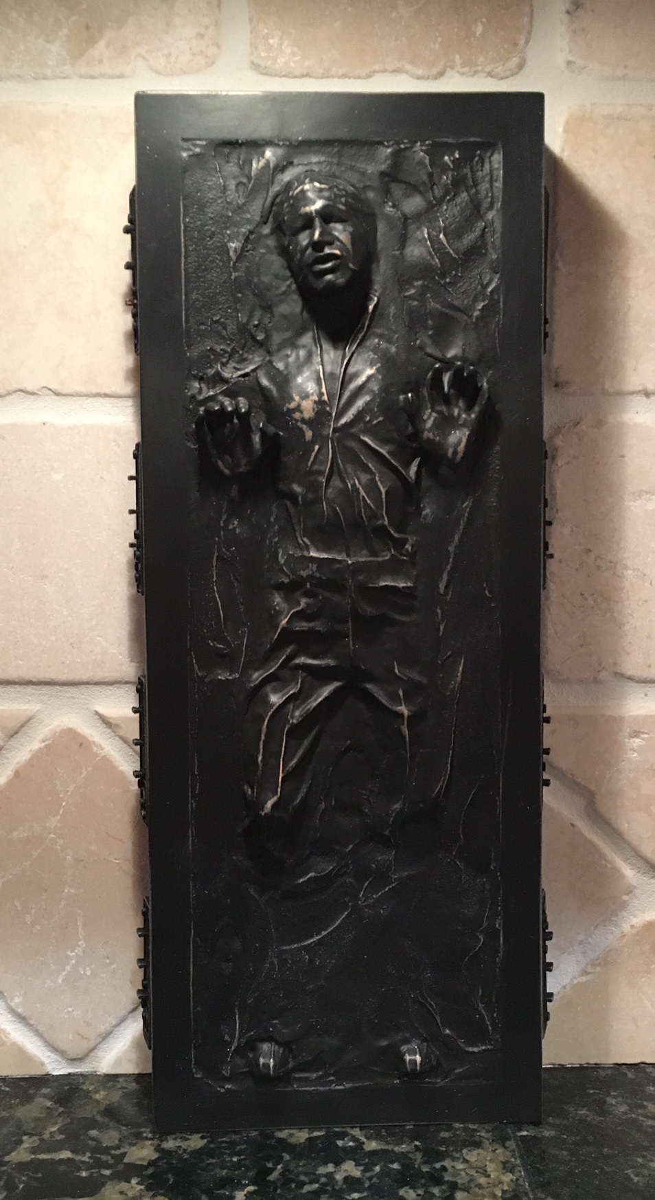

Thought I would post my progress so far. I have the LEDs ready to wire in and the back cut to fit. Should be done by end of week. I painted it with primer, bronze, then grey, then flat black, followed by steel wool buffing for highlights. Thanks zenix!
