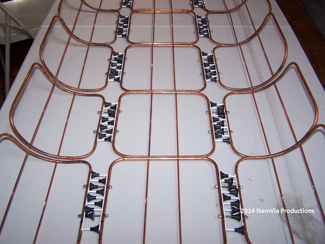

All of the copper tubes that I cut the holes into have been placed inside the panel frames. These will be used to support the light panels as well as allow me to run the lighting effects through each of the tubes.

This month I've spent quite a bit of time casting many different pieces for the Light Panels as well the panel frames. The focus was mainly on the Power Nodules that are seen on either side of the tops of each of the side light panels. I needed to cast these parts in two different pieces because of the complexity of each part. There are 84 nodules on each of the docks so I had to cast 84 nodules as well as 84 of the clamp pieces.

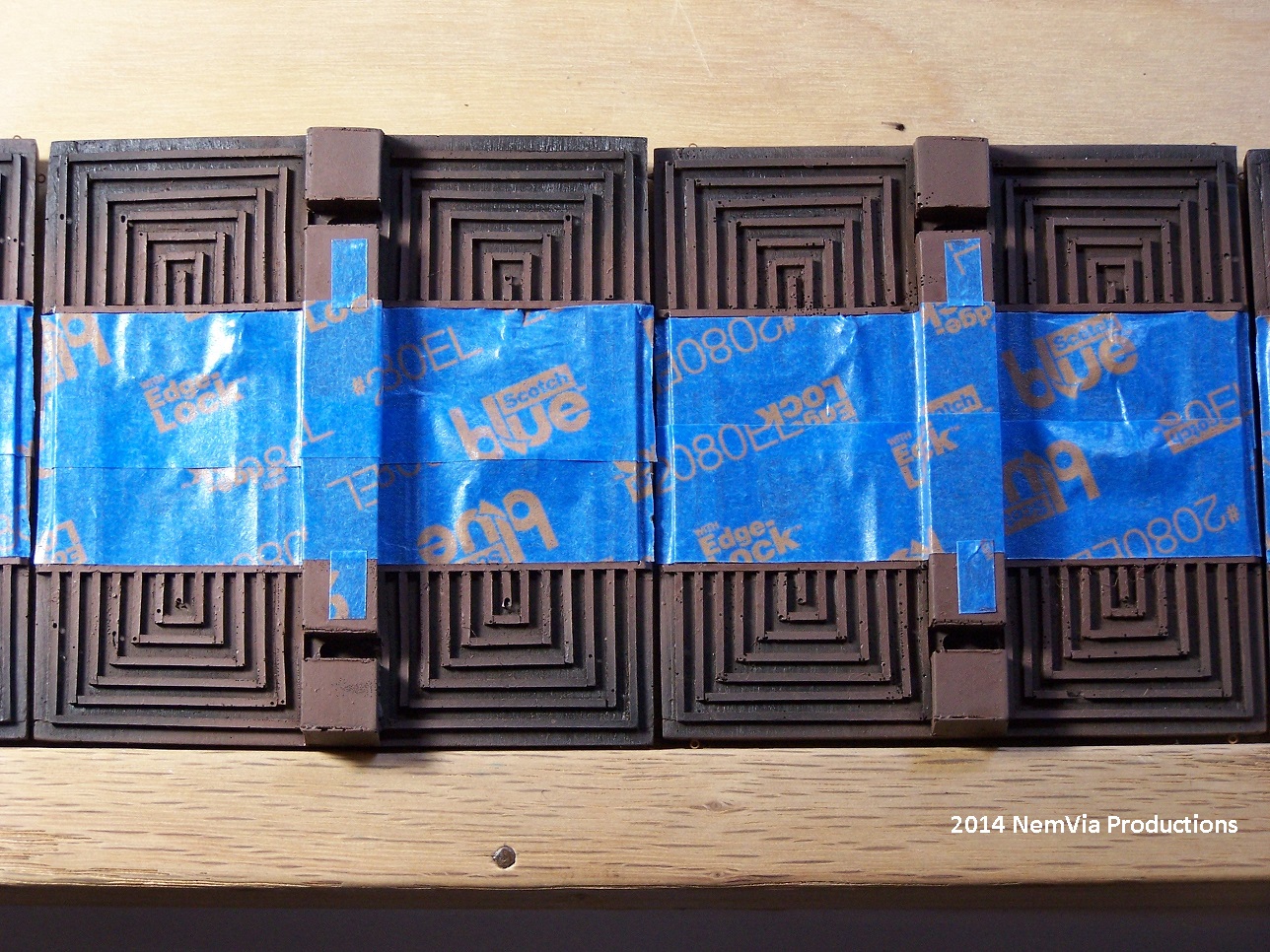

To start out with the painting I needed to fix almost all of the corner pieces of the modules. This being my first major resin cast project I did not get everything to line up exactly. But with some styrene and super glue I was able to fix all of these parts up. Next I wanted to add in all of the remaining anchor cones so that they could all be sprayed at the exact same time. This would mean less touch-up work later on. The reason I didn't add all of the cones sooner when I was assembling them early on was because I was going to use some of these cones to thread wiring through them for some of the lighting effect. But I now, I've come up with a new way to add the lighting which I will discuss in future updates. So anyway, I fixed all of the loose parts by either re-cementing or replacing them so that everything will be ready for the final paint job. Next I did some more masking of what look to be grill plates on the underside of the modules. I also masked off a lot of the side panels to give a little bit of a variety in color. Then I sprayed the entire model which took me just under an hour to do for each model. The spraying time was mostly taken up by doing all of the anchor cones.
There are some pretty good pics of the paintjob on the AUGUST UPDATES 2014 page.
After all of the masks are removed you can see the different colors on the underside and sides of the modules.
I was also able to start adding the starboard side panel frames to one of the models. This took some doing because I needed to added the support rods through the modules. After I had originally built each panel I had to align them with their proper positions mark all of the drill holes off one at a time to make sure all of these pieces would fit properly later on when they would be connected to the modules. To make sure I didn't mess up their order I needed to number all of the tiers so that they could be placed back into their original positions.
The Starboard frames are now anchored to the modules but they still need some tweaking. To finish all of that though I need to add in the lighting wires for the light panels. After they are all in place I can then make sure everything is squared up and then I can add the vertical detail pieces on the inside and the outsides of the frames. Once I get this done I can actually mount the Refit Enterprise into it's final resting place inside the Drydock. I really hope I can get to that part very soon! I've been looking forward to that very much!

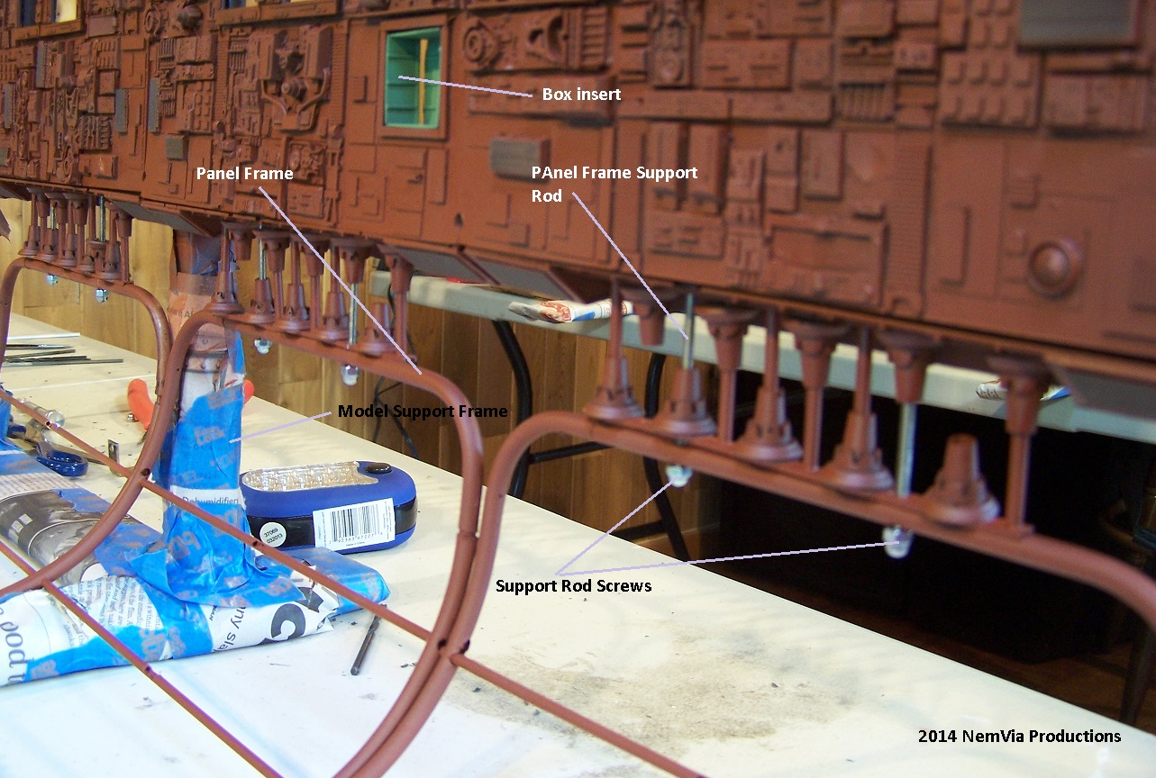

Any of the missing anchor cones have now been put in place, then I finished putting the horizontal detail pieces then painted all of the details "Rust". This prepared all of these pieces for the next important step of lighting and wiring the panel frames and panel lights.
I have also added the box insert pieces to the overhead modules and cemented them in place. Next was the part that I've been wanting to get to for a very long time. The wiring of the light panels. For my 1/350 scale Drydock I used copper telephone wire and lots of LEDs. It was really a wiring nightmare because of how many connections were needed and later when the model was moved around or slightly shifted some of the panels would go out and then I'd have to find out were the break in the line was and re-solder everything until it worked properly. For this model which is about 1/260 scale, the pieces are a lot larger and easier to work with but I did not want to use LED's because of all of the soldering needed, so I'm, using a new technology for the panels which is becoming very popular for lighted models called EL Wire. This wire can be fed through all of the tubes, be looped around the spurs inside of the panels and then fed through to the next panels and so forth. The LEDs took several days to wire in. The EL wire took me less than 3 hours for one side of light panels.

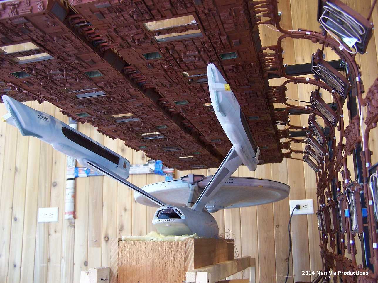

After I threaded all of the EL Wire through I was then able to connect all of the panel frames together then put on the Vertical detail pieces on the insides of the panel frames. Right now I'm working on the outside of the Starboard frames and adding the Vertical detail strips on there as well.
I'm now beginning the work on the Port side frames and lighting work. After I get this part detailed and wired I will be adding all of the Light Panel Graphics and Front parts of the Light panels. I should also be able to get one of the Enterprise models mounted inside the dock if all goes well. There's still a lot of work to get done but it's getting closer to being finished.

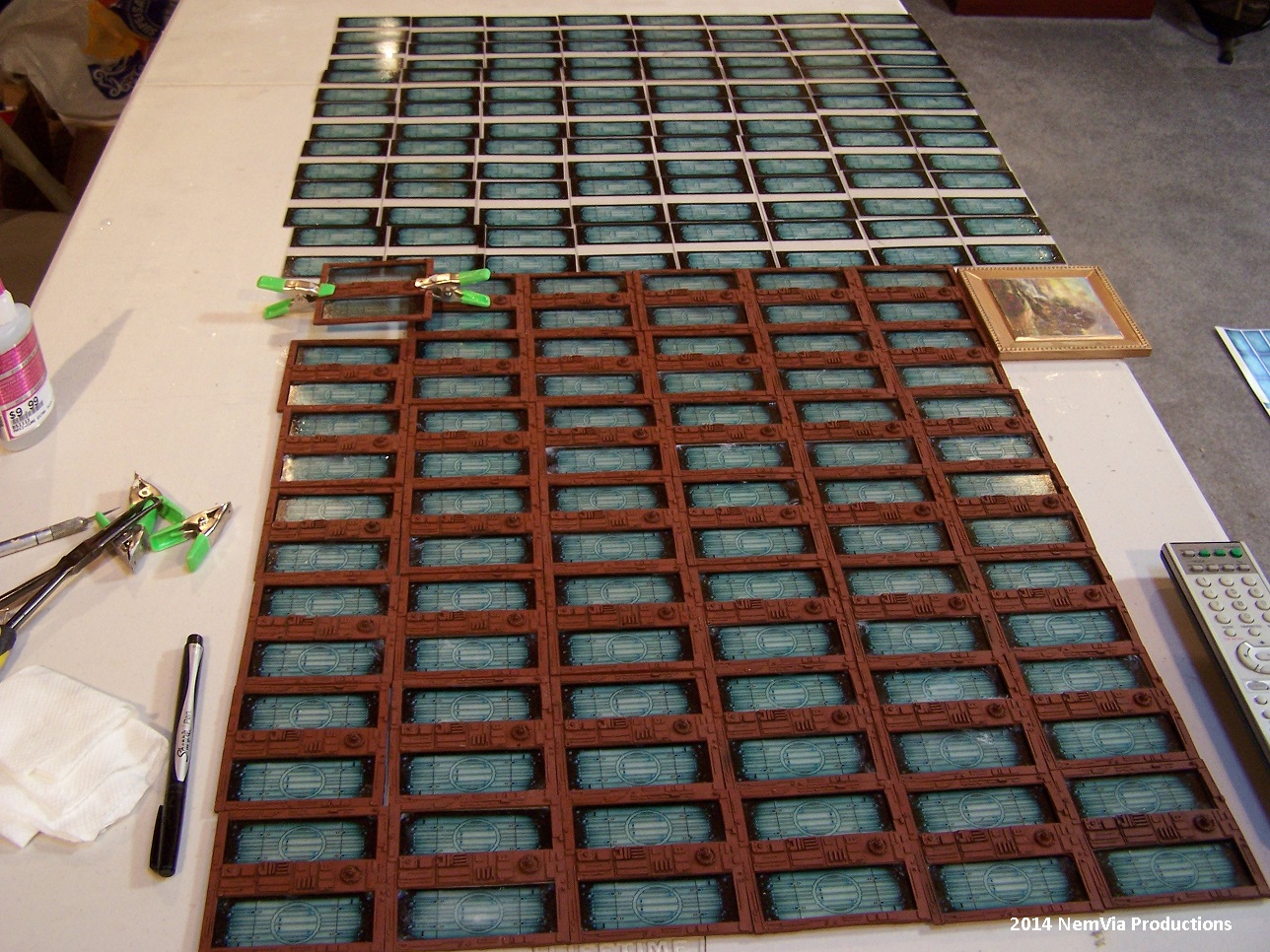

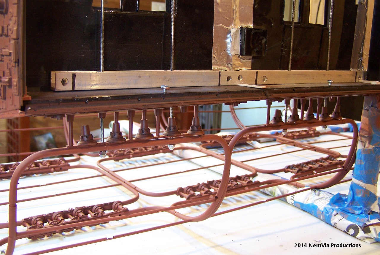

September has been another busy month for drydock building. I was able to spend a lot of time on the Light Panel frame fronts. I had to cut out all of the plexi-glass pieces to use as clear windows and a 3rd piece of plexi for the graphic decals. For each light panel there are 2 pieces of plexi. That makes 112 pieces for each of the panels. The plexi was then cemented in place. I then had to make all of the decals which amounted to the same number of pieces. There are what I'm calling left and right side decals for each piece. There's a slight variance between each of the decals, so I had to make sure they were all put on the appropriate sides.
I've also spent a great deal of time making the turnbuckle anchors and tension rods. One of my clients requested that this detail be physically bolted to the panels and the frames. So here's how the work load pans out for this month. There are 504 tension rods needed for each drydock. These rods connect from the light panel to the panel frames. I am using styrene rods because they are very light weight. I'm spraying all of these rods "Rust" before I cut them to size. This way there will only be a minimum of touch-up work to do. On each end of these rods will be an anchor with a loop on the end of it. (See pics of this process in the October updates page) There are 2 of these anchors on each of these rods so I need to make 1008 of these. 336 of these anchors will be for the center tiers of the light panel frames. The remaining 672 have to be made with the end loops on a slight angle because of the way the top and bottom tiers are of the panel frames are curved. As of this posting I have the 336 anchor loops finished and will be working on the rest later in the week. The hard part is keeping track of how many of these have been done. The other dock will have just the sleeve part of the anchor loop on them so it will look more like the filming miniature version. Later when I start adding the rods to the model I will be able to touch up the unpainted surfaces.
In other areas... because of how repetitive some of this work is it's nice to break off and work on something else for a while. For the last year and a half I've been contemplating on how I was going to build the work light arrays. On my 1/350 version I had no idea of how I was going to tackle this because of the complexity of these lights. In the end I wound up taking a piece of cardboard that had a mirror like surface on it. I cut it into a hexagon shape, then etched a lot of line into it and drilled holes for where the lights were supposed to be. I then back-lit this piece with 3 LEDs to make the lighting effect. Although I've hear some good suggestions of how and what to use for this array, such as a florescent light cover cut into a hexagon shape, it just did not work out for the scale I needed to build these arrays in. I have found some pictures of these light array panels and they were originally used in the unused TV series version of ST:phase II drydock as the side panel lights. They have a very complex configuration and I wanted to at least in some way be able to come as close as I could to getting these as accurate as possible. I stumbled on the simplest of solutions. At my local Hobby Lobby I came across a section that has all kinds of beads, glitter and most importantly of all Sequins. They were in various colors and I happened to notice that the silver ones had a reflective quality as that of mirrors or reflectors that are used in lamps and/or flash lights. JACKPOT! They had 3 or 4 different sizes, so I bought a couple of small bags. I notices that even though they are punched out into round shapes, the center of each sequins had a hexagon shape to it. So I lined up 60 sequins of 2 different sizes of each kind of sequins then measured out the overall size of both of them and decided I had a close match for the work light arrays. When lined up properly with the edges of the hexagon they reflect light similar to what is seen in ST:TMP. So I built 4 of these panels 2 for each of the docks.

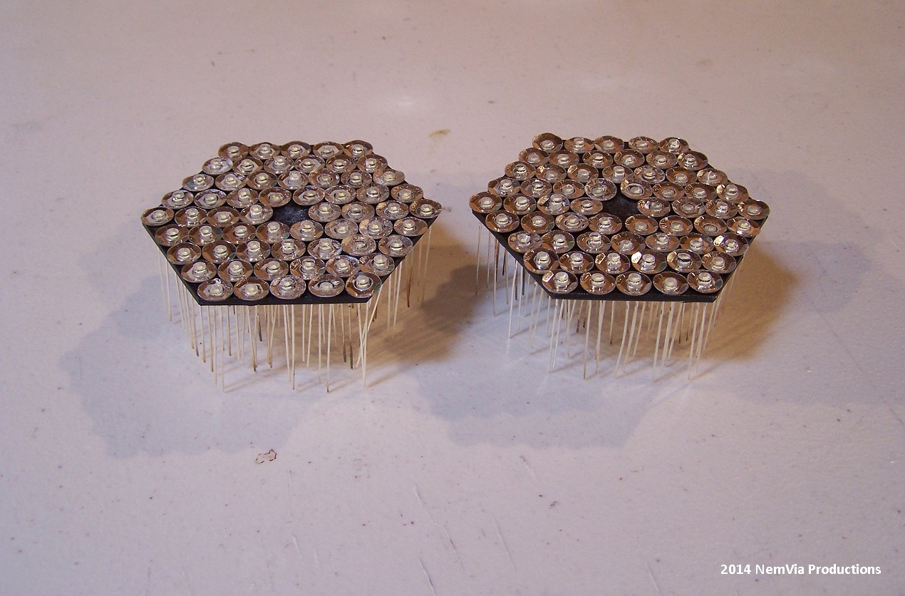

I cut out a hexagon shape made from sheet styrene, sprayed them FLAT BLACK, then carefully cemented one sequins at a time until all 60 were lined up and in there proper places. Next I drilled out all 60 centers of the sequins so that one LED could fit into each of the holes. It looks great so far and I can't wait to wire them up and do a lighting test.
For the last part of my update: Since I was able to add the Starboard side of the light panels to the overhead modules I wanted to see how one of the Enterprise models looked inside of the dock so I snapped a few pics and put them into this month's update. There are 24 new pics on the "October Updates 2014" page on my site! Hope you like them. More updates coming next month! See you then! Have a great month!
Mark

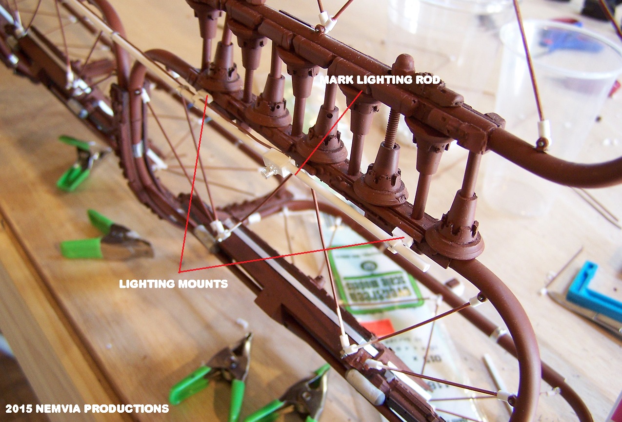

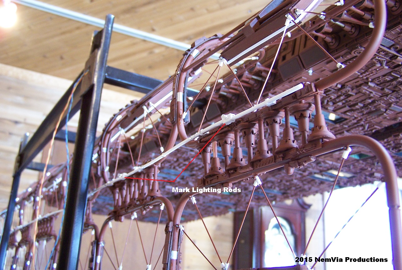

I also put together the Port side panel frame structure and ran all of the wiring through it so I can add the LEDs to it later on. After I finished this I started putting together all of the LEDs that will be used in all 56 of the light panels including the ones in the Overhead Modules. I also test fitted the Port side Panel frames to the Modules to see how they will look together with the Starboard side. So there was a lot of soldering going on during the month of January and there will be a lot more to come.
In other areas I finally got to the point where I needed the modules to be standing in their upright positions so I can get more of the model assembled so I started working on the display base. We had a couple of 40 degree days out by us so I was able to go into the garage and start working on the base. For the most part it is assembled together as you will see in the update pics for this month. The top of the base however is not permanently attached to the model as of yet until I can get all of the wiring and controls in place.
I've also started working on some additional lighting rails that run along the bottom of the lower tiers of the panel frames. This lighting is much like the ones that are on the bottom side of the Overhead Modules. There are also 4 more rails, 2 on each outside of the middle light panel tiers that will need to be made and mounted to the frames. Coming up will be some work on the mooring tractors on the bottom of the dock as well as some work that will be done on the work light panels and the work cranes. It starting to come together little by little but it's looking good and I feel good about is being accomplished! There are 23 new pics on the FEBRUARY UPDATES page for this month! Hope you enjoy! And I'll see you once again Next Month!

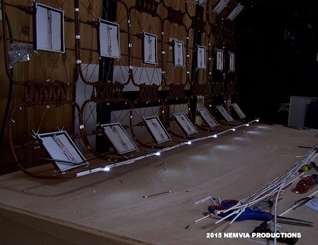

For this month's update I was able to get a lot more wiring done for additional lighting effects. I have 25 new pics in this month update page. On the outsides of the dock there are 2 rails with lights on them that run the entire length of the dock. They are more accent lighting than anything, but they are there. I've also built 2 more rails with lights on them that run along the bottom sides of the dock. These are more visible in the movie. I have also started building the Mooring Tractor Beam emitters which steady the ship while it's inside the dock. There are 4 of these that are seen in the movie and they are located on the bottom of the dock as well. There are also a few more details that need to be built before I actually mount the ship inside the dock. These include 6 outside mini panels (For what they are used for I have no idea, but you can see a great shot of them when the Enterprise leaves Drydock and the little dude is seen doing flips as the ship goes by) and I will be starting some work on the work crane and work light assemblies. These will be far different from the ones I made for the 1/350 scale dock. I will be making a master mold for these crane pieces so I can save some building time. I will also start work on the Gangway docking platform as it needs a lot of detail work on that. This piece might have to be made into casting mold as well. She's starting to come together even more and I'm hoping this will wrap up in the next 3 or 4 months if there are no more delays. Keep checking for the latest updates and I'll see you again in a month.

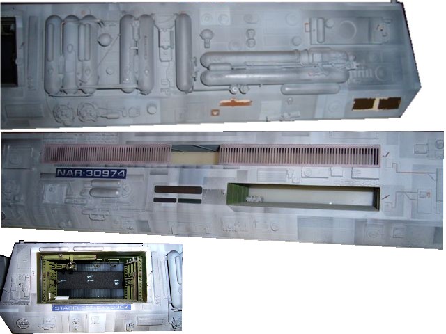

This months update is quite extensive as far as the work done on the Drydock. To begin, I started by opaque-ing the Tractor emitters Flat Black. This took several coats because of the thinness of the styrene plastic. I had to make sure there would be no light leaks. I then painted the emitters Rust. But reviewing some of the Behind the scenes pics of the Drydock miniature and a few other sources I will be updating that color to a light brown color. I was then able to solder the wiring in place and connect it to the main frame of the Dock. All of the lights are working. I also was able to do a lot of touch-up work on all of the added pieces of styrene especially on the light panels and all of the detailing work around the entire panel frame assembly as well as all of the tension rods and turnbuckle assemblies. They are now a uniform Rust color. In addition to this I've also added the completed mark lighting rails that run along the outsides of the panel frames. These were soldered into their circuits and then painted to match the rest of the dock. The test lighting on this came out really nice!

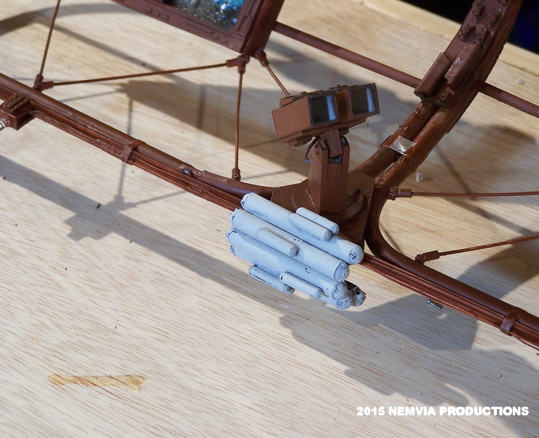

The next part, or parts I was able to work on were the Cryo-tanks or whatever they're called that run along the bottom of the lower tier of the panel frames. There are five tanks per cluster. I scratch built 5 different kinds of tanks with various smaller tanks attached to them. I then used this as a master for making molds. I needed 120 if these tanks for 2 separate models. I cast all of these in black resin then sprayed them a Light Gray primer. They were then detached from their main sprues and put in a pile on my work bench. Then I randomly selected 5 of these tanks for each cluster. These five tanks were attached to 2 mounting bands which allowed the tanks to form a half circle grouping. I then attached all of these clusters to the 6 separate joints along the bottoms of the lower panel frames. They turned out rather well. After I cemented them in place I did more touch up work on all of the tanks.

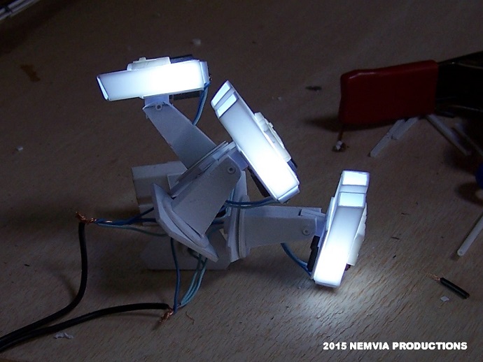

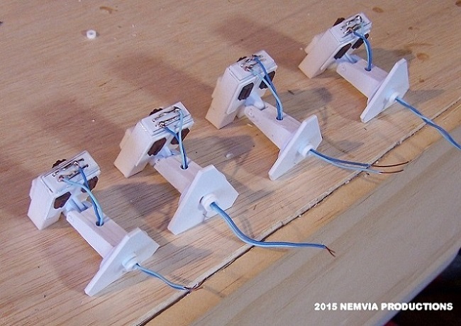

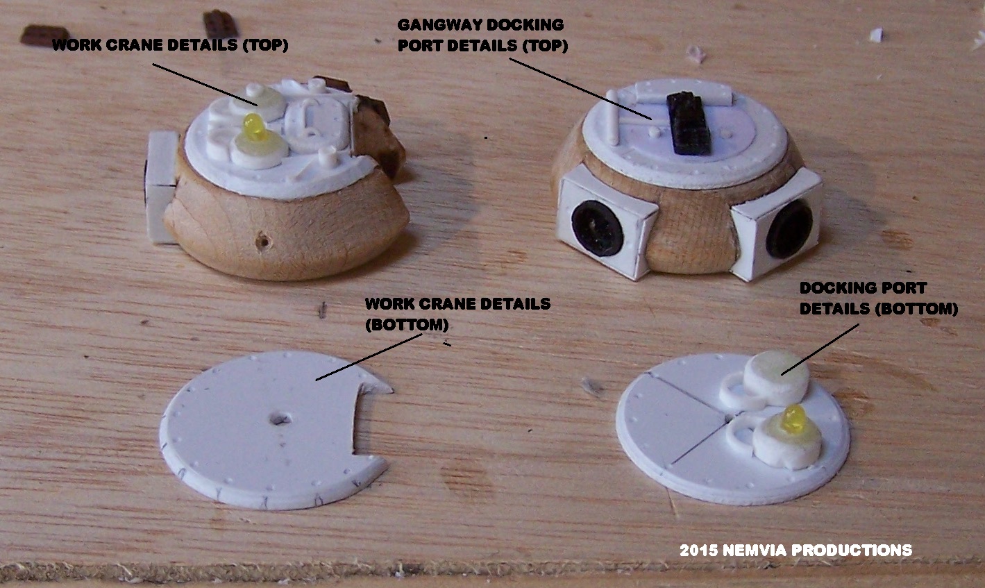

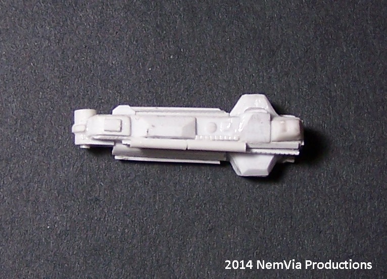

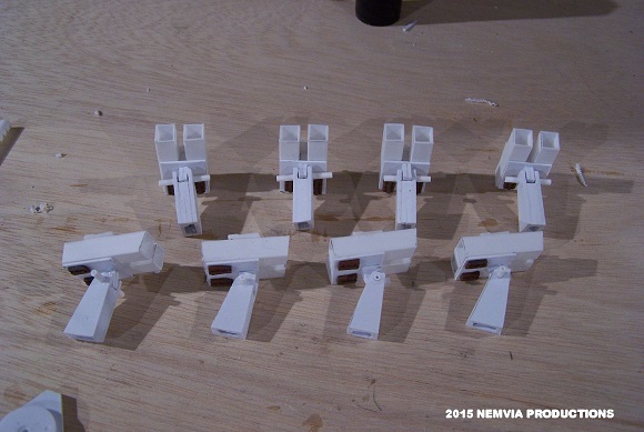

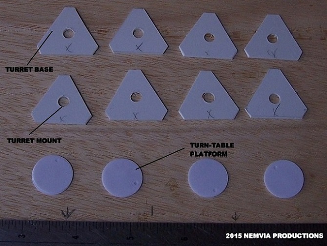

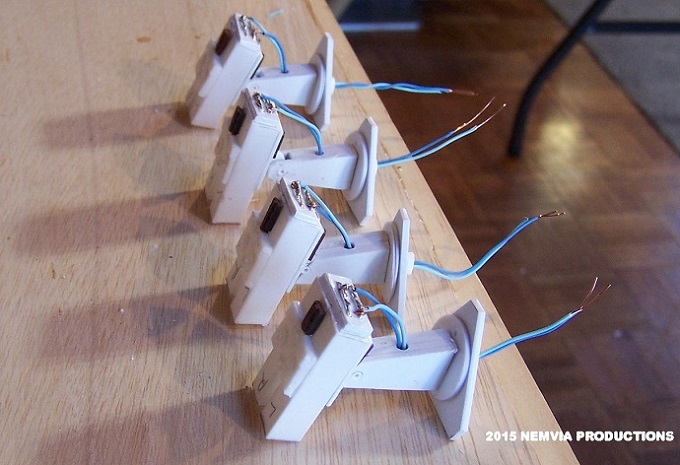

Another area I worked on was the work crane and work light turrets. These had to be built by scratch. I had purchased a mini-lathe specifically for this project and now I was finally going to use it. I took two wooden wheels that I purchased from Hobby Lobby and put them on the lathe and was able to create the basic shape for the turrets. The turrets resemble mini Jupiter II's from LIS:TOS. After a nice light sanding they turned out perfect, but I found out that they were a bit too large for the scale, so I bought more of the wooden wheels in a smaller size and re-lathed 2 more pieces. It only took about 20 minutes to get the right shape. I then carved out a notch in one of these wheels. This is for the Boom arms that will extend out to the ship. The other wheel was made for the Gangway Docking Port. There are 2 docking ports on this piece and one on the work crane piece. I wanted to add some lighting effects on these turrets so I cast them I clear resin to all I would have to do is opaque the pieces and scrape of the paint where the lighting effect will need to be seen. The castings turned out very good. I am currently opaqueing them and then painting them a light tan color. There are 2 pieces for each of these turrets, this eliminated the need for me casting piece in a 2 piece mold, which is a lot of extra work. BTW there are 5 turrets for the work cranes and 2 for the work lights. I will alos be adding other details later on including the booms for the cranes and wiring and lighting as well as other small details. Most of this will be scratch built.

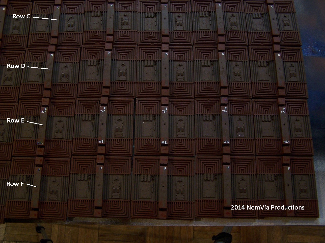

Another area I've started on are these 6 panels that run along the outside of the dock. There are 3 on the outside of each middle tier. Only 2 of them are really visible in the Drydock scene when Kirk and Scotty are in the travel pod. The only really clear shot of these panels are from a larger scale miniature that was built for a close up shot when the Enterprise is leaving the dock and the little dude is doing summer-salts as he's waving goodbye to the ship. These parts will also have a small but noticeable lighting effect. I started this by cutting up some very thin clear plastic into squares. I used a behind the scenes photo of this as a reference as to how large these panels will be for this scale model. I have added some masking tape for the parts where the lighting will show through. There is some minor detailing that will be added later on, but this too is turning out very good.

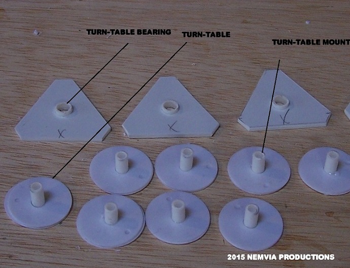

Last but not least, I am also working on connecting the armature to the Enterprise. This armature will connect the Ship to the Dock. There will be a lot of tweaking for this armature because of the weight of the ship. It has to sit in the dock very parallel to the panel frames. So hopefully this will be something to look forward to in next month's update. Otherwise there are 33 new progress pics in the April Updates 2015 page.

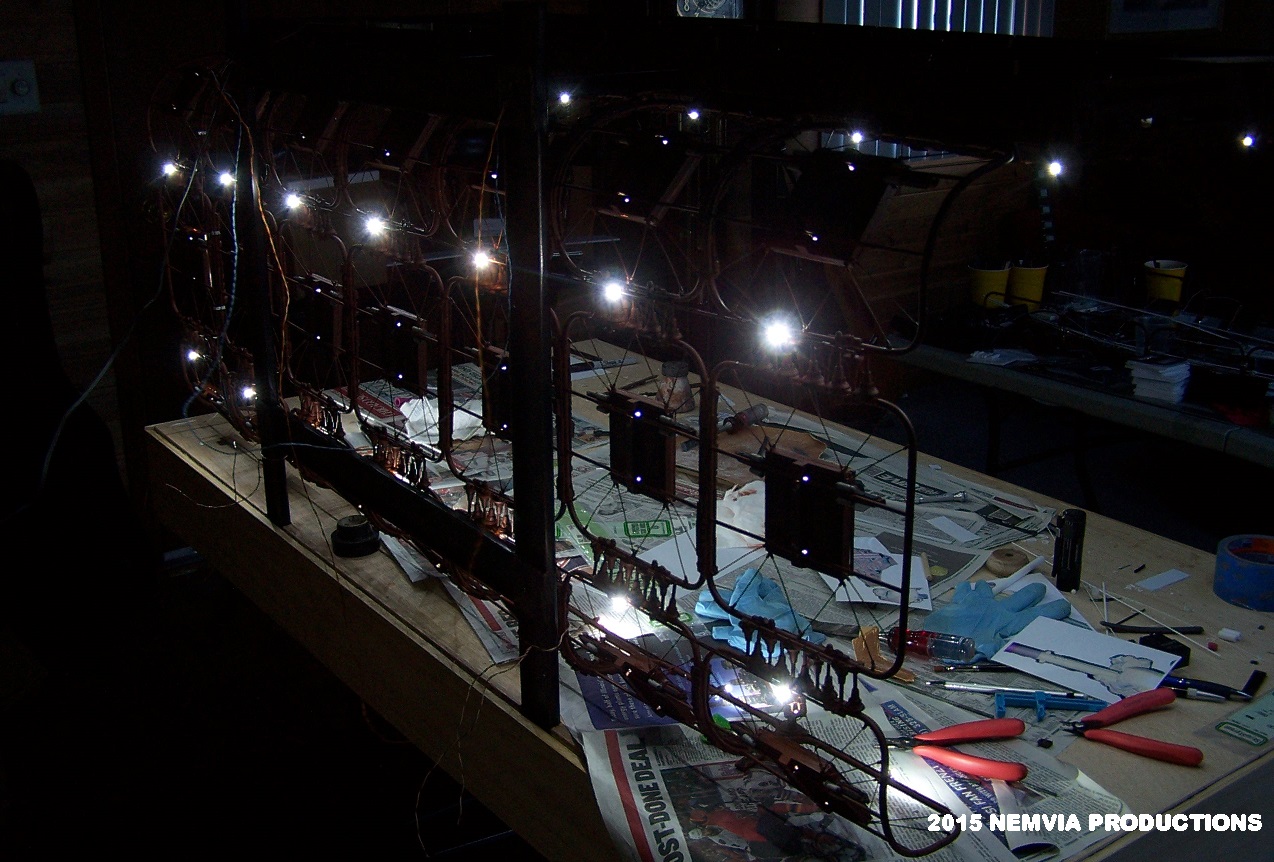

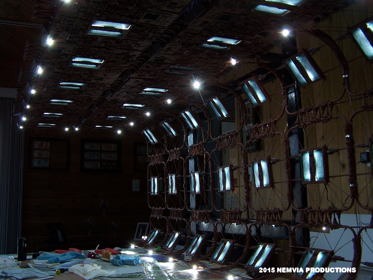

So I spent most of this last month doing a lot of soldering and wire running. Then after the wires were run thorugh the armature I needed to test that the ligthting circuits were working, then lable all of the wiring and the voltage for it's final connections to the power sources. So, I got the Engineering section wired up as well as most of the upper and lower saucer pieces. I am waiting for a shipment of LEDs to complete the thruster wiring for the Main deflector housing. I was able to get the main deflector dish wired up and working. I have lighting tests pics for some of the ship's lighting. By next month's update I will have the Enterprise resting inside her drydock and then I can add the Port side of the dock to the model. Hang in there gang. It's getting closer to being finished. I have 16 pics int the May Updates page. Check 'em out and enjoy! See you next month.
