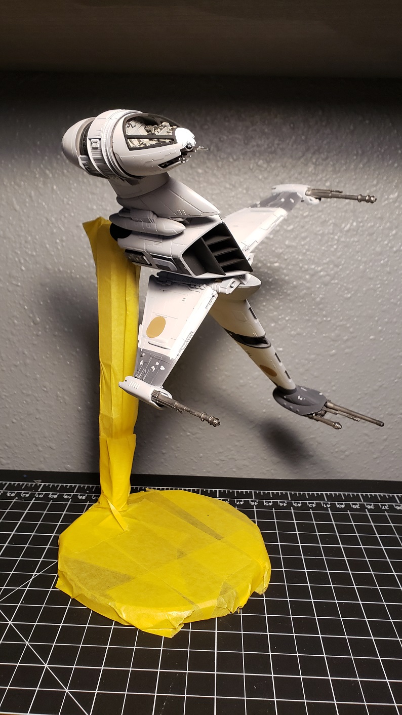

1:24 Scale B-Wing **Completed**

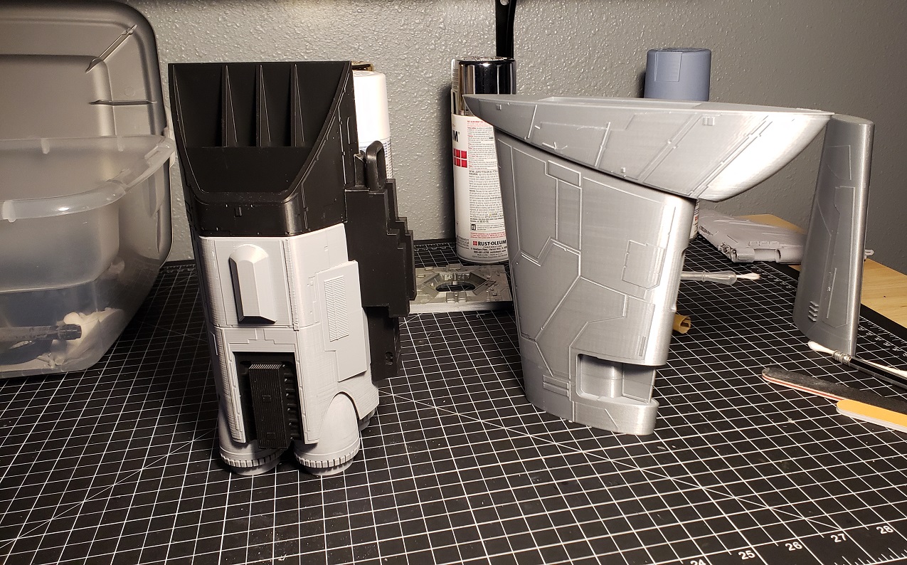

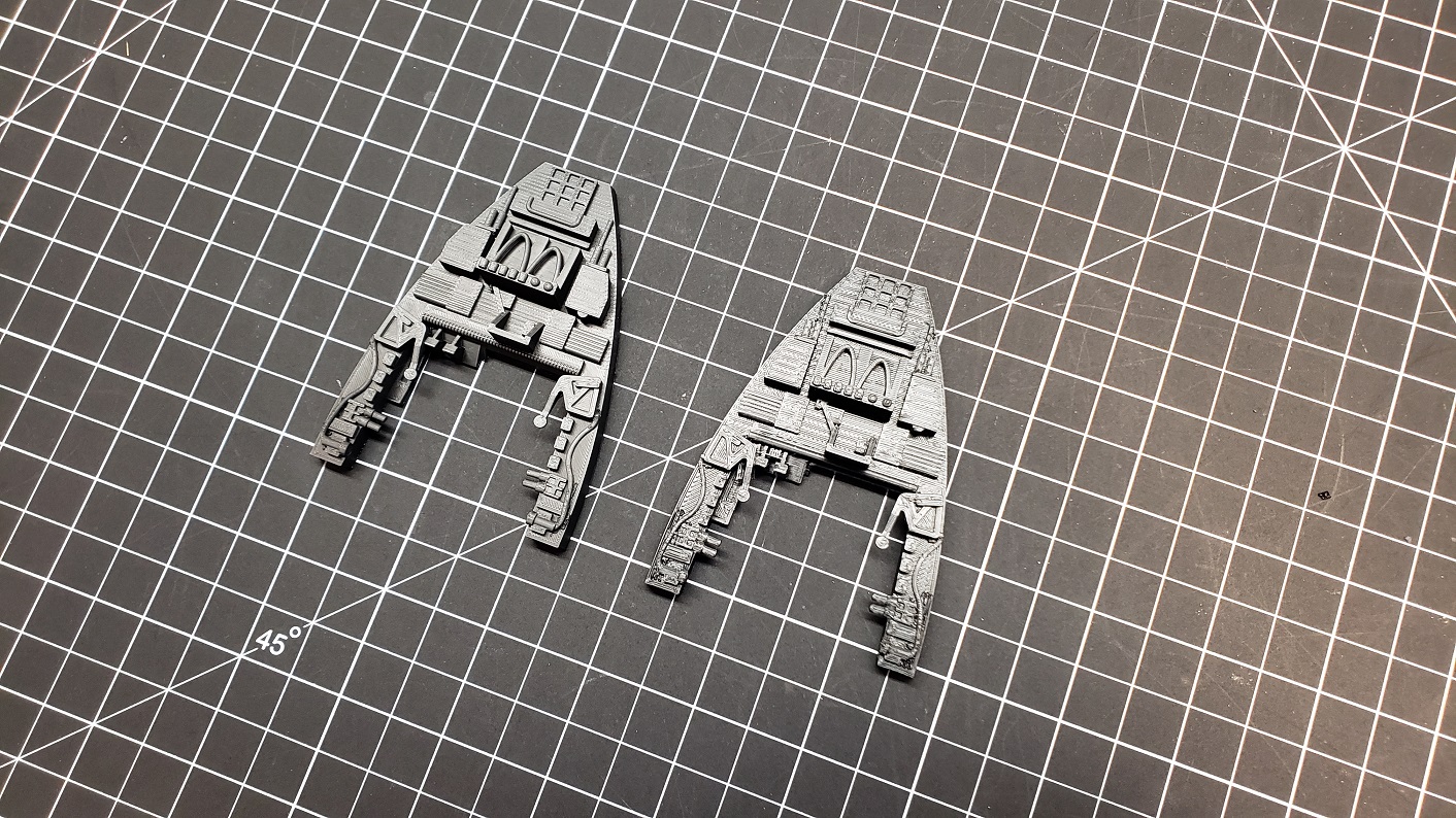

Here is my latest print at .07 this time. It seems to be a good mix of detail and speed. The .05 is great but the print times are crazy. The .25 nozzle has been working great. The .40 is just not able to get the panel lines and the smaller details on the sides of the hulls like the hoses.
.40 vs .25 nozzle, the .25 excels when the detail if 'facing up' on the bed. As there is no real way to print this standing up, which would be ideal, this is as close as I can get.

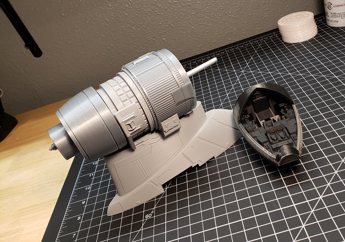

More progress on the big B-Wing :)
Print times are slowing way down as I learn to print some of these smaller detailed pieces. I assume I have at least 2 more weeks of printing before I get it 100% one and ready to go. I am having a real issue with a few of the parts, they would be easy with resin...

Beauty and the cockpit is the bomb! You're going to light up the whole thing also? (y) (y)
No, I was not planning to, until I was cleaning up some parts last night... I may reevaluate that plan as the cockpit is asking to have fiber run into it.

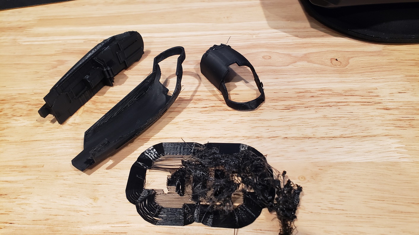

Some of the hoses and other really fine details did not print well, others didn't print at all. For some of these, I will use small aluminum pipes and bend them into the correct shape, for others, I am not sure yet. I need to come up with something that looks like a ribbed hose. If you have any ideas do share!
I use alu tubing or pvc tubing, bent to shape and then I run .3mm solder around it.
you won’t go wrong buying the largest roll of .3mm solder you can find. It works like magic.
Ah, solder, I have a bunch of that, not sure why I did not think of that. I will give that a try.

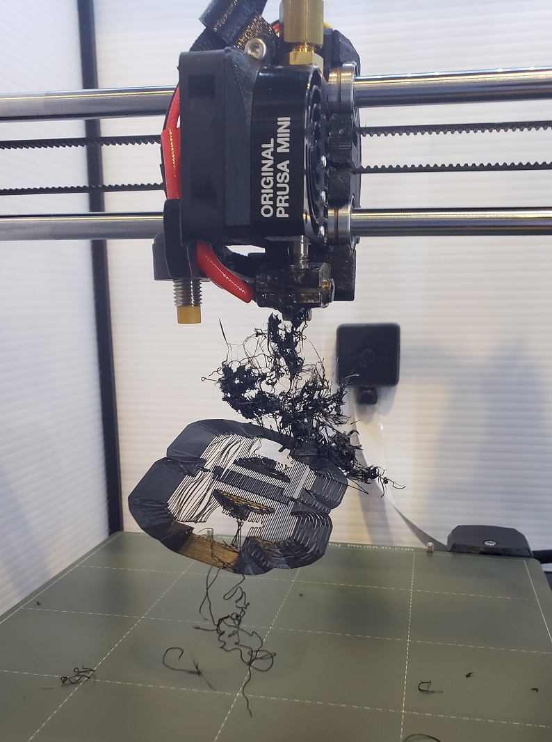

Awesome, I would love to see that. I have built the USS Sulaco, a 1:24 X-Wing and Interceptor among others. This B-Wing has the only part I have not been able to print so far... I have tried everything I can think of and no matter how I orient the part or play with speeds, the prints are just not great or they detach from the bed.
It's also driving me crazy as it's such a small part... but the shape and detail is oriented just so that getting it right with my current rig is eluding me.
I am really looking hard at the ELEGOO Mars Pro MSLA with UV curing stating. They are on sale right now via Amazon. I wanted to avoid jumping into the resin printer world, but for these smaller detail parts, it just can not be beaten...
Try to split it into more pieces, you may able to orient the individual sections better for printing.

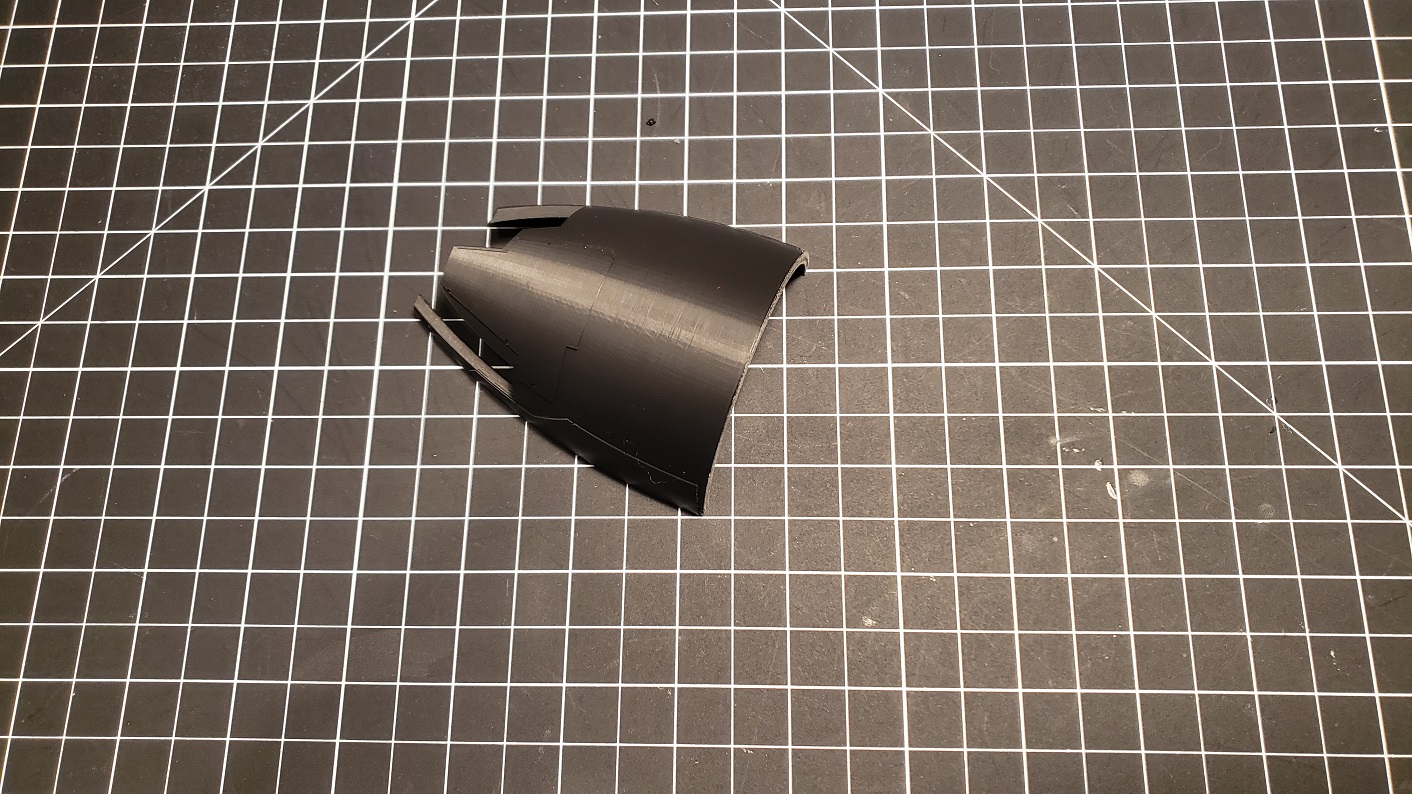

So, I went back to the drawing board and I was able to get this to print, so far. I am working on the second more complicated print but after 4 failed attempts I was able to get this one. The real issue was getting an object with such a small footprint to stick to the bed. I re-calibrated everything and slowed the print speed down a bit and it seems to be working better.
I also used the honeycomb pattern for the supports which works a lot better when building thin vertical supports. My favorite part so far about the .25 nozzle is that the supports just fall off the print with zero effort and leave almost no trace. I did not clean up the part below at all except just taking off the supports.

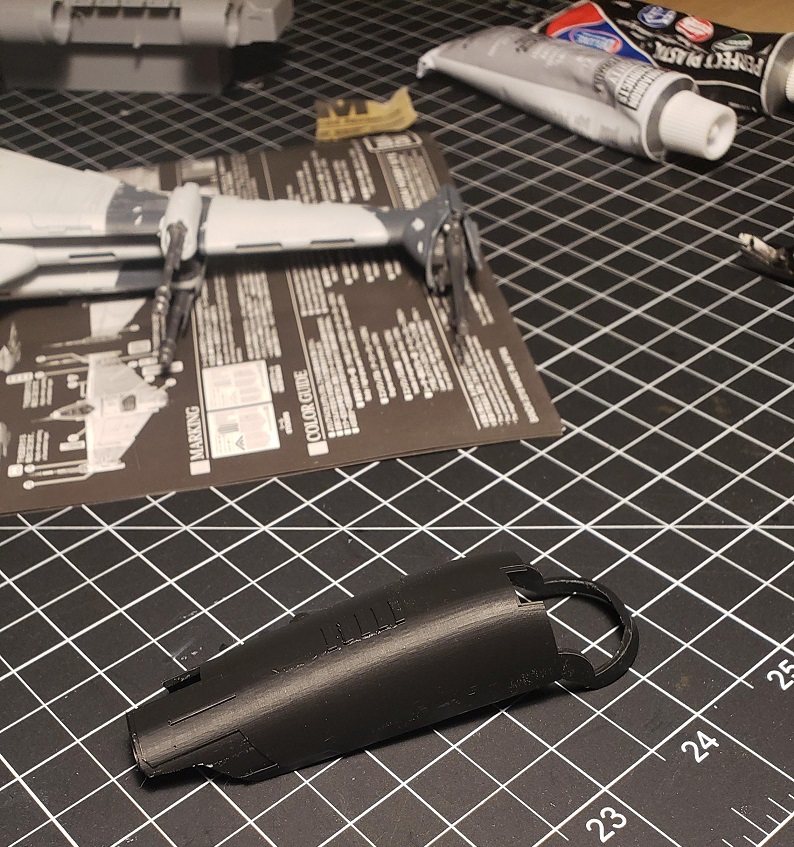

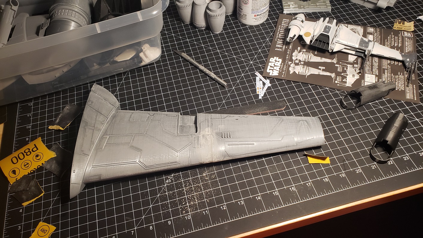

Try a heavy build primer for that and sand out the lines from printing a bit more with a lesser coarse sandpaper.
I'm a collision repair guy,this way you could save a bunch of sanding time.
