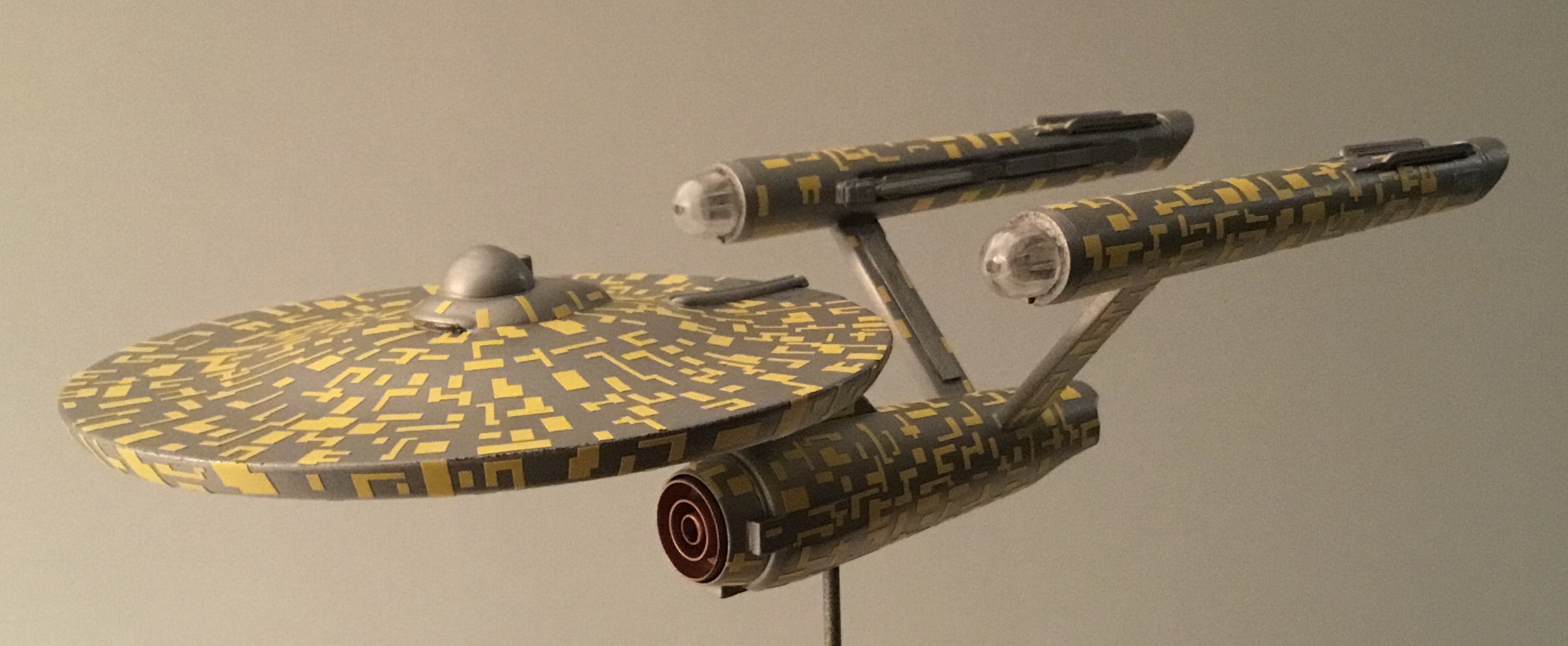

I noticed that the black undercoat was showing through in a few spots which weren’t fully covered by the airbrush, so I re-masked and gave the model a second coat of aluminum. Once it’s cured and buffed, then I can proceed.
Over the years, I’ve bought many of these 1/1000 kits, and now I can finally make use of the included stickers (as opposed to the waterslide decals) by using them as paint masks for all of the hatches and technical markings.
Paint masking has begun. I trimmed out the hatches/technical marking stickers from the Polar Lights kit and applied them to the model, then began the painstaking process of adding the hull plating masks.
I laid out basic patterns across the saucer and secondary hull, moving all around so as to maintain the randomness and spacing of the pattern. The first sheet of paint masks is nearly used up. During the next session, I’ll use the second sheet to fill in the blanks and make the pattern even more dense and random.
Sprayed steel onto the model. Once it dries, then comes the tedious process of removing all the masks.
Depending on how harsh the contrast between the two panel colors is, I may mist the base aluminum color over the model to tone the pattern down a bit. We’ll see.

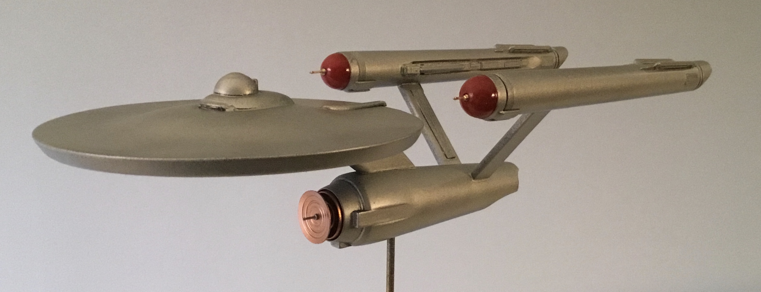

Like a kid on Christmas, I had to pull off a few of the masks to get a sense of how things look.
I’ve removed all the technical hatches (the T-panels and rectangles on the undersides of the nacelles, the underside of the secondary hull, etc,), the triangular landing legs on the saucer, a few from the front rim of the saucer, and the starboard nacelle pylon.
The silver contrasts nicely with the steel, and kicks back light at certain angles. Gonna have to wait until the whole model is stripped of masks before I determine whether a light dusting to blend it all together is required. The model will also need minor touchups from removing the masks, as well as being buffed to reduce paint buildup around the edges of the masks.
Three hours of pulling off tiny paint masks. I’m very pleased with the results. The brighter aluminum panels pop nicely in certain angles.
That being said, the contrast between the aluminum and steel is a little too strong for this scale, so I’m gonna lightly mist aluminum over the model after it’s had a few days to dry. Although I’ll also do a little bit of preshading with a Gundam marker before the misting.
That should tie everything together and make it look quite nice. It looks quite good as it is, but it needs to be a wee bit more subtle.
After that, the nacelle rear endcaps and trenches will be painted with a darker steel color, and then I can glosscoat in preparation for decals.
