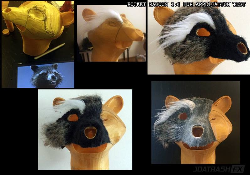

Gauging where his "skin" would be without the fur was the first challenge.
I've very rarely worked with fur or hair and I want the end result to look real. I decided against using real fur for ethical reasons so I needed to find a way to make his faux fur look like it does on-screen. I did some quick testing with various glues and paints on a throwaway prototype skull to nail down some techniques.

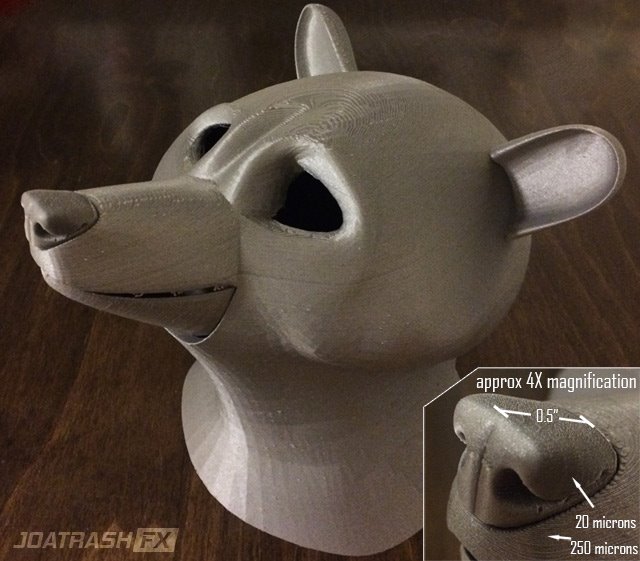

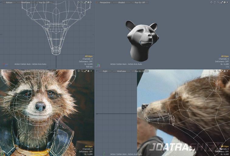

I then further refined my head model, making sure to give it a lot of asymmetry. Features have to be exaggerated a lot to accommodate for the smoothing that the fur will do. I made his lower jaw separate so that it would be easier to work with and so that I could modify his expression a bit if needed.
I haven't done much "organic" modeling, so I thought I'd try my hand at sculpting his nose in the computer. Turned out rather nice. The skull is 3d printed in 200 microns (very low resolution); I didn't need higher since it'll all be covered anyway and a rough surface helps the glue grip. Even so, the skull is a around a 20-hour print and uses a lot of plastic! The nose is actually a 20 micron (0.02mm!) print. Pores would be added to the nose later.

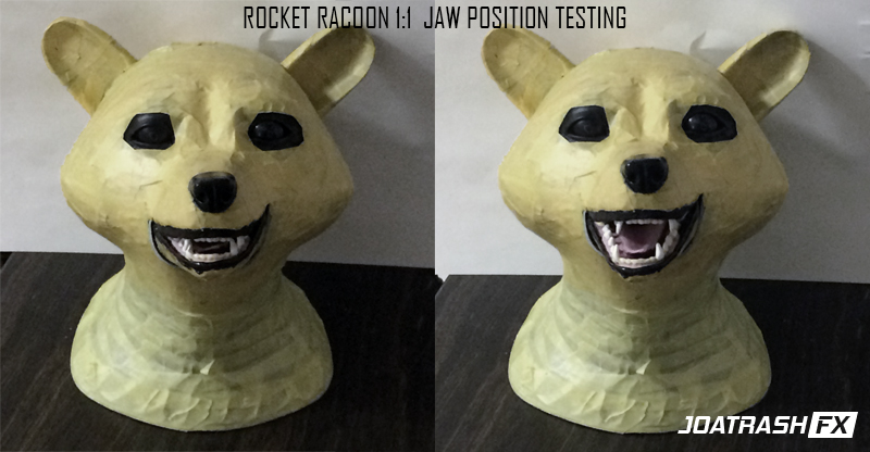

Skull covered in masking tape for fur-patterning. Teeth and tongue (not pictured) were also printed but his lips and eye sockets are sculpted in clay. (The eyes are bought ready-made.) So much of his personality is in his eyes and I wasn't really sure that this would look right in the end.
Painted up the inside of his mouth and gave him his second eye. Trying out a few different mouth positions. I still don't know if this will look right once the fur goes on, but I think that I can see at least a little bit or Rocket in these last two shots. (Once the bushy eyebrows go on they'll give him his trademark scowl.)

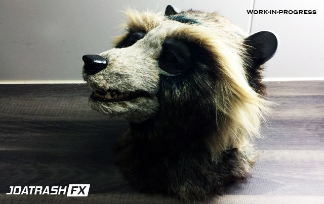

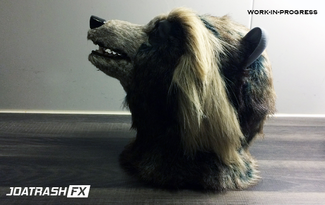

Starting to add fur. Right now it's much too fluffy and he looks more like Sprocket from Fraggle Rock than Rocket Racoon, but trimming and matting the fur with special mixture of PVAglue, acrylic clear coat and water should take care of that.
This profile shot looks promising when compared to how he looks in the film. Ears are much too small now that he has fur, so I'll have to replace them with bigger ones. I might also have to give him a bigger nose depending on how it looks once the fur is flat.
attachment.php
I'm still worried about being able to capture that special look that Rocket has. It's incredibly difficult to duplicate it with something like fur, since it does really "behave" when you work with it and having to guess at how his bone structure looks underneath doesn't make it easier.

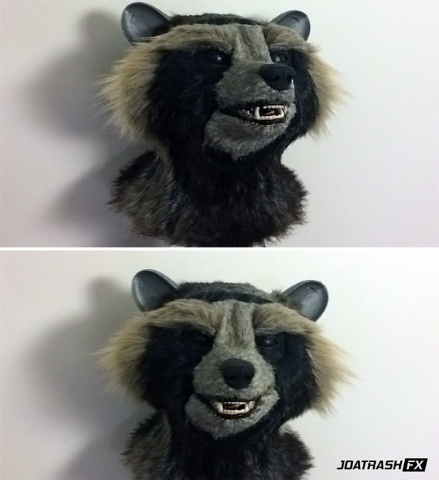

Time for a loooooooong overdue update. Life has been busy, taking away appendixes and making kits for people so I haven't had a lot of time to devote to this little guy, but I'm back on it. Fur has been changed, trimmed and the eyes resculpted.
At first I didn't want to do Rocket's trademark scowl, because it's the look just about everyone goes for, but I ultimately decided that "friendly Rocket" just didn't work as well... and really wouldn't work sitting on my shoulder as Groot holding onto his huge gun. So now he's scowling.
He also has larger ears and a slightly larger nose, sculpted out of Sugru (for that soft, rubbery feel) over a 3d printed base.
I can finally see a little of his personality in the build. It's Rocket and not some random racoon.

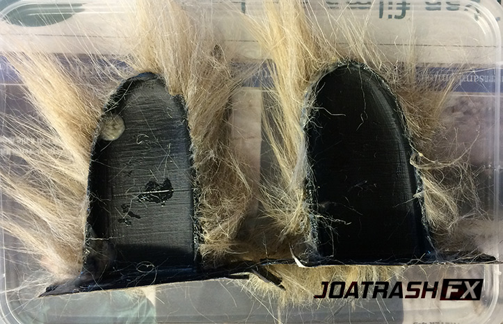

New ears w-i-p!
I had to redo the ears because I made them too thick and stubby. This image is just plain ugly, but they'll look right when finished.
Using resin and thick superglue to coat the ears with fur. Gluing the entire faux fur with backing would have made them much too bushy, so I opted to glue strands of hair directly to the plastic. Rocket has pretty thin, wispy fur on his ears. The insides of the ears and some areas of his face (such as around his eyes) will be covered in model grass flock, because it's perfect for short stubble.

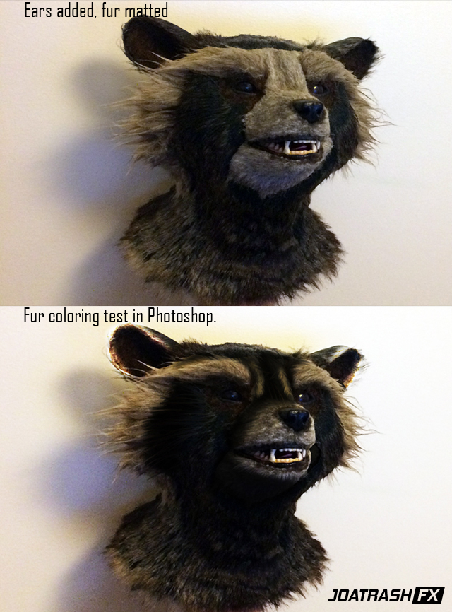

I've been making slow but steady progress on this build. I've ordered a felxible child-size mannequin to use as a base for the body.
After experimenting with 6-7 different pairs of ears of different sizes and shapes I finally settled on a set that I was happy with. So I'm a bit tired of making ears!
I also began matting down the fur with PVA glue and water. Still needs a bit more styling but it's getting there.
Next up will be the coloring of his fur using a combination of dyes and airbrush to get the correct pattern. I did a quick test in Photoshop (bottom image) to give me some ideas before I start "for real". I think he's finally starting to look more "alive" and with a bit of luck he will not look like a stuffed animal when he's done.

Overall it is looking great. Not sure if it is lighting, but the whole thing is looking just a bit dark. Rocket is a little brighter brown than the photoshop coloring. :)
Re: Rocket Racoon 1:1 poseable statue build
I know, it's the lighting and blends. To quickly blend the different shades of feaux fur, I had to use an overall blending filter that was darker. The base brown of the fur is actually pretty close to Rocket's real color viewed irl. I just needed some ideas as to what darkening will do, because the fur pattern is a big part of his personality. In the top image he still looks like a dog!
