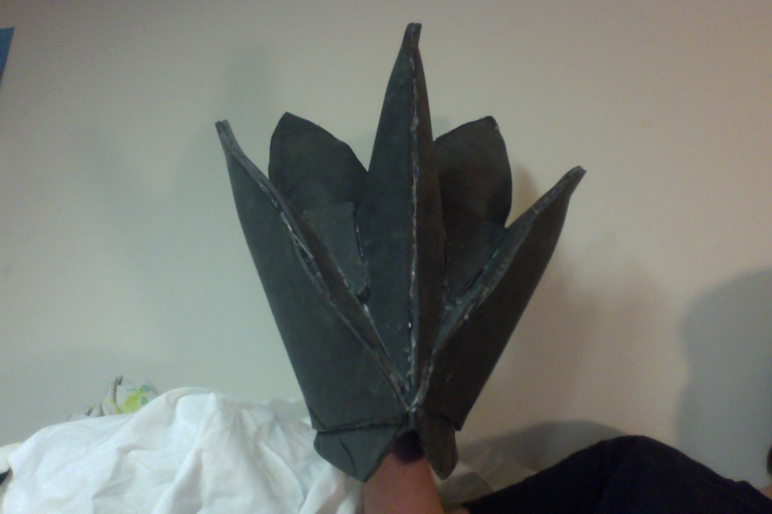

Here are some intermediary steps:
There's been a lot of evolution and revision in the design throughout the years. It looks a bit messed up in its current incarnation because at one point I thought I'd try to smooth out the shape by hot gluing thin sheets of EVA foam onto the surface, but then changed my mind and ripped them off.
The main structure, in my opinion, is basically done, minus the bottom section which I'm still finishing up. Specifically, the material I used is anti-fatigue floor mat. Cheap, cuttable, and comes in handy rolls. It's hot glued together, with the scraps stuffed into the pockets in the "fins" to keep their shape.

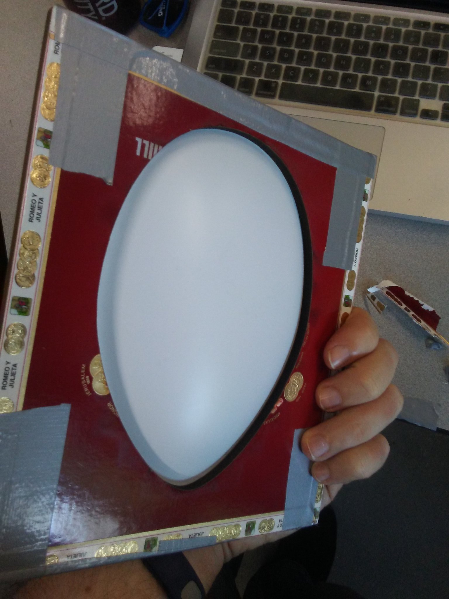

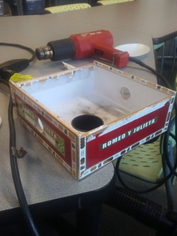

I made a makeshift vacuum forming box from a cigar box, mainly as a test, to form the face shape. I volunteer at a makerspace so I used the laser cutter there to cut out the hole in the box lid, used their heat gun to heat up the styrene, and their shop vac for the vacuum.
And, well…
I was so jazzed when this worked out. My first foray into vacuum forming. The extremely basic version of it, but still. But that was out of a .03" thick sheet, which seemed too thin, so I made another from the .06" sheet that I also bought.
