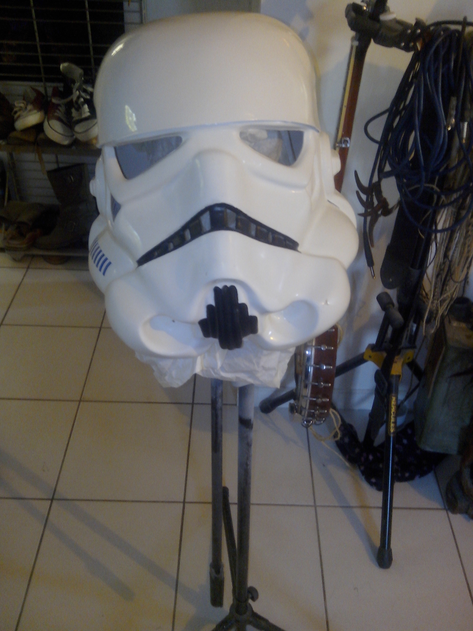

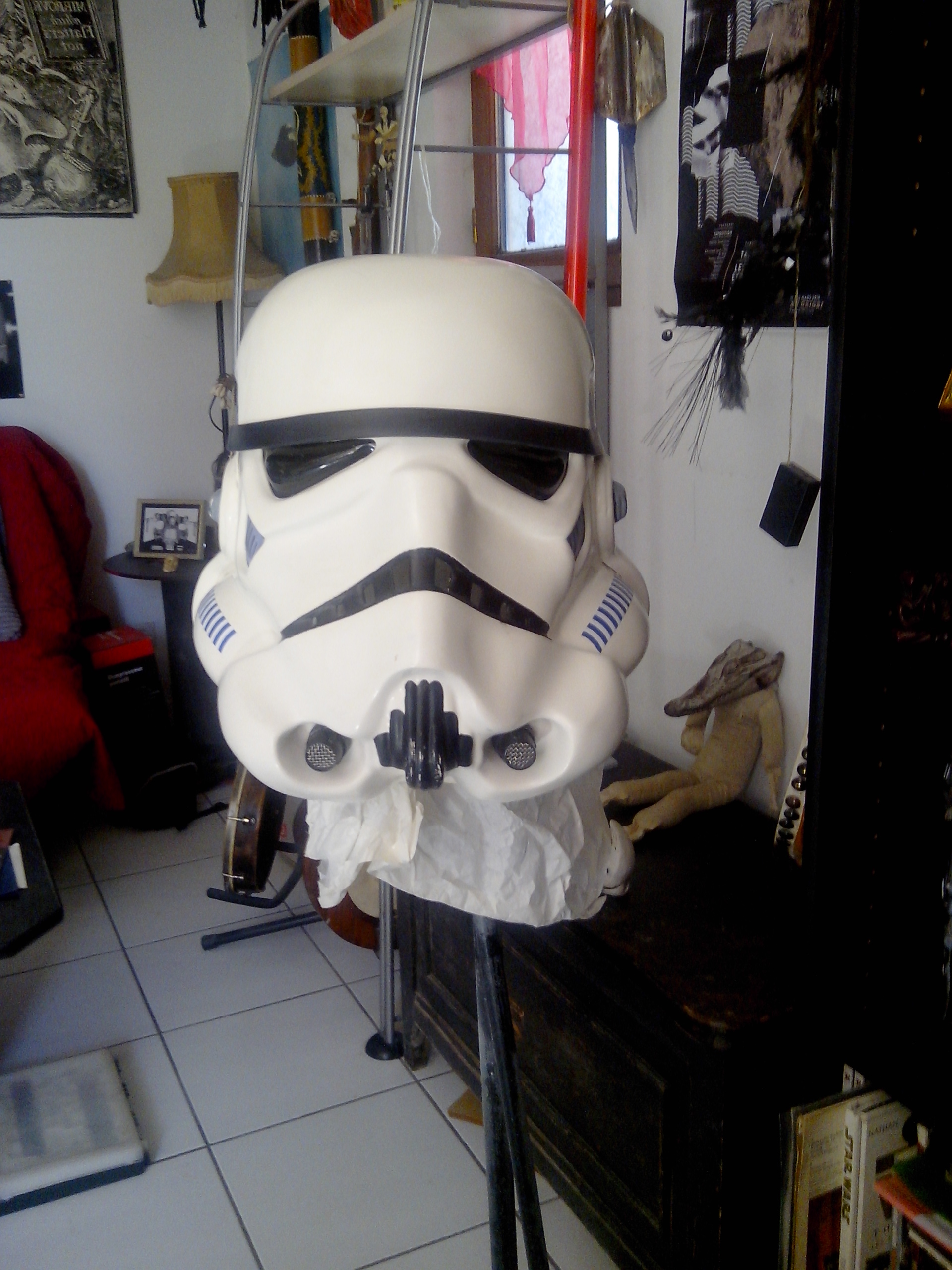

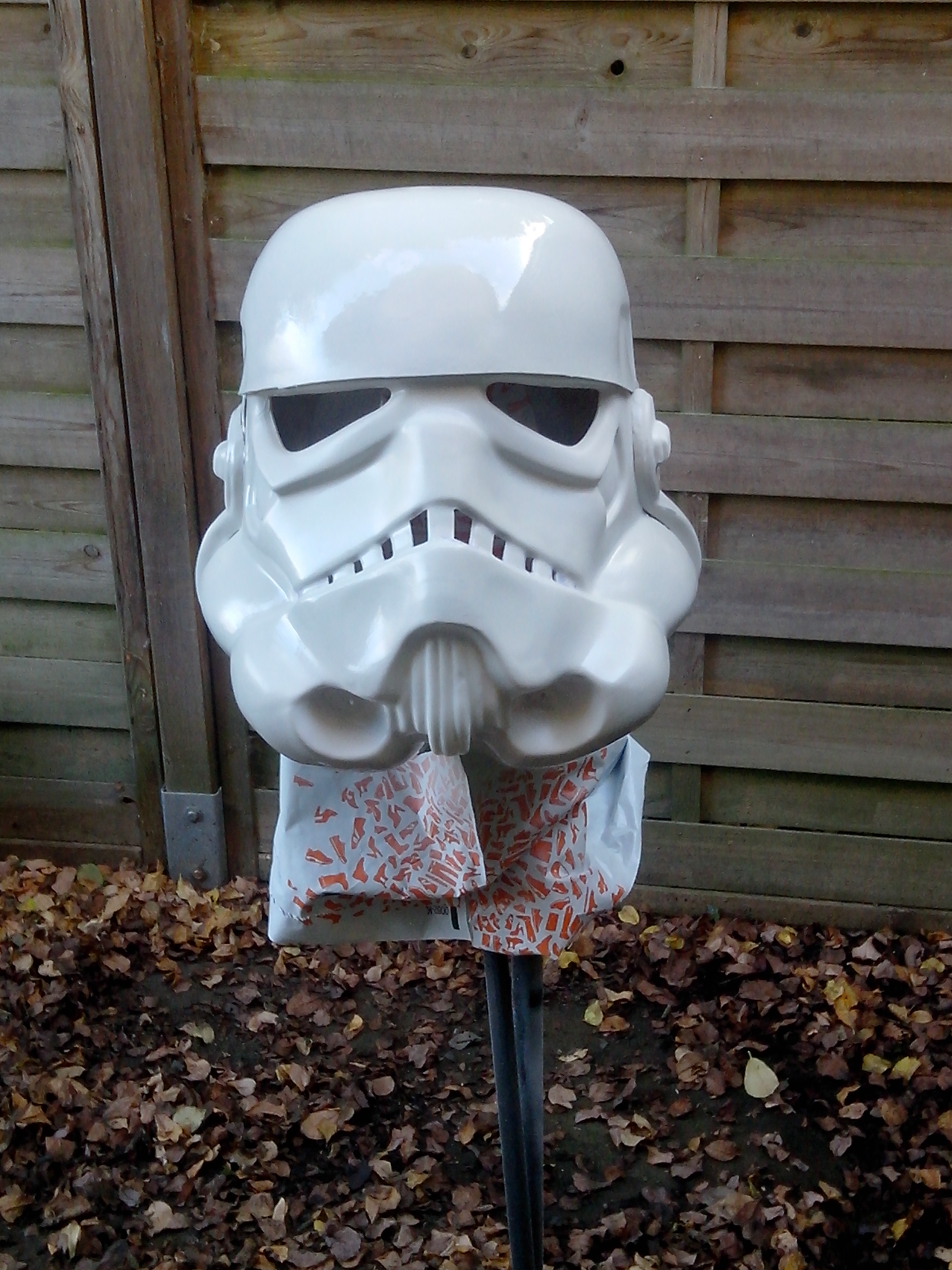

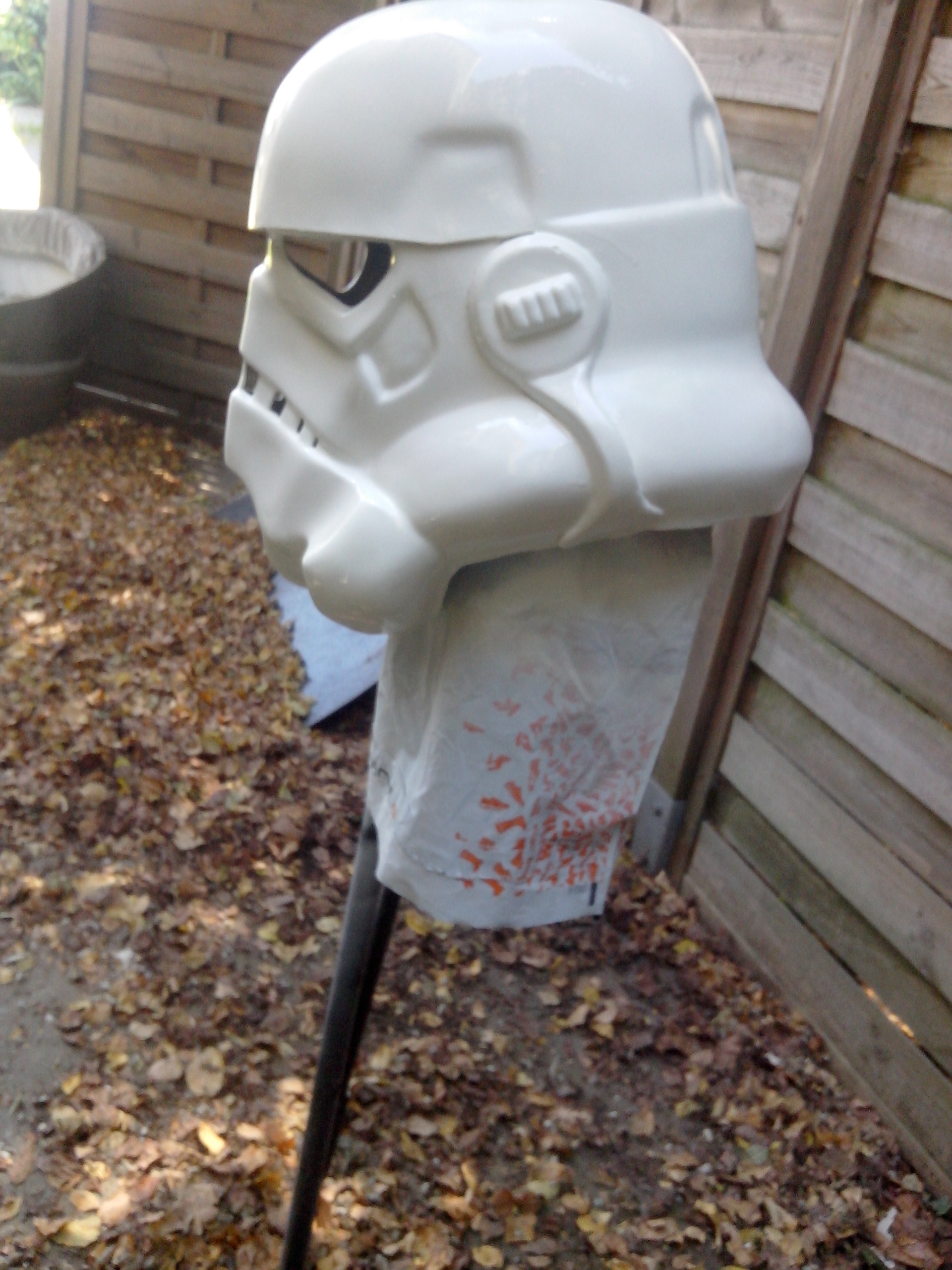

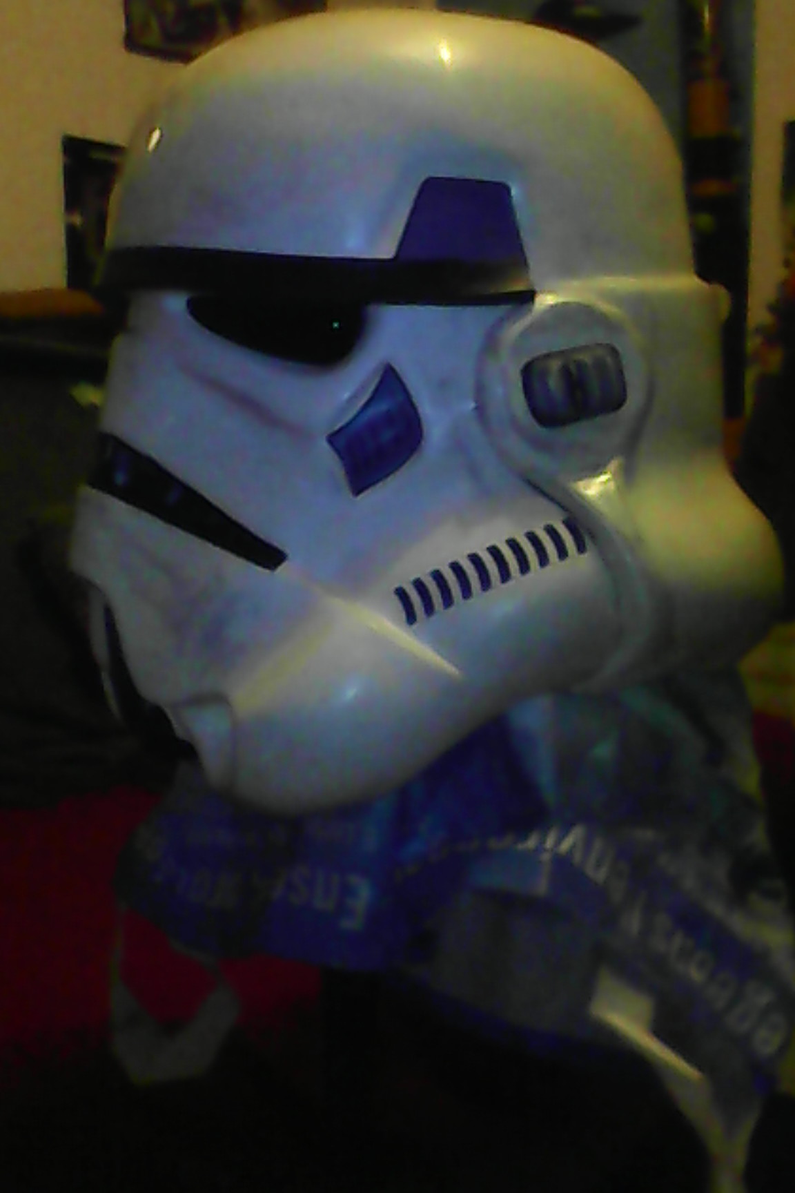

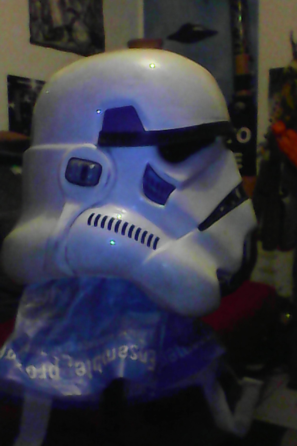

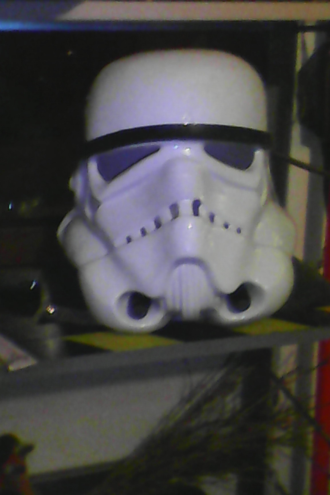

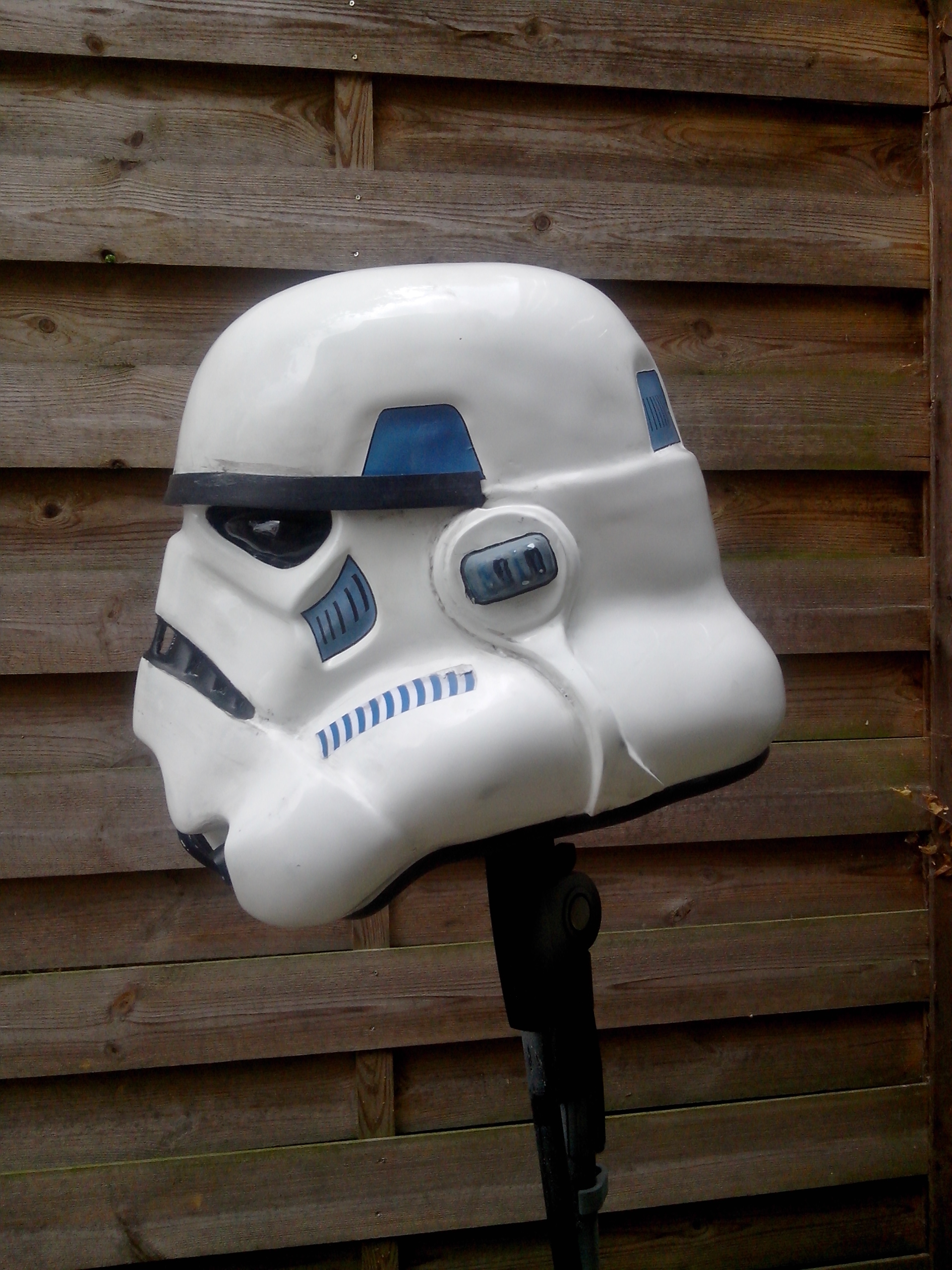

Two years later, after months and months of research, dust, work and trials, I ended up with that guy.
IMG_20160718_134332.jpgIMG_20160718_134415.jpgIMG_20160718_135023.jpgIMG_20160718_143847.jpgIMG_20160718_143903.jpgIMG_20160718_143927.jpg

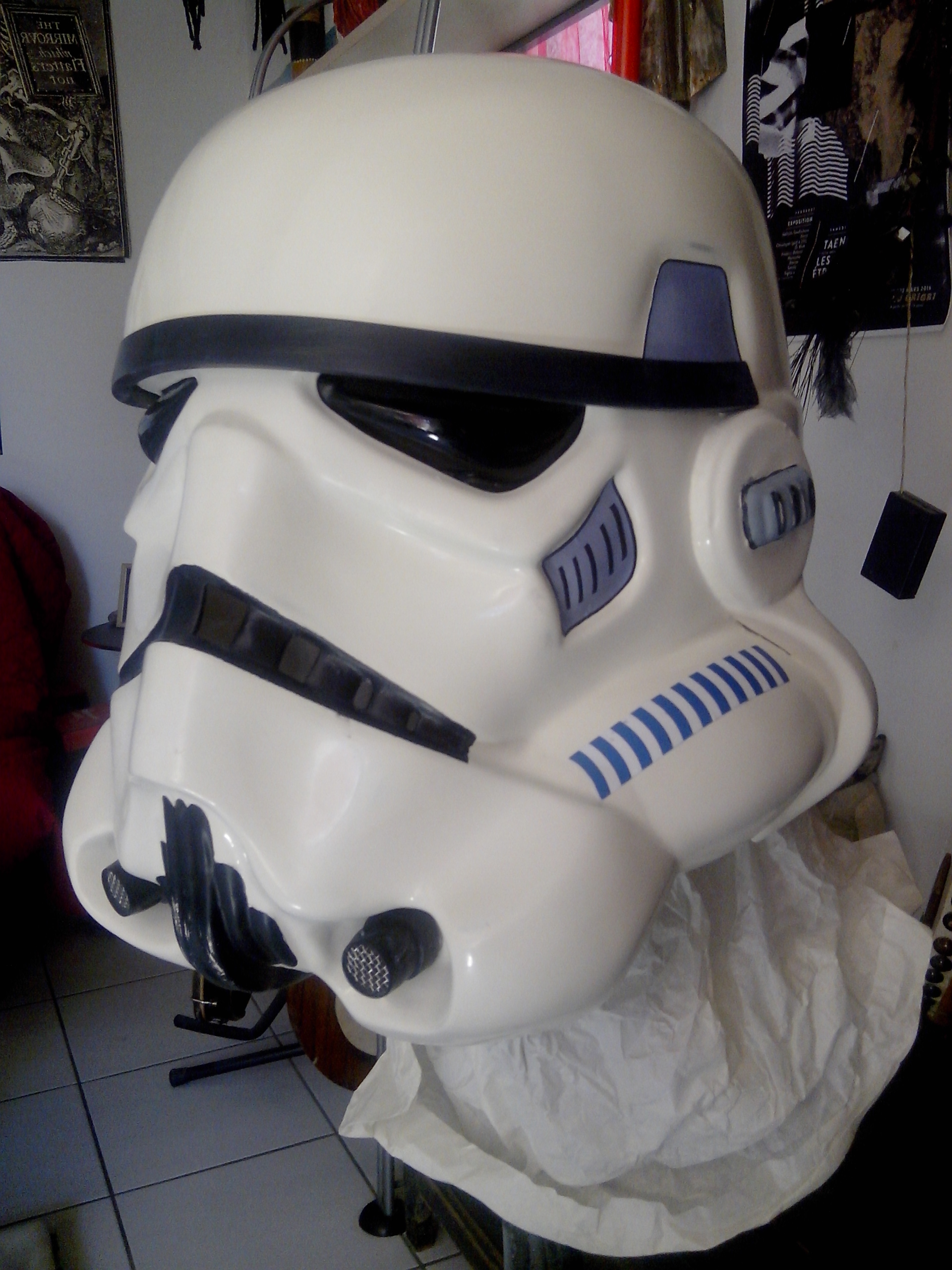

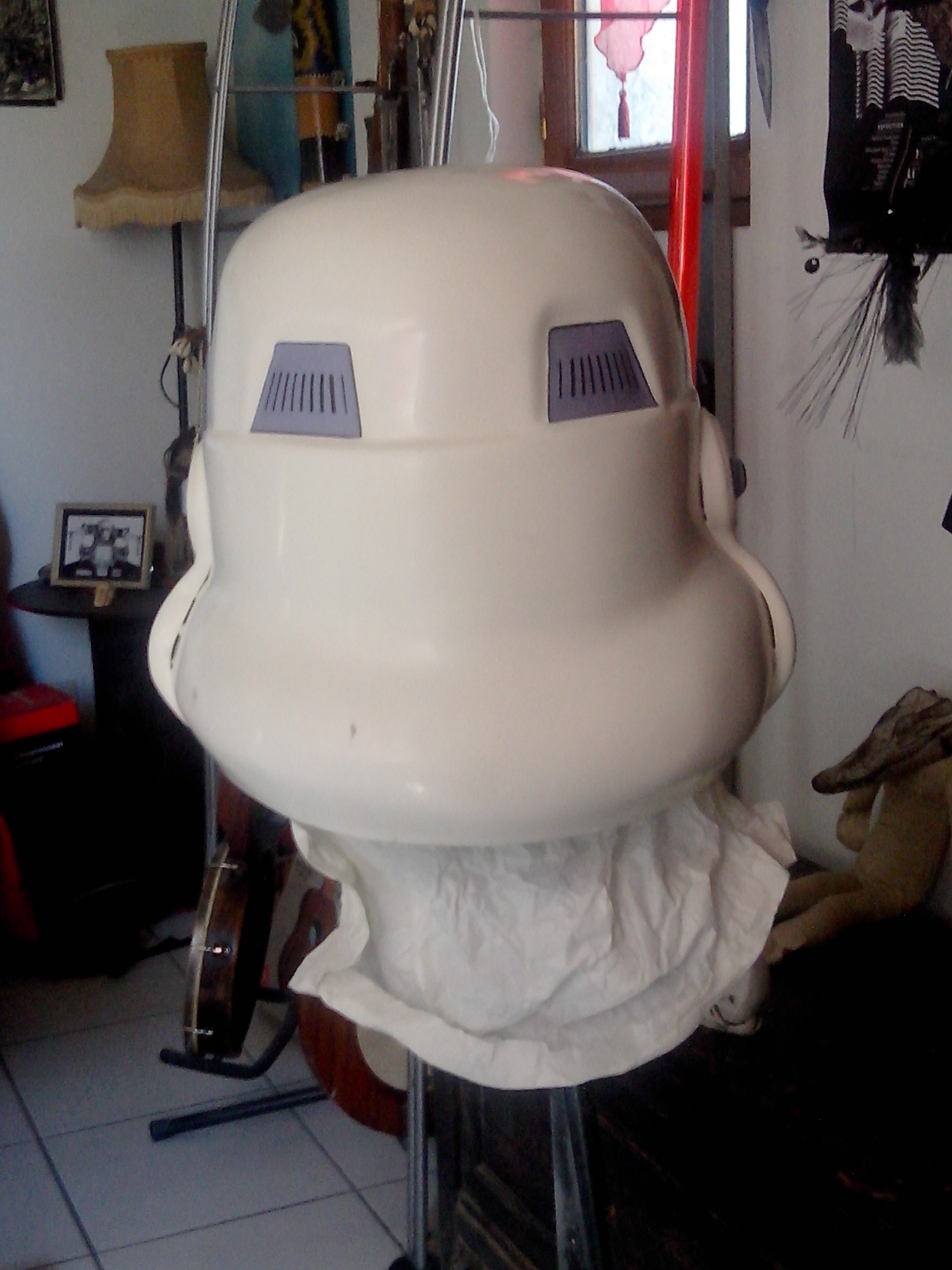

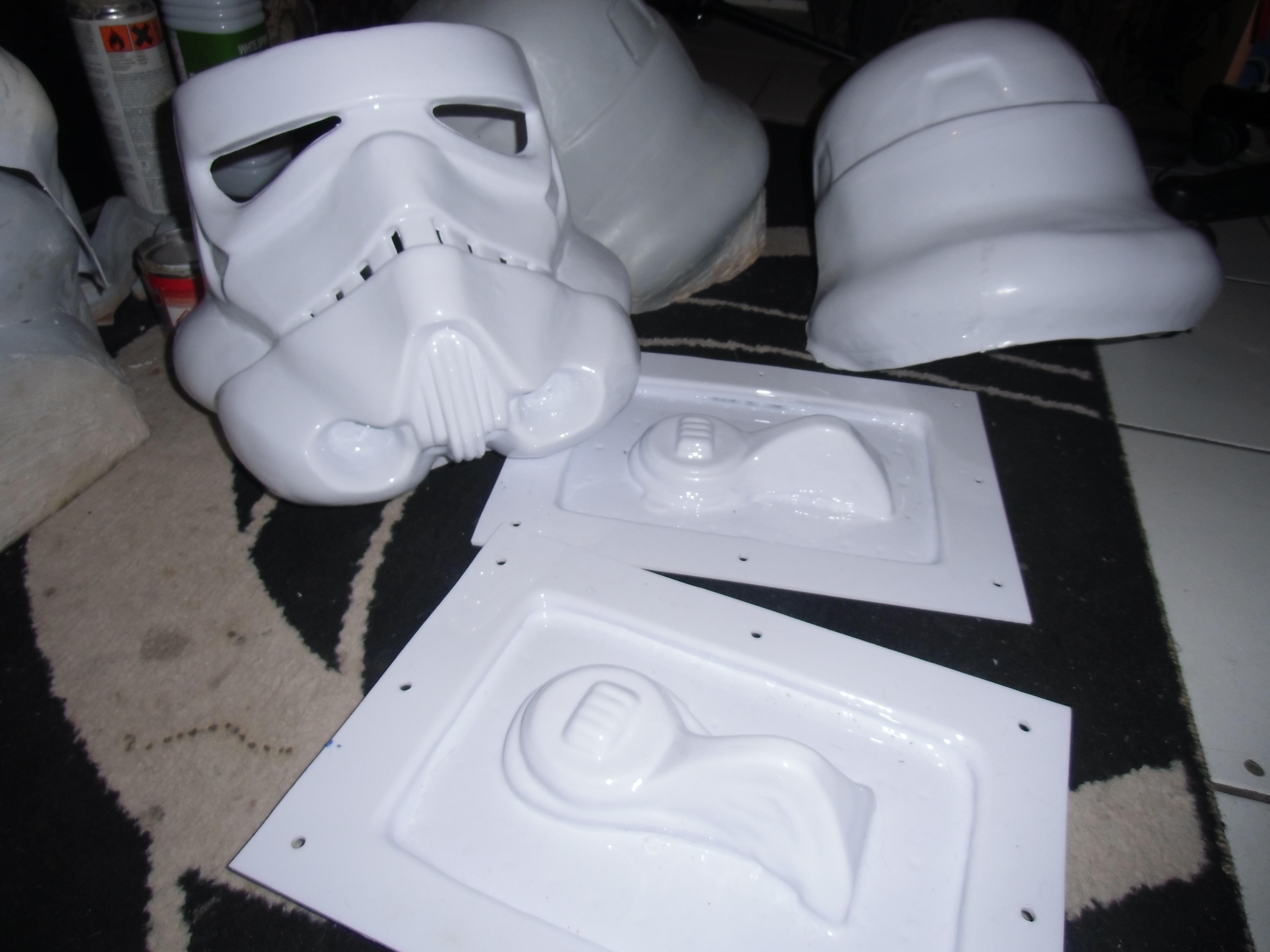

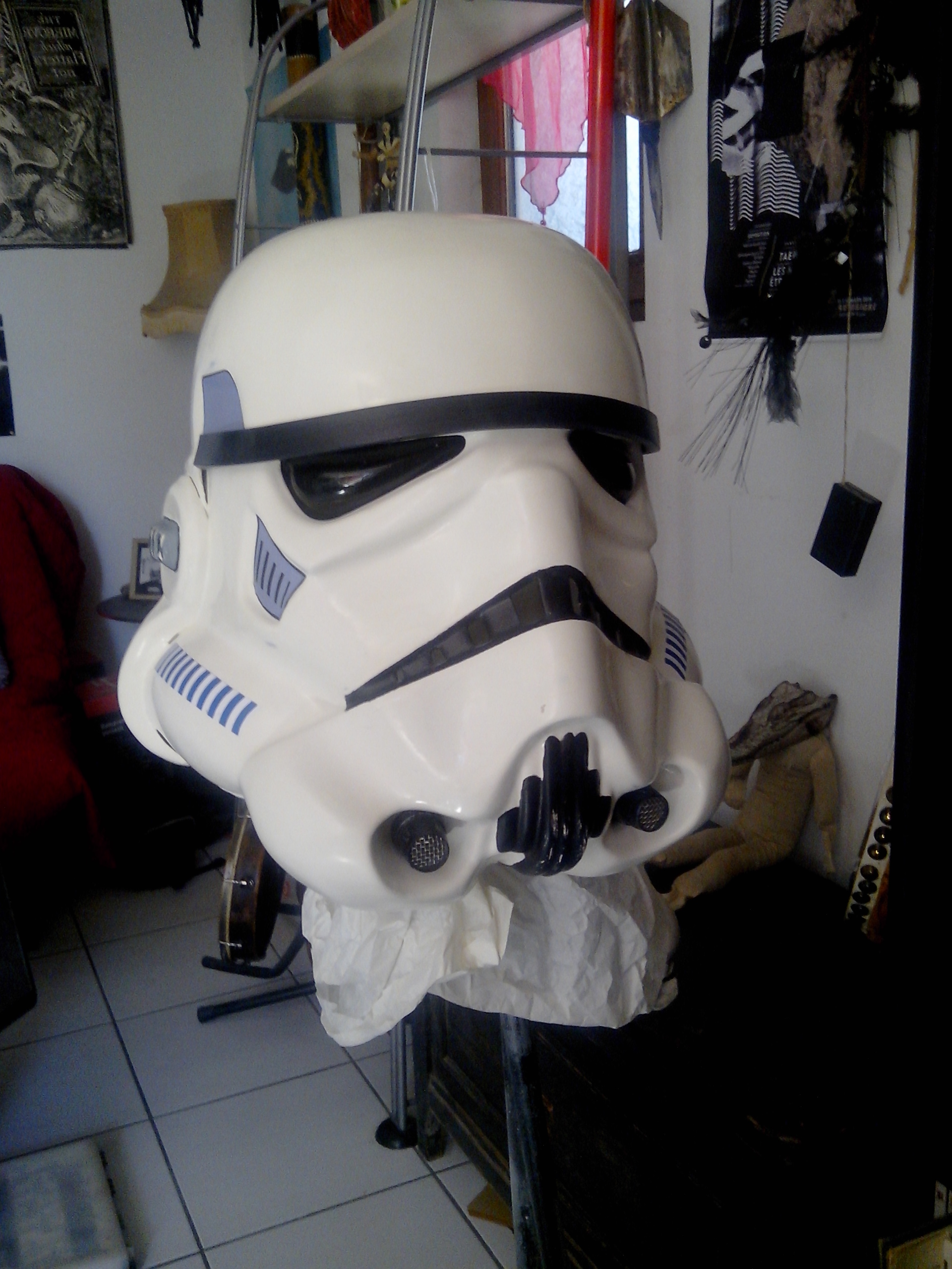

That helmet is made from four pieces of vacuum formed HIPS (back/cap, faceplate, ears). I painted it off white to match the ESB MKII from the propstore of london (I love that helmet).
I'm not truly obsessed with total screen accuracy so I was pretty happy with it.

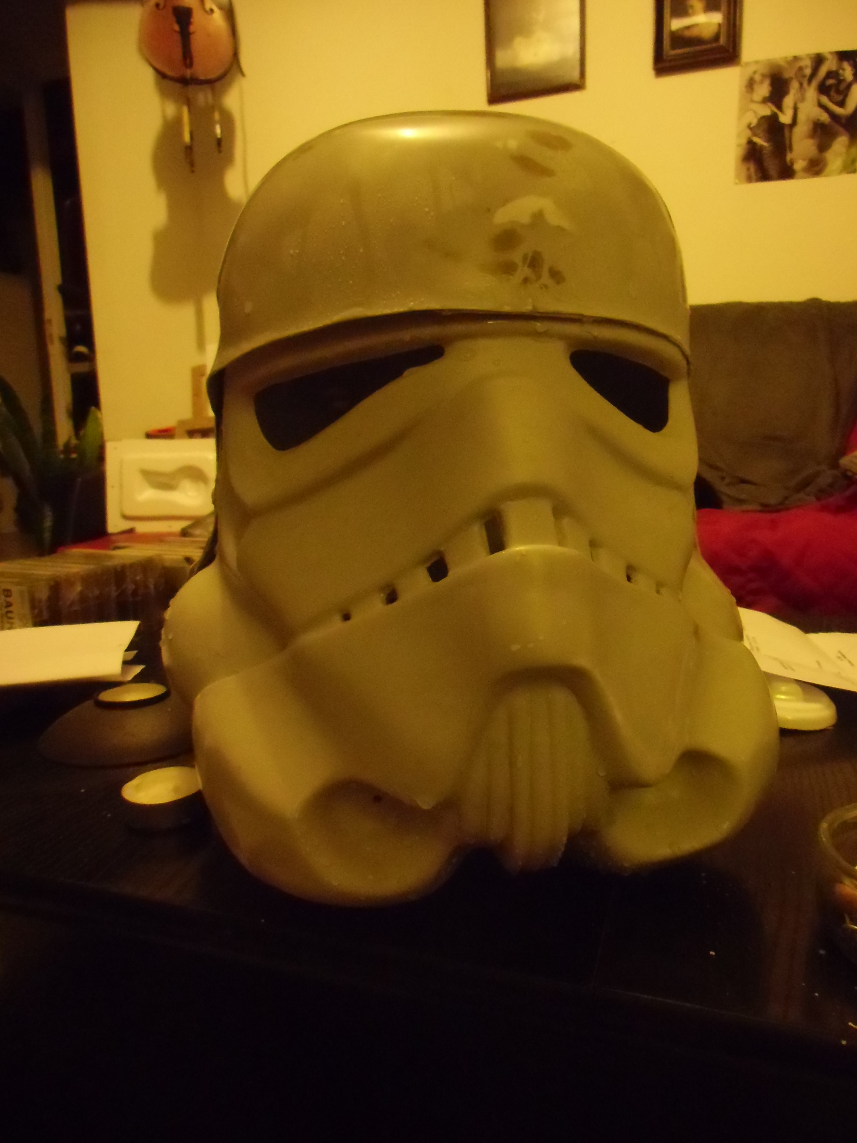

some progress pics:

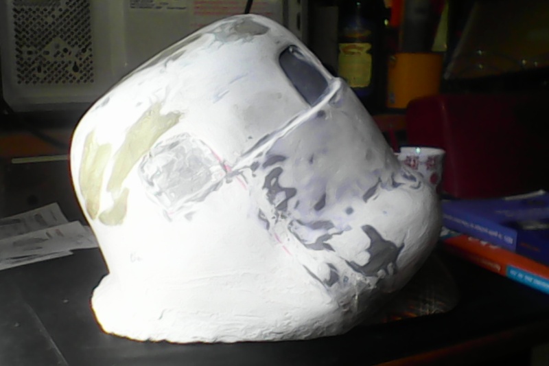

first I had that pretty sad pepakura attempt.

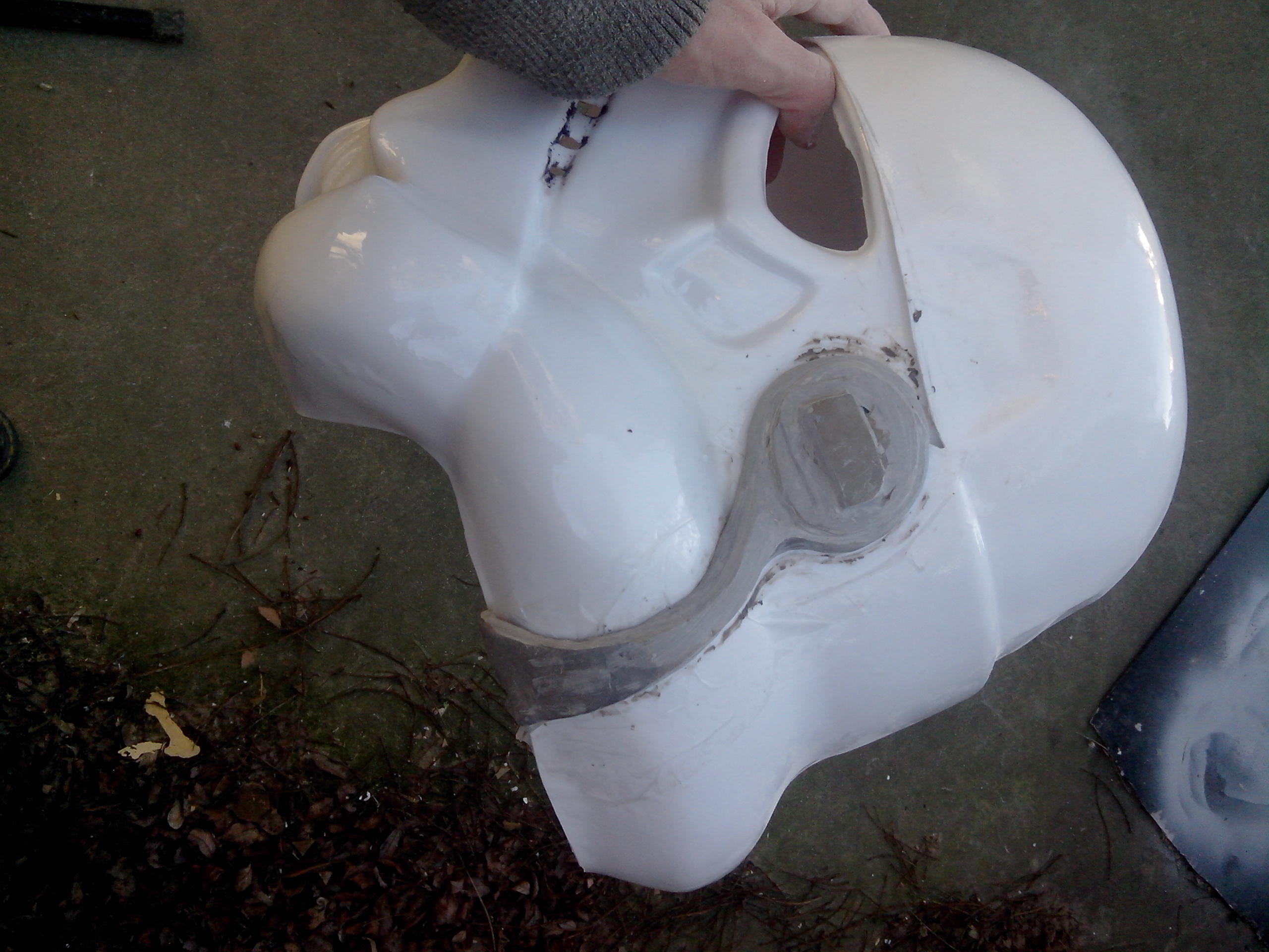

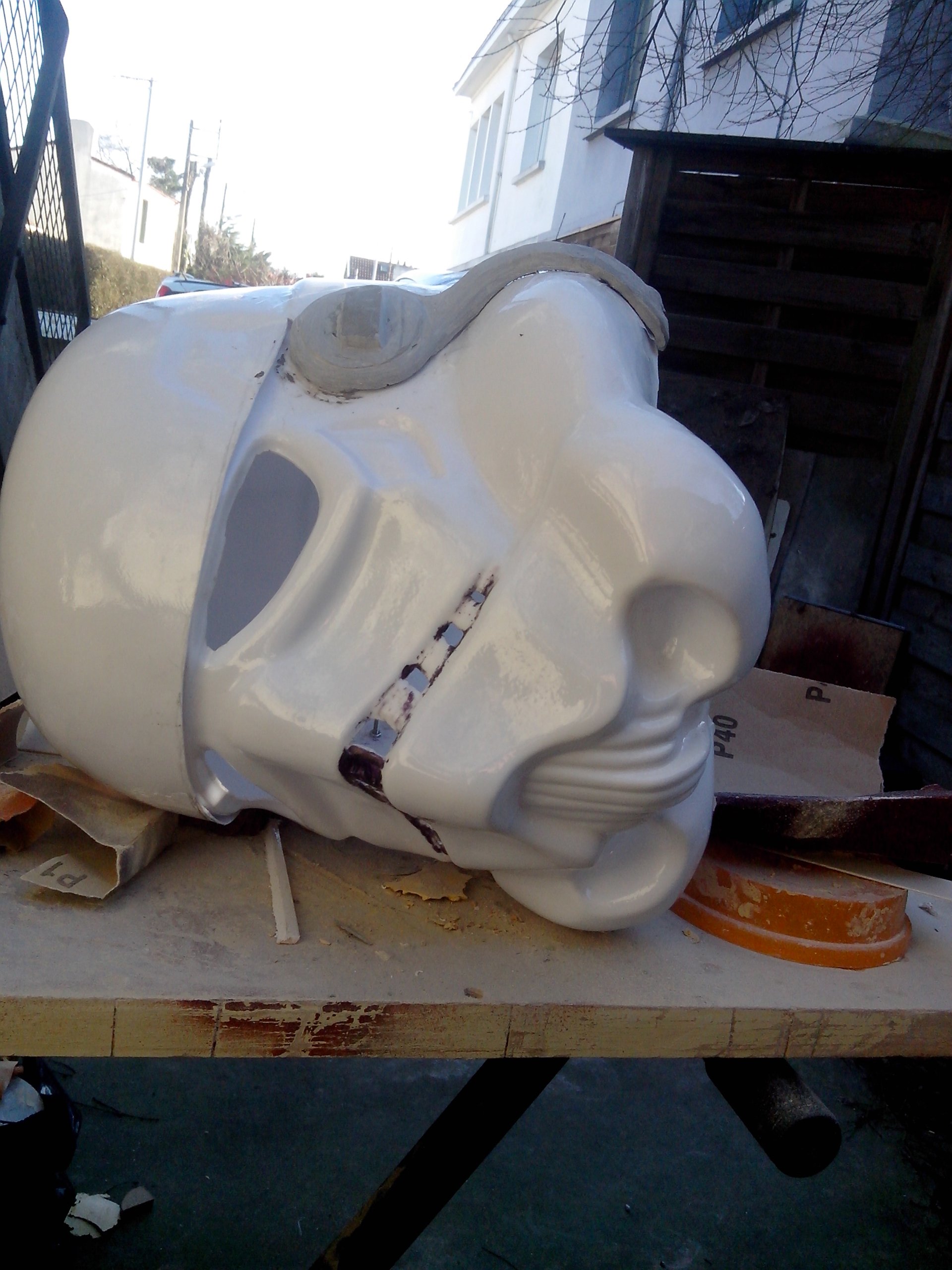

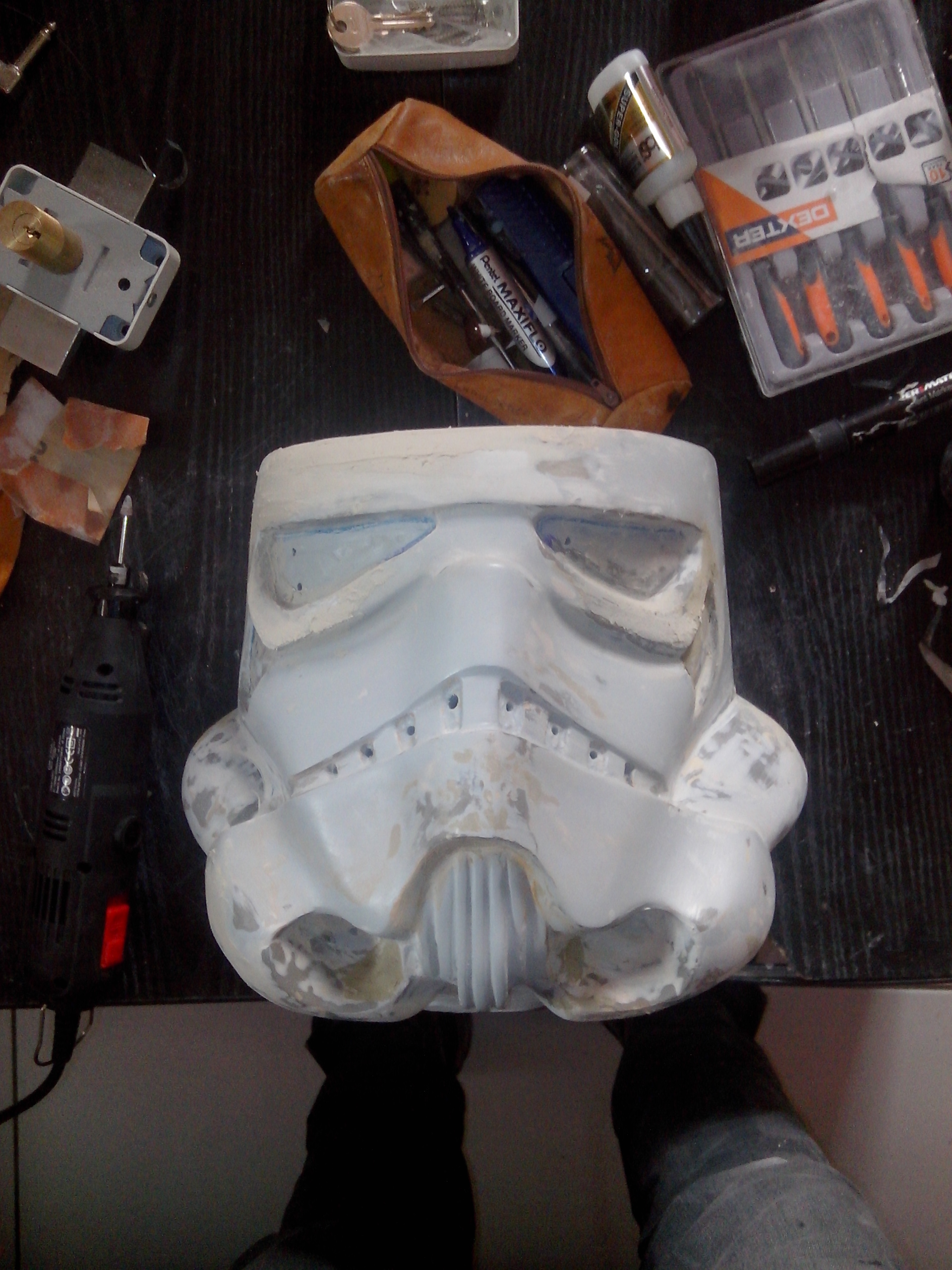

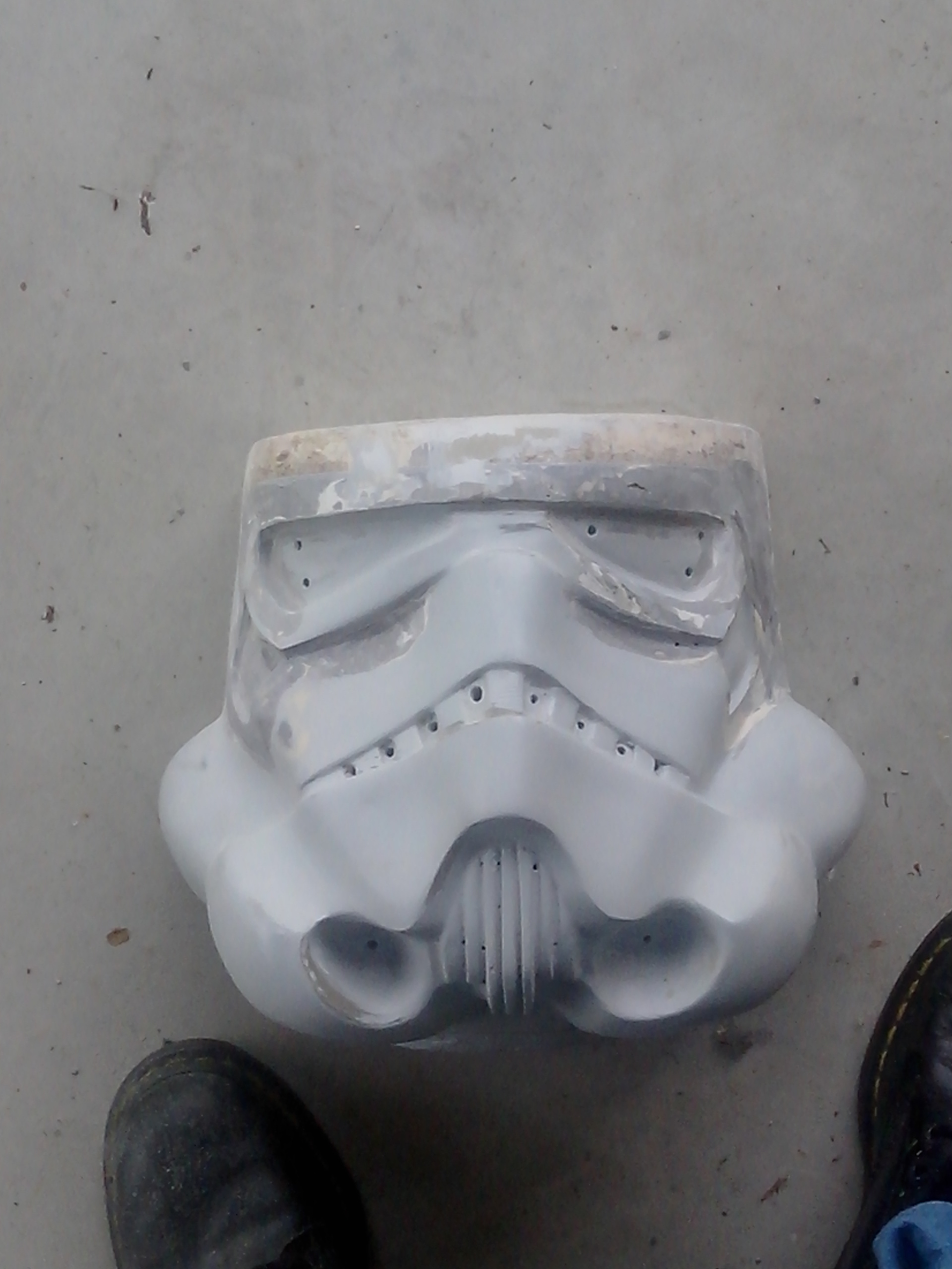

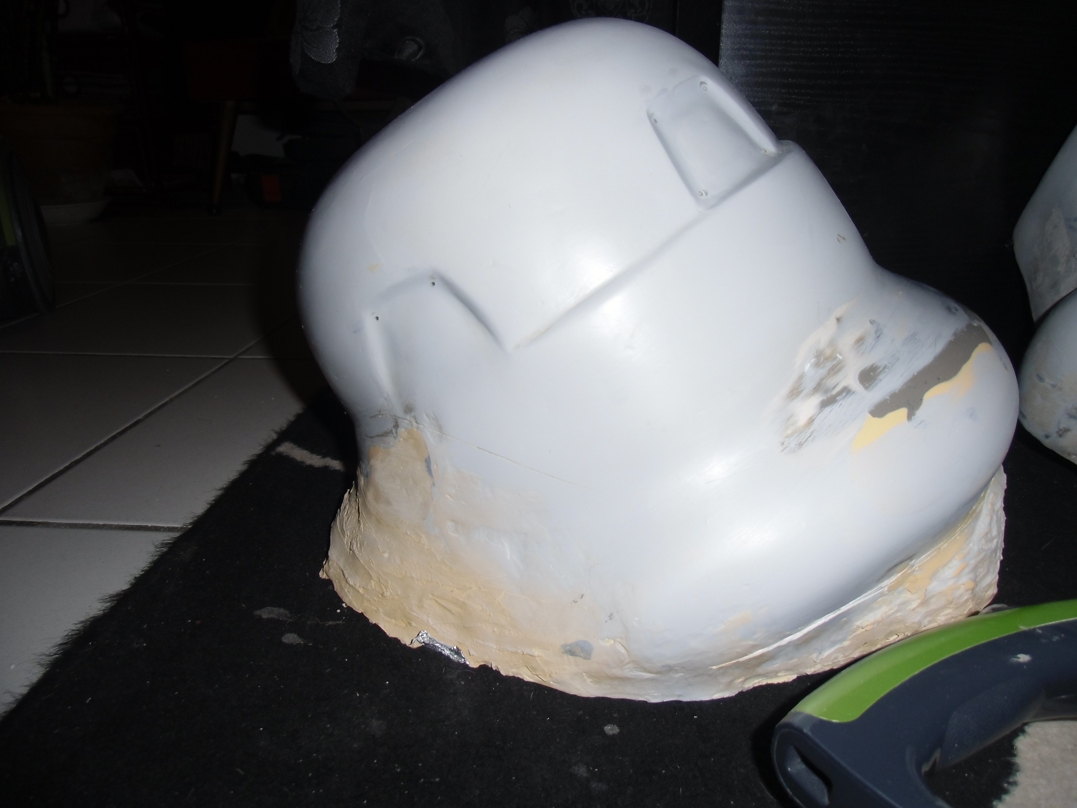

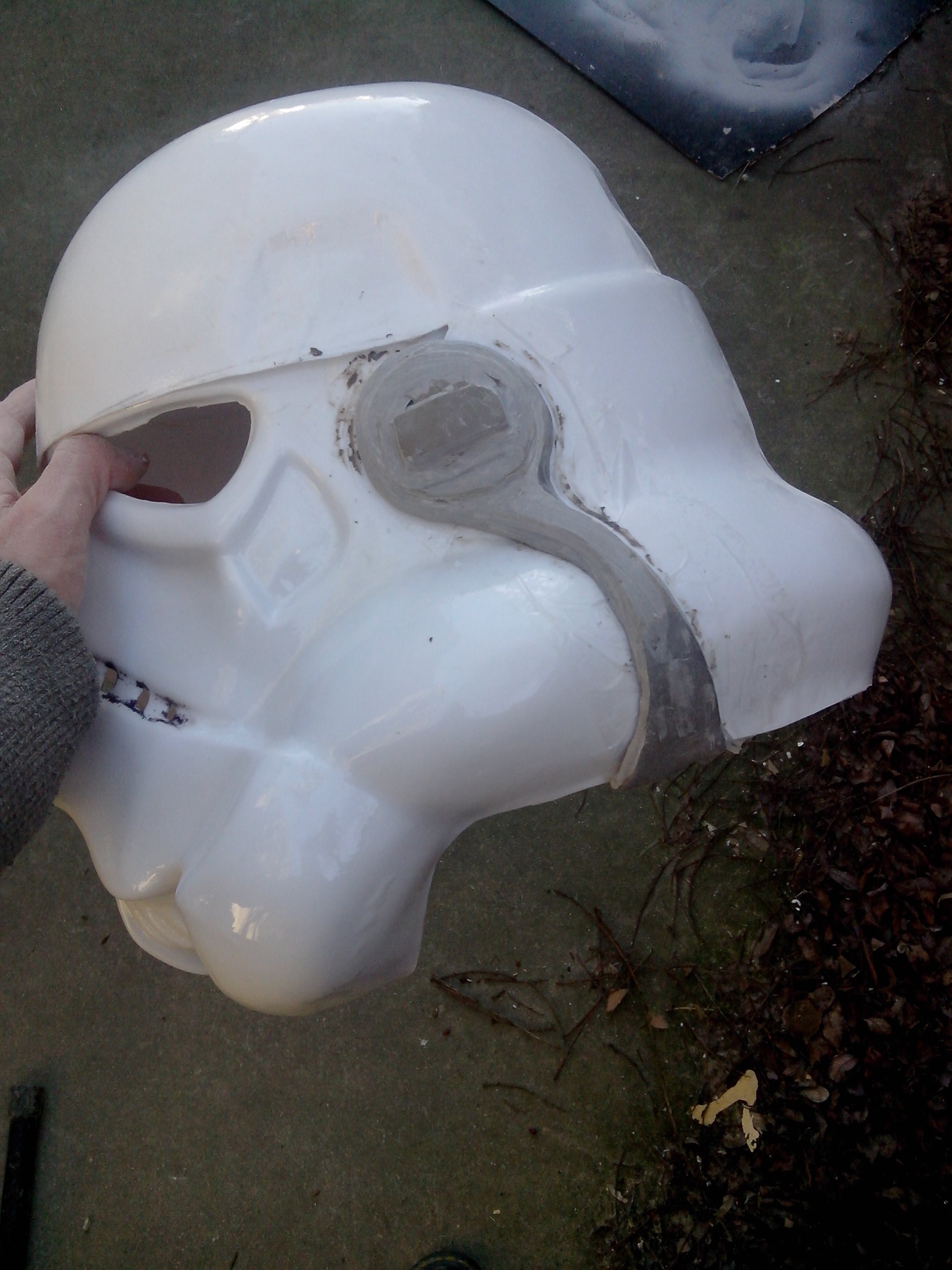

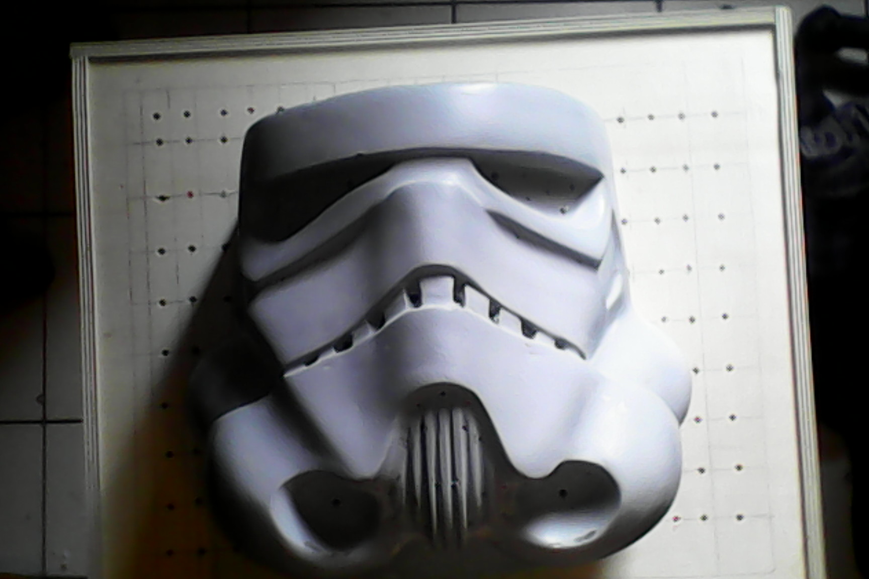

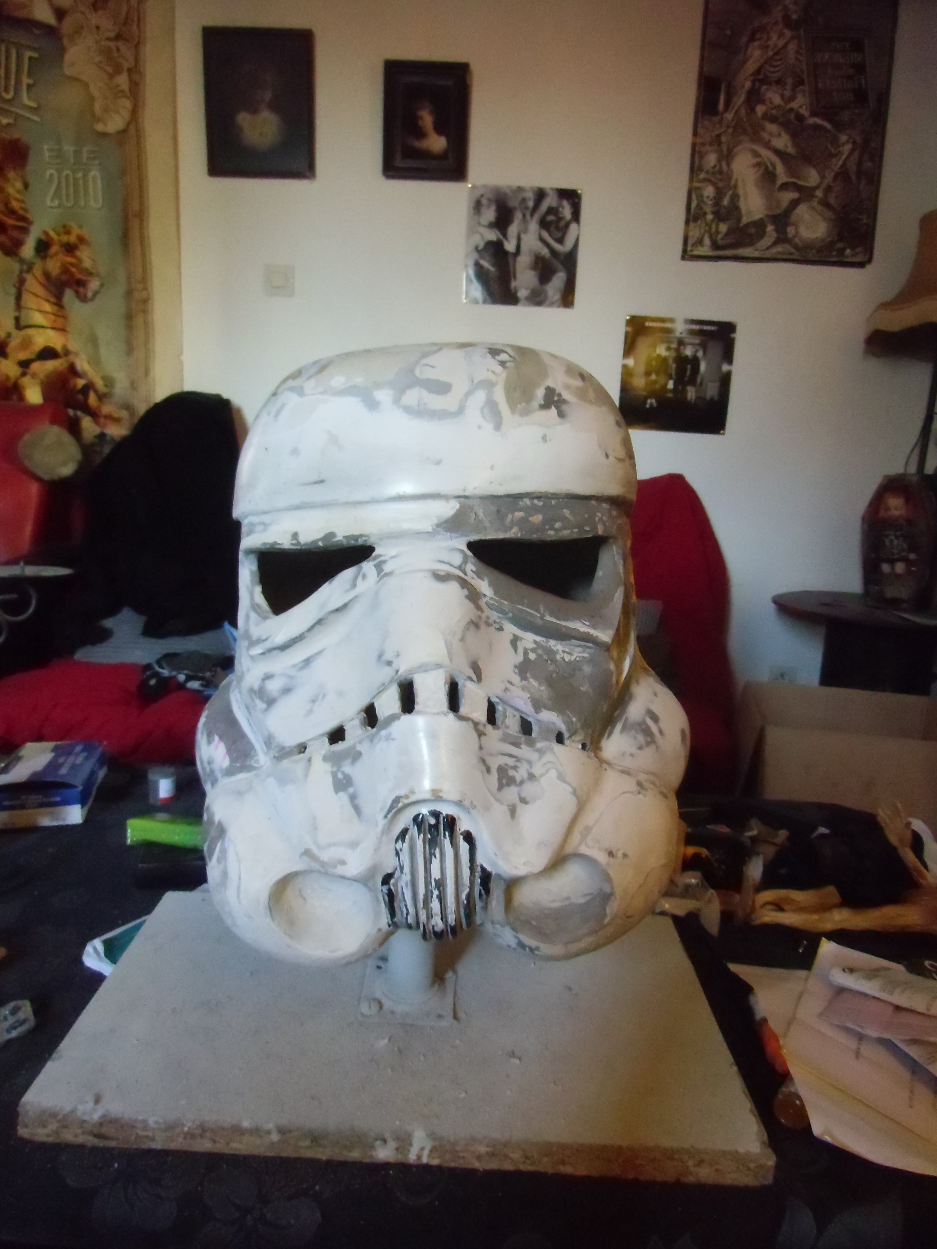

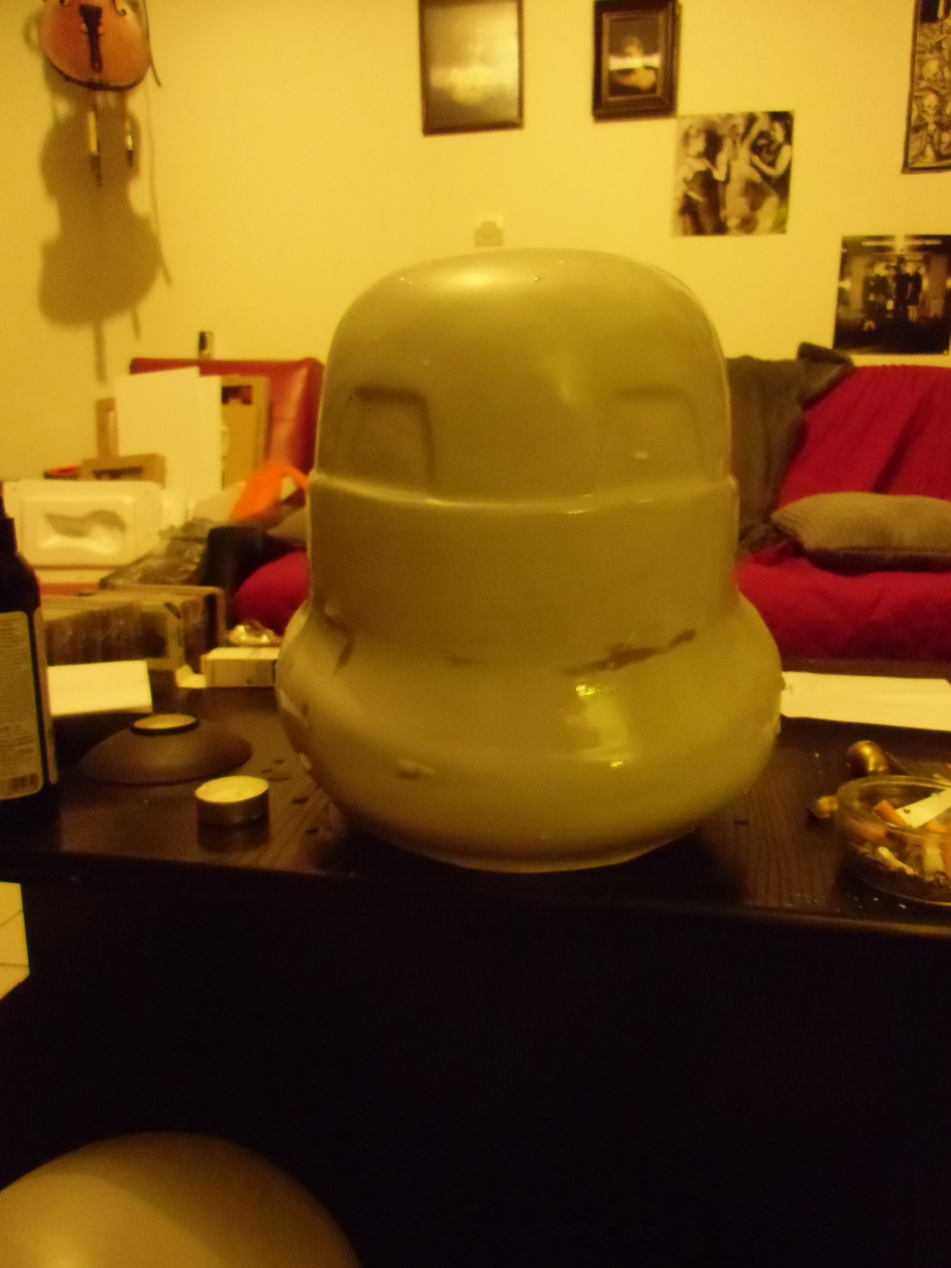

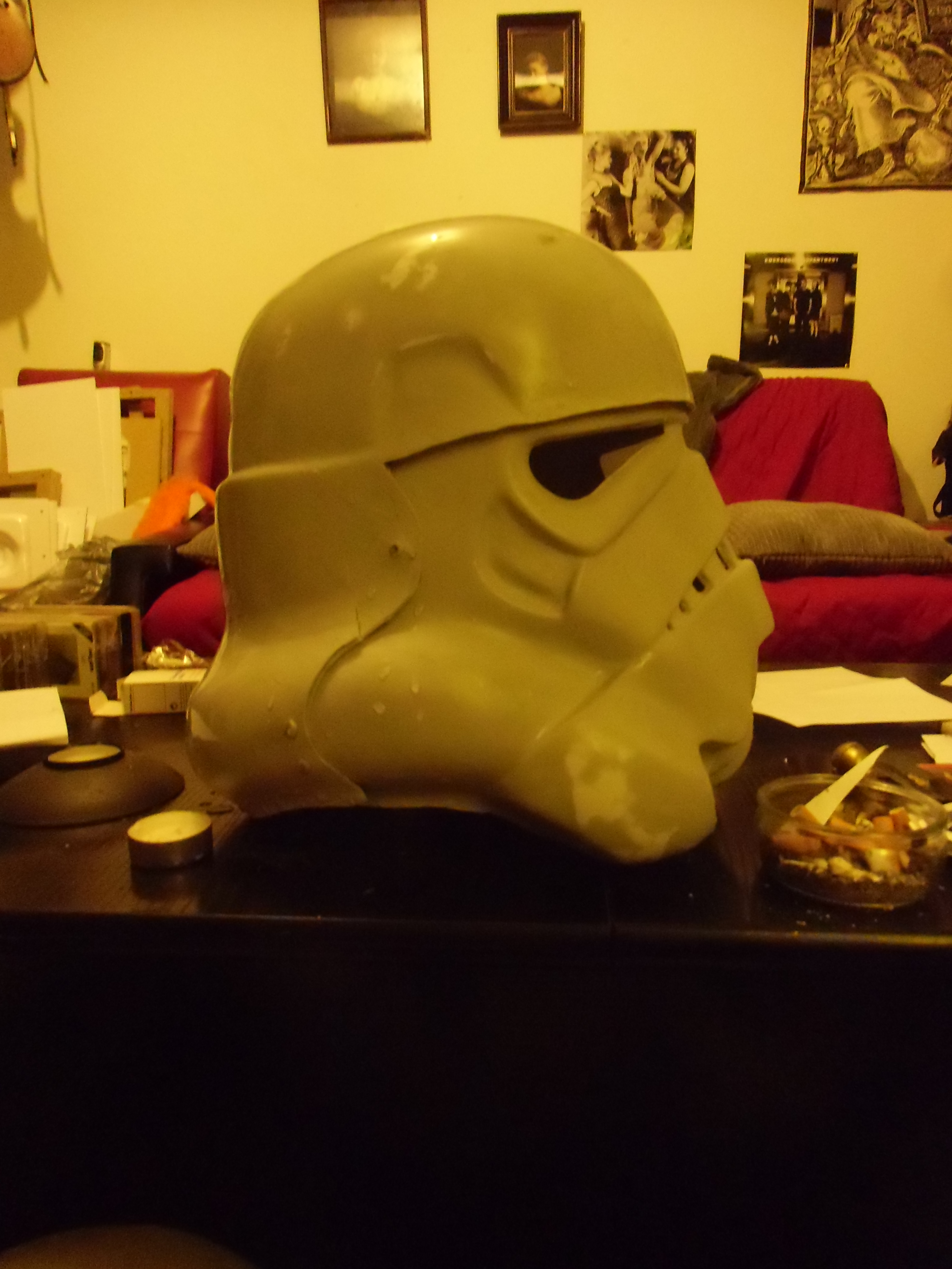

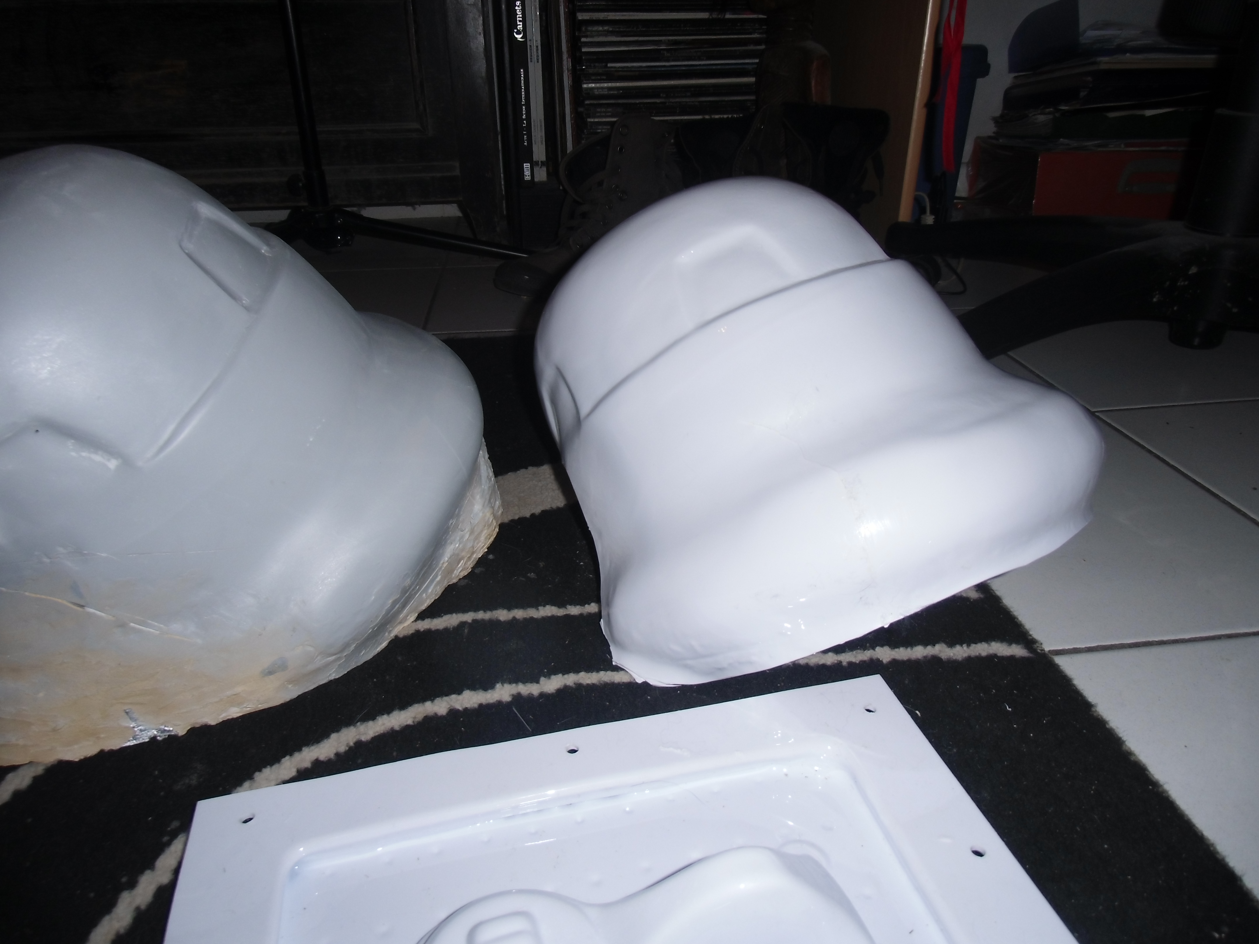

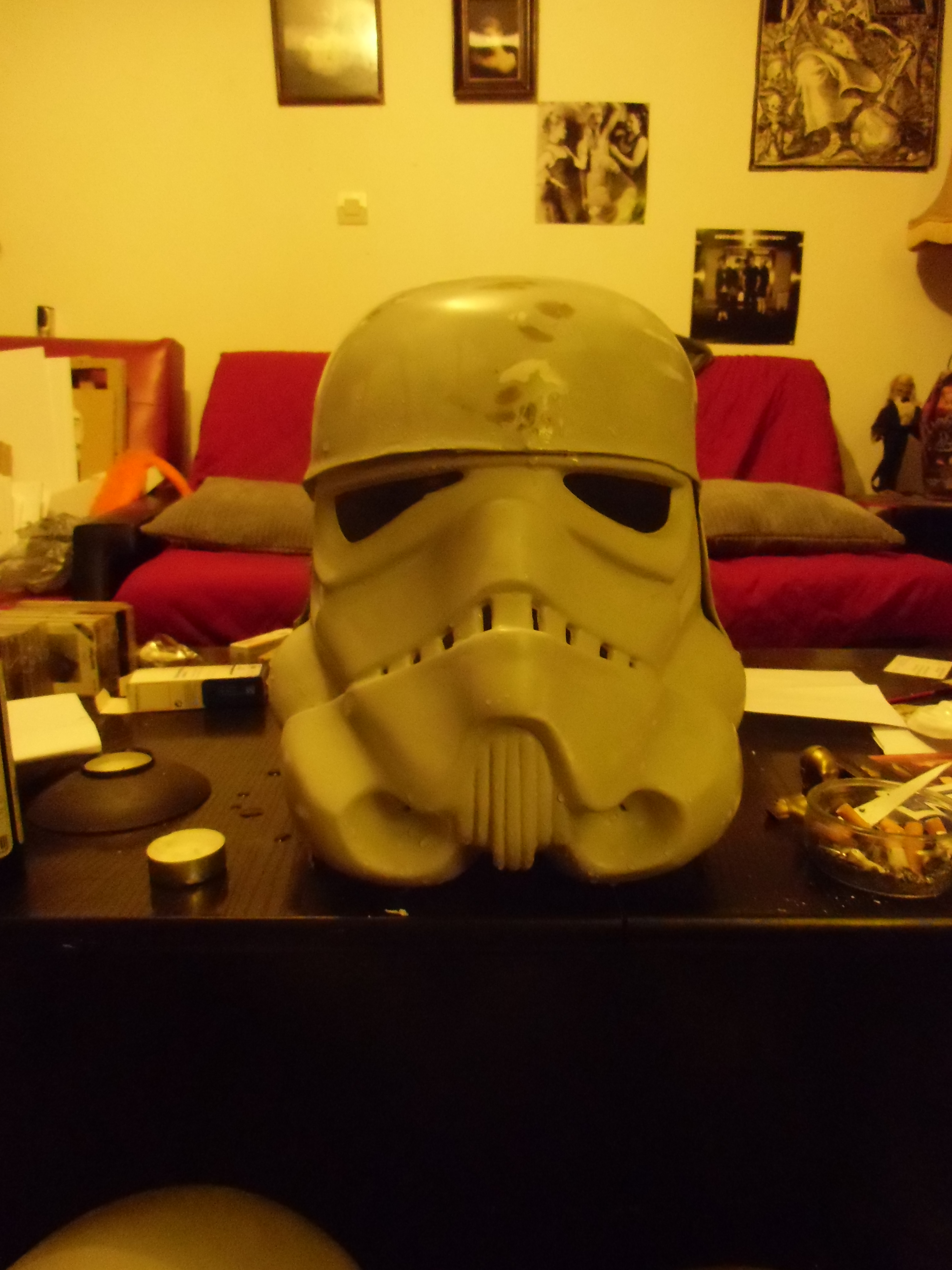

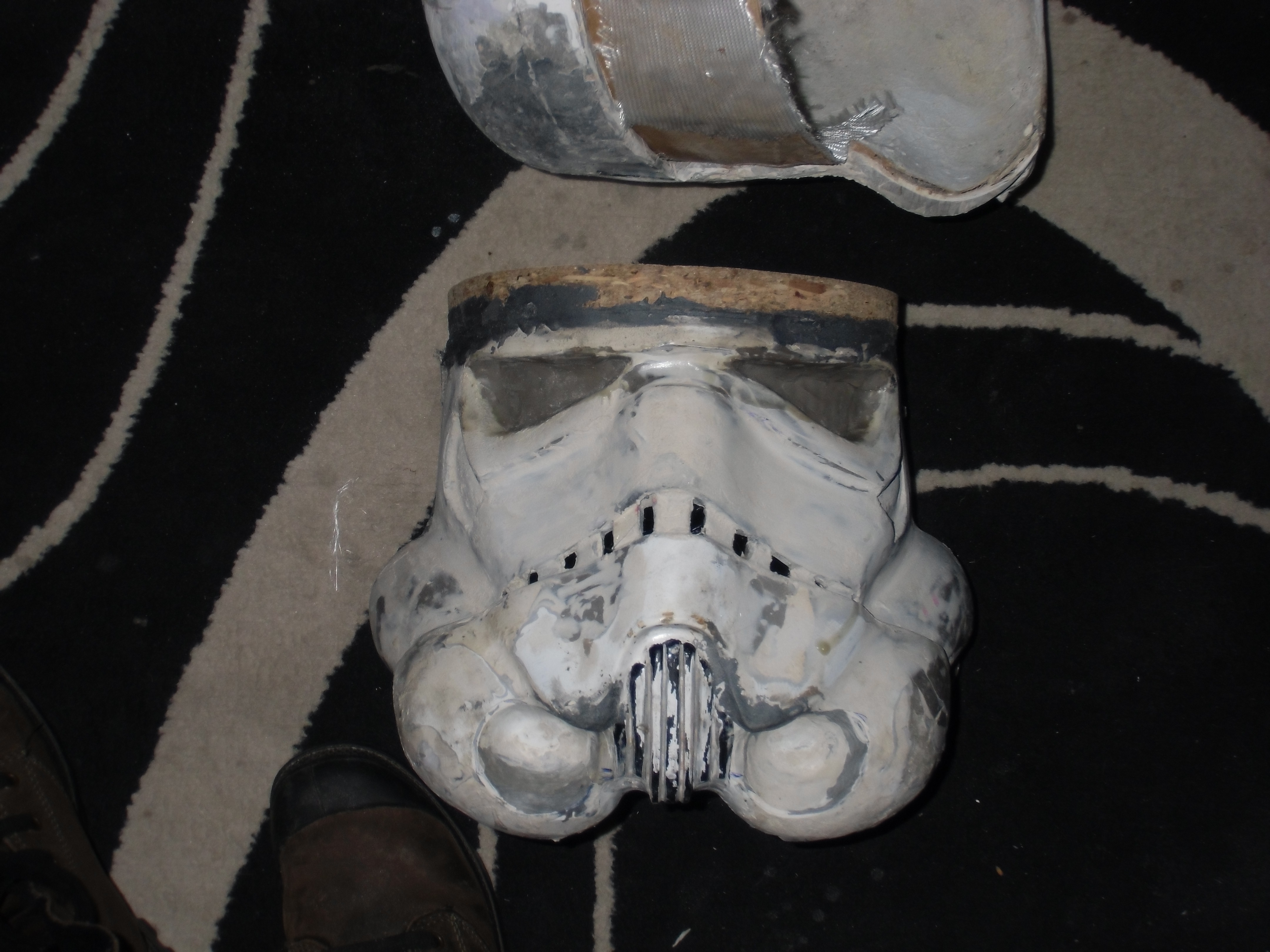

I took it as base to sculpt vacuum form bucks. I separate the helmet in two pieces and started to fill the blank parts with whatever I could find (fiberglass, bondo, wood, cardboard, resin, epoxy putty)

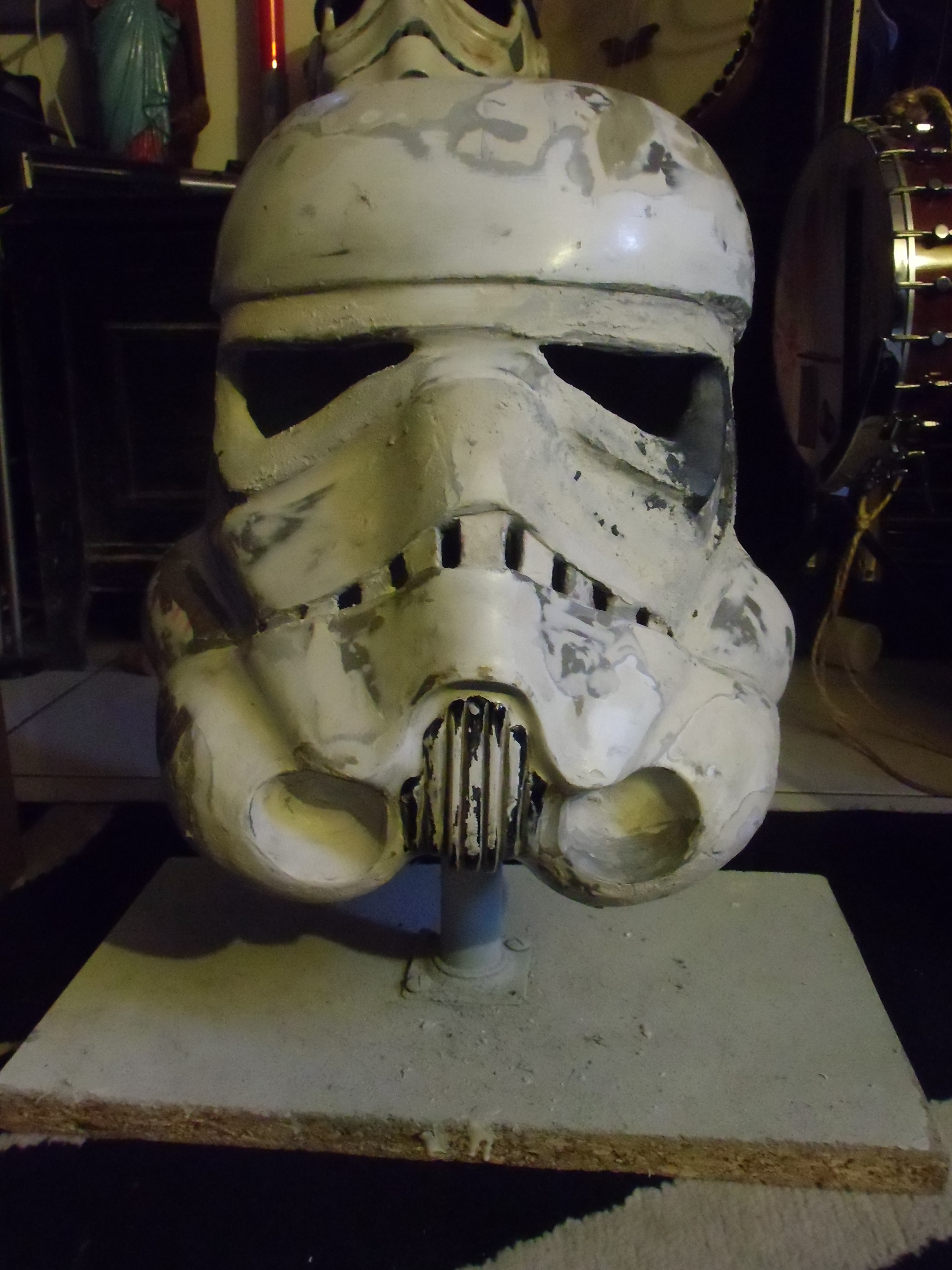

Here started the painful part of the process: sanding, sanding, sanding, bondoing, sanding, comparison pics, then resculpting, bondoing, sanding, sanding, sanding.....

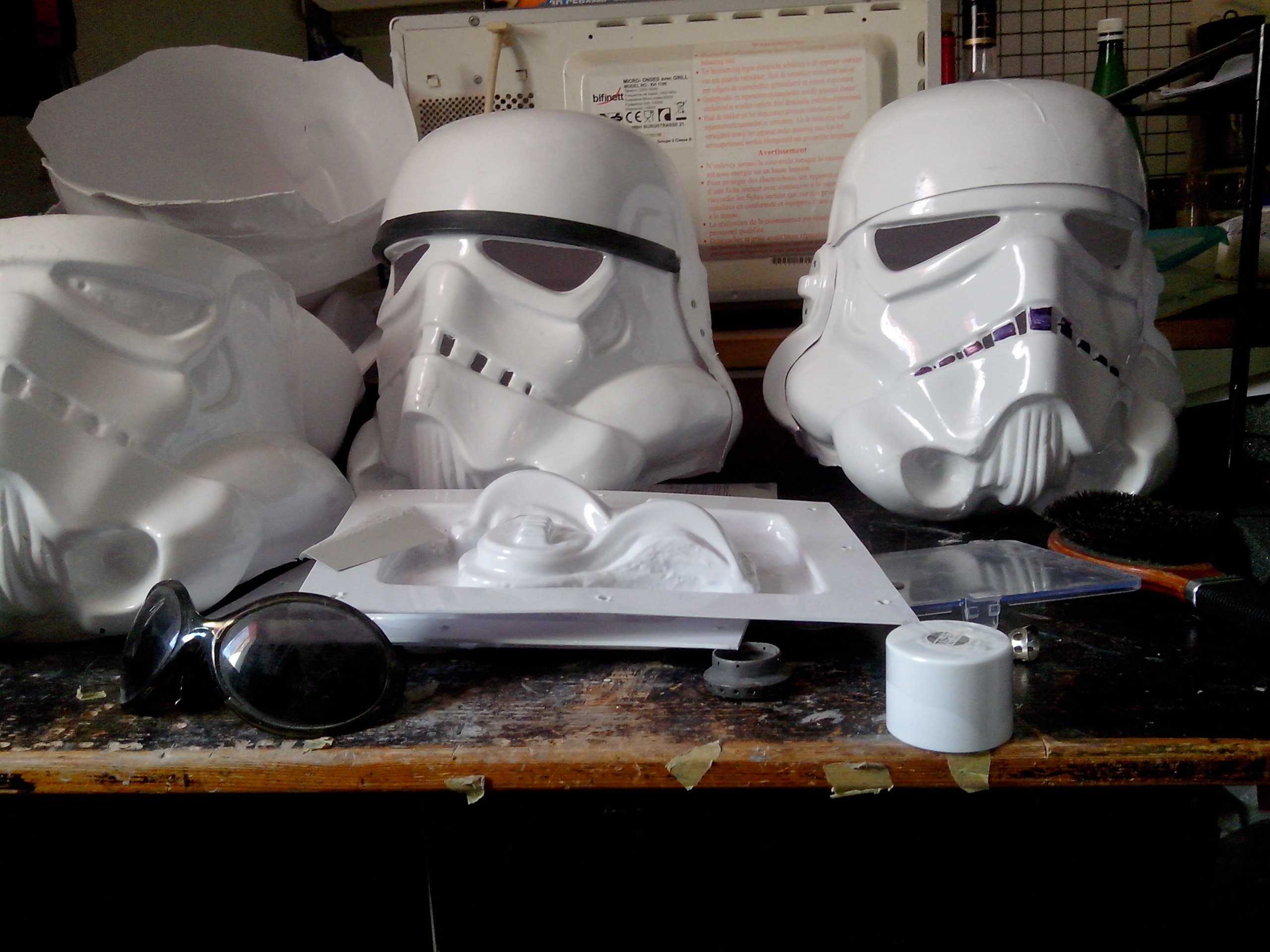

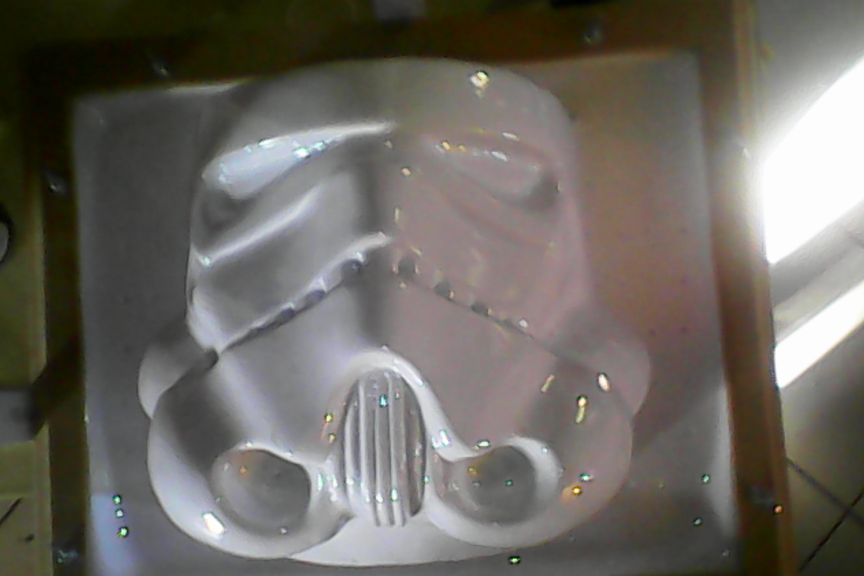

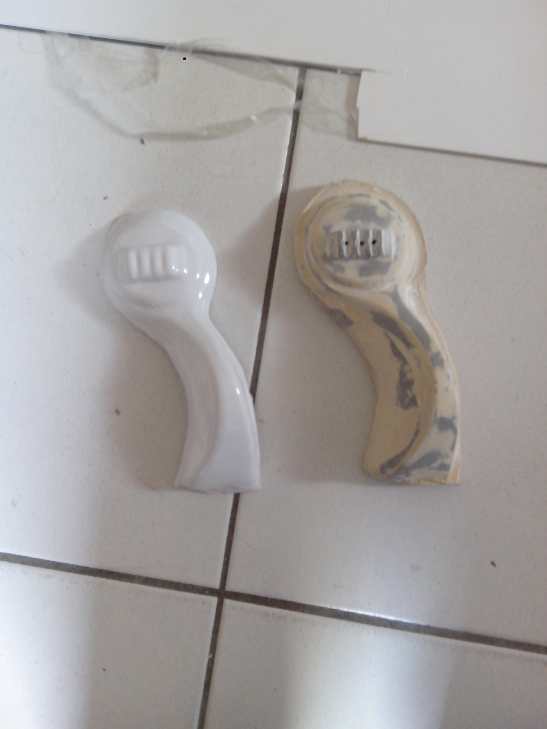

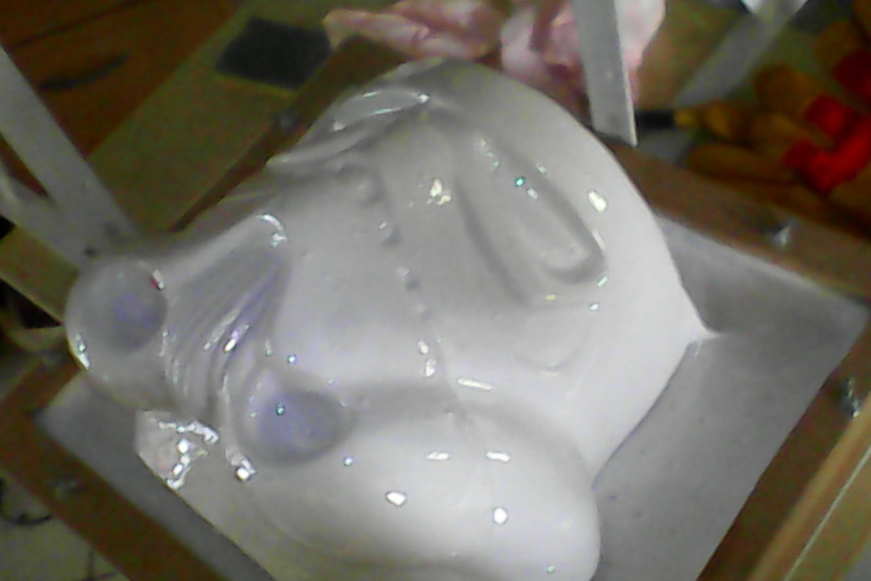

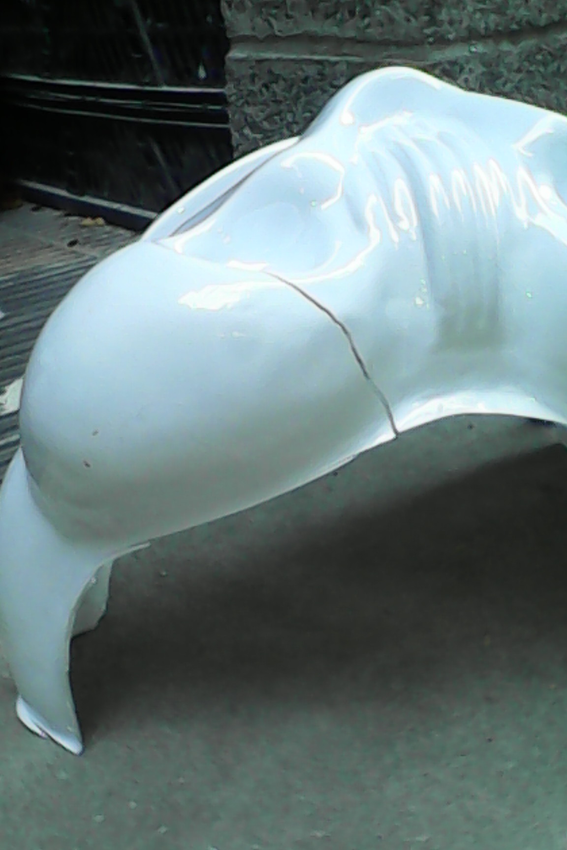

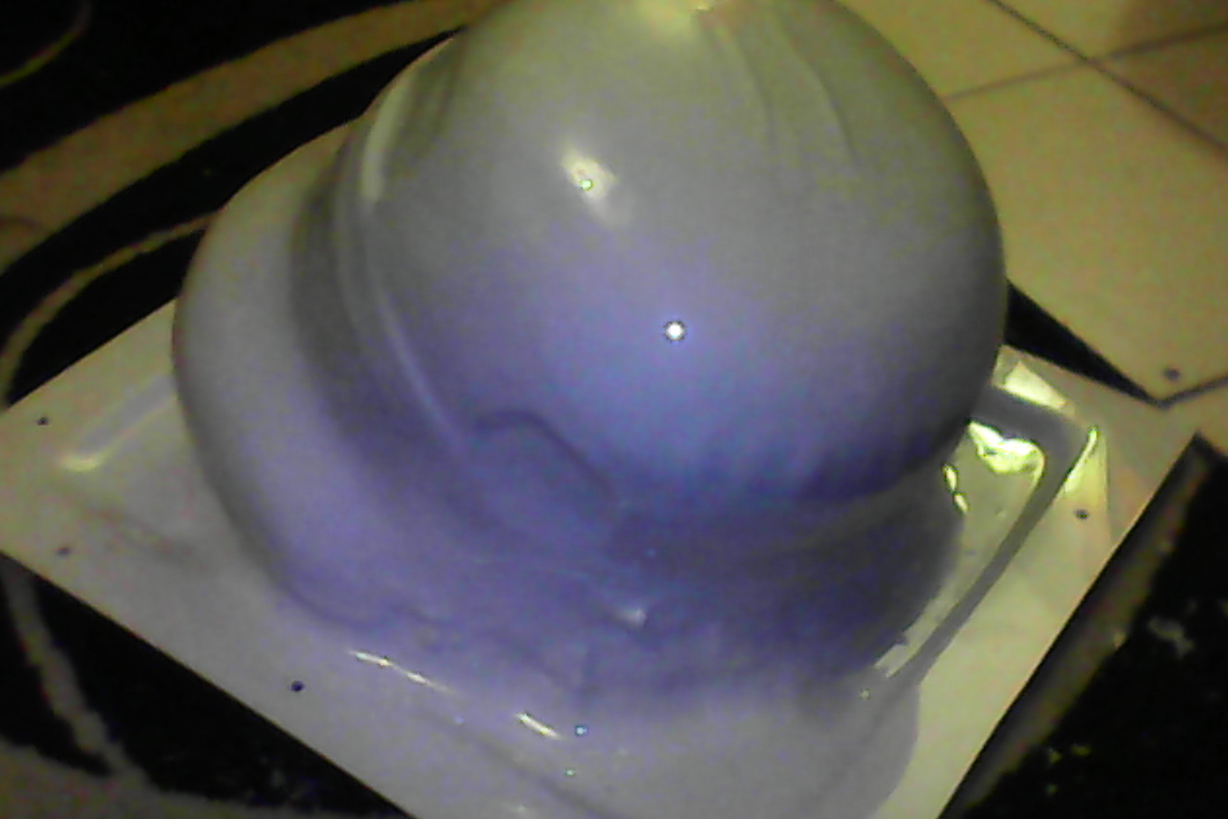

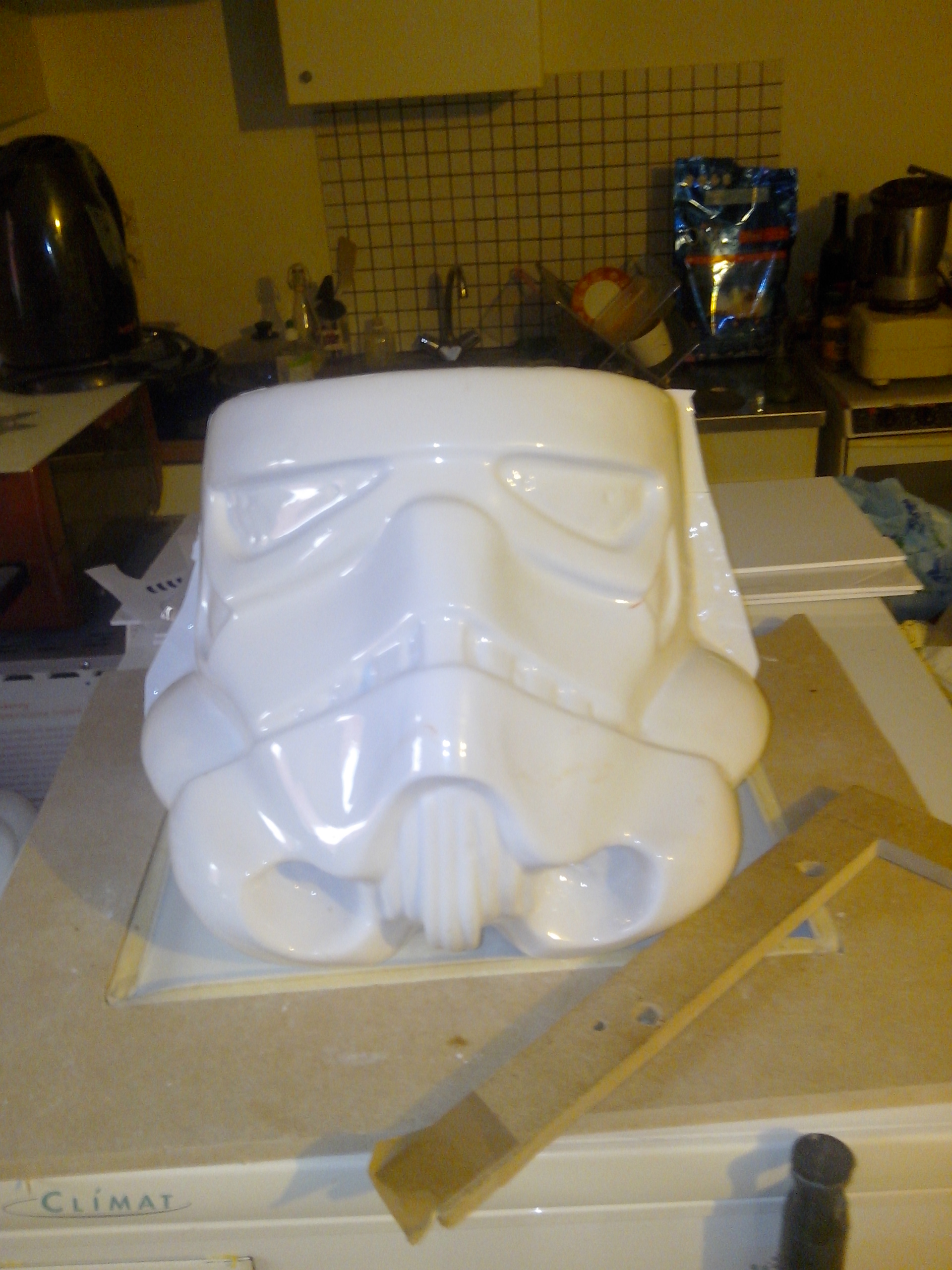

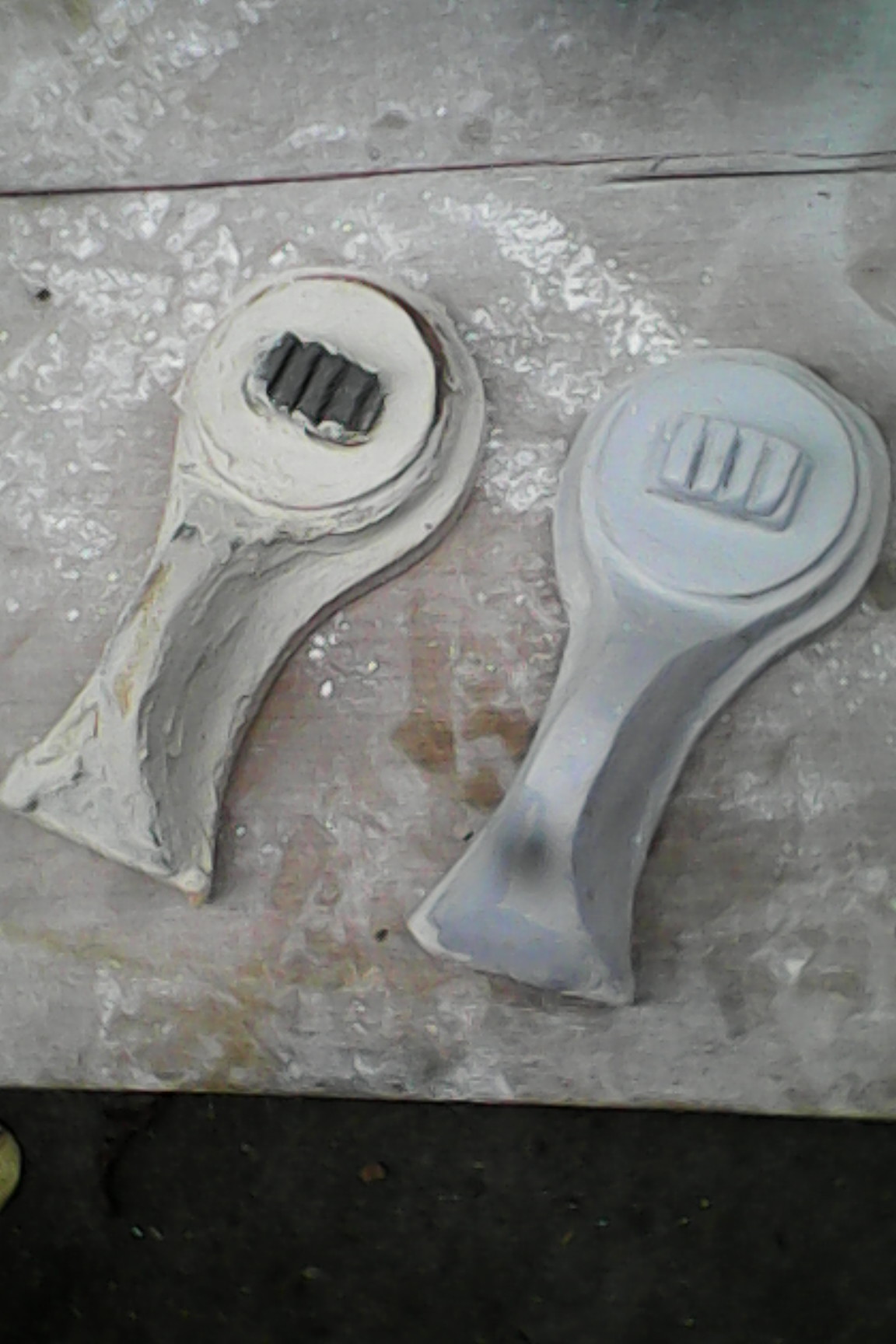

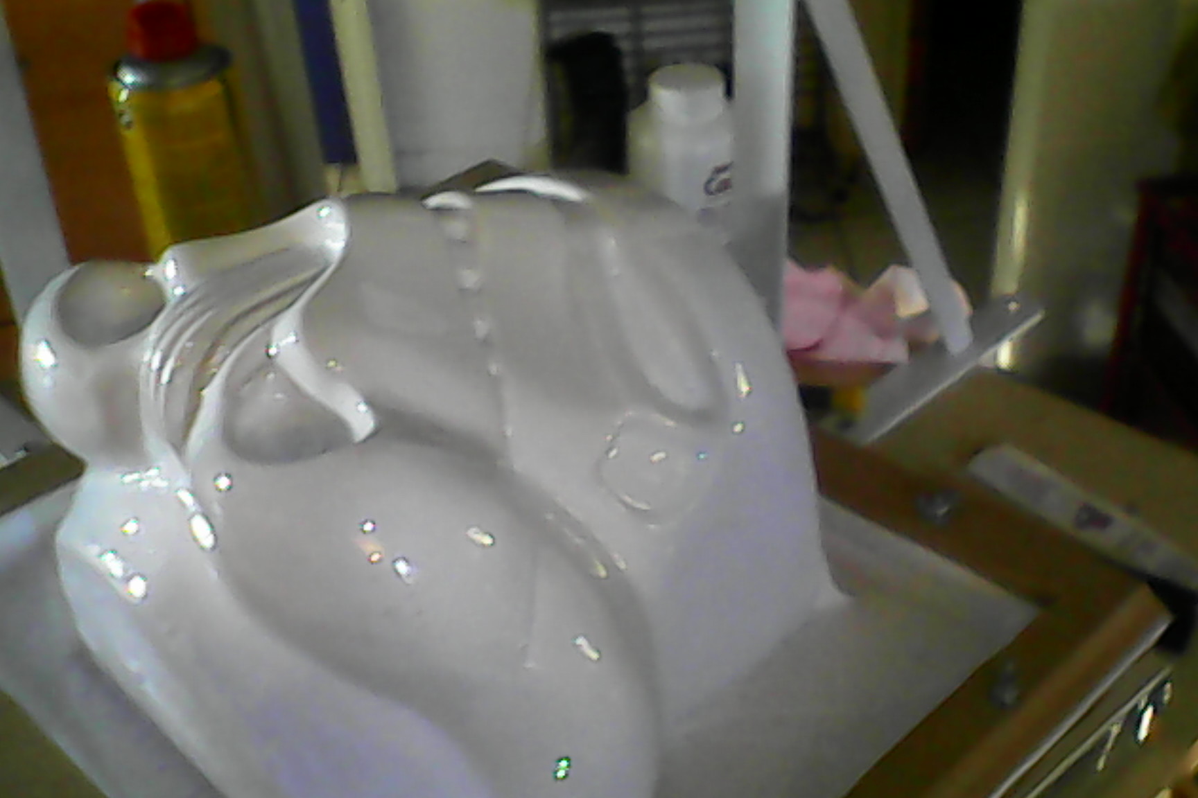

At that time, I wasn't looking for a super accurate helmet so I've stopped working on it at that point. I've started to sculpt the ears bucks and built a vacuum forming table:

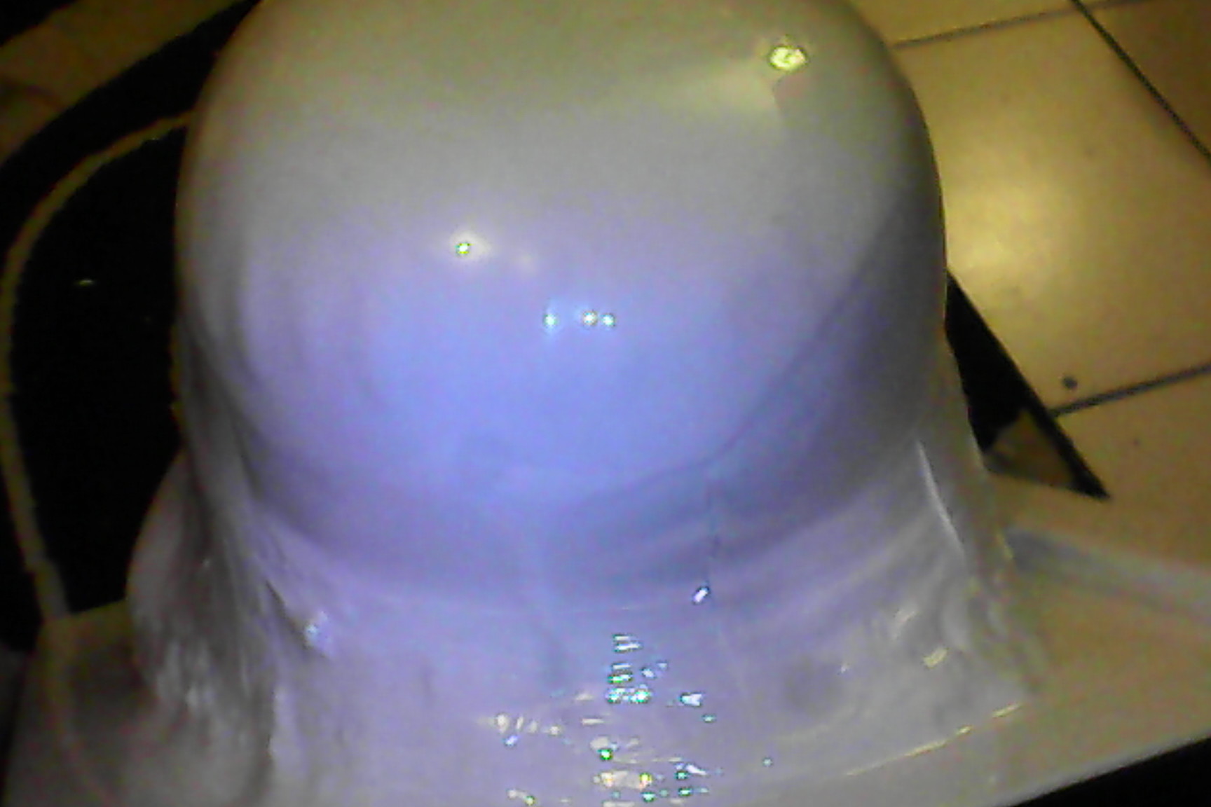

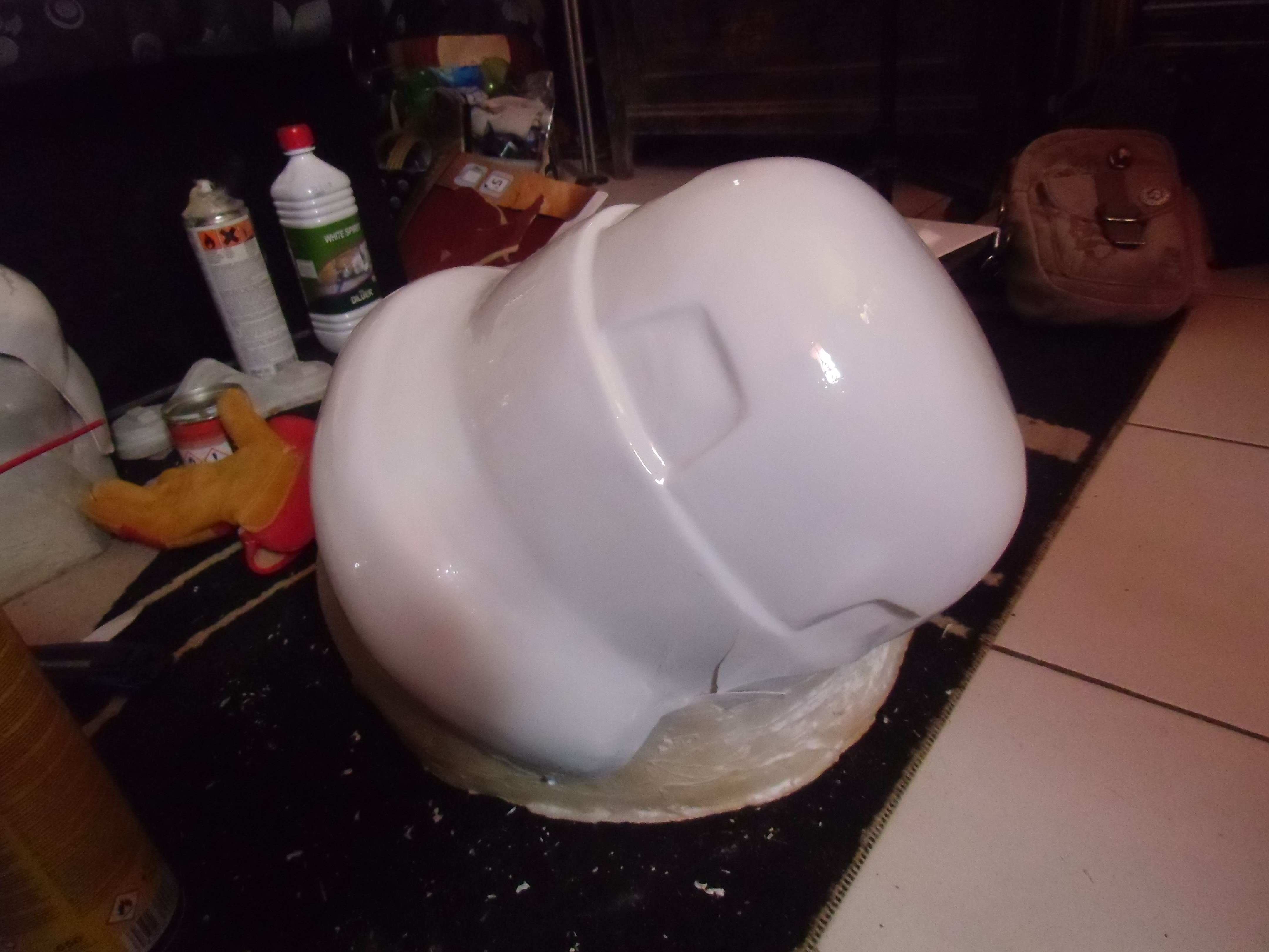

Then I've made my first pulls out of 3mm and 2mm HIPS in my kitchen oven:
IMG_20150905_150215.jpgIMG_20150905_183644.jpgIMG_20150905_183654.jpgIMG_20150905_185243.jpgIMG_20150905_185313.jpgIMG_20150905_185528.jpgIMG_20150905_185550.jpgIMG_20150905_185613.jpgIMG_20151109_180754.jpgIMG_20151109_180807.jpg
Not that good but pretty encouraging for me. The back/cap piece was the hardest part to pull, I had to try many many times to obtain something correct ad usable.

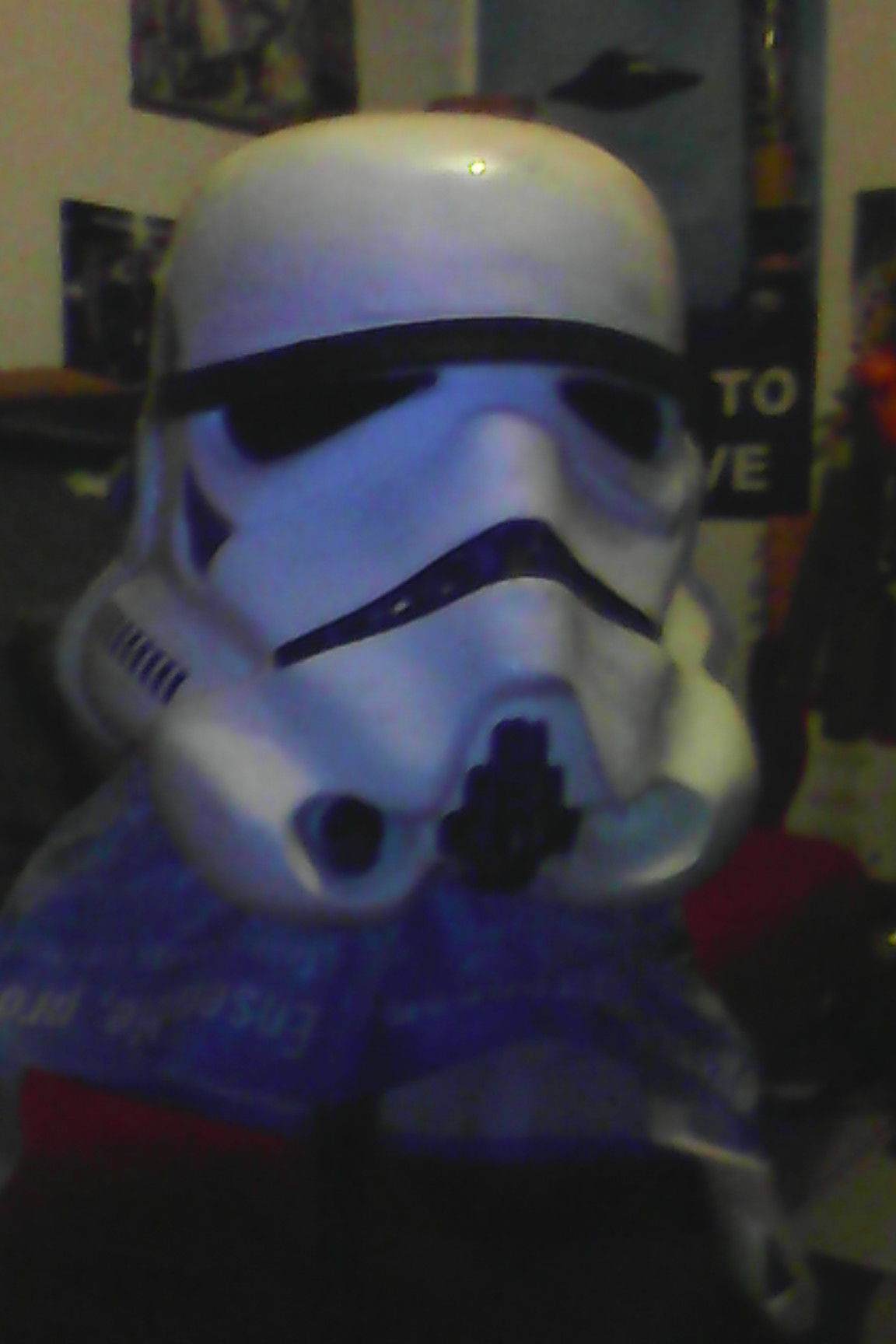

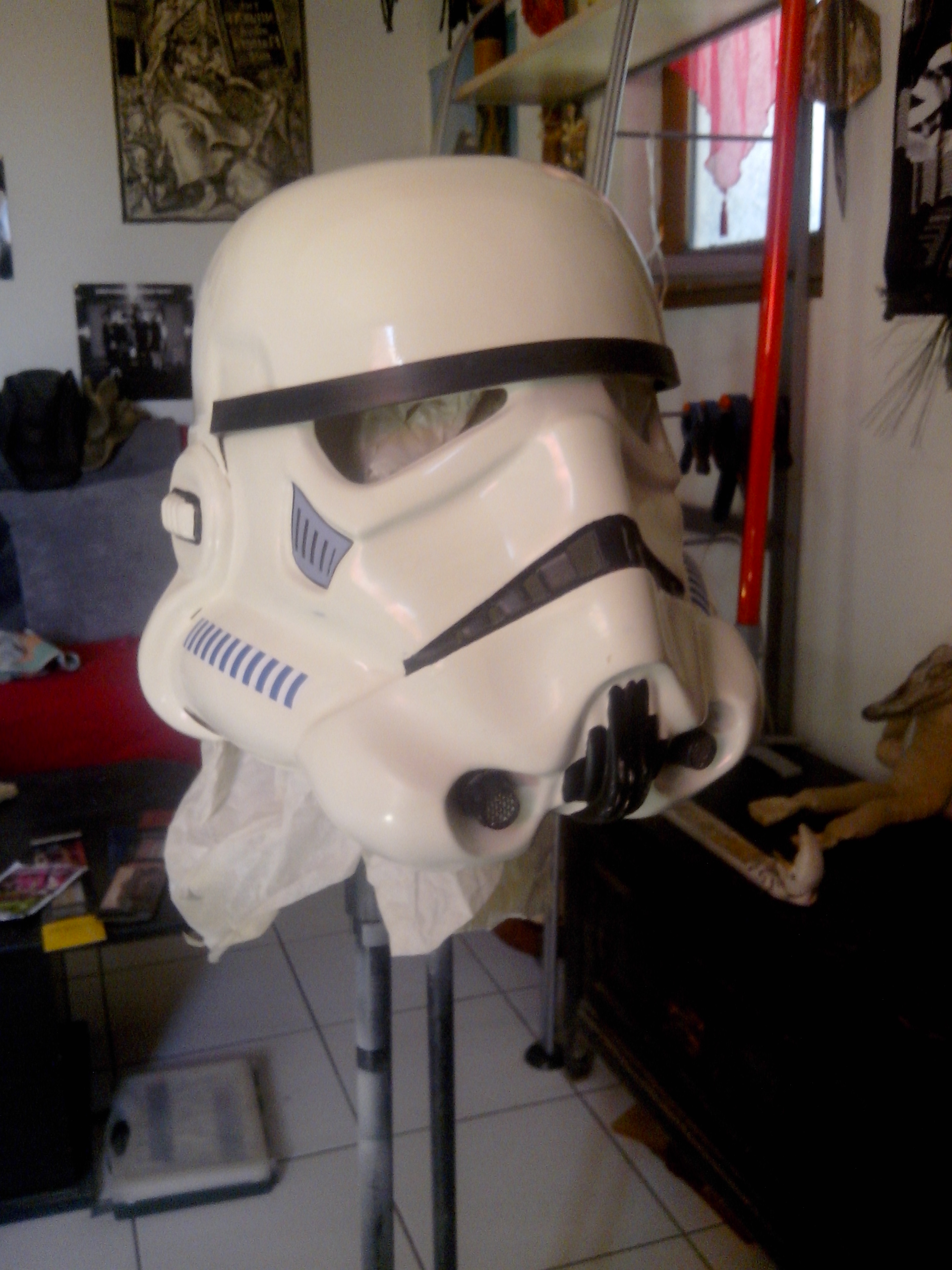

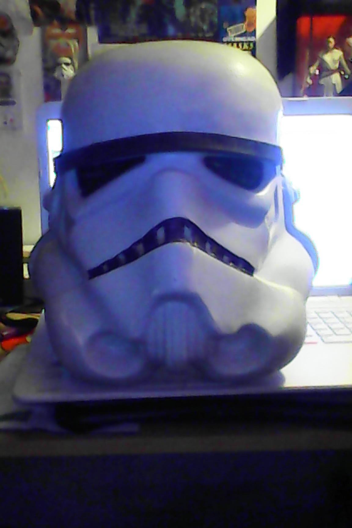

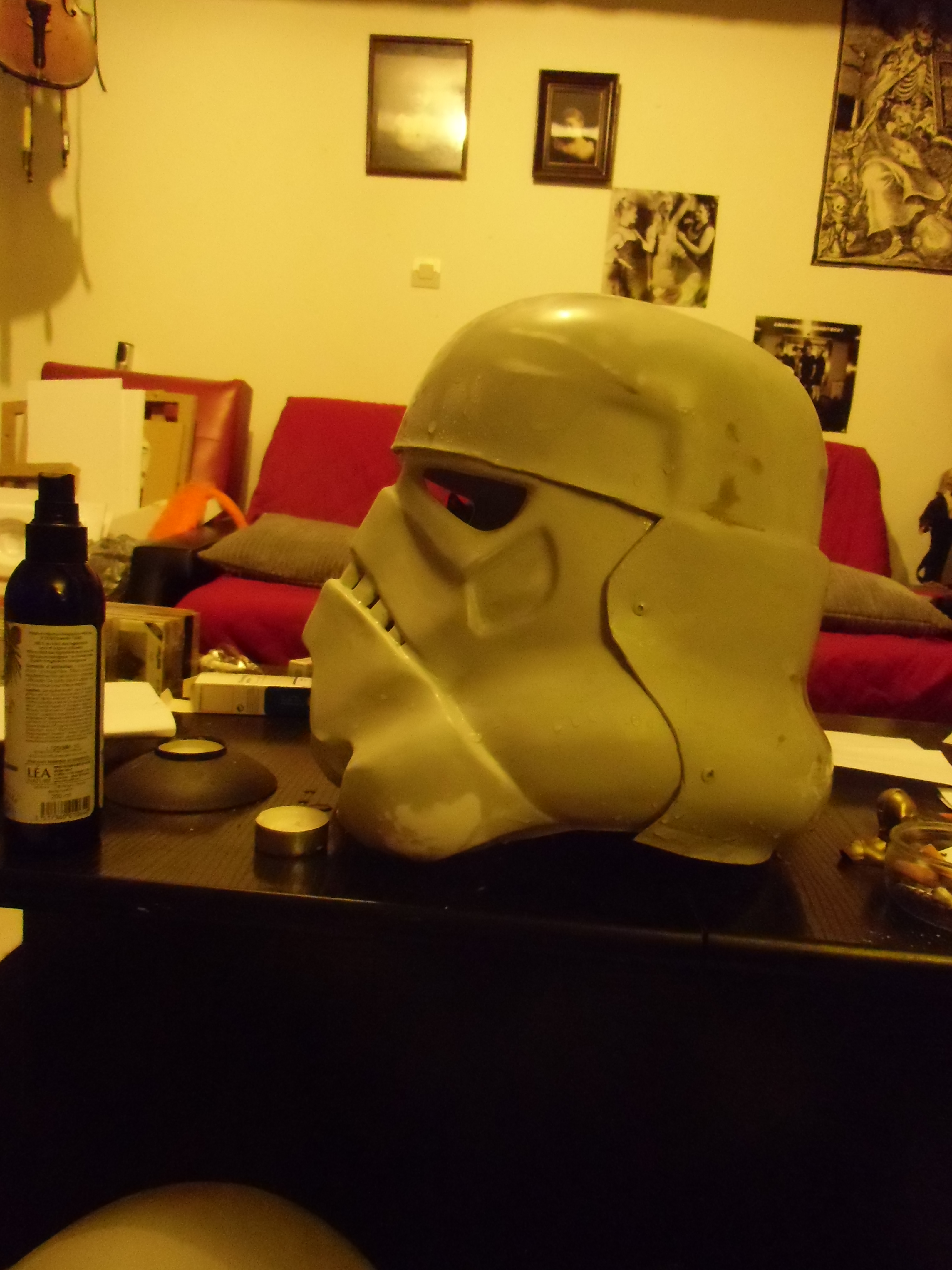

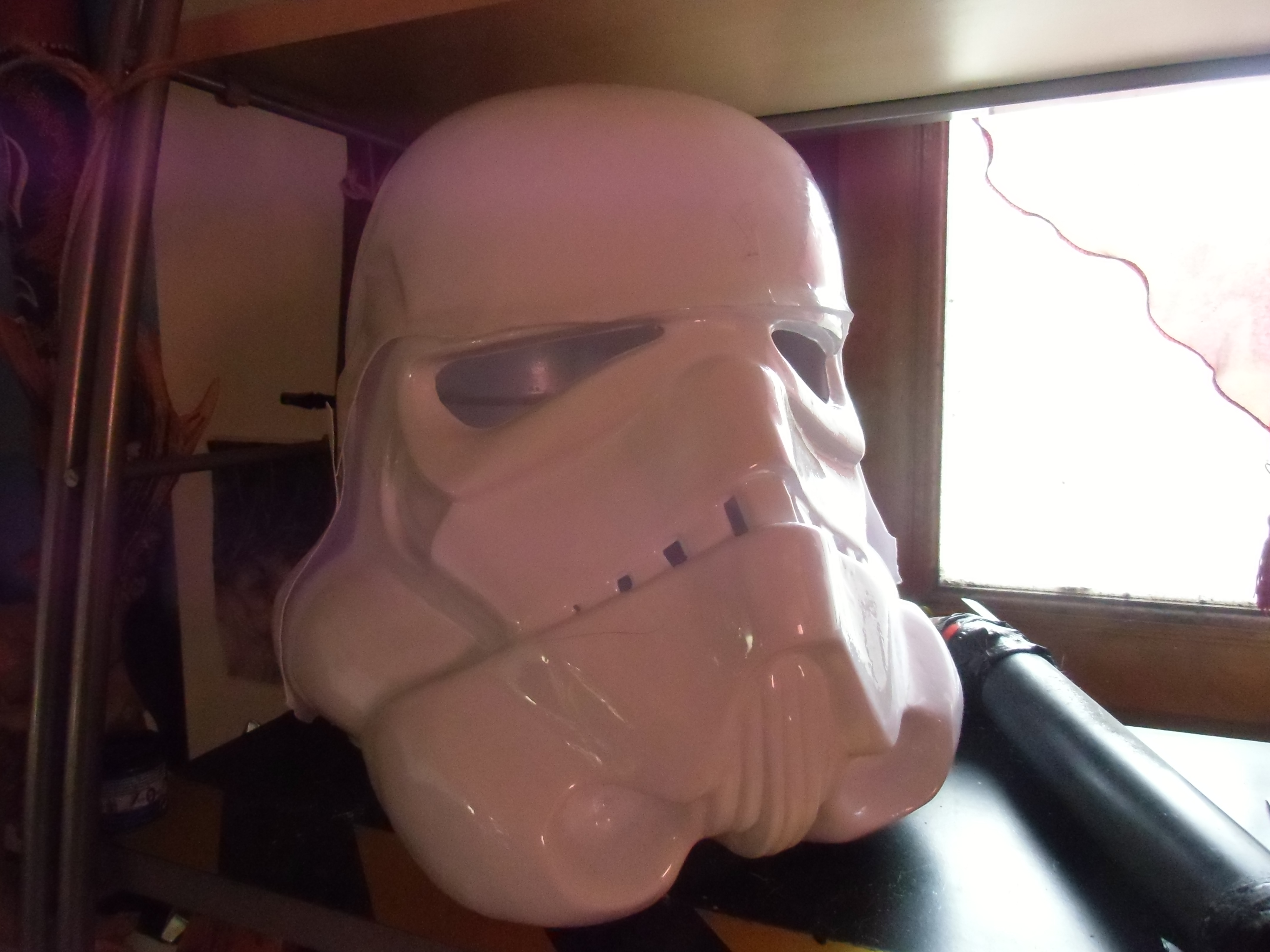

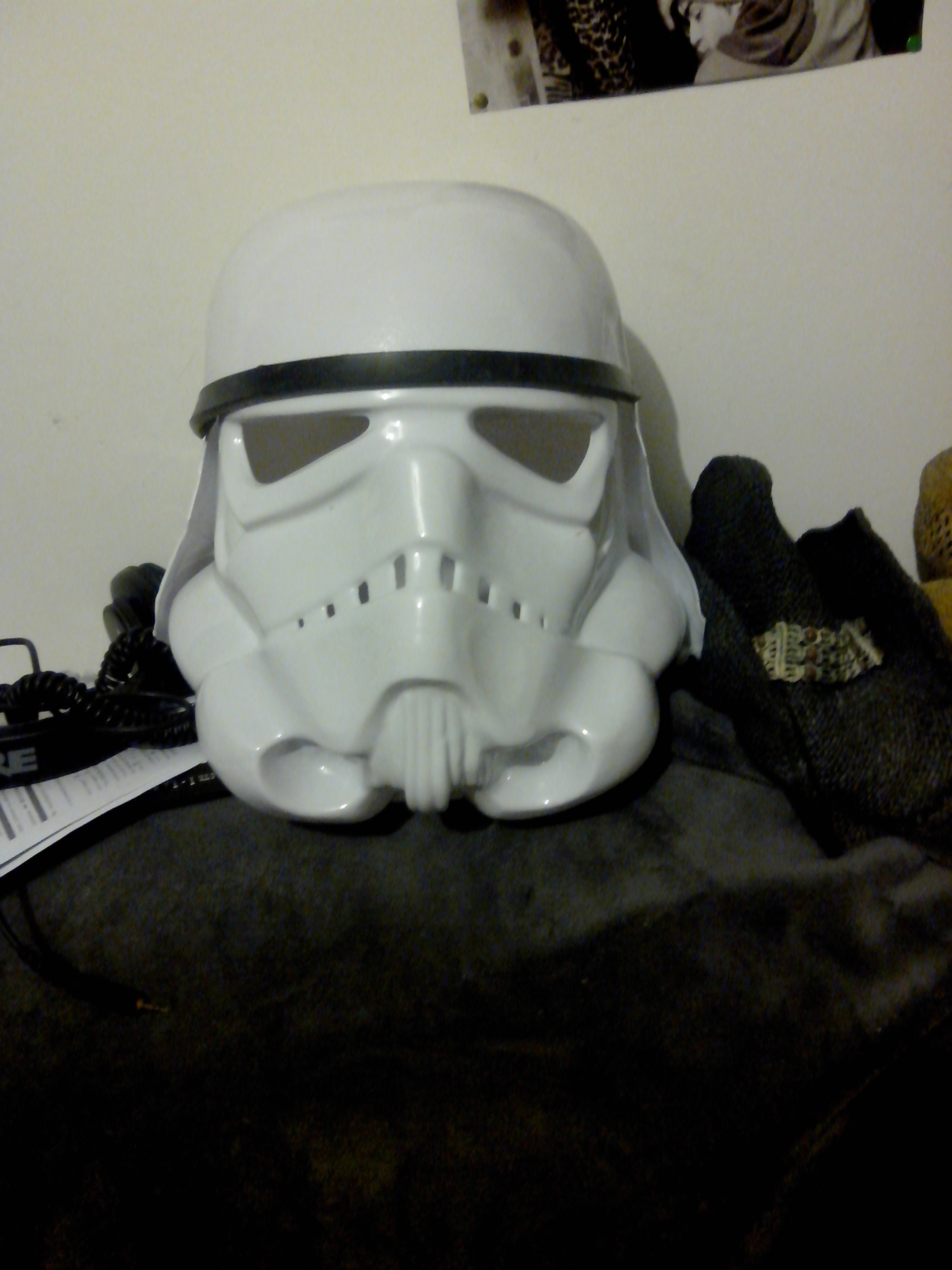

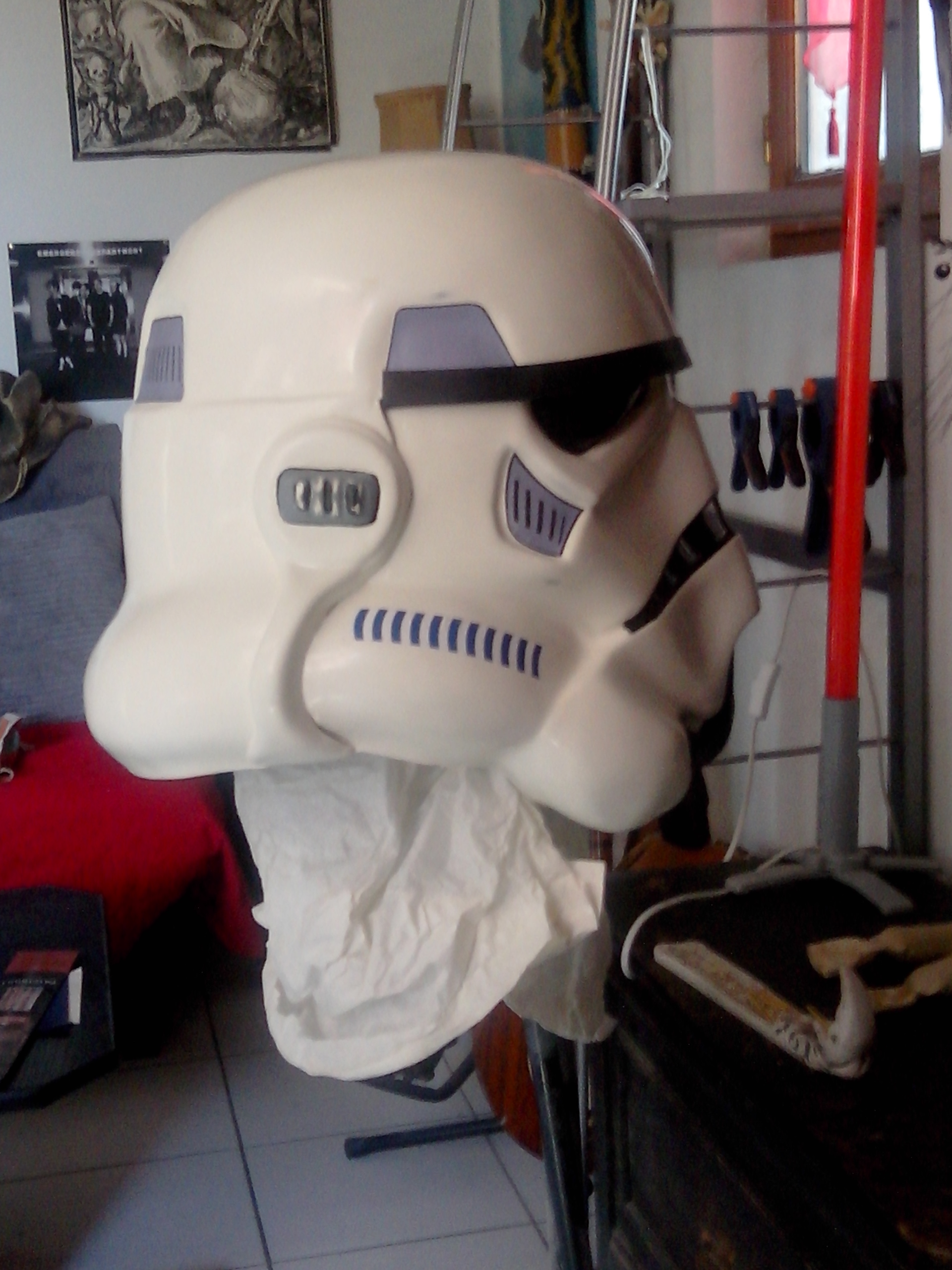

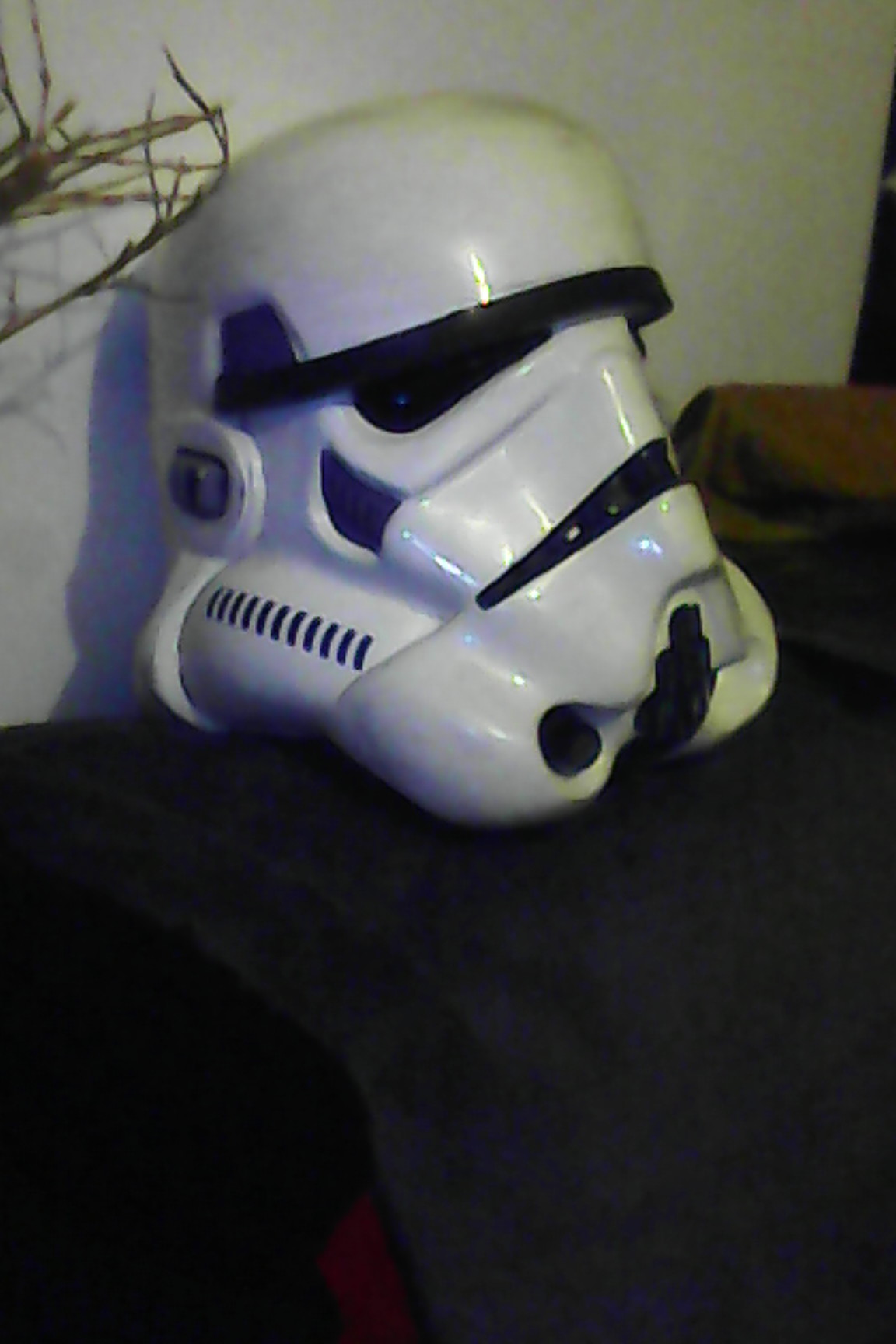

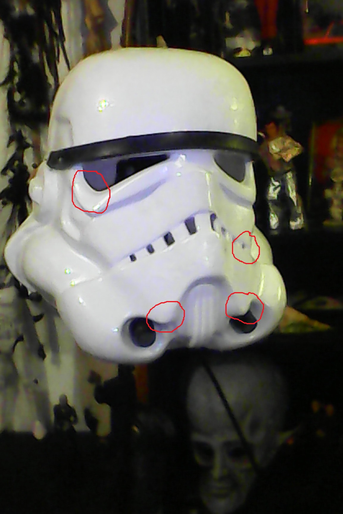

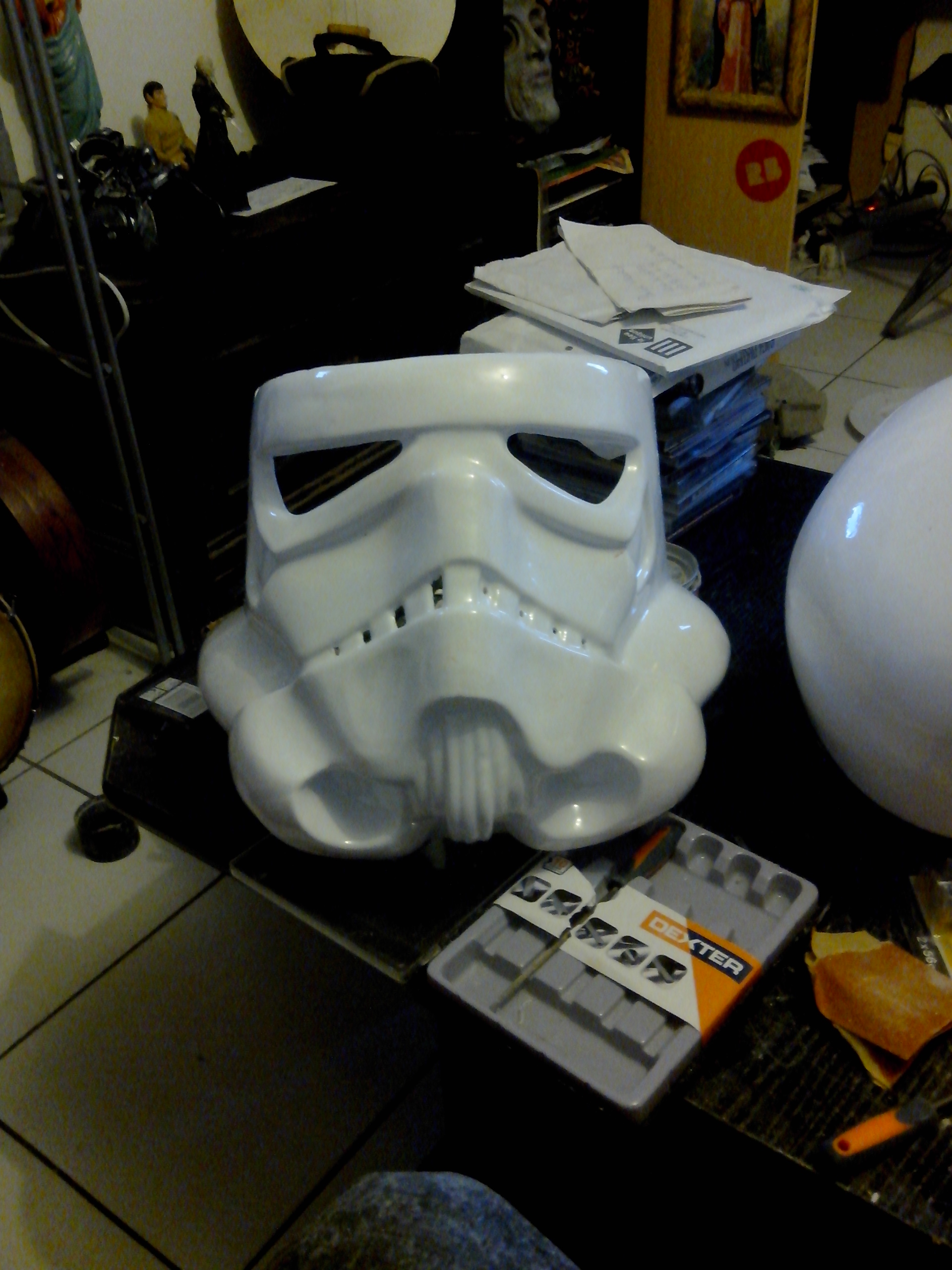

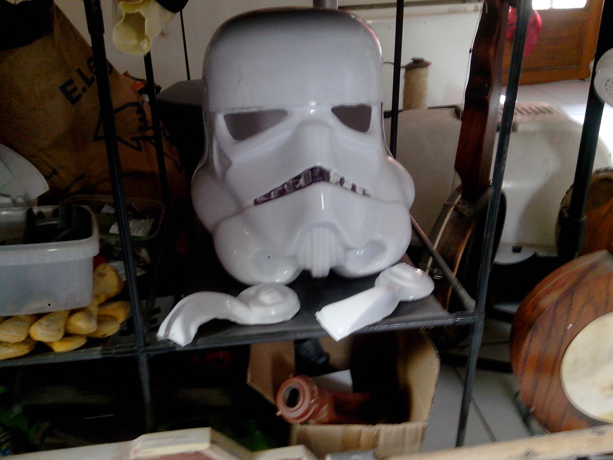

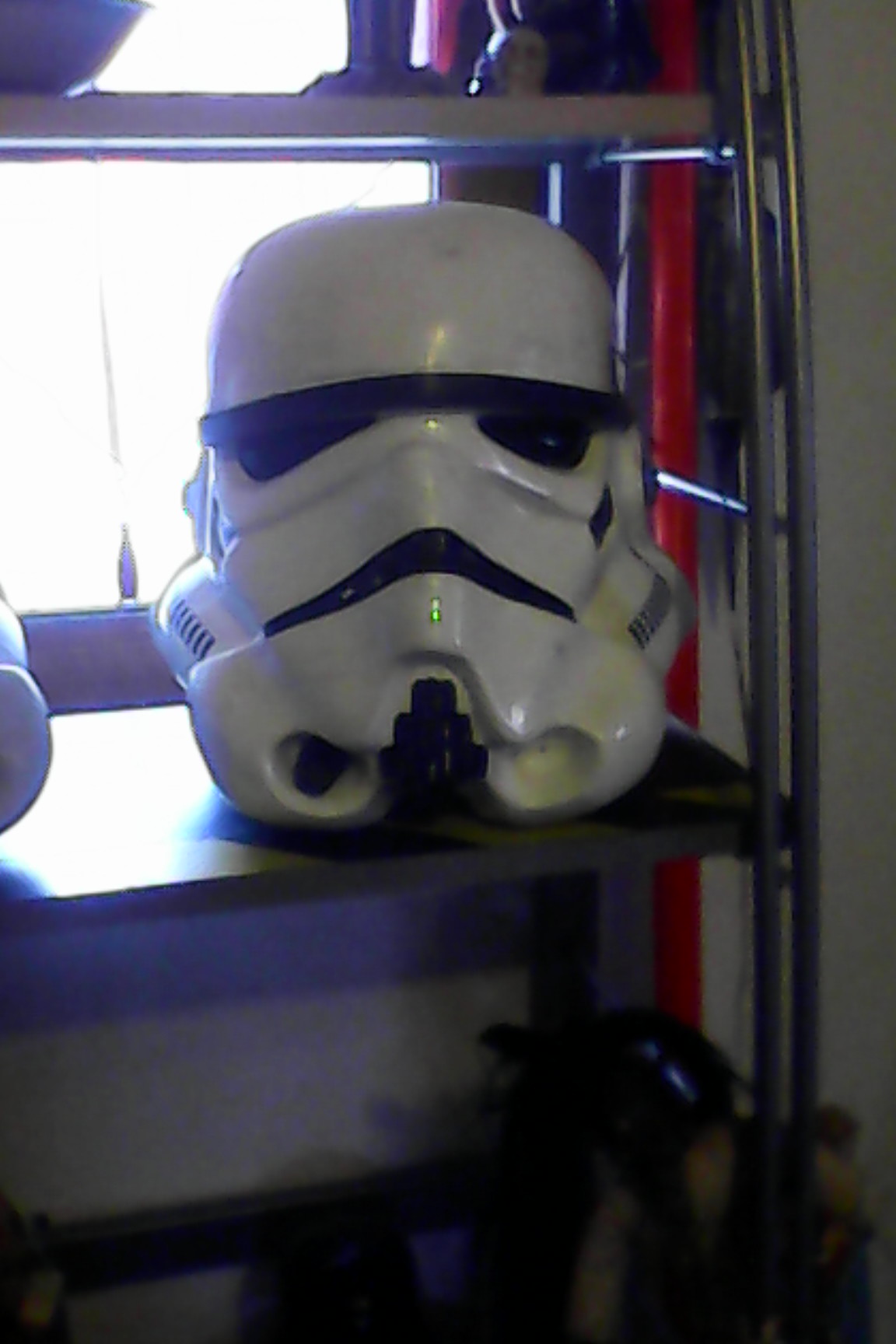

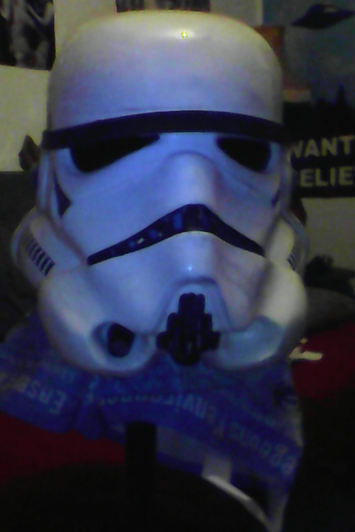

At that point, I was able to build one first helmet.

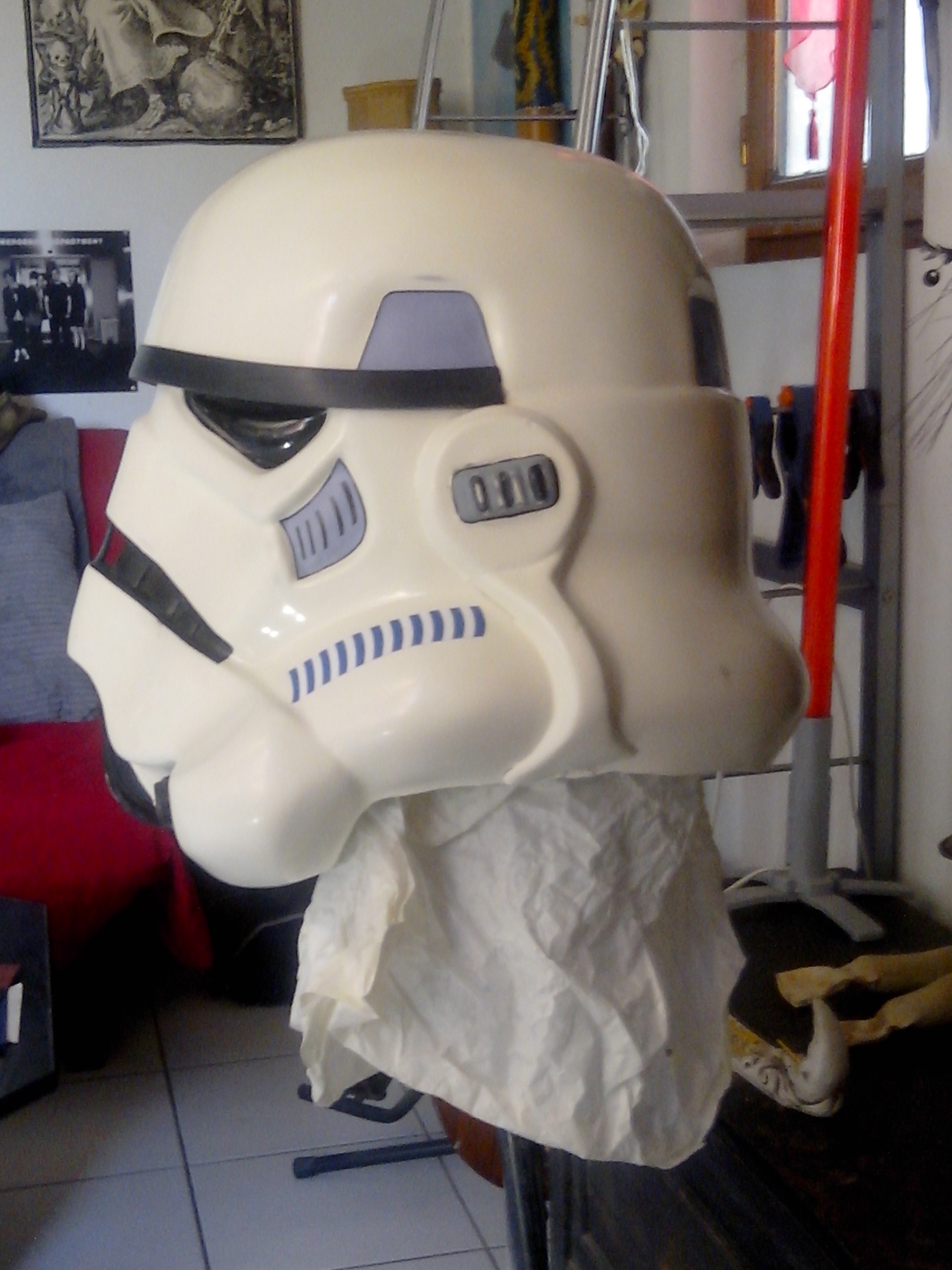

....But wasnt satisfied AT ALL with my sculpt. To me, that helmet looked terrible.
Even painted I didn't like it that much
IMG_20160203_190816.jpgIMG_20160203_190711.jpgIMG_20160203_190700.jpgIMG_20160203_190651.jpgIMG_20160203_183739.jpgIMG_20160206_105458.jpg

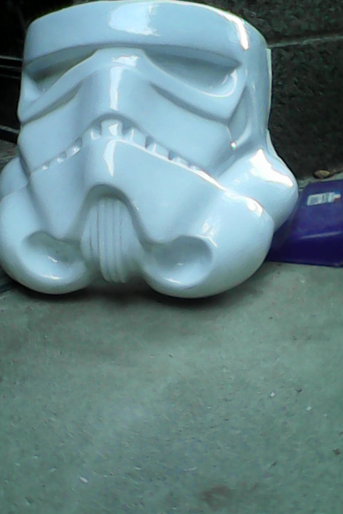

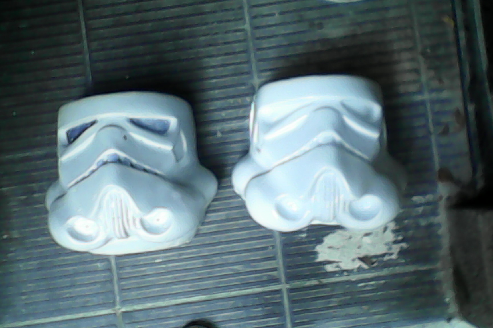

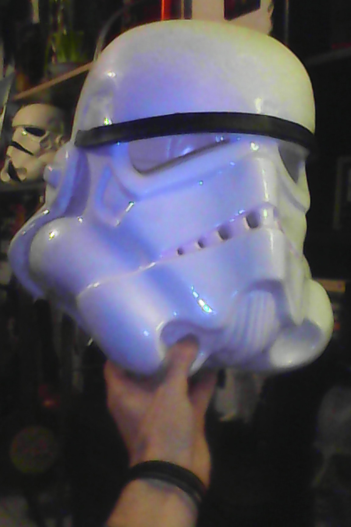

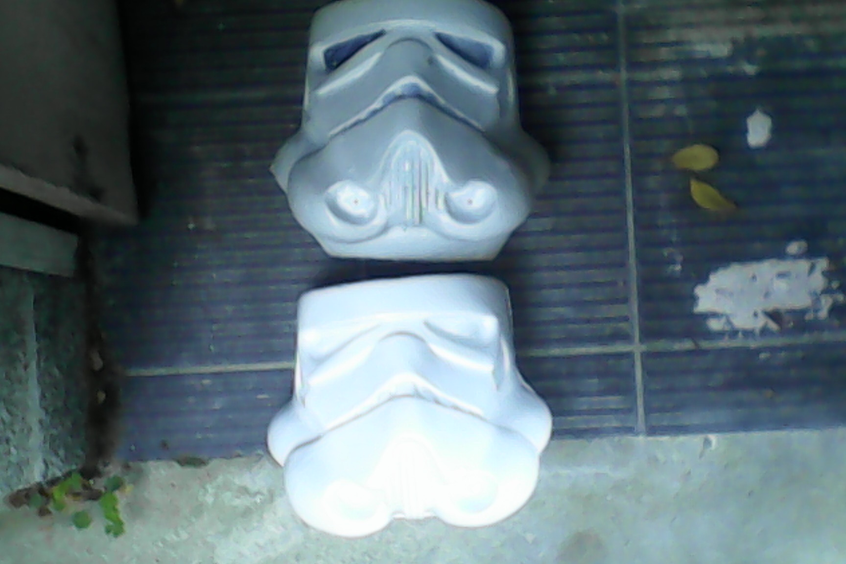

That one first helmet made me understand I needed a much more accurate helmet, so I worked a lot with comparison pics, re-sculpted the bucks, made some pulls, resculpted the bucks again and again and again. Here are some trials
IMG_20160118_191327.jpgIMG_20160118_214545.jpgIMG_20160119_191755.jpgIMG_20160125_225031.jpgIMG_20160207_152251.jpg

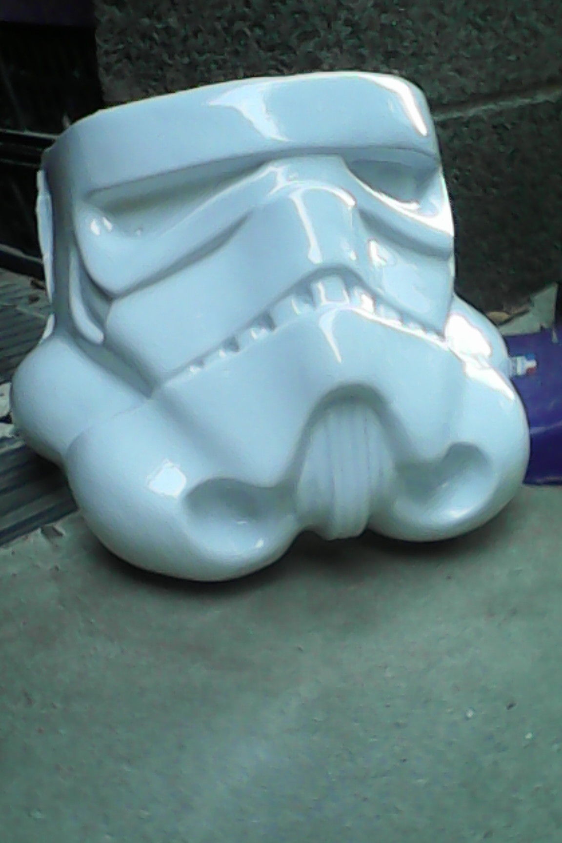

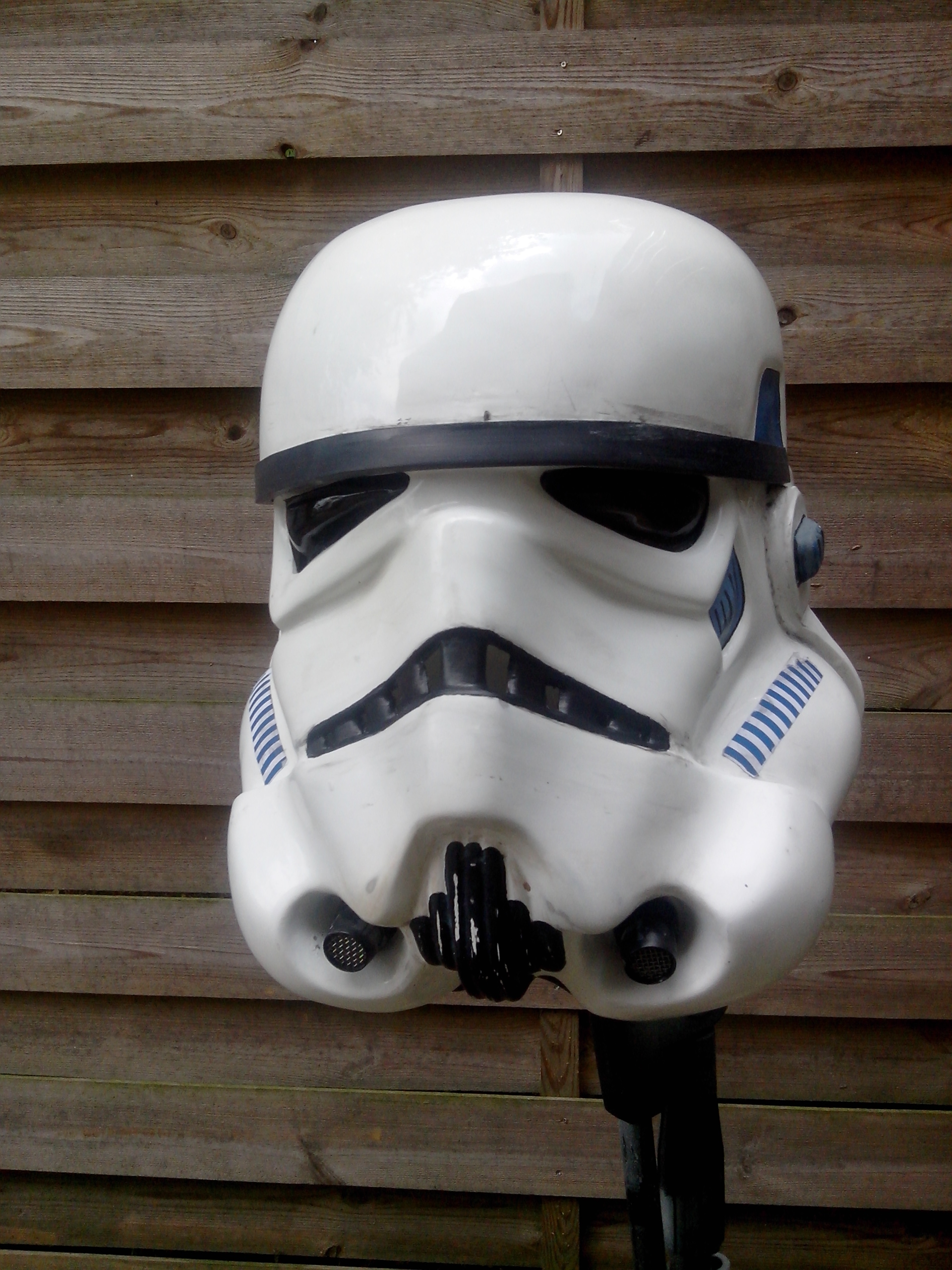

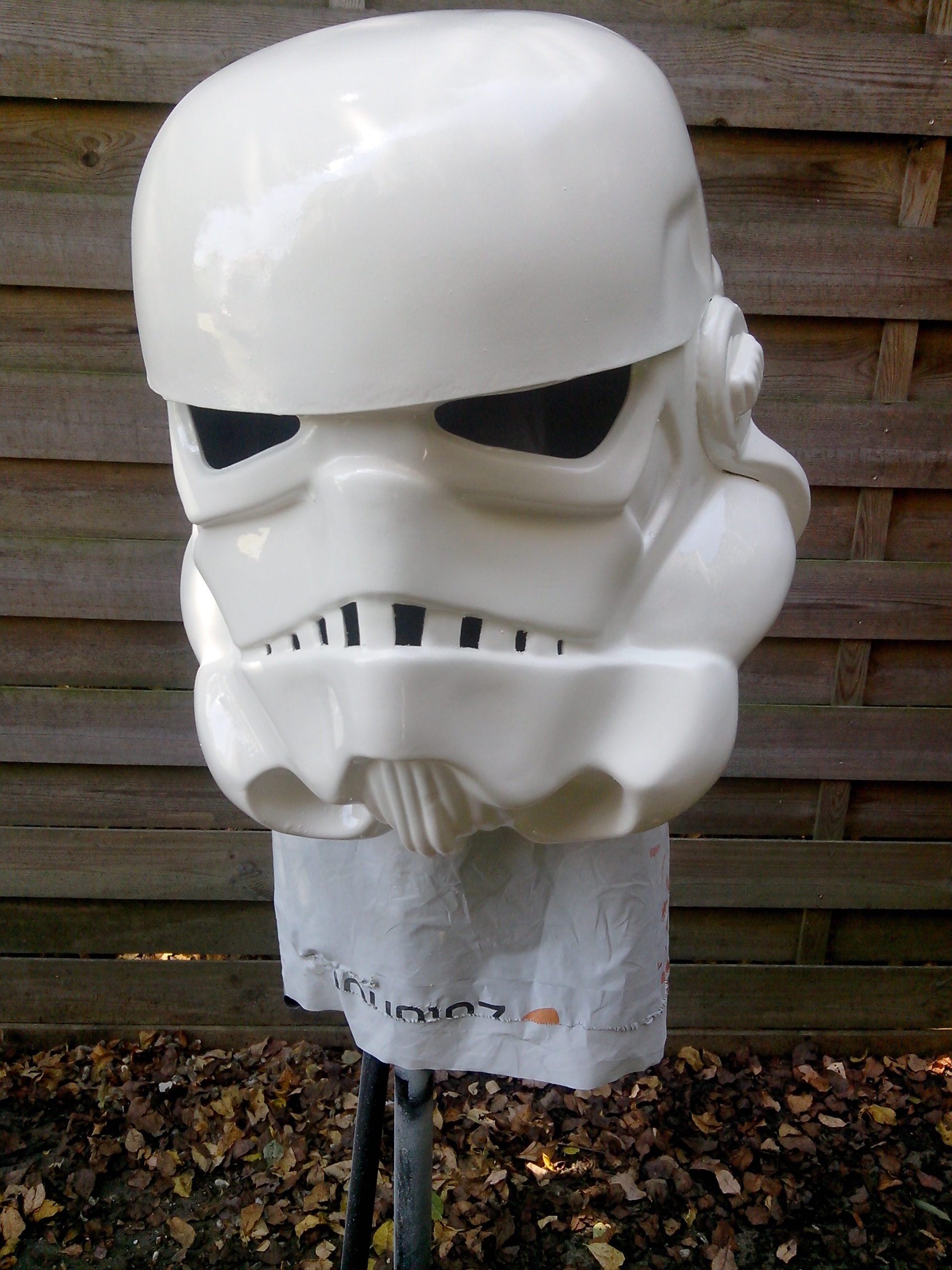

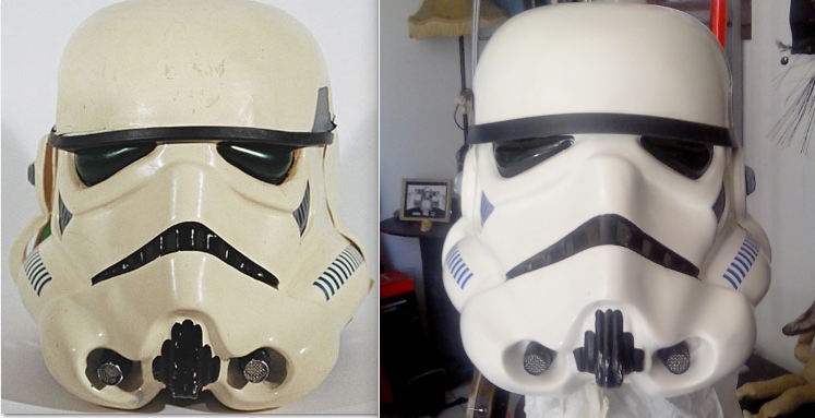

It took me months, lots and lots of pics and comparisons to obtain a satisfying sculpt
from this
I was discouraged at the end but the pulls I obtained gave me hope

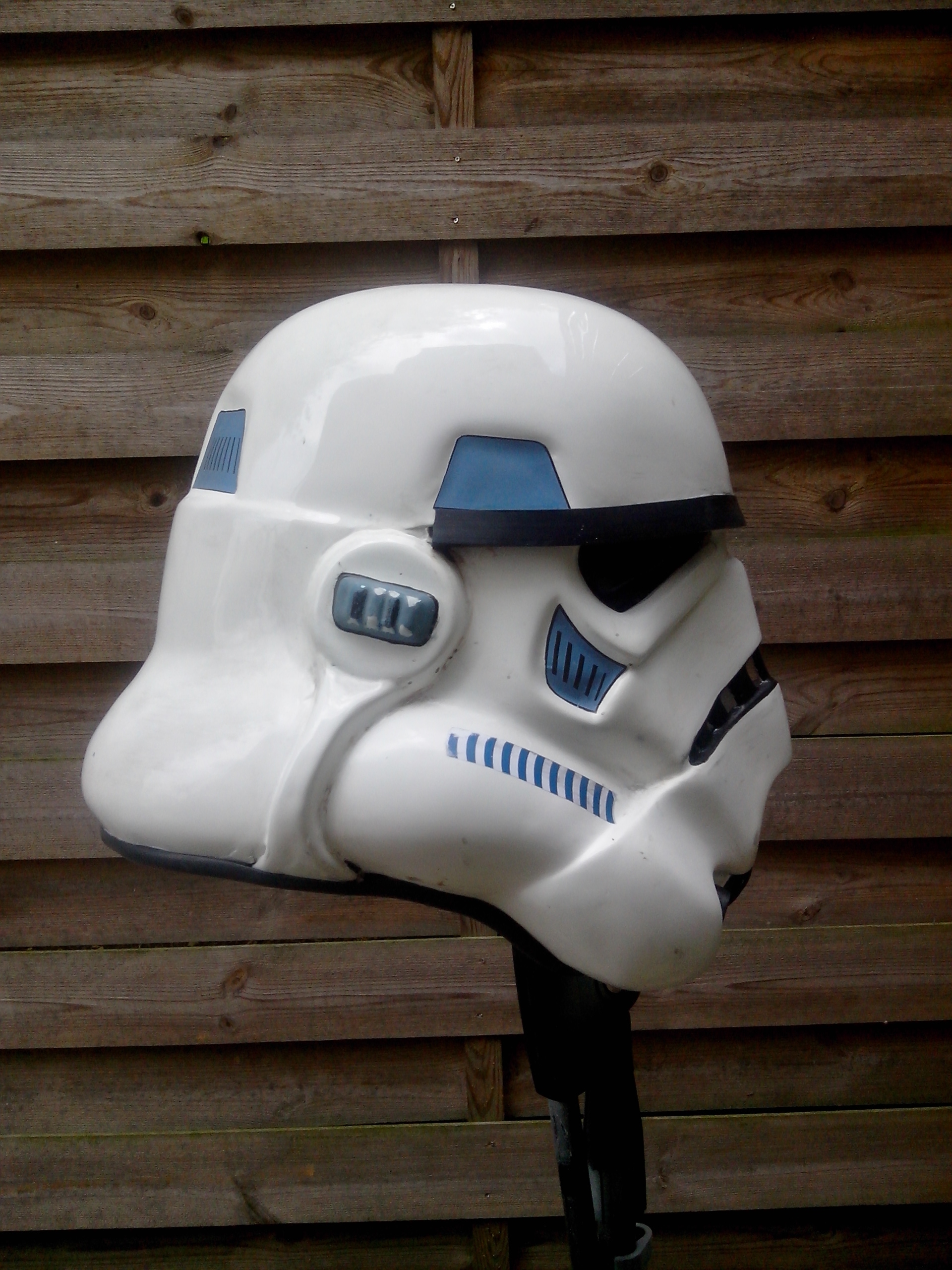

some progress pics of that final helmet
IMG_20160716_195212.jpgIMG_20160708_142122.jpgIMG_20160708_142101.jpgIMG_20160704_204516.jpgIMG_20160622_221429.jpgIMG_20160622_202851.jpgIMG_20160717_132224.jpg

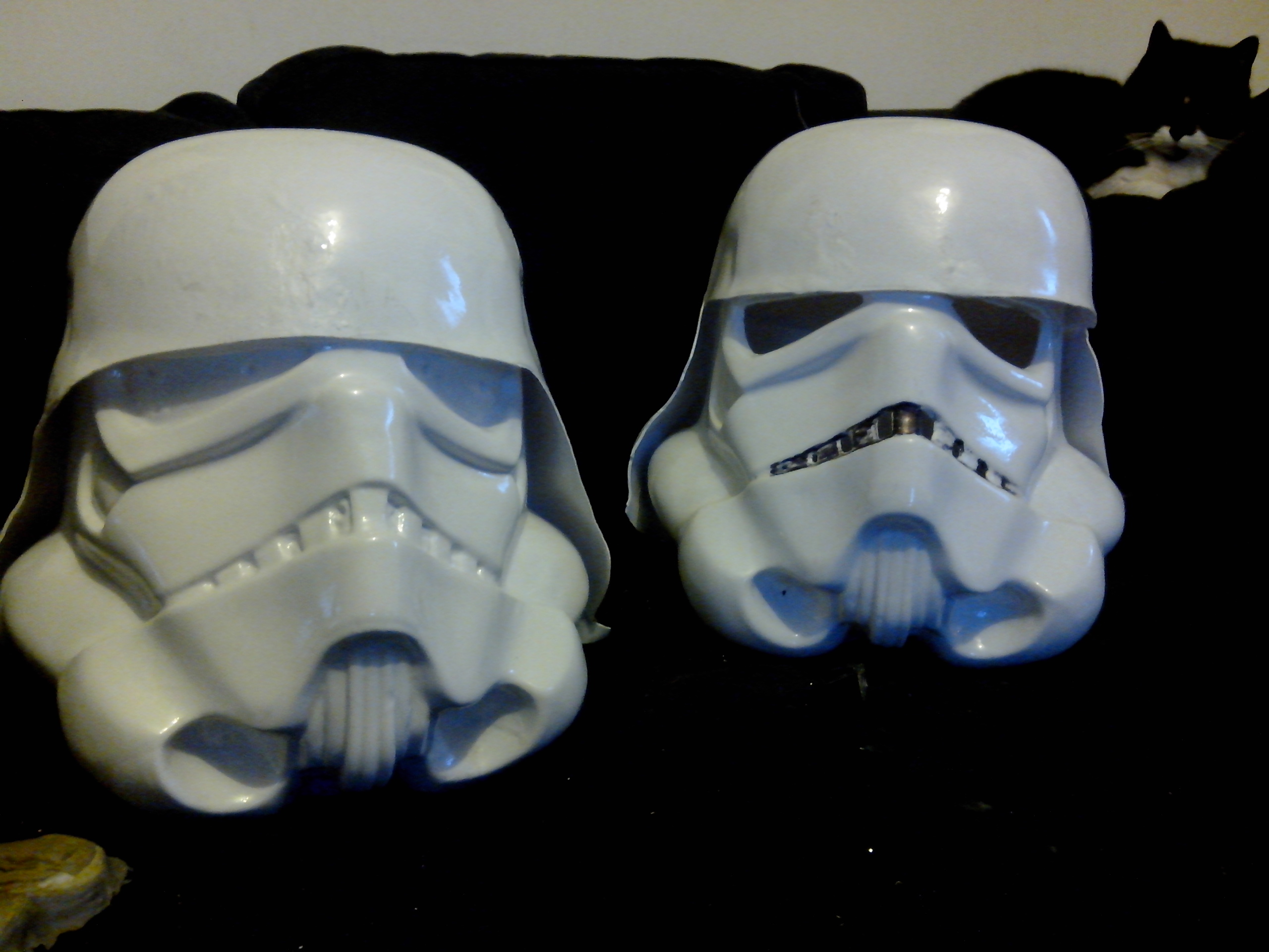

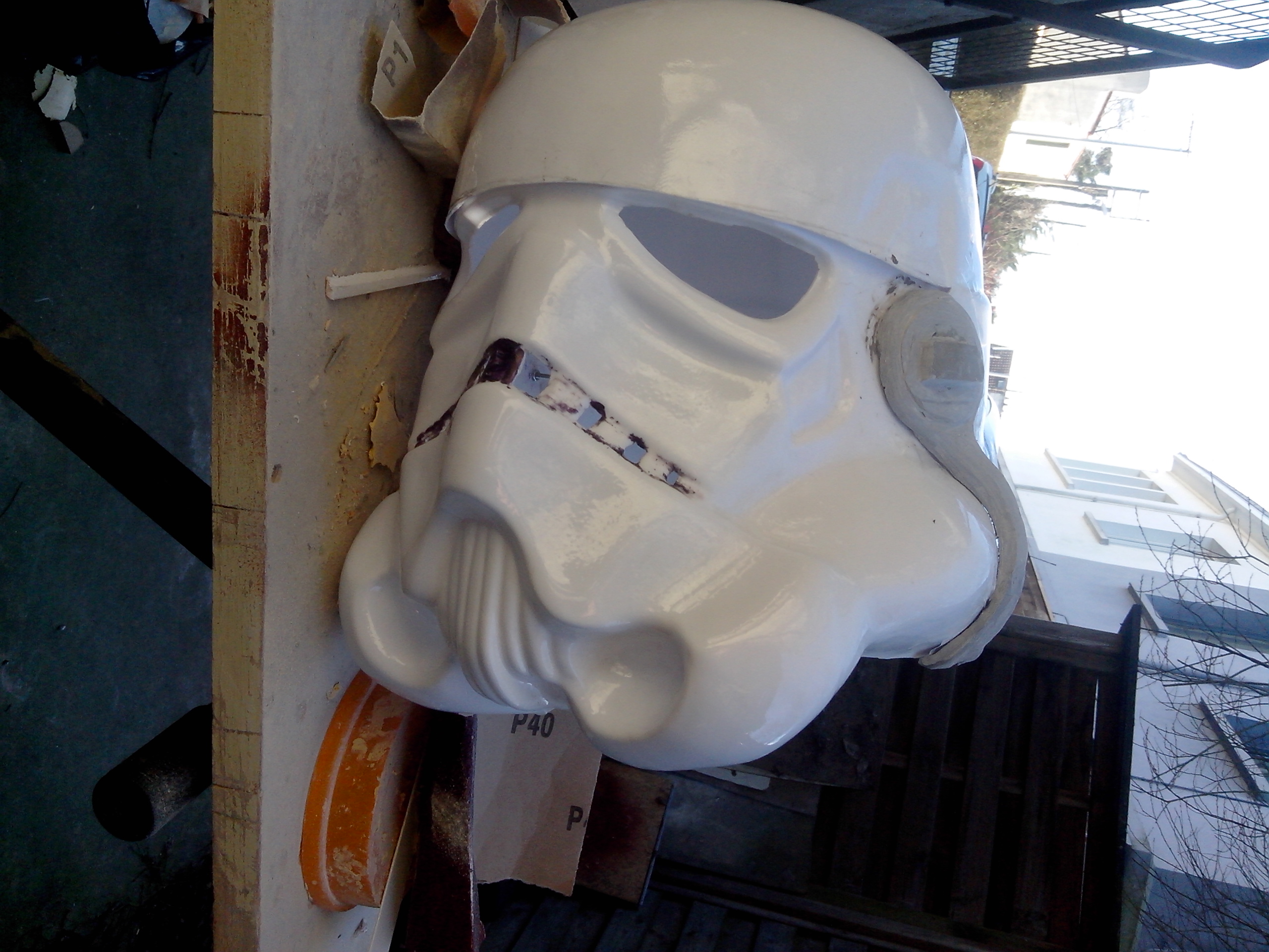

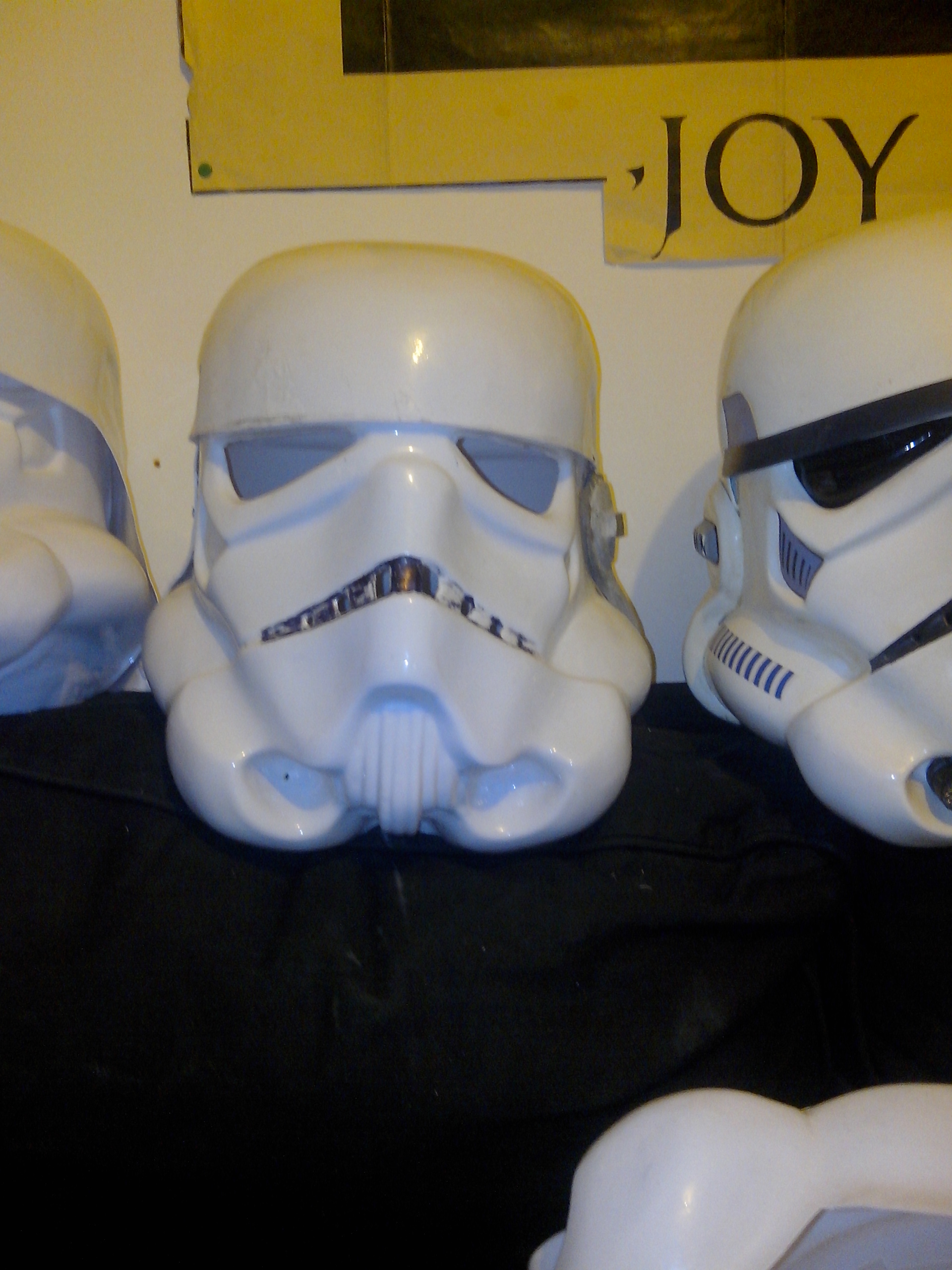

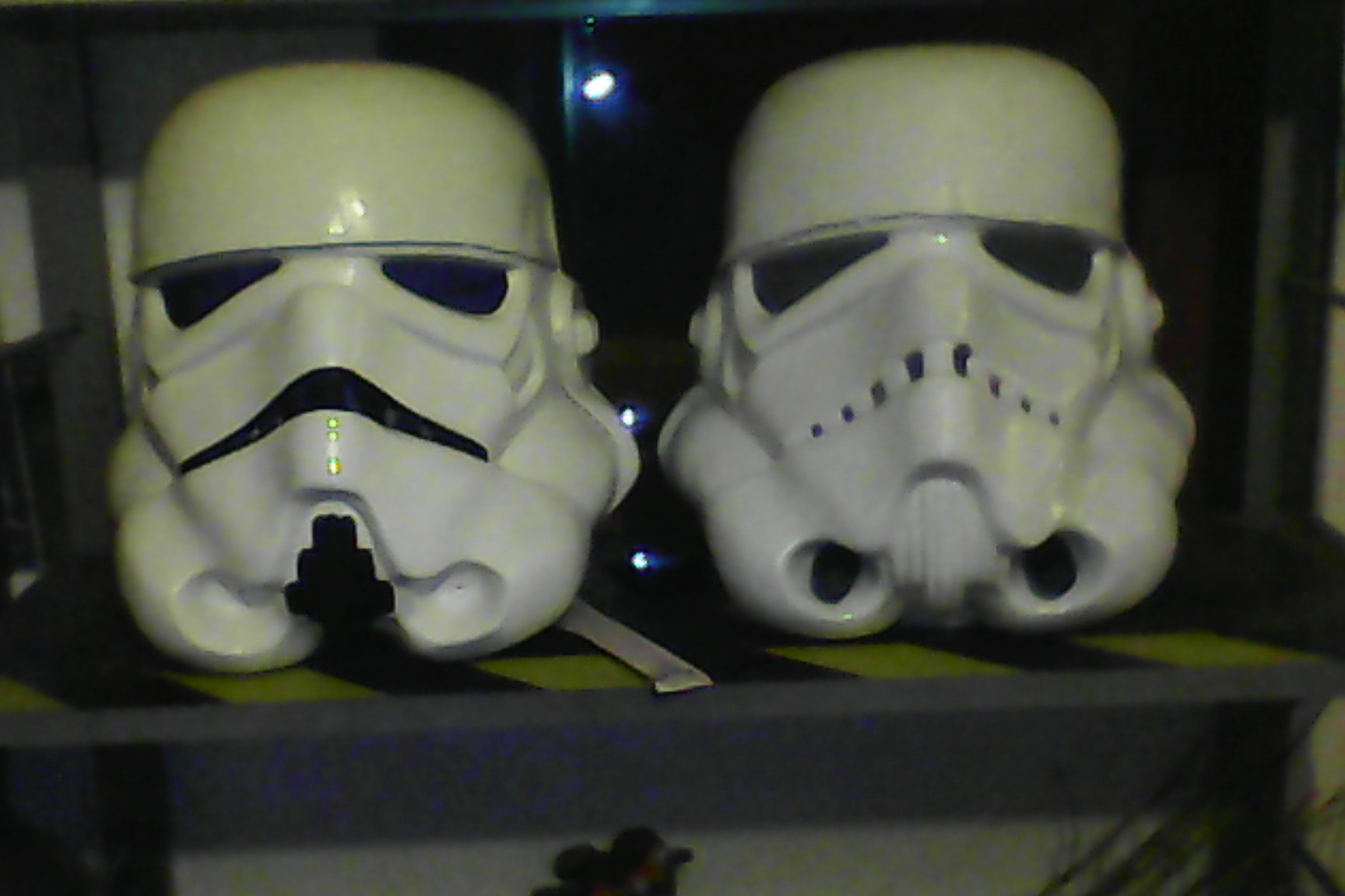

Today I got four helmets to build for people who want to have their own. My first attempt was to have a ROTJish/MKIIish helmet, but now I'm trying to reproduce the ANH/ESB helmets by pulling 2mm instead of 3mm to have sharper pulls:
and I also have a ROTJish attempt with an older trial. I've sculpted the left ear.
IMG_20170218_155659.jpgIMG_20170218_155736.jpgIMG_20170218_194046.jpgIMG_20170405_160439.jpgIMG_20170212_175445.jpgIMG_20170405_160501.jpg
There's CFO and many trooper makers out there, they all provide a fantastic job, and honestly I feel a little stupid for having spent so much time and money to build a less accurate helmet, on the other hand I learned a lot from that project and I'm quite proud of the result :D.

This is pretty damn impressive, both the sculpt and the great pulls you're getting from that little vacuform box! What are you using for vacuum?
Well, Thanks a lot ! I use my vacuum cleaner. It always worked fine (2000 W/ 30kPa as depression rate). I was worried about the size of the box but, finaly, I never had any trouble with this, even with that huge back and cap piece.
