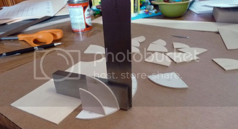

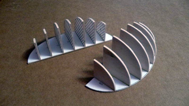

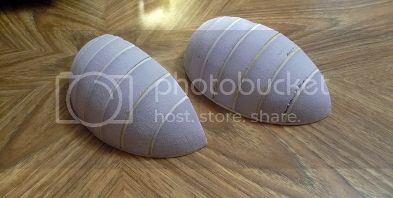

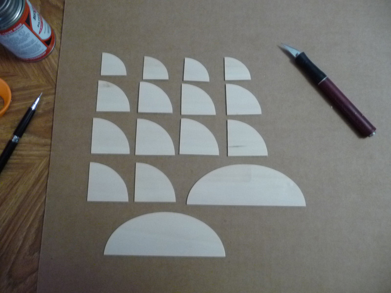

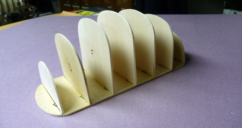

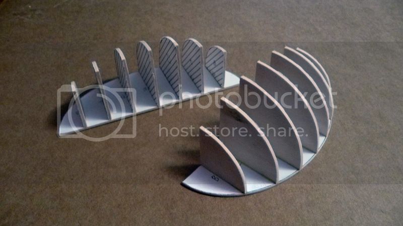

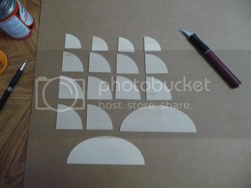

I took a number of sections through the side “pod” and pasted them onto bass wood and cut them out.

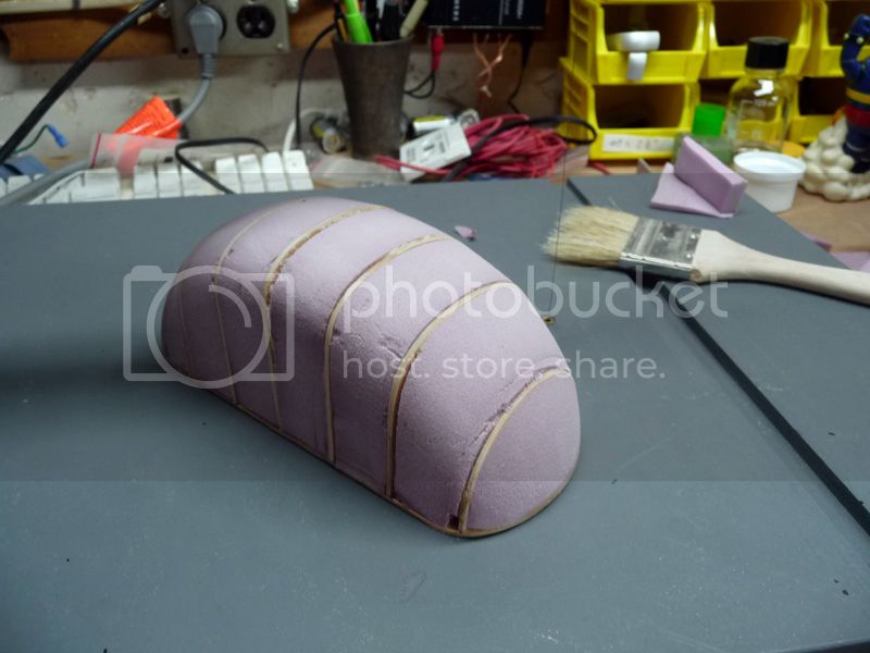

Then I filled the spaces with foam and sanded.

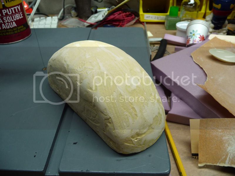

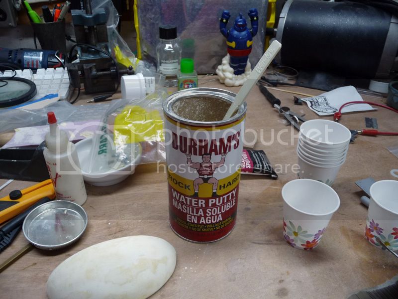

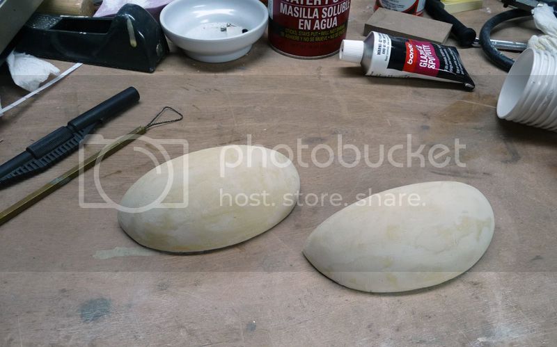

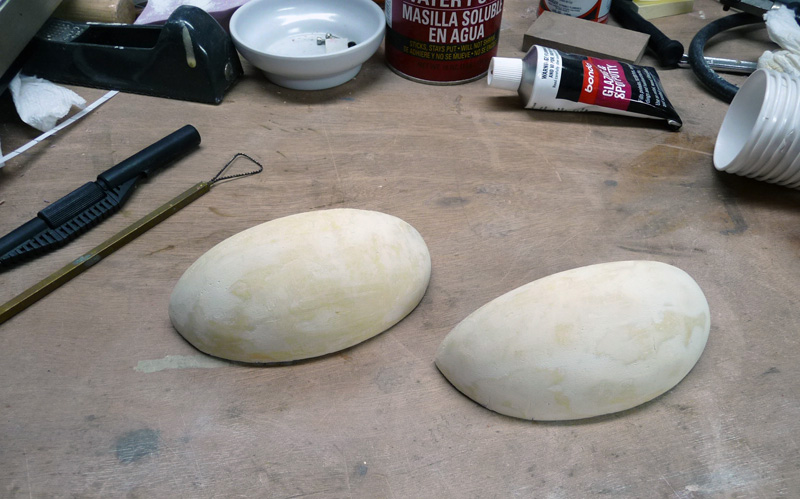

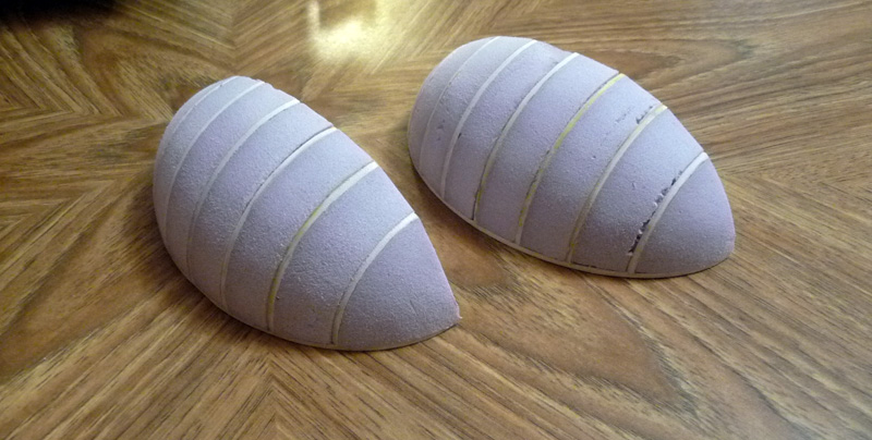

The foam was coated with a decent layer of Durhams Water Putty.

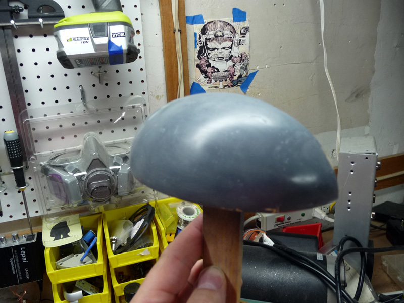

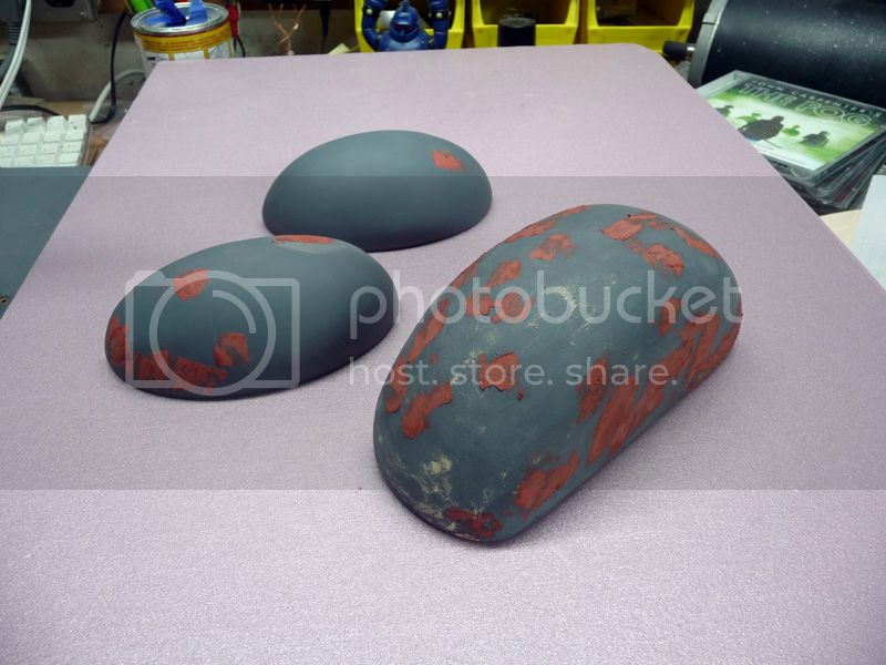

Here's the first shot of primer

That is a great start. Thanks for showing the build process.
What are you using to glue the foam to the basswood? Contact cement?
How thick of a layer of Durhams are you putting on?
Do you have any worries about it chipping or cracking?
I have some and that stuff is rock hard.
I just don't know how well it will hold up over a long period of time.
I thought about using Durhams to make a master and then do a resin cast from it.
Looking forward to the rest of your progress.
Hey, thanks for looking.
I used Titebond wood glue to glue foam to basswood. I'm not too worried about the Durhams holding up over time. These are simply forms to vacuum form over. The main purpose of the Durhams here is to protect the foam from the perils of vacuum forming. I built up a layer of about 1mm or so, I'd guess. I'm sure if I dropped one it would crack or dent. I could have used Bondo, but I hate the smell. It also eats the foam and costs $$. The Durhams is only $1.79 for a pound (that's 450 grams to everyone else in the world)

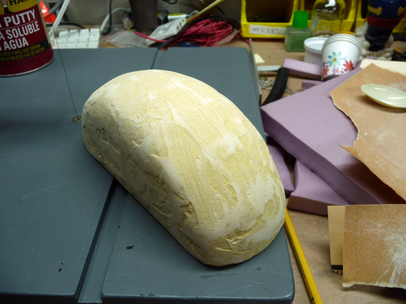

Ok, Here's a bit more progress. More Lofting ...this time the main hull.
basswood sections
foam filled & sanded
Plastered
Geidi Primed

So now that I have the main body parts and can hold them together and compare them to the (somewhat limited) reference photos, I think it's not quite 100% right.
I'm still trying to wrap my head around these forms. I think I may have to remake the side pods. It's not a big deal, we're talking about $5 worth of materials and a couple of afternoons. I really want to get this right.
