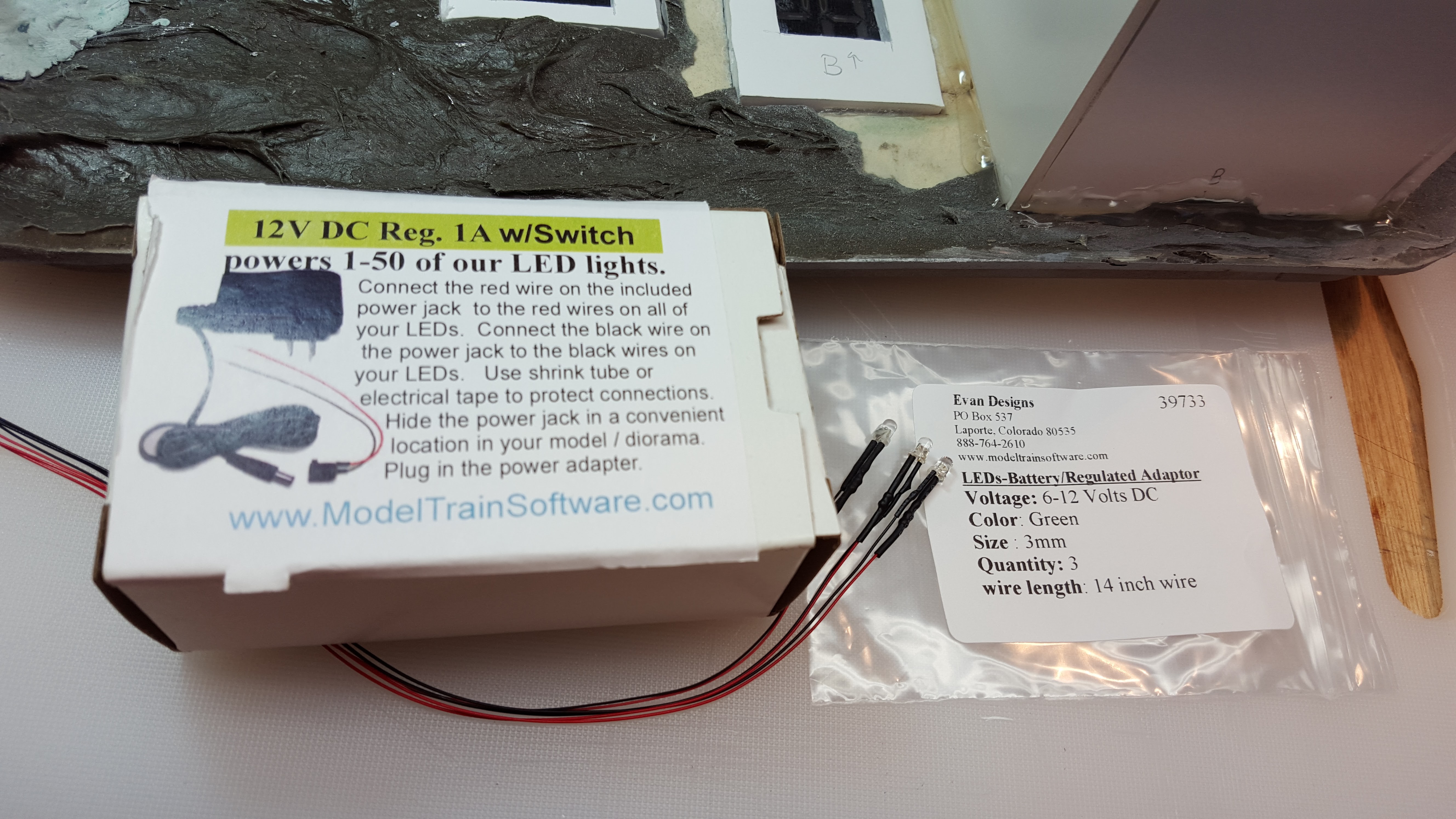

Step 25:
The LEDs that drive the large green light and the digit lights are embedded in boxes made from foam core. The inside of the boxes are lined with aluminum tape to help diffuse and bounce the light inside.
Step 26:
The LEDs are powered by a 12v DC Reg. 1A Switch – meaning they simply get plugged into the wall for power. For this setup, you can drive dozens of LEDs, however for the project I’ll use around 10.

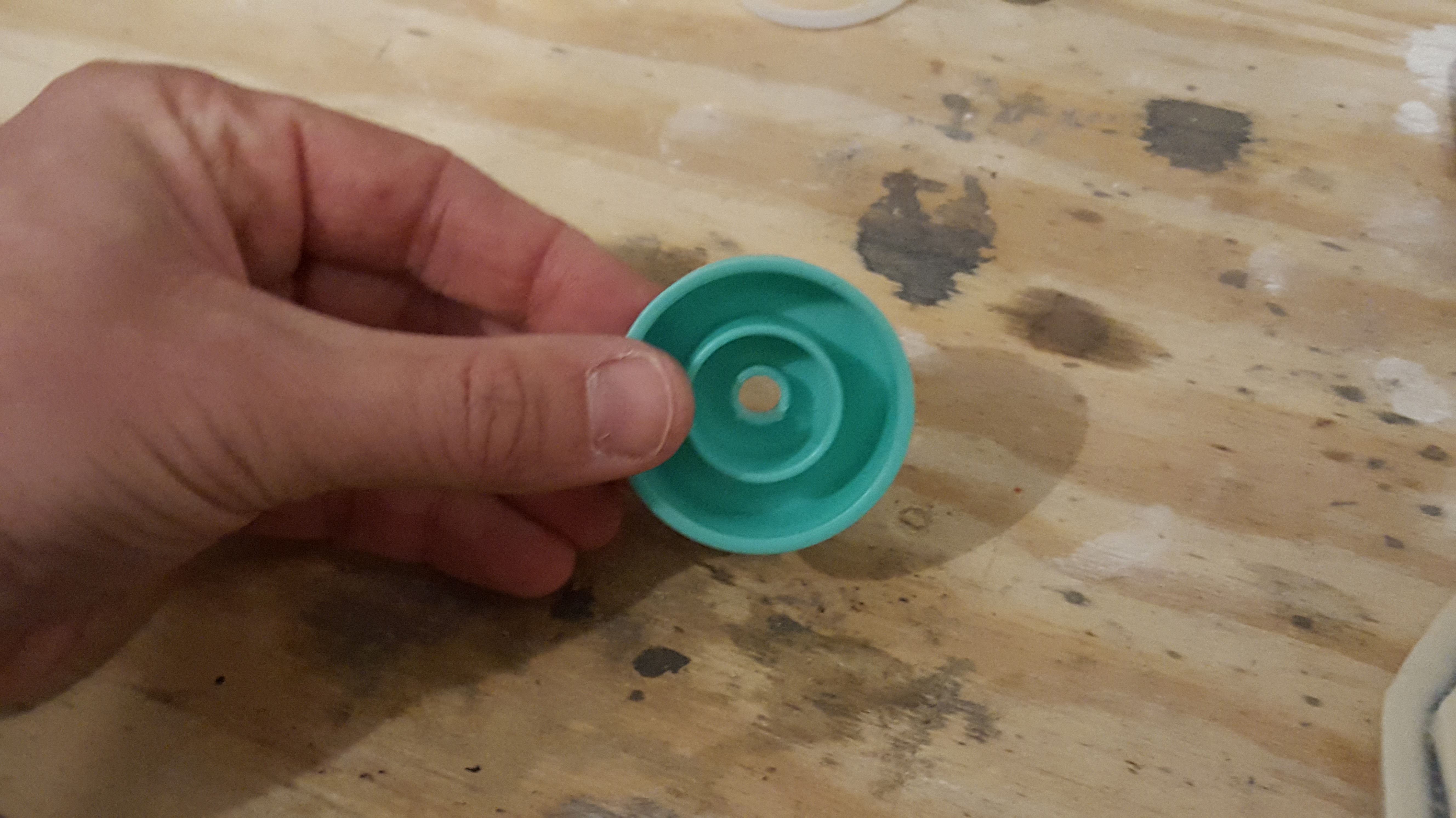

Holes for the remaining LEDs are drilled and secured with a small drop of super glue (CA glue). An ON/OFF switch from an old set of speakers was used to turn the LEDs on and was secured using a small L-Bracket and some epoxy
