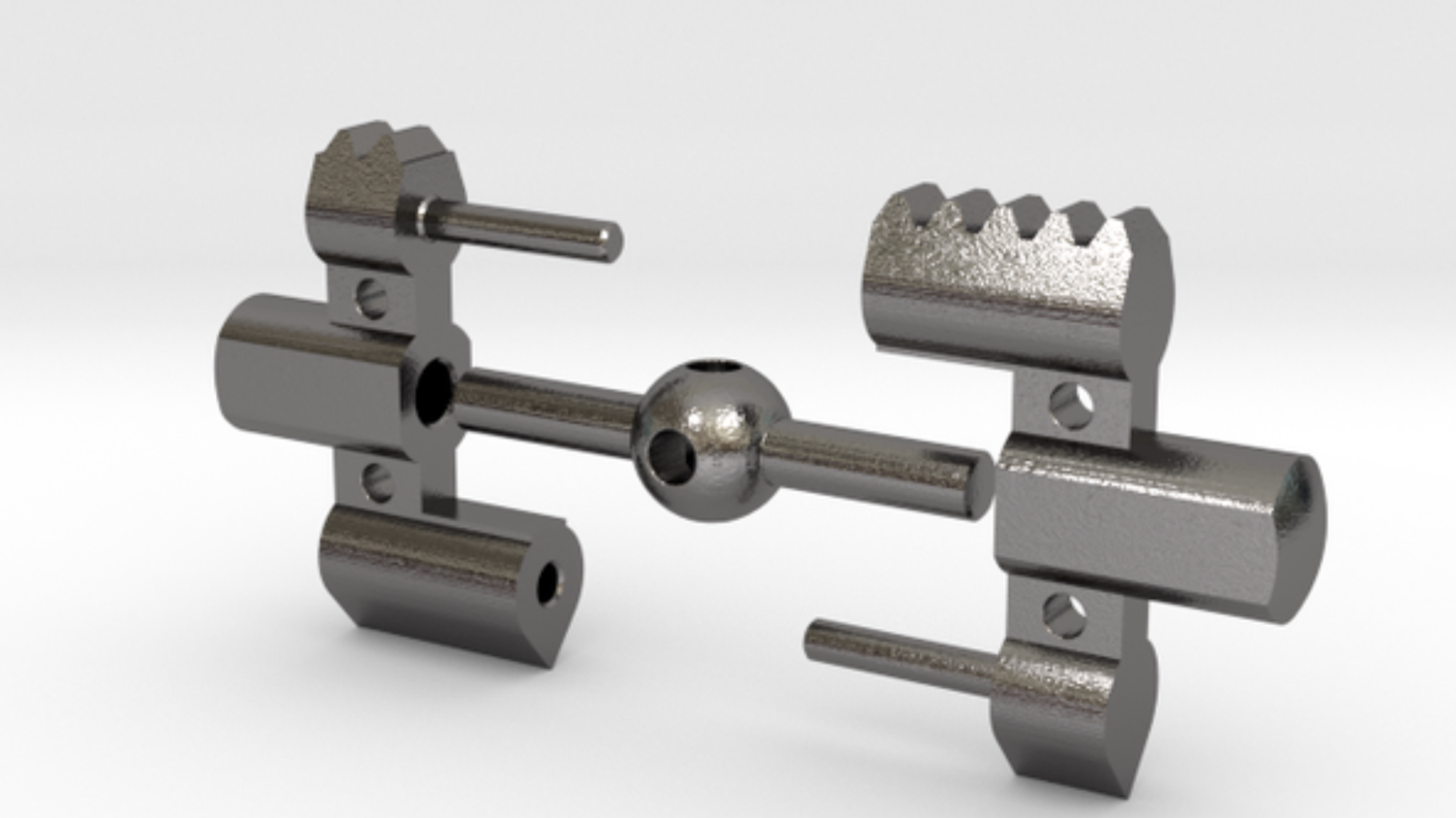

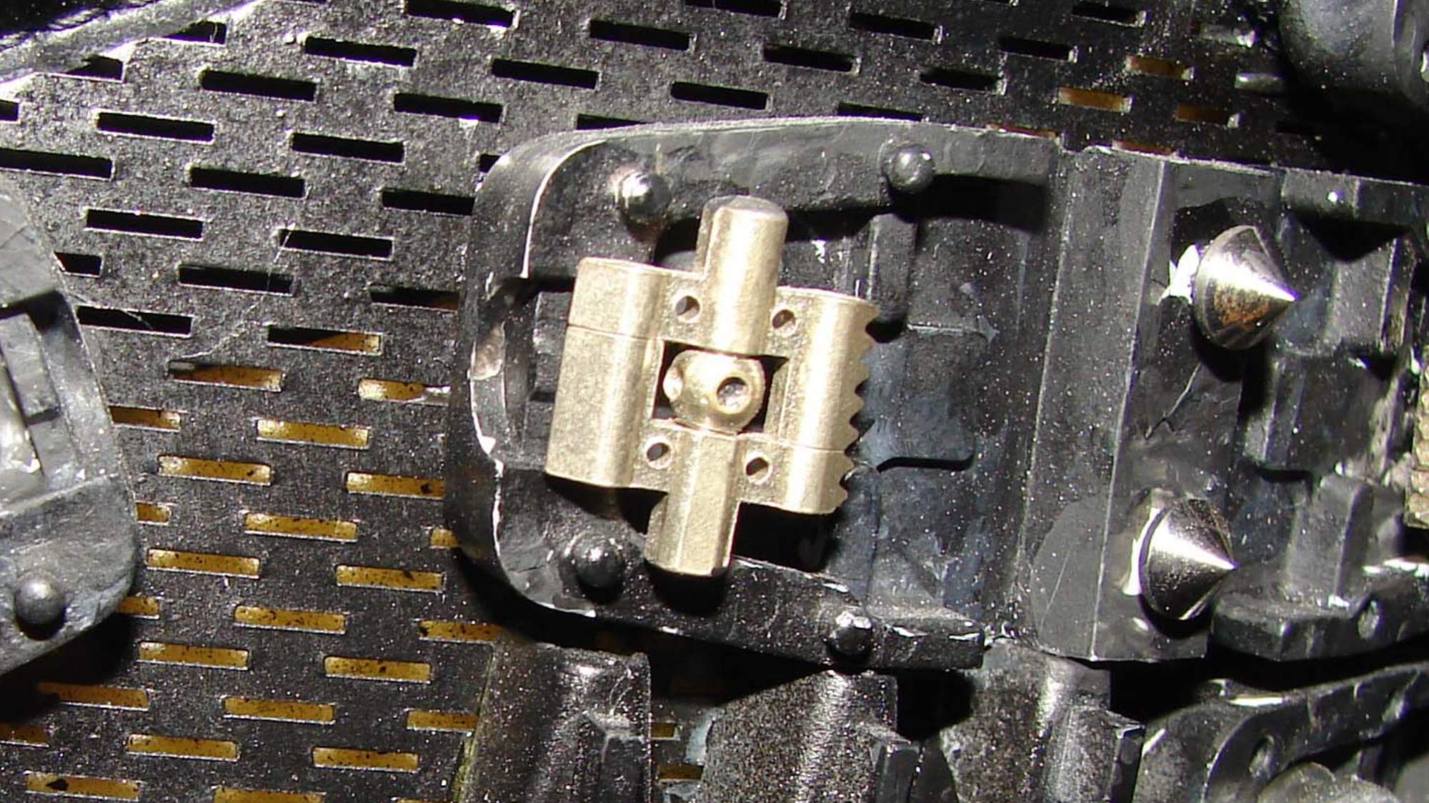

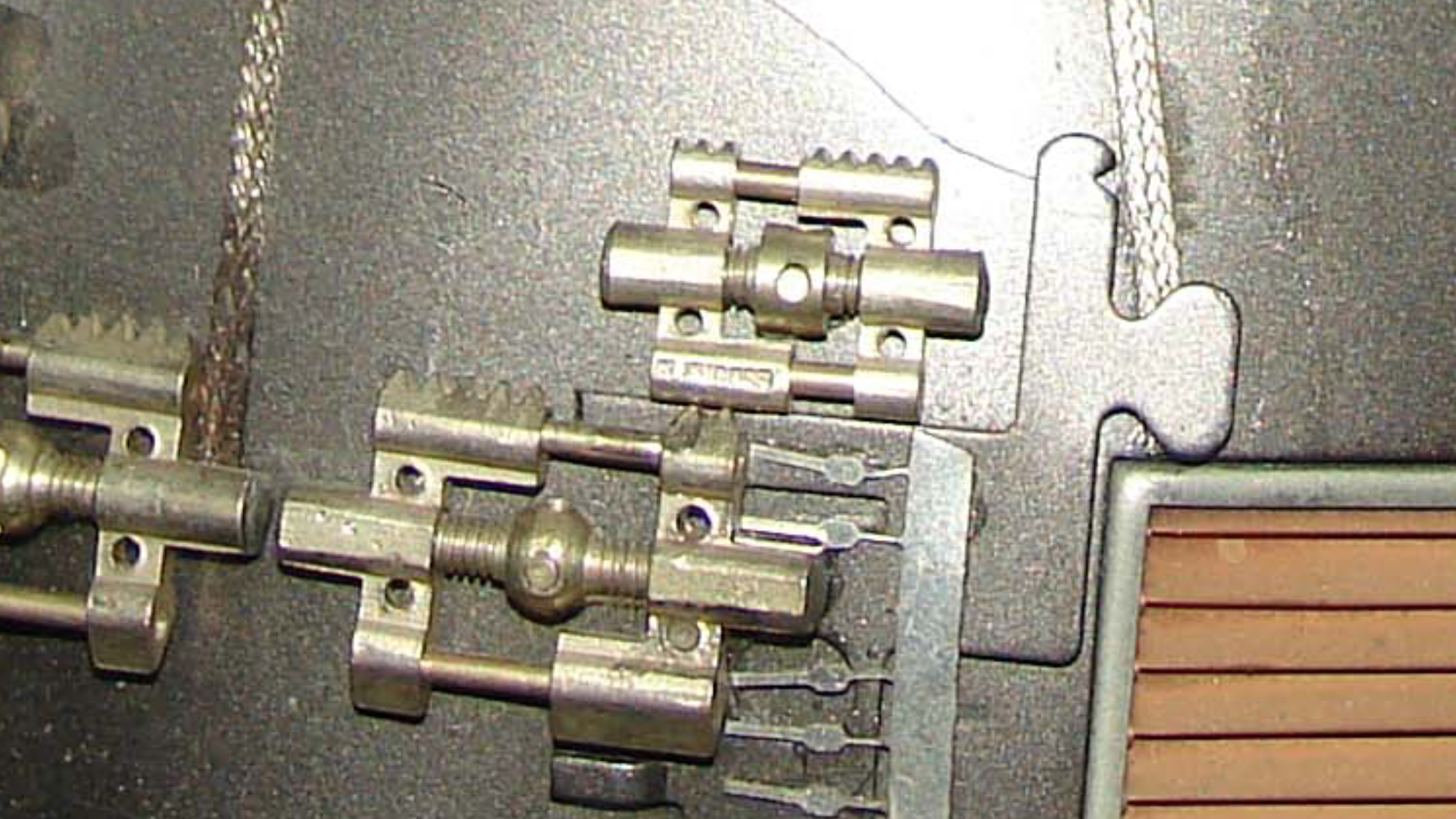

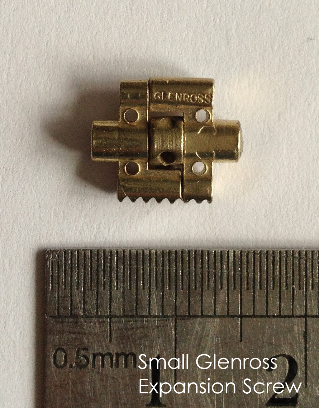

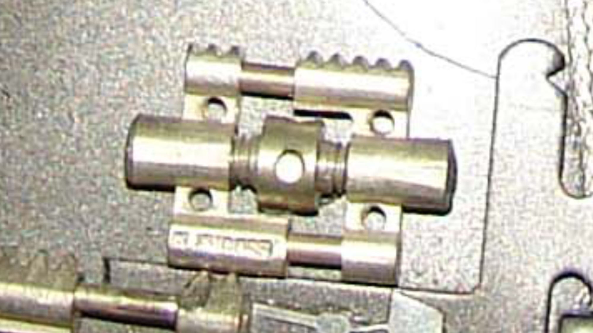

Hi Ben
There are just two types, large and small. 1 and 3 in your pics are the same, both large size it's just that the one on the neckbrace has been wound closed, the 'Glenross' lettering is on the other side.
You open and close these using a little metal prong that you poke into the hole in the middle bit and lever it round. They also come with a short metal post that also fits into the middle hole and that's how these pieces are attached to the Reveal mask.
Hi Ben
Ahh got it now I thought the ones on the collar were the small ones (my bad going to edit last post ) and look and work harder next time:facepalm
Working on so many bits my head is jangled :facepalm

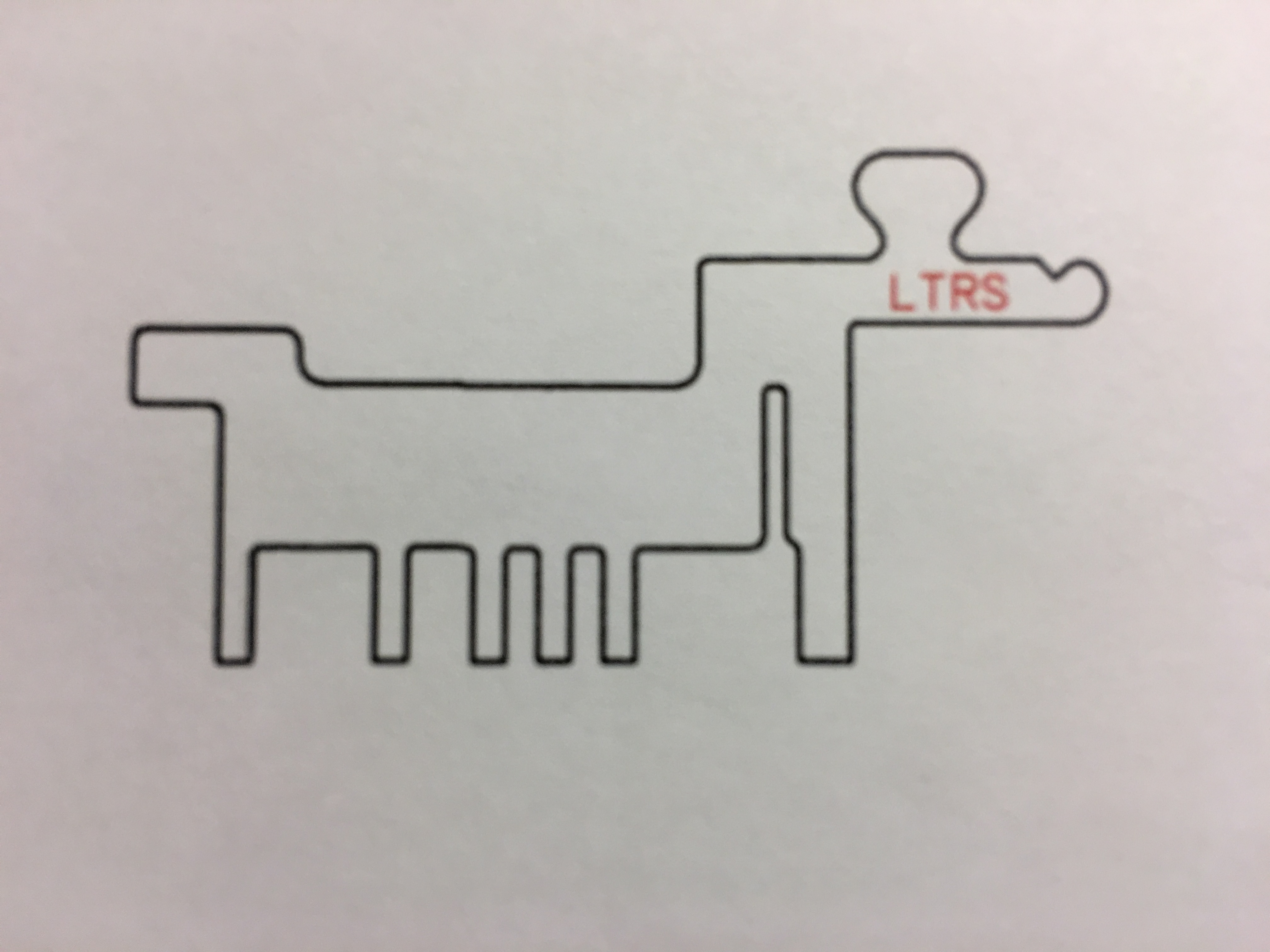

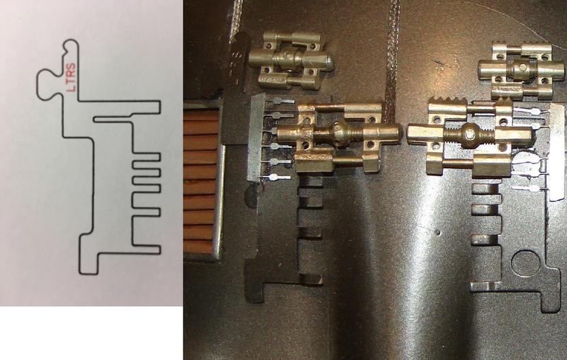

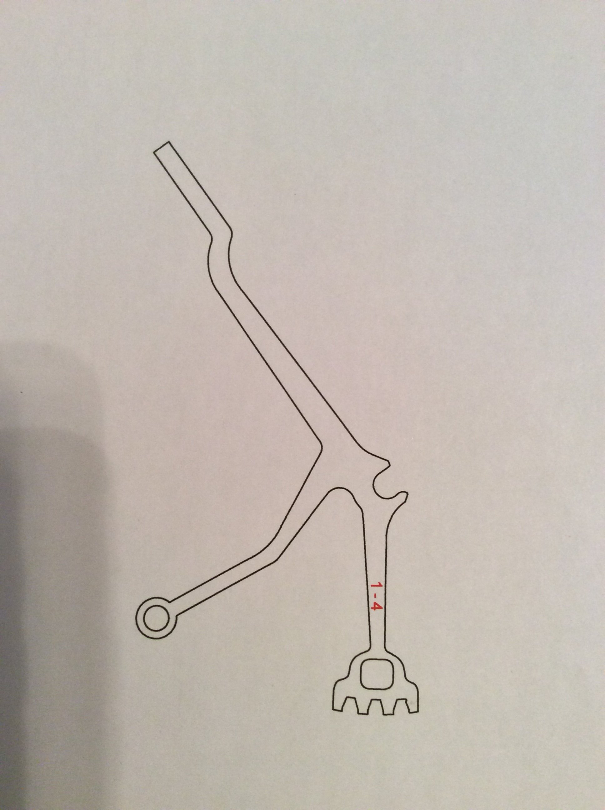

now that I've redrawn the brow linkage I'm going to concentrate on the one without the holes, the one that has the LTRS stamped into it, tryed to stamp it myself with a jig just didn't work out as I would have liked, also I was to busy with the real world ( work ) and having to do 25 for the kits it just wasn't looking right for me but I will keep trying. SO what I've done is :
now redrawn I've added a separate layer in red for the photo etching company. The red lettering denotes half depth etching on that face. I'm going to send it off for pricing so they all will be the same.
BUT I need info back as to the look of it as I don't wat to send it away, get it cut, spend money and later find out that my efforts have gone to waist as I was out a little bit out and have to scrap it and try again ( money ain't cheap ) this happened with my vocoder part ( now being re cut )
please chip in if you can
Thanks Ben

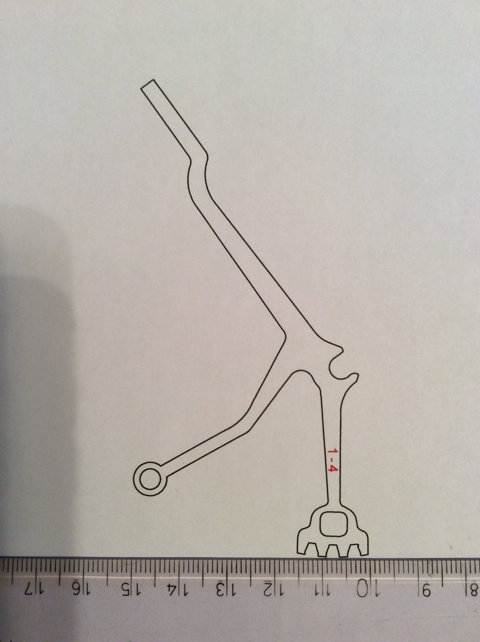

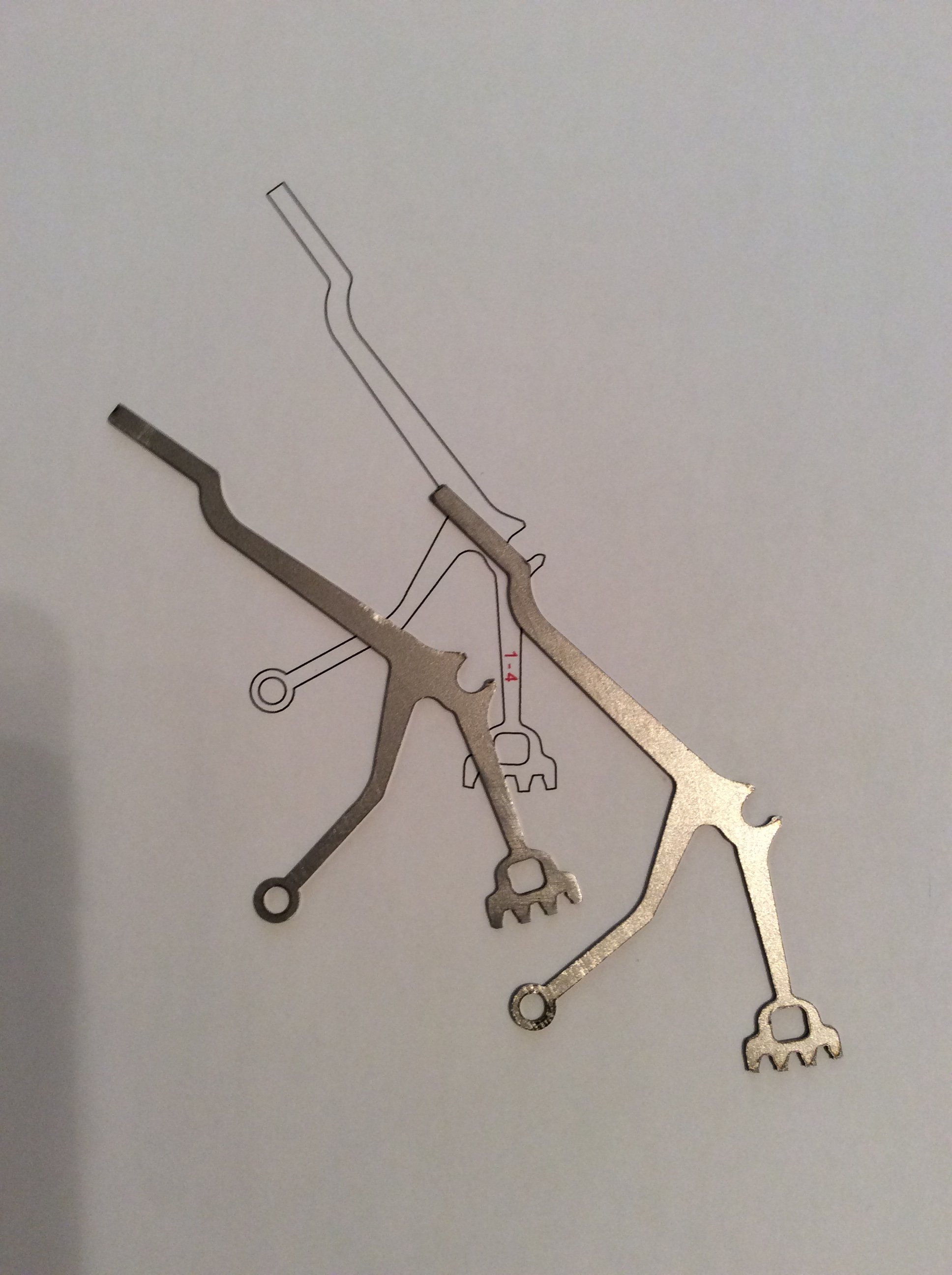

Now that I've redrawn and had cut the face linkage I thought I would put the 1-4 in place for the photo etchers but I'm not going to have these done as yet until I get my ROTJ helmet from CFO as the helmet is my main scale item, I'm sure some of my pieces are going to be fine as they are scaled off accurate items but to be on the safe side I'm now holding back from over producing the pieces until my build, at the end of it if it looks good and accurate on mine then that's what I will eventually be offering BUT the scale will only be for sskunky's CFO ROTJ HELMET as that's the only helmet that should be turned into a DV reveal ( in my personal opinion)
I've redrawn this from other members photos and information if you have an original piece or a copy of an original please please tell me where I might have gone wrong OR send me your piece to copy so we can all get a piece of the perfect action ( no harm in asking )

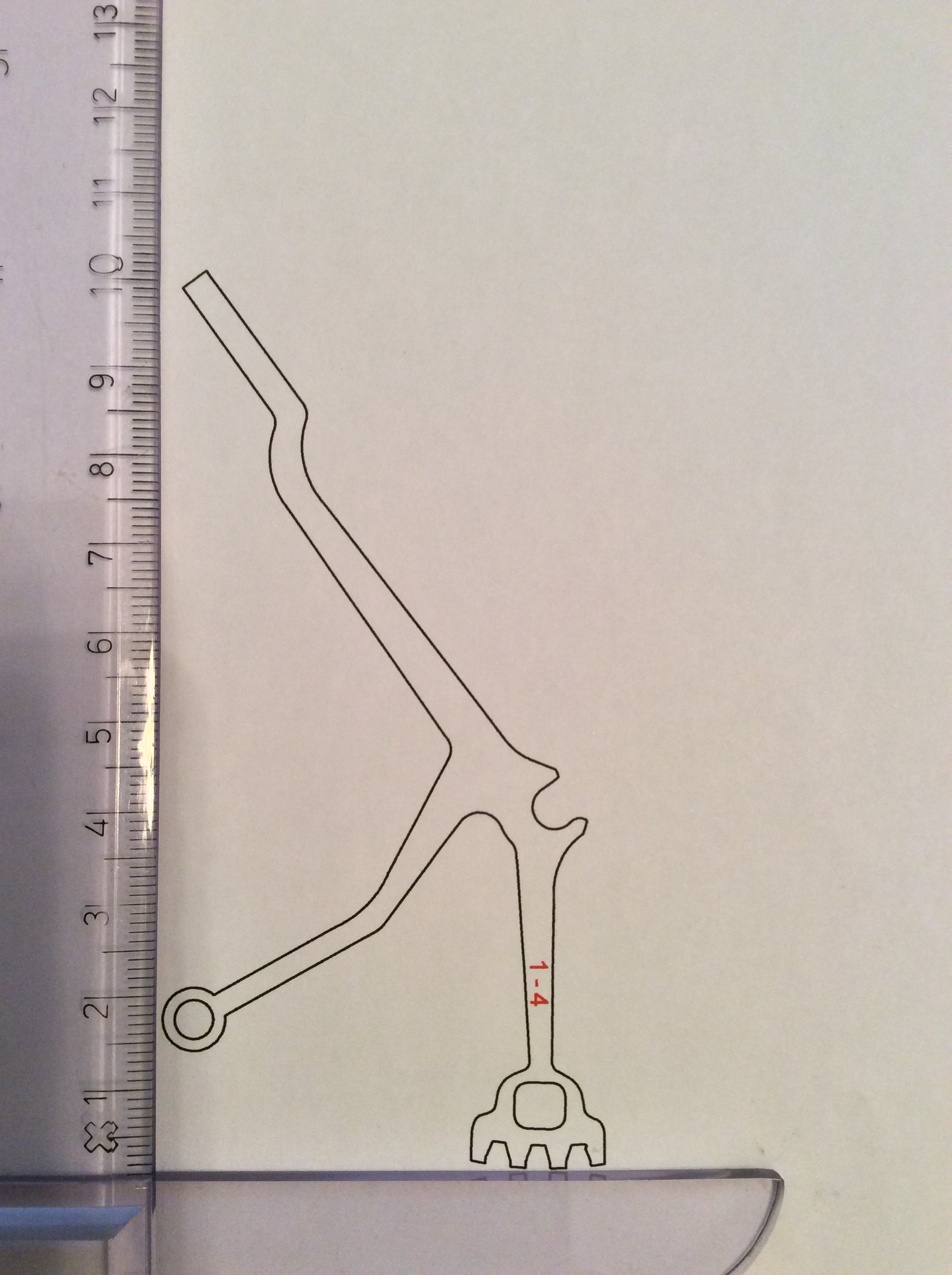

And here is the scale, please tell me if I'm wrong
Version 5.3 I think I've lost count :facepalm
Looks very good to me...
It is very hard to build the parts without a mask.And if you become a mask later its also a thing how the propbuilder has made it.(how high is the crown,where are the dynodeholes over the mask...etc.)Also the complete size of the mask itself.
http://up.picr.de/28297638vt.jpg
Thanks Mark
ive also thought about the height of the crown and the positioning of the Dynodes :facepalm that's a later stage problem I will have to work out

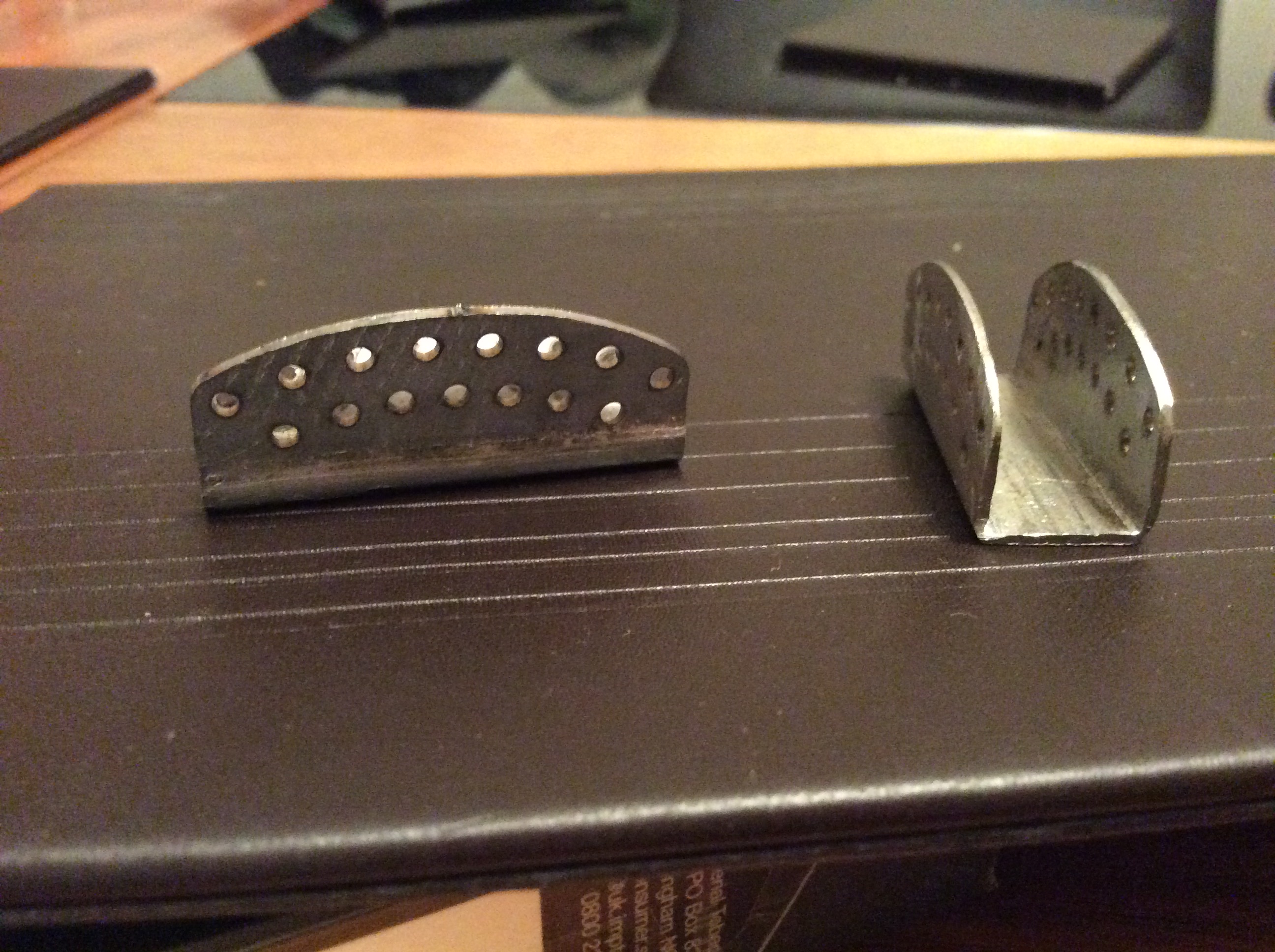

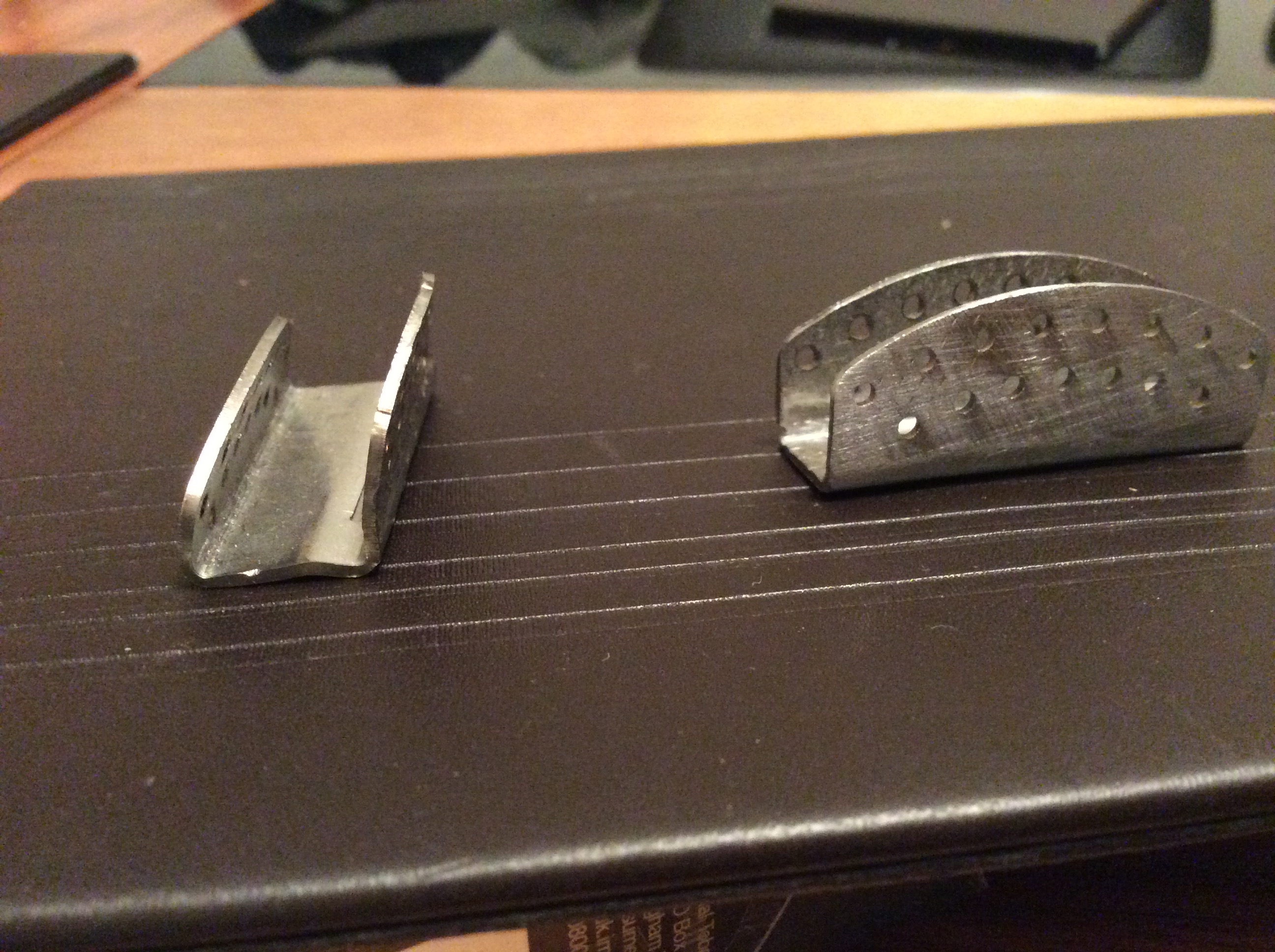

What a nightmare trying to bend the nose/lip guard 1st 2nd 3rd and 4th attempt total failure 3 and 4 are probably now in orbit as I launched them out of pure frustration
i need to try thinner metal either 0.75 or 0.5 but I don't want to loose the look of it if I go thin then i might have to give it a heavy chrome plate to give it the correct look also might have to go slightly bigger holes as the chrome will close them up
I will try again later this week

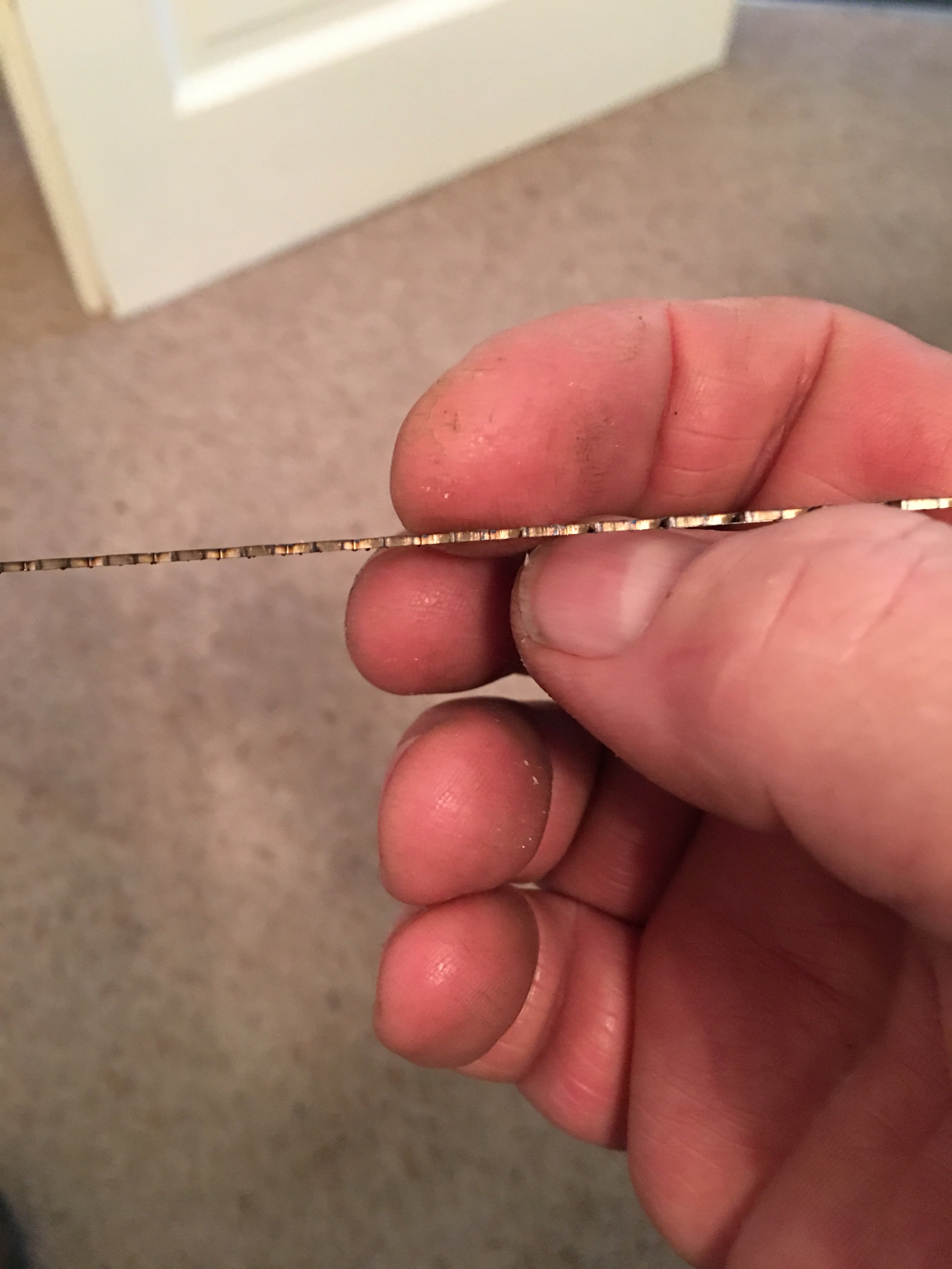

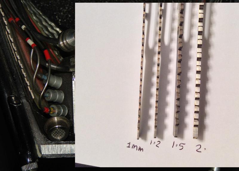

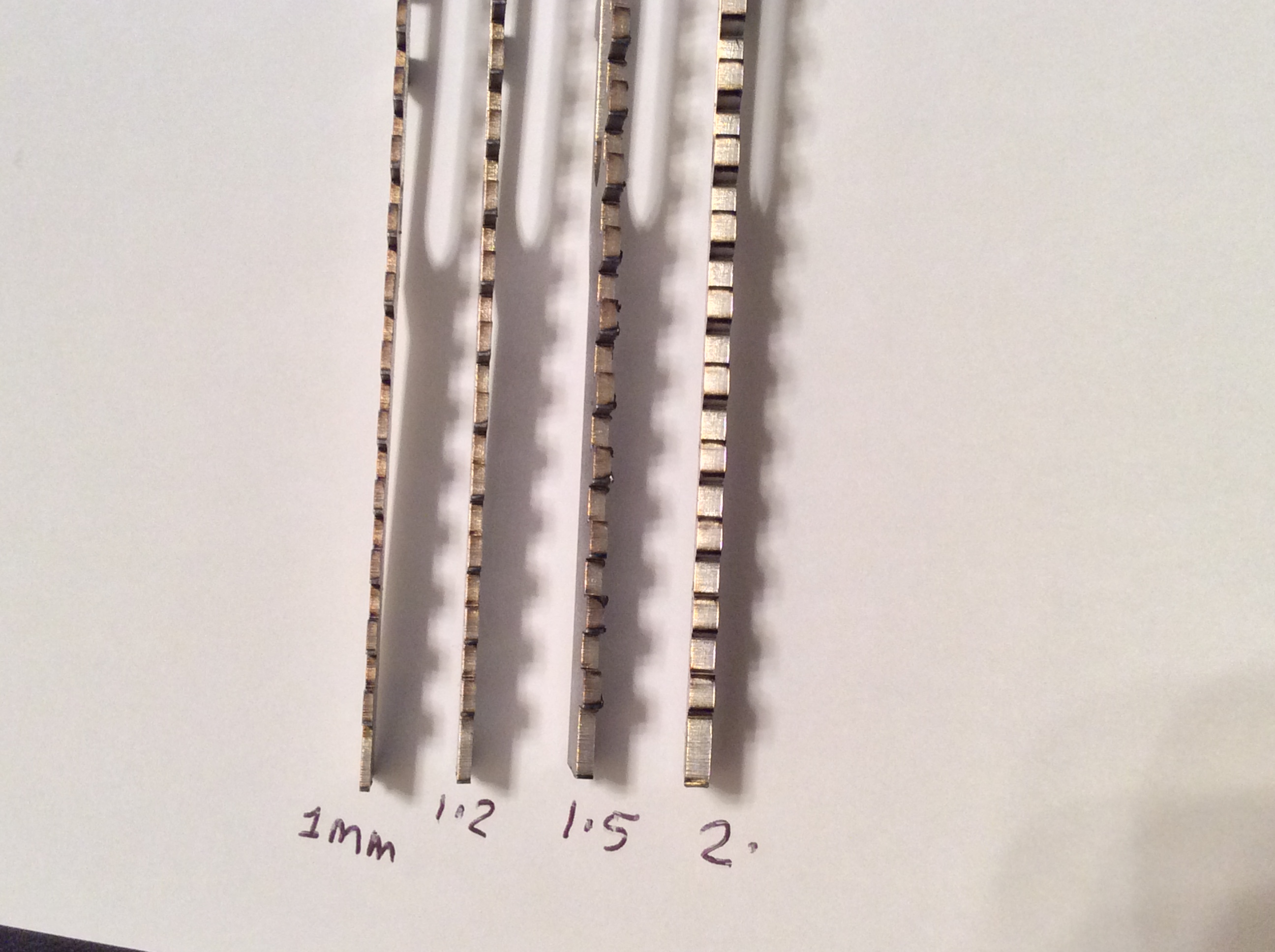

Ok as promised I've got the lower jaw teeth or zippers back from my "laser cousin" and I've had 4 different sizes cut from left to right 1mm , 1.2mm , 1.5mm , 2mm
please all look closely and tell me what will look the best on the DV reveal my personal opinion and trying to scale them I would say 1.5mm
please comment as the size with most votes gets cut for the kits
1mm seems very thin in hand
Kroenen77 (mark ) I've still got your address I will send you a few put them on or near your build and compare them and post some pics on here so we can compare :thumbsup
