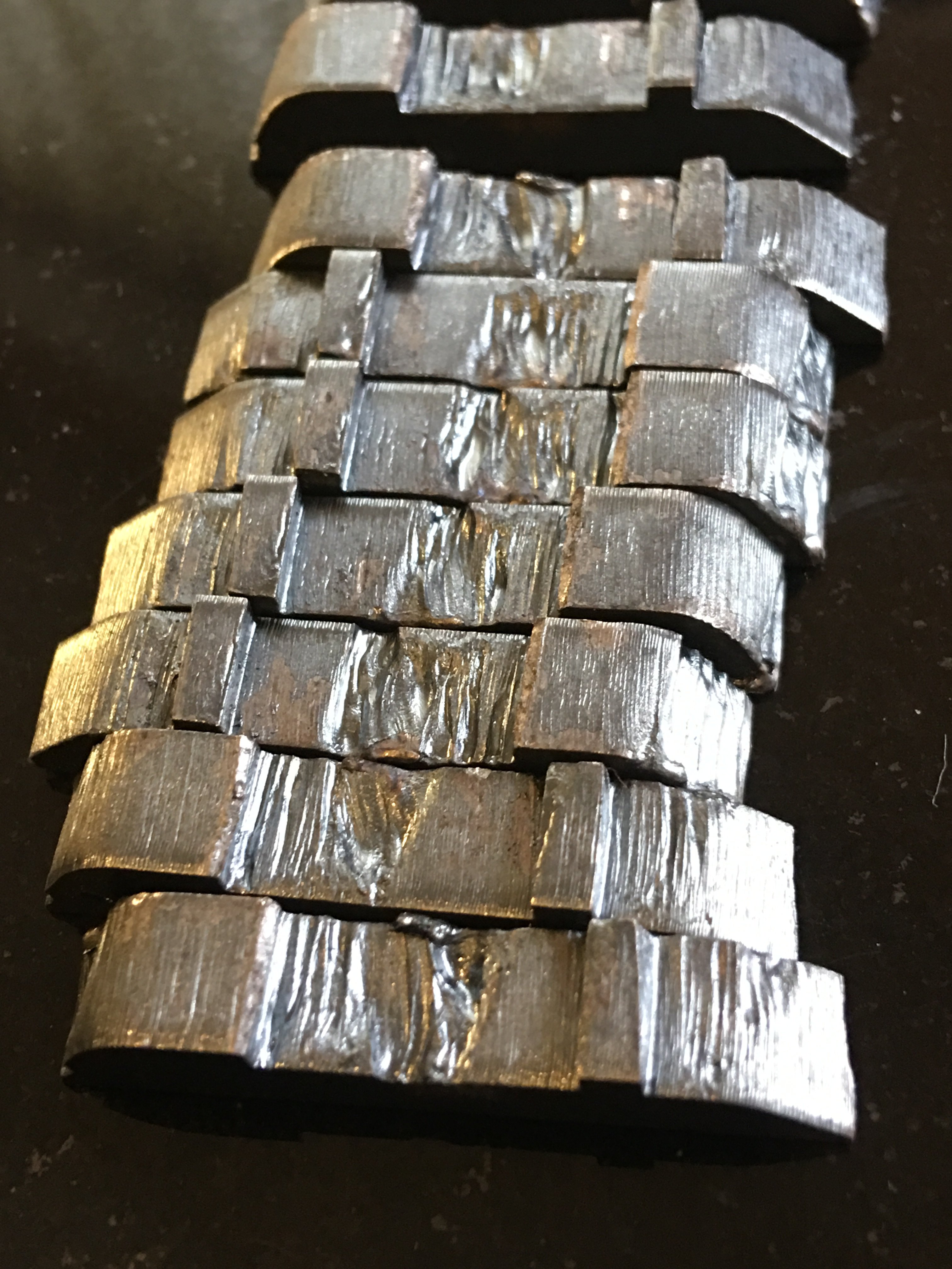

Got the vocoder keys back from my laser cousin made from steel as I'm going to take a cast from them and mould them from aluminium, but what a sack of Bantha fodder !!!!
He said the laser cutter had a dickie fit should have just chucked em in t bin ( trashed them ) for our American cousins

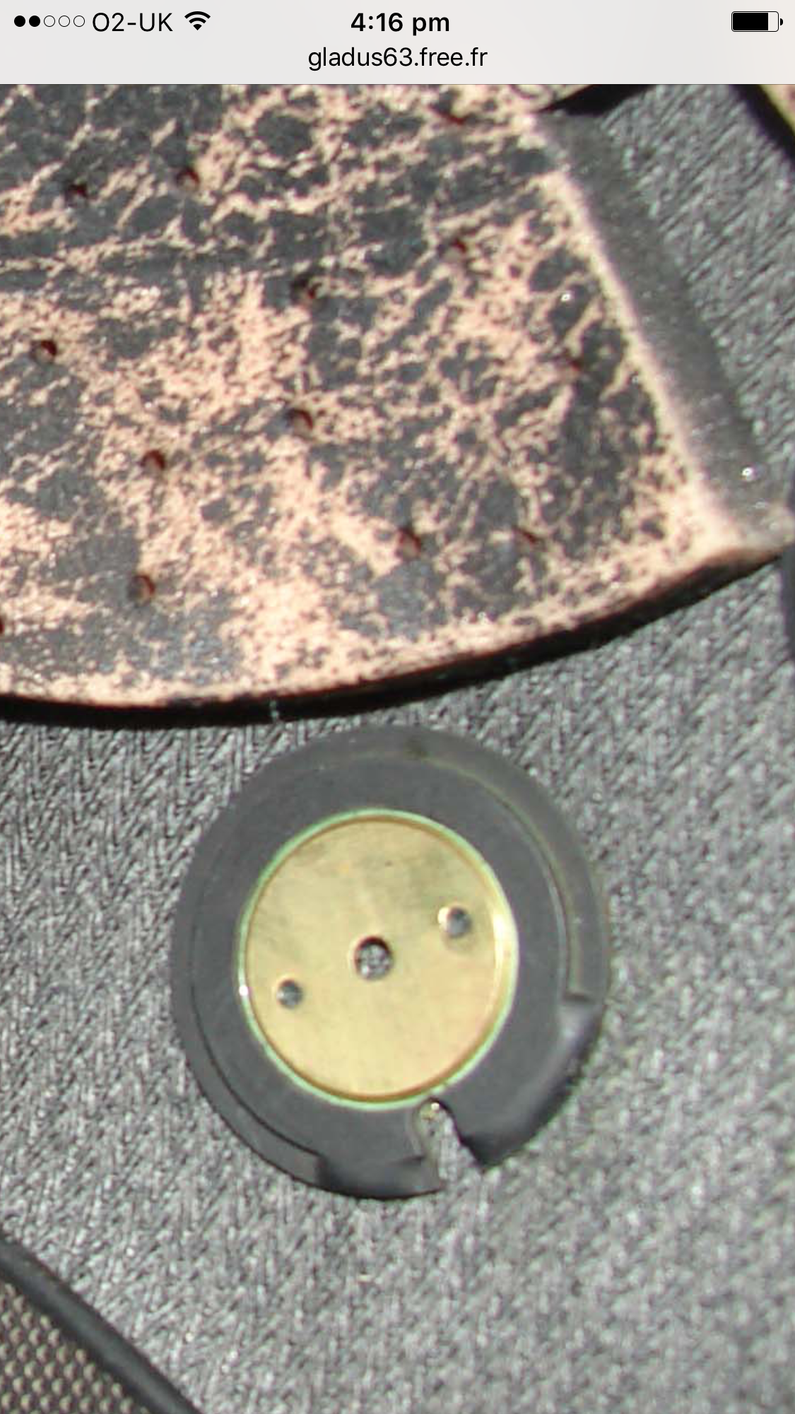

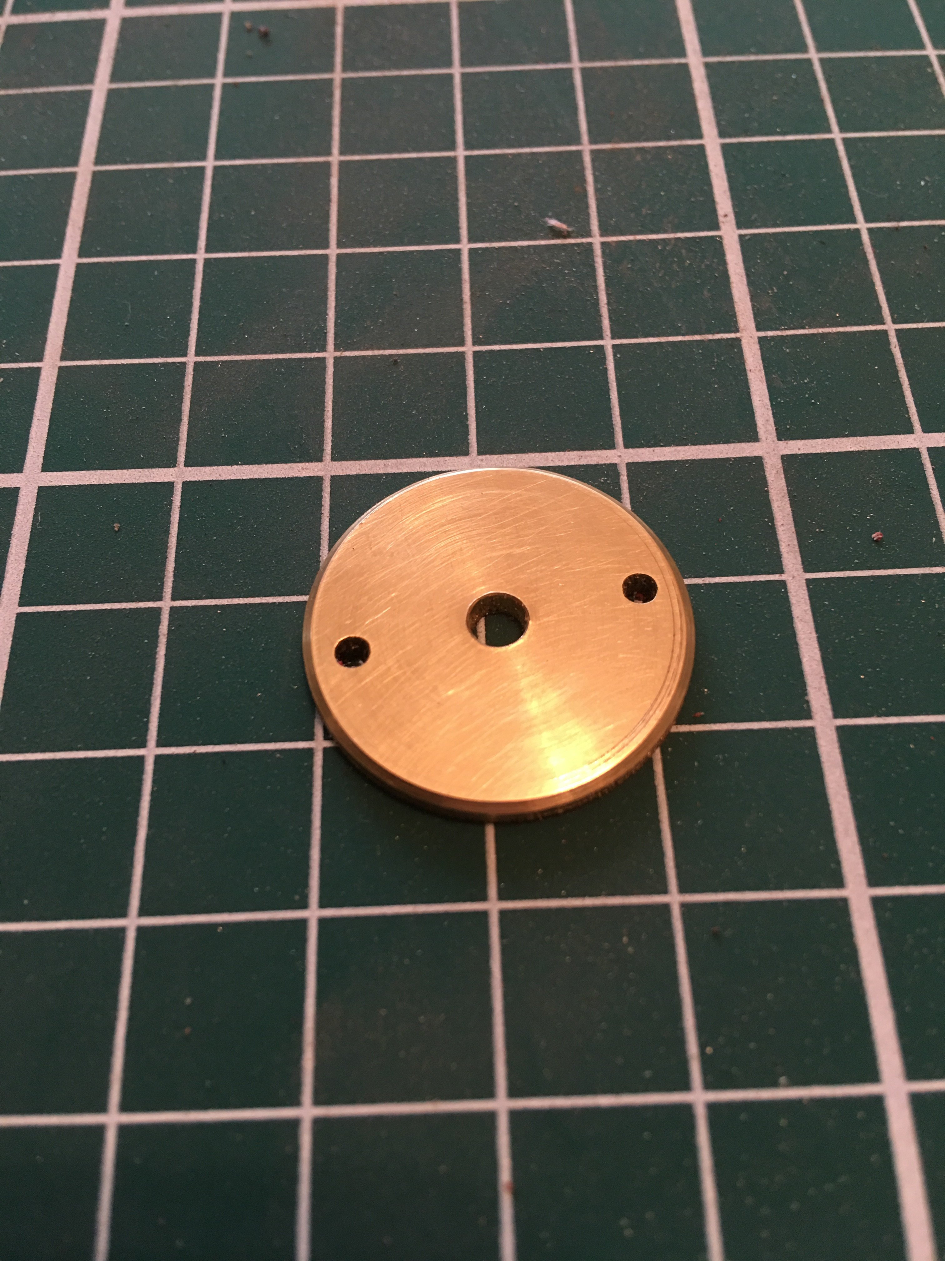

I've made a brass disc with centre hole @ 3.5mm and I think it looks more to the screen than the 4mm I've seen and originally cut so the rest will be 3.5mm I've also measured the outer holes ( 2mm ) in the correct position, not like my first attempt, now I'm going to draw up the molds for the black rubber backing thingy's
There are 4 discs per mask and if I'm planing on doing 25 kits then I need to be sure of my measurements 24mm disc 3.5mm centre hole 2mm outer holes, from centre of the disc the outer holes centres ive got 9mm centre to centre distance, now if you know of the exact measurements please please tell me before I make 100 discs and find out they are not correct, that would be demoralising and send me to my cupboard under the stairs in my dark and damp corner clucking like a chicken !!!!
BUT 3.5 I feel is the correct size centre hole

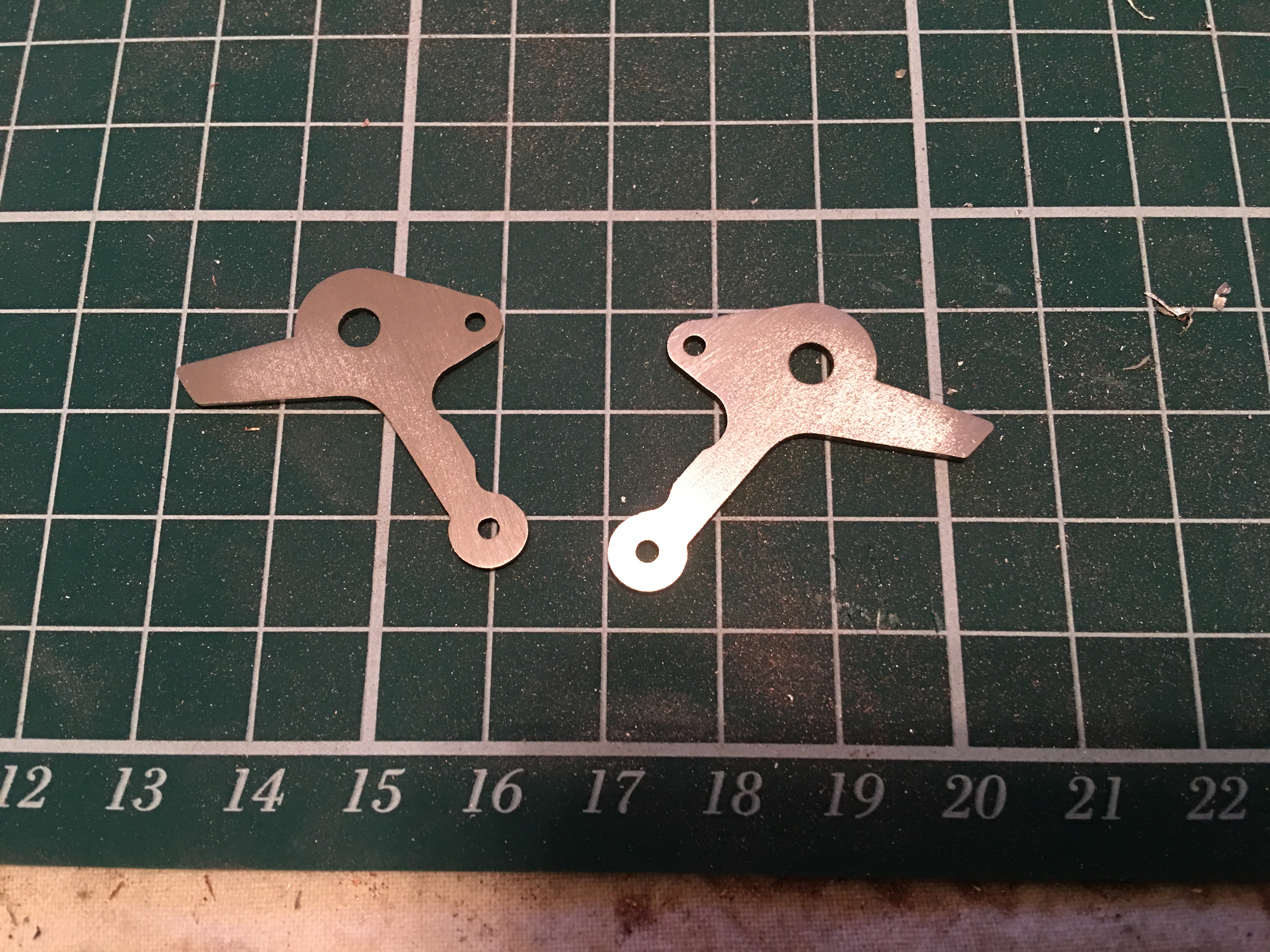

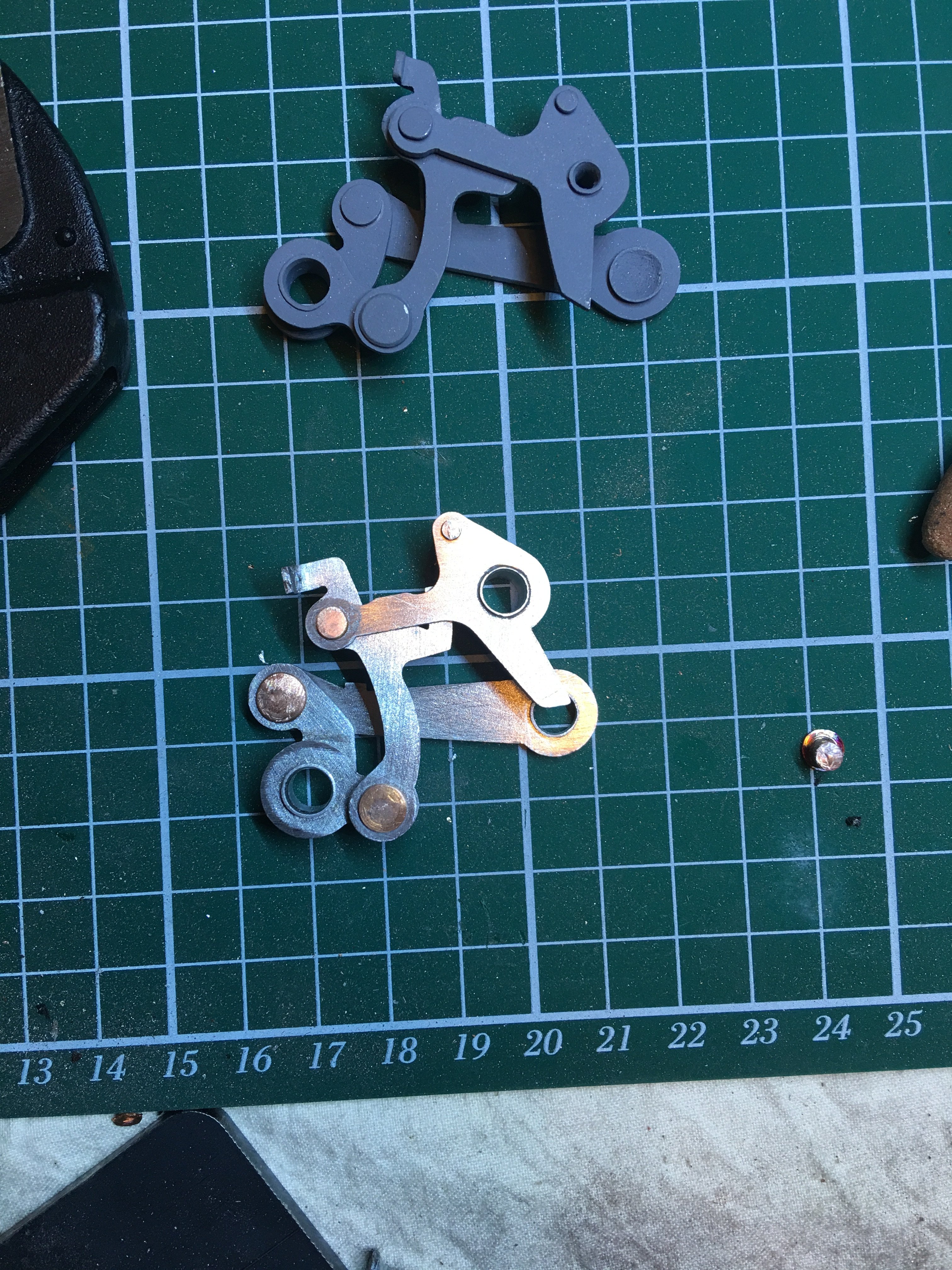

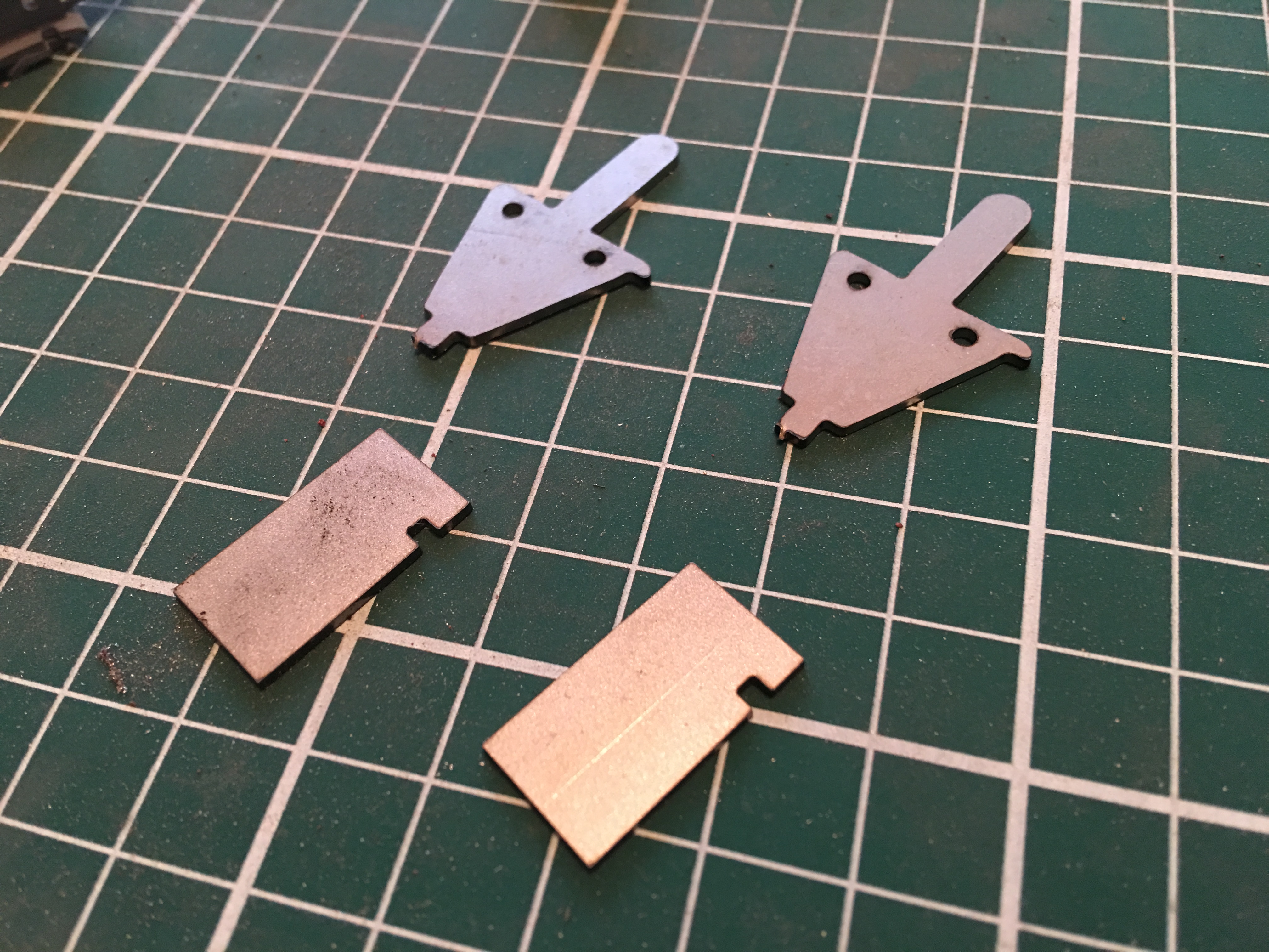

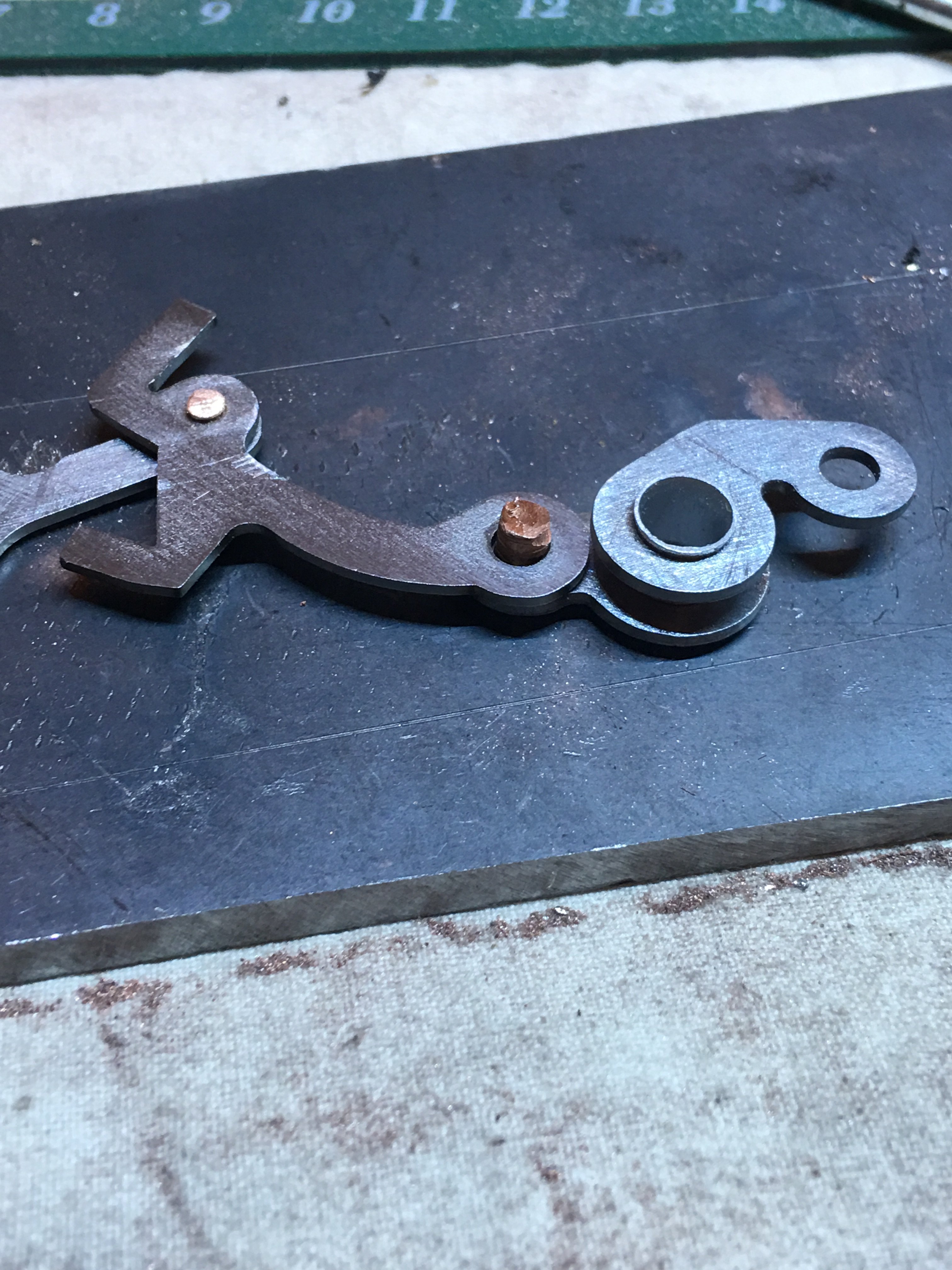

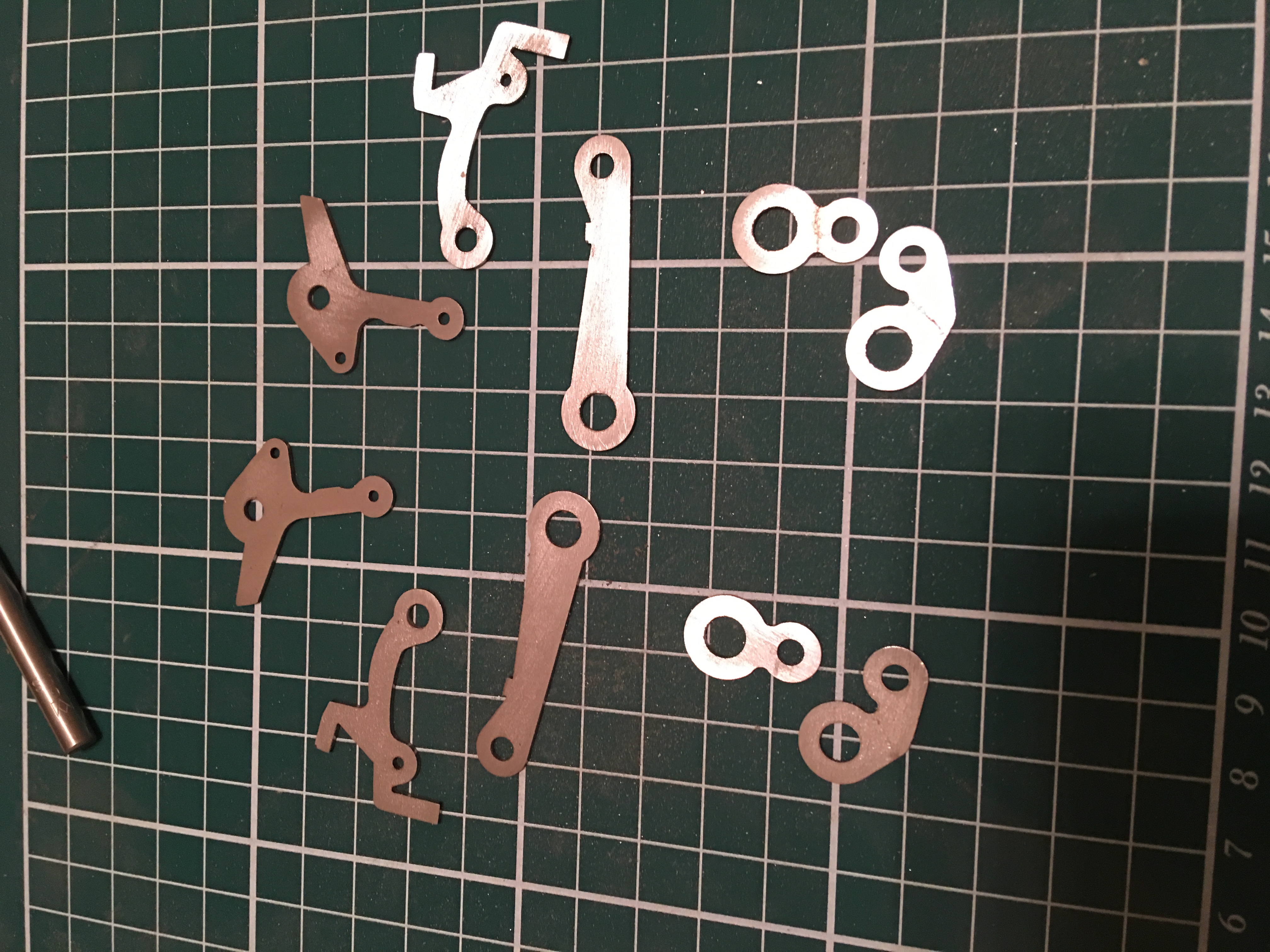

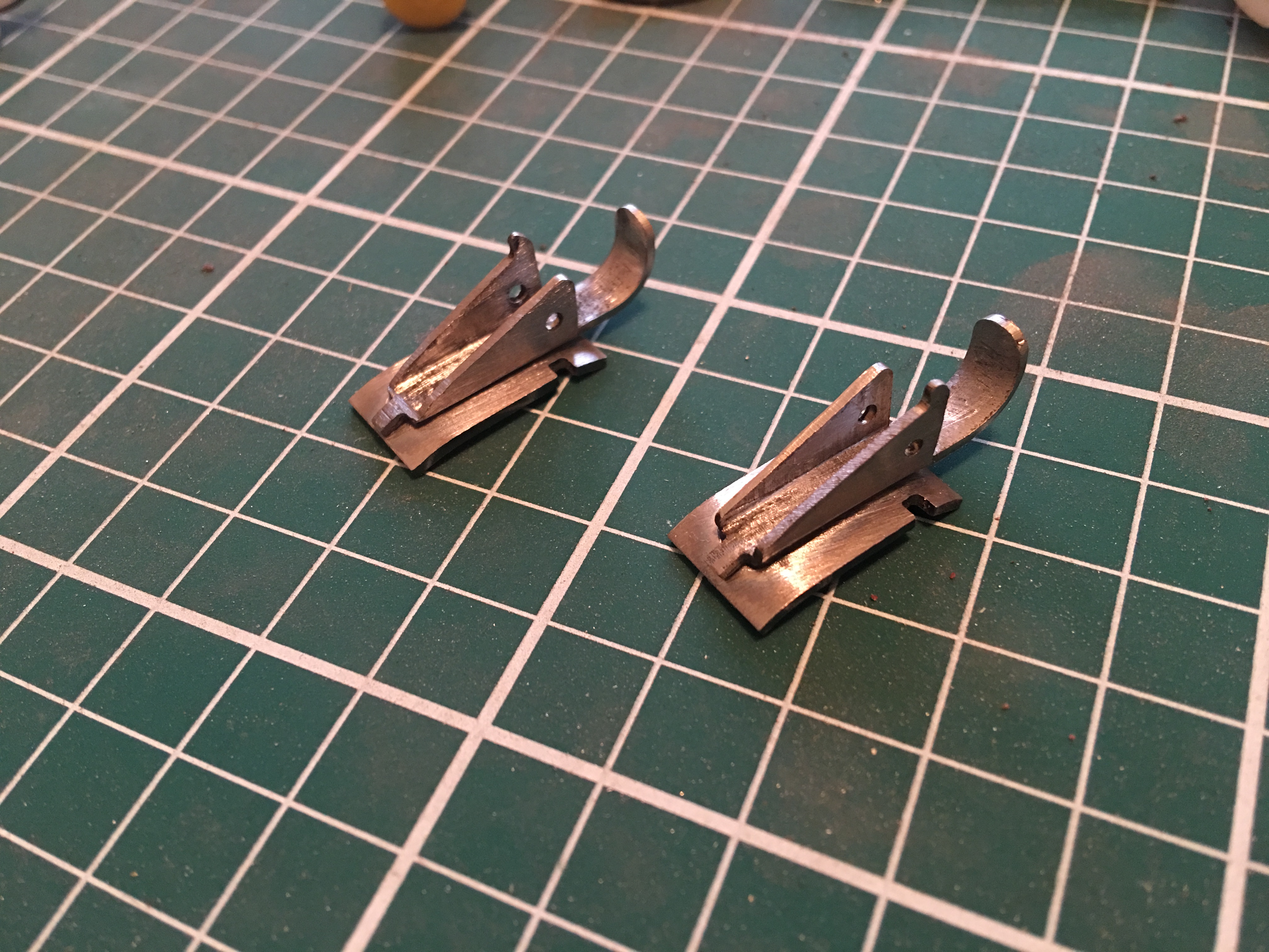

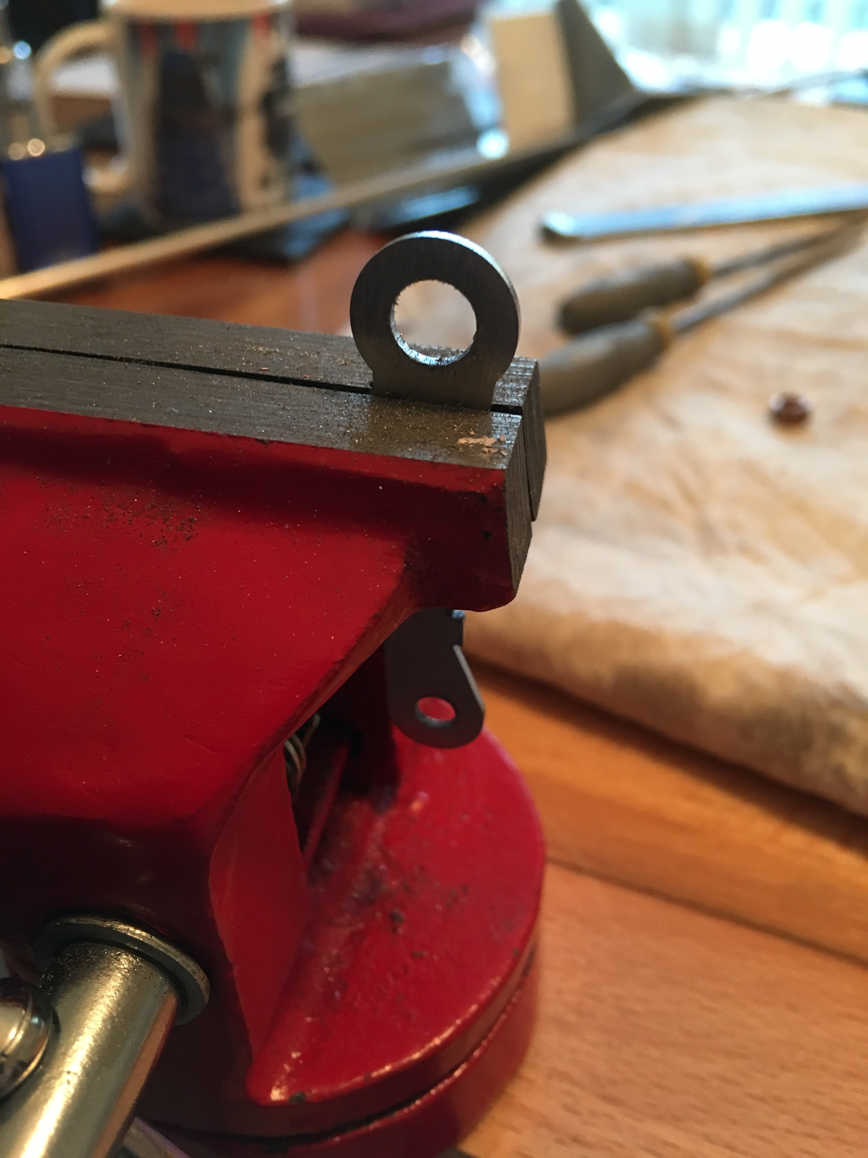

I thought I would try and put together a couple a pieces that have been laser cut from my measurements as I scaled and hand cut my first test pieces and then made a cad drawing from my hard work, now putting them together isn't that hard !!! The problem I have is bending the metal both the same, not so easy by hand ( need a better jig ) not hands and a hammer
first piece hand cut, hand bent with primer
Second attempt laser cut and hand bent
Glued together with no primer
Need to find an easier way of bending these if I'm going to make 50 for kits :facepalm

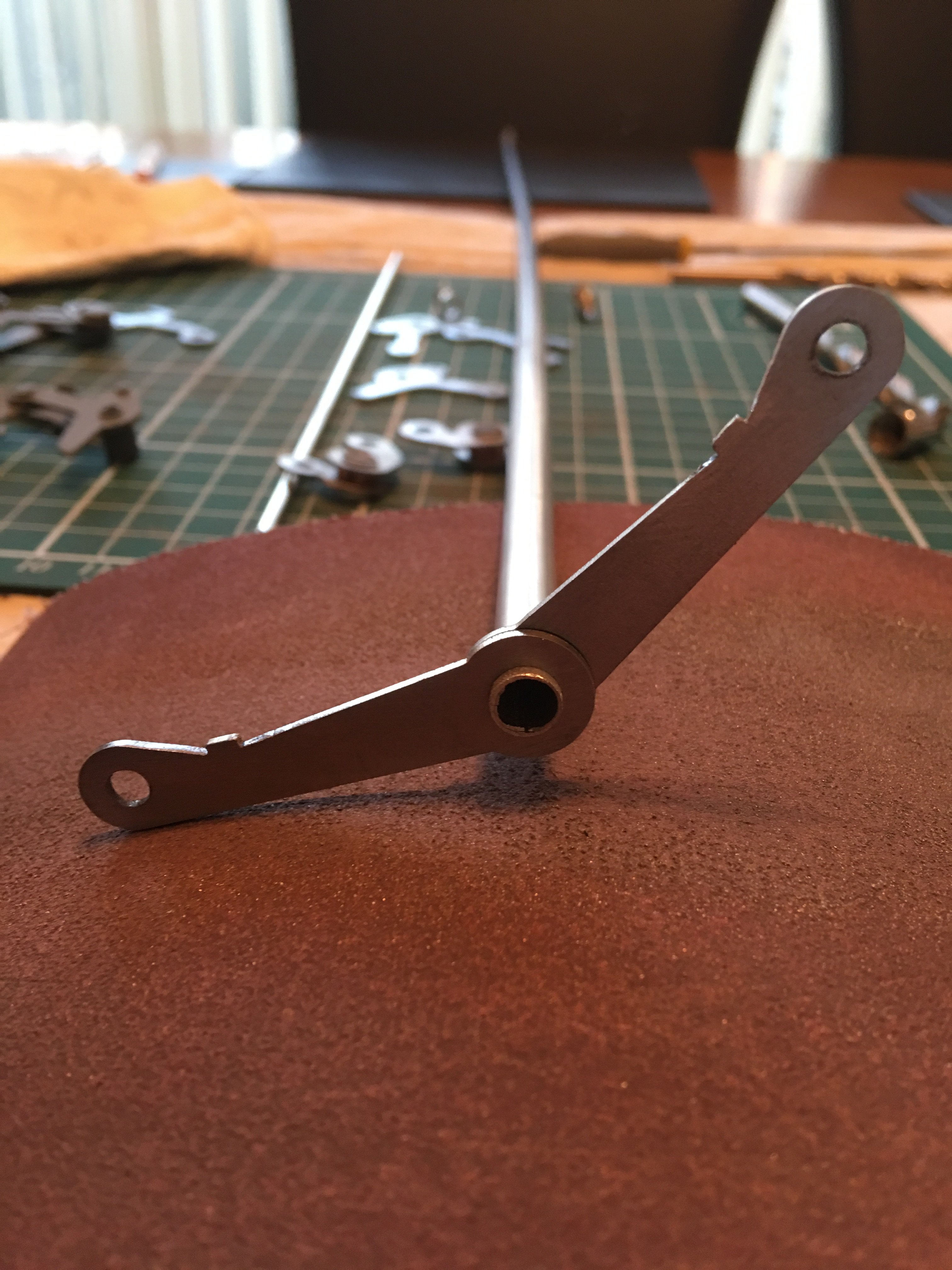

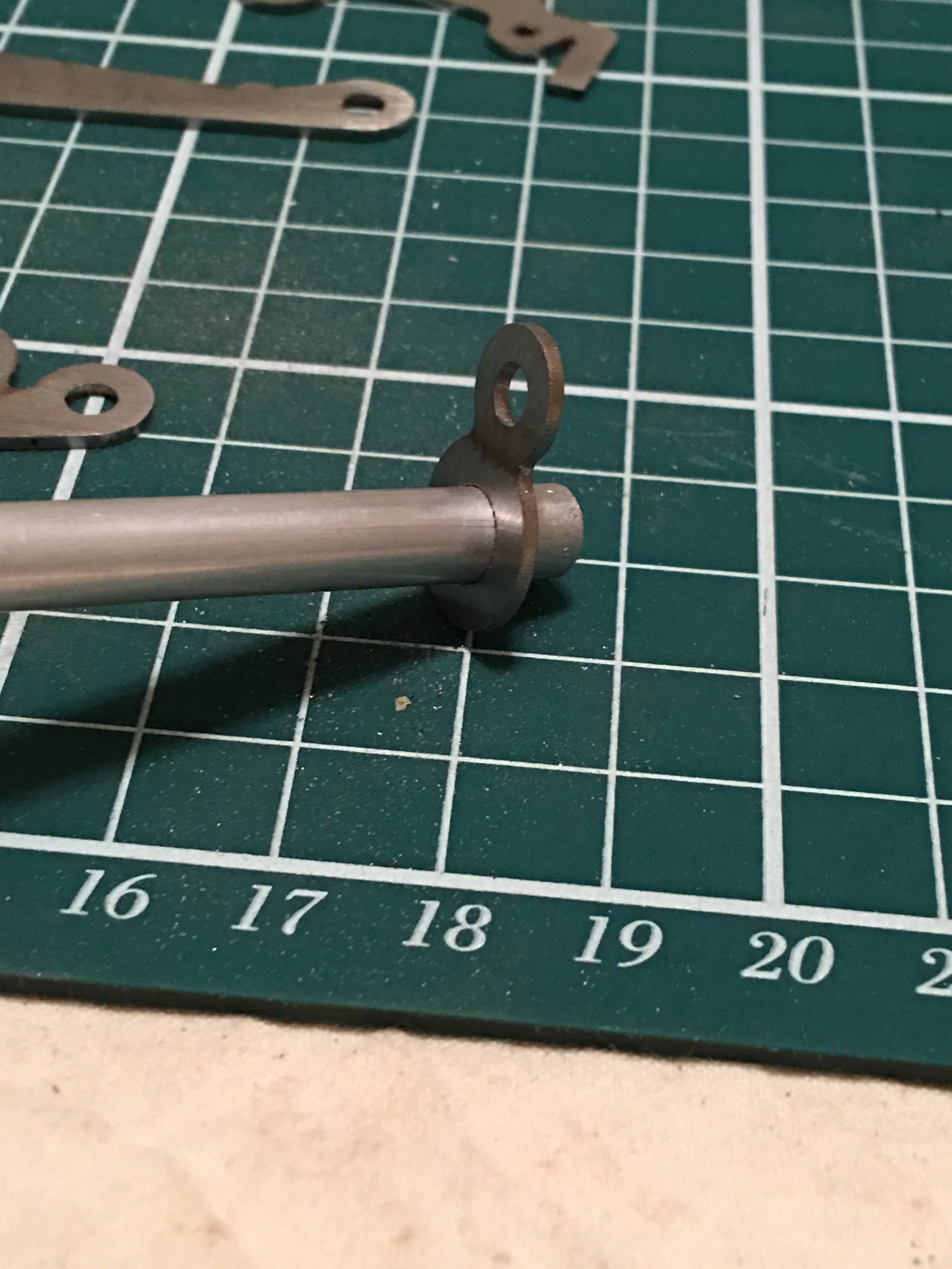

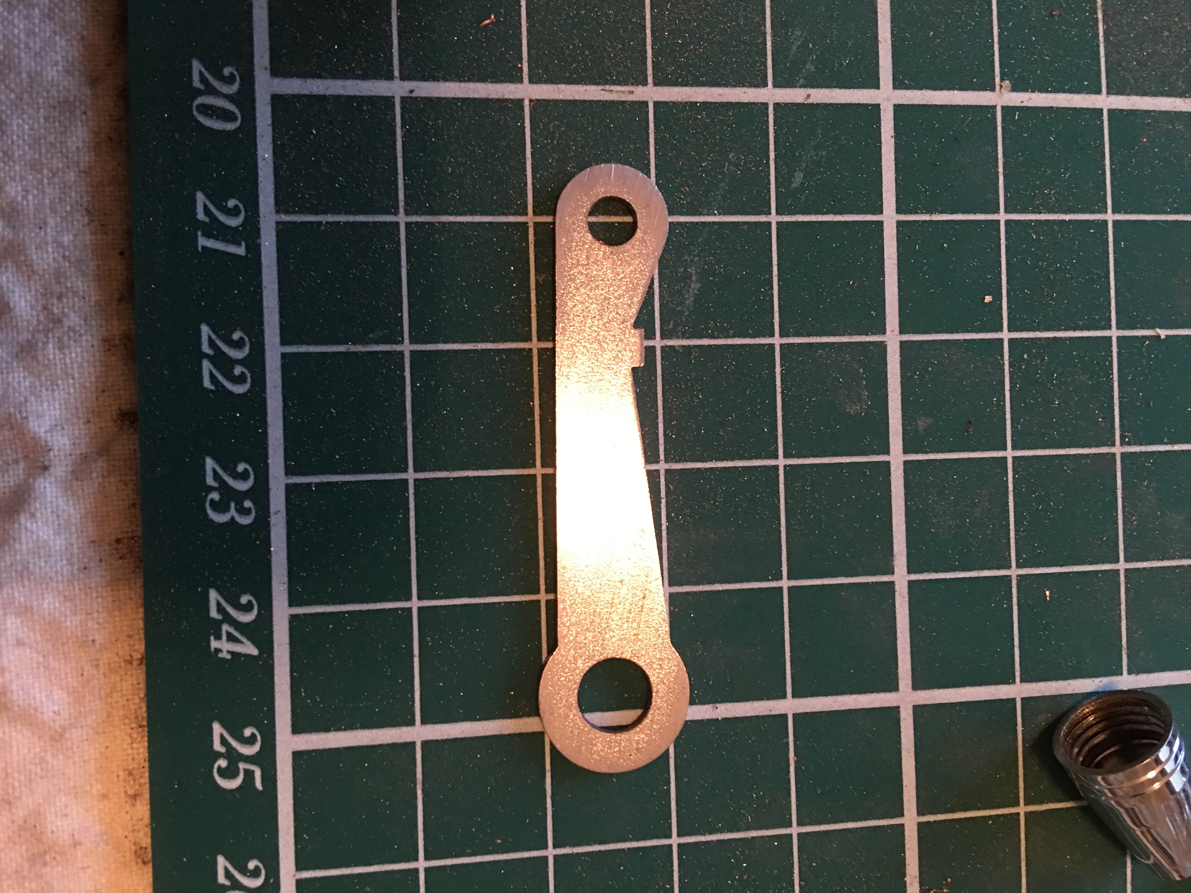

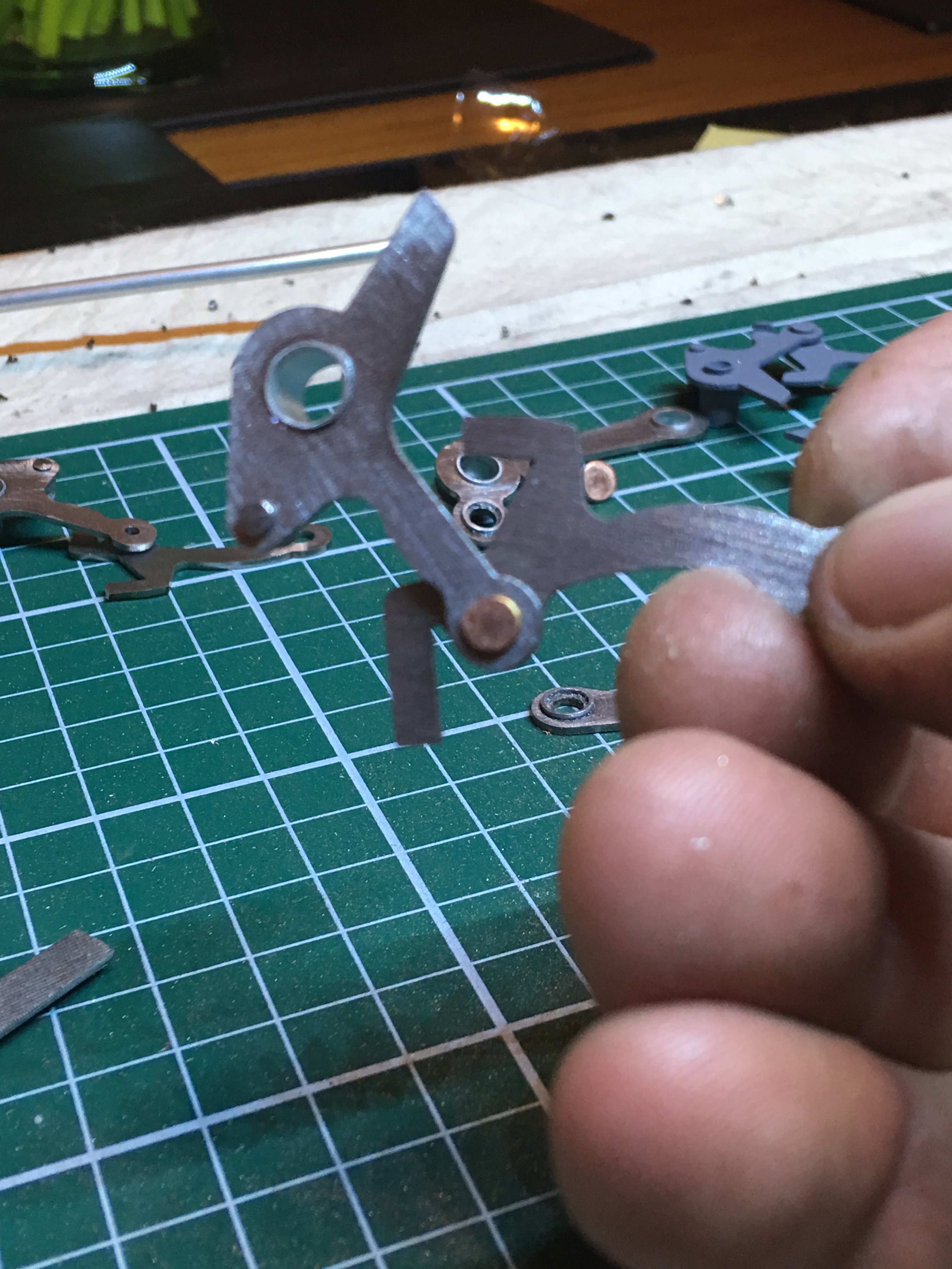

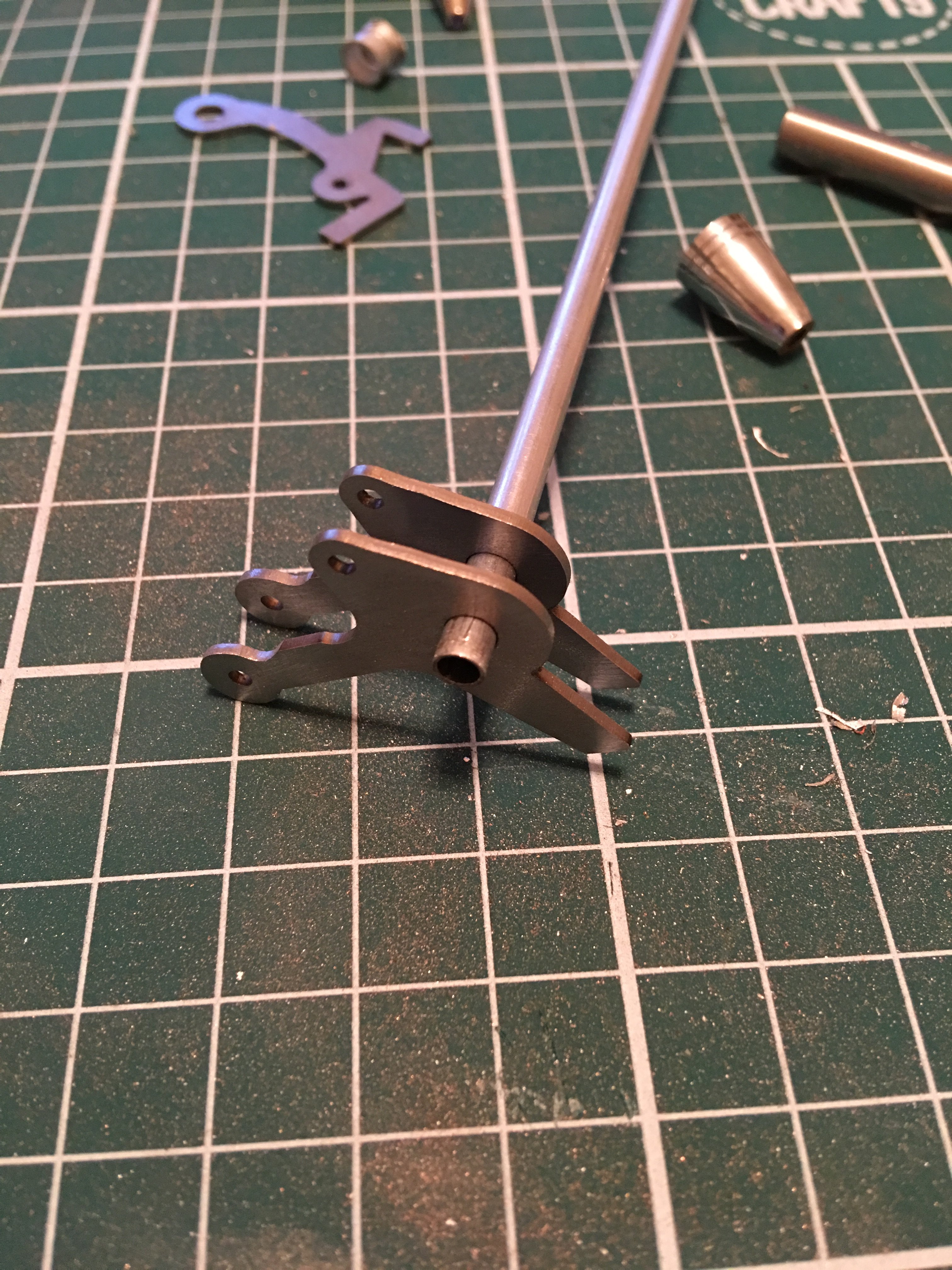

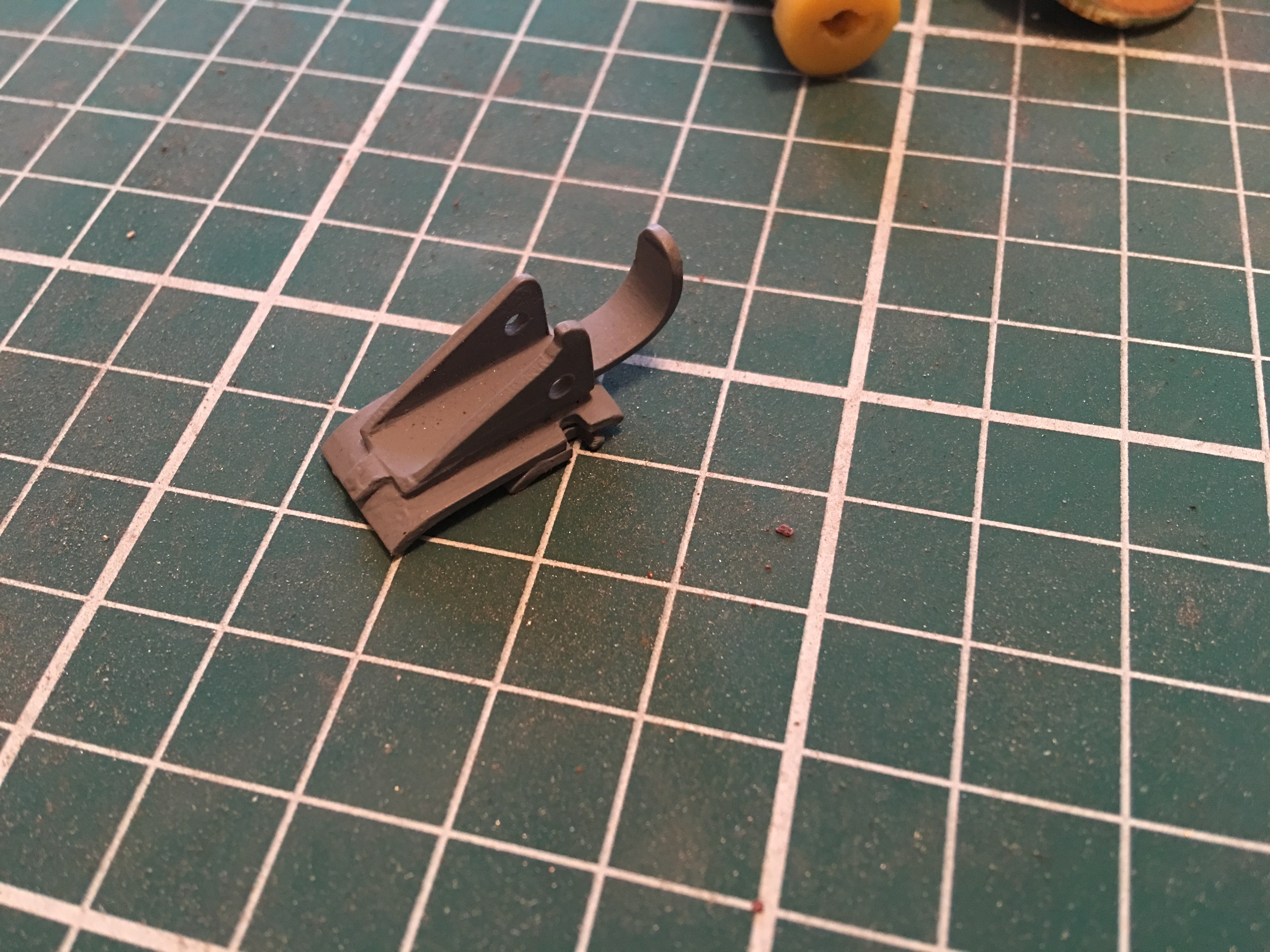

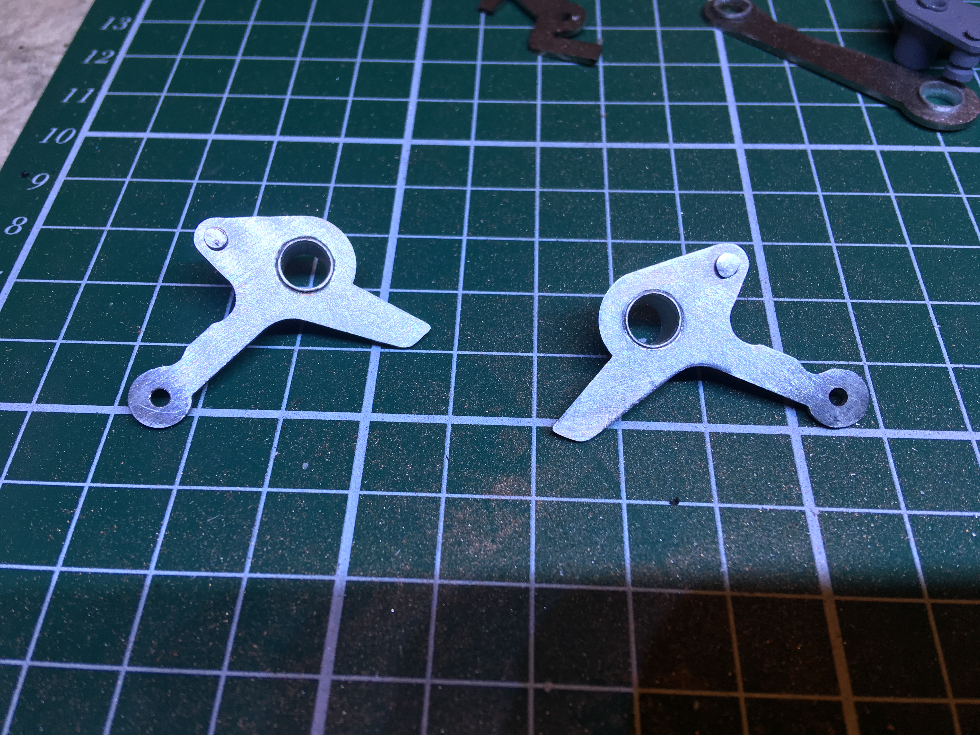

I hand cut some reveal ears a while back then I did some cad drawings and had some pieces cut, so now it's time to assemble some laser cut pieces together to see how they look

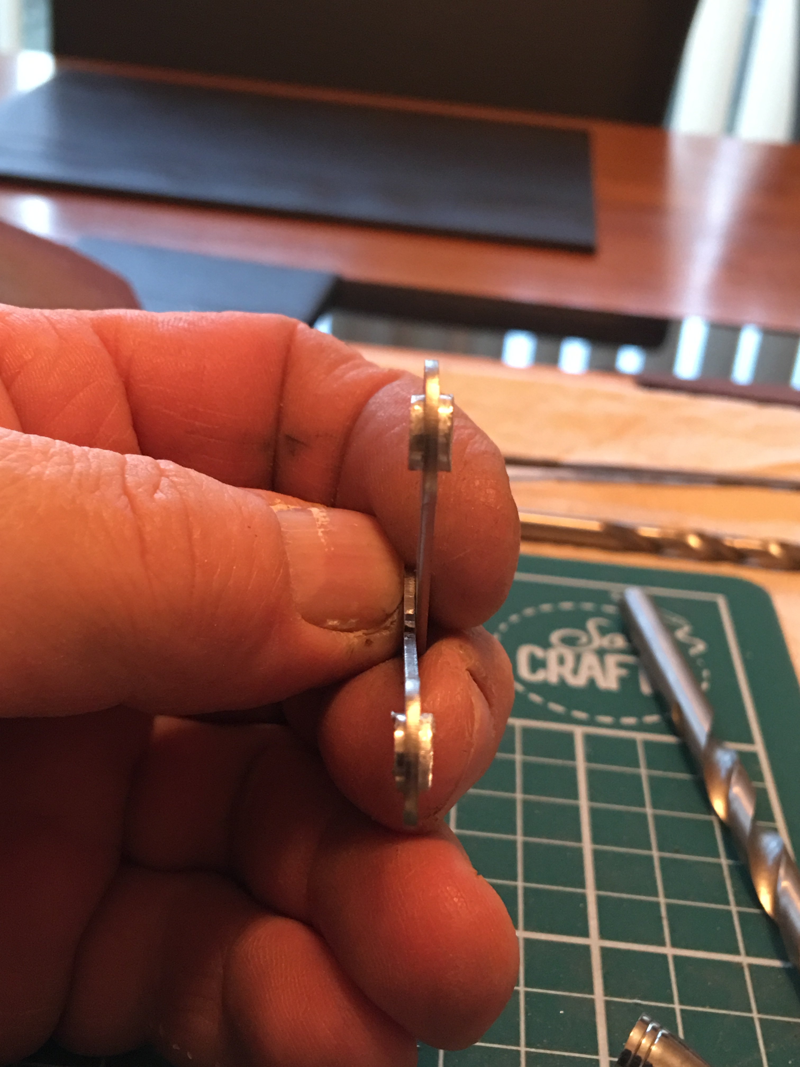

first I cleaned up the pieces

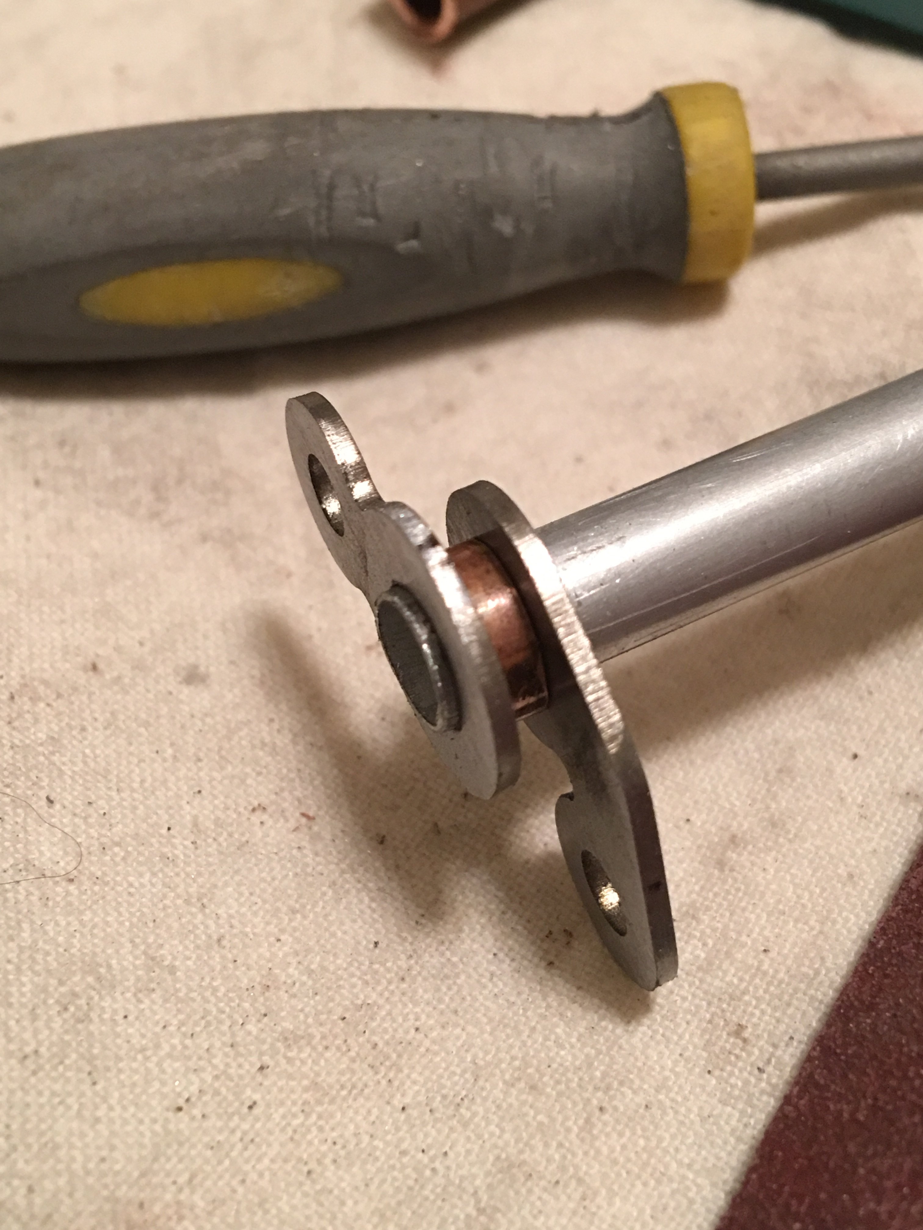

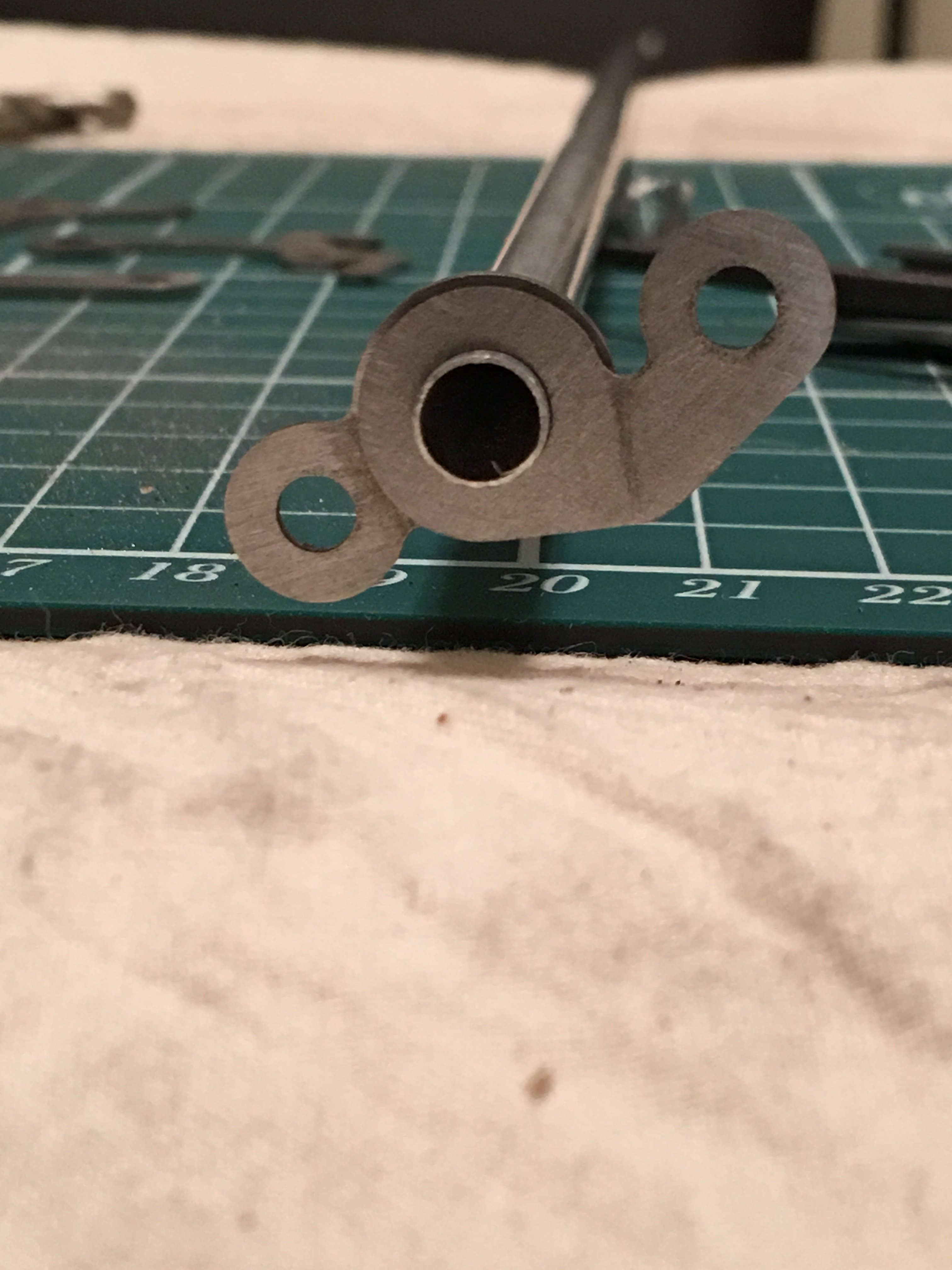

Then I made the holes the correct size for my ally tube
Then I made a spacer from copper and put it in between 2 pieces on the ally tube
I then cut it off to length then opened up each end slightly to hold everything in place
I then filed down the ends to clean them up
More assembly tomorrow

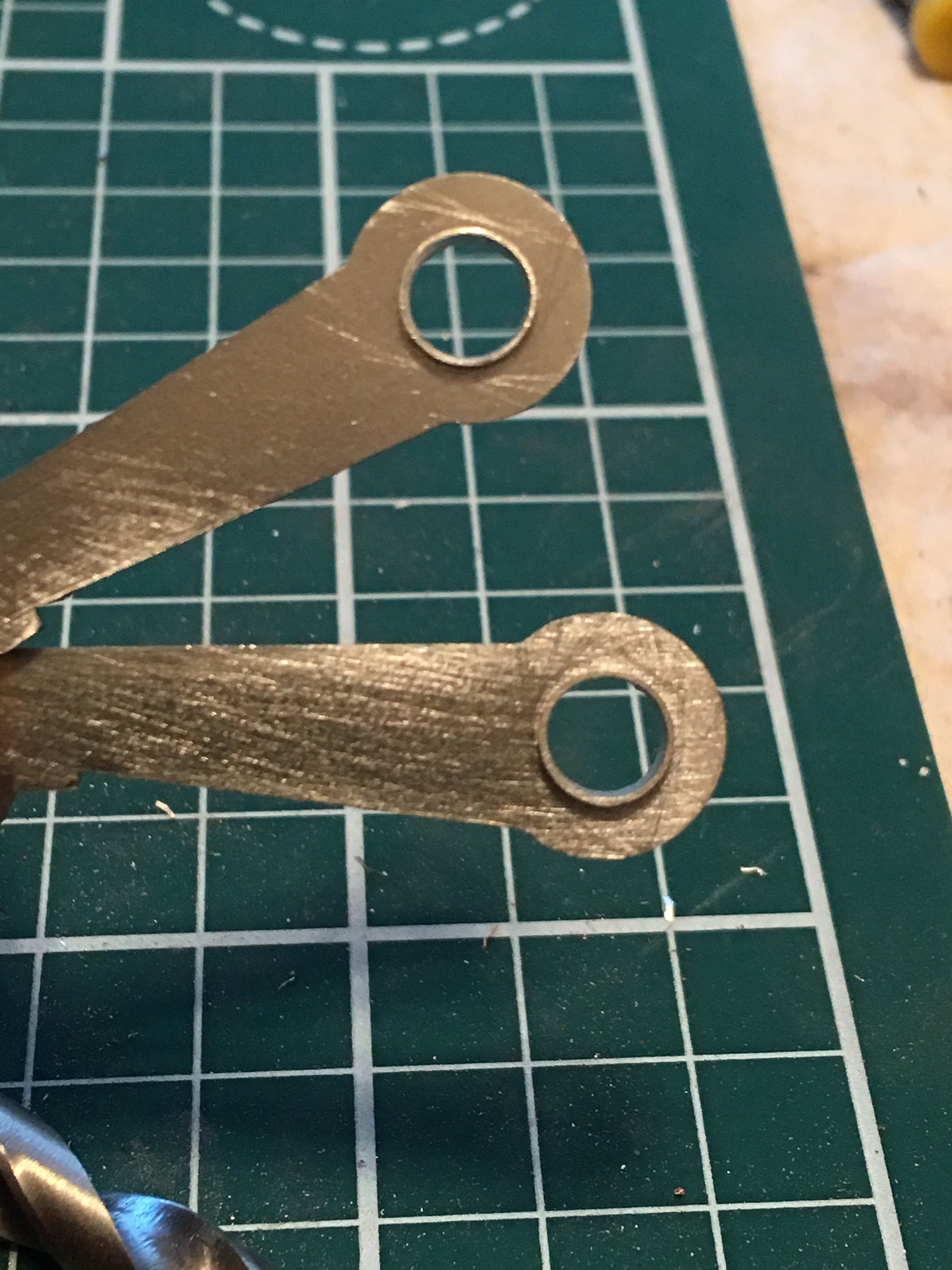

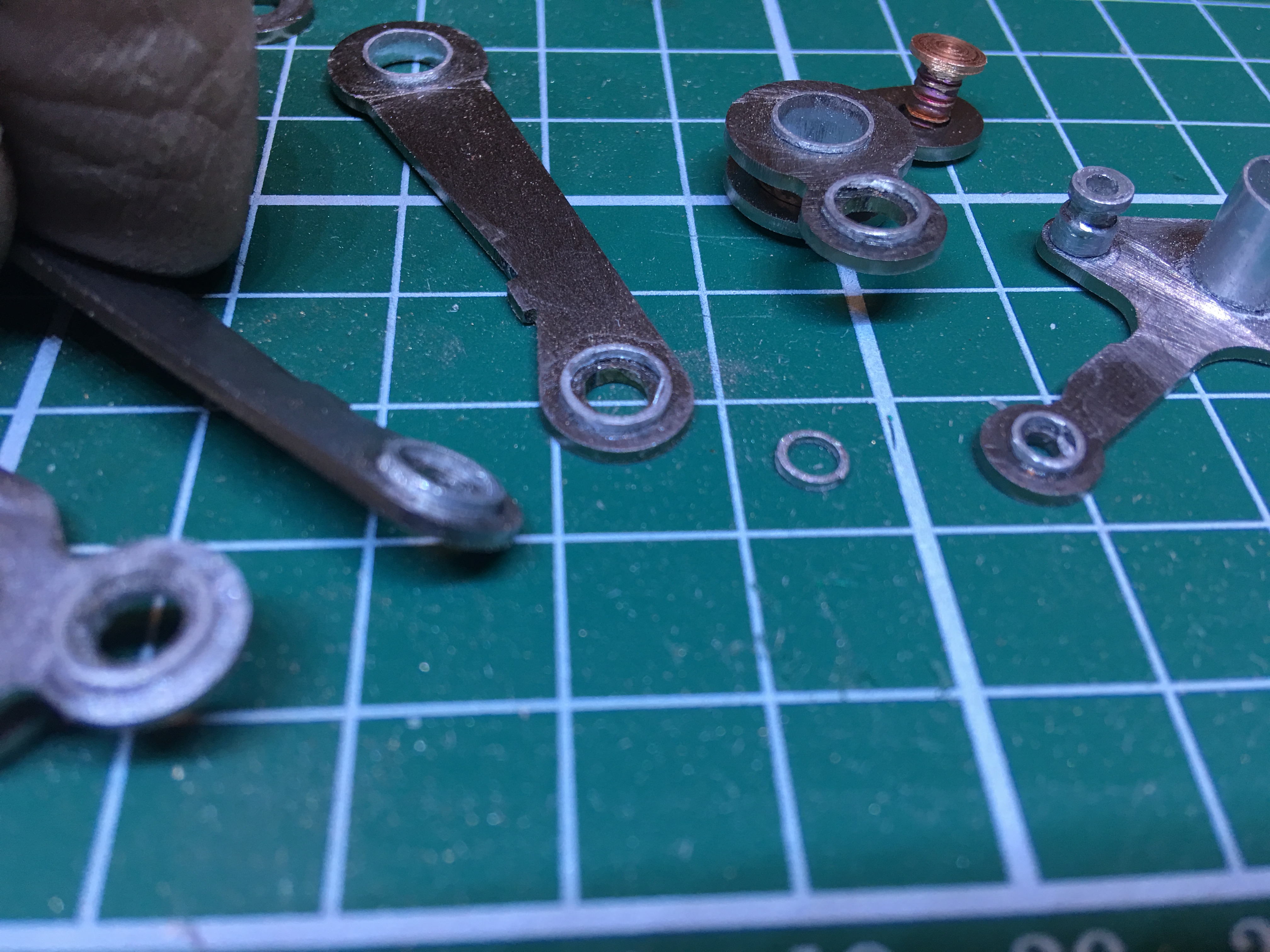

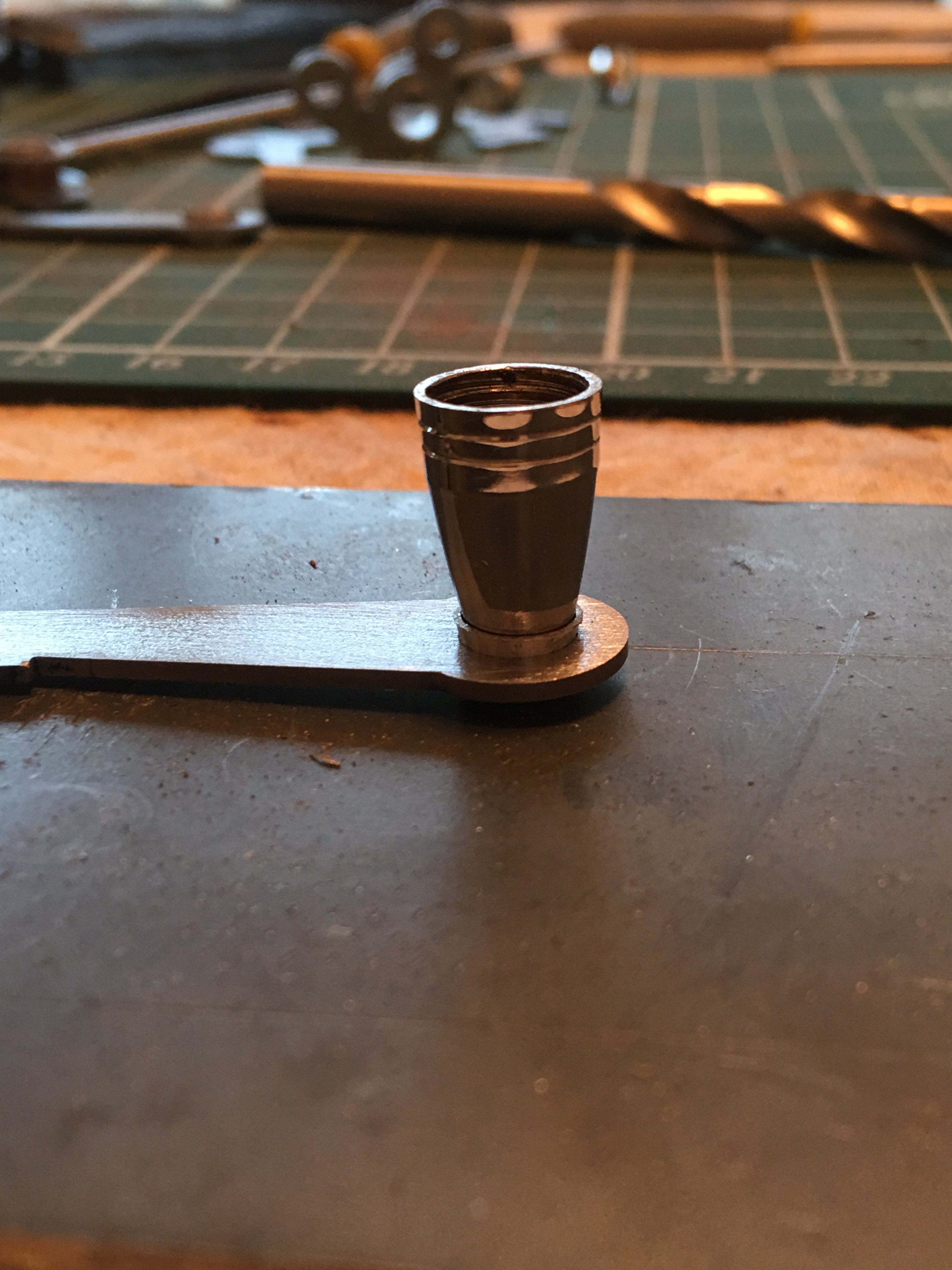

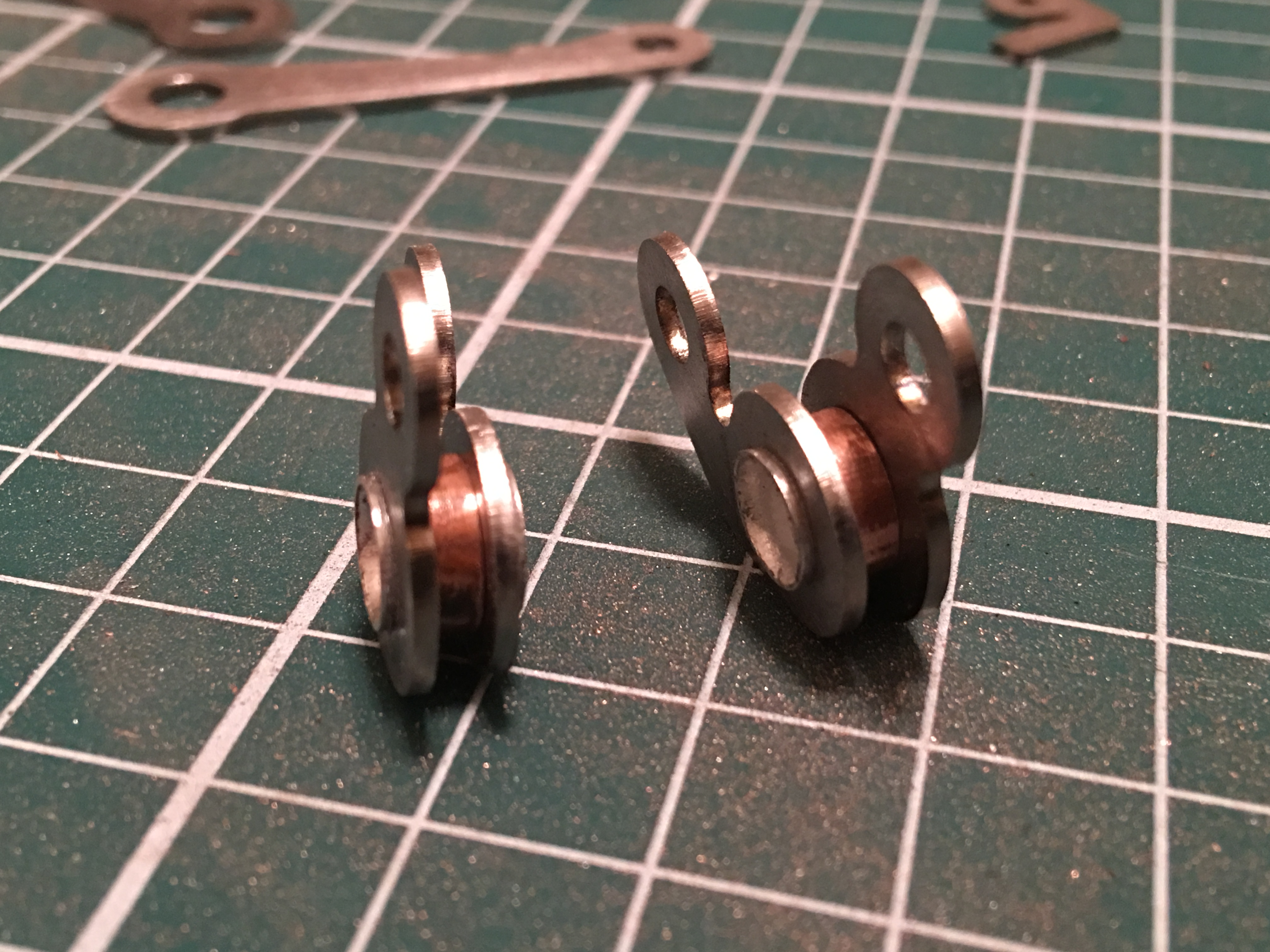

A little bit more assembly on the reveal ears

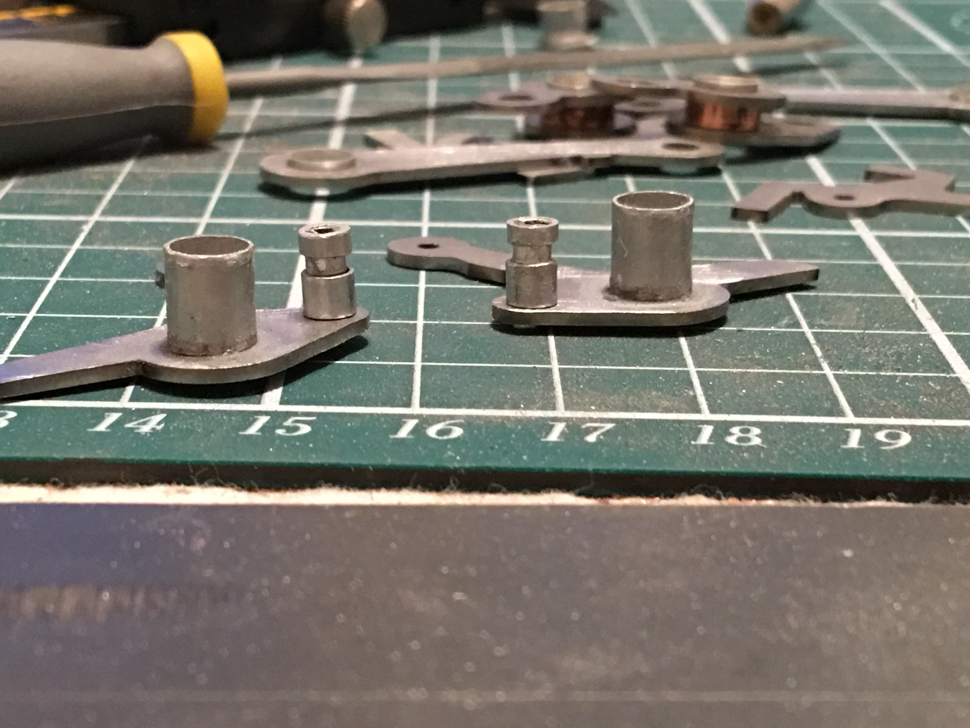

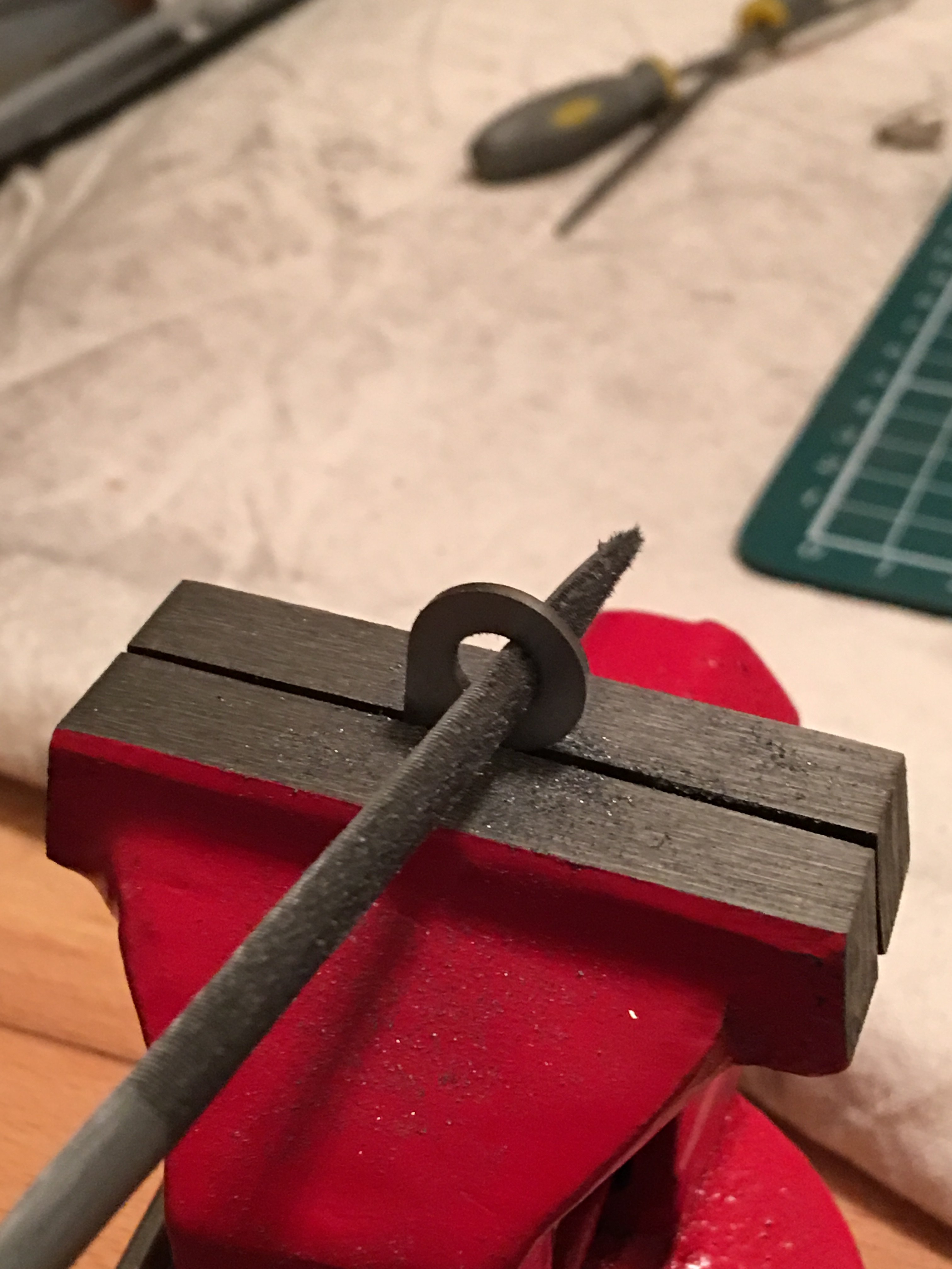

the larger hole has to have a sleeve so it can be filled later
Filed the hole to the correct size to fit my ally tube
Cut the sleeves to size and inserted them into the holes
I then slightly opened up each end to keep them secure my special tool for this is the metal end of a pen
Filed down and cleaned up
Next part for assembly

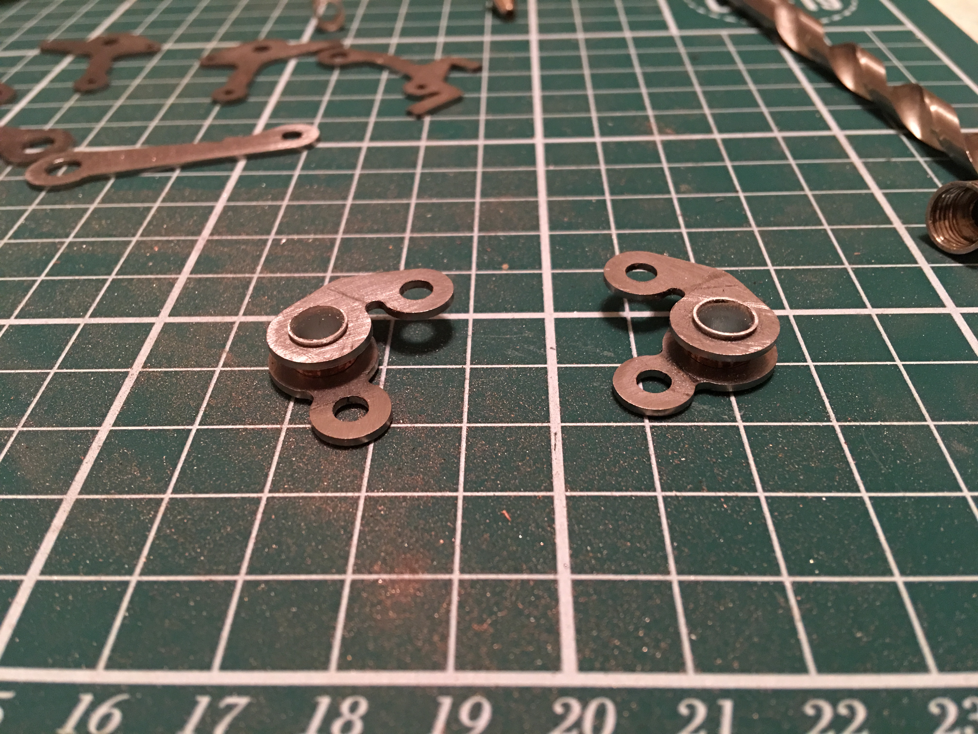

same as before filed to fit my ally tube

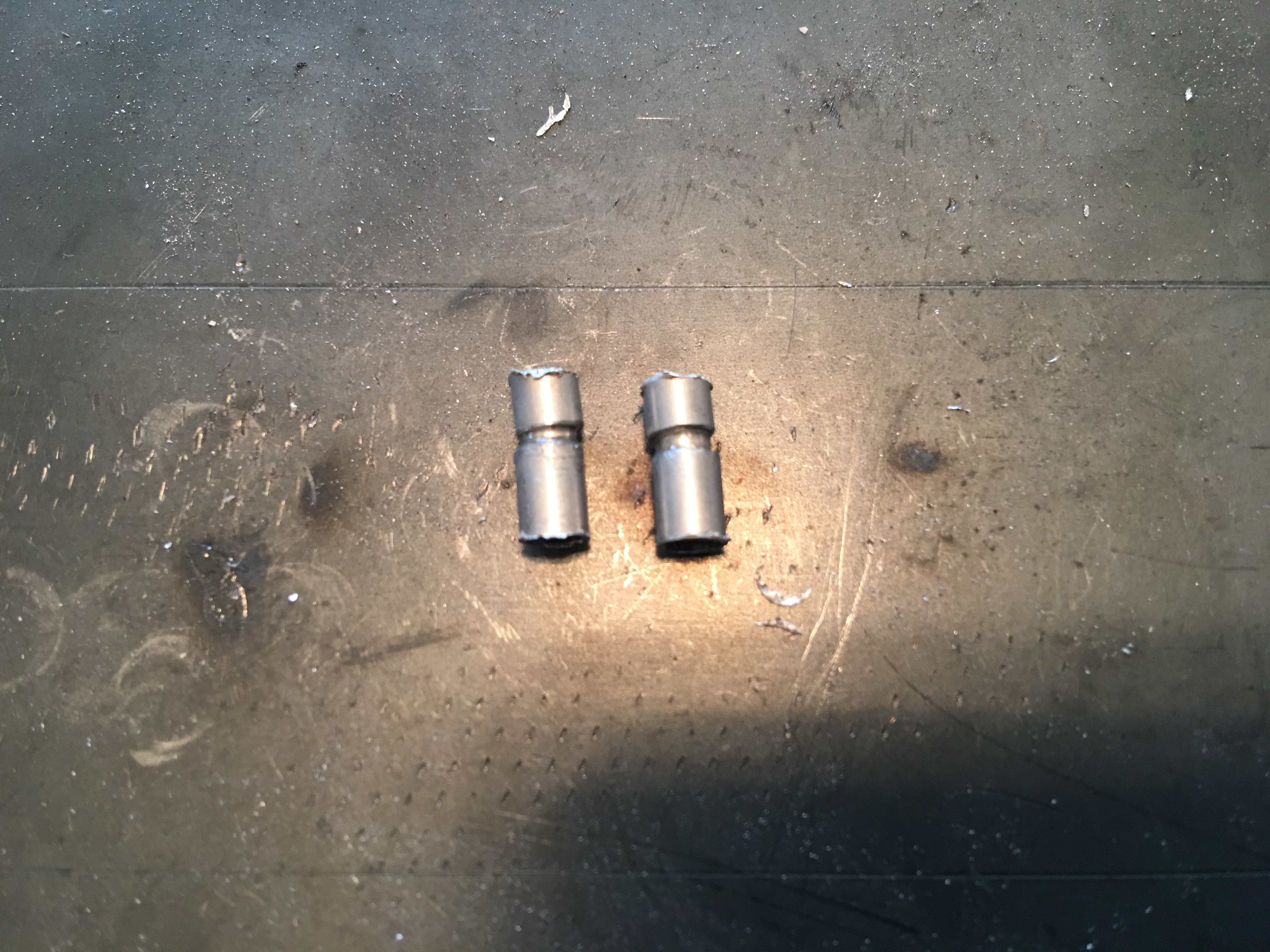

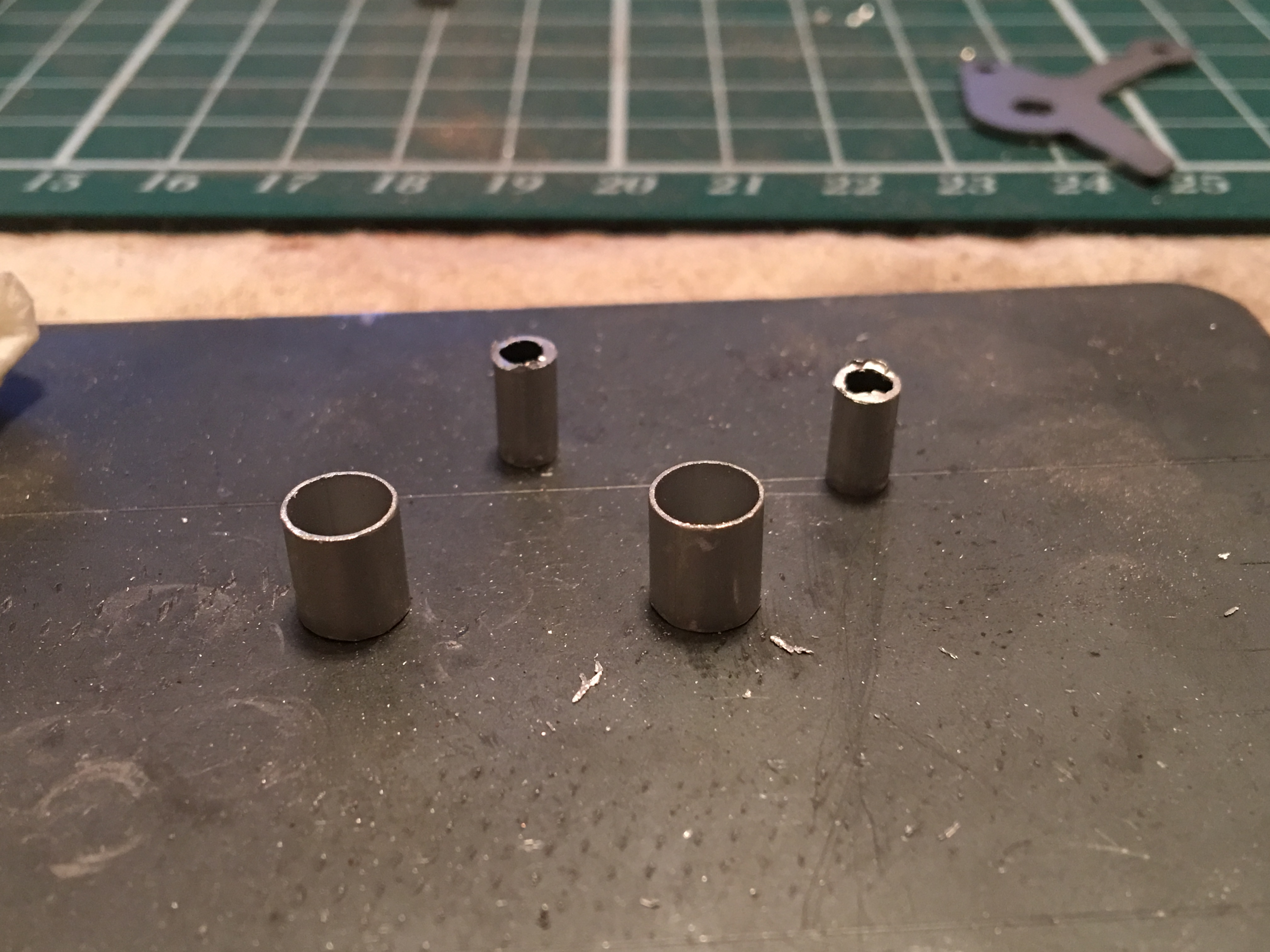

Then I cut 2 x 6mm and 2 x 4mm ally sleeves
Fit the 4mm sleeves and opened up one end closest to the piece
Then glued the 6mm sleeves over the 4mm
cleand off the excess glue and ready for the last part for this piece ( but not today ) my lathe belt hasn't arrived and need to make some correct size rivets and buy some small and very thin washers so they can pivot at every joint

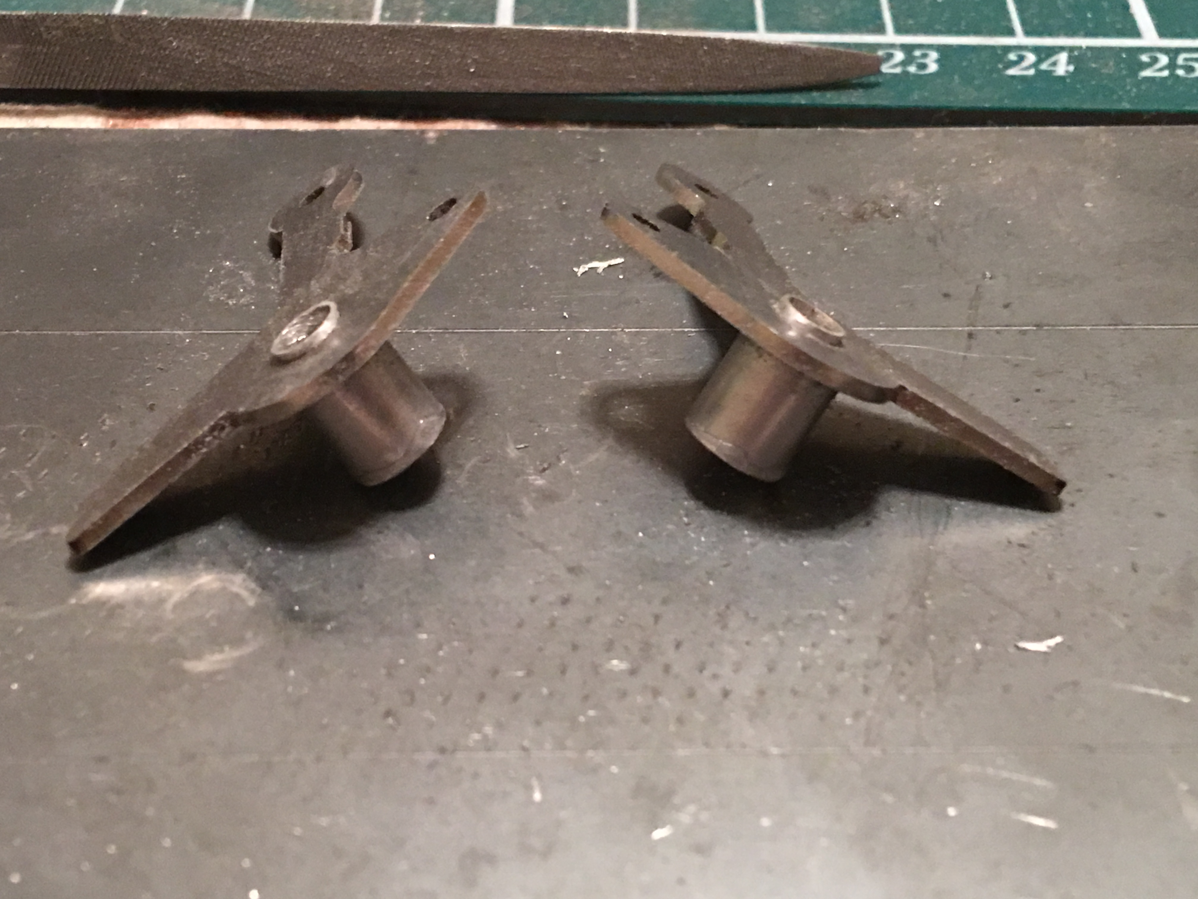

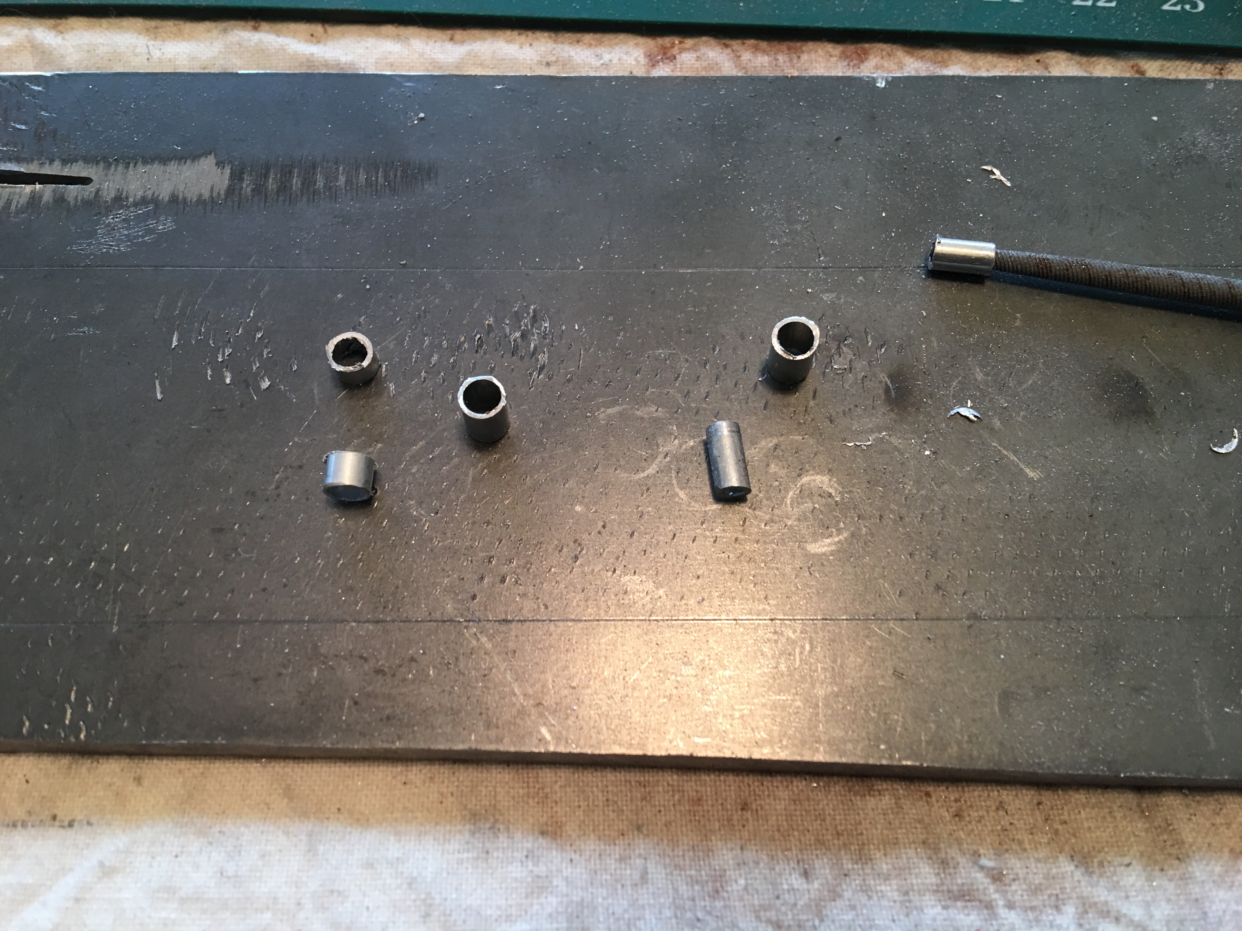

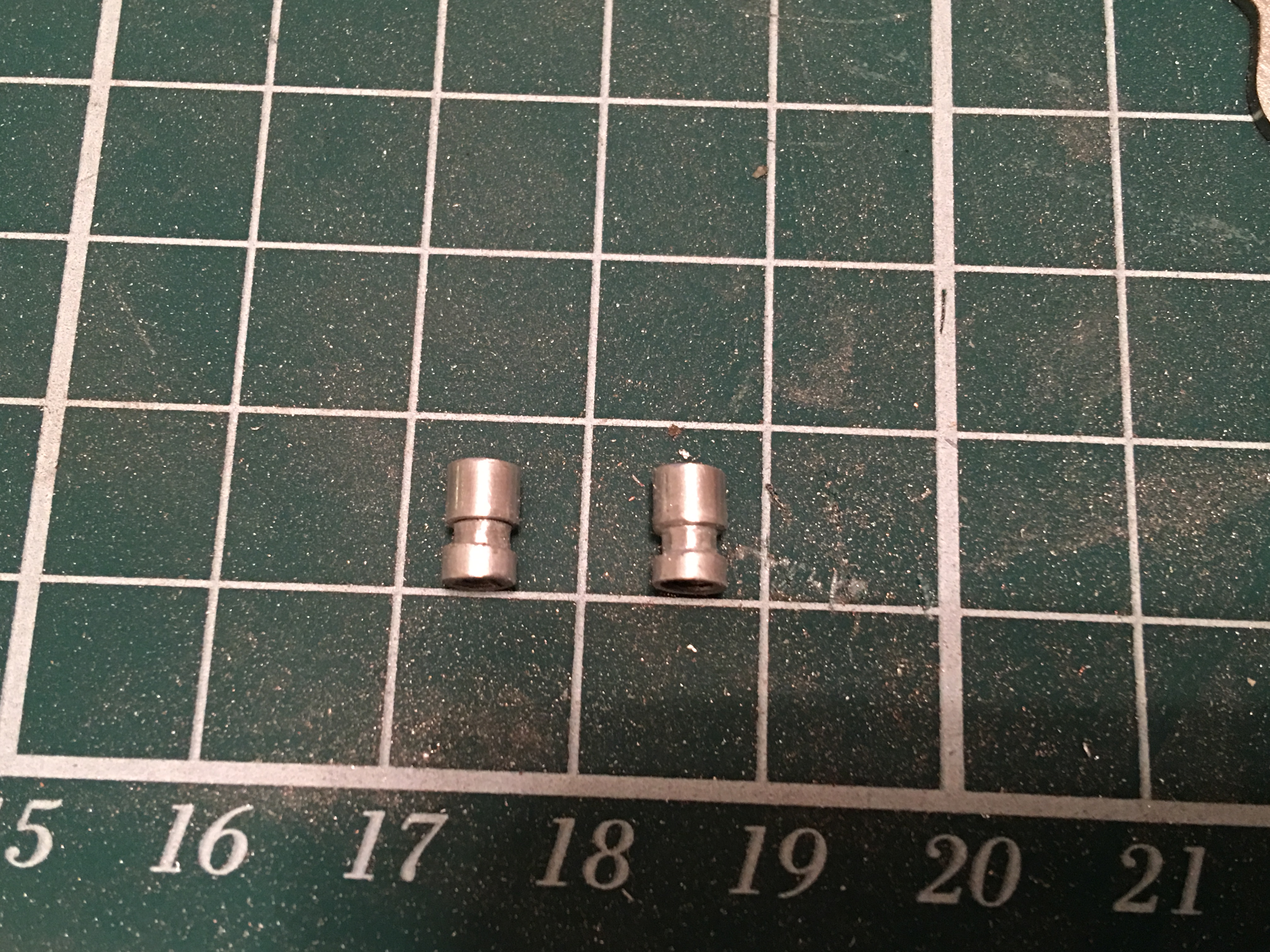

A little bit more

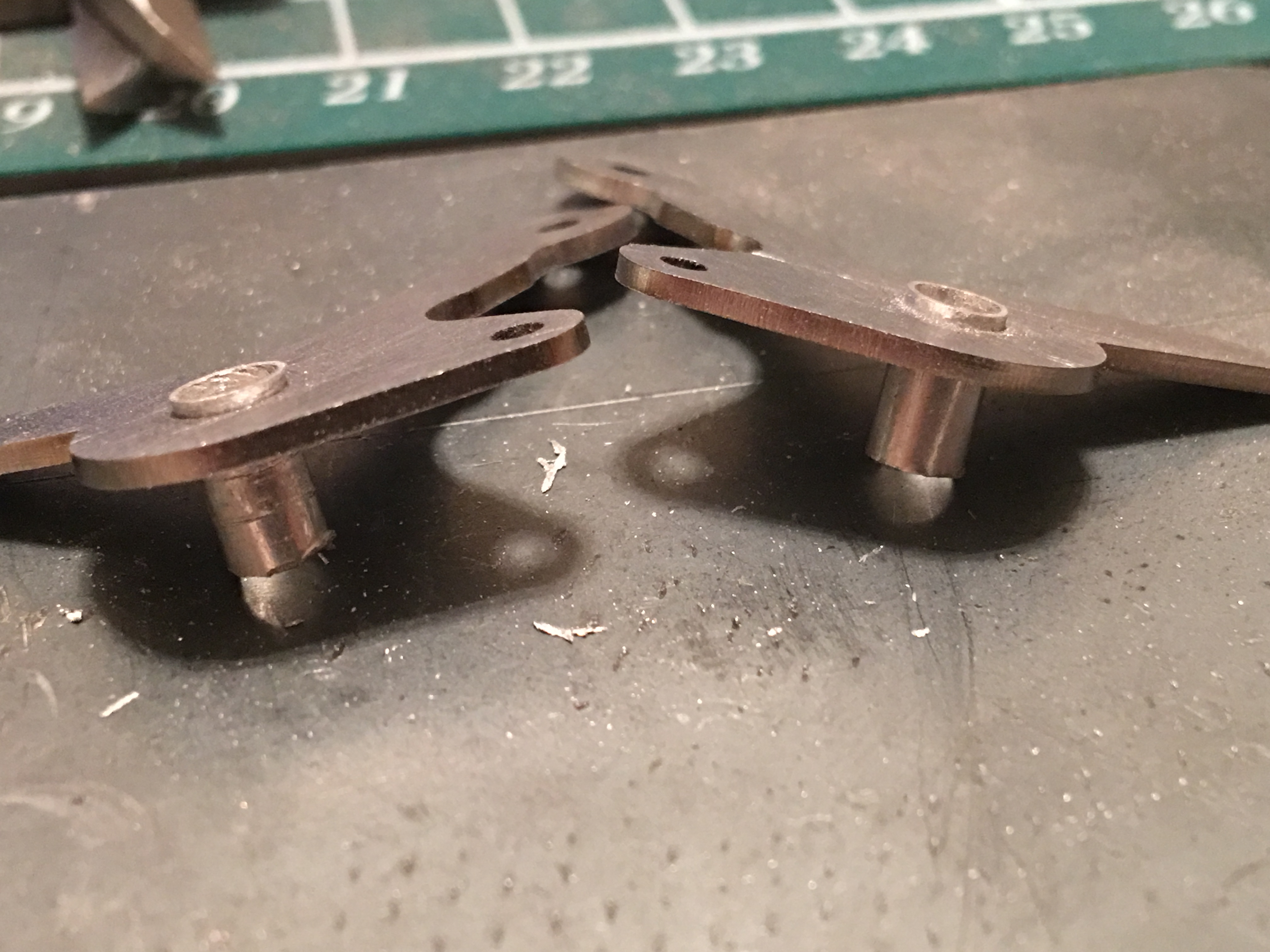

cut some very small ally pipe pieces 4 pieces for the outer pipes and 2 smaller pieces for the inner sleeves
Glued them together
Cleaned them up with a file, not fully happy with them at the moment but let's jus see where they end up
Just placed on for a quick look, they need making smaller
Made one smaller and cut down a 1mm pin/nail
Glued into place..........BUT !!!!!
I need to redo the centre hole as it's to small !!!
What a prized plum I am :facepalm
I will post an update when I've rectified the centre hole

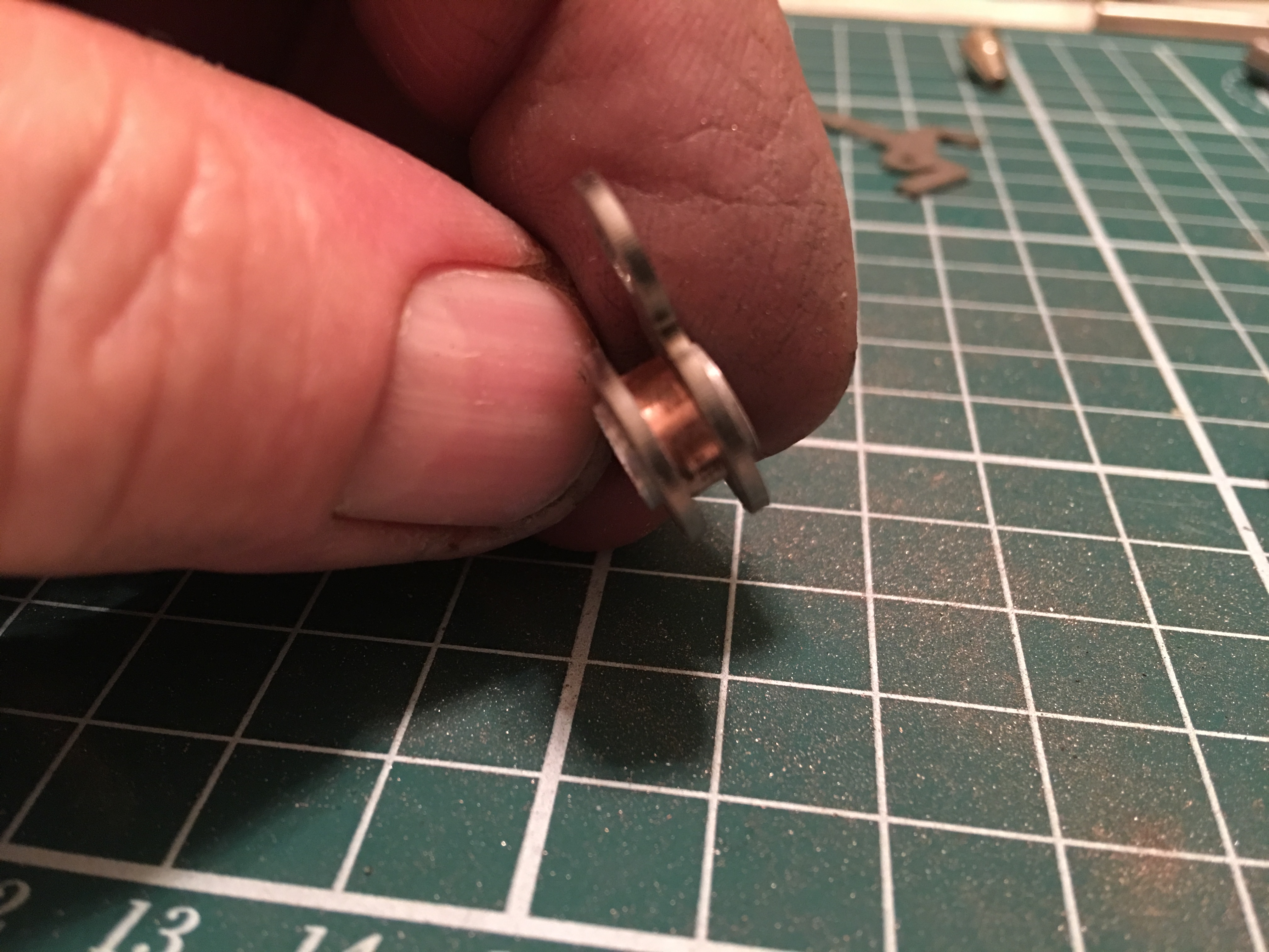

Update

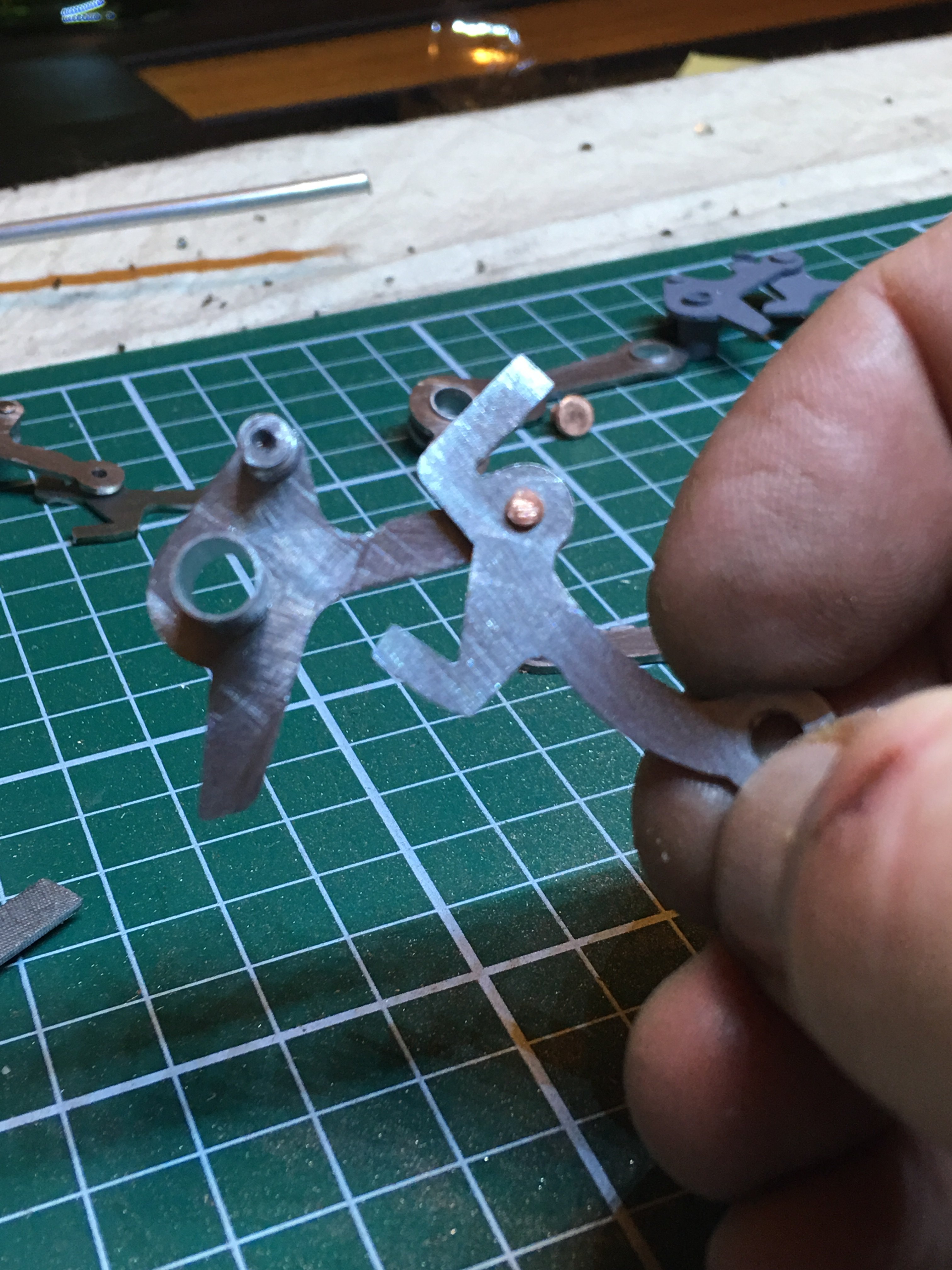

made the holes bigger after my mistake and fitted the new sleeve and the little end pieces

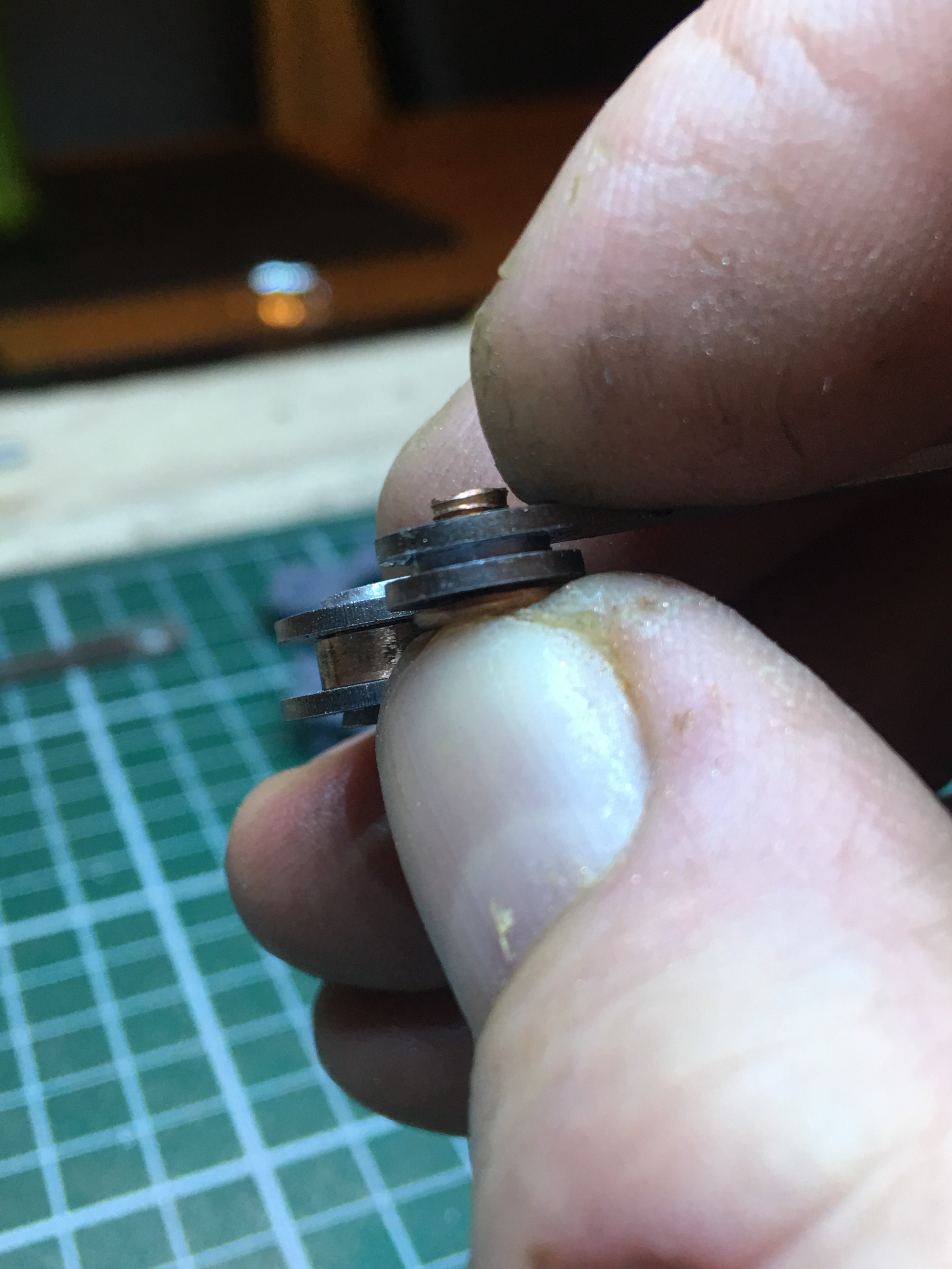

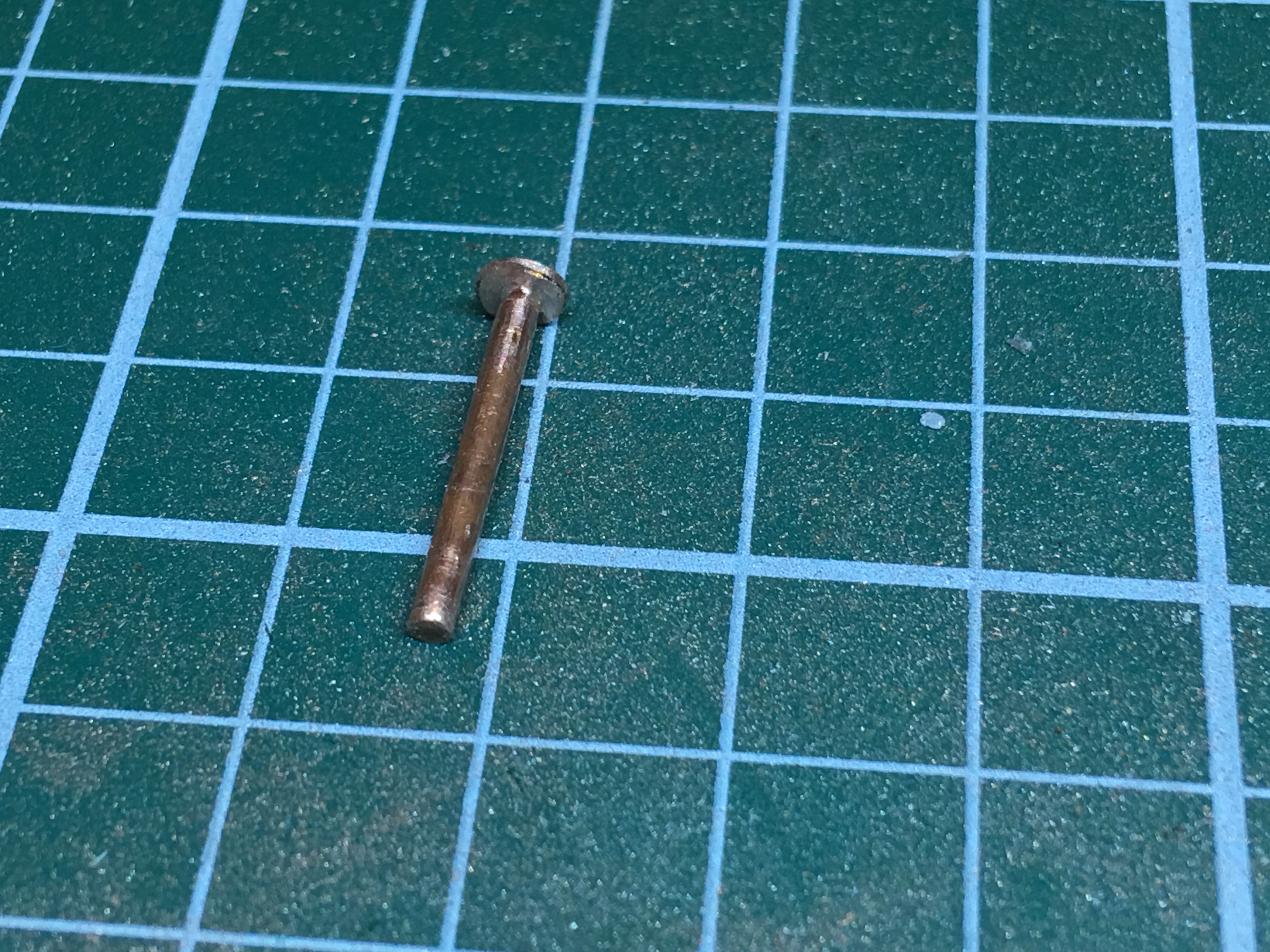

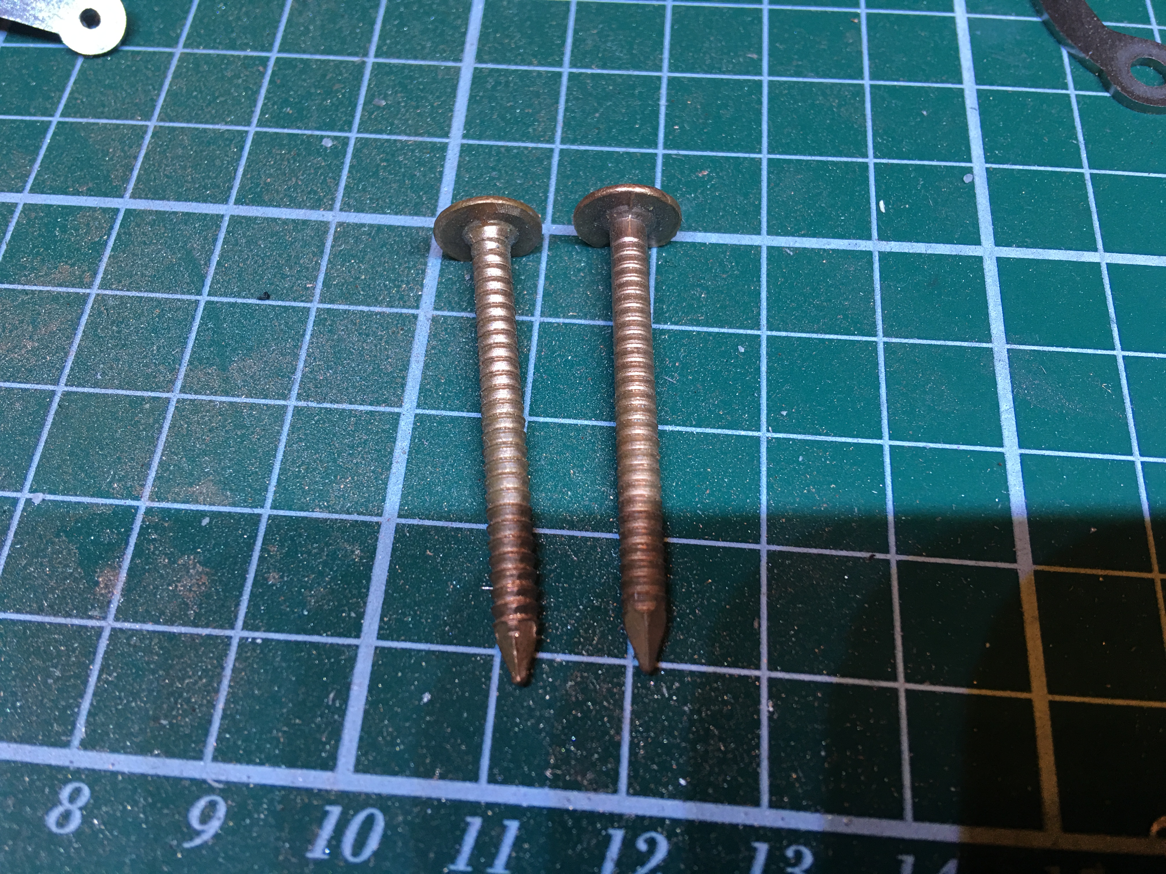

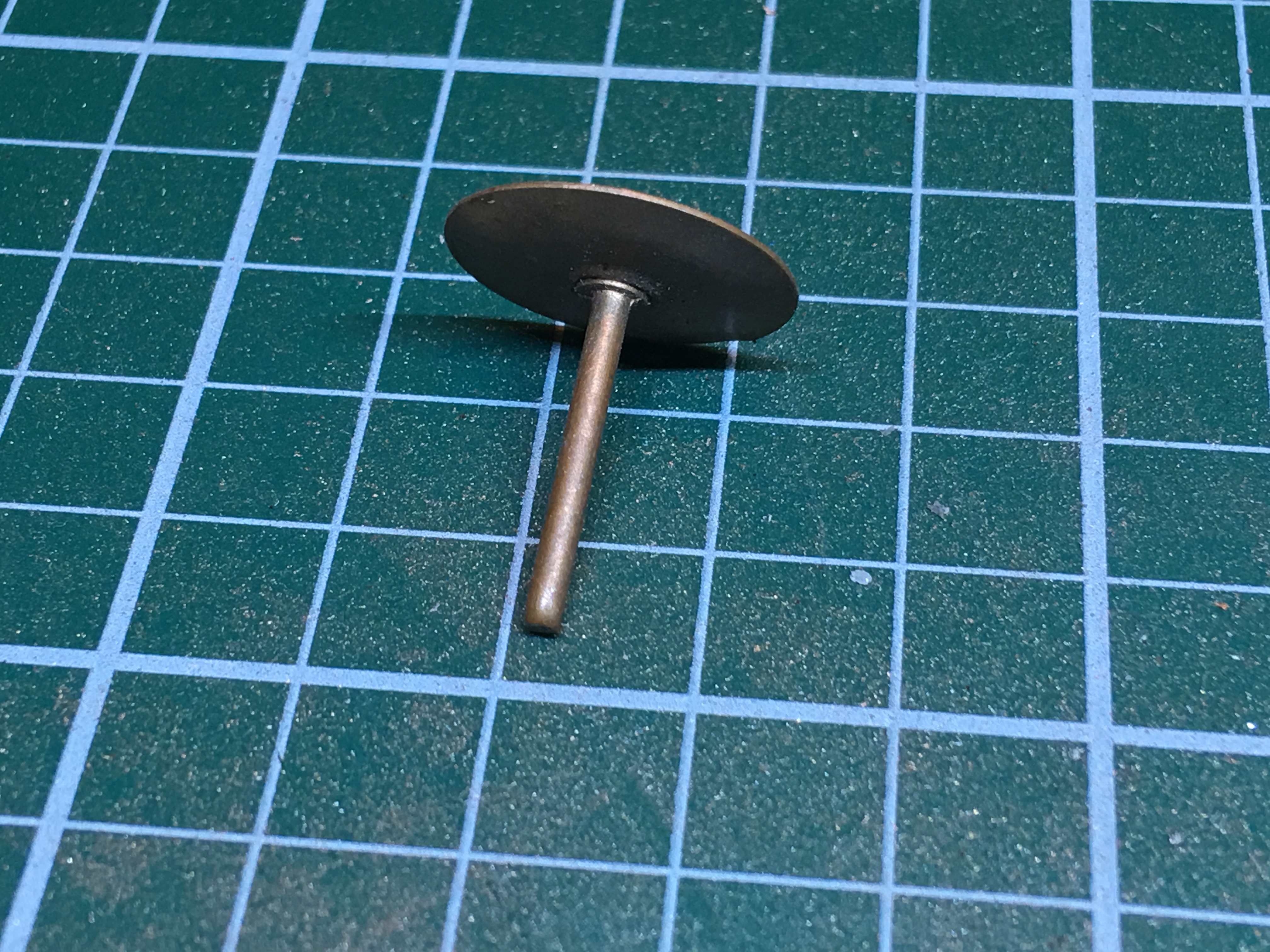

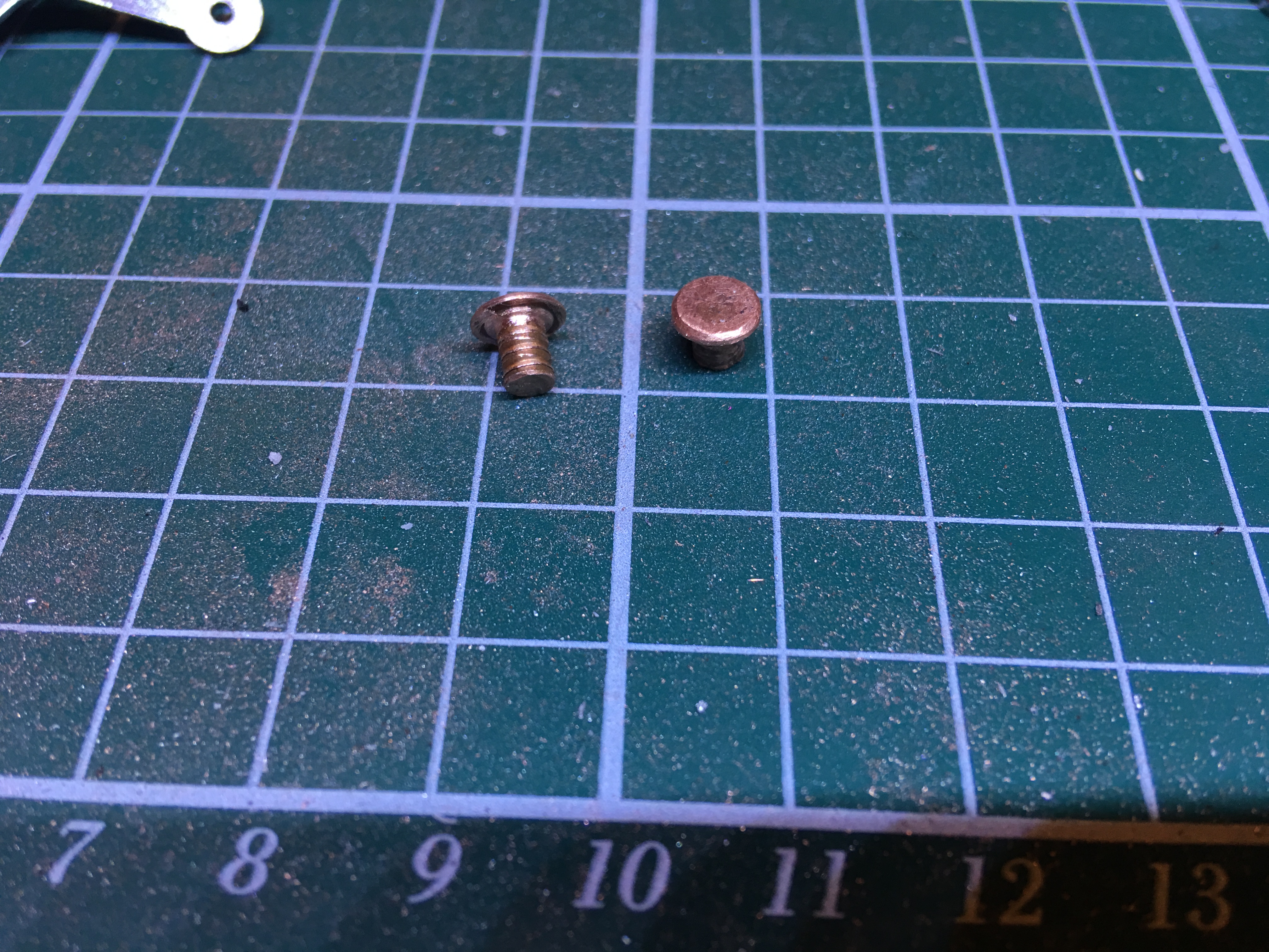

Now I need to make some rivets, I have some copper nails from a old roofing job
From them to these
from this
To this

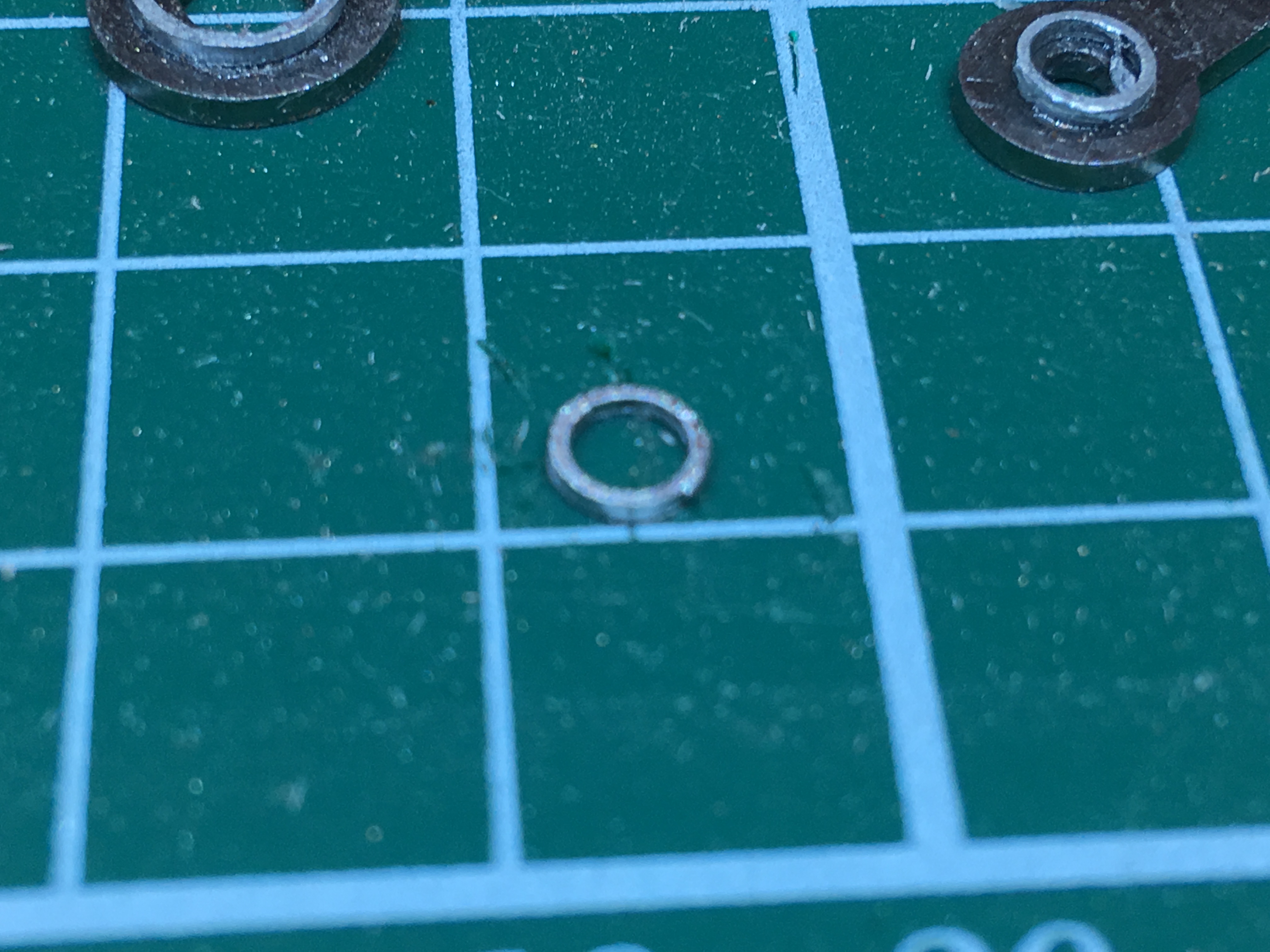

I also cut some various size ally tube to use as washers/spacers to stop the pieces from binding when riveting is done

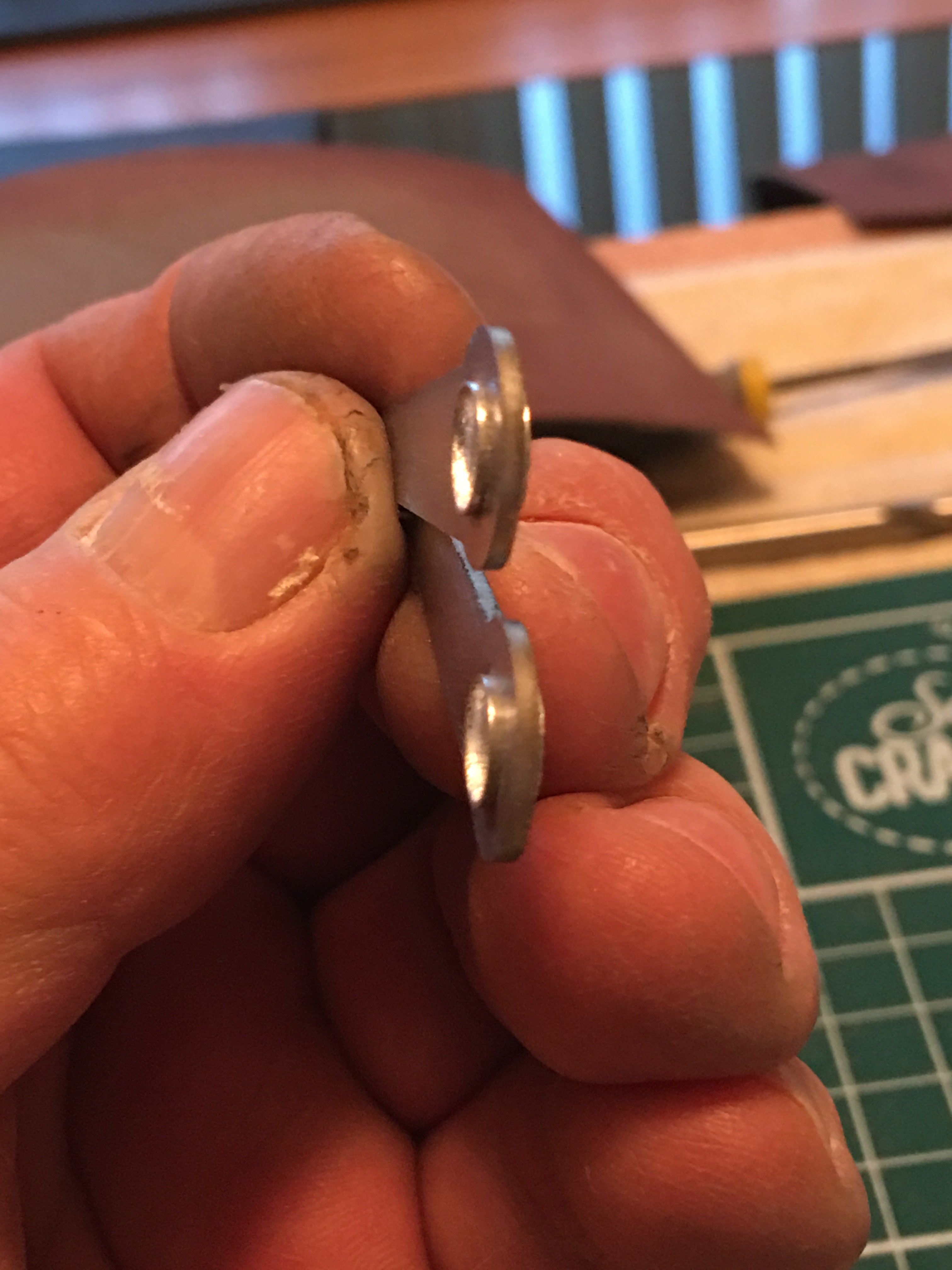

Glued into place

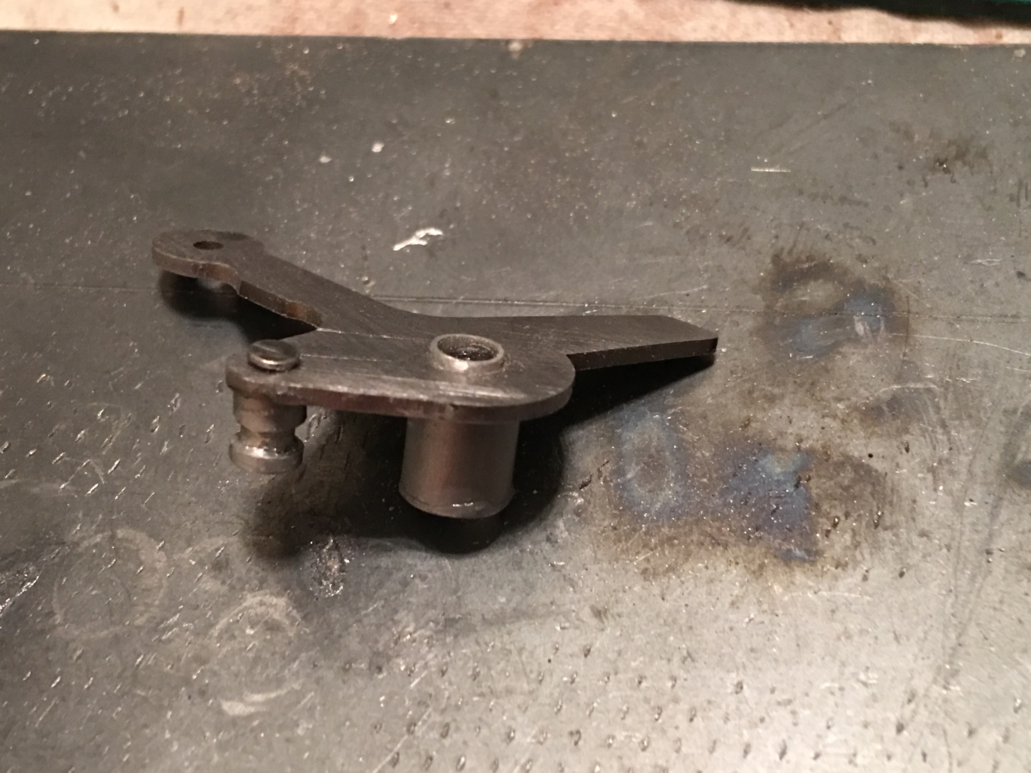

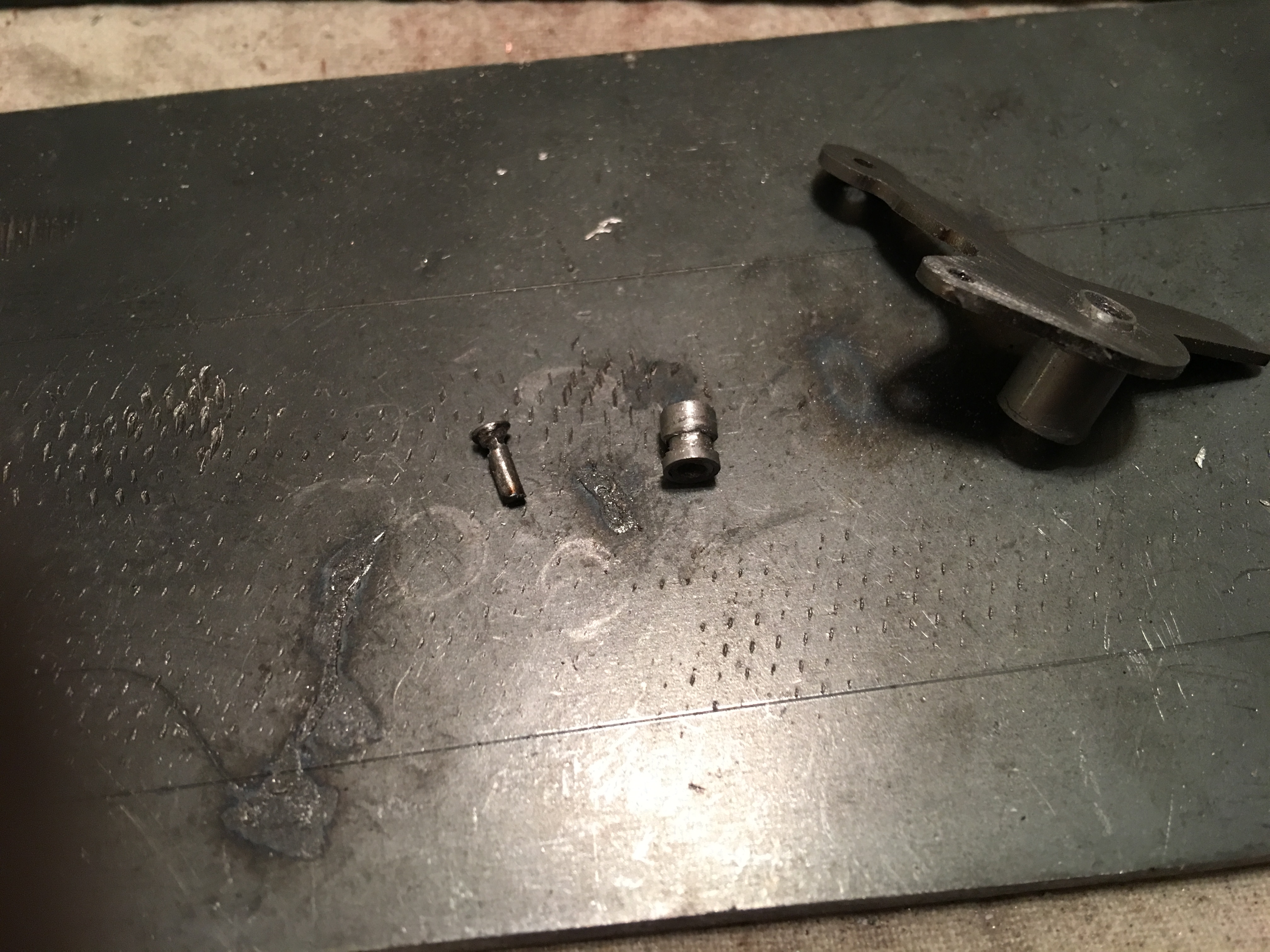

Put together the first piece to show the rivet and spacer in place before its fixed in place
first piece fixed
Second and third fixed
First one all fixed, just a little refining to do, but first I will put the second one together first

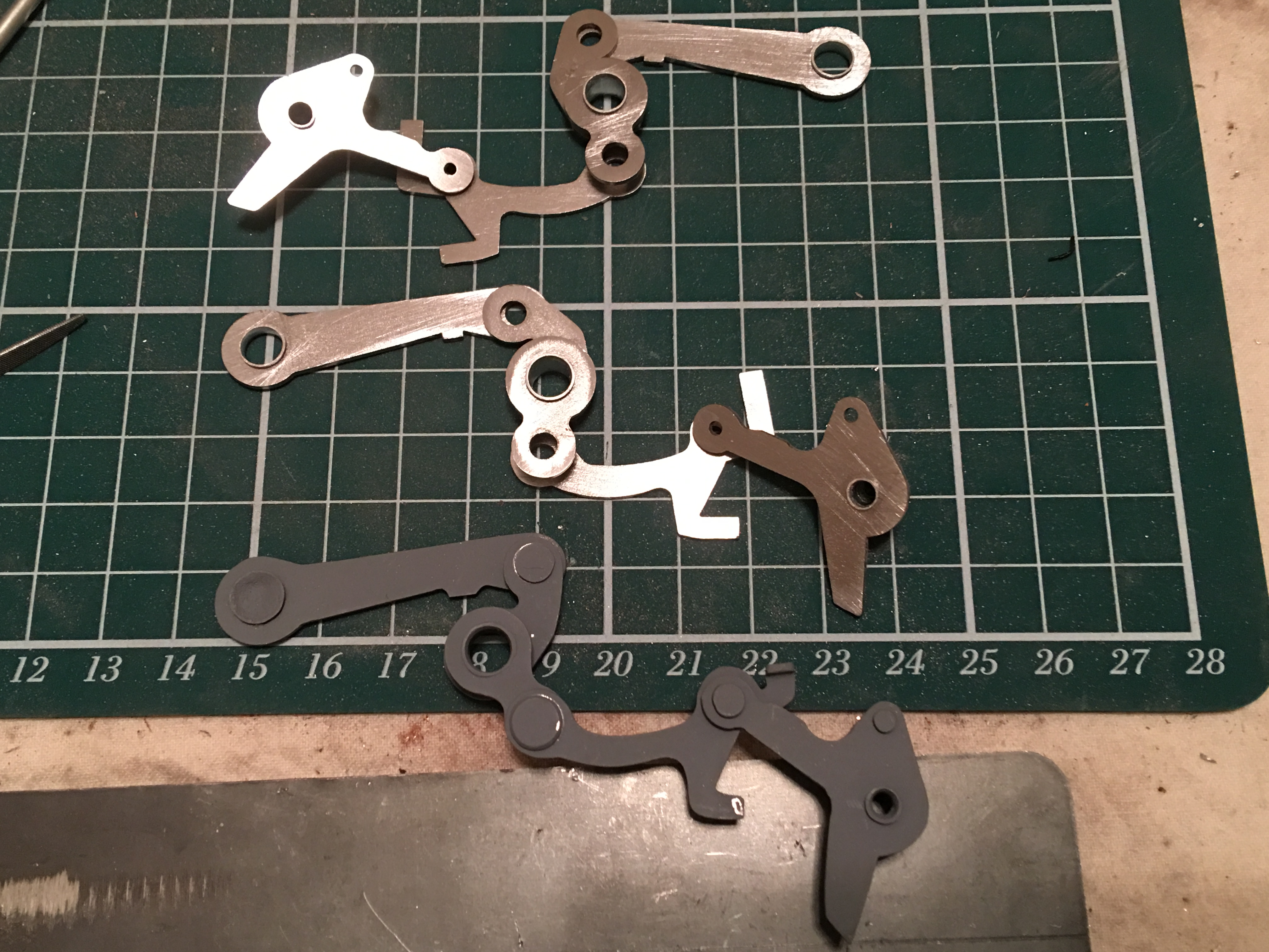

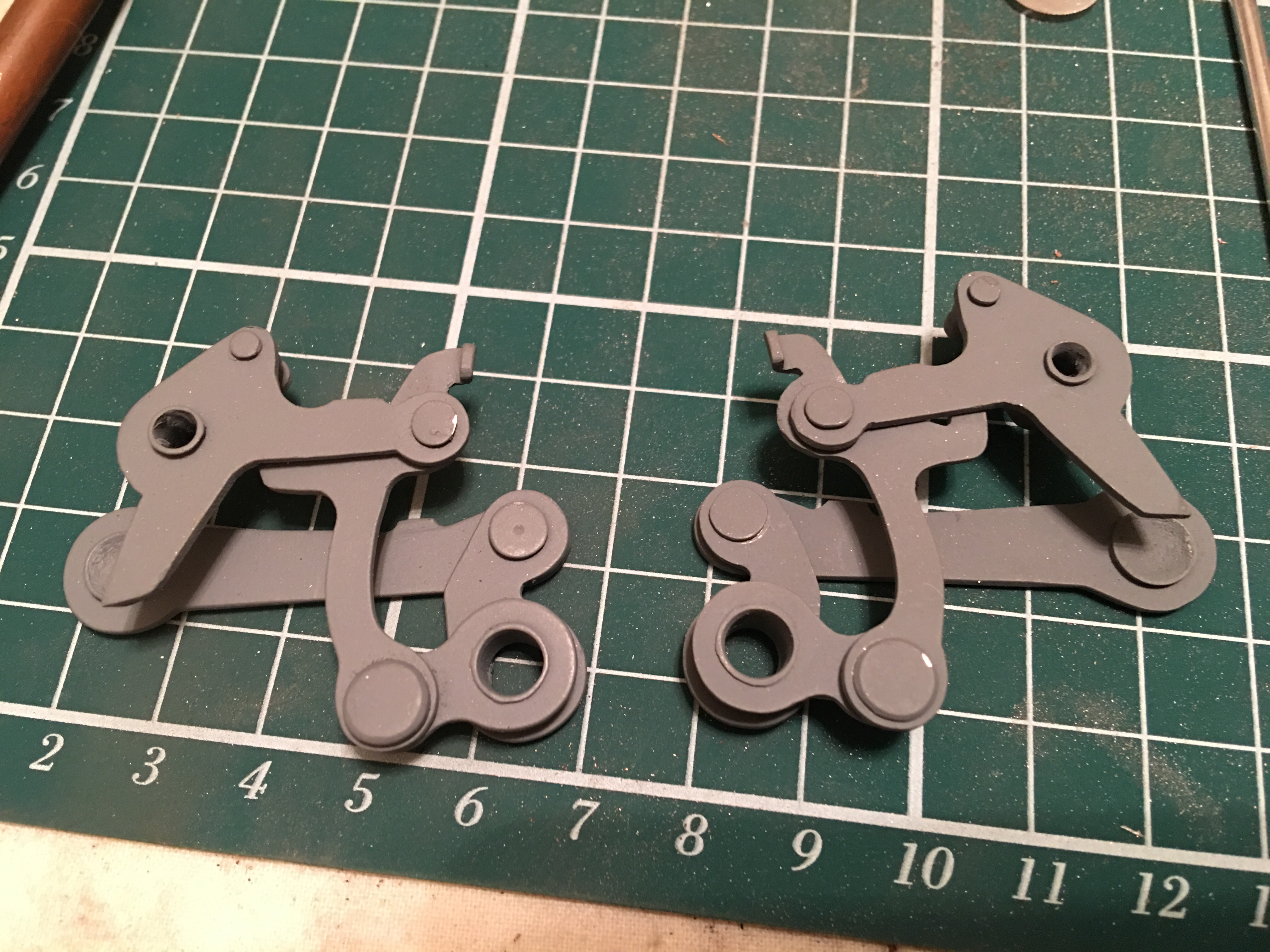

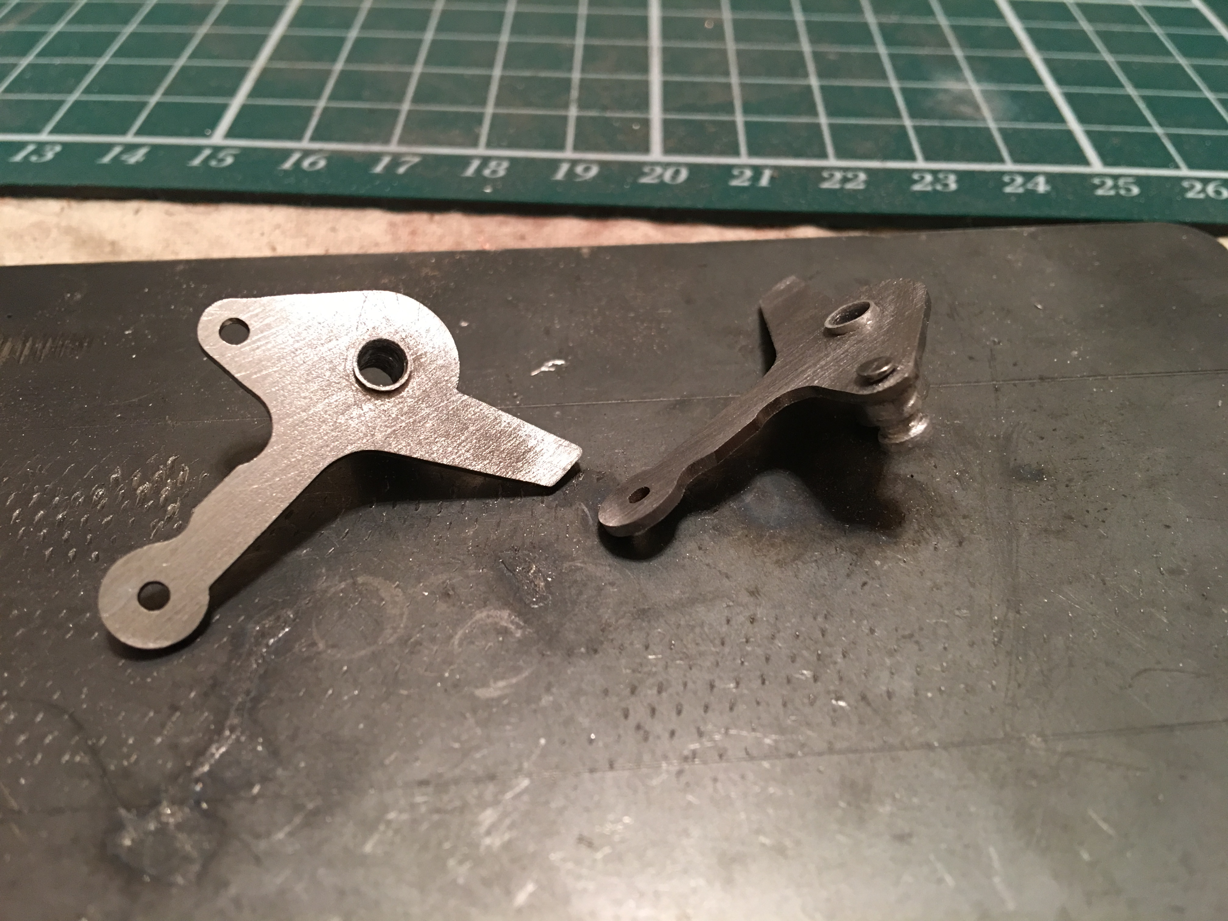

the top one is my hand cut and filed
the bottom one is the laser cut and hand finished

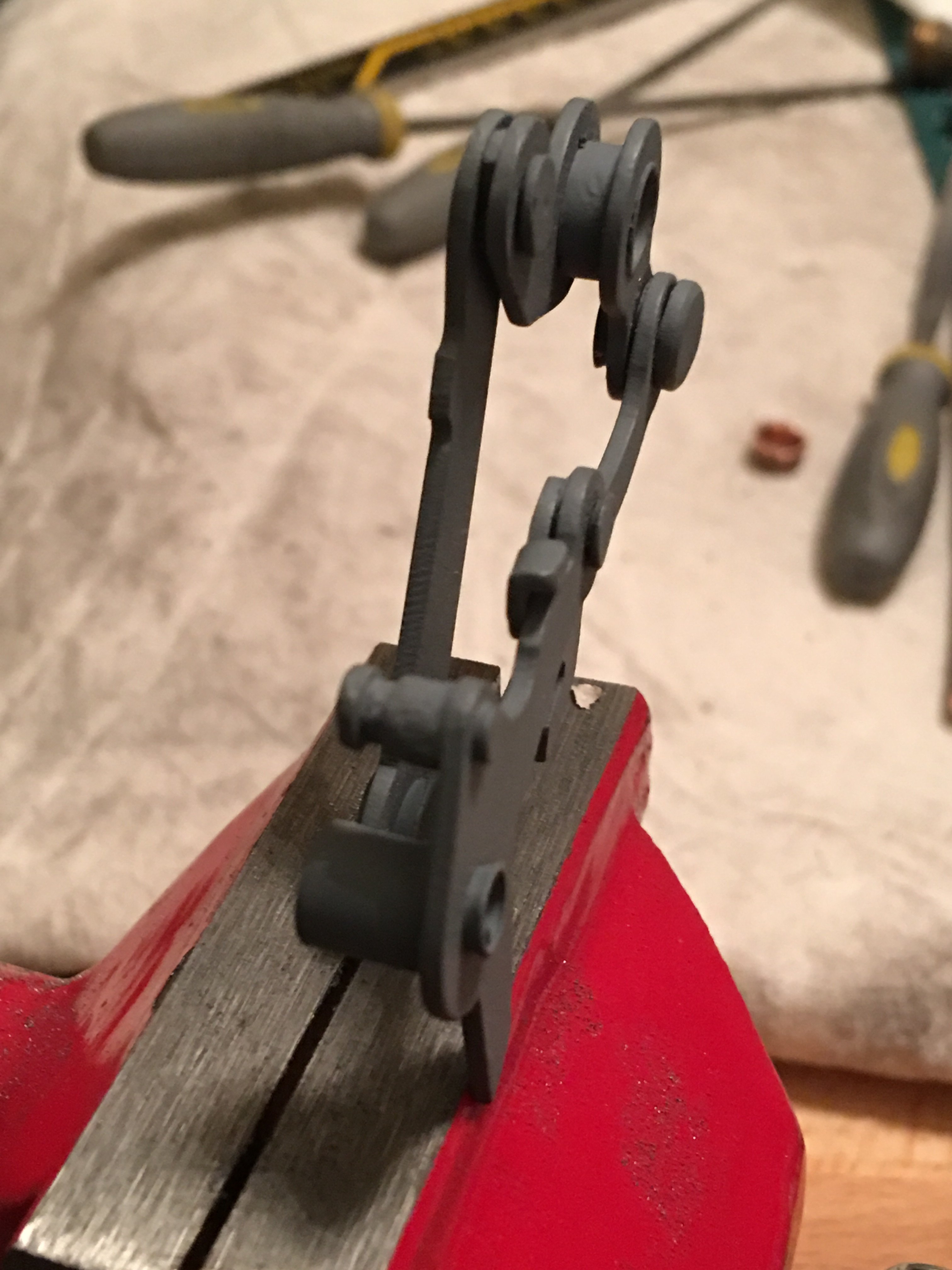

Update.....now the second laser cut hand finished Vader reveal ears are finished all I need to do now are slight refinements, fill the end holes, clean down with spirit and give them a coat of primer.
The top set are hand cut, hand finished ( first attempt ) never to be used as there are mistakes made
the bottom set are laser cut and hand finished, all the copper rivets and sleeves all hand made but I will buy pre made aluminium ones next time to save time in putting these together, I will post a picture when I've filled in the holes and given them a coat of primer.
AND THEY SWIVEL
i love them to bits all the hard work has payed off
I'm a happy little bunny
