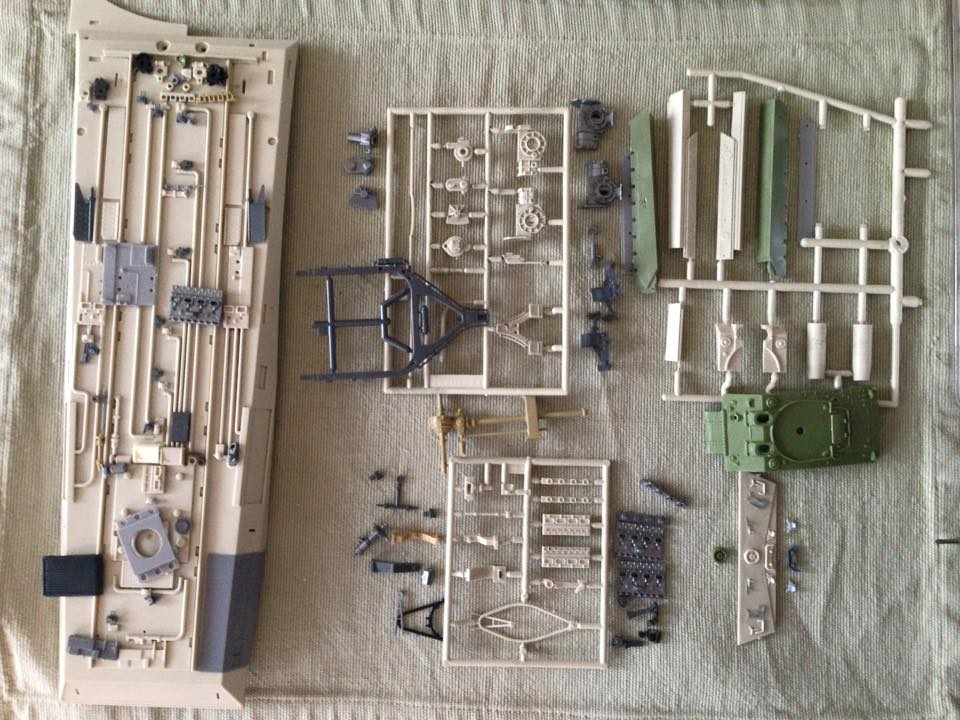

I'l be replacing many of the nurnies/greebles with the original kit part, but if the DeAg piece is good enough, or I don't have apart, it'll stay.
I'm not planning to use most of the interior, the ramp, or landing gear. Although the cockpit and canon interiors will mostly be used.

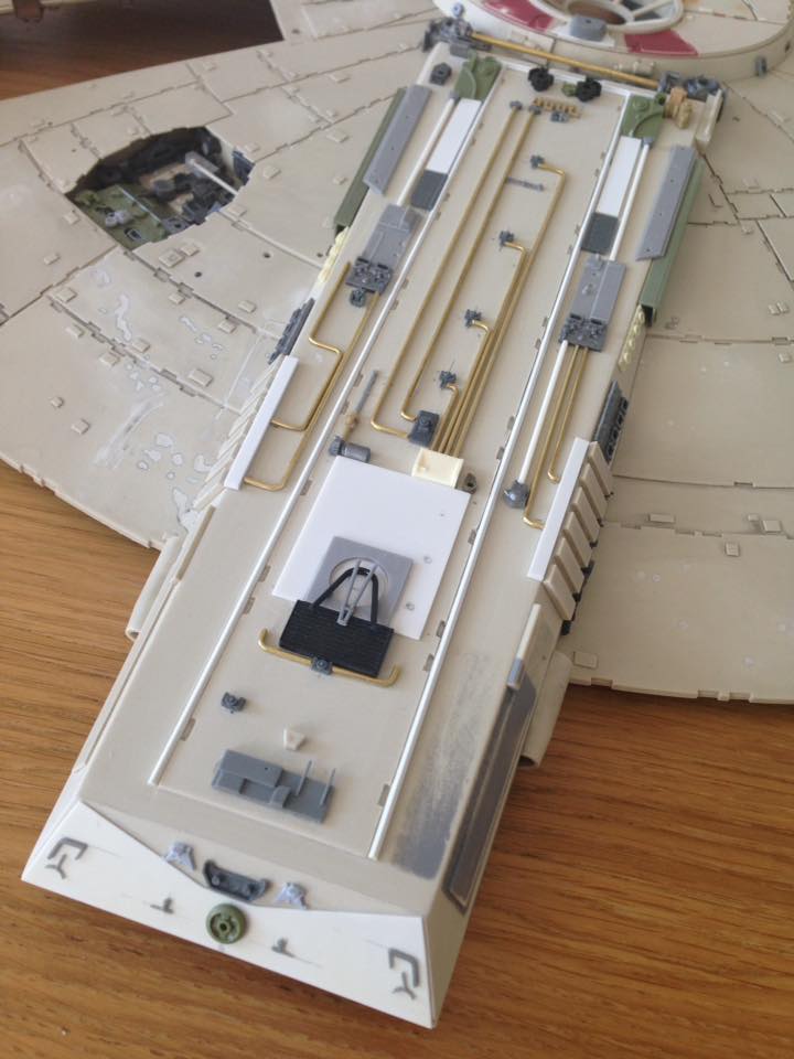

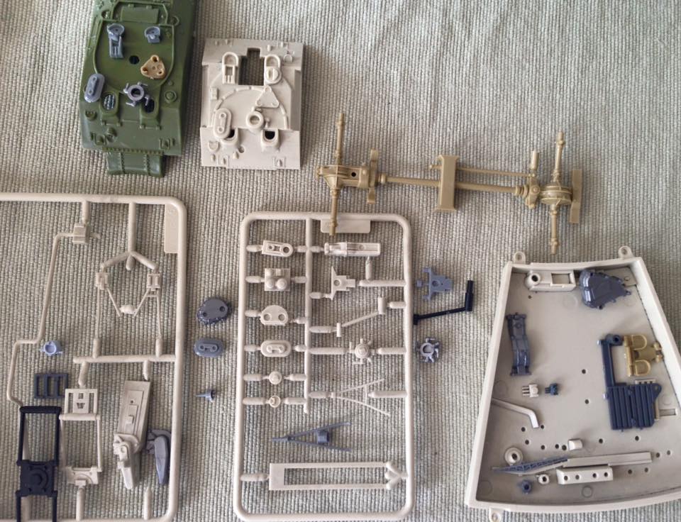

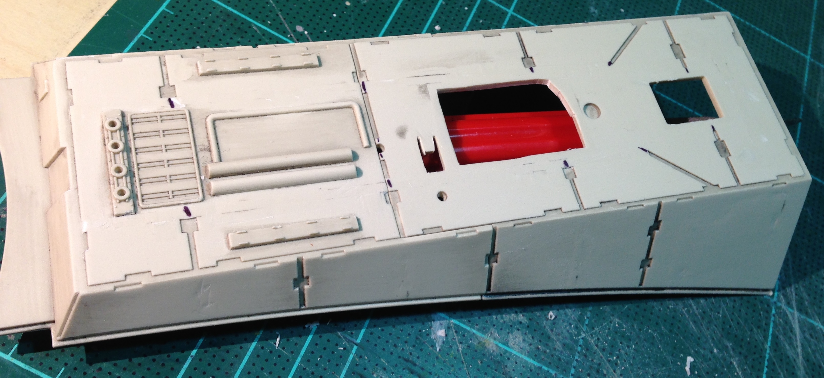

So here's where I'm at with the lower section, there's a few pieces missing, but it's mostly fixed as far as I'm going. I didn't bother updating the two lower recesses much as I don't they will be seen much. The upper/sides will get a LOT more work on the,

Awesome. Those parts will definitely add more depth and definition to the overall look of the kit when completed.

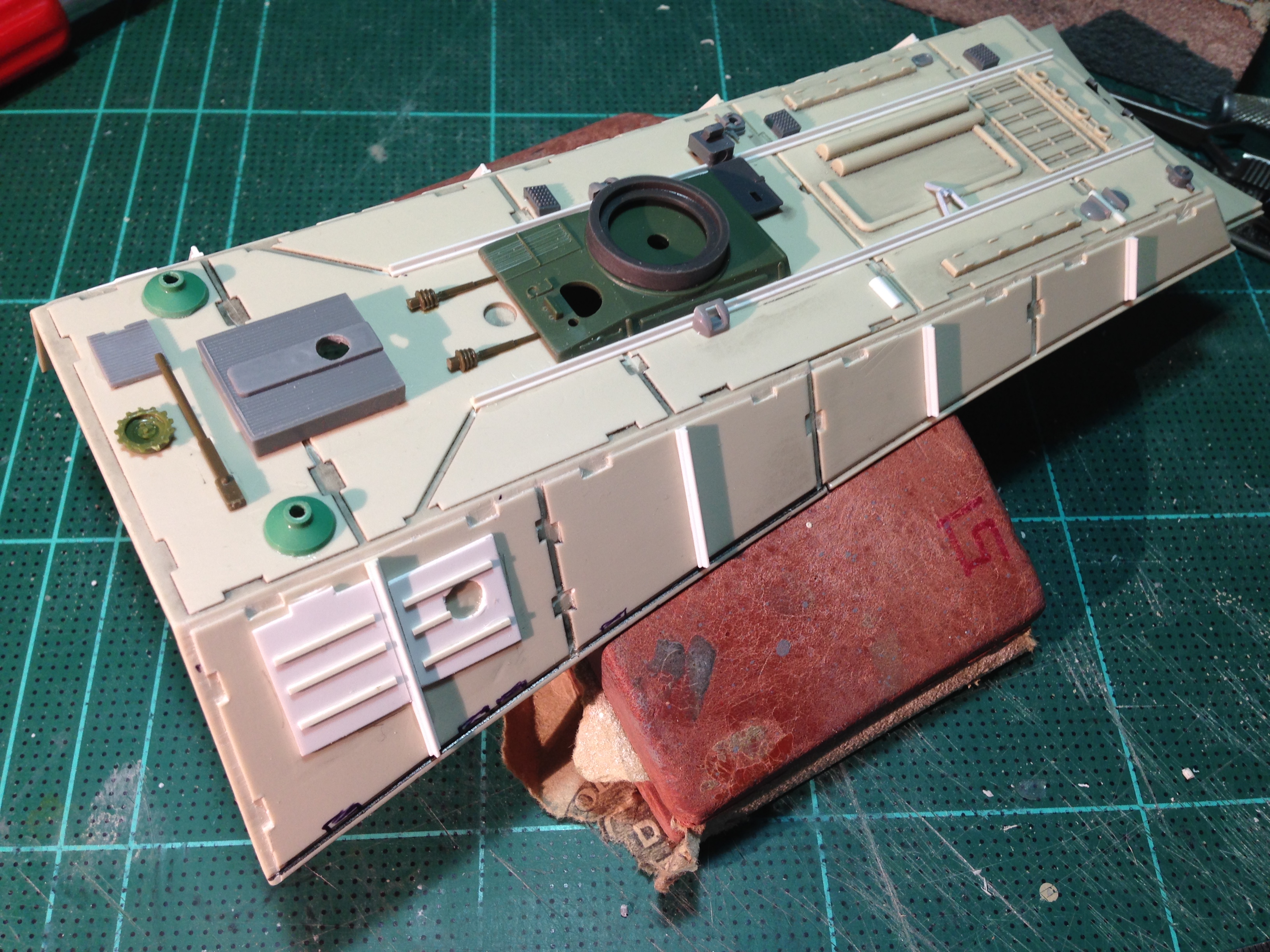

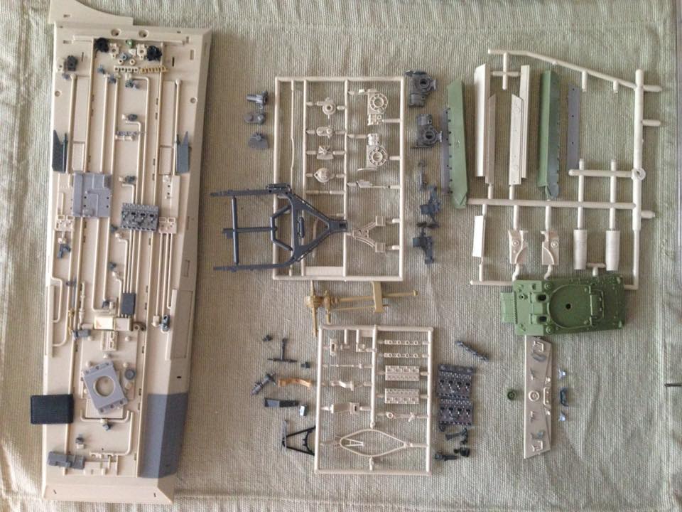

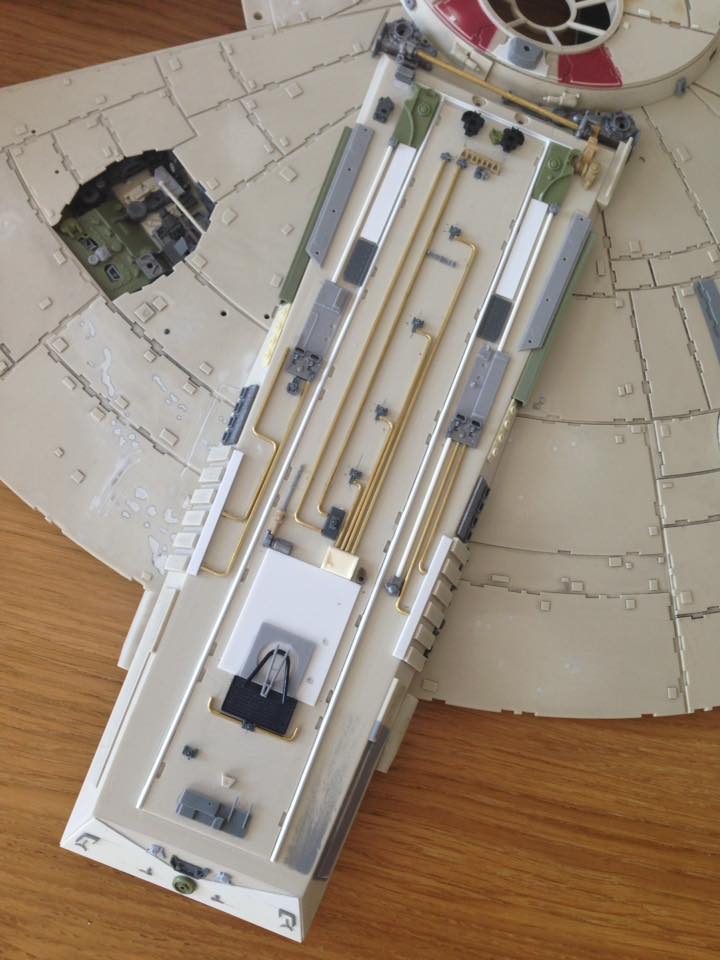

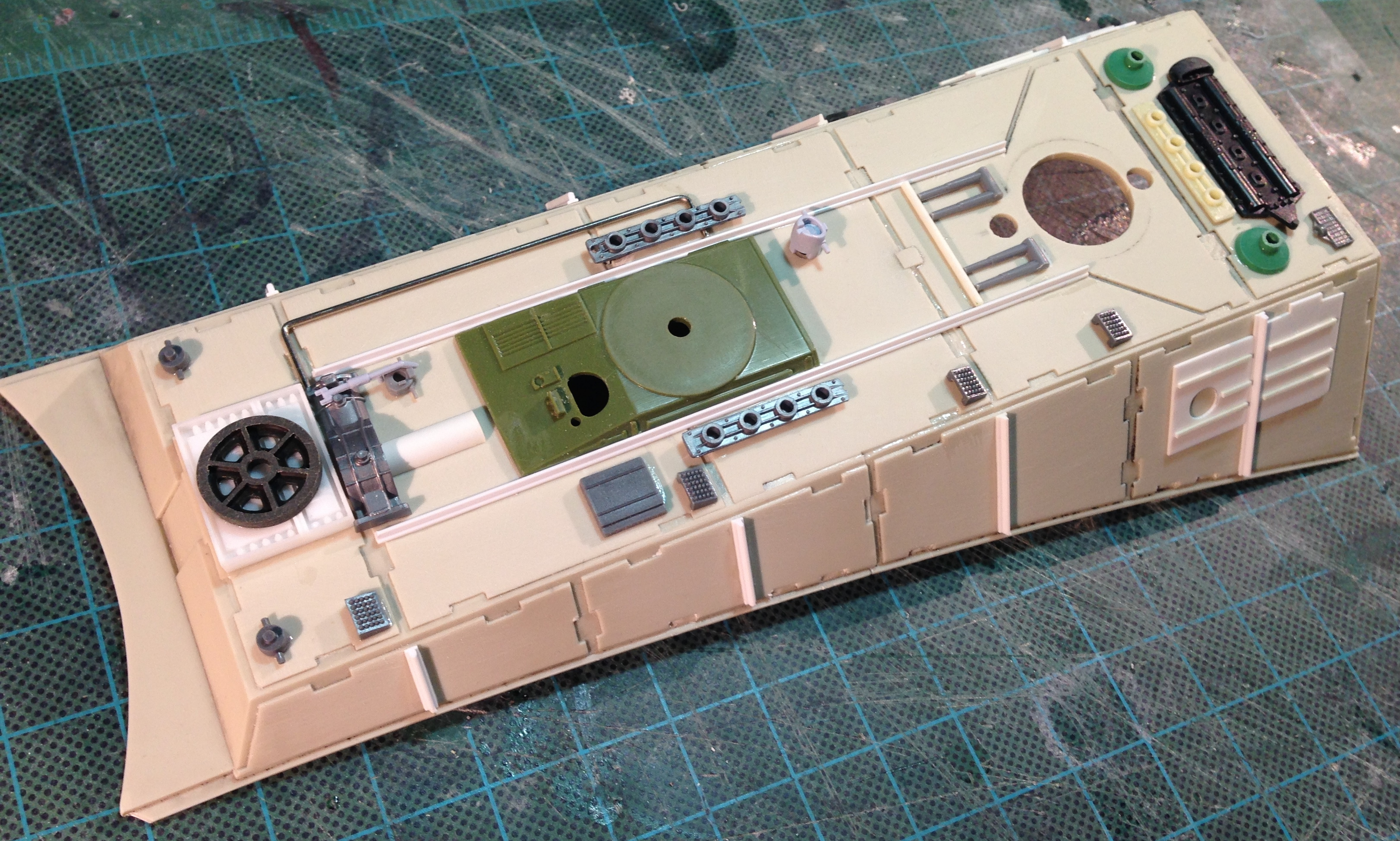

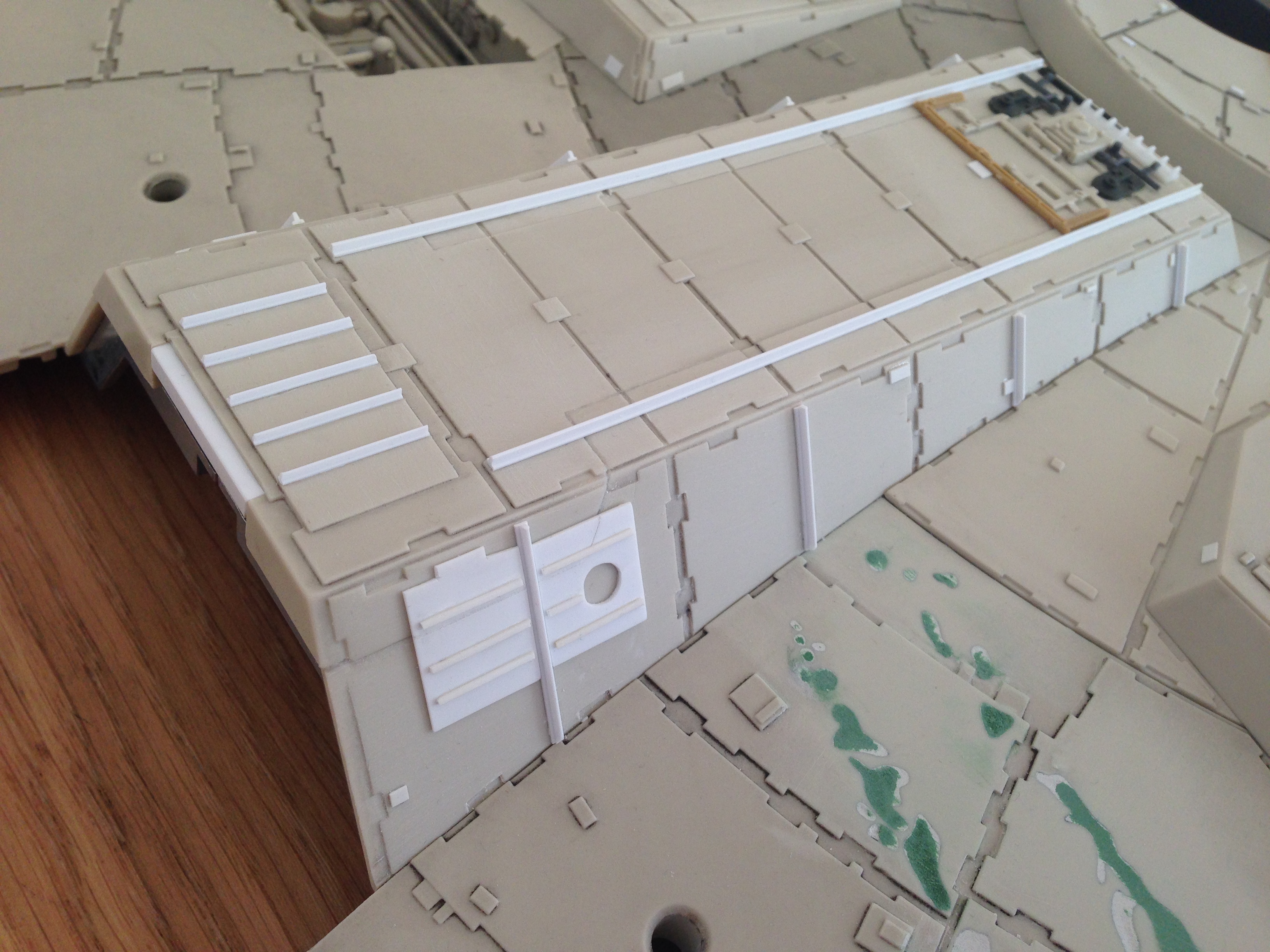

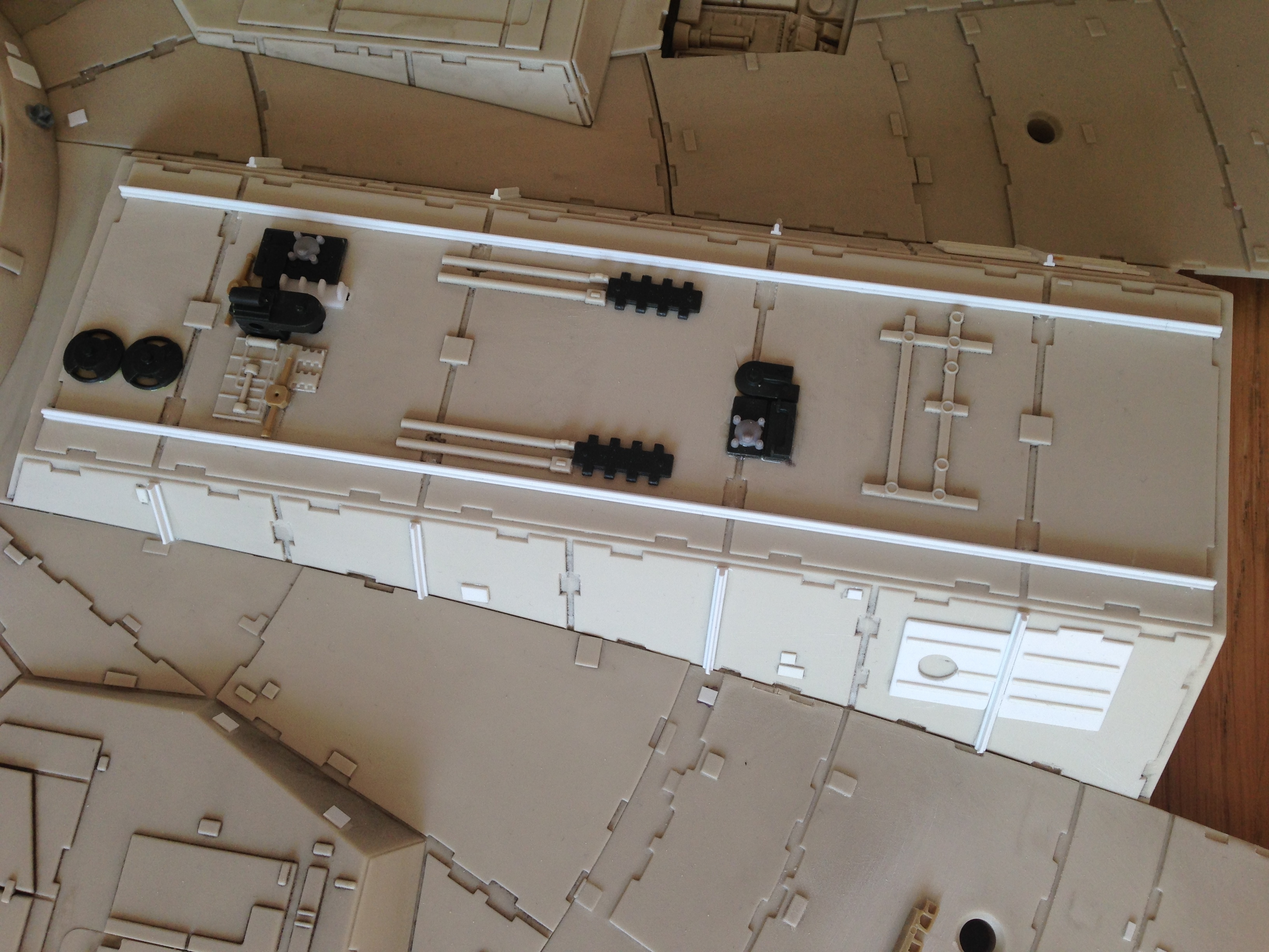

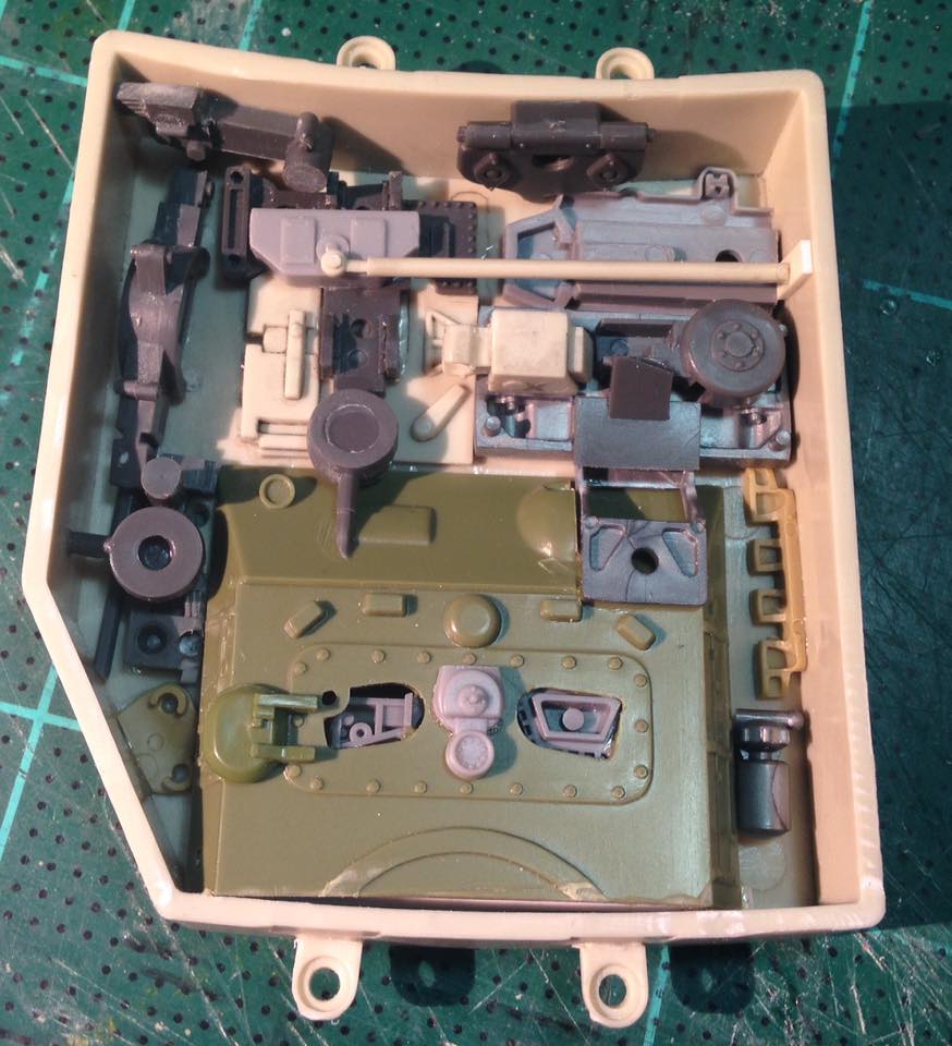

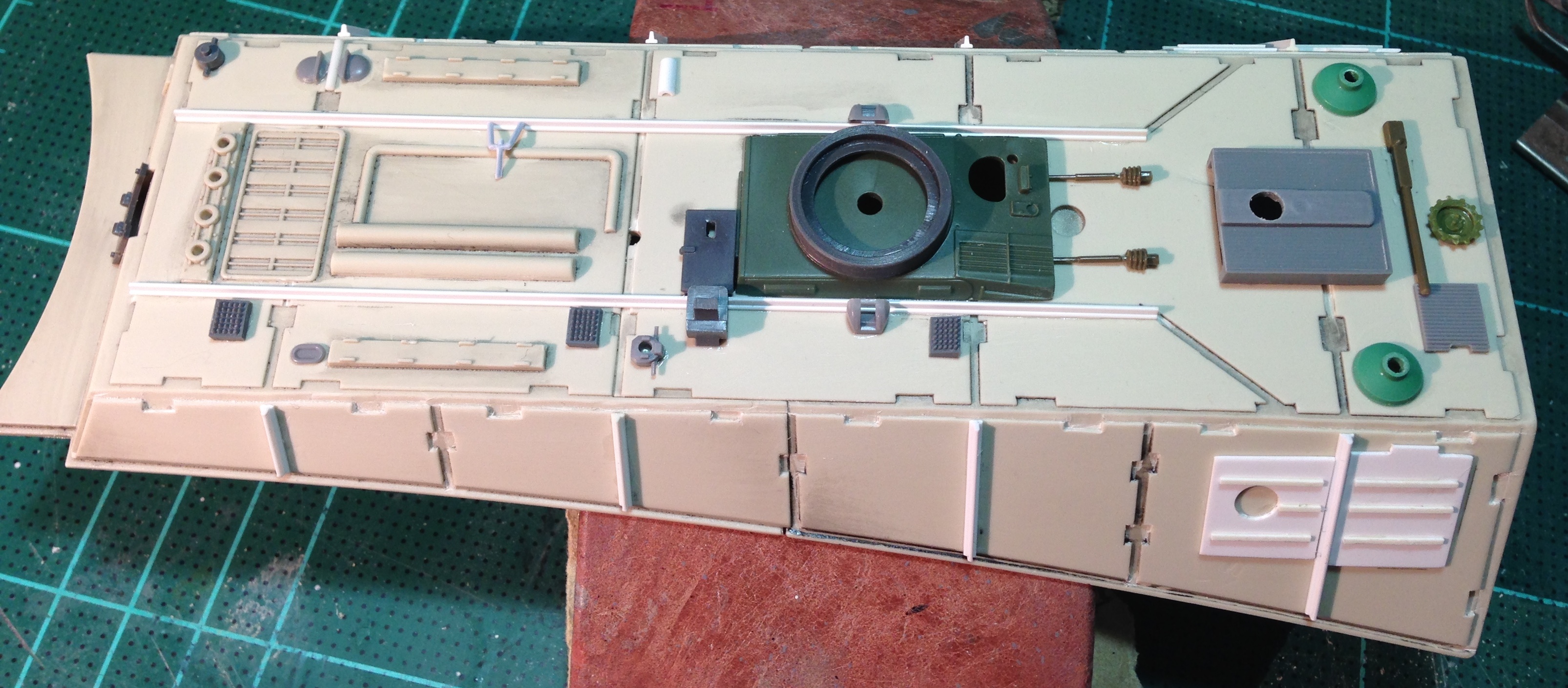

The upper tunnels are next. The right one was some of the very first pieces and required extensive changes and tweaks. The left not so much. It's easy to see that the patterns have been improved and updated as the project has progressed. It should be noted that the right tunnel has been updated again by DeAg. While some of the details didn't really need replacing on the left tunnel, I already had the kit parts :-D

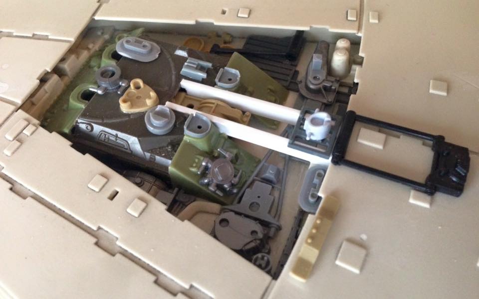

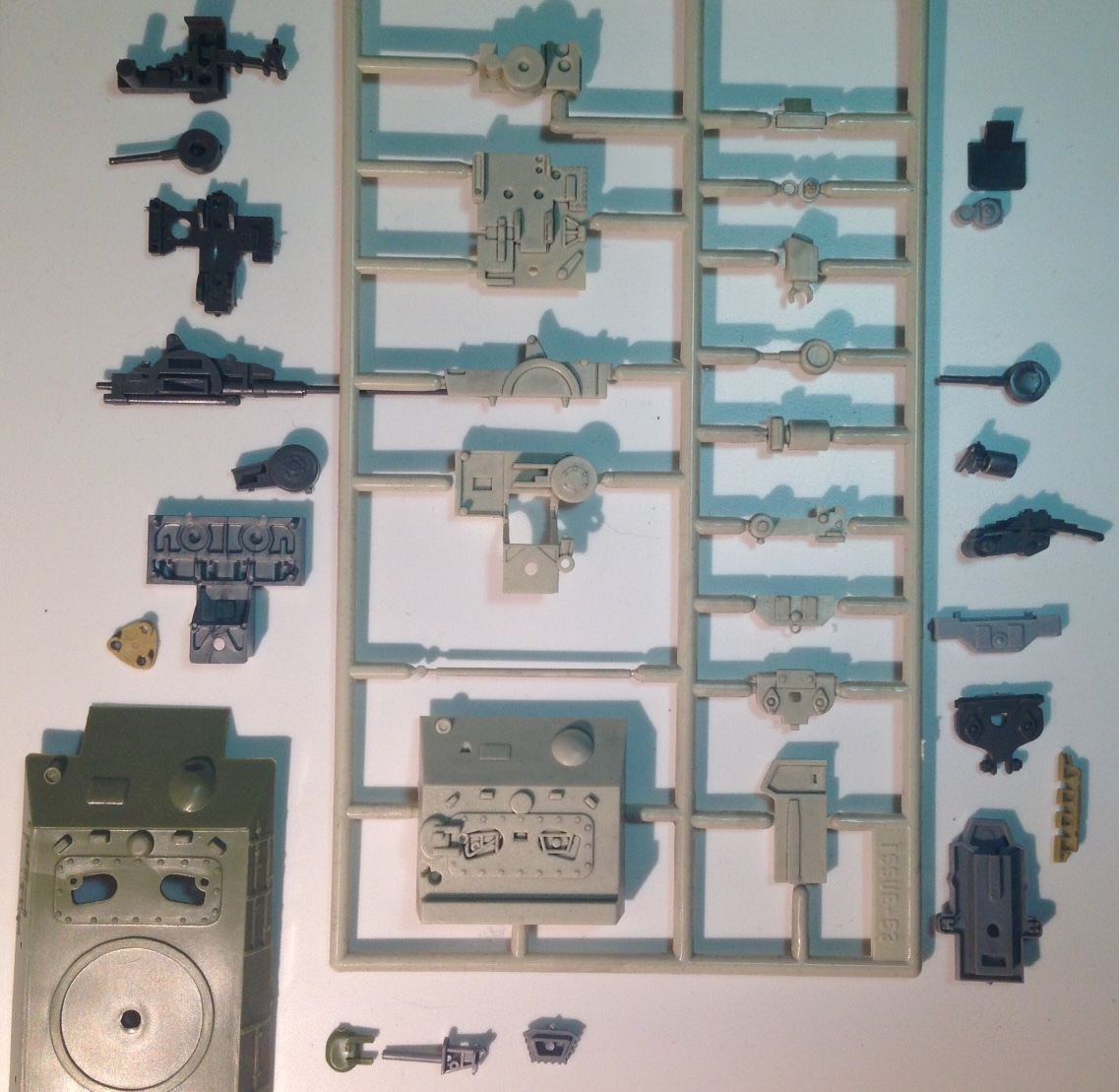

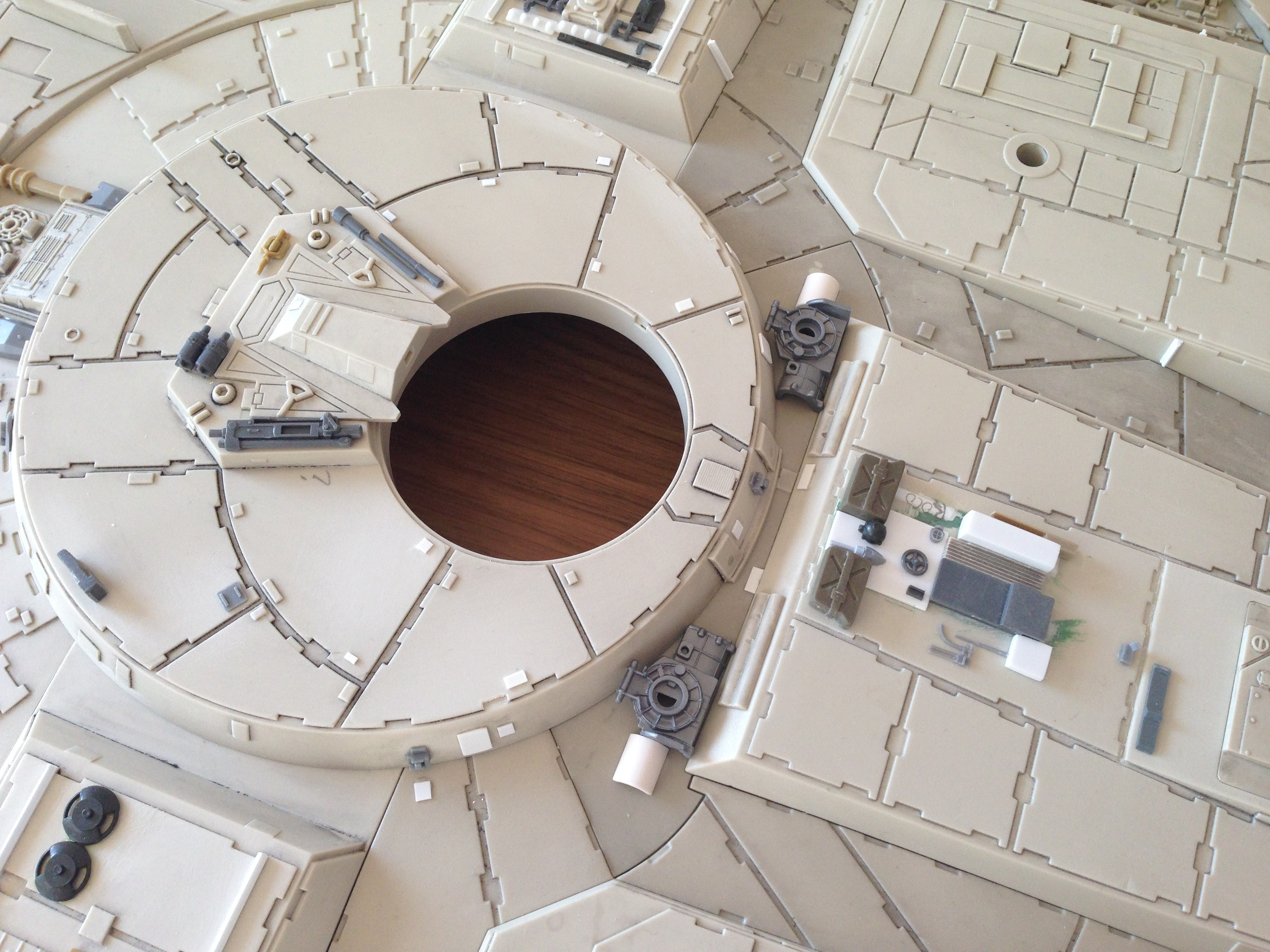

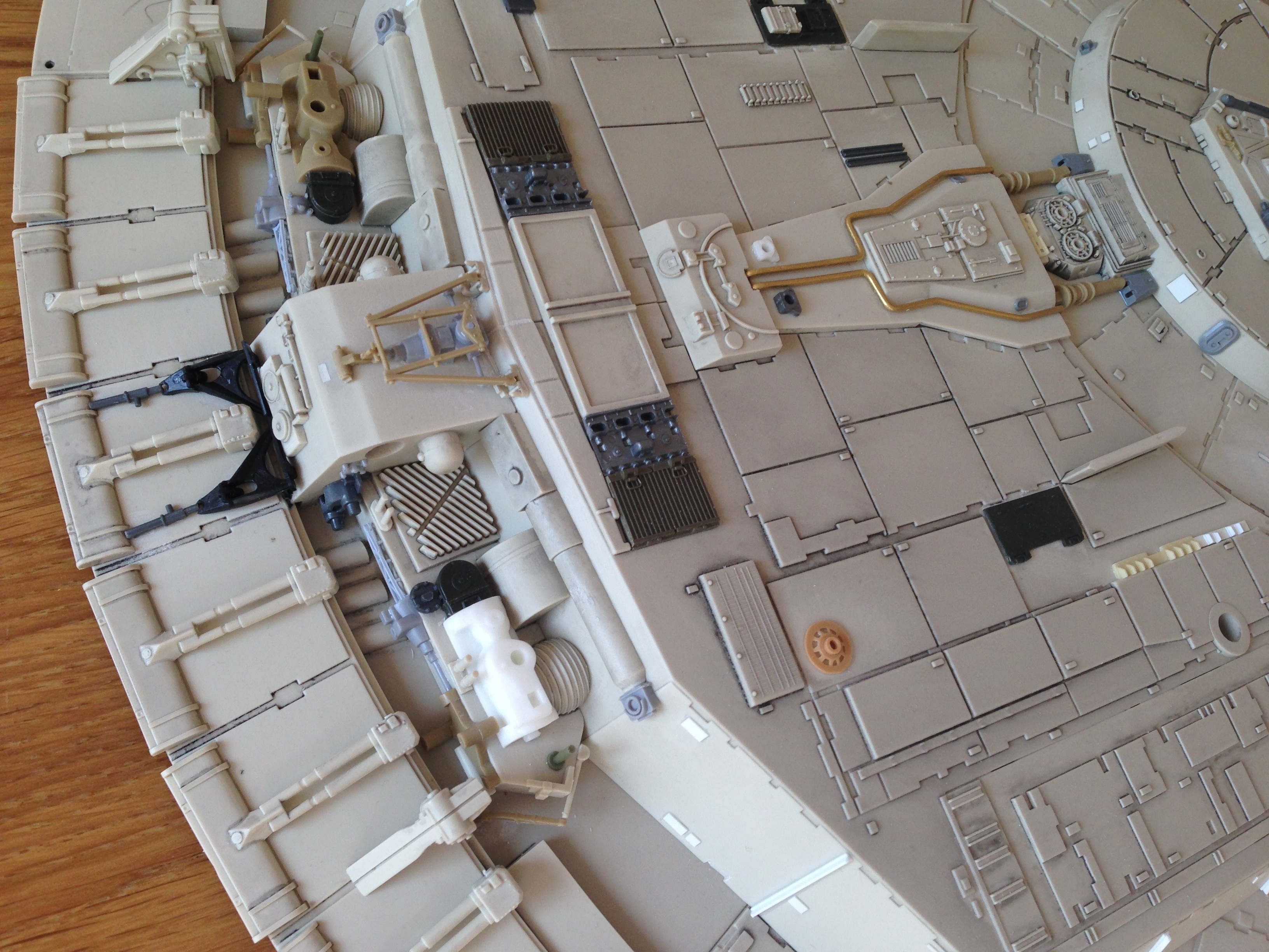

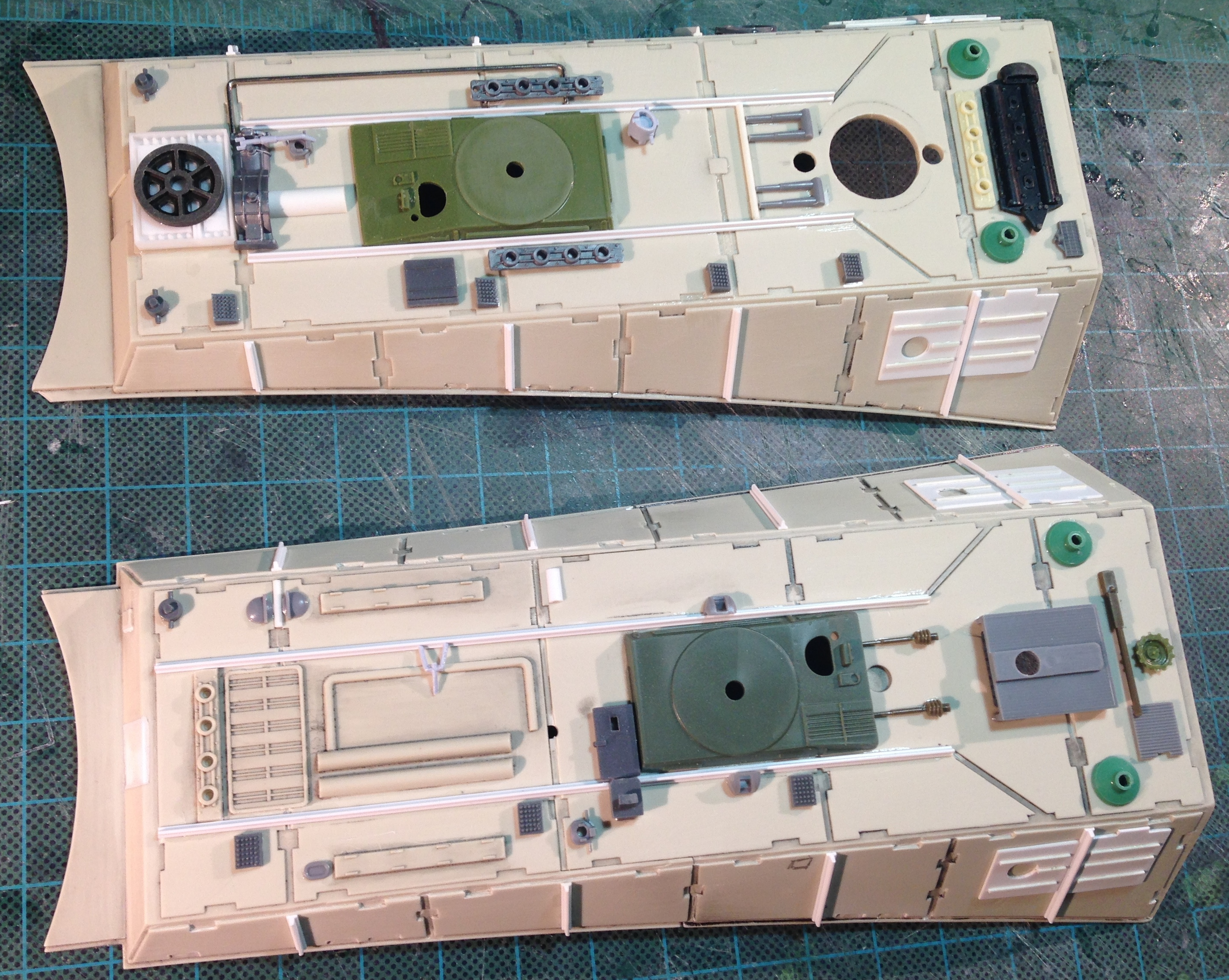

I've now started in the top 'saucer' as all those parts have arrived. Before I tackle the cockpit I'm getting the 3 recesses out the way.
Ended up replacing everything in the first one. Plus I added some of the details that are missing. The undercut at the top on the original minature goes in further, but I didn't extend the section as it seemed unnecessary. The DeAg part, as you can see, isn't bad for the most part. Some of the smaller details are missing though.
The next one needs a little more work. Again the DeAg parts are a mix of 'really good', to 'what?' :)

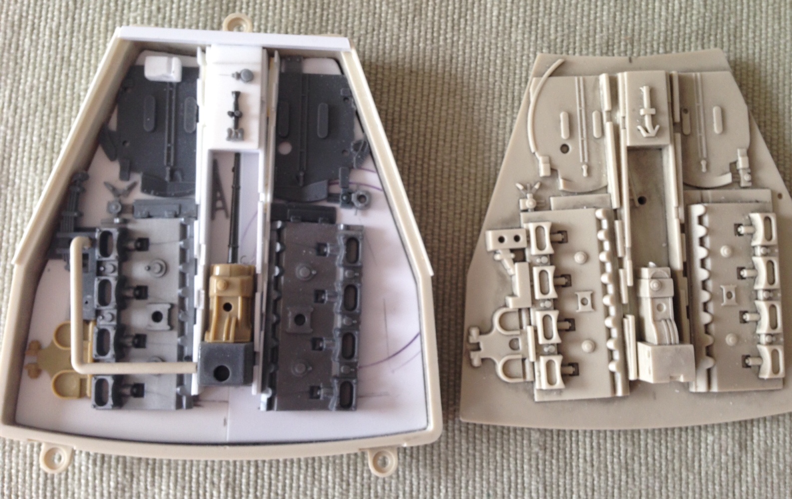

Great work Sherlock ;-) Have you head on views of the original studio Falcons recesses to judge how accurate your parts lay?

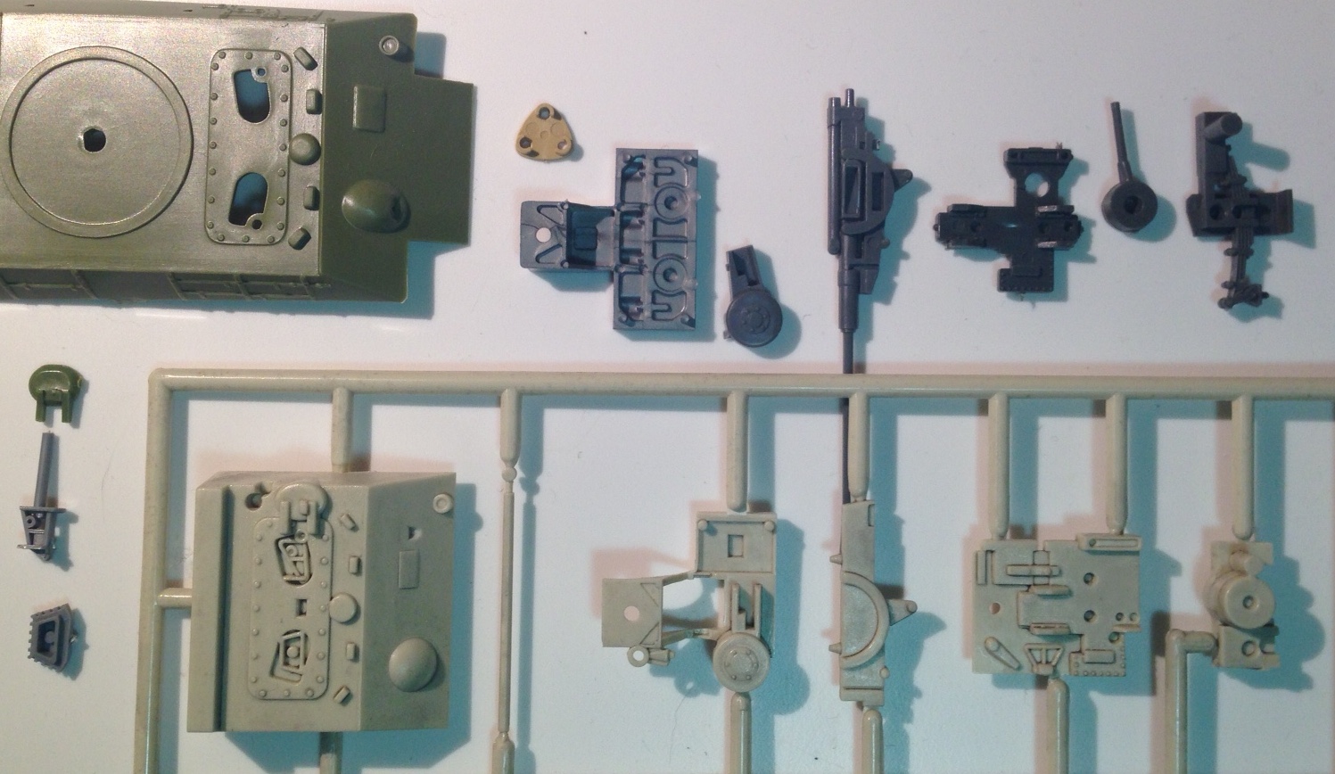

Lee, you used a 1/35 Gepard part but they used the 1/87 Roco Gepard on the original, quite a different size ! :D
Hey,
Yes I know, when I was pulling the parts I saw it was Gepard and just got that piece. I was thinking it was too big but didn't check until I started trimming and gluing!
If you look at the second picture, you'll see it's the right one!
As best I can. I have thousands of pics of the original, but still there's angles I could use. So I open as many as I can for a particular area and go with that.

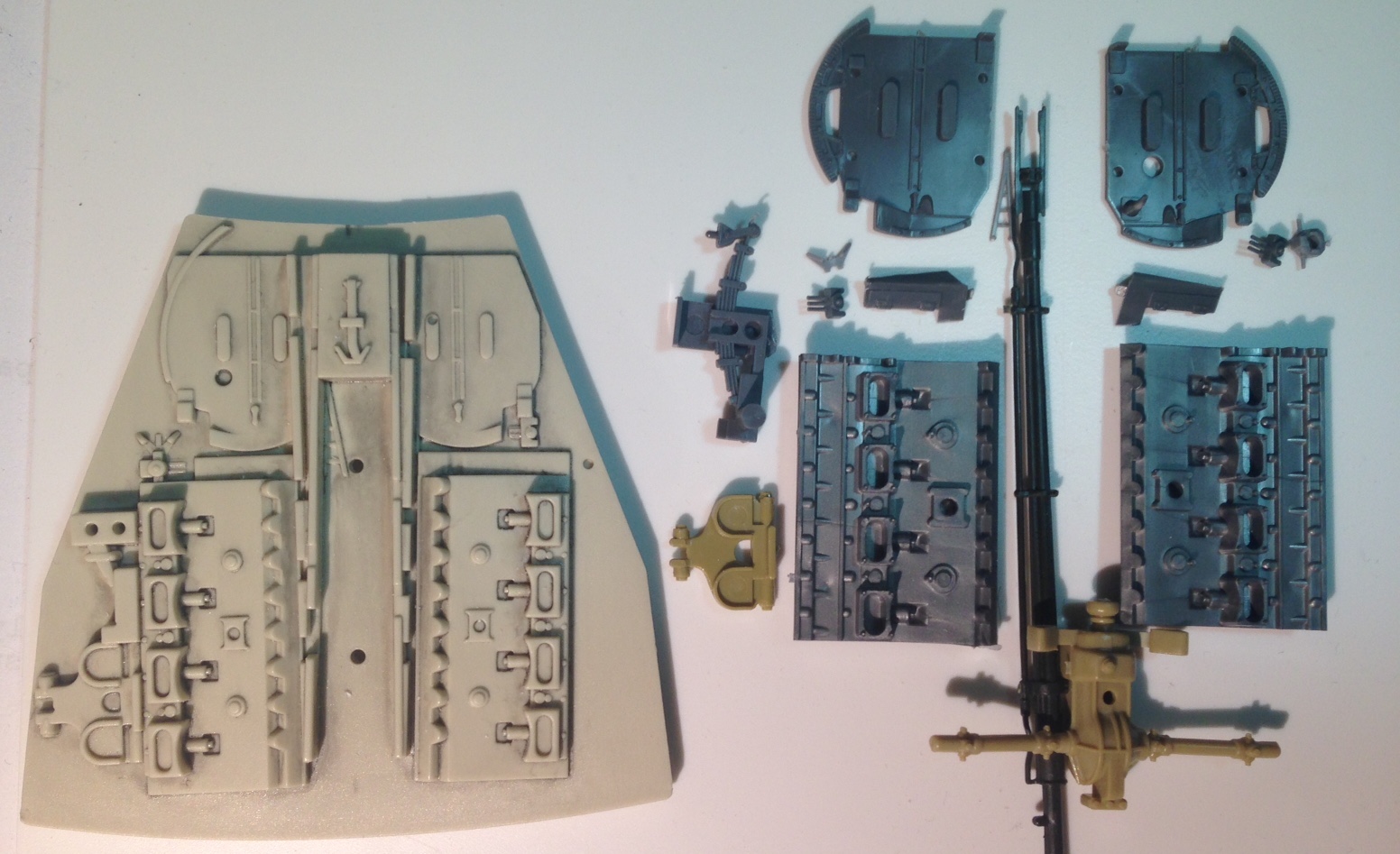

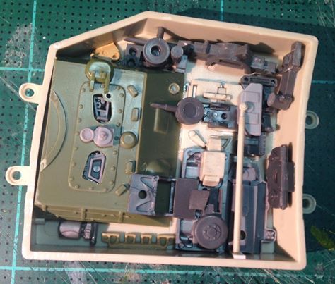

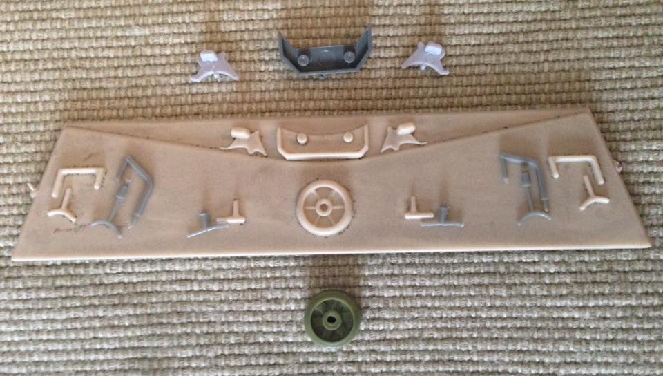

One more down. This was a bugger and I'm still not fully accurate. But there's only a handful of people that will be able to tell :)
I've now replaced the piece on top with the kit part (Tamiya type61)
