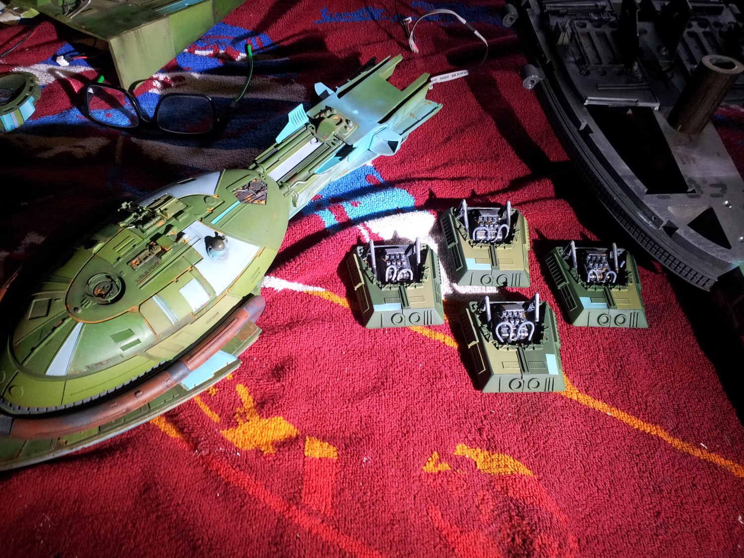

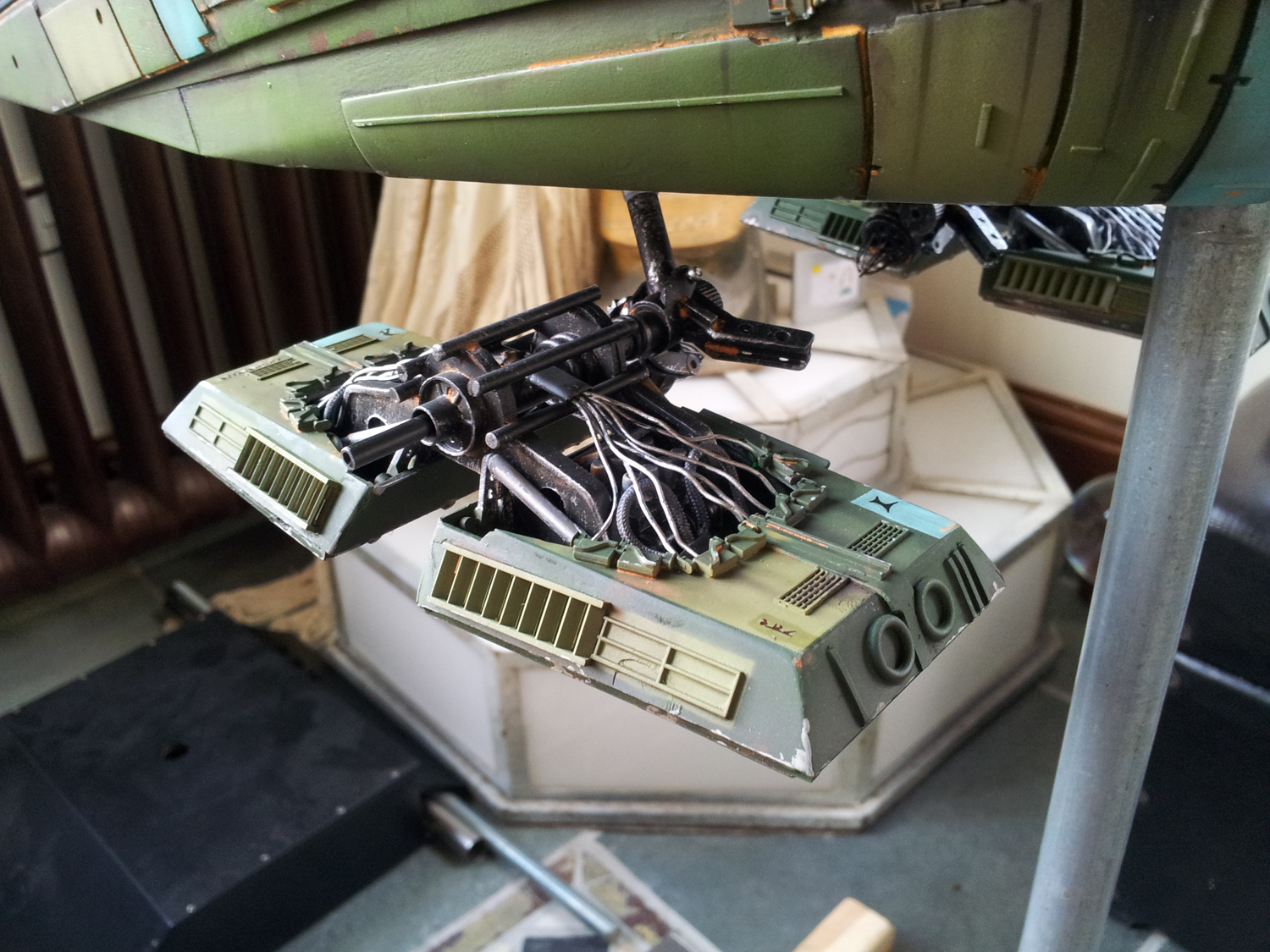

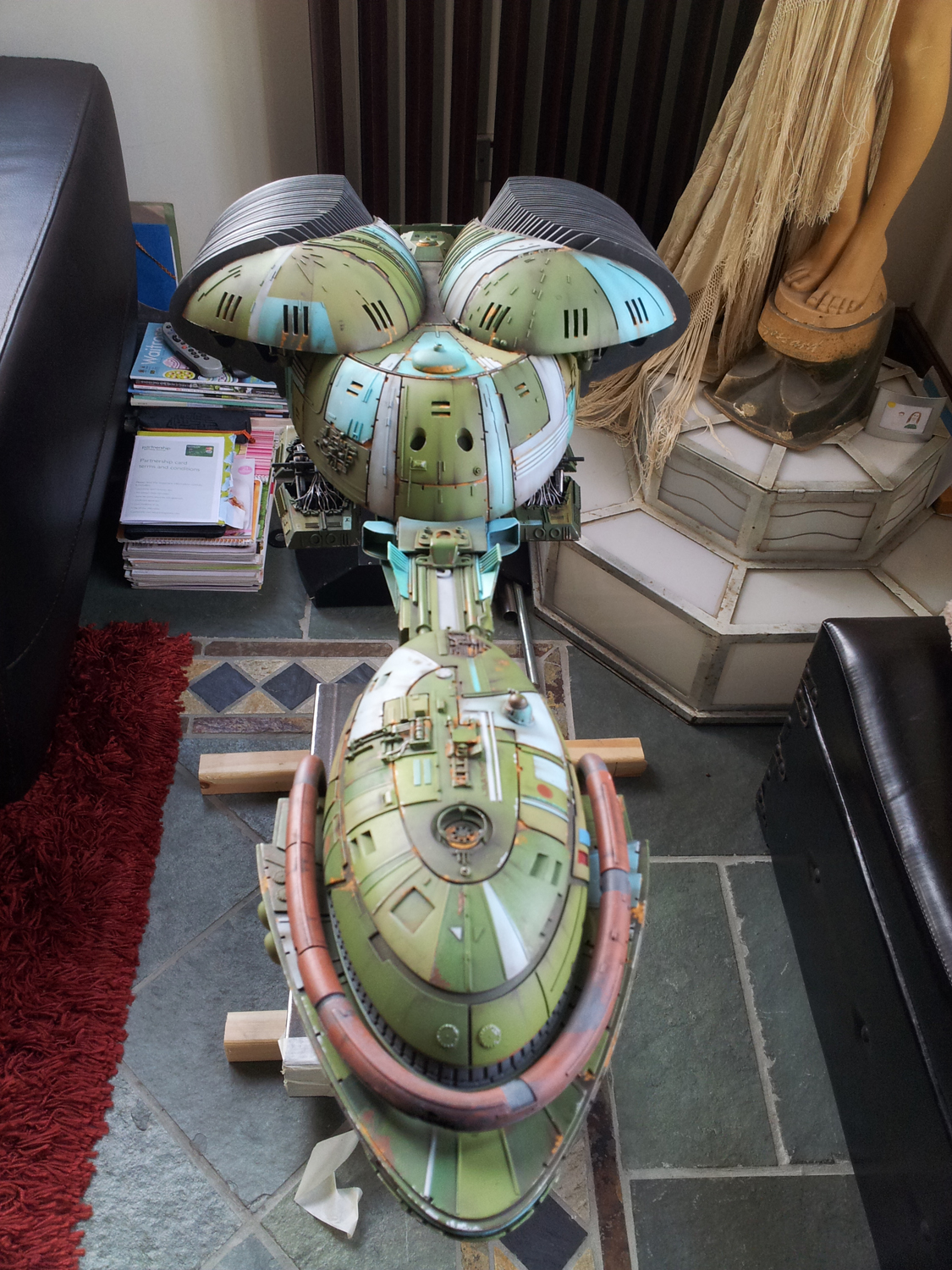

f2.jpgf4.jpgf1.jpgf7.jpgf8.jpgf6.jpgso that's it for the day, just finalising the panels and adding some weathering and rust to let me know where to airbrush on the next pass over this monster bird. I finished off the rough blending of he neck and its panels and I started on the feet. I went for a more abstract foot design to bring the eye down to them once the model is reassembled, the landing gear bays now have a coat or 2 of the first colours. I wanted to keep the corrosion effect inside the panels rather than on them , unless it needed to be on the panel to match the reference, so I used tamia weathering pigments dissolved in cellulose thinners to run them down the edge of the panels where it was needed. They dry great and act as a guide for the weathering using the airbrush on the next steps. The main rust will be re-done on top of the airbrush weathering again in once its almost complete. Ok folks, thats it

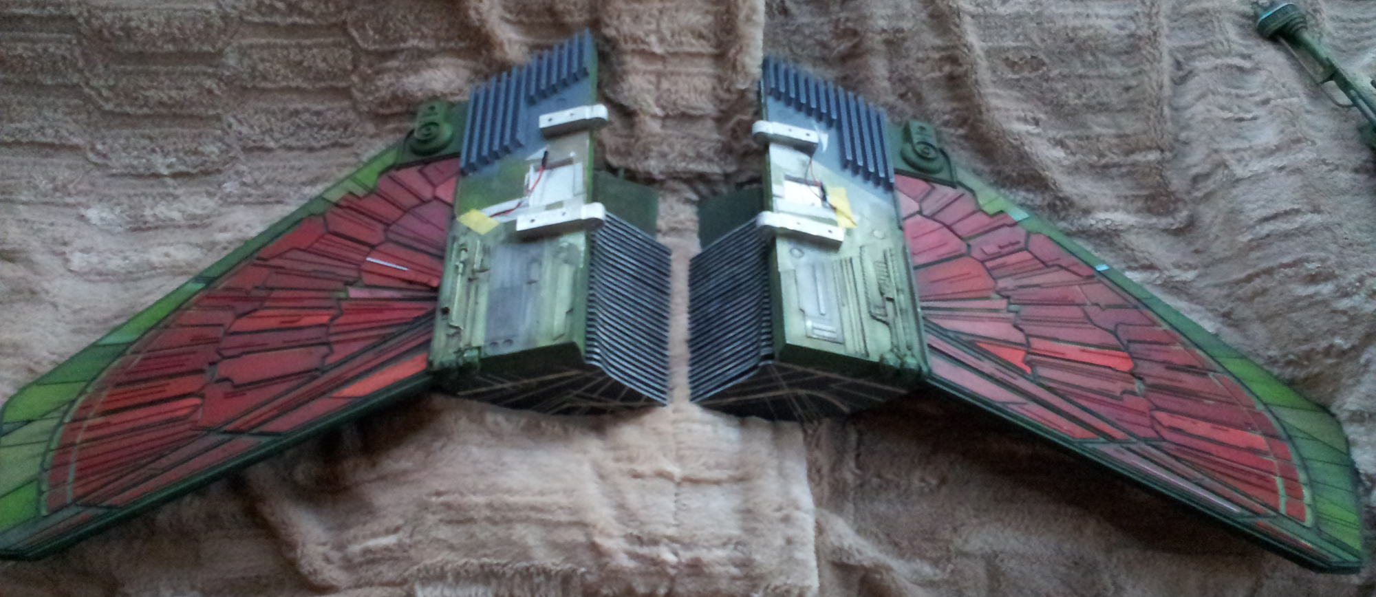

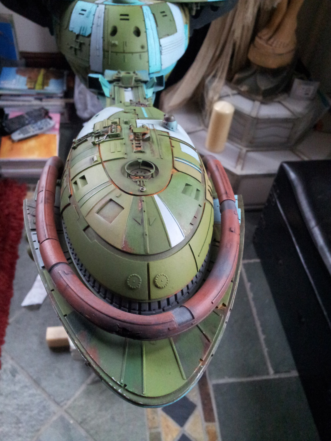

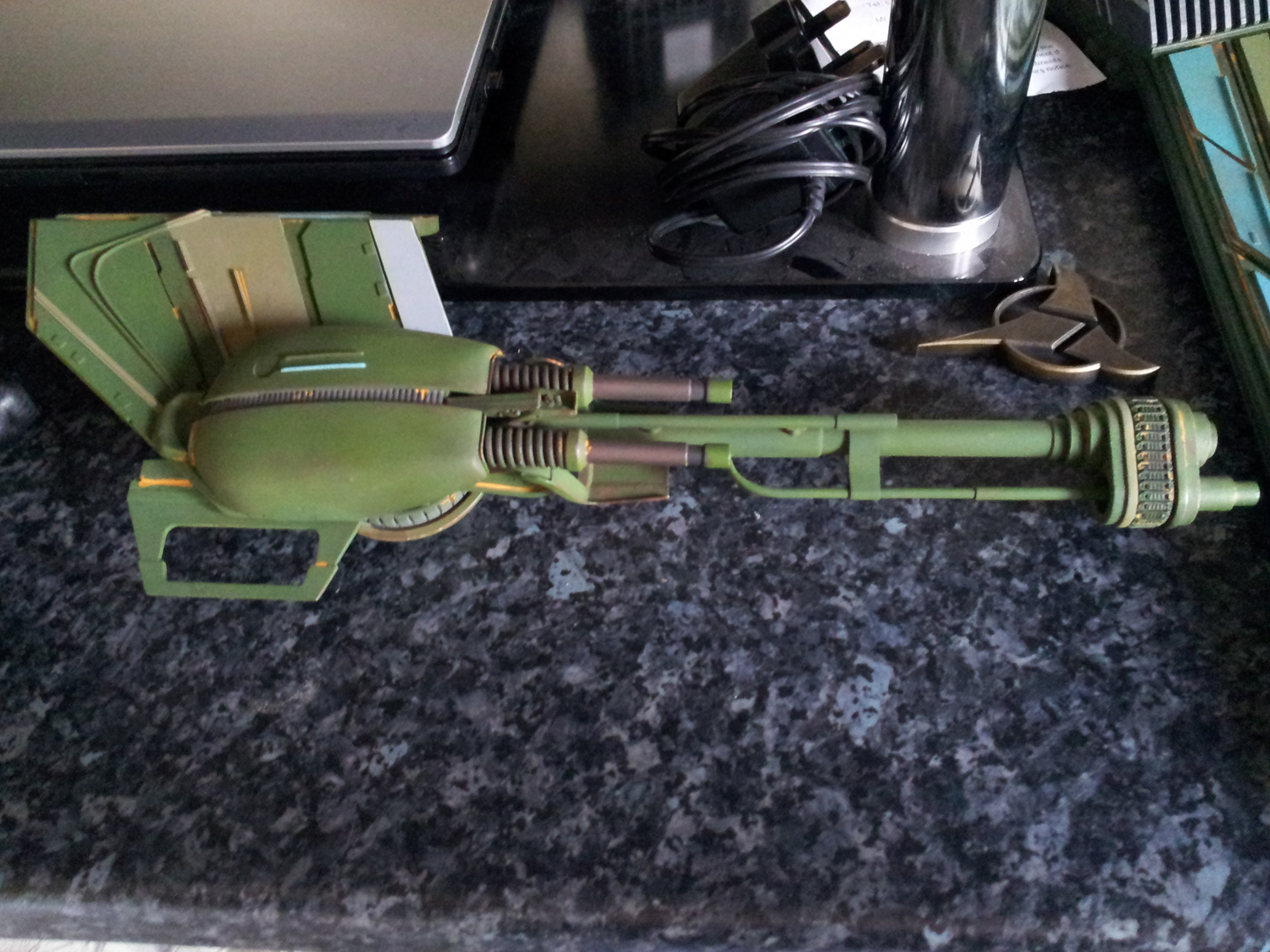

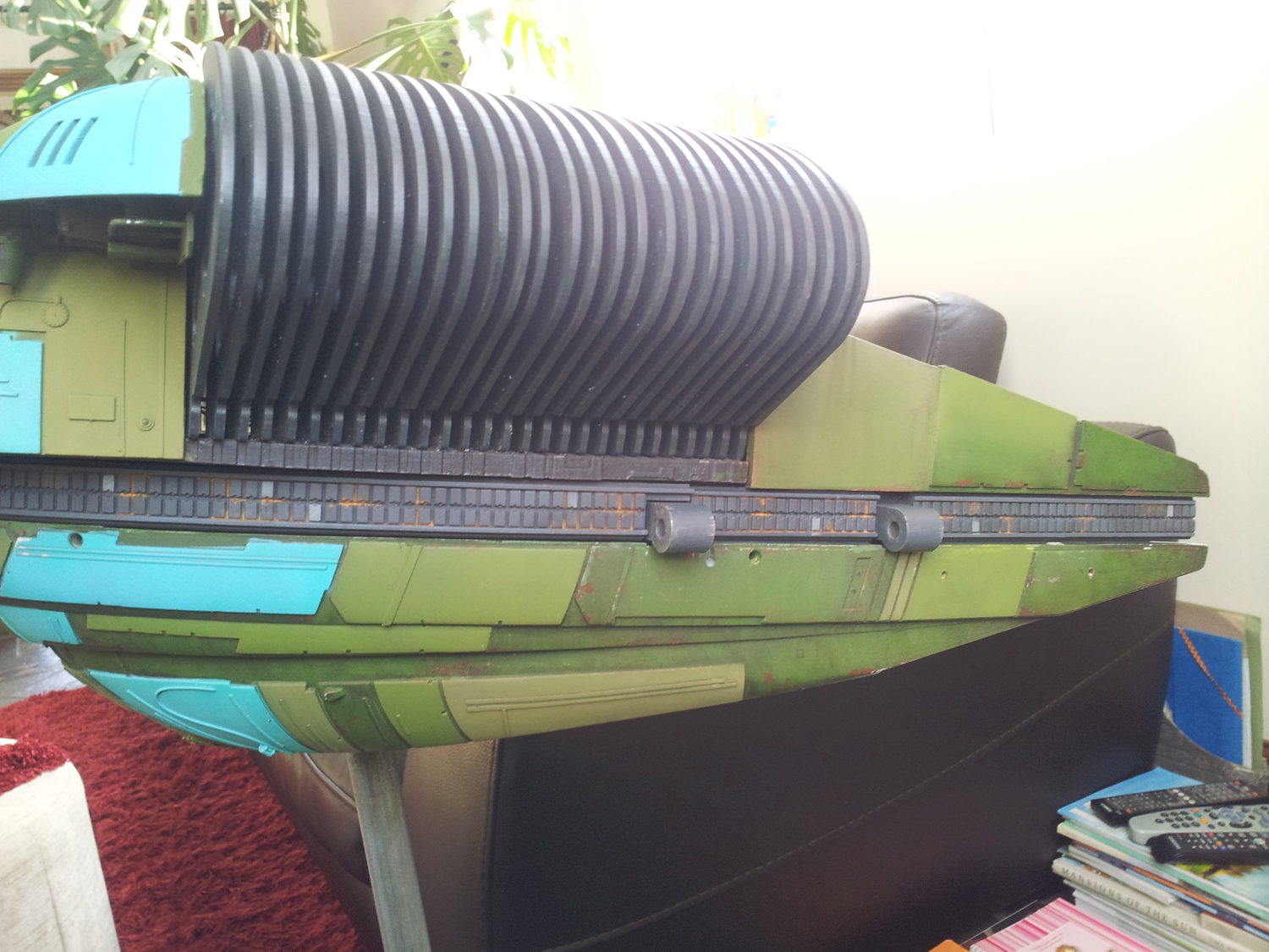

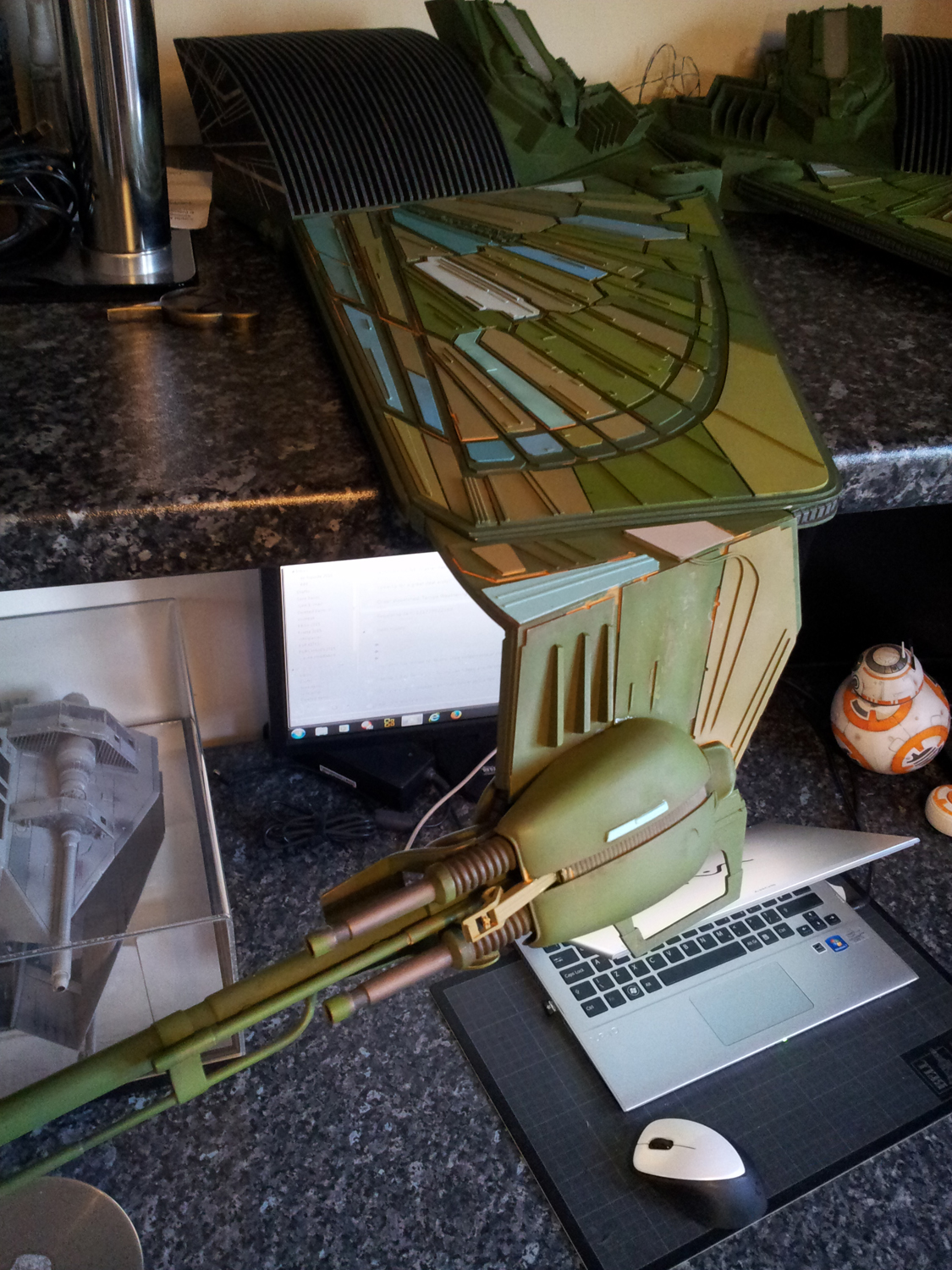

more done over the last day. I painted the central tank tracks which wrap around the body, tried to find the references for the whiter squares on the belt. weathered it back some with rust again. The wing guns are now painted up ready for weathering and some rust added to the wings as well. Ony rough at this stage but its coming on now. Almost ready for the main weathering now.
I jus need to re do the kilingon logos on the guns and wings before the main weathering takes place.

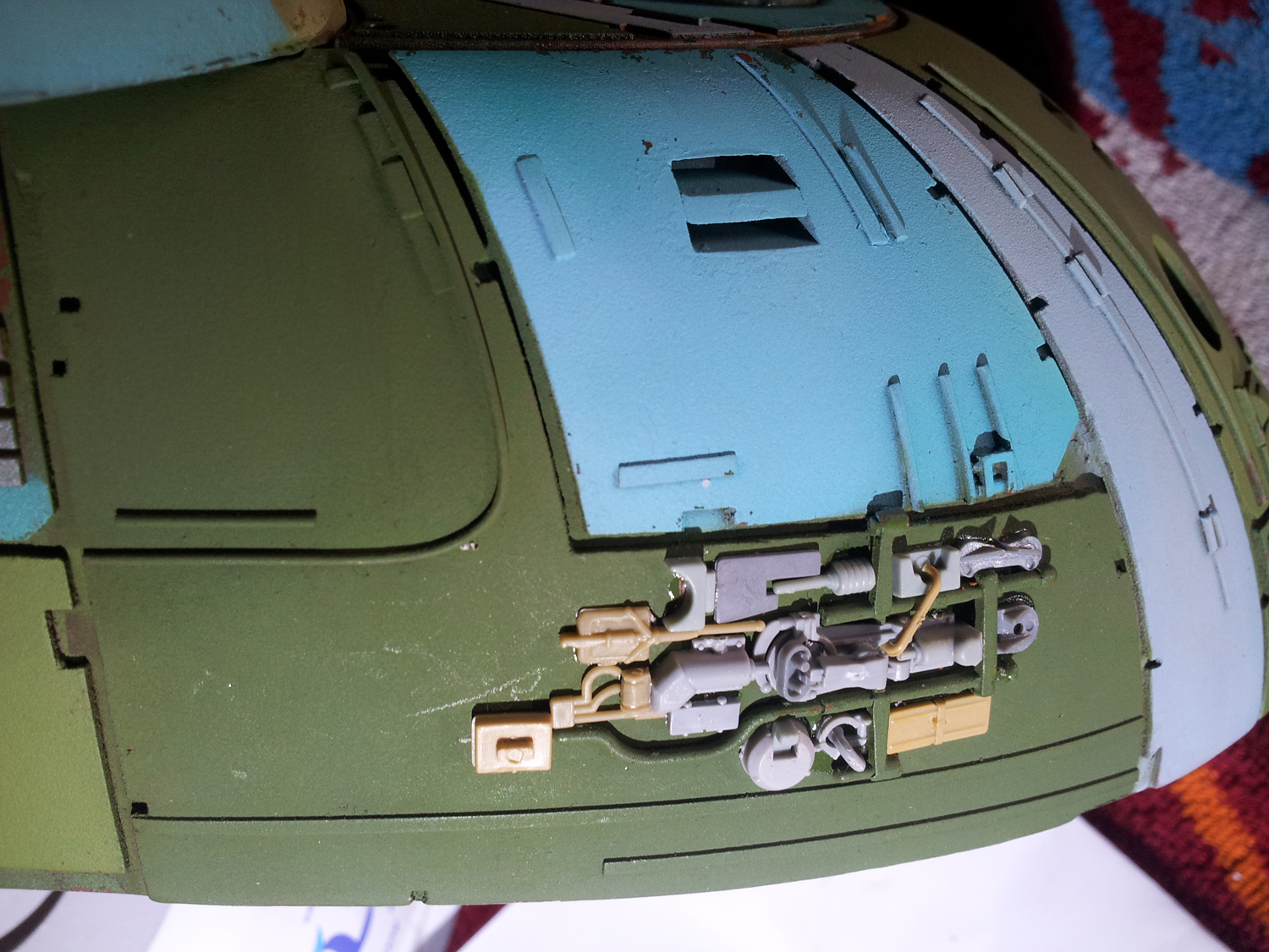

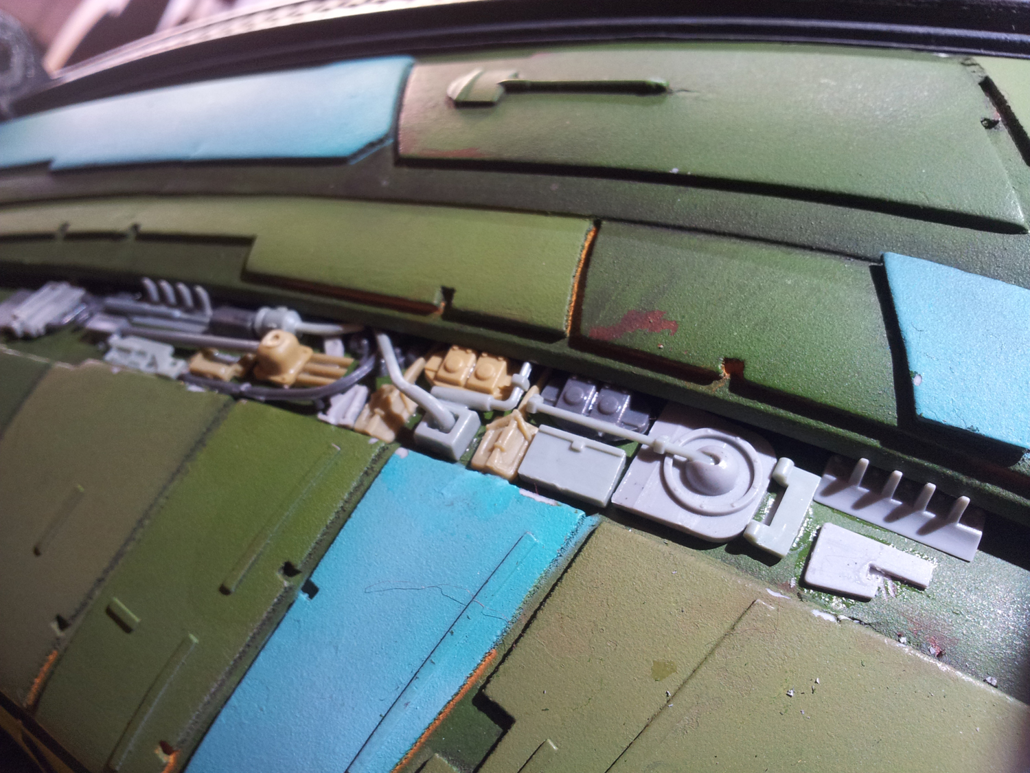

Anyone know what these greeblies are?, as it looks as though they do not exist on the model I have here. Or maybe they were an addition or removed between The search for Spock and The voyage home ? any info would be great guys, otherwise I may just kitbash them as best I can

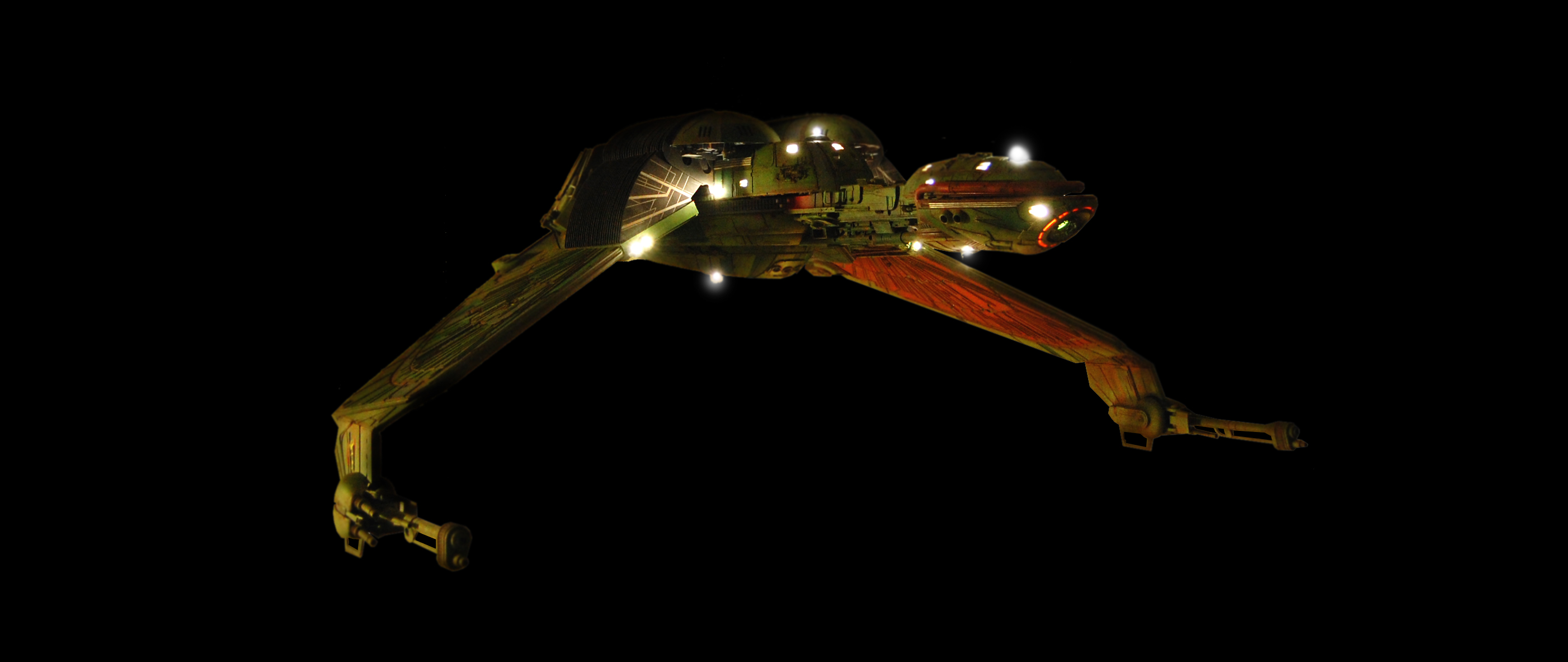

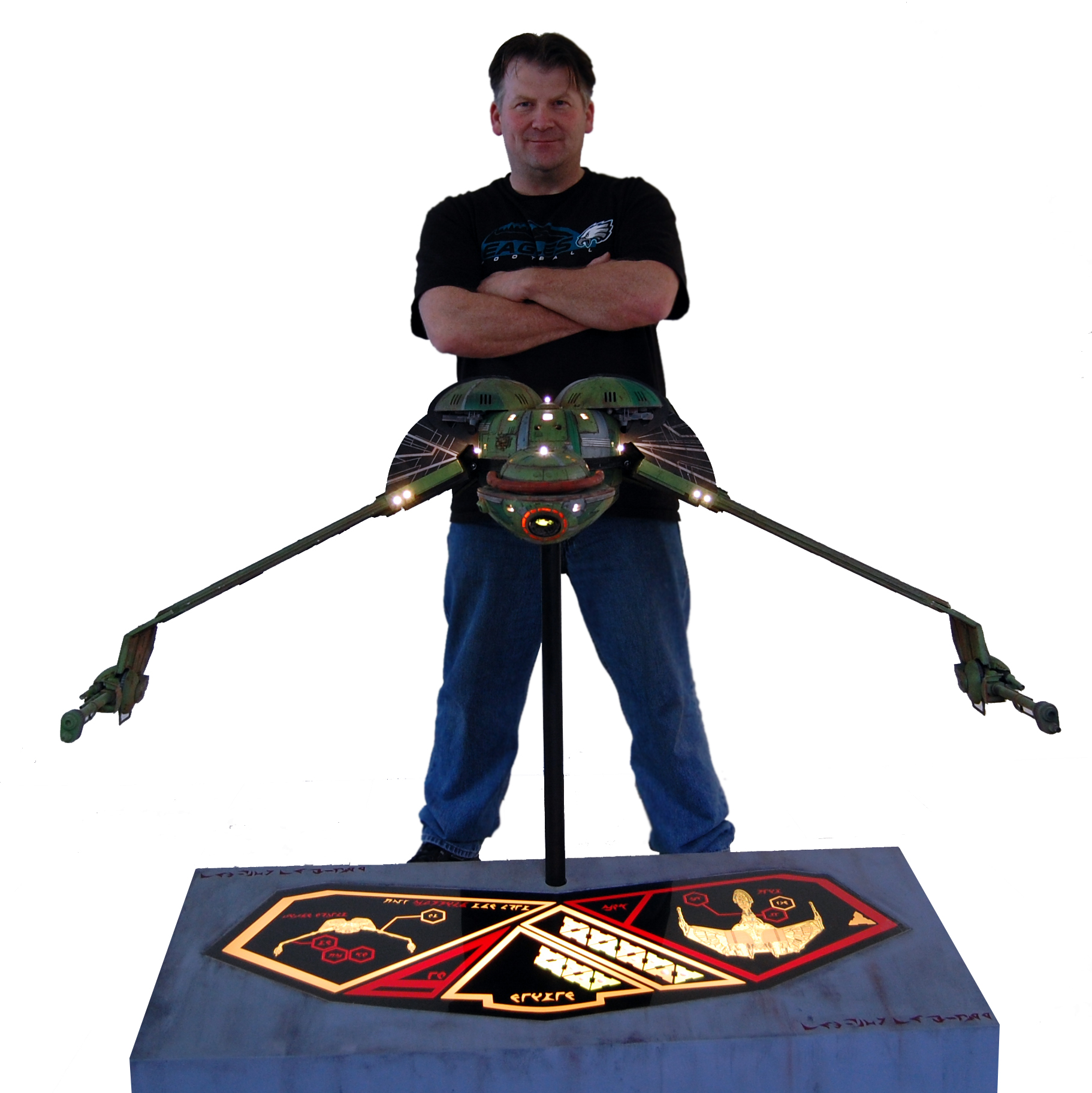

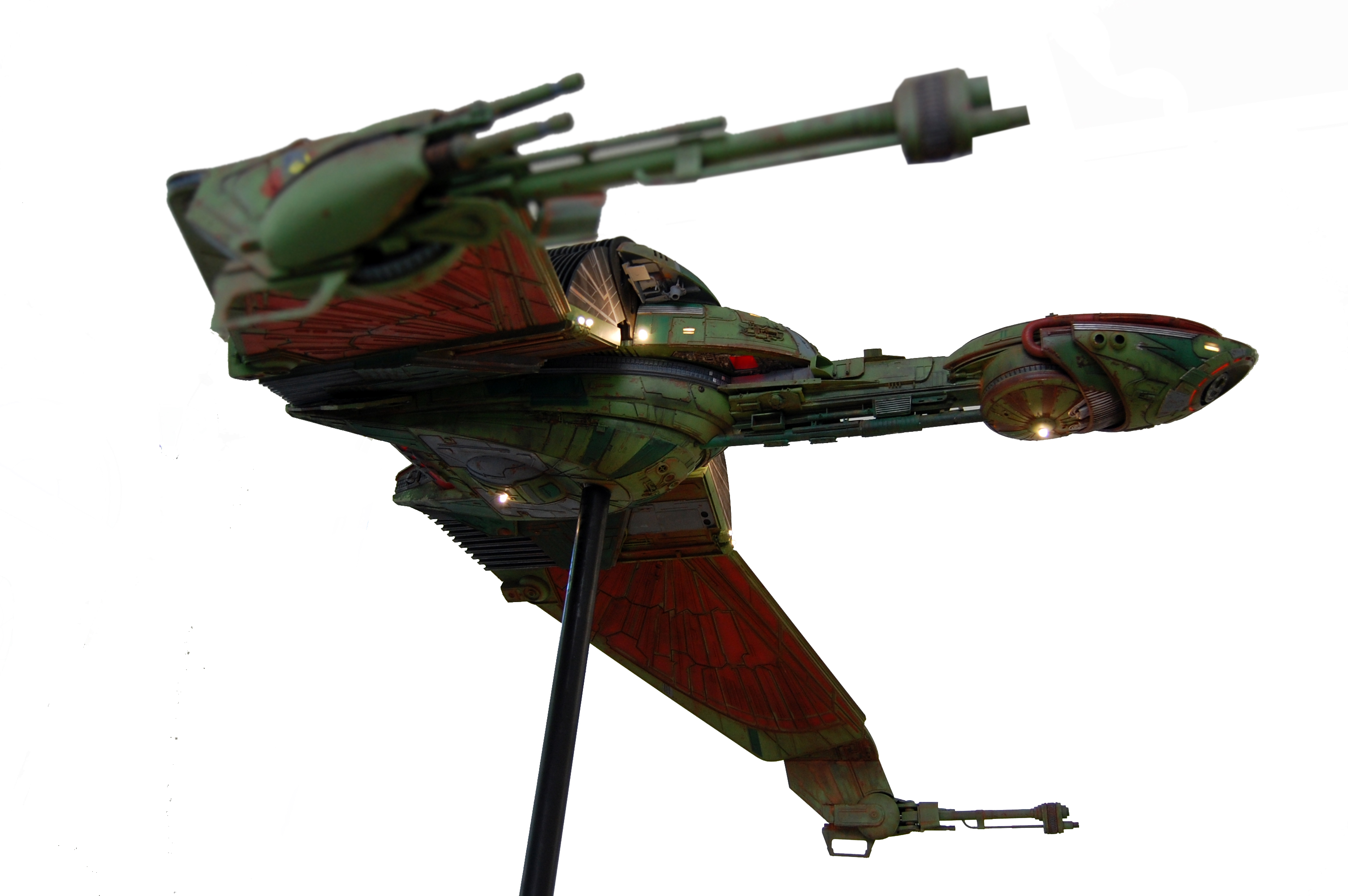

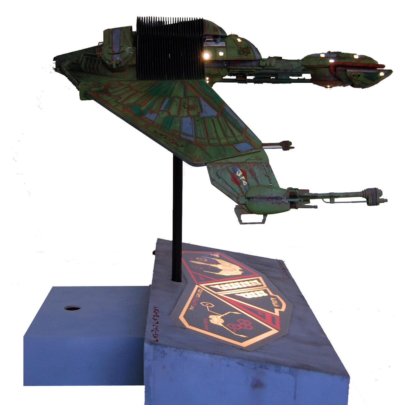

The ones that were found are either on the kit or in it.. everything else is well your best guess.. there just isnt any good reference of the area at all.... this is what I did....
and as far as paint sticking.. ive painted two and no issues and I use acrylic. Makes sure all parts are washed with warm soapy water and if your using masks make sure you seal the paint you are masking.... worked on mine... as far as problems with the resin wing parts separating.. you have to remove all grease on the aluminum ... rough the bottom of the wing and armature with a dremel or sanding disk to give the 5 min Epoxy something to grab onto.. use enough epoxy paying attention the edges are covered.
DSC_1057.jpgDSC_1144.jpgDSC_1053.jpgDSC_1095.jpgUntitled-2.jpgDSC_1085.jpgDSC_1187.jpg

The BOP has always been available my friend... i just have to put the molds in storage cause they are so big and so many... fillls up the bed of my pick up.. I may do a Landing gear add on for the big bird.. seams folks like the landed version....

I didn't have a lot of time on the bird he last couple of days but here's what I managed to do. I've made up my greeblies and given them a quick green paint. Today I will be mostly starting to make it look really knackered.

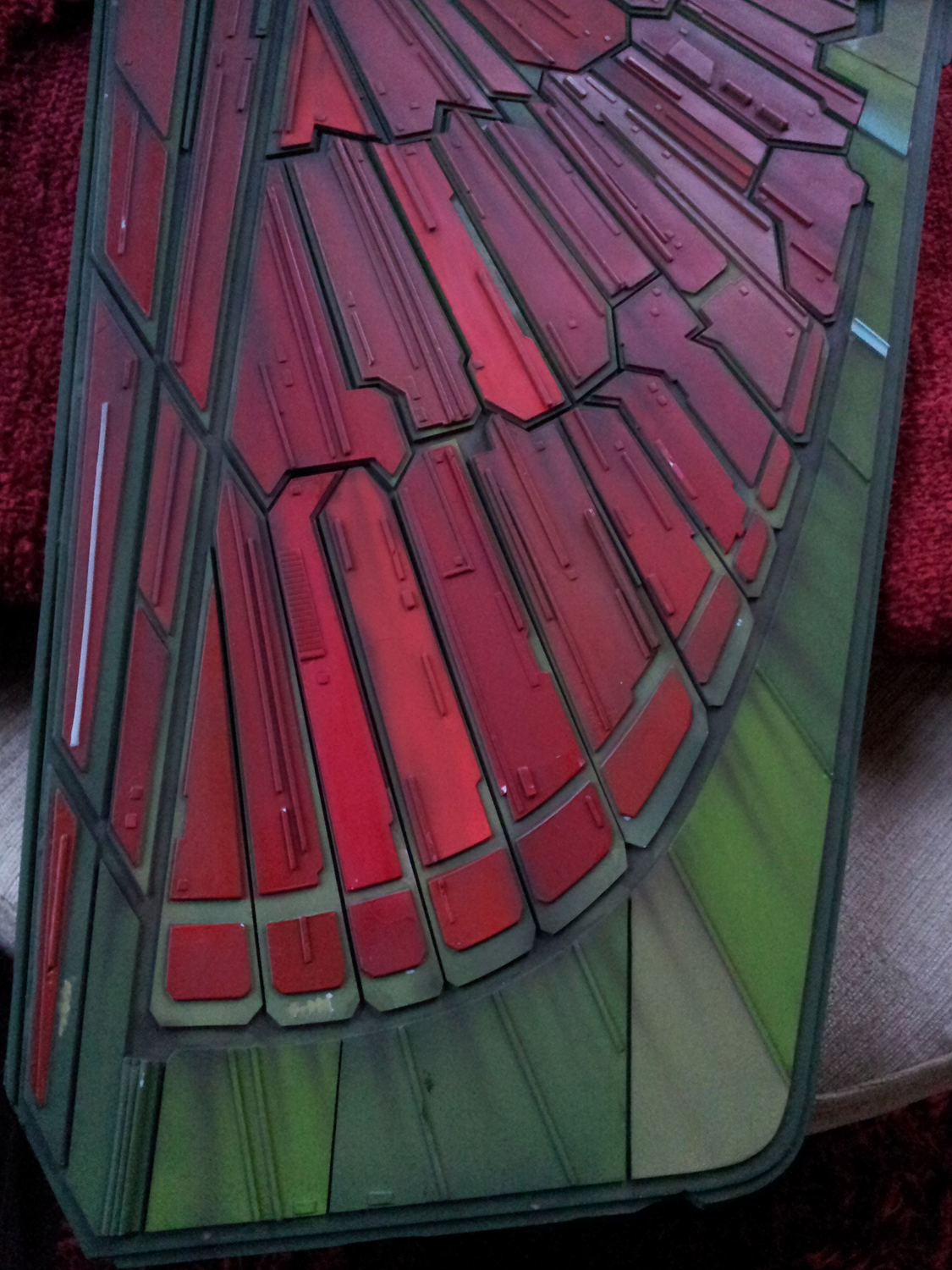

Today I worked on the decals, slightly resized and cut into separate letters so as to miss most of the relief details on the wing, as the film I have seems to be a little thick to mould over them nicely. All sealed up and ready for a matt clearcoat tomorrow.

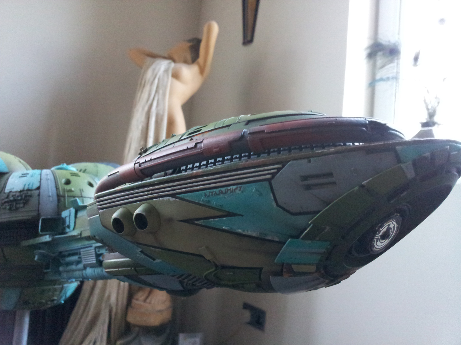

Then I decided the best way to get a grip on the weathering on this beauty was to try and replicate the head as best I could, as it has a lot of reference to work with, and doing it gives me a good idea how to freestyle the sections of the model where needed. So I've been doing more colour detailing with whites, reds etc. Then I started to get onto the last but one stage of the weathering, covering the existing rust with a thin layer of airbrushed Dark brown and black mix again, slightly darker than the last pass and fully masked off to pick out the detailing again which can end to get a little lost under each freehand pass over the model. All the streaks with this darker colour are masked off individually, then faded down from top to bottom. The resulting faded line is then hit with a freehand airbrush to thicken the top of the streak and give a more graphic feel. This gives a much sharper look and you can make some insanely thin streaks using this method. A must for a falcon build. Then some chipping to the panels based on the reference material so I don't over do it. rust detail again with a slightly different colour. blah blah .
so now im happier with the head and im always carefull that im not getting fixated on one area for to long, its time to move rearwards on the model. So im now building up the weathering on he rear of eh head and the neck section with paint chips etc.
