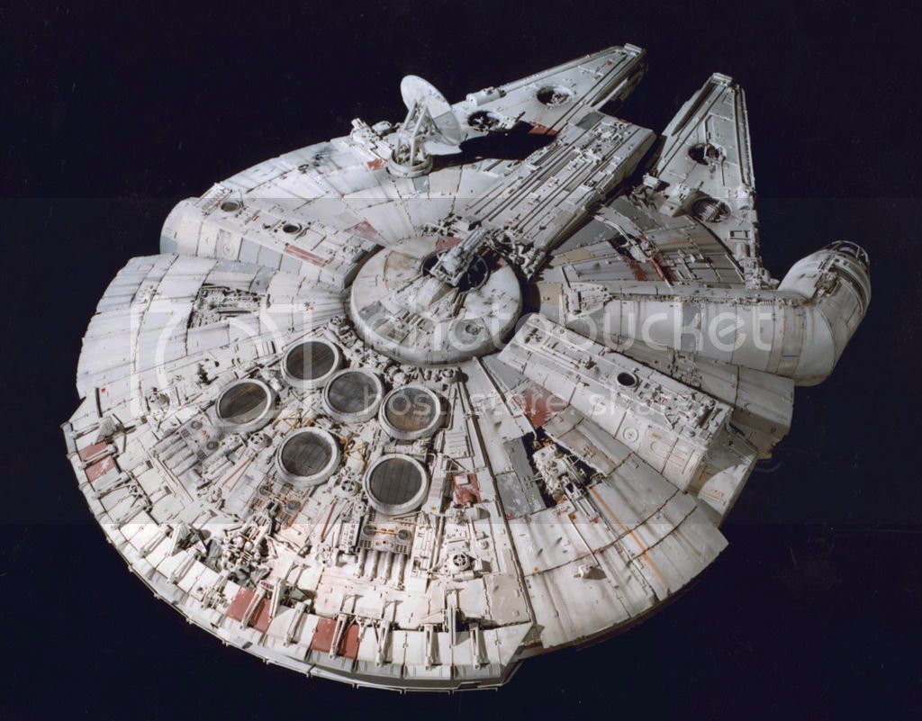

I have the image bellow of the original 32" If you zoom in you can see the position of the grey areas. Seems to be the same as the master replicas version.
Yep! I've gone for that after hours of search...took stills from SW & ESB etc... Even the movies have slight variations depending on model used... The greys run off right to the edge for instance.. & it has much more greebie details on the 5ft'er but not going down that road...it's the 32" after all.
Great pictures, yes think that might be yours further up l put on of the full back radar!?. It's just that the grey strips are the wrong way round on the 5ft judging from the movie still frames on SW & ESB.!!!
I think that the way to Dish rotates and flips could lead to either configuration of the stripes with the dish facing forward.
Maybe the dish got flipped in some shots and rotated and flipped the opposite way in others?
Yep the promo photos of the Falcon in ANH of the front of the dish show weathering & blast marks that are upside down on her now
Also this was the model used in the shot of Lando ripping the dish off In RotJ
J

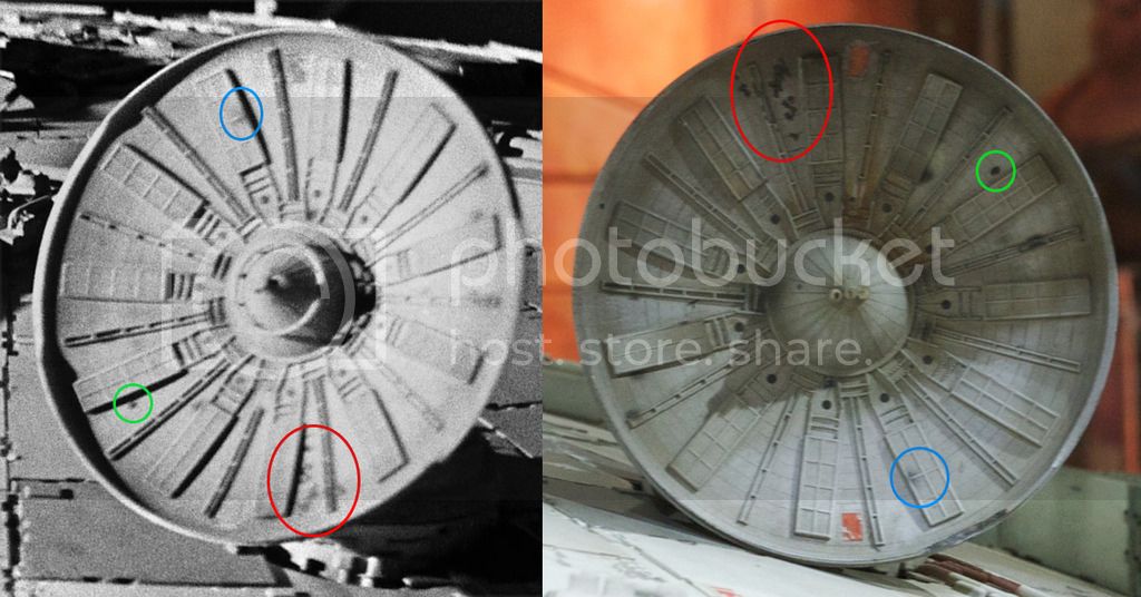

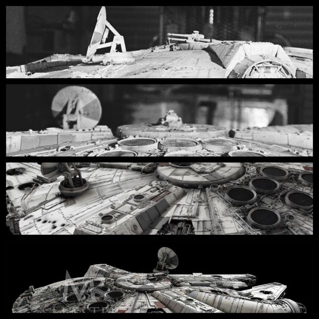

The radar details do differ loads

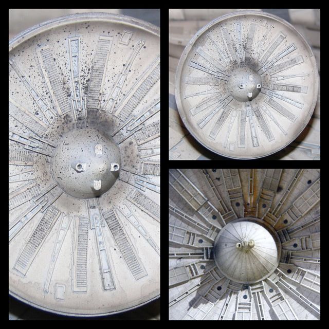

TOP two are from Steves MR version and so we have that in our Deago build.
BOTTOM right: the 5ft'ers details all completely different in pattern,cone etc...
Below:
1&2: STUDIO
3&4 MR MODEL. Images from Dropbox: Copyright to there respective owners.(sorry couldn't find names).

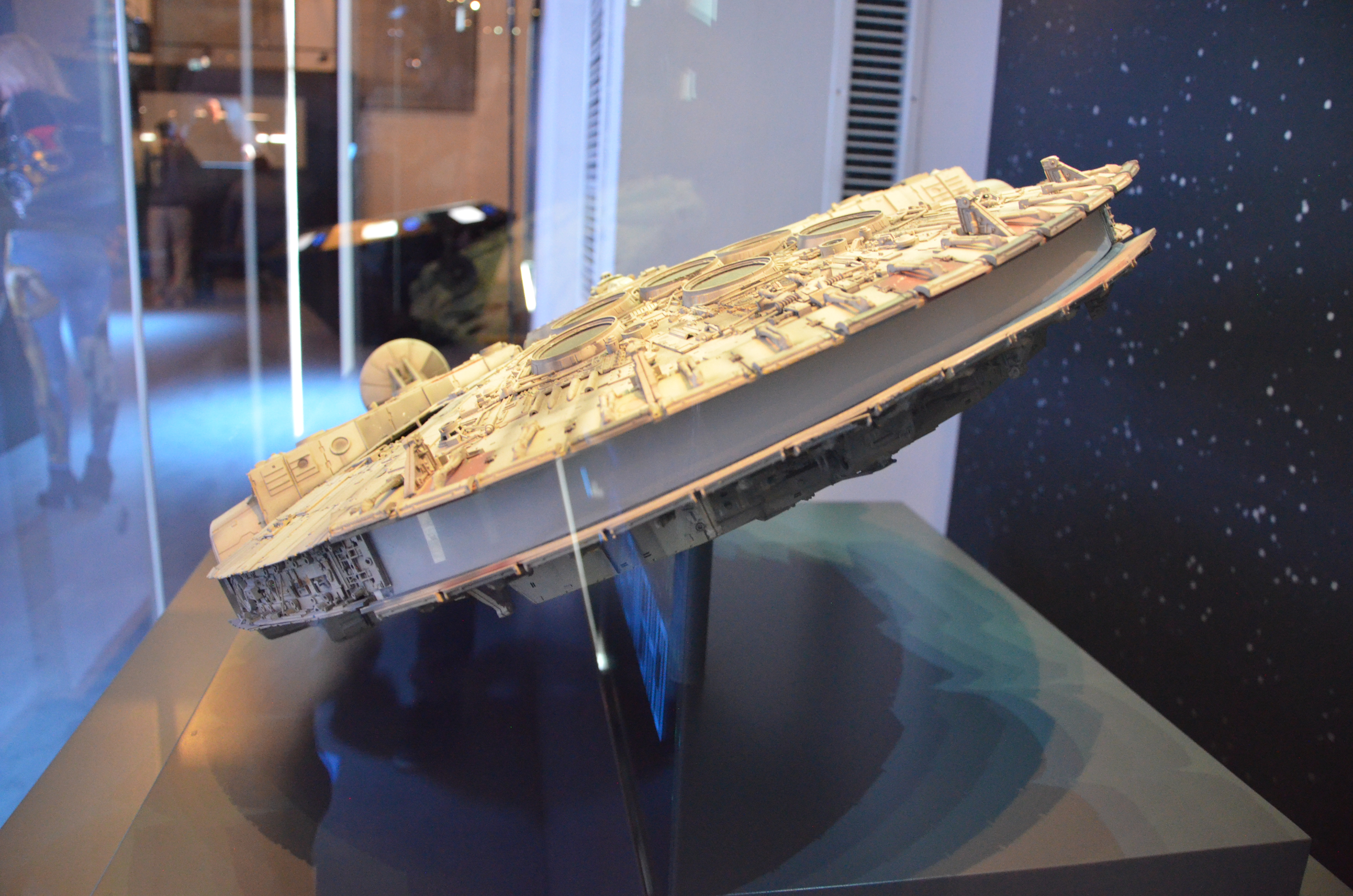

Yep the differences are massive,..the model makers really only had to get a general impression because the 32" version was made out of necessity,.....a much lighter, highly detailed model was needed to do the more dynamic shots,....it's a stunt model,...standing in for the 5 footer,...to do the fast motion shots.
The differences were hardly seen in the films because they were disguised by motion blur

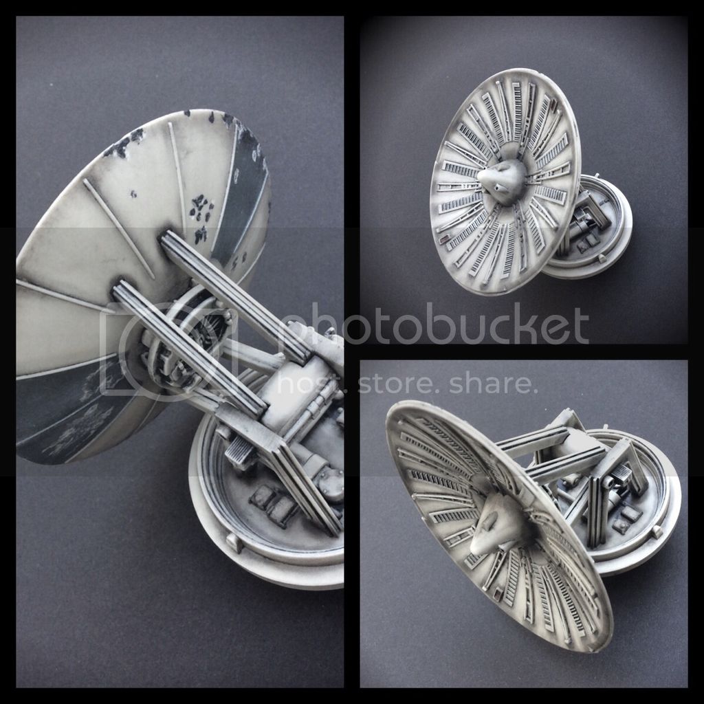

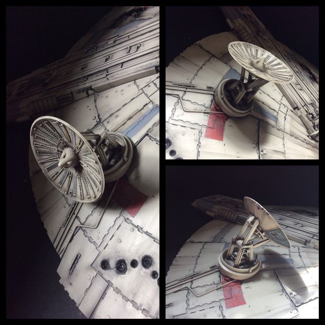

@Here's my Radar with the best of research... May detail more the base area.
Above & below the dish turned & rotated.

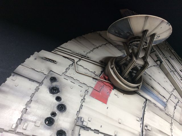

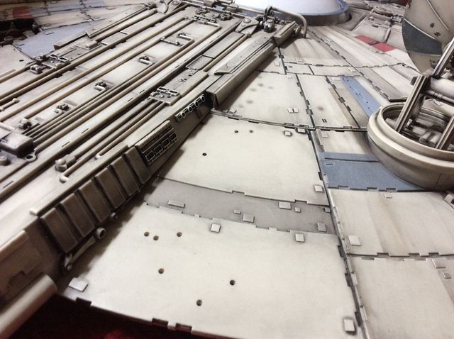

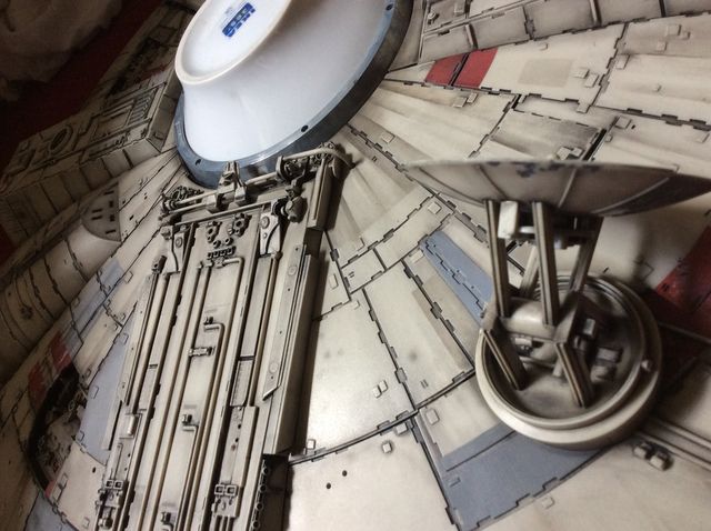

Just adding this picture....

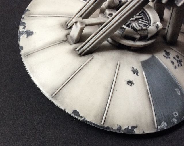

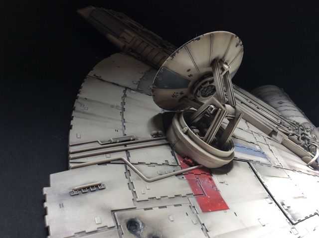

Below: For me l used my Dremel very very carefully then with l micro brush added the dark areas...
