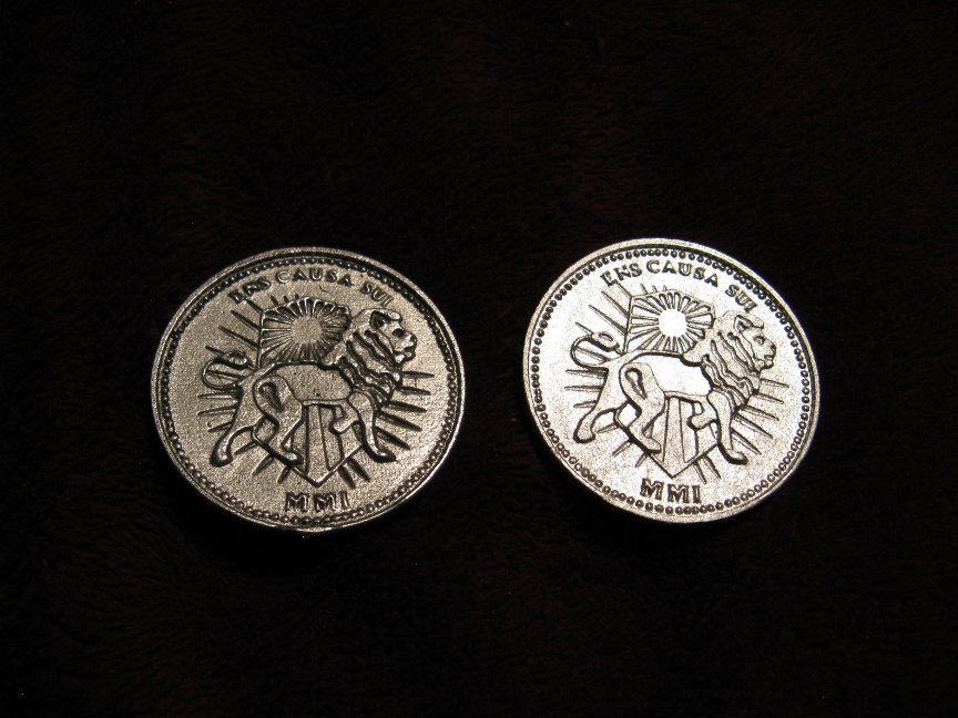

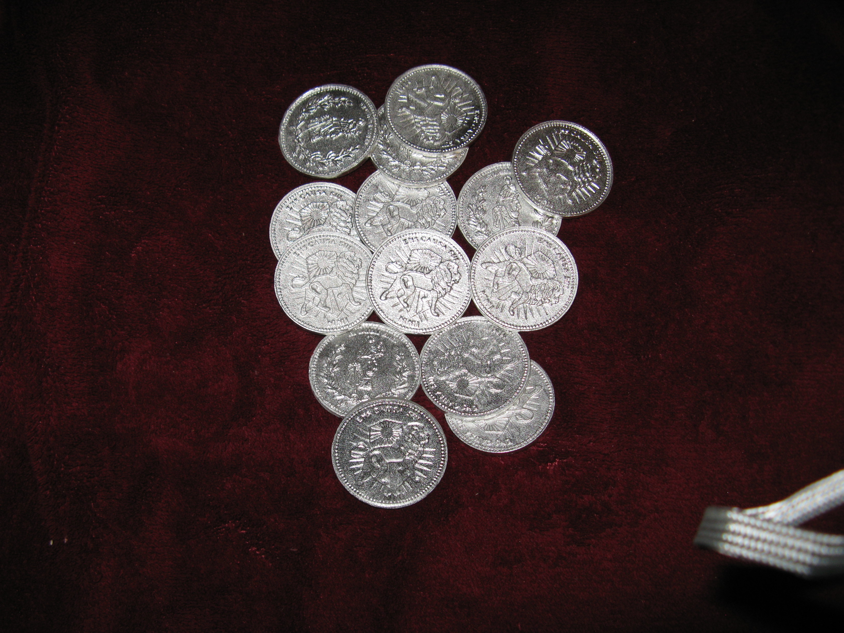

i finished the molds and started casting.
out of 250 hand casted coins only 25 were usable>
i'd have one side turn out perfect and the other side would be garbage so getting both sides to read was a chore!
then did a polish test

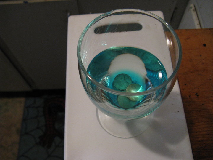

now making my own copper sulfate to start plate testing
blue layer is the copper being removed from the old pennies

Holy crap they look amazing! At least that many turned out, could have been worse I suppose lol. Can't wait to check out the gold version!

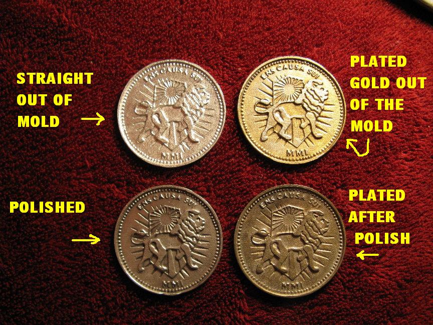

i tried plating a coin straight out of the mold and another one that was polished:
it looks as though plating pewter is going to be as hard as i heard it was.
the gold reacted with the polish on the polished one and made it muddy.......it came out better plating it straight out of the mold.
while surfing around the net i found that i have to plate it in copper first then in nickel then in gold to get that look we are trying for.
so basically i'm " macgyvering it ".....i already made a batch of copper acetate out of old pennies. and now i'm in the process of making nickel acetate
out of canadian nickels because they are 99.9% nickel from 1955-1981....all old american nickels are 75% copper and 25% nickel.
