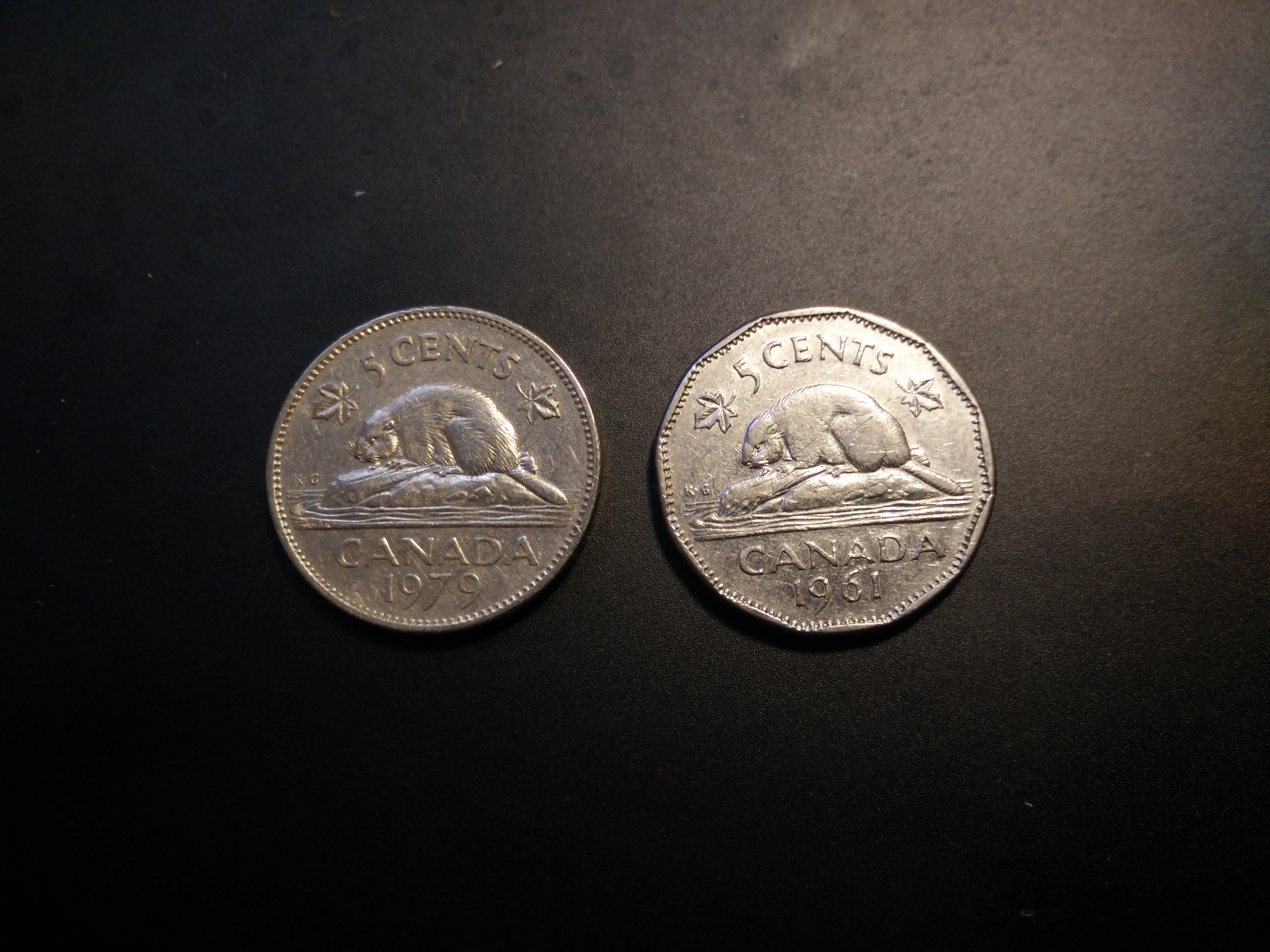

and actually thebigbang914 i live in the usa and would love to hook up with a few more canadian nickels Pre-1981...i only have 3 that i'm working with right now.

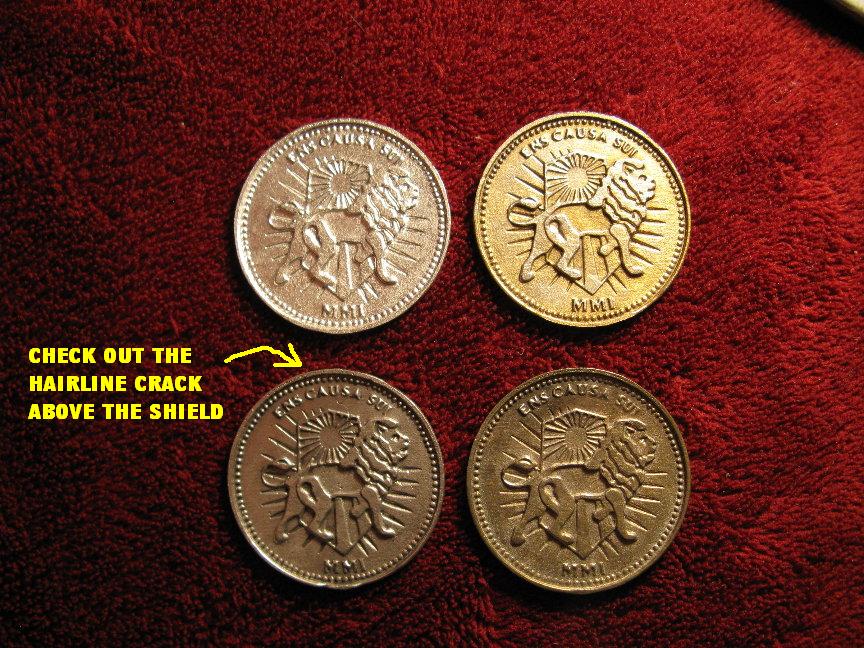

i hand pour each one of these so they all have little imperfections ....some have little pit marks some have dings going around the band on the out side from having uneven metal from the pours.
if you look at this picture you can see a hairline crack above the shield and below the letters on the top:
right now i'm just working on getting the gold to look the way i want .....aging it will be easy after that :D

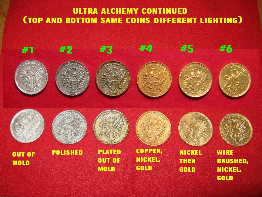

slowly but surely the work continues.
my lighting for the pictures has sucked due to taking pictures in my kitchen under a 45w bulb...hopefully one day when it stops raining i'll try some outside shots to get true color. on the latest test i used a wire brush on a dremel to shine up the pewter pre nickel plate...and wow did it make a difference!
i want to try another way of getting a thicker nickel plate and then do the gold and see if i can pull off a polish. i'm starting to think that if i ever do get around to selling some of these off ....all the money will go to some professional plating equipment, then i could do a second new and improved run and use it to help people out in the junkyard.
I live in Canada and I have a couple of those nickels that I'm willing to ship over.
awesome keep saving them up...i'll let you know if i need them!

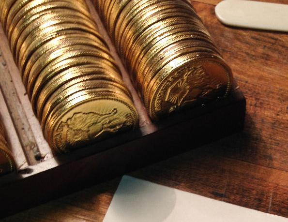

i've been checking out pistol cases and trying to figure out how to gut one so that you have a gun on one side and a stack or two of coins on the other.
or make the little wooden coin holder from the movie:
got this from a friend that took the pic on the wick set!
