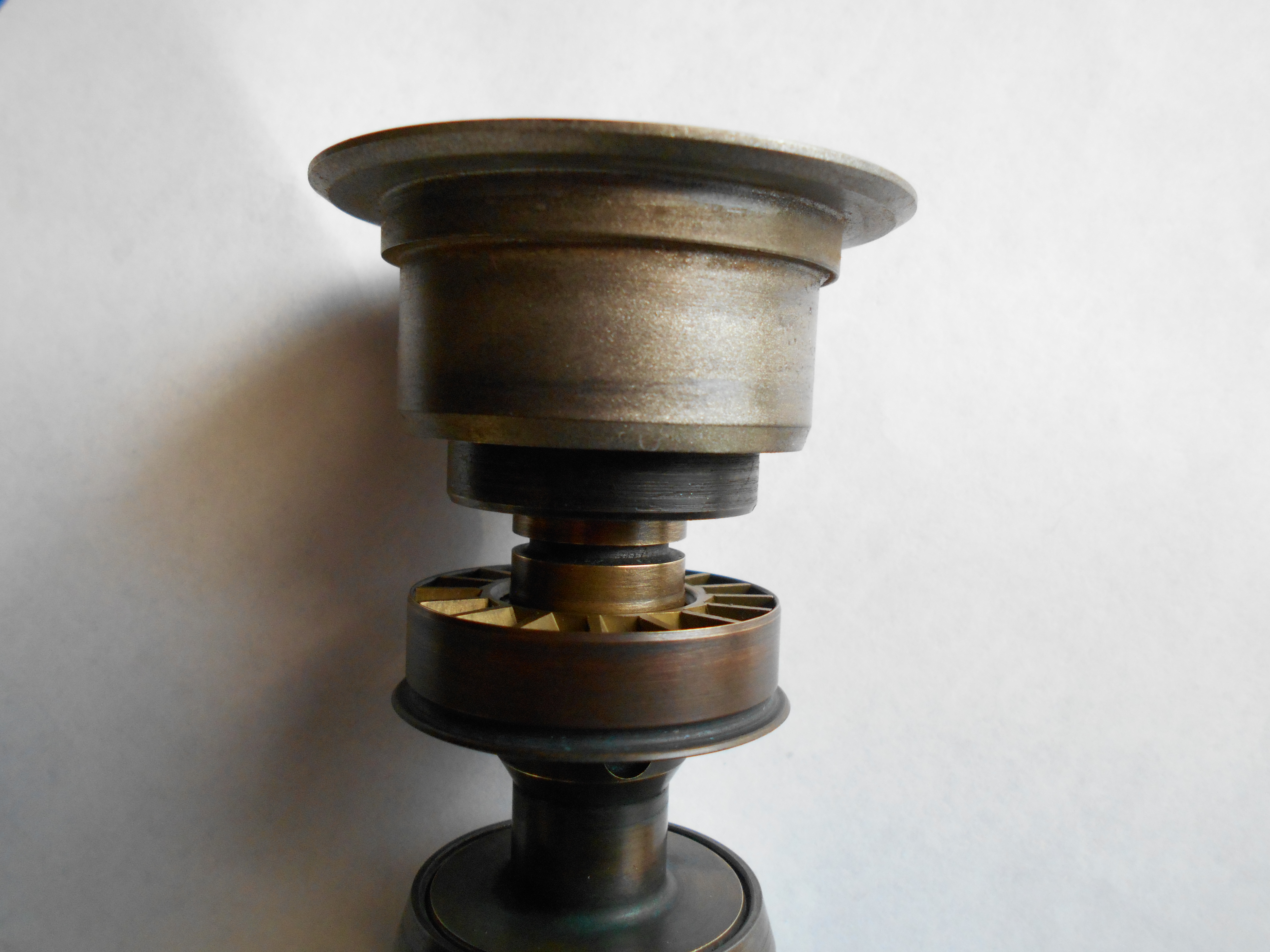

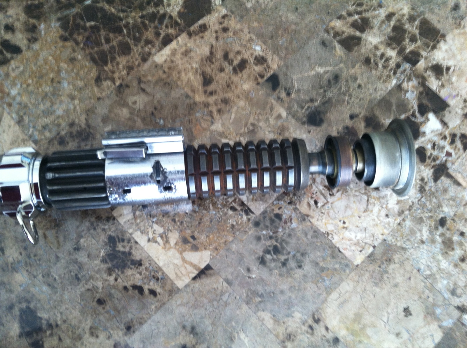

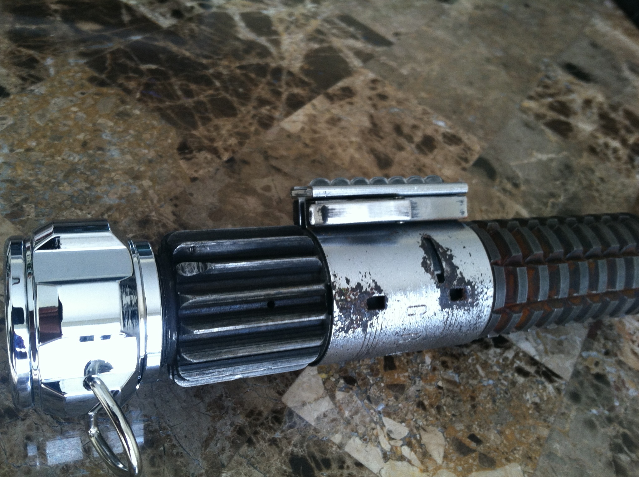

This saber has a mind of it's own, I can't stop messing with it. LOL I wanted a more authentic looking weathering on my emitter. Though it doesn't look like the prop, it looks more true to the Inconel found on balance pipes. I etched the steel with vinegar, salt and a 9volt battery. This gave me a matte finish on the BP to weather. I like the way it turned out, my cam phone doesn't capture it very well.
Is that a REAL booster? The Balance pipe looks good :)
So . . . how does that salt, vinegar and 9 Volt solution work exactly? Could you describe the process step by step, please? I still have a replica emitter to finish someday and I really like the look and feel of yours :)

Hi Chaim. Thanks for the compliments. I read online about how to do this. You need some white vinegar mixed with regular table salt. There no real formula, but I used 2-3 oz of vinegar and probably a tablespoon of salt. Use wires and alligator clips to connect the positive and neg on the 9v batter. Use one to ground onto the metal you are etching and the other to hold a cotton swab that you have dipped into the solution. I did a few passes over the whole outer sleeve. This produced a finish close to what I wanted. Then I had to use a lot of heat, flames etc to weather it, then I left it in a rusty fire pit for a few hours. We had rain the other day and the fire pit likes to fill up with rusty water. THis helped me get the look I wanted. One thing to note. The finish is more of a blasted look. I tested the method on another piece of steel and it produced a softer smooth finish. I weathered this one so many times prior to this using the oven, scorching it with flames that the outer finish is different and even closer to what I desired.
Here's a close up of my result. Honestly at one point, I thought I'd messed it up and would need to use steel wool to start over. All of the previous weathering has made this BP a bear to work with. It was difficult to take the weathering and the steel wool I hit it with did nothing. I'm done now as I think all of the heat and other weathering really had an affect on it.
