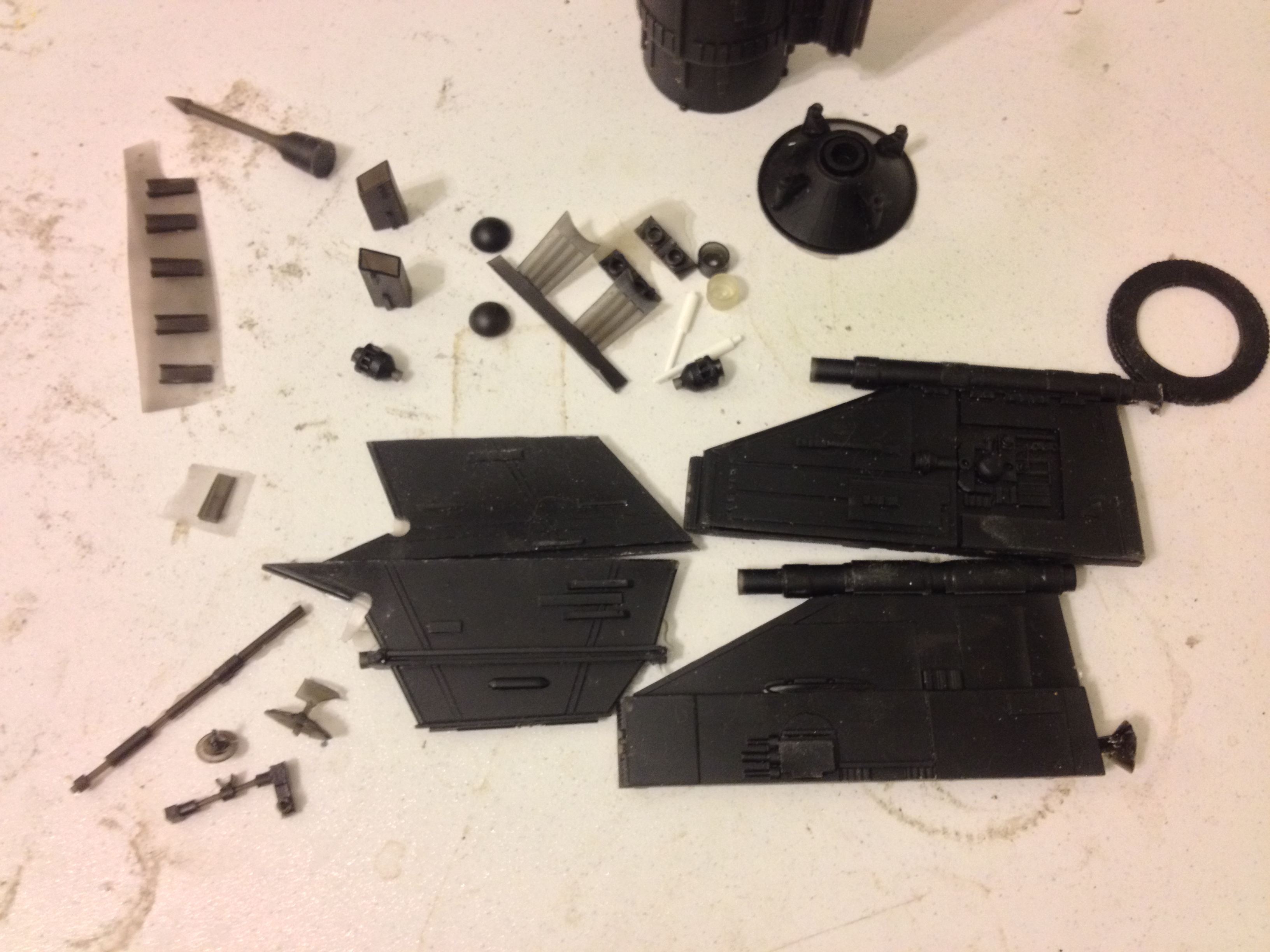

Here are the parts: hull, 4 wings, various greebles, front spike, rear engine and the antenna array.

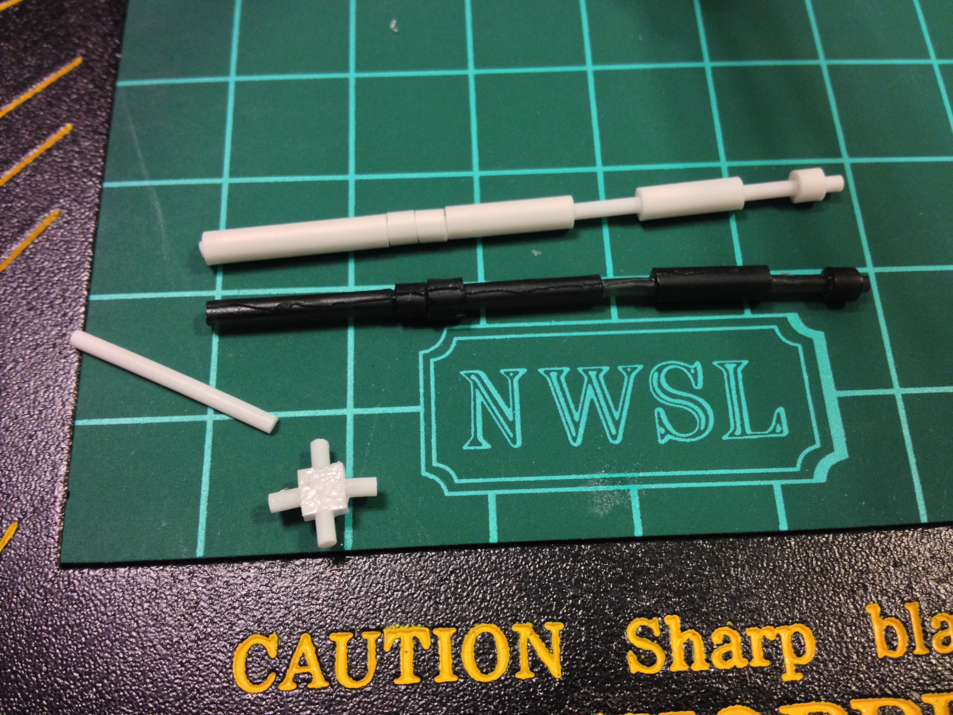

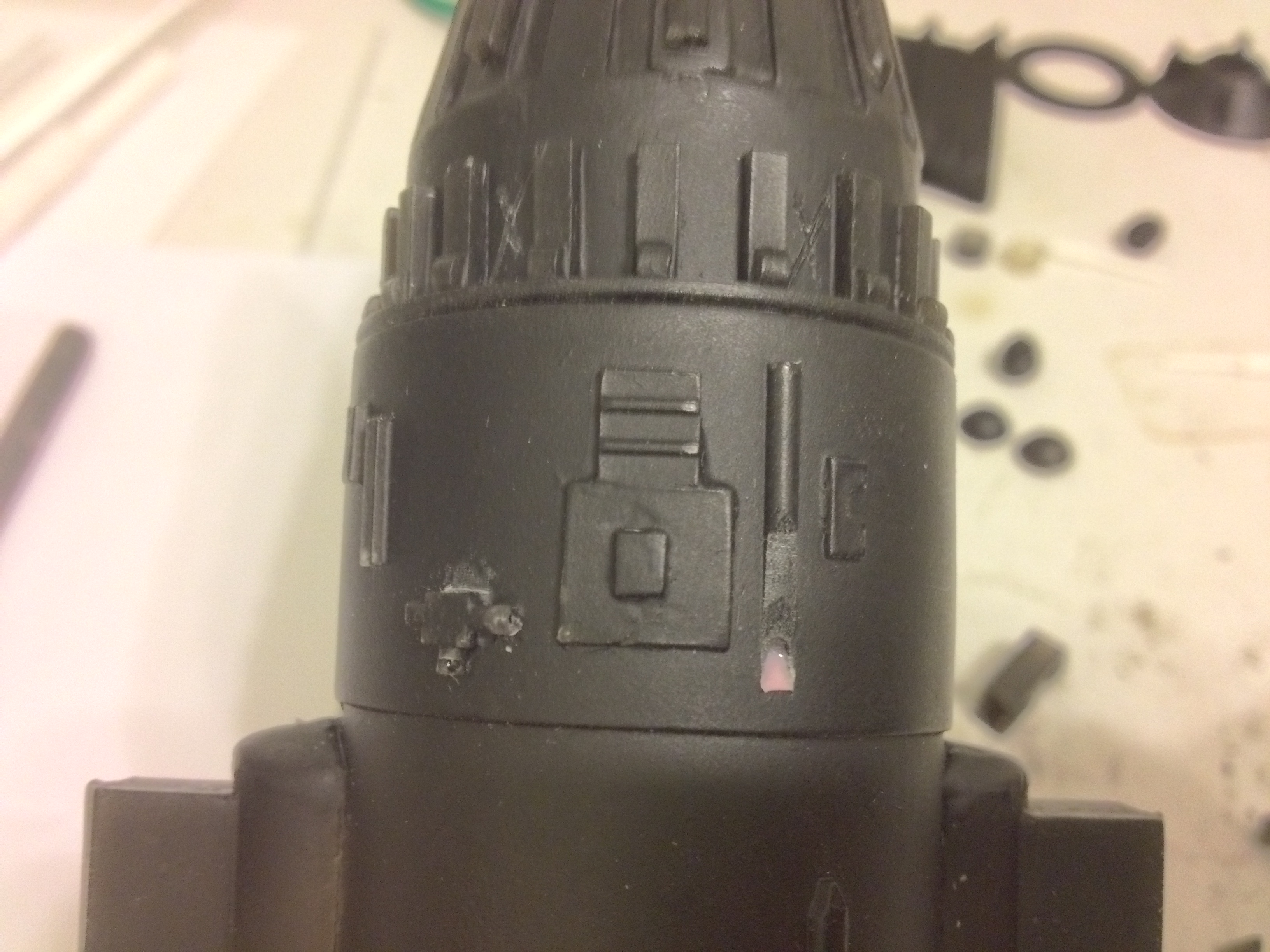

First, the kit. Just the usual cleanup. I sliced off 1 misshapen strip from the hull, easily replaced by strip. I also removed the molded on "space 1999 eagle thruster” (conspicuously mounted on the hull) which was also deformed, too delicate for resin. I quickly scratched a new one with sheet & rod but it will be one of the last things I add, as it protrudes from the ship and is bright white. I also replaced the main antennae with small plastic rods for a cleaner look.
Next step, gluing on some parts (there aren't many) and surface filling/prep.

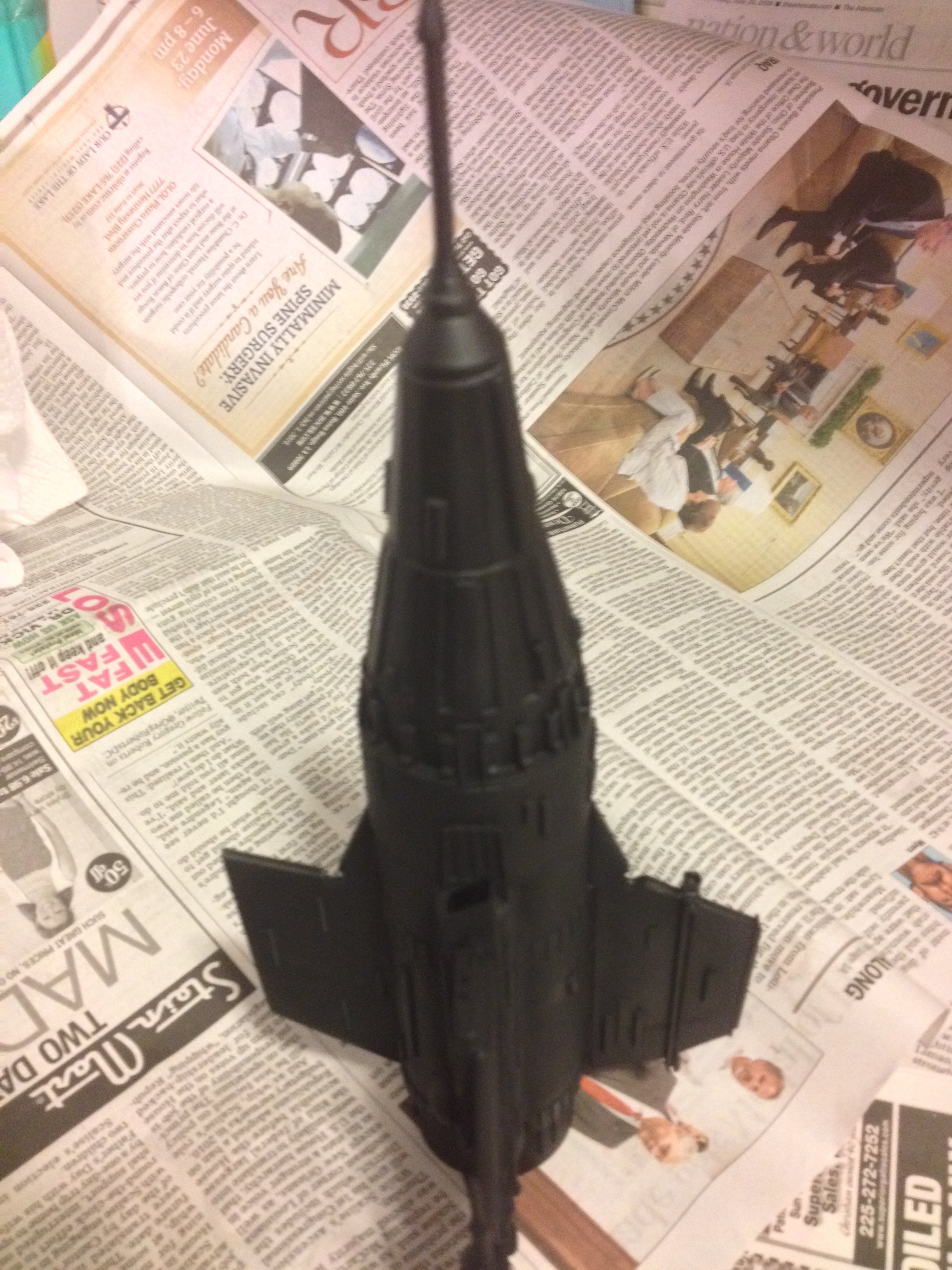

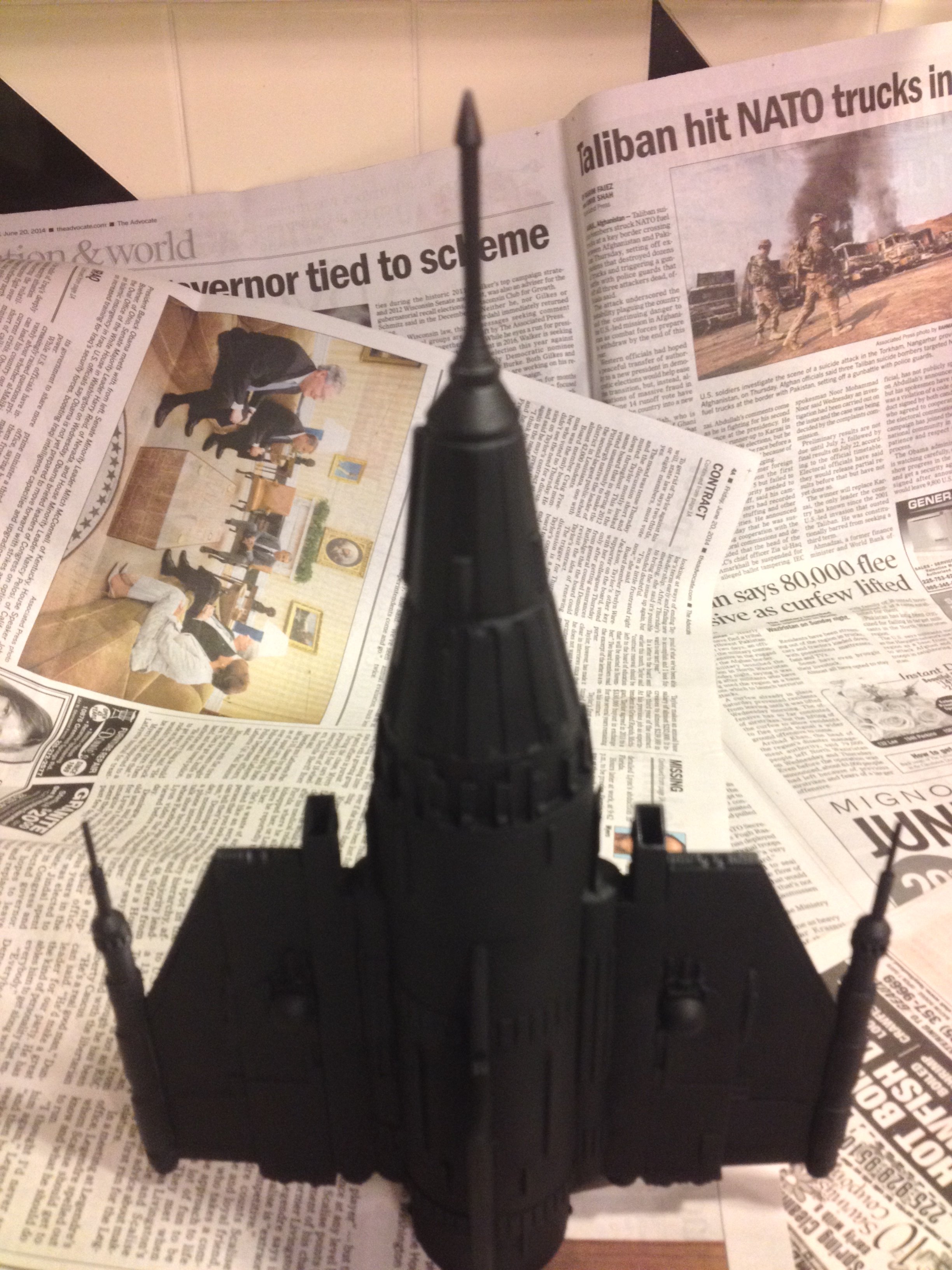

I've primed the model and painted it a flat black.
The entire paint scheme should be blotchy, faded shades of dull red/maroon, with various dull orange patches/panels throughout. The black undercoat should help with this and help the panel lines stand out a bit

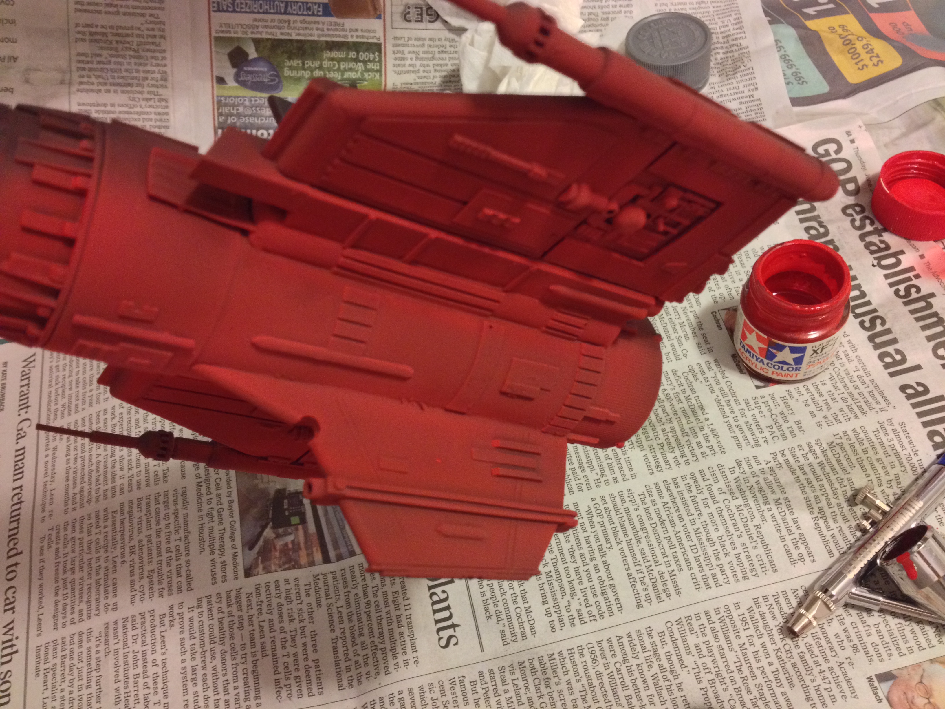

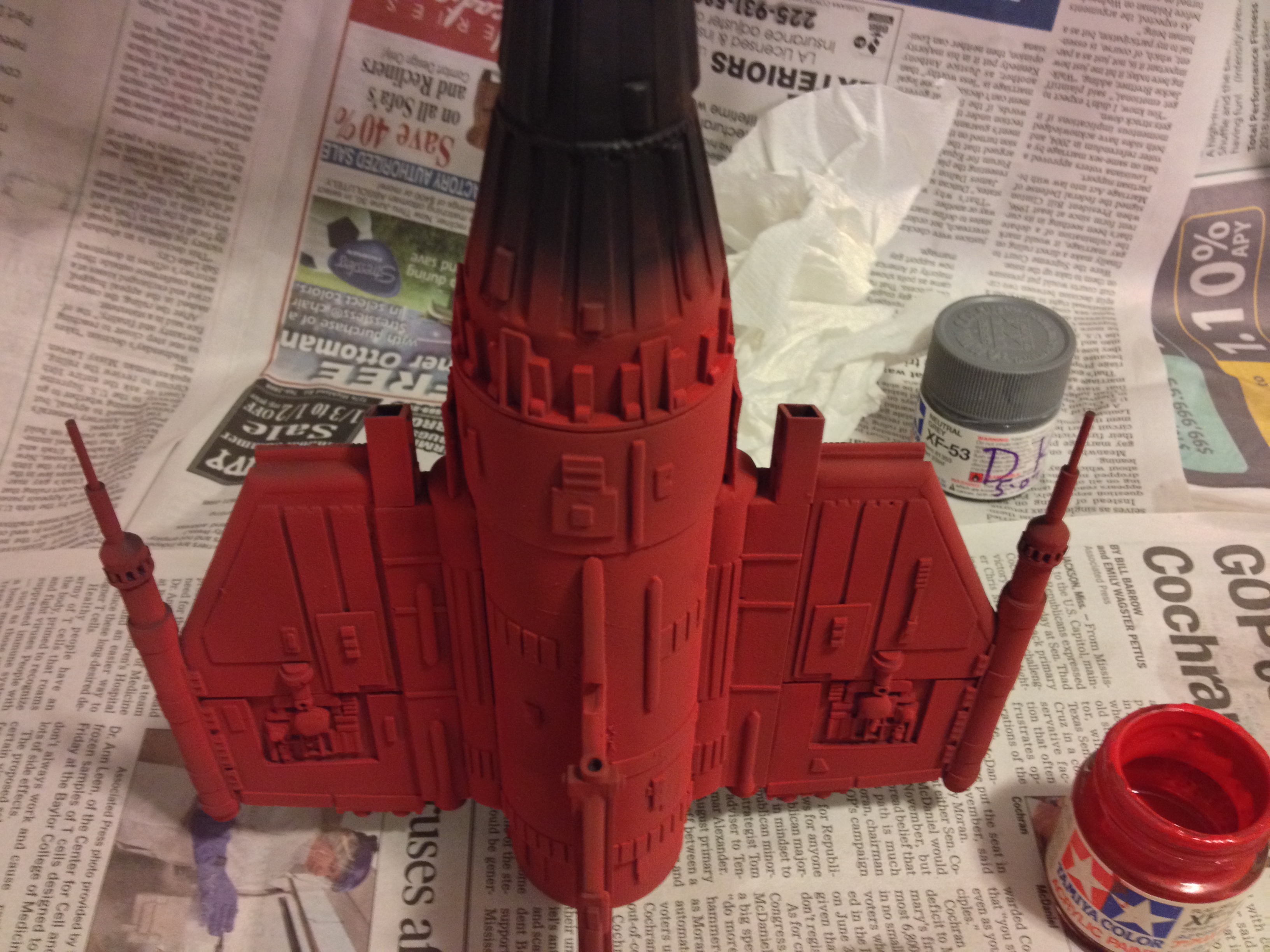

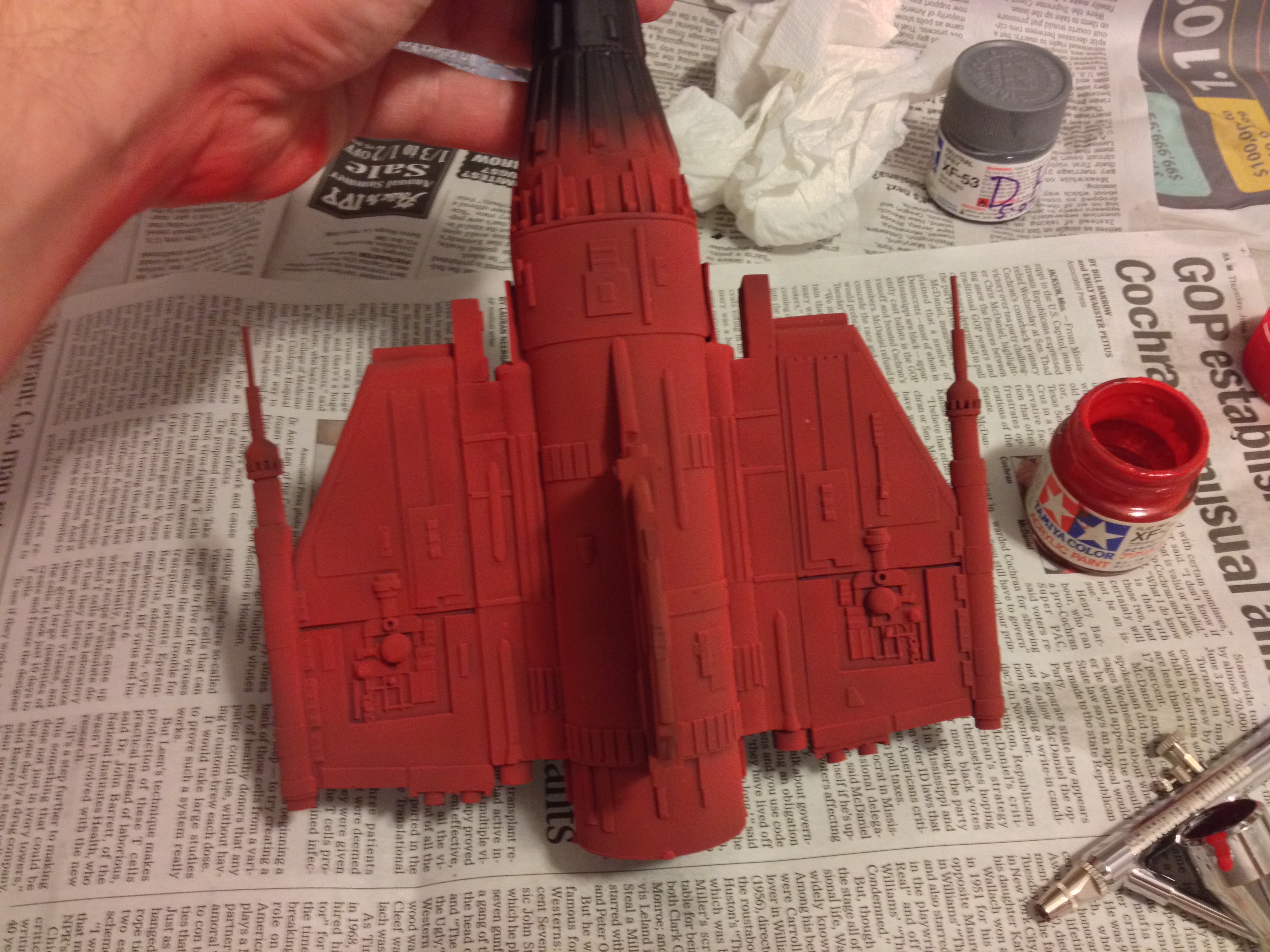

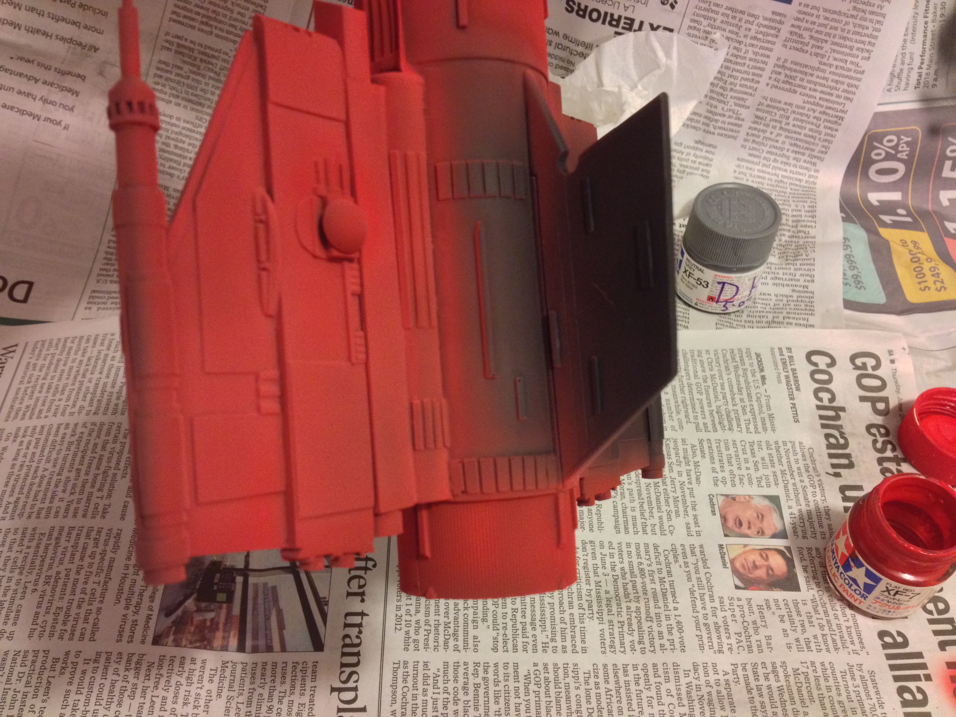

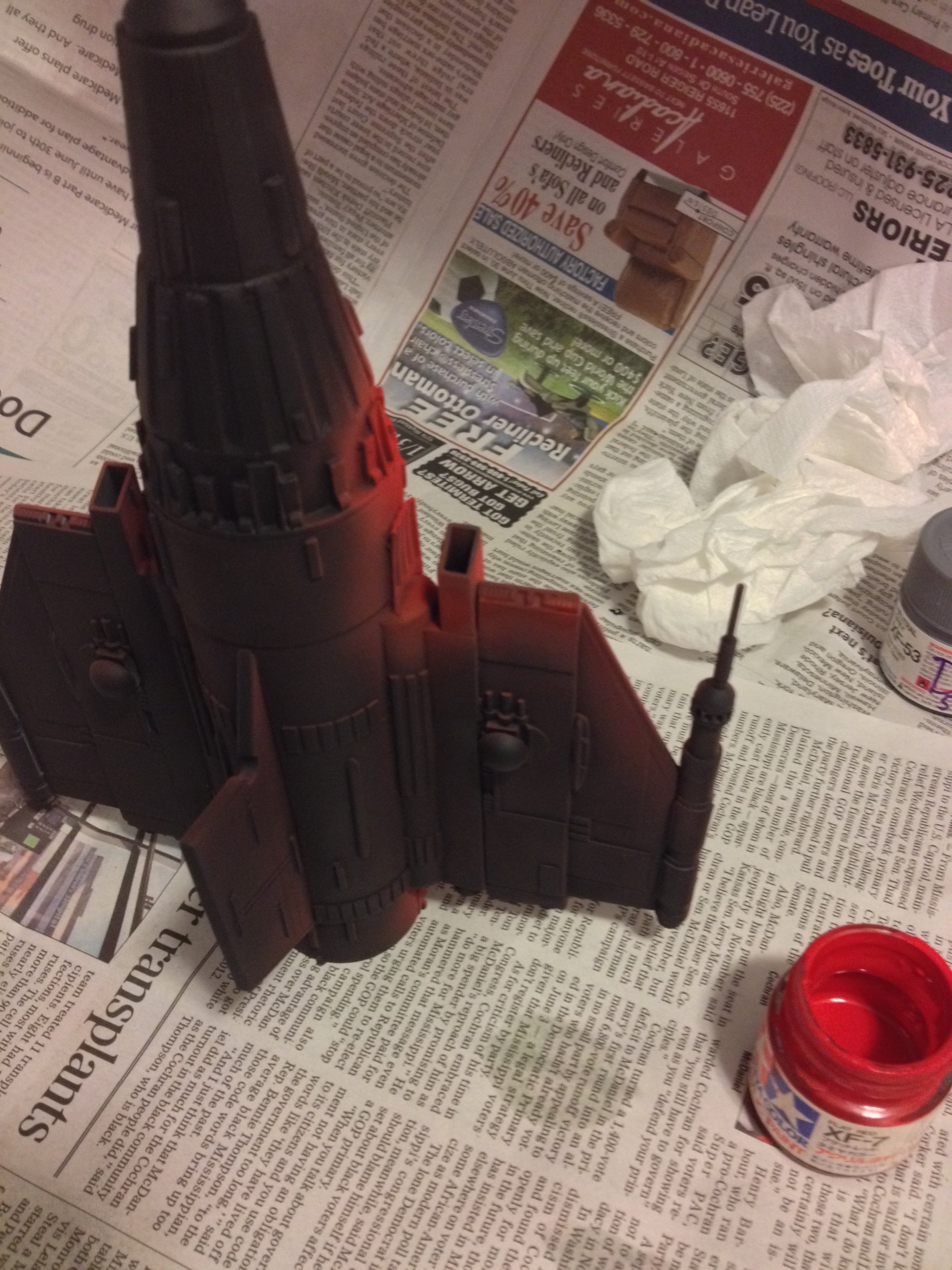

I've also started airbrushing the red paint.
I'm giving it a basic coat of flat red by Tamiya, a good generic dull red color.
Its a nice, generic flat red. I'm trying not to make the coat completely even -- It needs to be "faded" a bit in various areas with the black undercoat showing through.

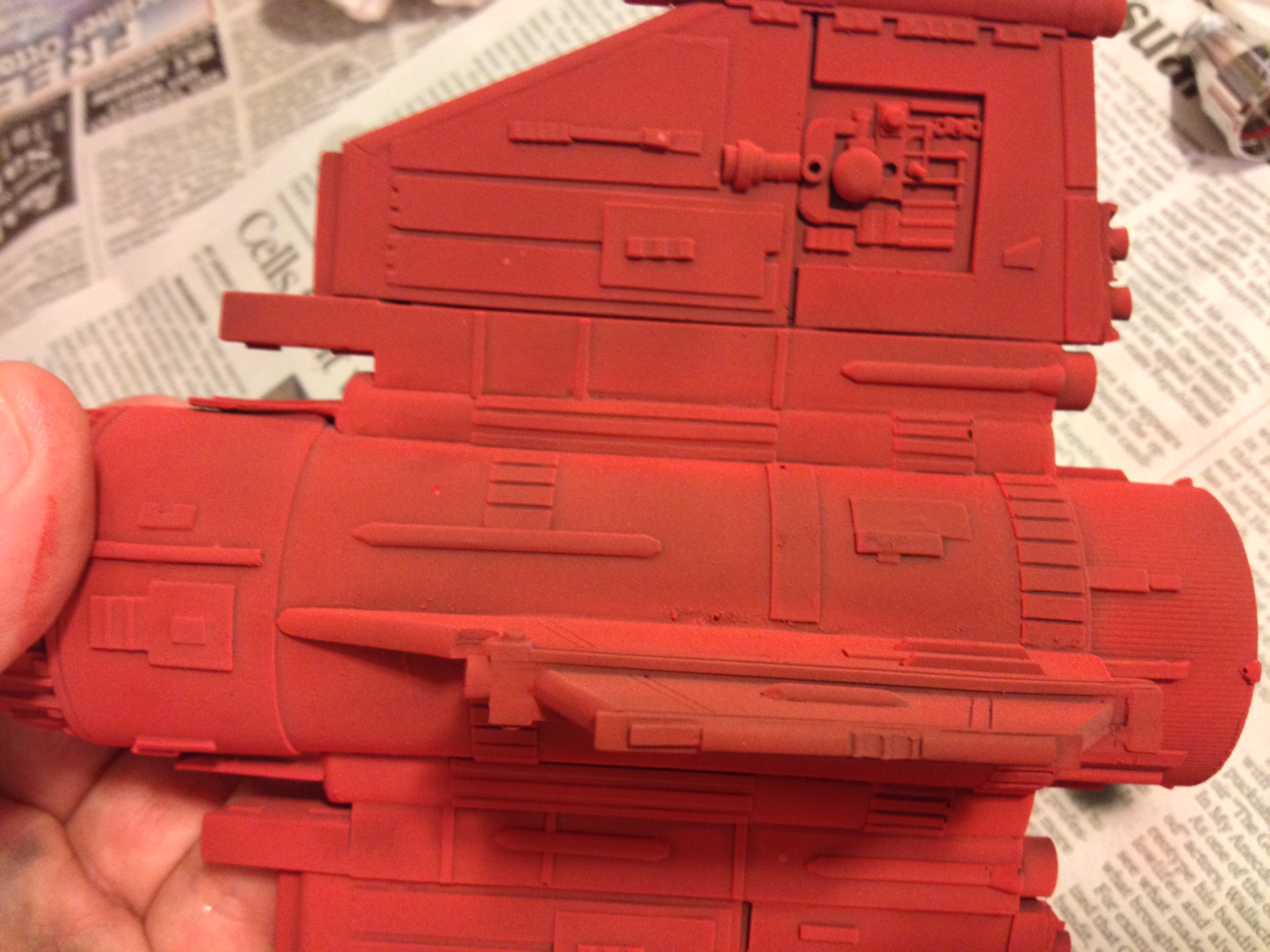

Got a few paint spatters, but the touch up with many maroon/orange panels will cover that later.

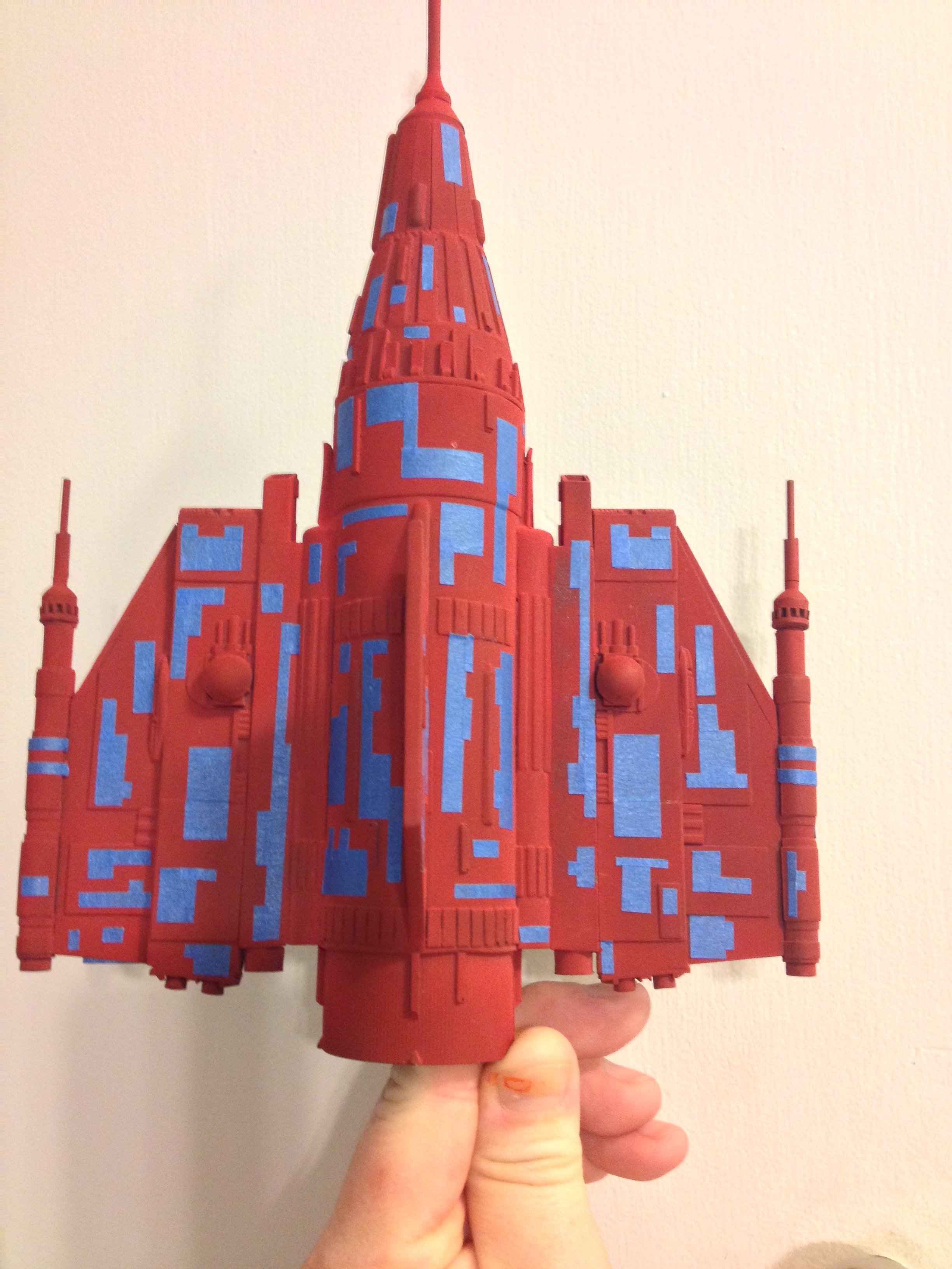

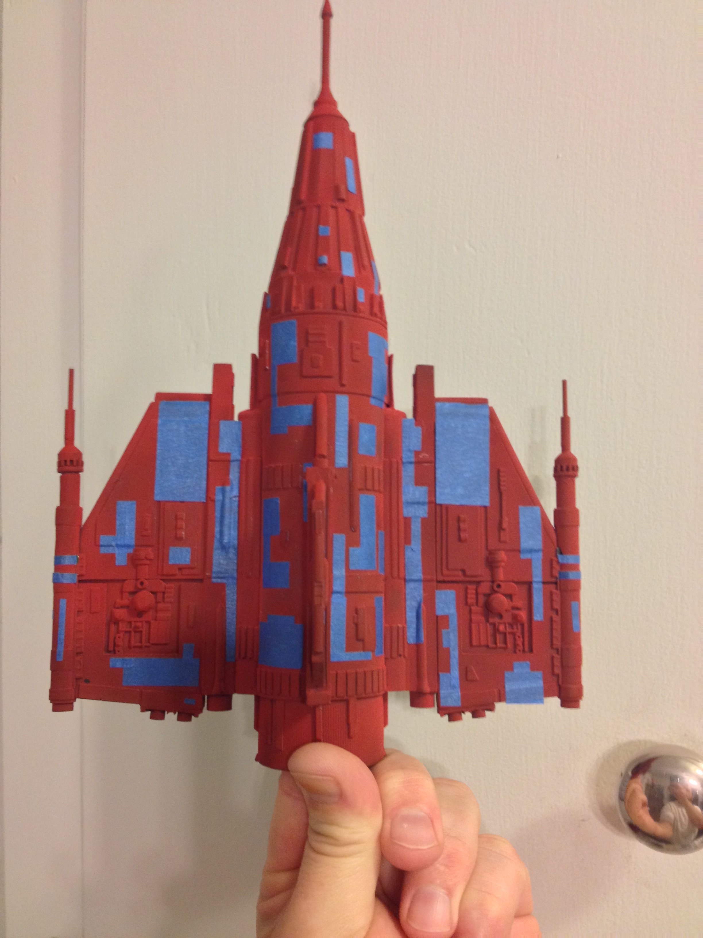

Now the fun begins. Looking at the prop and other photos, I cant seem to find a regular pattern for the various painted panels. The paint pattern" on the prop seems to seem mostly random (there are a few symmetrical bits/panels). Also, there was more than one prop, and they didn't match exactly. Soooo....time for artistic license.

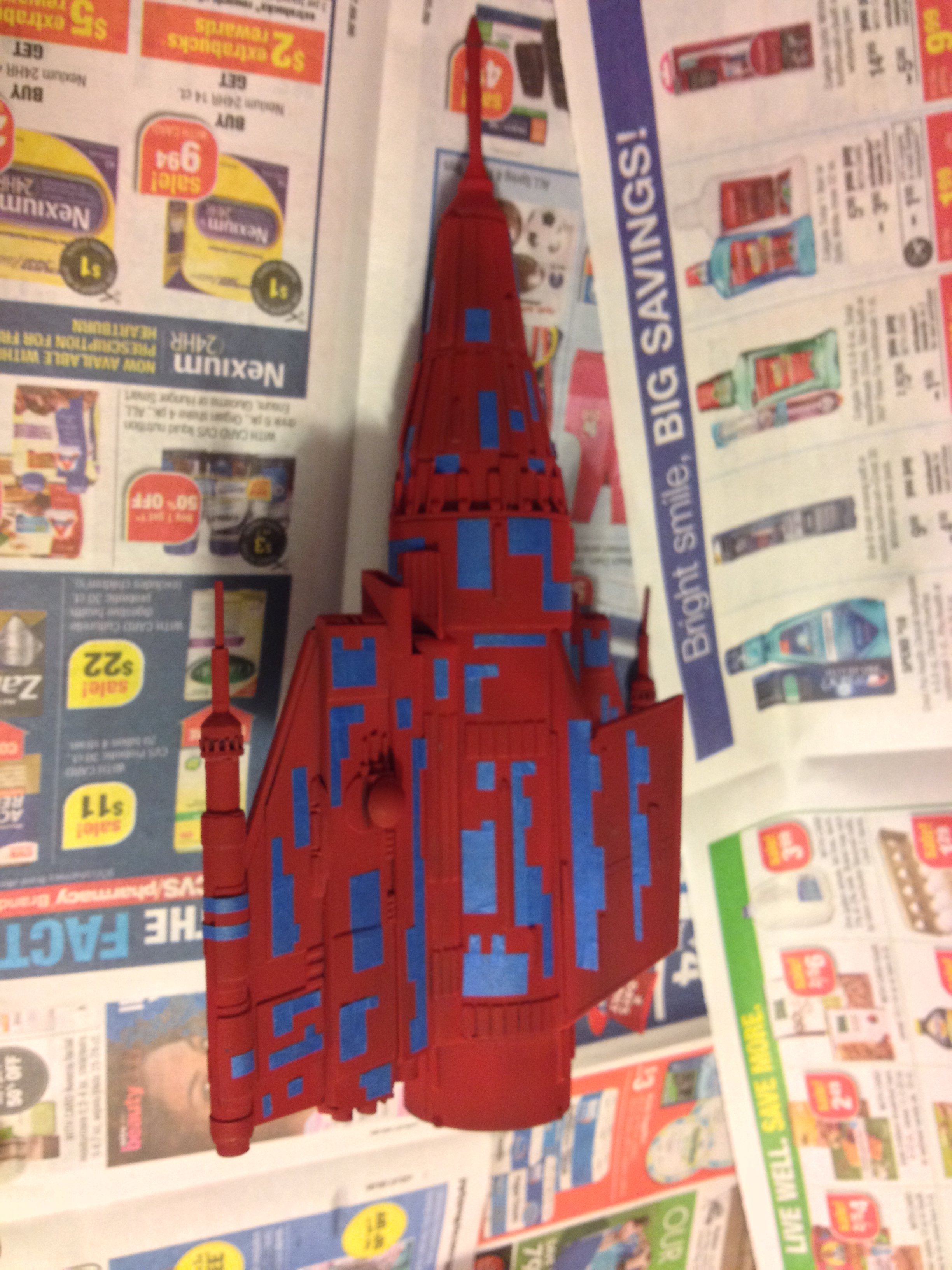

I've cut dozens of rectangular painters tape bits and put them in various places around the model.
I've mixed up 2 more batches of for the paint job. one is more red than orange.
And shot the whole model with the darker orange red. I've also mixed up a lighter/more orange version. Next step is to mask off some larger sections and shoot the remainder with that lighter orange red. The final paint job should be various faded orange/red hues and panels.

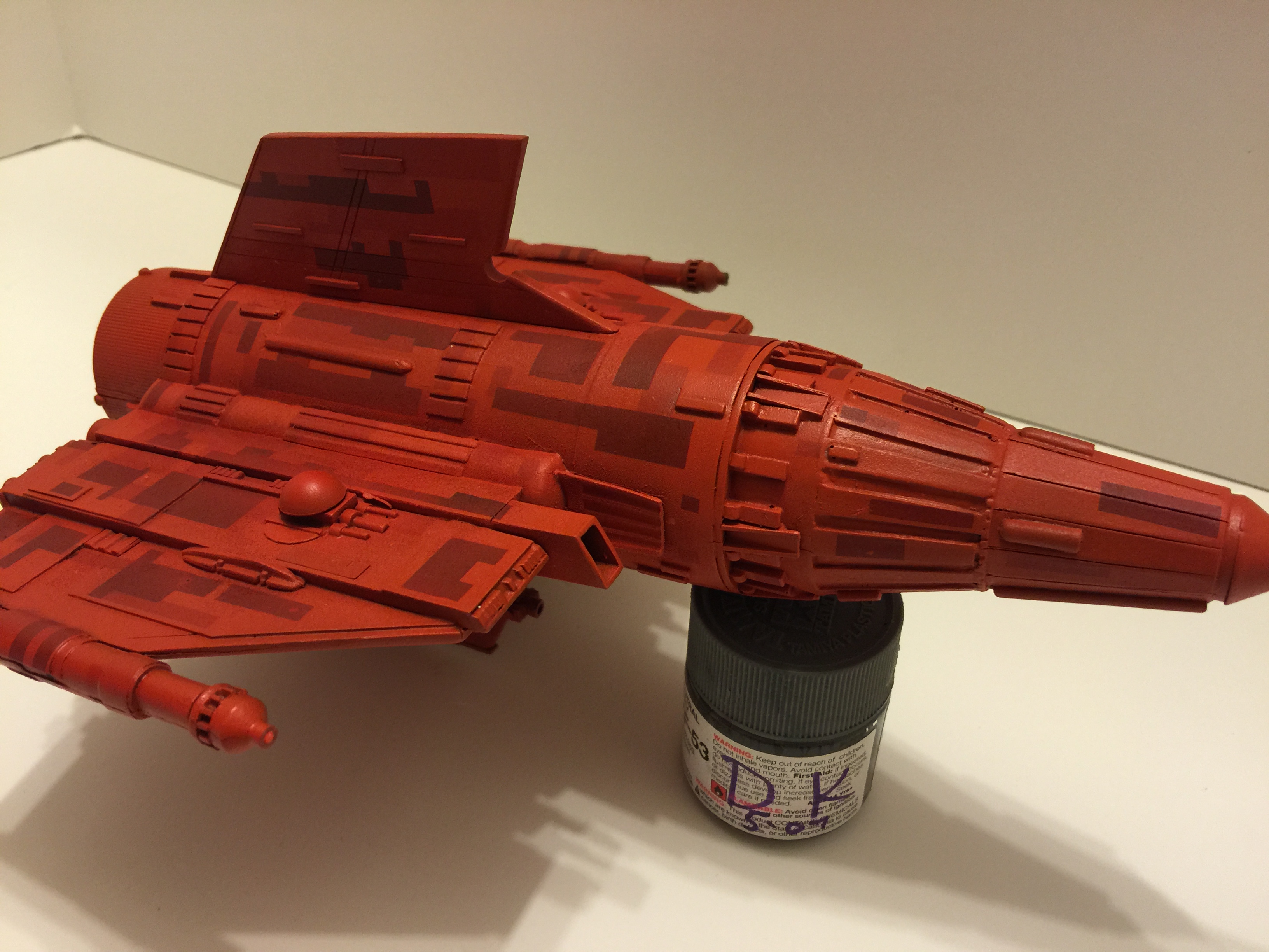

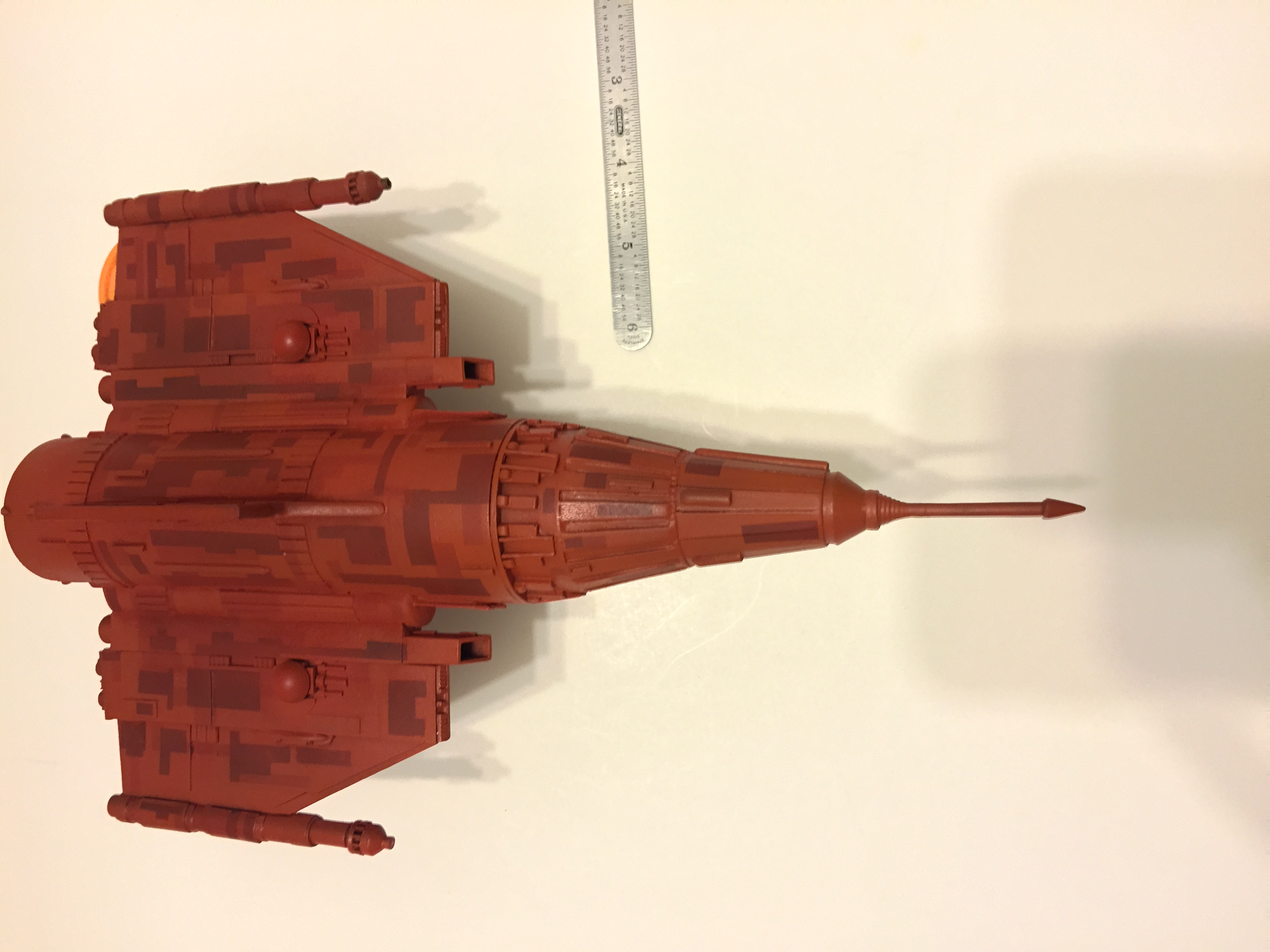

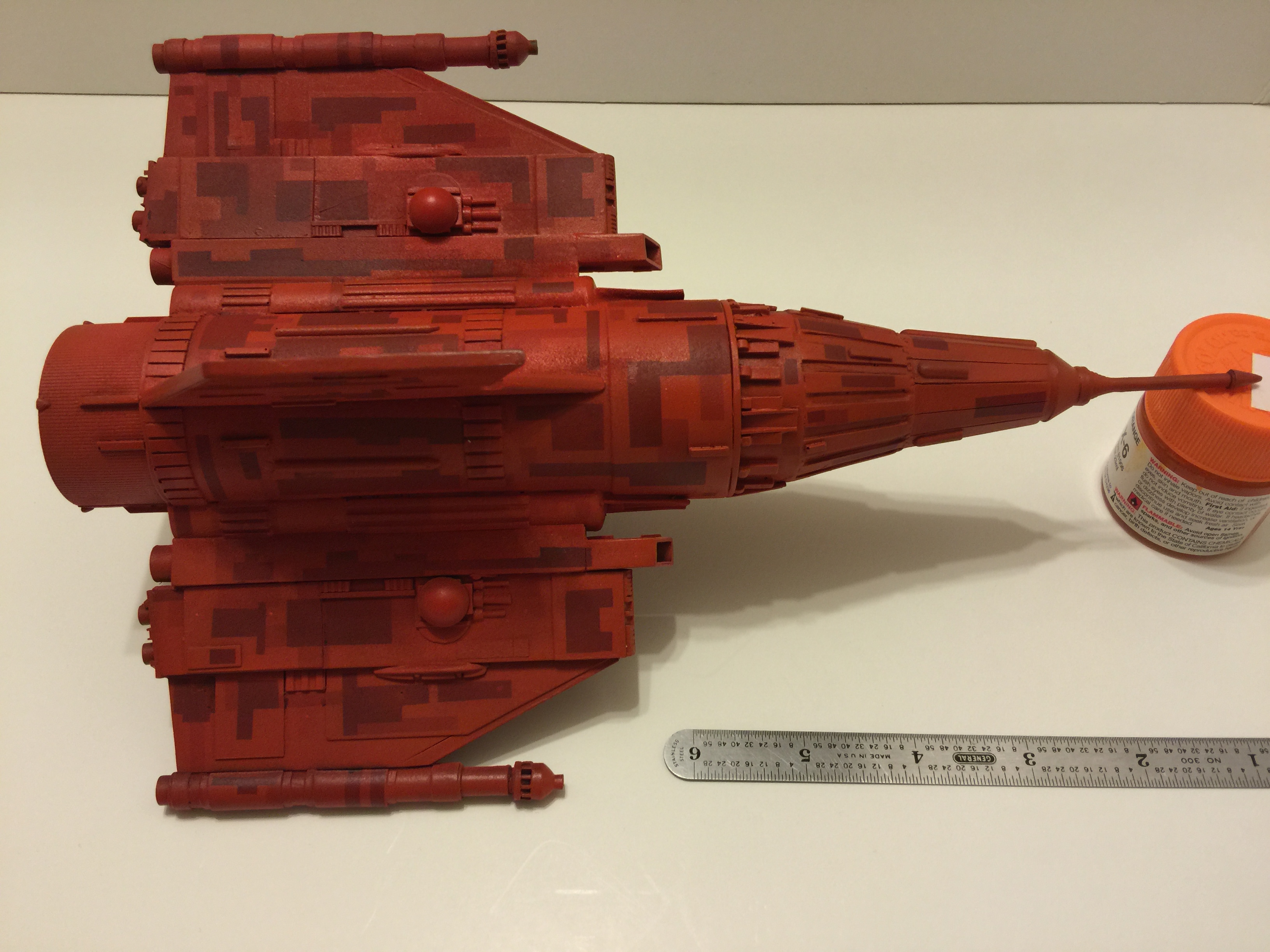

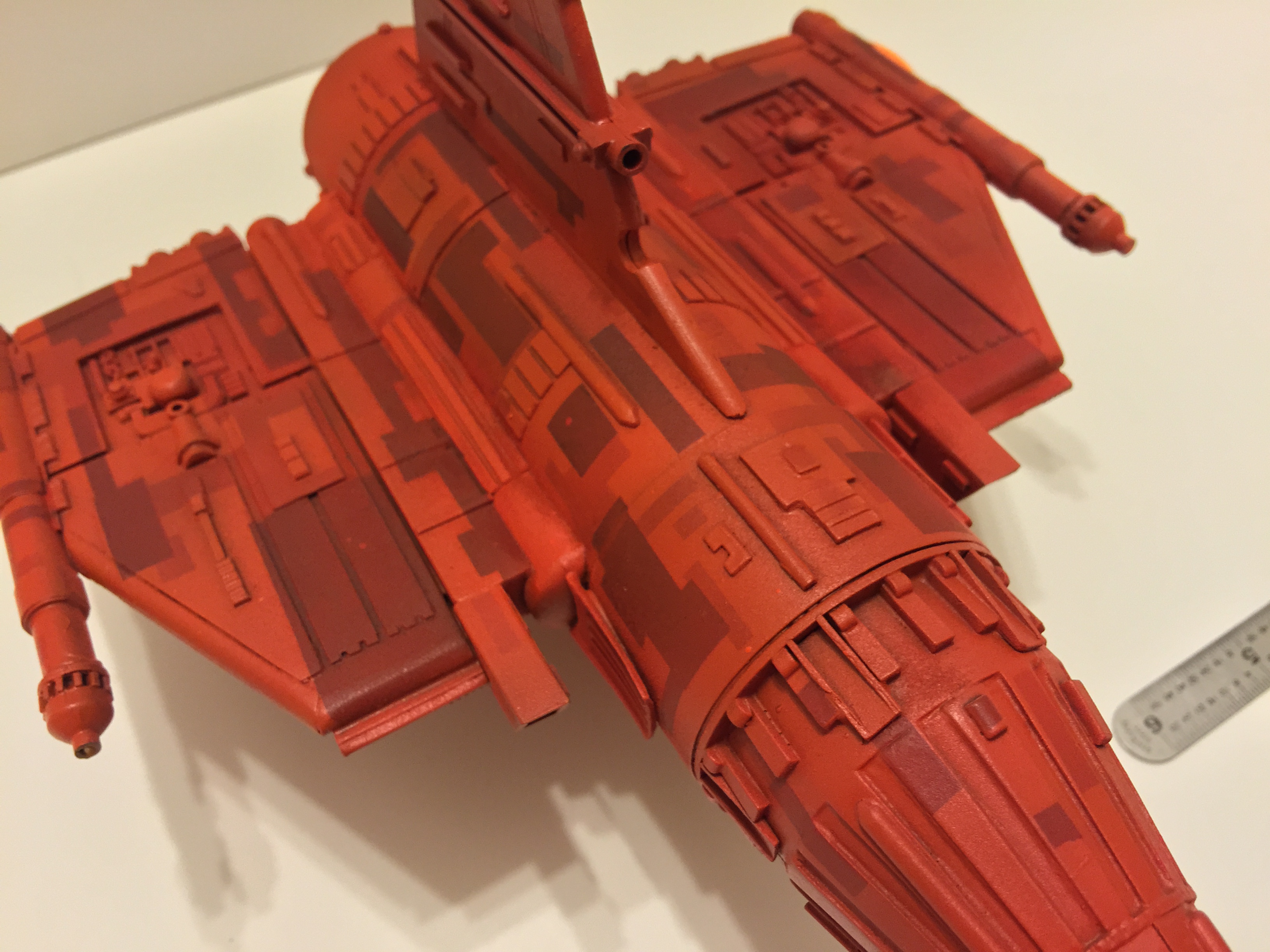

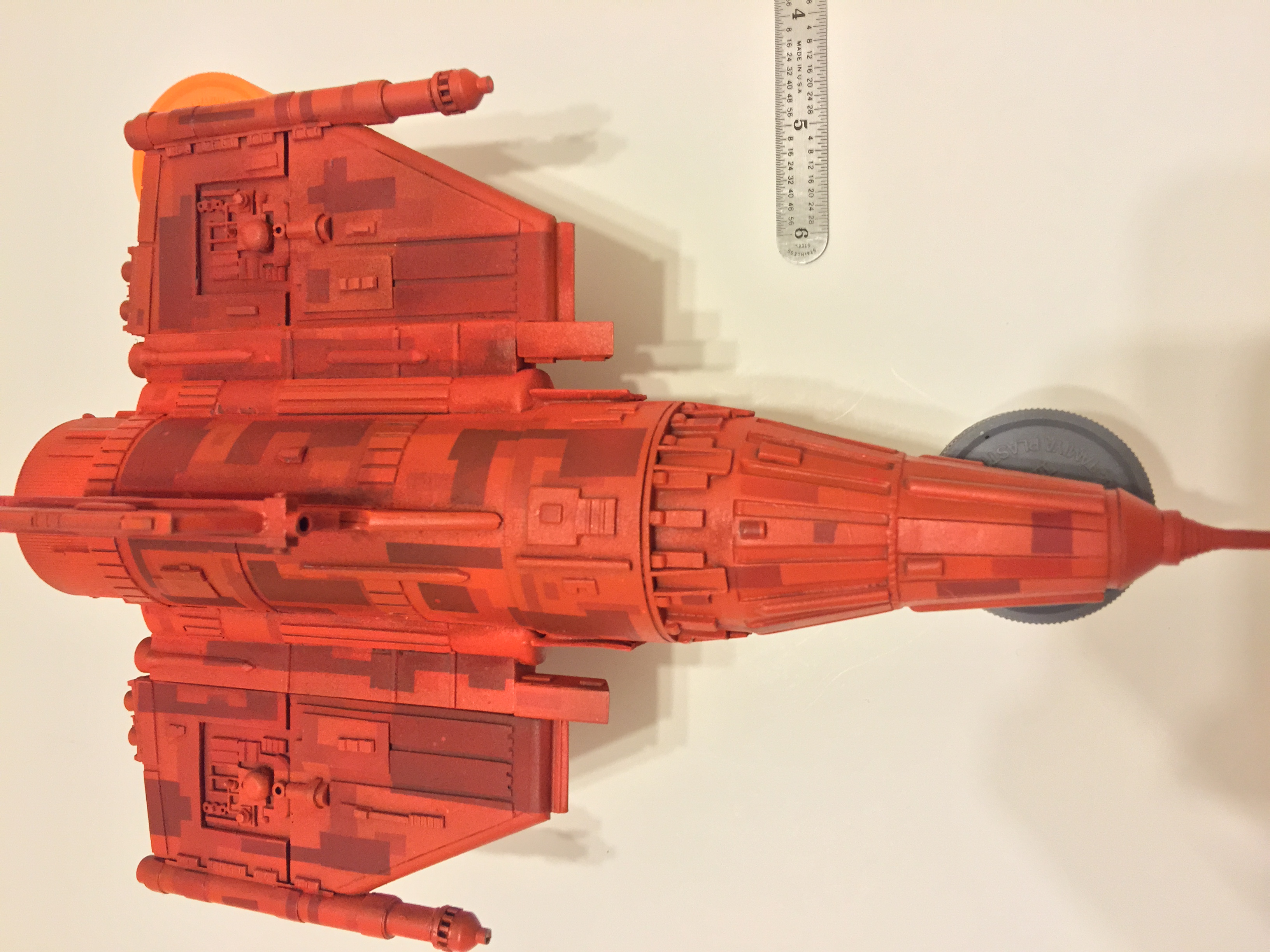

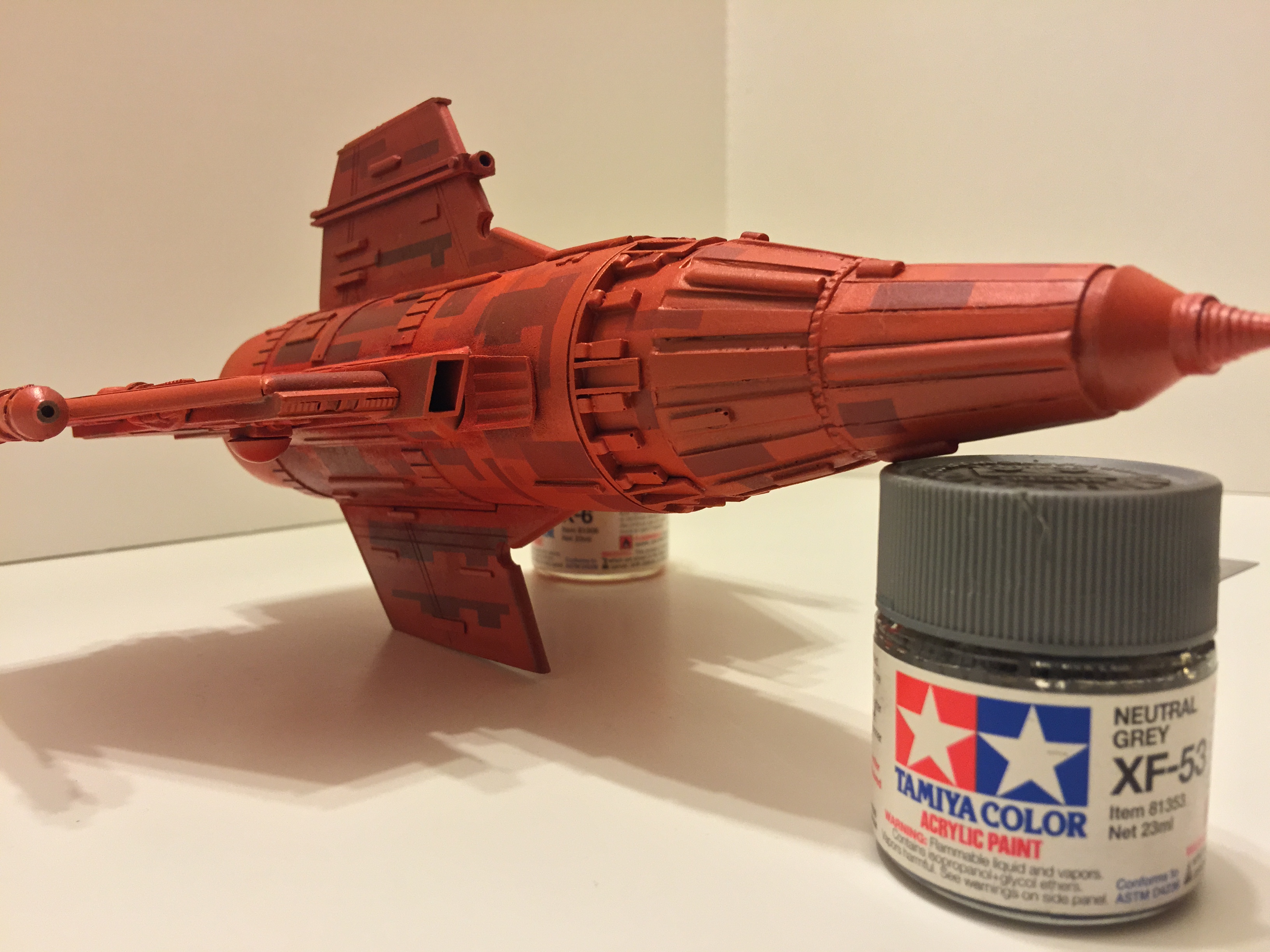

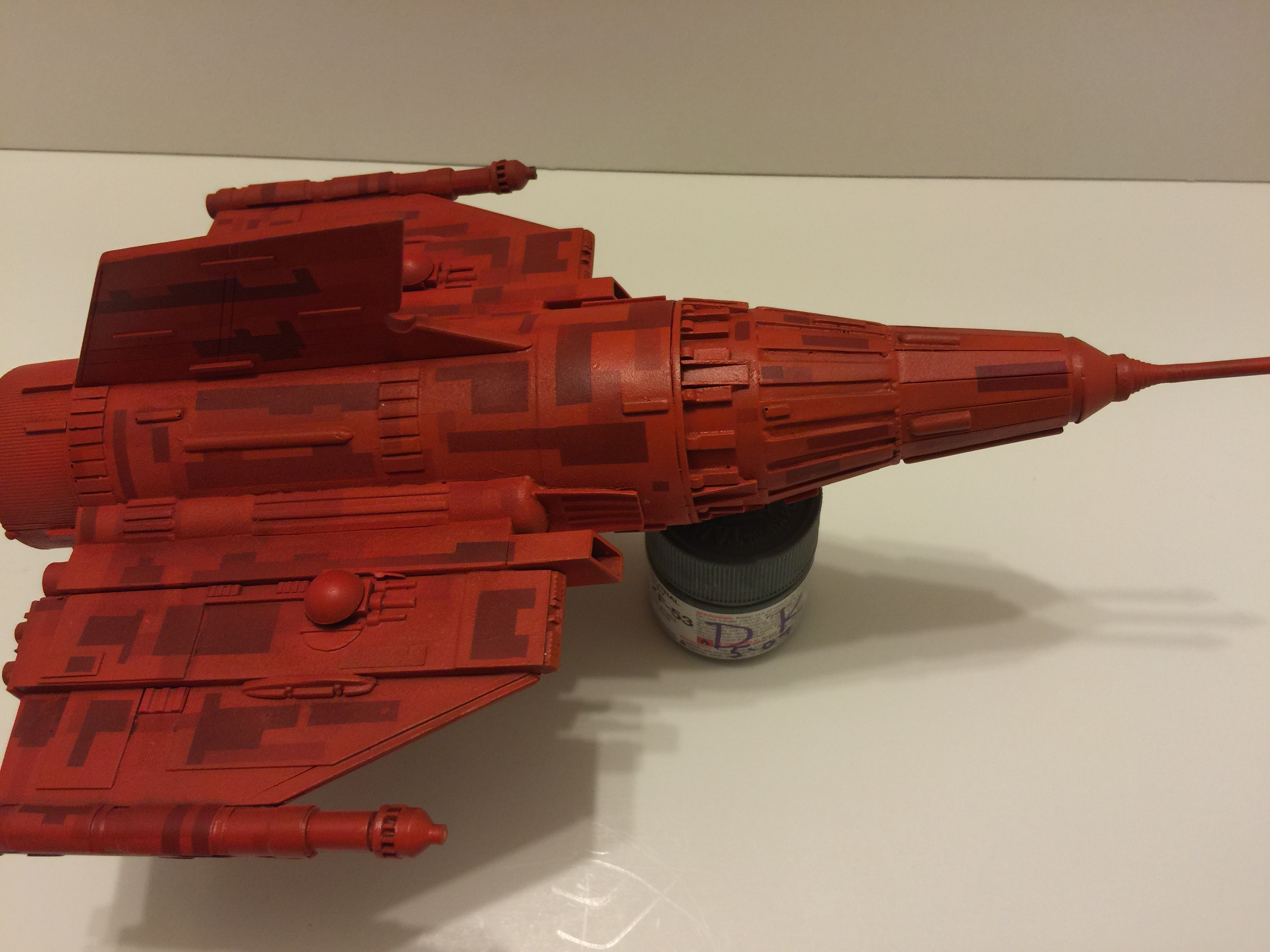

Finally getting some free time to work on this. It's all tamiya acrylics. I used a flat black undercoat, then thinned flat red. I added a bunch of masked squares and shot it with flat red mixed with some orange. Then more squares, then red mixed with more orange. Then I added more tape squares, then very lightly shot it with pure orange just to highlight on the outer edges and to give it some contrast. Finally added a light dullcote to seal it.
I was going for a blotchy, worn appearance which really makes the red color stand out. I'll probably give it a few light airbrush passes with thinned smoke/flat black for the crevices/inner edges.
Still have to work on the top antennae/dishes, the 2 other fiddly bit details on the hull as well as the side laser wing guns.
Also must think about the engine, a stand and maybe lighting it. The engine exhaust is just a round engine vent and looks dull so I may not bother.

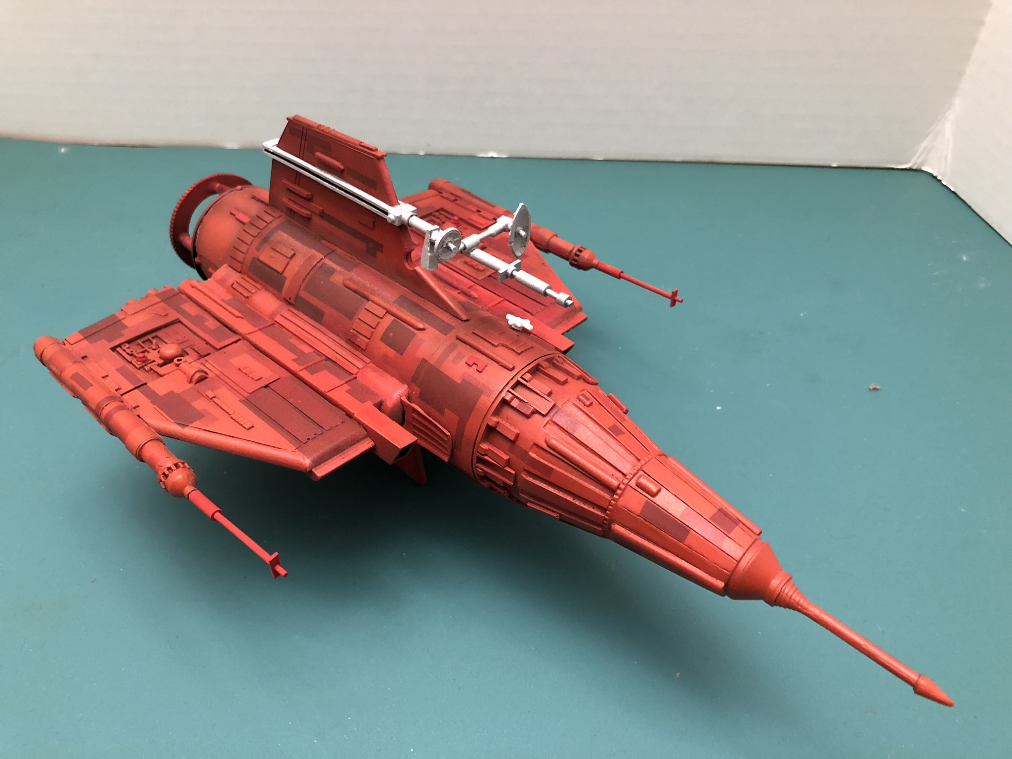

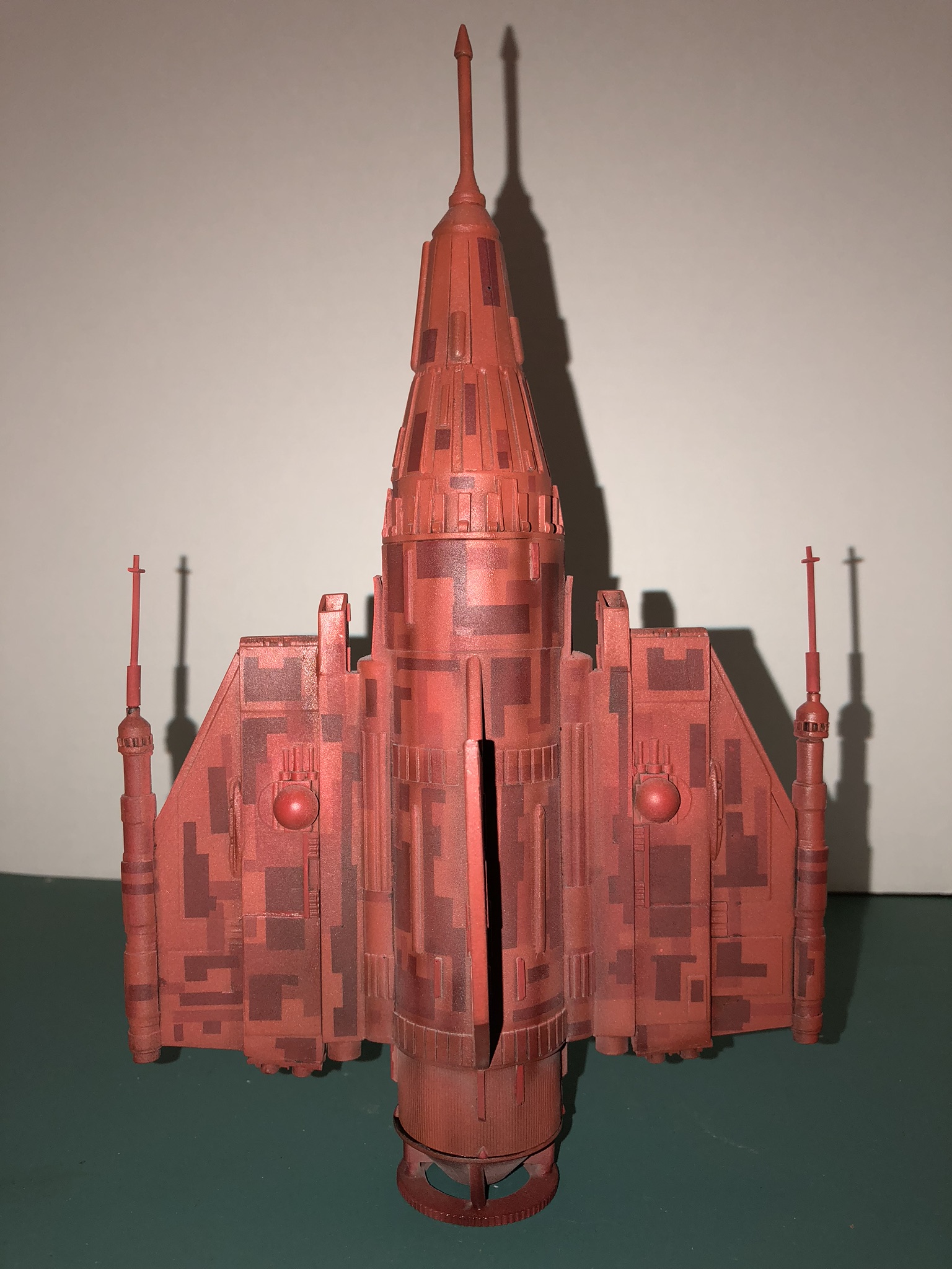

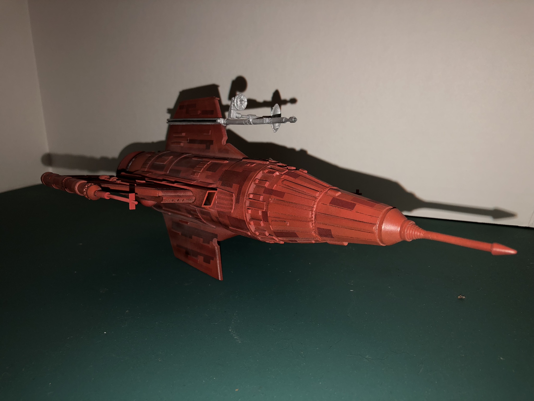

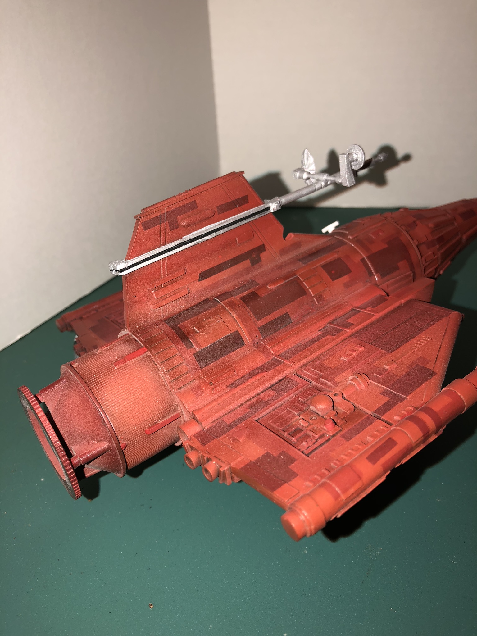

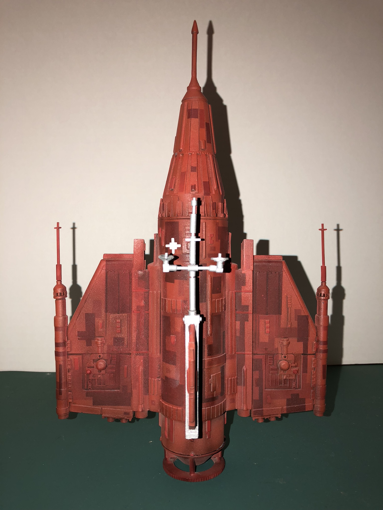

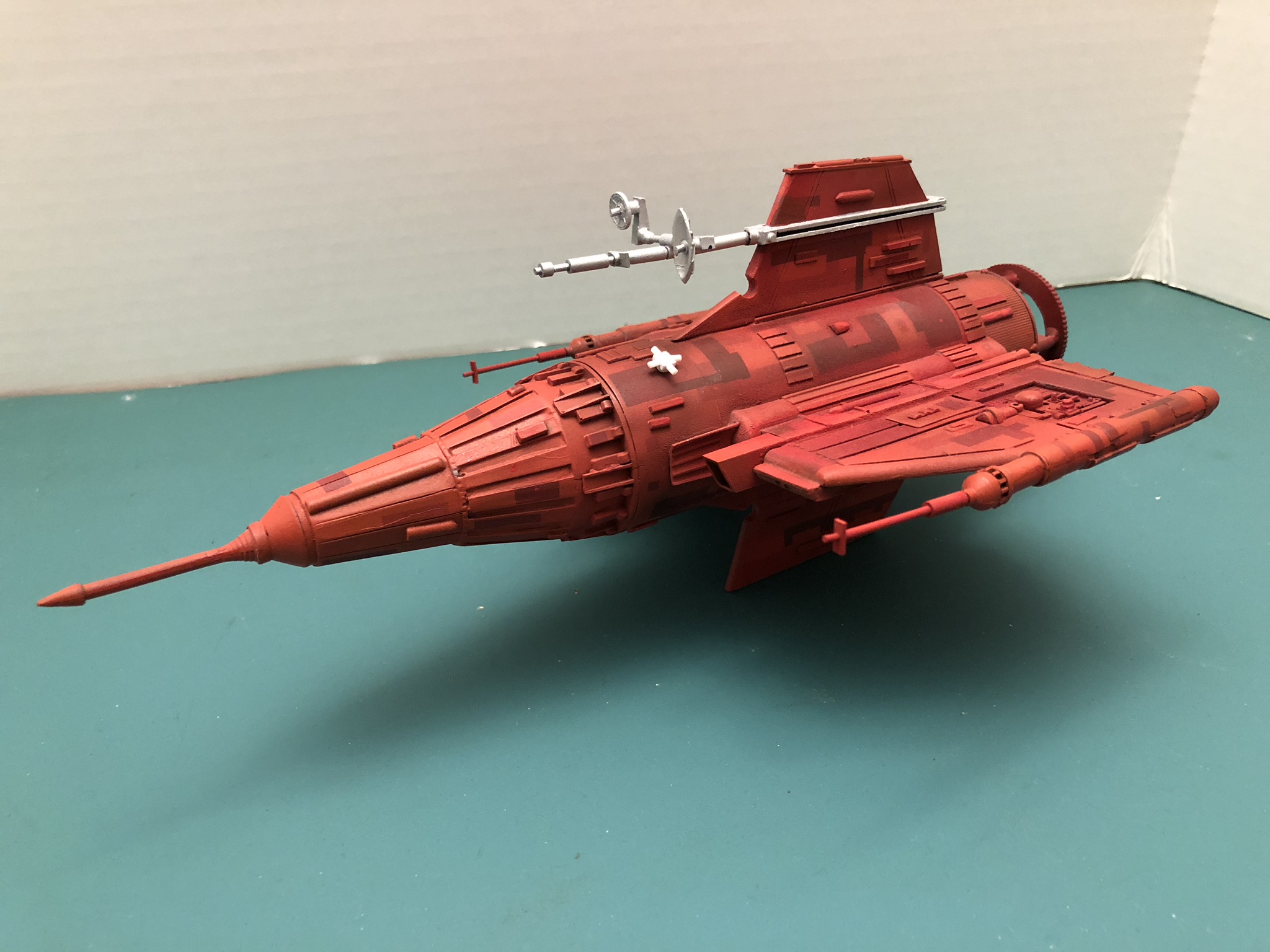

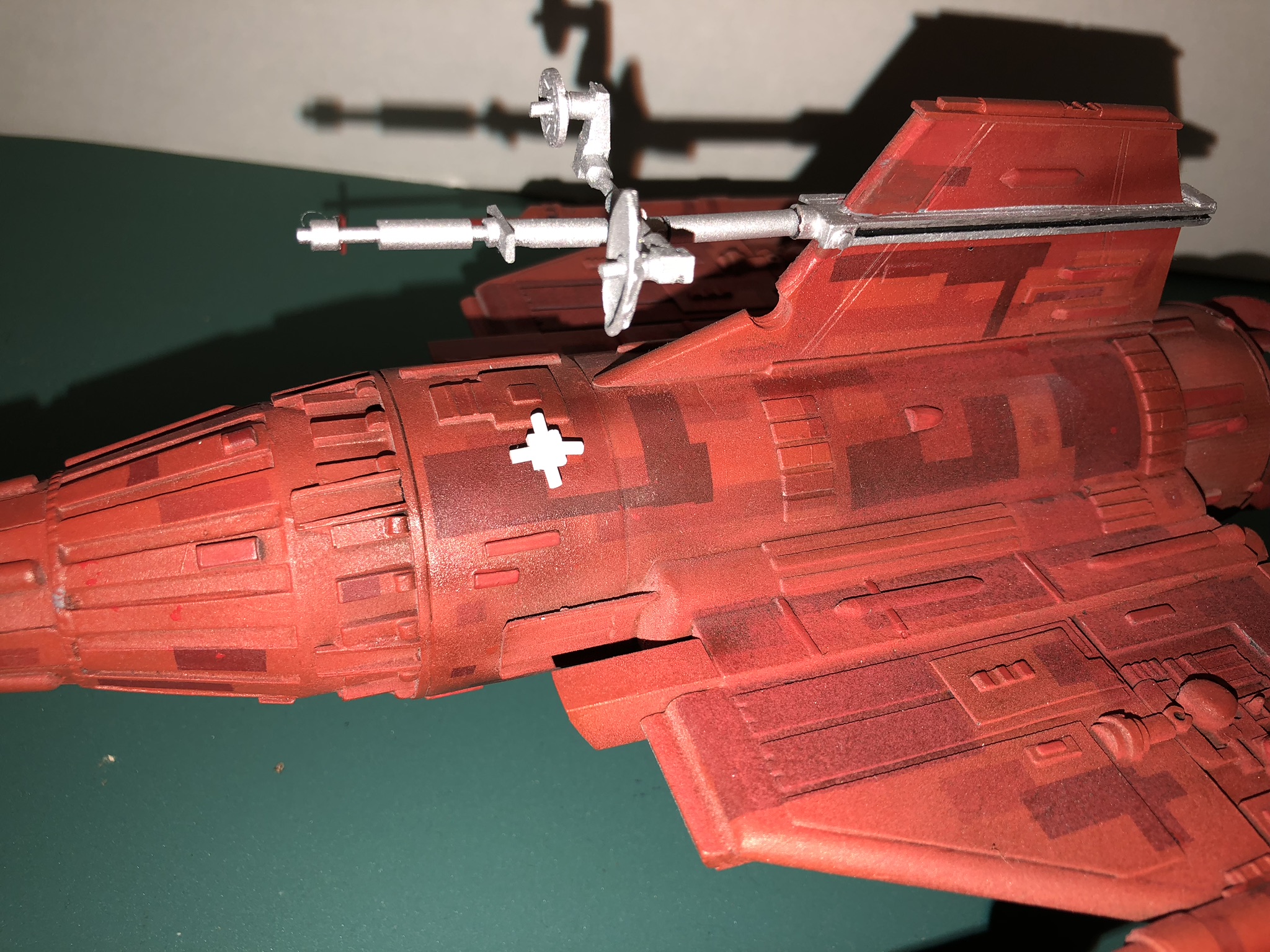

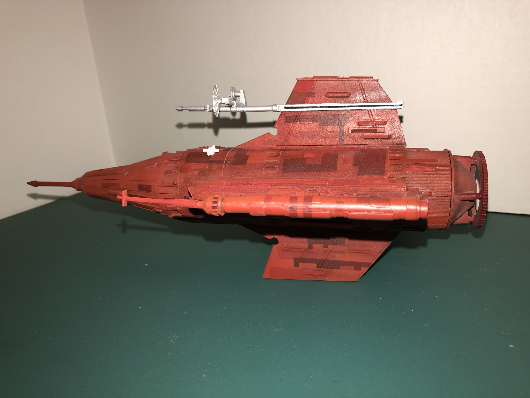

OK as it's been over five years since i started this, it's time to finish these babies. The Pursuit ship is complete except for the decals - I have to find them somewhere....
Anyway, it's been done for a few years so lets close this thread.
IMG_2830.jpgIMG_2831.jpgIMG_2832.jpgIMG_2833.jpgIMG_2834.jpgIMG_2835.jpgIMG_2836.jpgIMG_2837.jpgIMG_2838.jpg
Really nice seeing this built up. Great work
Cheers
John
Thanks. I've always liked when spaceships got away from the "shades of off-white/light grey" mode which is usual standard for SF spaceships, even today. Even the Expanse, which I love, has everything in grey.
