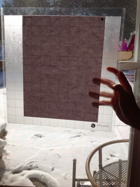

To give you all an idea of how well this thing can work. Hope you can see the light coming through the cuts and perforations.
Sent from my iPad using Tapatalk HD
