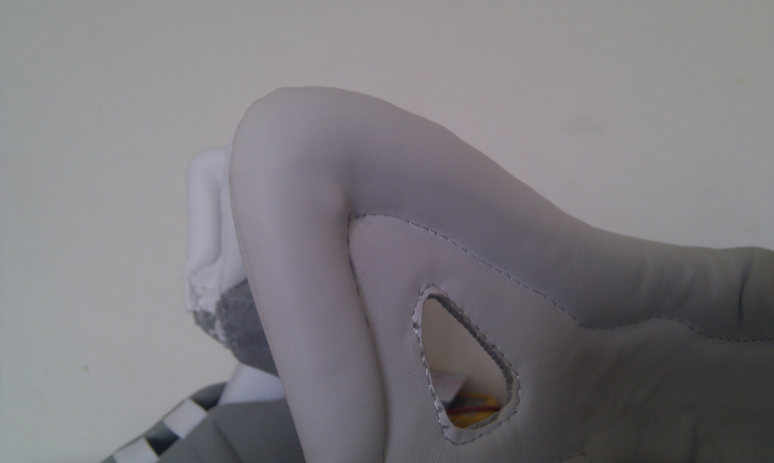

After the border is cut off, there is a line all around the edges that isn't entirely clear like the rest of the bubble due to the natural imperfections of cutting it off and I matched that up with the heel cup and that's where you need to glue it back. I hope that makes sense. When you actually do it, you will know what I'm talking about.
I found that it's easier to just match the ankle bubble up with the back of the heel cup. It sticks out a little less than the other way I said how to do it, but the way I just told you is easier to do and has a better glue bond. And if someone here does do this mod, make sure to do a section at a time. The ankle bubble tends to pop out of place a lot if you try to glue it all at once.

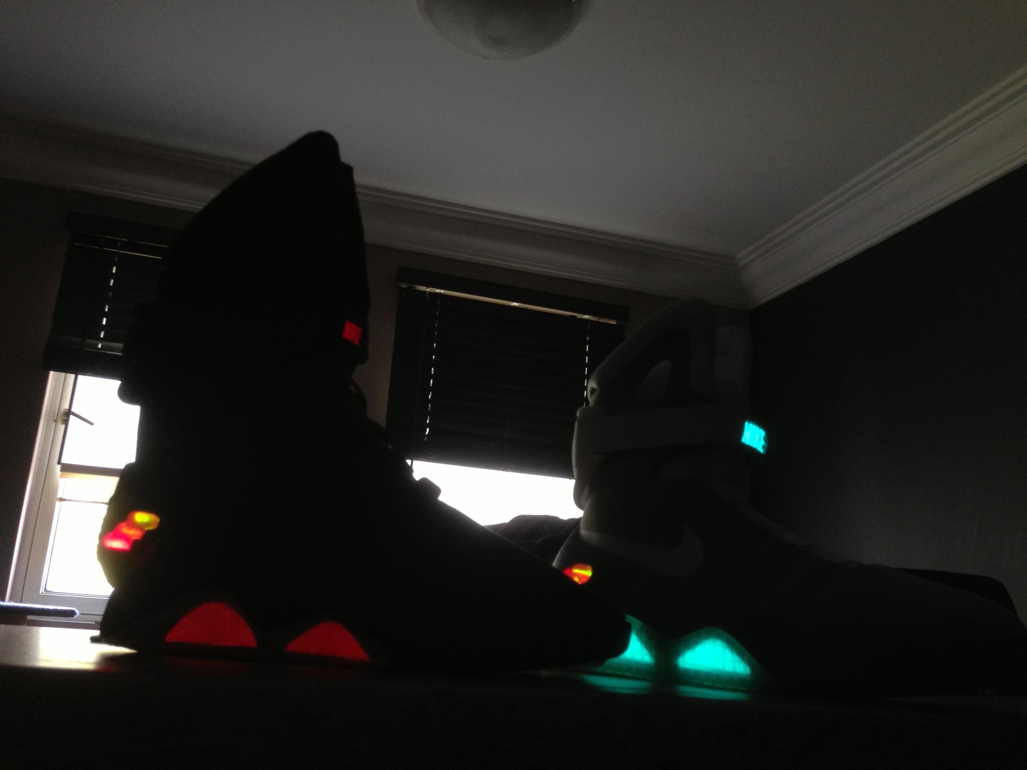

I've been a bit inactive recently but when I have had time I've been working on my black/red mags.. Not finished yet as I still have the laces and red nike tick to do but here's a pic anyway :)

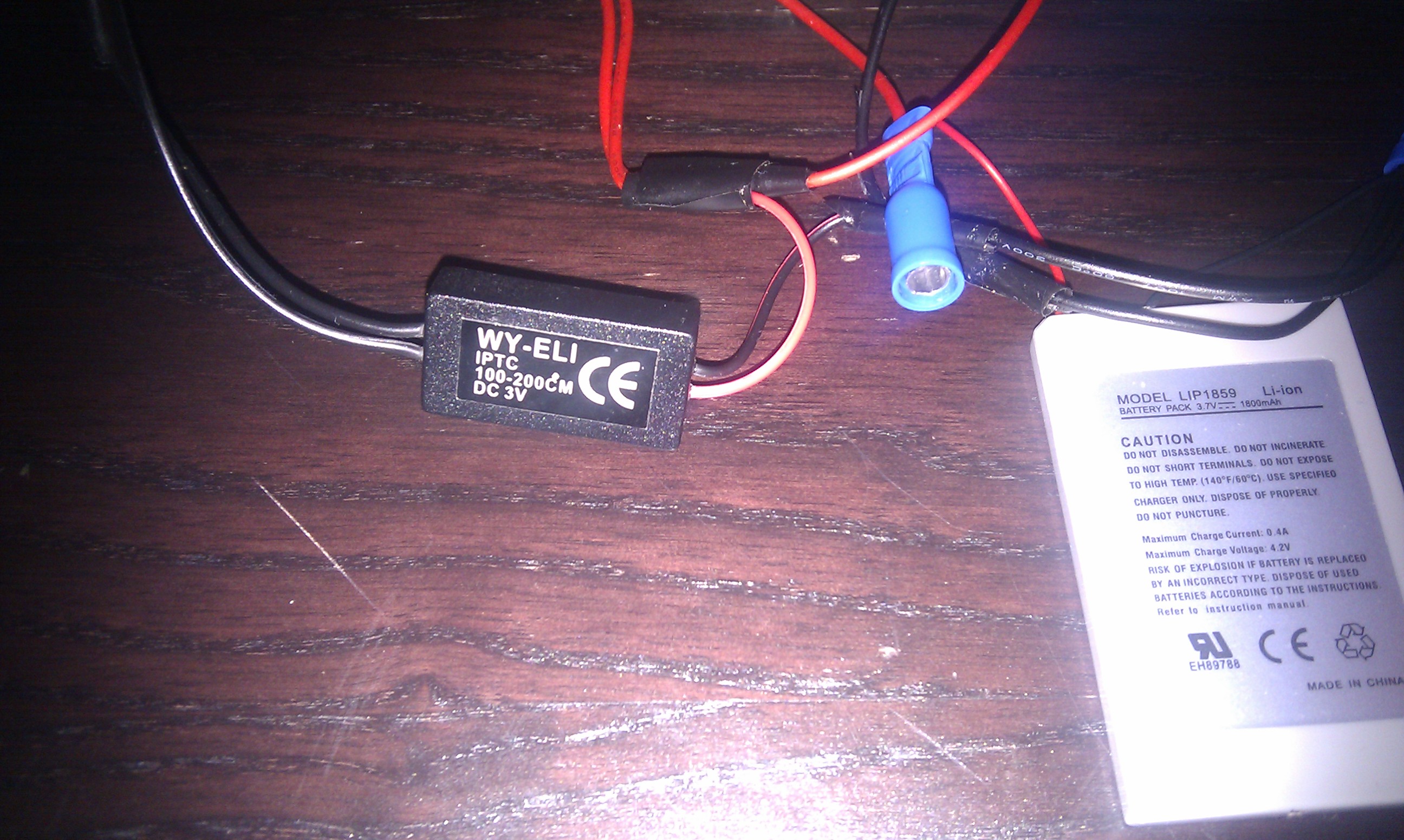

Hello, who has make the configuration with wy-eli iptc inverter 3V and battery 3,7V 1800 mah ( PS3)???
Because inverters work 10 minutes and stops, and does not restart any more.
Already several times the same thing with these inverters!
Is it the products of the seller which are chicken or the power of the battery which
destroys the inverter,
because in full load the batteries deliver until 4,2V neighborhood.
Thank you for sharing if you had this problem.
Is it the products of the seller which are Some **** or the power of the battery which
because the PS3 battery in full load deliver until 4,2V:
A connoisseur for this problem?

did you ask cloneprops?
i think he used same type of battery?

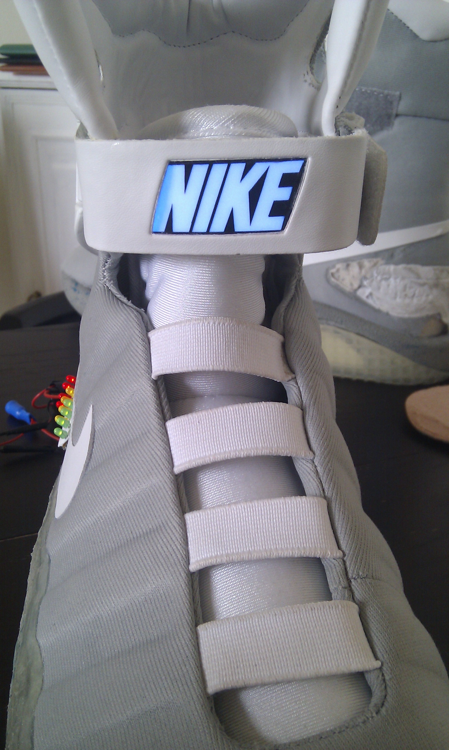

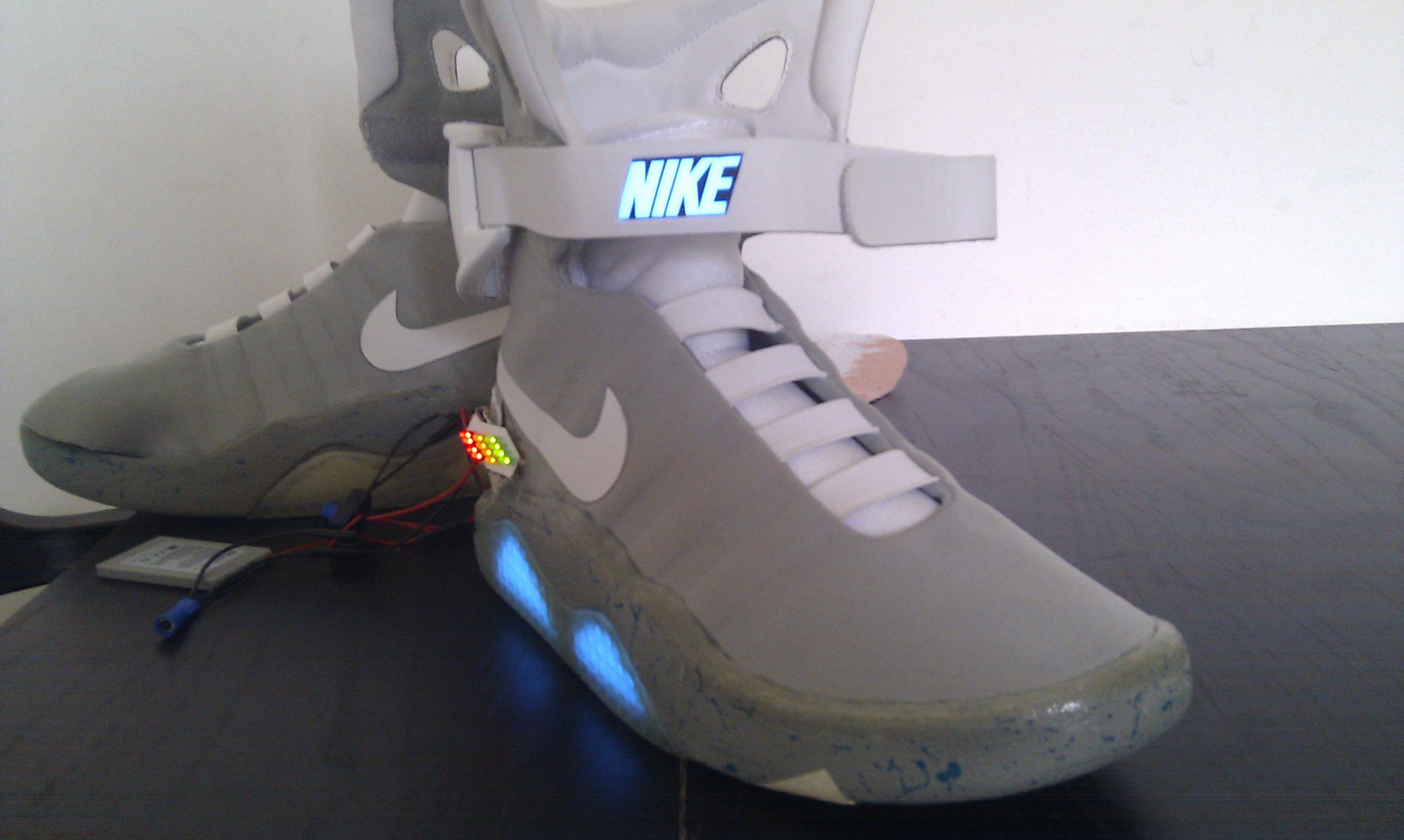

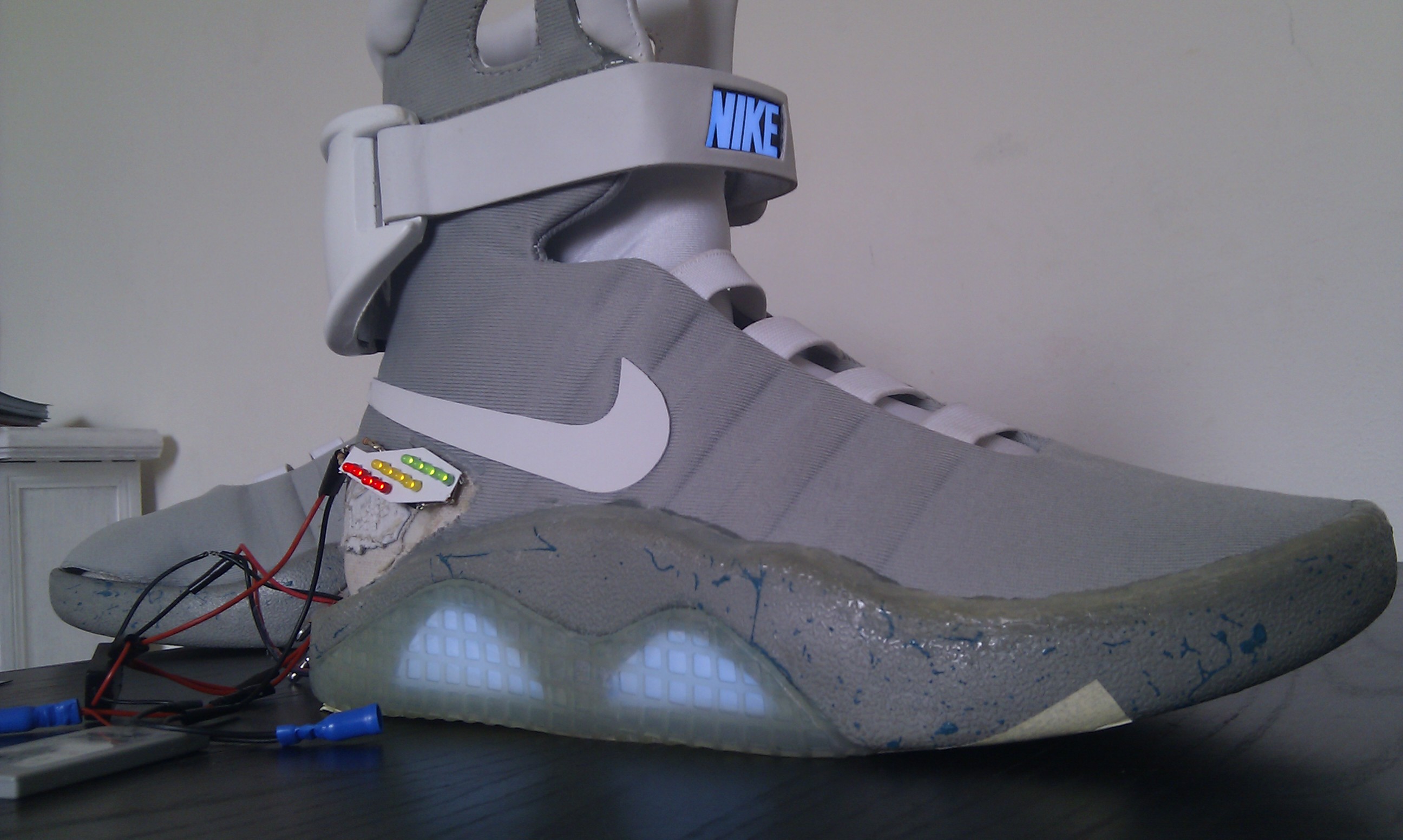

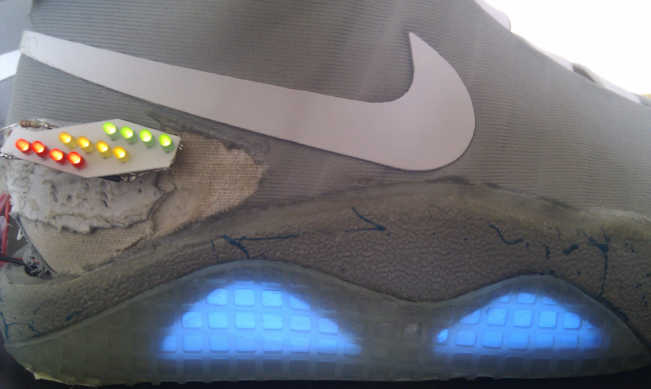

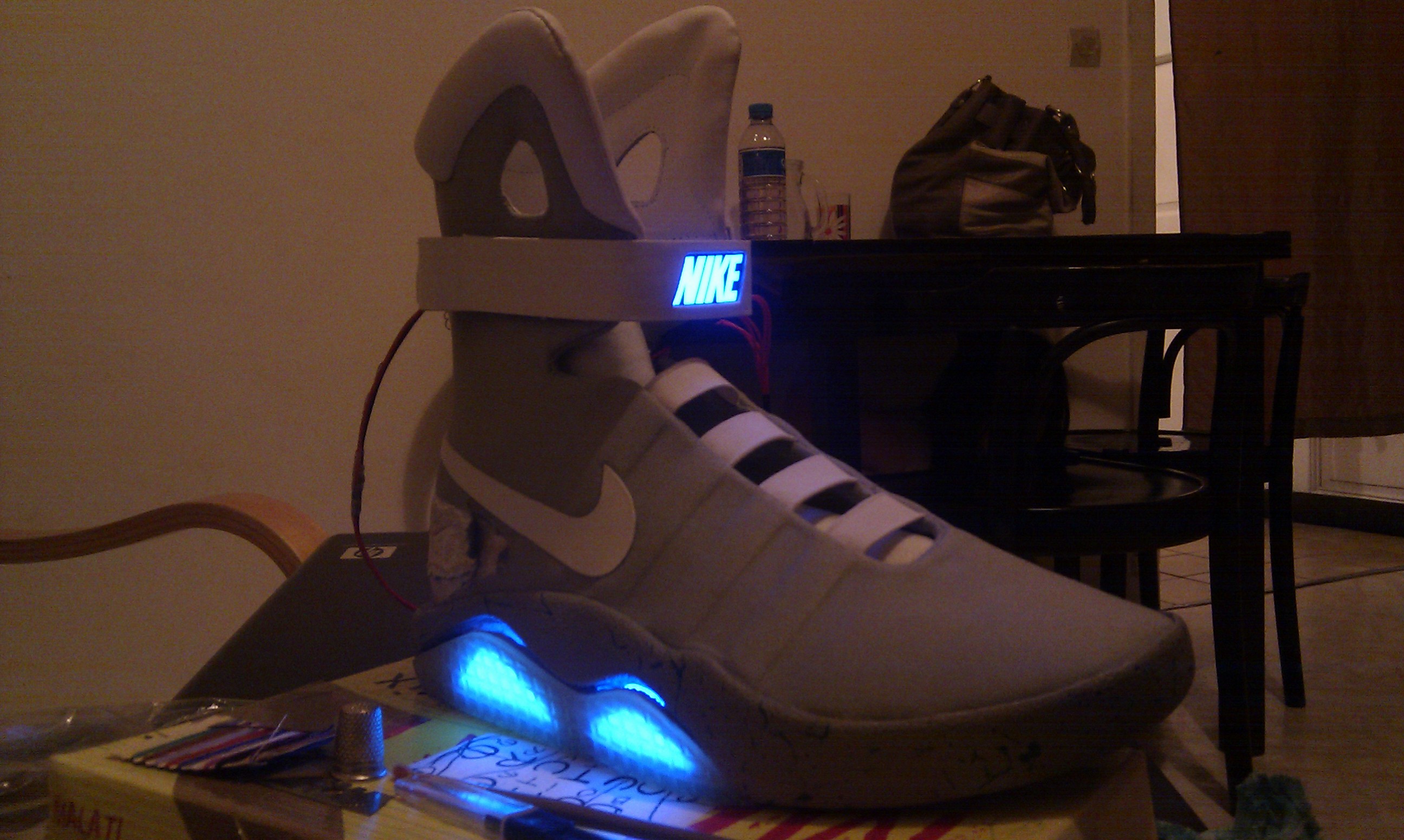

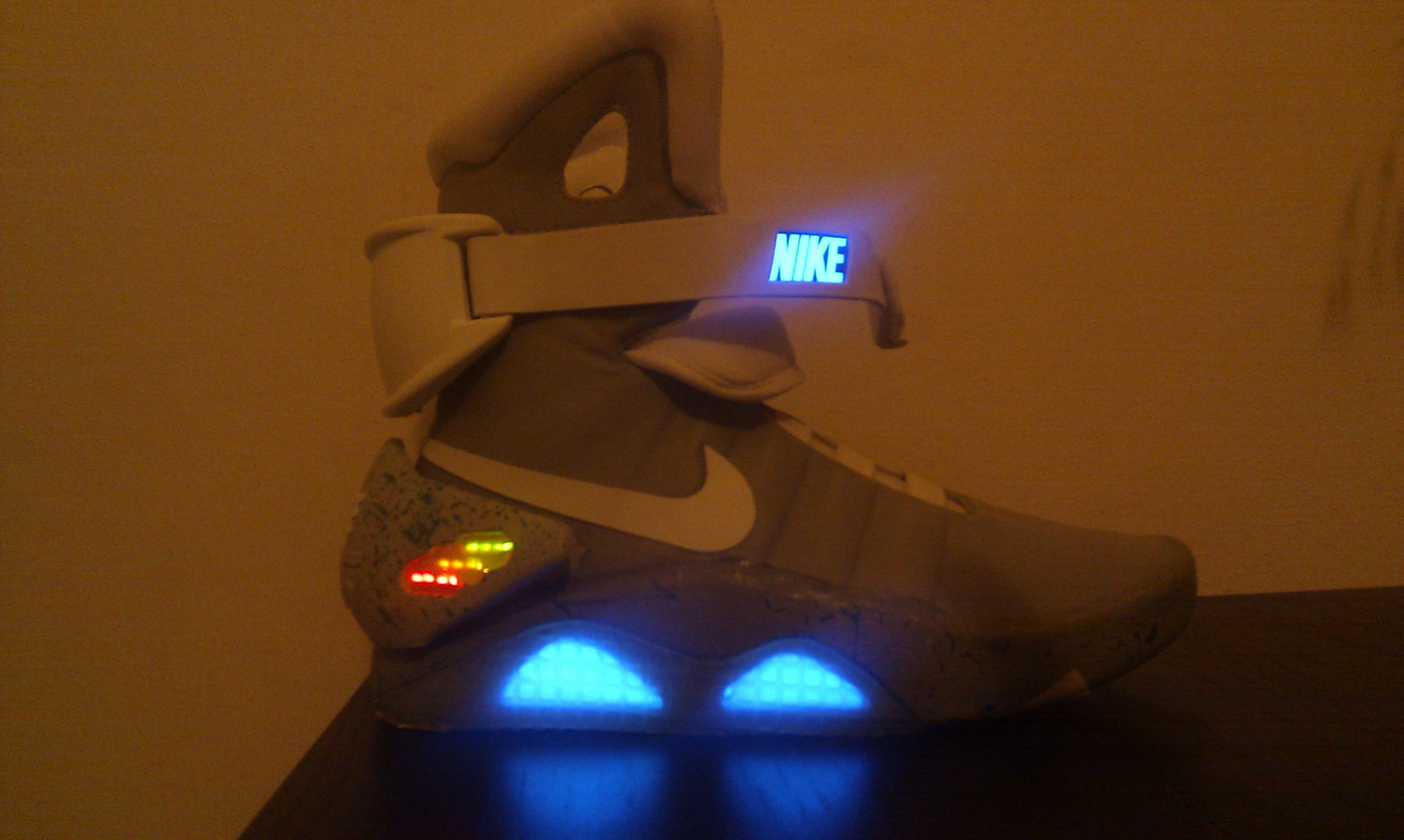

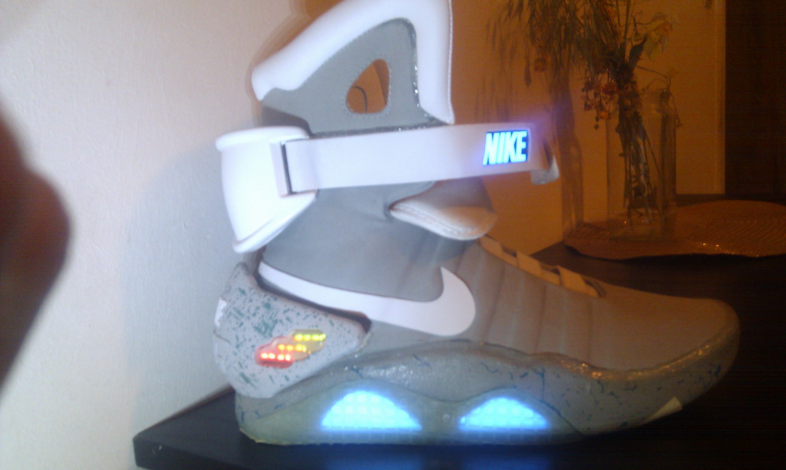

OK, thank you airair, I sent a message to cloneprops,
but I found my problem later. Enfaite, the negative wire of the inverter and wire el nike & el sole did not like the weld!
I have redo the connection and all is well.

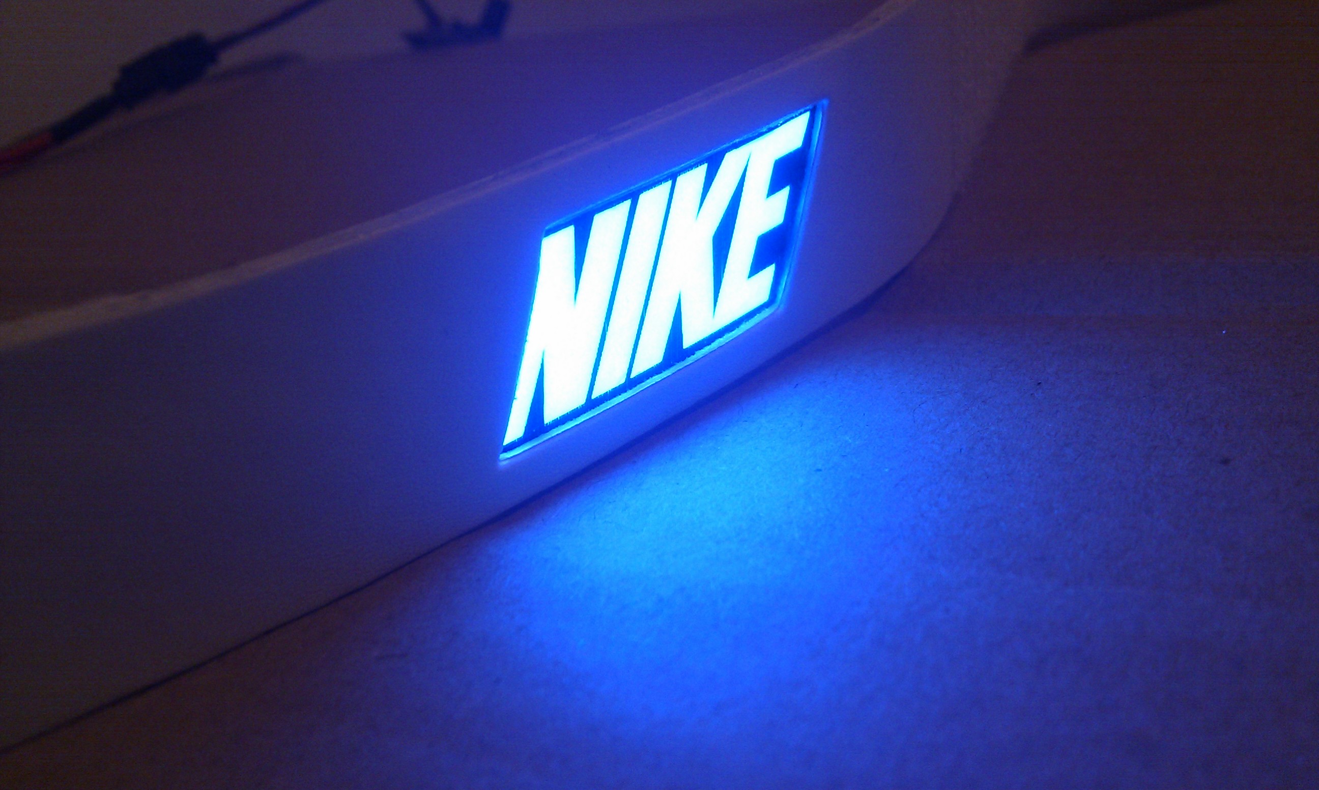

I put some photos of my pair soon to end.
The paint of the sole is missing to be painted (as the back heel), not to be afraid!
The lights seem low with the camera because I have captured in broad daylight but the effect is just as I wished.
Because too much power for leds gives a confusion of color, but there, we distinguish better couleurs.mais it is my choice!

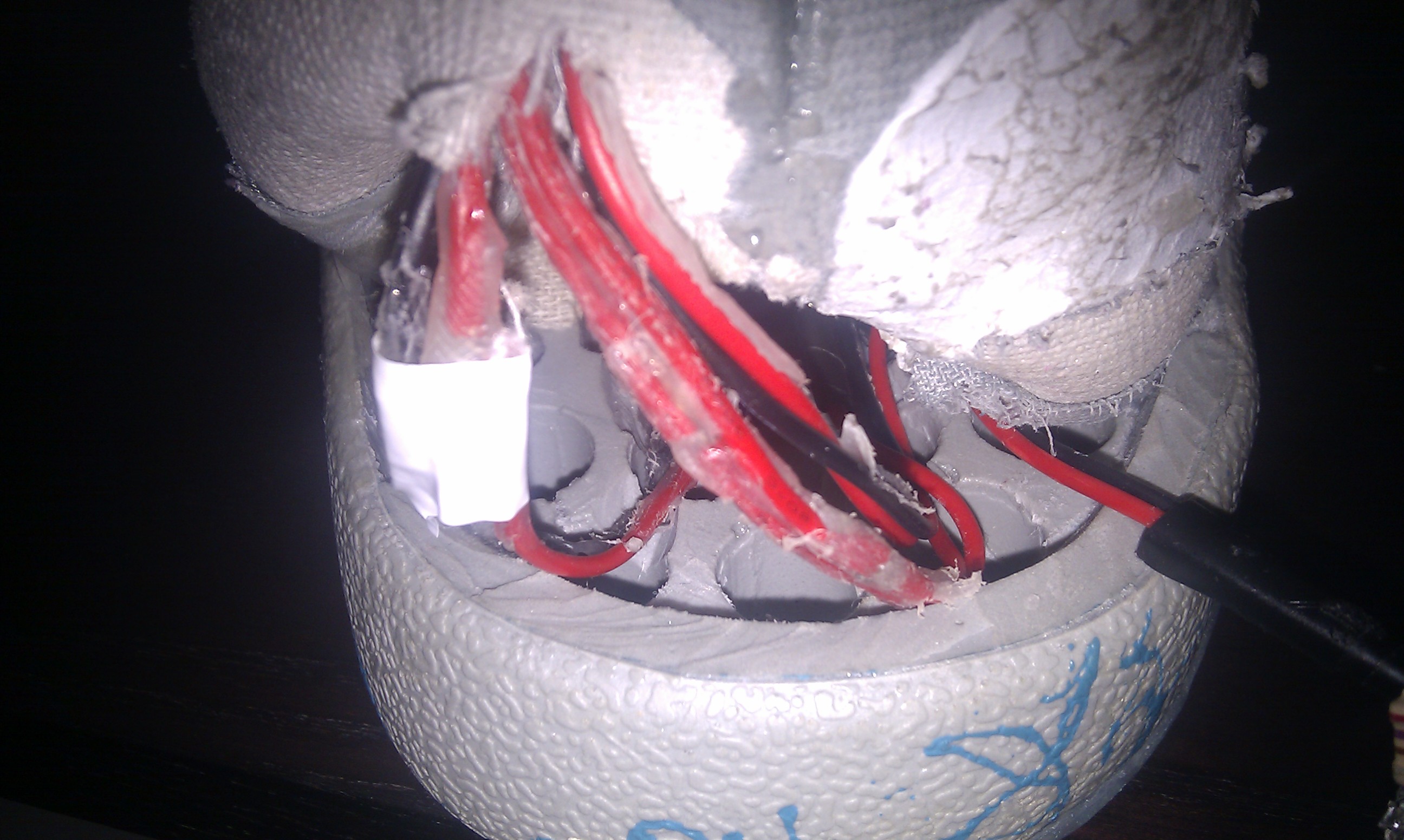

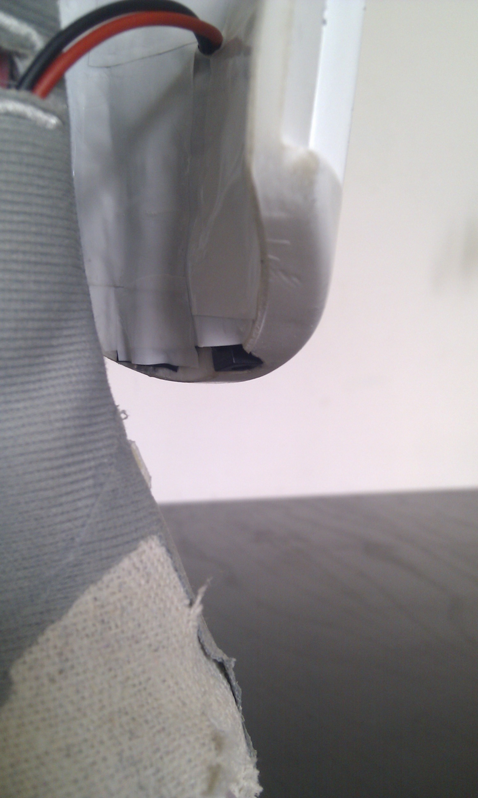

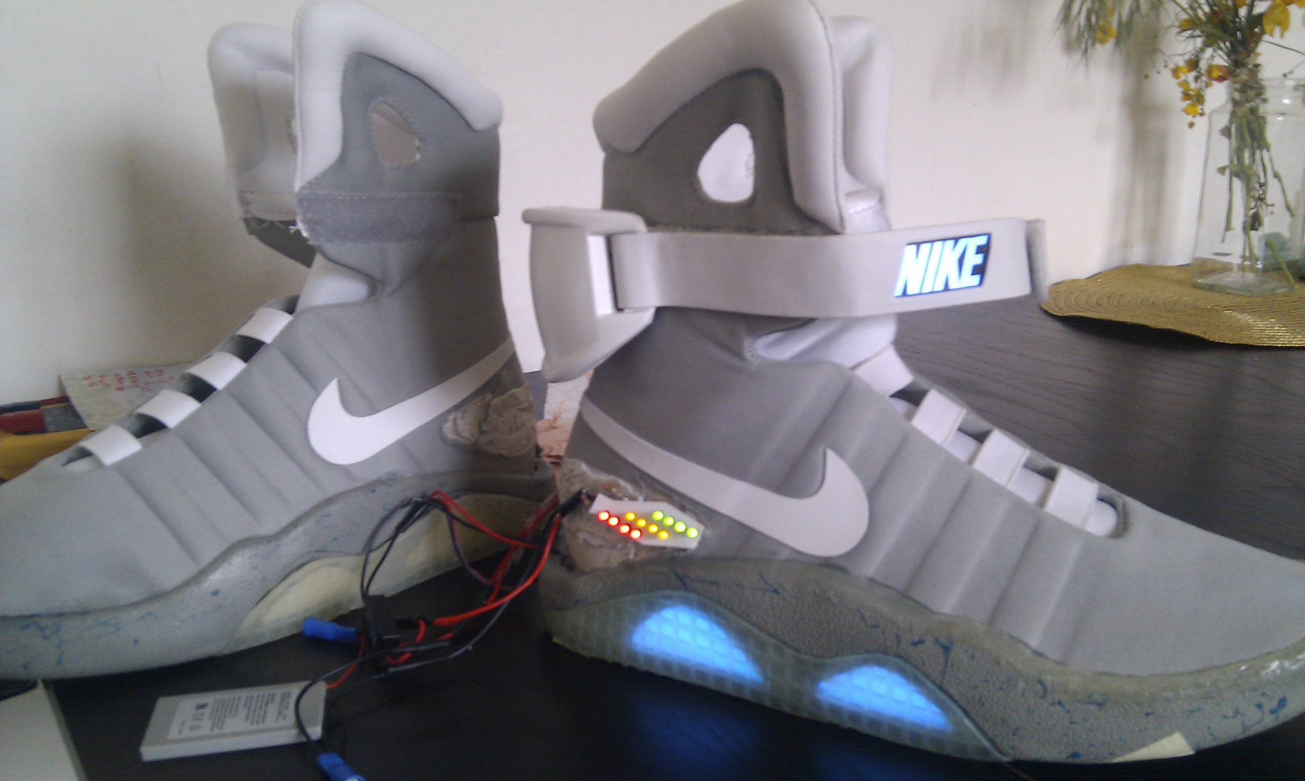

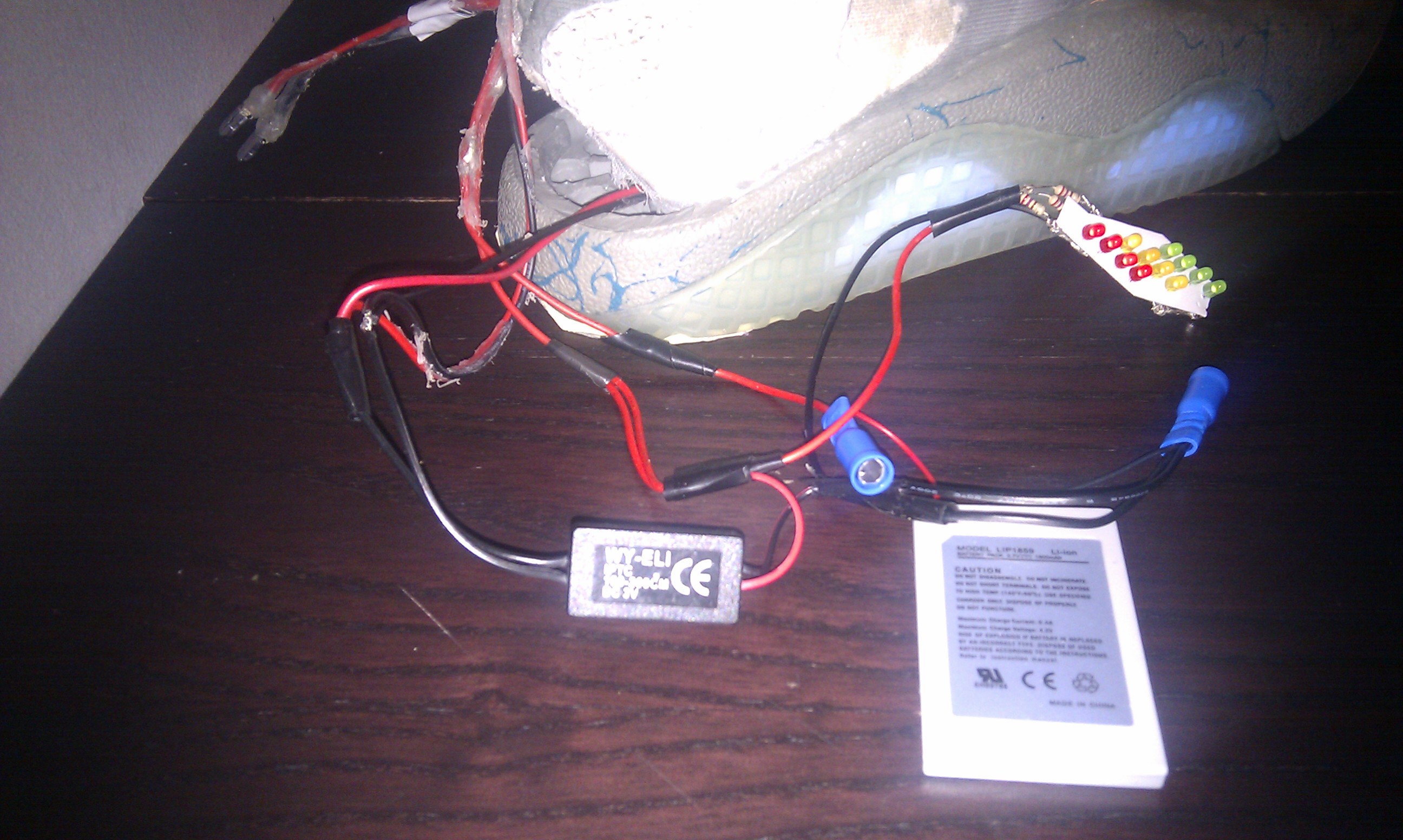

where is your inverter/battery placed? do you have any pictures?
I am so happy that with my crazy r&d I did on my v1 I was at least able to come up with a few helpful techniques for the shoes and it really means a lot to me to see others value my opinions with ironing the laces and even extending the toe front. I doubt Ill ever finish my v1's, it turned into a hole too large to dig myself out of but the few techniques I shared and the use they have obtained make it well worth it to myself. Great work everyone! When I eventually get the v2's at least now I have zero thinking to do when it comes to modding them as you all have done a very great job documenting the modding process.
Here are some photos:
Everything is in the sole, but it is necessary accentuated in length.
And, I have a controller of load for battery lithium in the back buckle.
