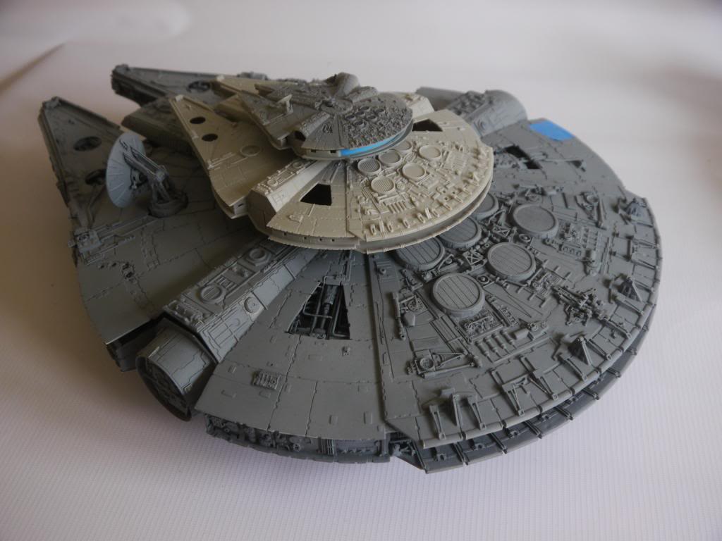

Scratchy, thanks for the new dish(s) (I also bought another for my 2nd FineMolds 1/72 Falcon)
It is a necessity after doing the mandible/jawbox mod....It matches perfectly the dimensions of the modded jaw, cockpit & docking rings:

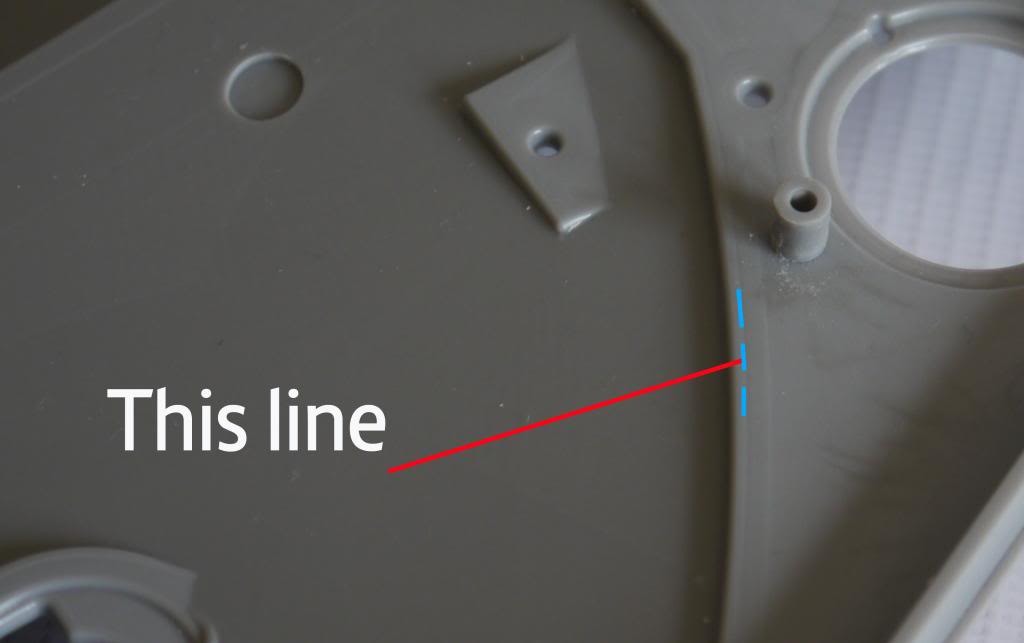

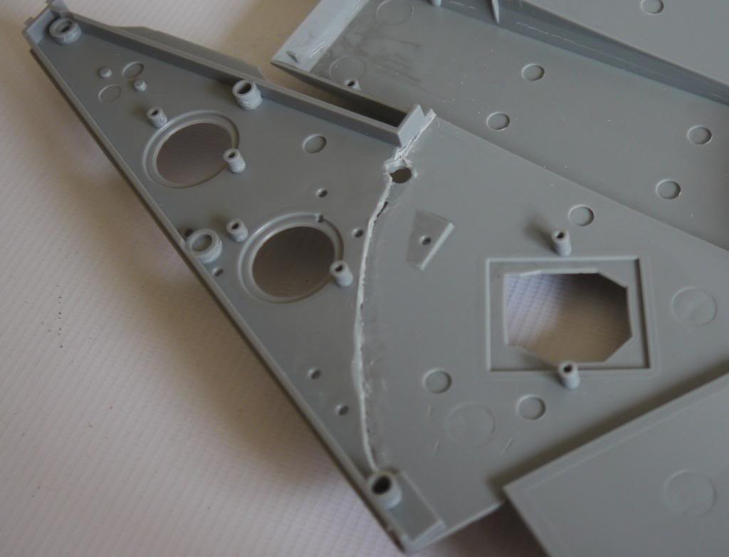

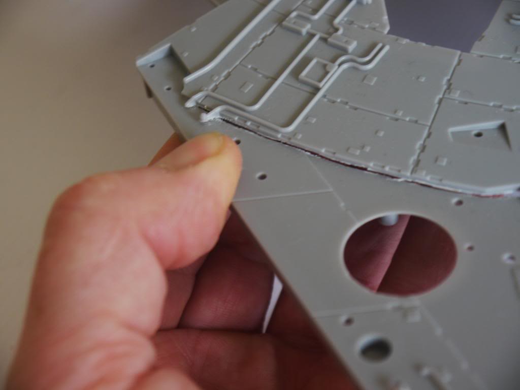

I think I might modify the mandibles & jawbox like I've done on my 1/72.....speaking of which I tried a new technique of detaching the mandibles on my other 1/72 Falcon......If you look on the inside of the kit where the mandibles join the main hull you can see a machine line moulded into the plastic:
If you cut along this line down to the level of the hull, youll find if you hold the model up to the light that the mandible & hull is now nearly separated & cutting with a fine blade from the outer side of the model is really easy without damaging details:

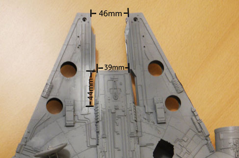

Jaitea, what are the revised dimensions of the mandibles? You shortened them in length and narrowed them...but by how much?
I remember bringing the mandibles in just before they touched the jawbox,....I left the model like that for long time.....when I restarted working on it I was bugged by the size of the nose of the jawbox, so I decided to reduce it's size also.
When the jaw was reduced I was able to bring in the mandibles a shade more
I measured the parts tonight,.....gap between the front end of the mandibles is 46mm,......the length the jaw comes out from the saucer is 44mm......the width of the nose of the jaw is 39mm:
Hope this helps samster,.....good luck
