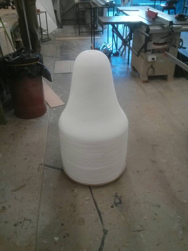

Hi Pork and Beans thanks for your help. After talking to reps at smooth on Im currently leaning towards a hardish expanding urethane foam cast in a fibreglass mould material cost will be around $30 a bell so that's in our budget. I still have a bit of time to decide but just started on the plug yesterday. Got my old wood lathe turned it on it's side made a big plate to attach the polystyrene too and attacked it with a grinder. It was like it was snowing in the workshop....
Obviously plug is nowhere near shaped yet . Still open to suggestions for casting / construction methods? I'm currently leaning towards casting a flexible expanding urethane foam in a fibreglass mould.

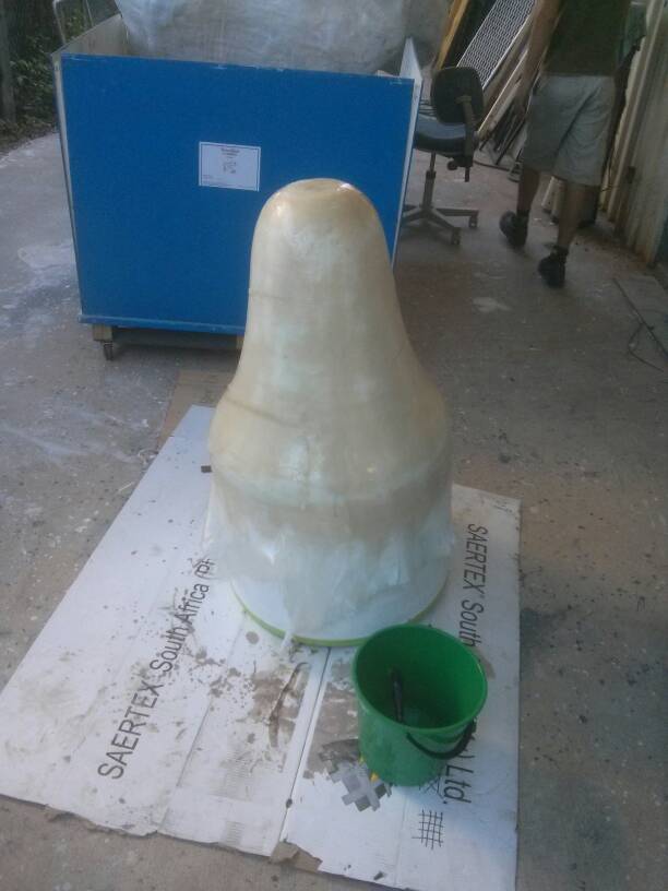

OK done. Going to fill it with a single part filler, epoxy glass it, fill again gel coat the outside melt out the inside and sand smooth [emoji12]

Hi Just a quick update. Got some self skinning soft urethane foam today and cast it in a small test bell mould with some pigment and managed to get a good part out pre colored and reasonably strong so things are looking good.
