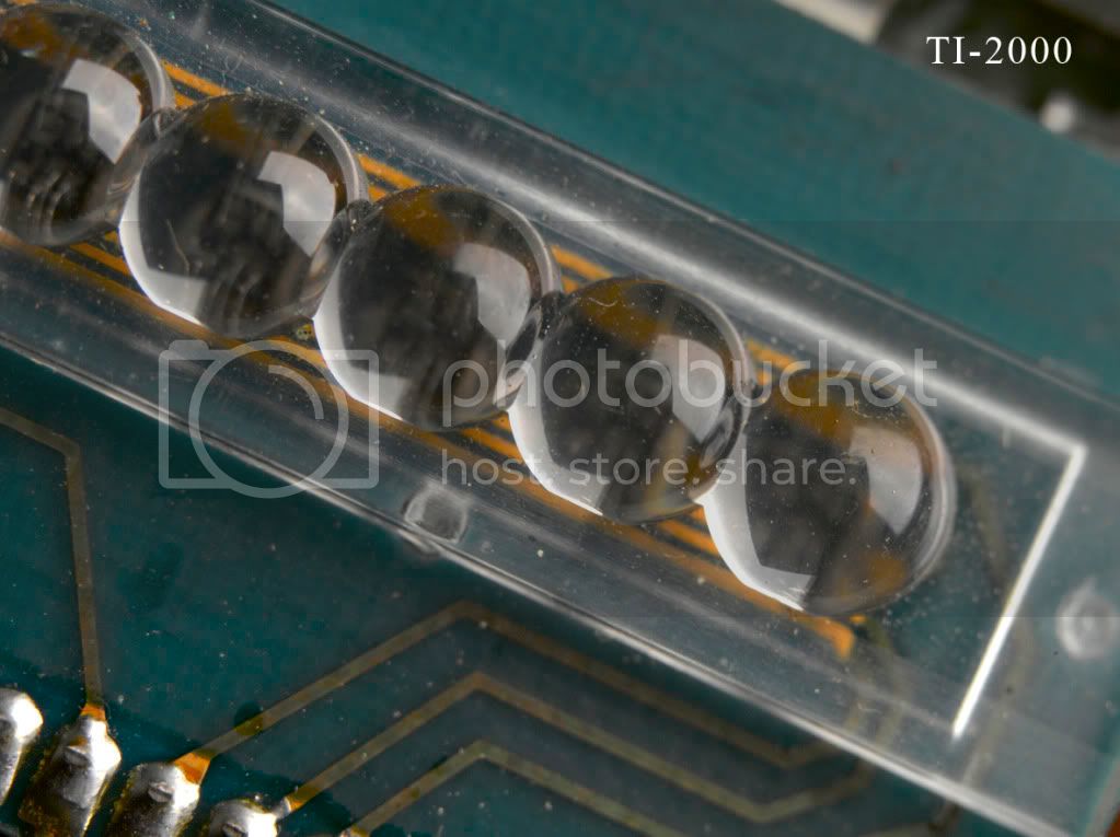

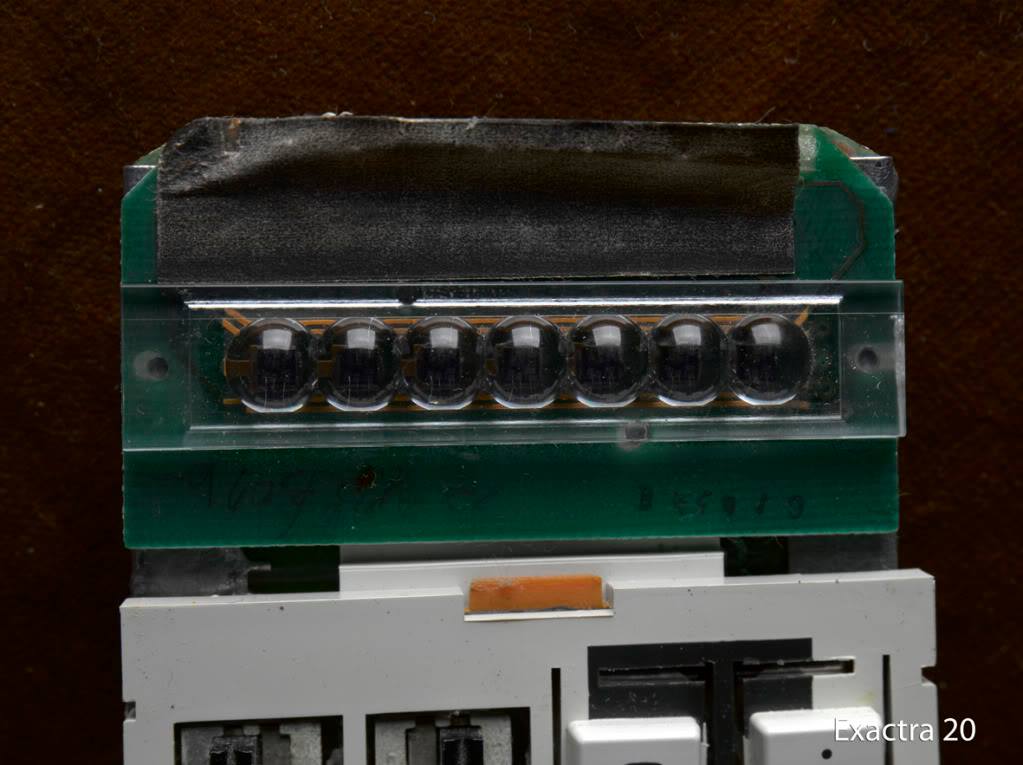

As you can clearly see on these pictures provided by d3po2u ... the board underneath is much smaller than the bubblestrip it is attached to ... furthermore the poor lighting conditions theses pictures were taken and possibly the ROTJ poster dark colors being reflected could influence our perception of the color of the board :
Though going on the slight frosting of the bubblestrip which is quite clearly visible, I suggest the turquoise board coming from i.e. this TI-2000, produced in Italy yet components might still have been coming from the U.S.A., is most likely what must have been used underneath the bubblestrip :
Chaïm

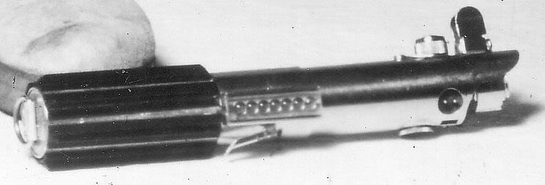

Comparing the MANY real bubble strips I have, the Luke and Obi BOTH look to have frosted type bubble strips. Frosted with cut edges on the bubbles. Also, the frosted type have what you'e consider a small window. When I do like for like comparisons, the light transmits exactly the same way. To me... I'm fairly certain.

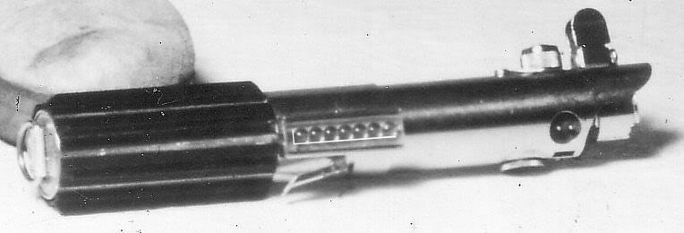

don't know, not sure, but for me the vader is for sure a green board bubble so, not the small windowed one.

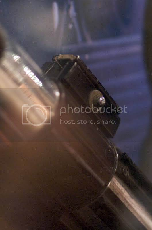

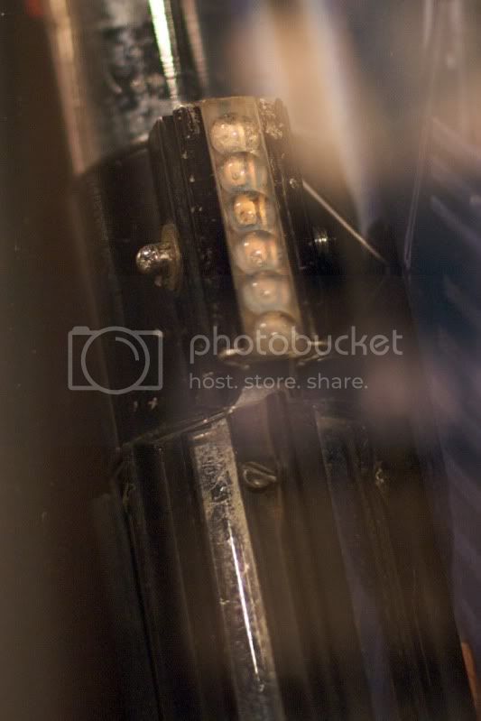

would need to find higher res of this picture:
and this one:
After reflexion, the toe pic could be a small window blue board bubble.
the reflection makes me think about a small window, and looks quite frosty on surface too.

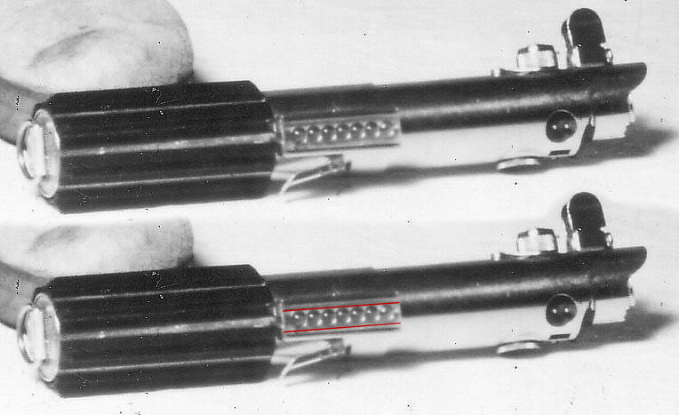

I was thinking about a small window yesterday, this is why I made a different drawing on same photo, but I made some tests and what I think to be the small window could be reflections of the bubbles on metal I had exactly same reflections today when I show to a friend explaining I don't know if small or large window bubble.
the most logical is this to me.
Chaim, looks like the board is the green-blue type, with the large window 4 holes bubble.
What is interesting is how the board would heve been cut on your picture, to fit directly in the window, that's weird, really hard to see on the picturs I have but looks totally right to me!

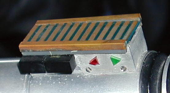

And if you wanted to double side it with something else that was blue...

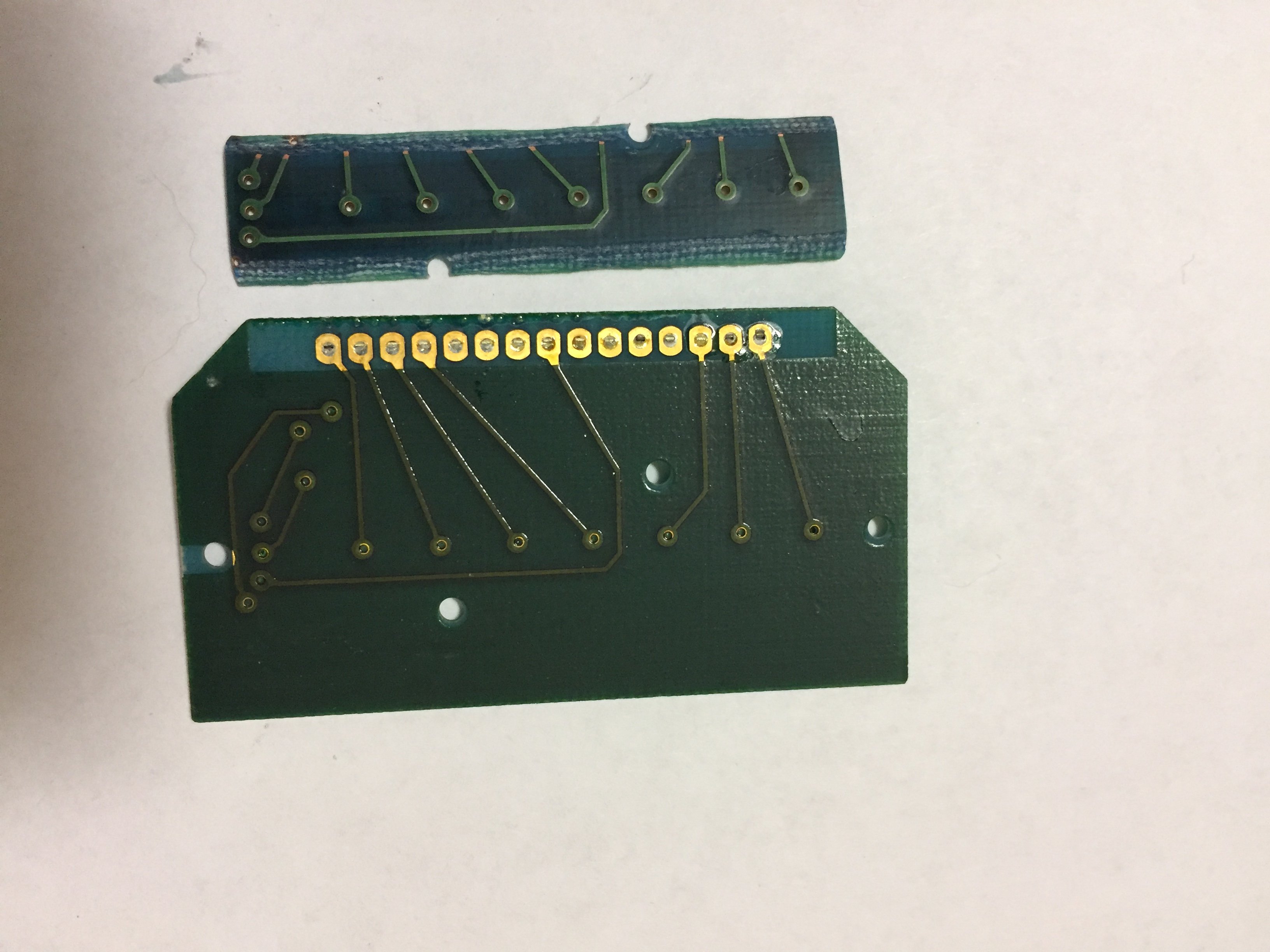

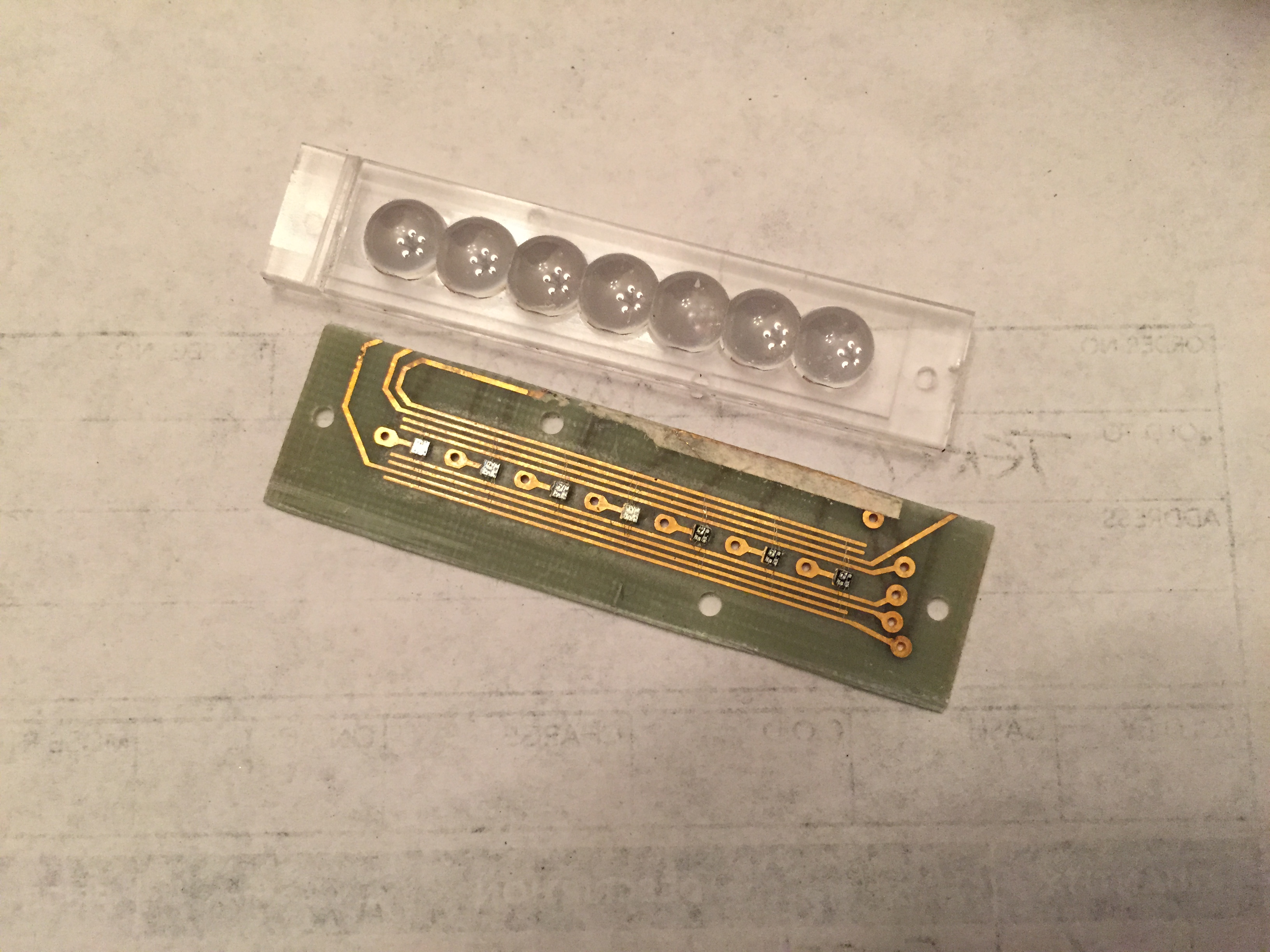

slothfurnace I'm not sure if this would be good enough for your to go on....
Mind you this was untrimmed and only just cut out....

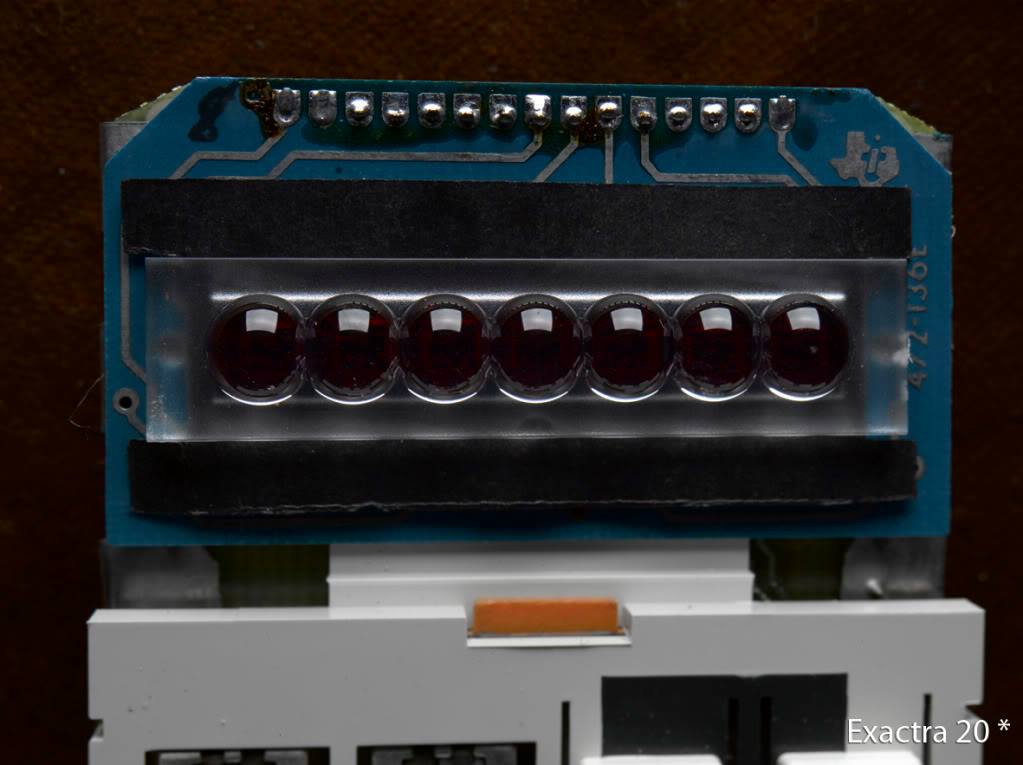

Hi Parfaitelumiere ... well I haven't opened up all my Exactra's 19 or 20 yet ... the green-blue or turquoise board came from the TI-2000 ... others are more green but don't have the frosting ... then there's the all roundish bubbles which are another variant ... I certainly need to start working on these lightsabers yet clearing out my late parents home and sorting everything out what I want to keep is taking to much of my time at the moment.
Chaïm
Did you (chaim, teecroz) get the blue "ti" board in a exactra or ti2000 calculator? All this is so interesting!

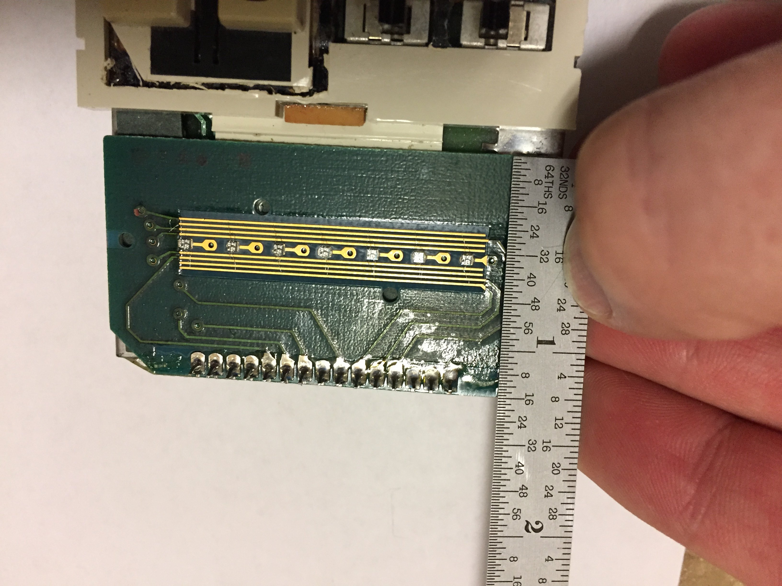

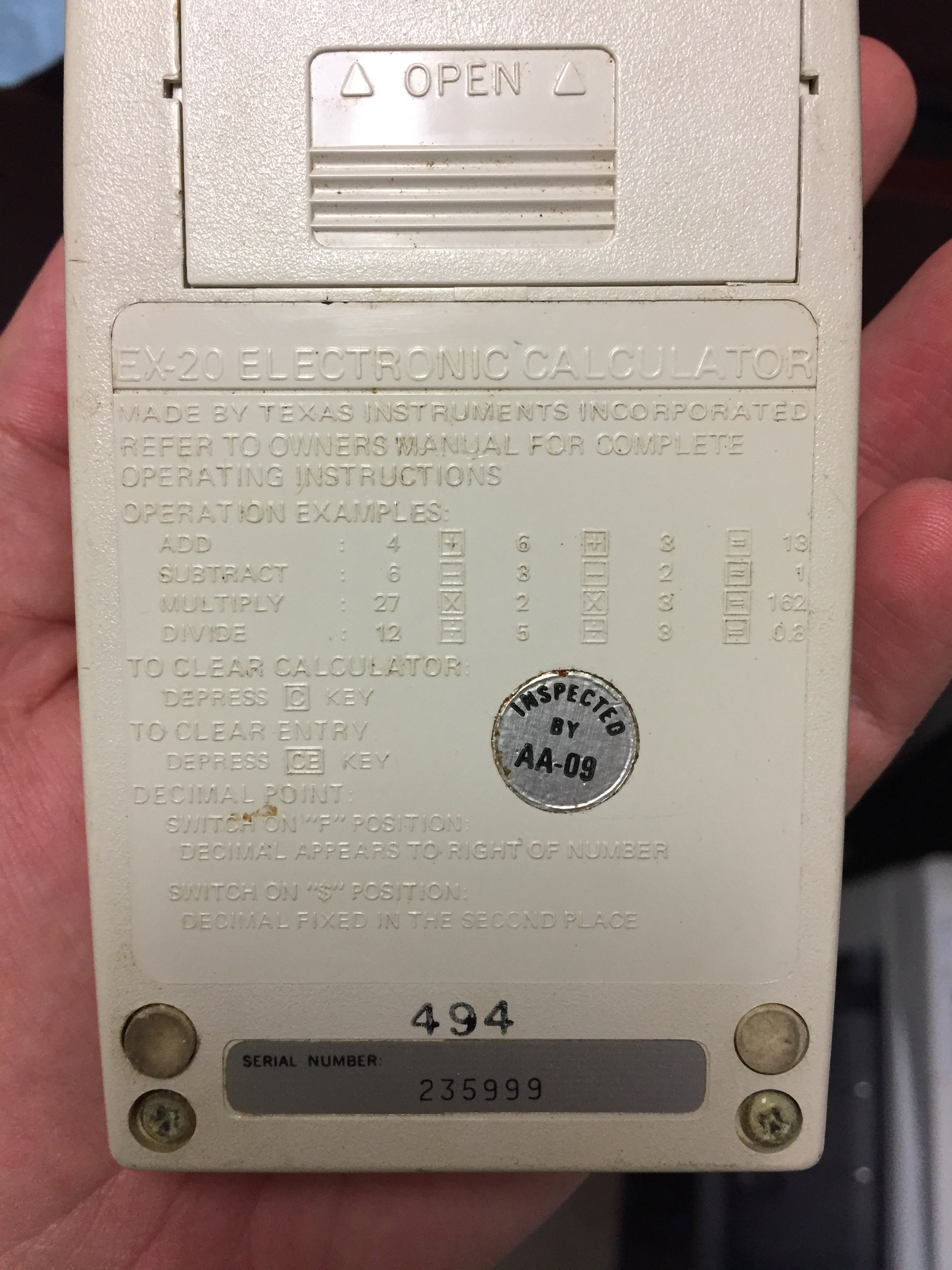

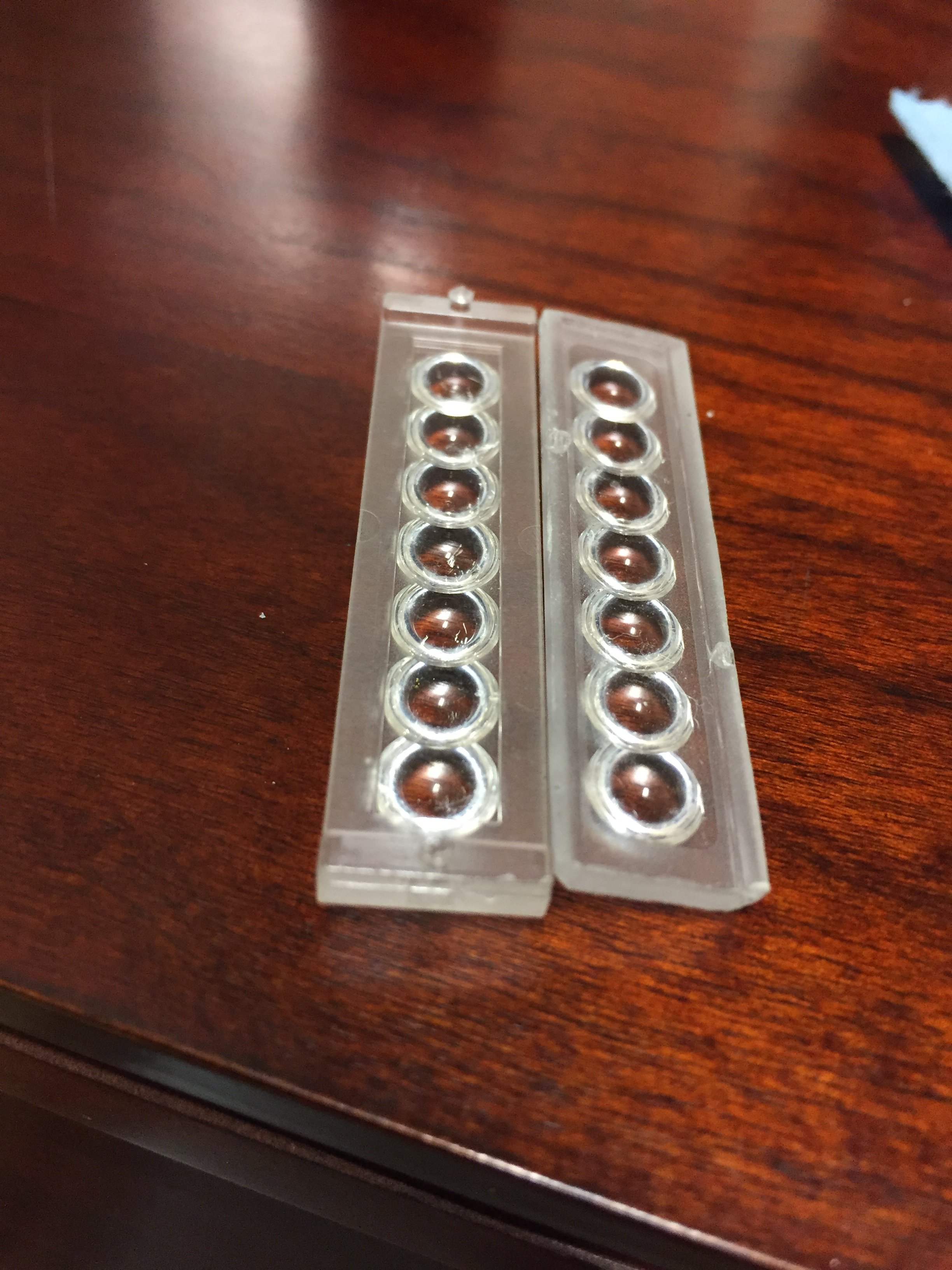

Mine came out of an Exactra 20. Some 20s actually have the TI backplate on the case, but this one was an EX-20. Picture attached for serial number and inspection marks in case their is any coordination to color of the pcb.
I was also asked about the windows that were mentioned. This is in reference to the back of the bubble strip. The strips that have the red rectangular LEDs under the bubbles have a smaller window, which is just the size of the bubbles themselves. The others have a large window that is the size of the bubble strip once you trim it for a Luke or Obi Wan saber.

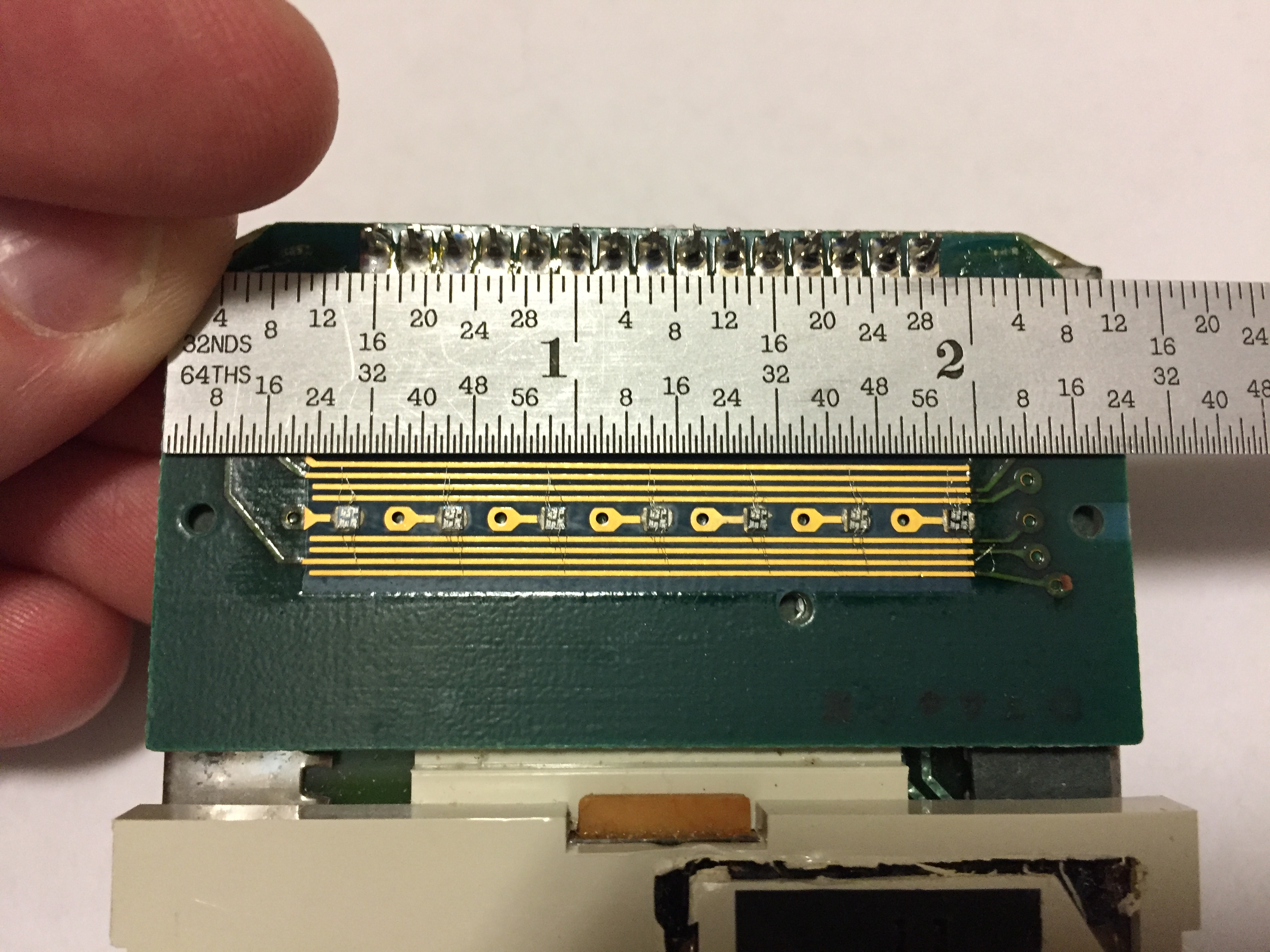

40mm long, and width will vary, so I'd make it the typical width or a real bumble strip

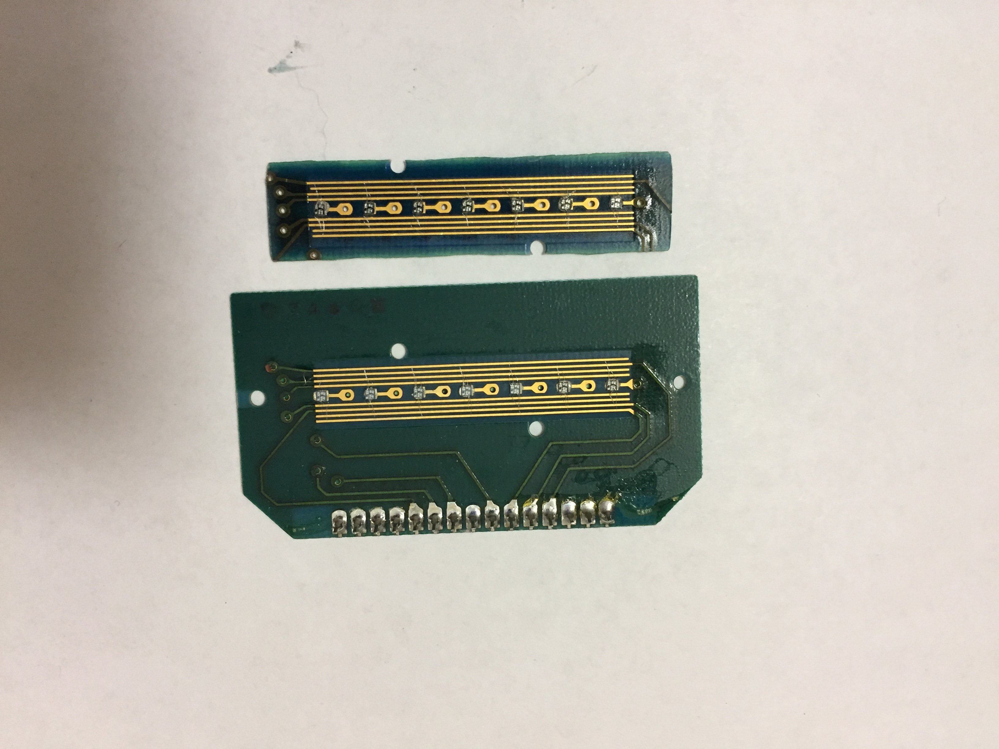

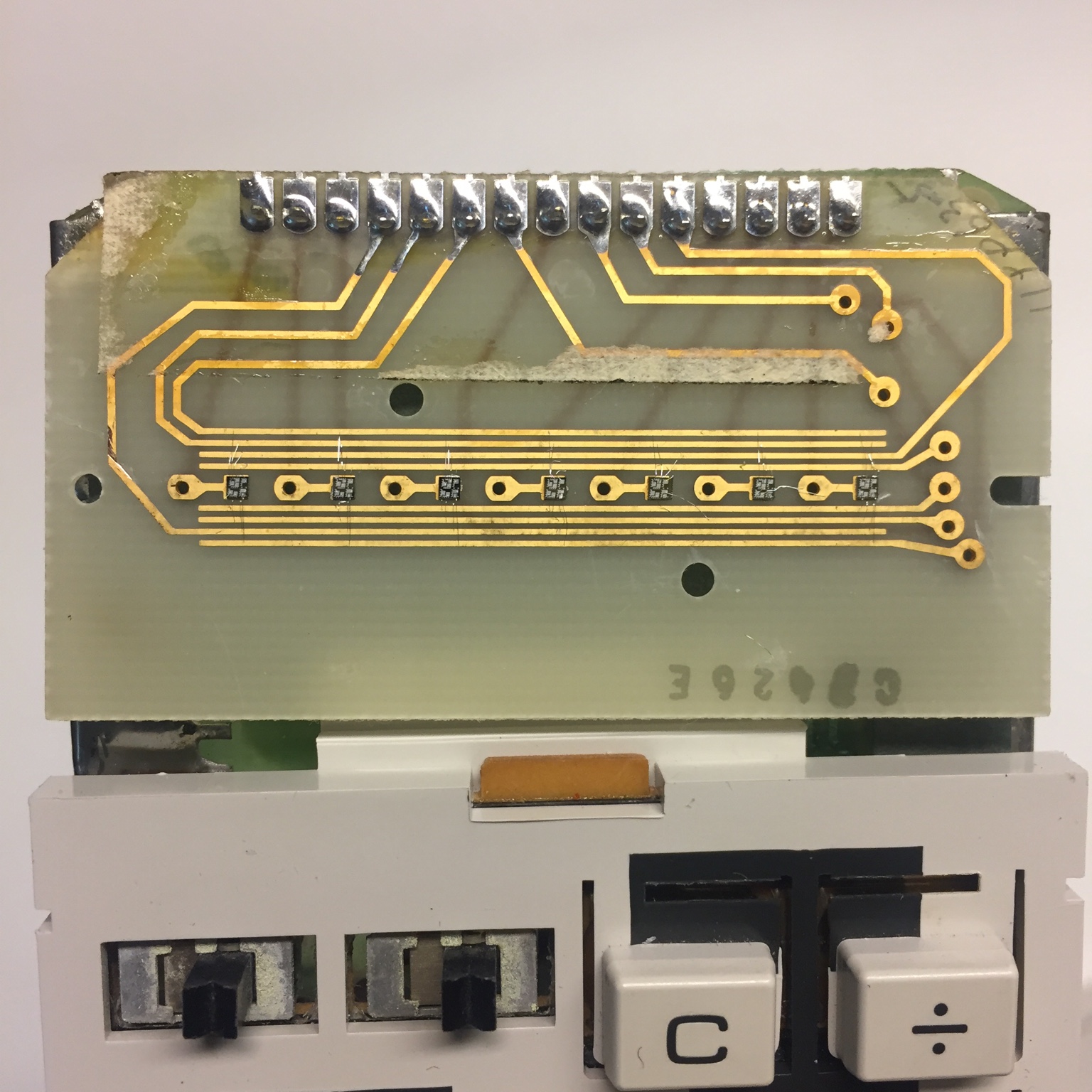

Here is a full card.
I think might be best to make it long for trimming.

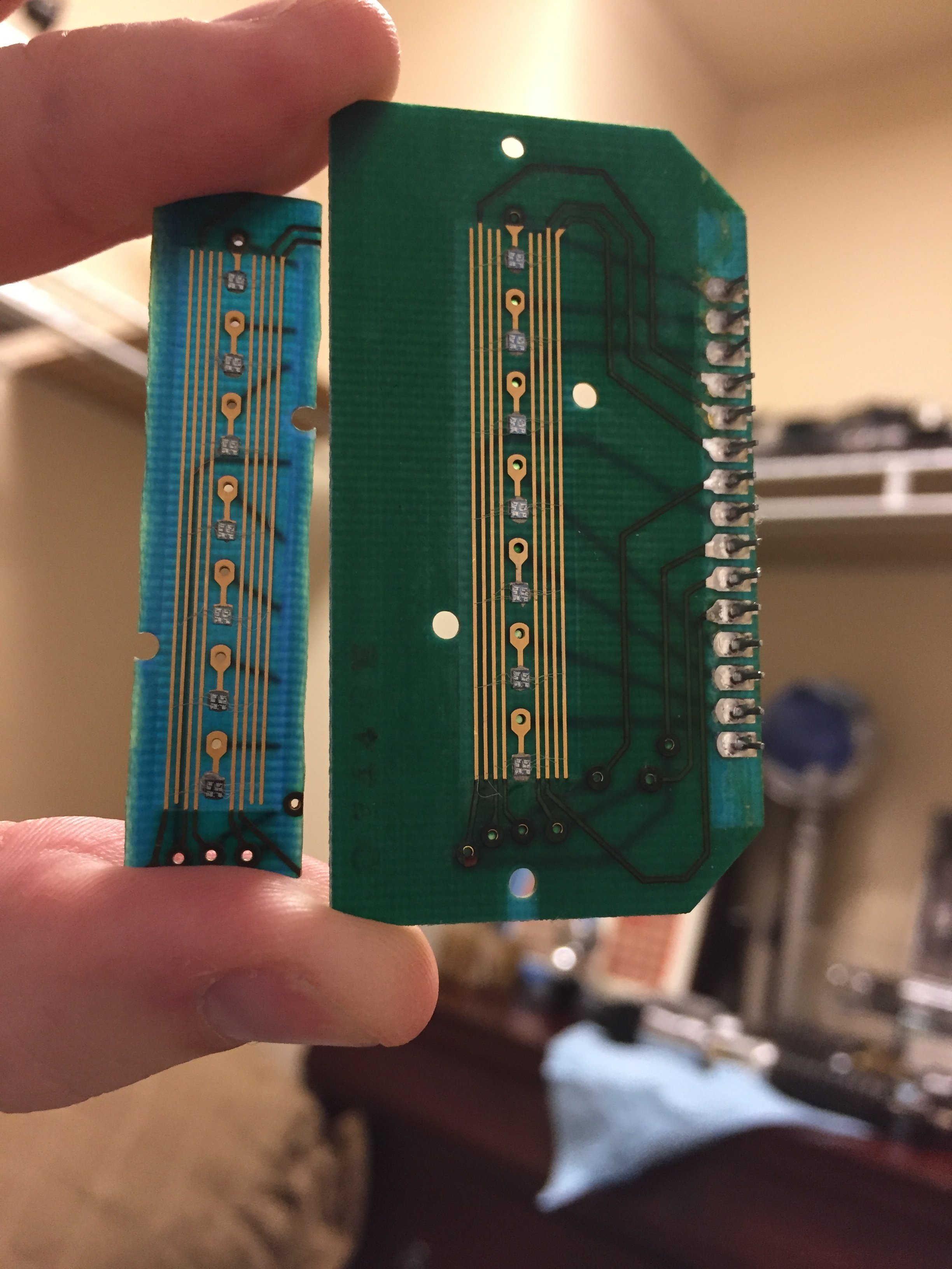

And color comparison.
I can send you one if that would help. I have a couple I'm not using at the moment.

I've got another weird color:
I have two of those, from Exactras 20.
The bubble strips have two additional bosses going in the small holes.

That would actually be very helpful. It will be really something to recreate one of these cards without having to do photoshop magic on blurry screen grabs.
looking at these photos, it'd probably be a good idea to recreate both sides. Since no other card layout is this size.
