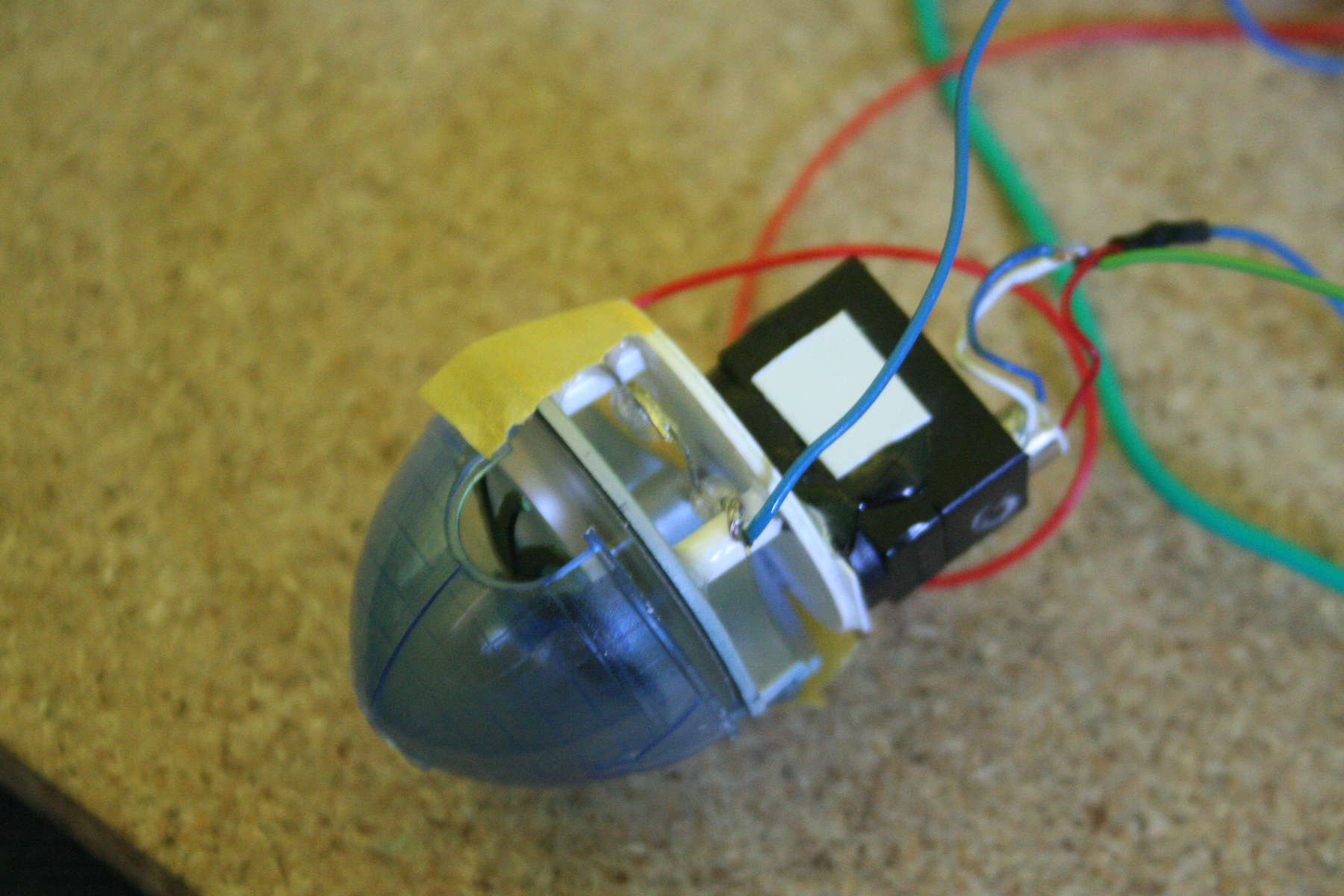

For the Bussards, I used two TOP-LINE MINI SERVO ES-05. I removed the control electronics and soldered the electro motors directly to 5V input voltage. One also has to remove a small stopping pin inside the housing which limits the angle of the servo lever.
Then I glued pieces of a cannula into the hole of the sprocket as an axis for the Bussard rotor. That's all.

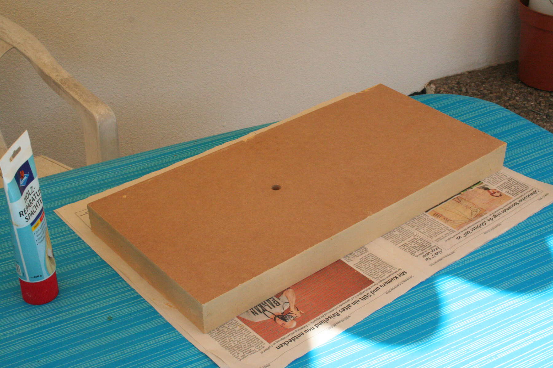

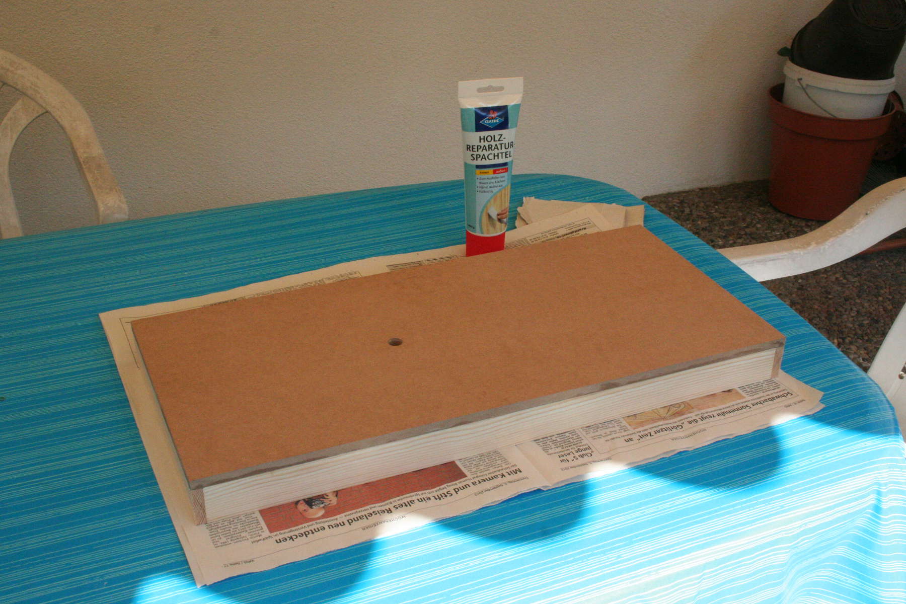

Some progress:
The base is glued together and puttied:
View attachment 228769View attachment 228770

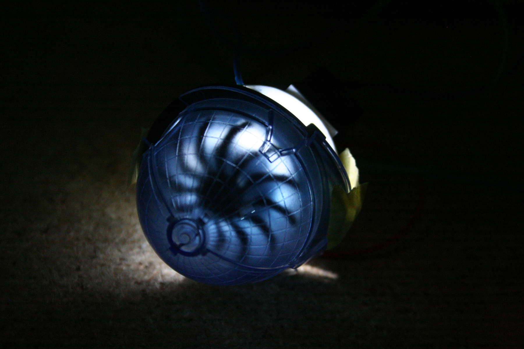

The bussard collectors are nearly finished, I just need to paint the details on the domes. Here are two pictures of the layout:
View attachment 228771View attachment 228772
The light is provided by two white LEDs on each nacelle. They illuminate a light box in front of the motor housing.
Here is a short video clip to show it in action (sorry for the bad quality, I don't have a video camera.):
Bussard_collector_test_20130907.mp4 Video by Herr_Bpunkt | Photobucket
The blades don't rotate so fast as it looks in the video, I really like the speed.
Yes, the sound of the gears is awful. But noone can hear it in space ;)
