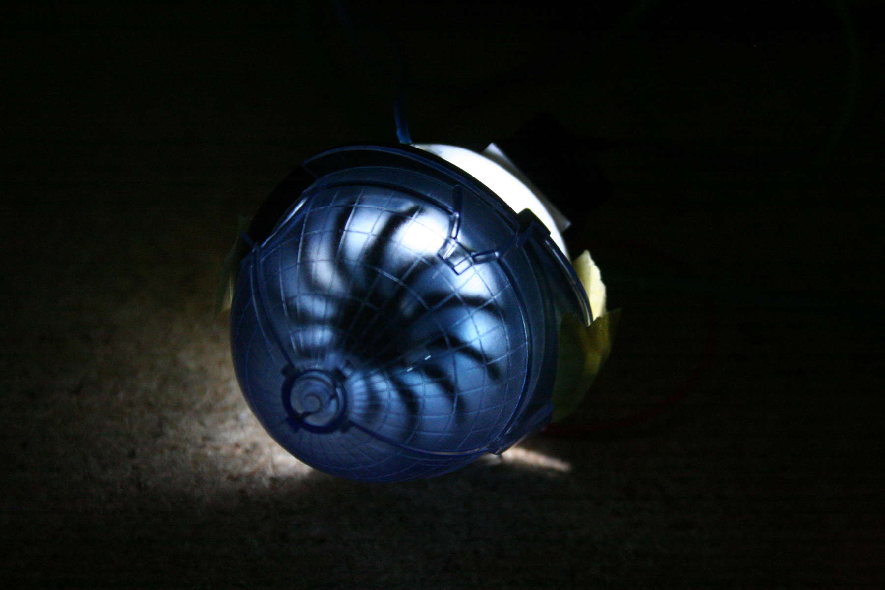

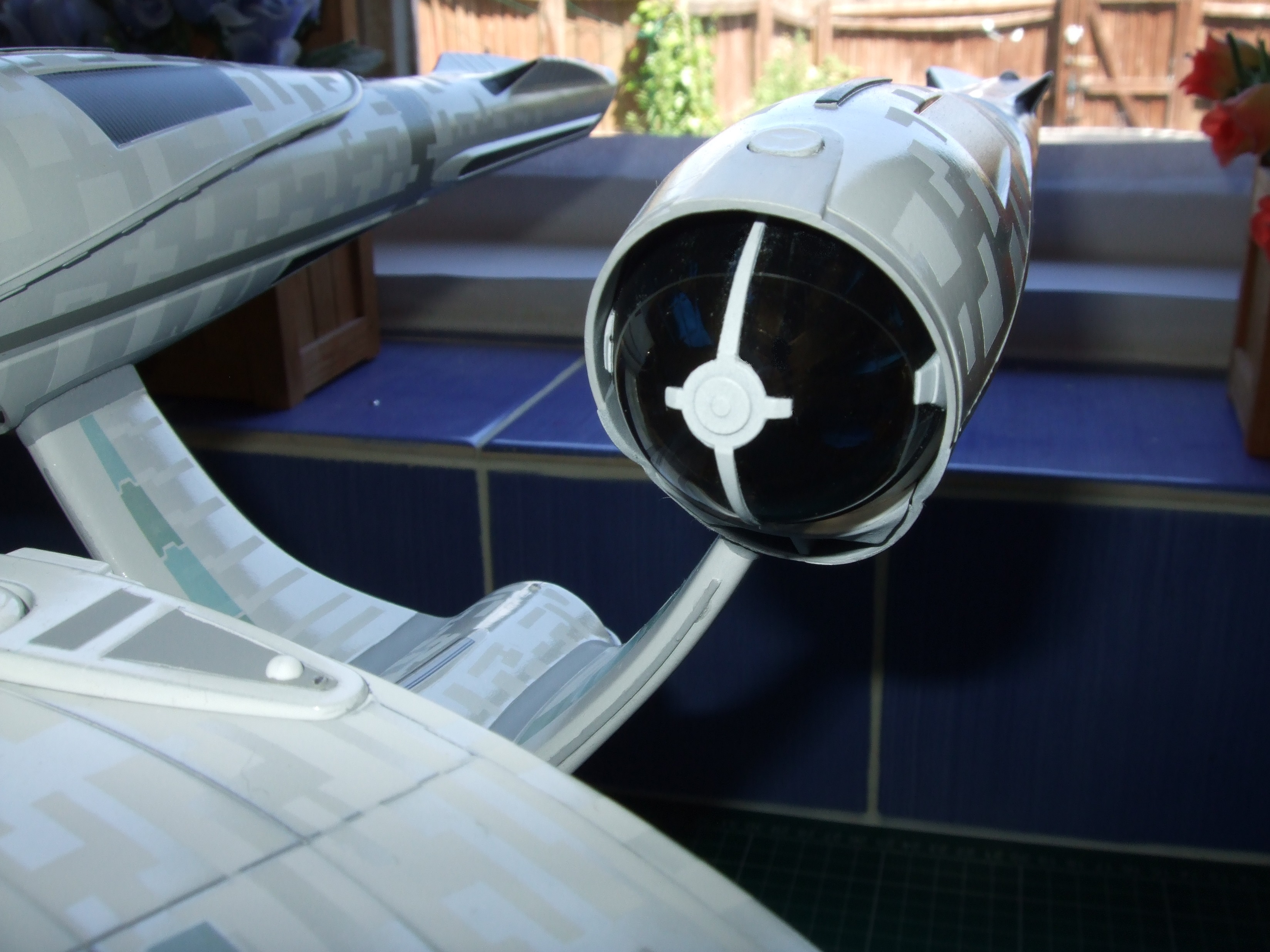

Hello I have just come across this site and nice build you are doing there, A suggestion with the clear bussard covers why not tint them from the inside with Tamiya clear smoke paint as I did, everyone seems to using blue on them but they are only lit up blue and should still remain clear so you can see the fan/blade/spinners. I put on two coats of the smoke paint to give it a dark tint but still allow the light to clearly come through, when all the lights are turned off I think the bussards look very smart! they almost black.

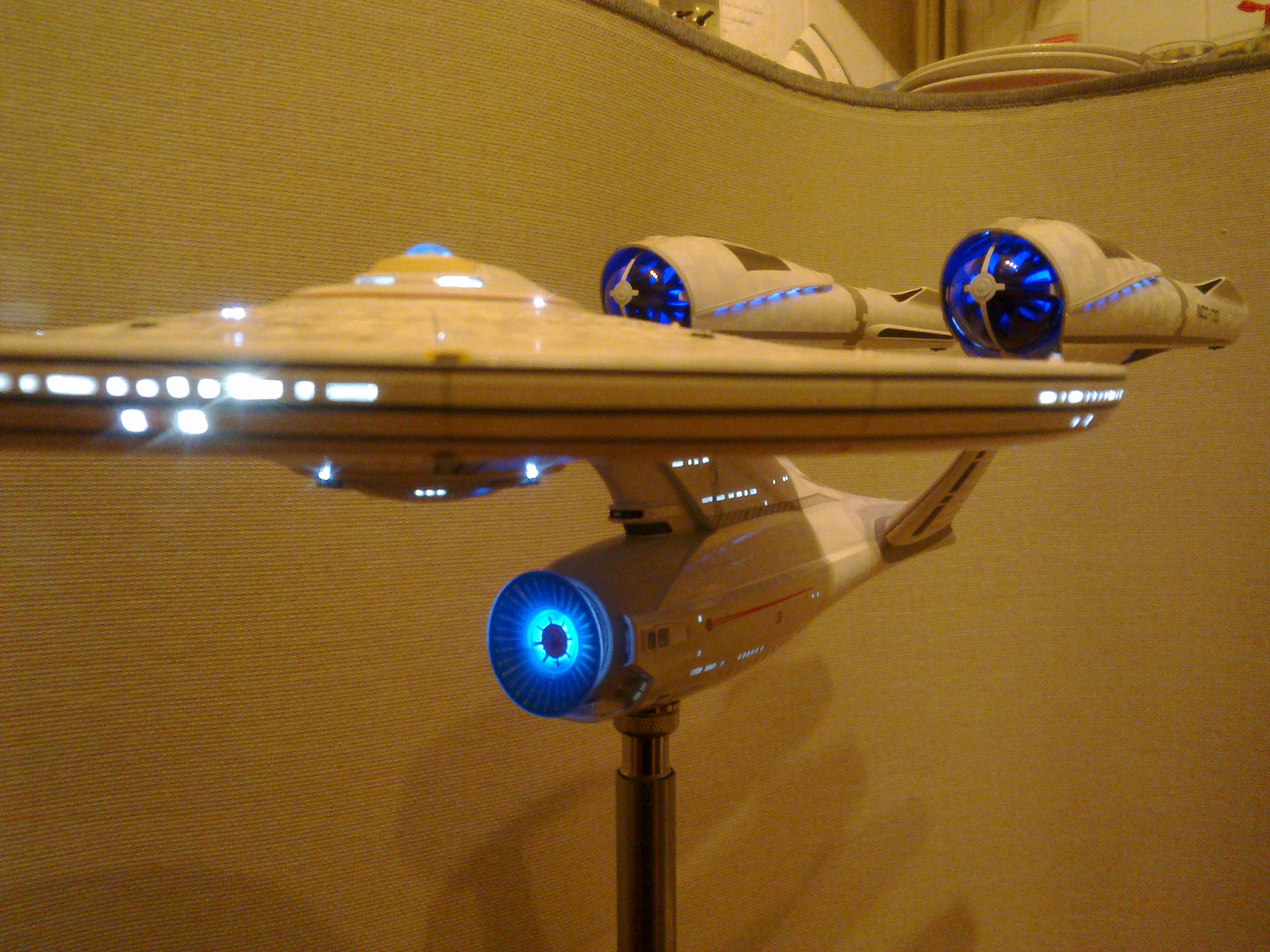

I never thought of using SMD led's before as I used fibre optic cable for my spot lights and like the look they give, ok not perfect but and easy install.

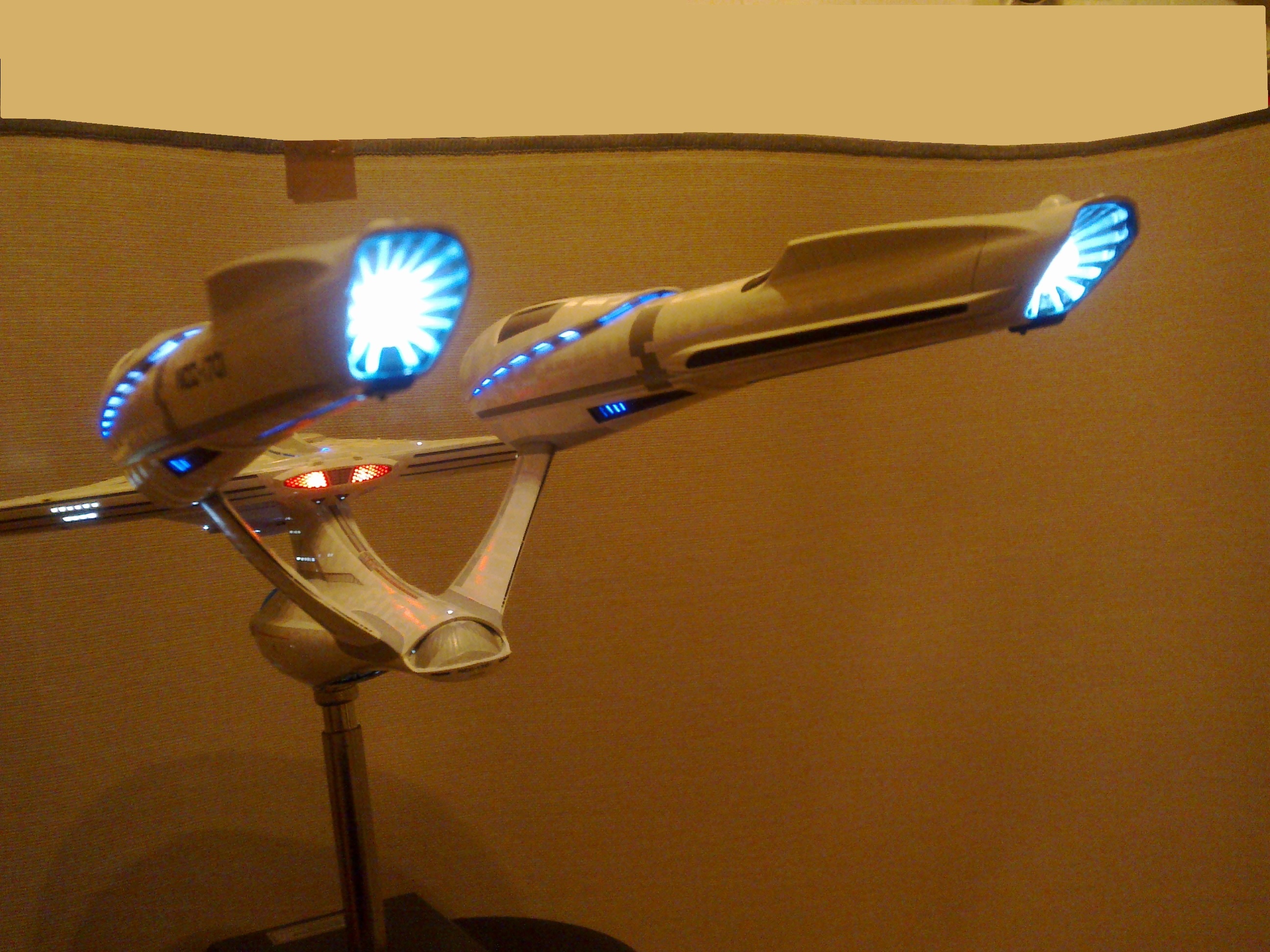

I had a major headache to trying to get the main deflector dish to light up correctly.

At last, someone had the idea. Not lighting mine but I used Tamiya Clear Smoke on the inside of the bussards.

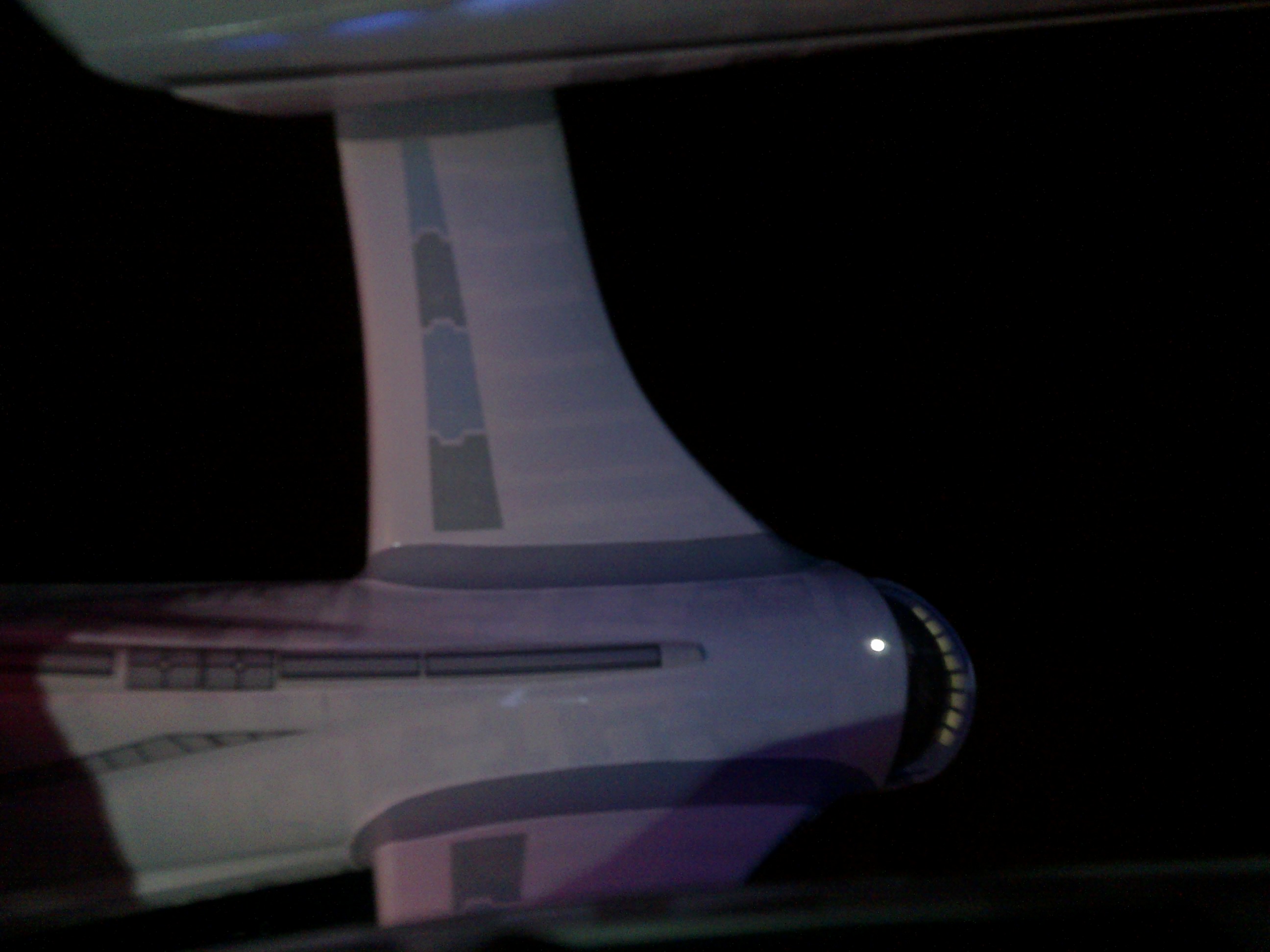

yes I had this idea a long time ago about 3 years ago in fact when playmates released the toy version of the ship as it to has a smoke tint effect to the bussards and I always liked that look, here is another look at one of my warp engines before it was attached to the model.

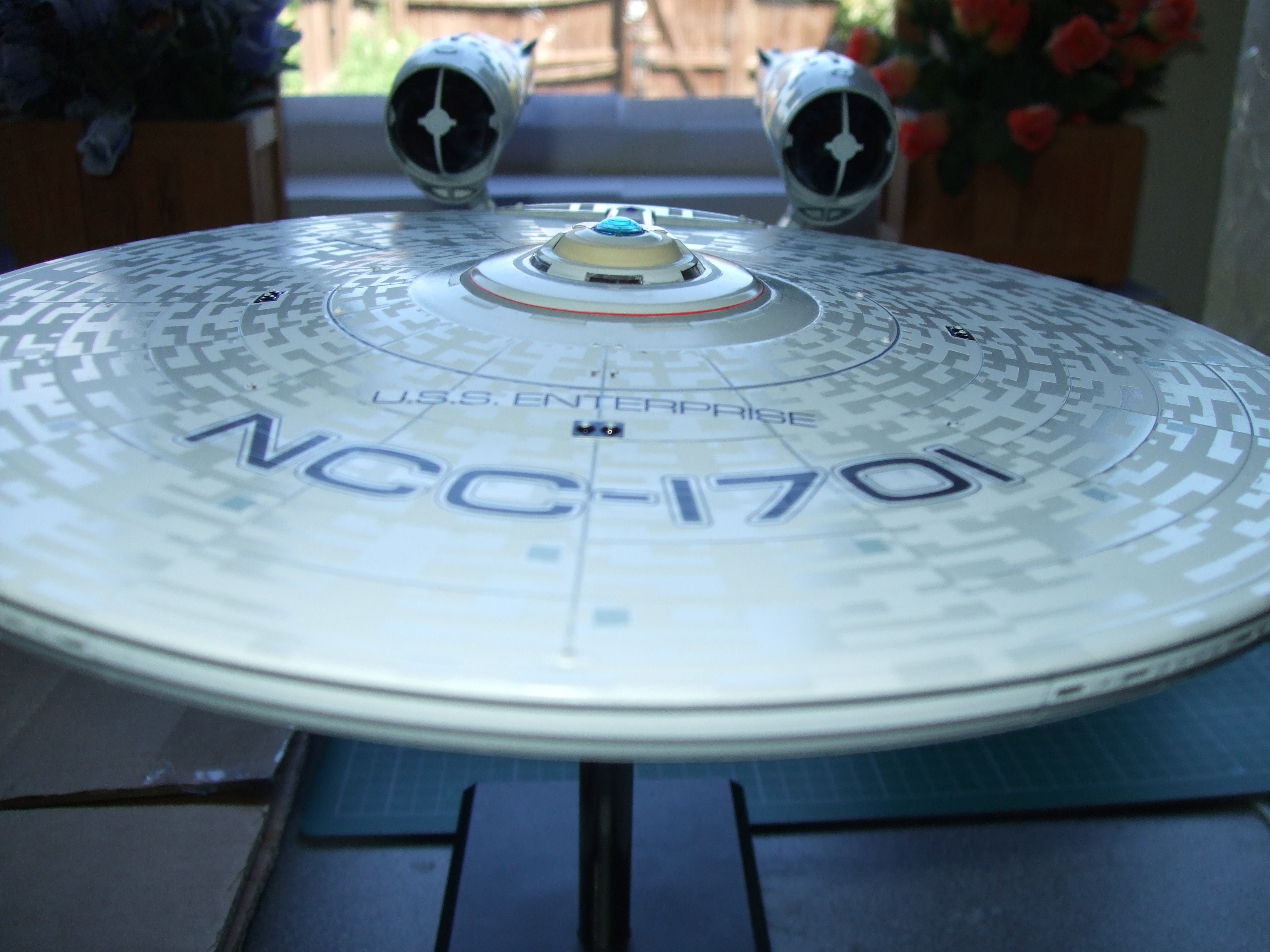

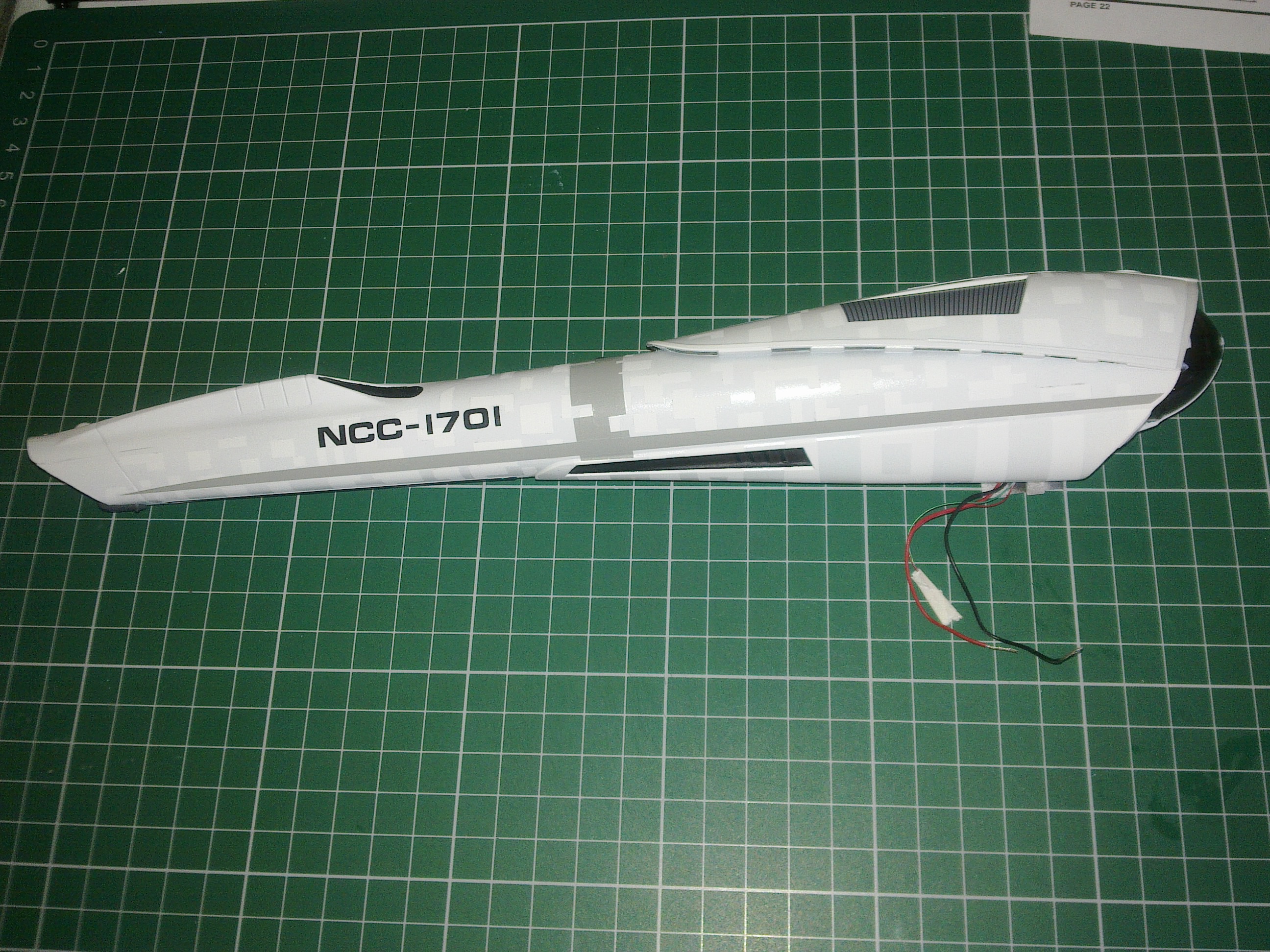

Another front view picture showing the Aztec panel effect Which I personally like as it can clearly be seen but without looking to busy and keeping the model looking clean and smart.

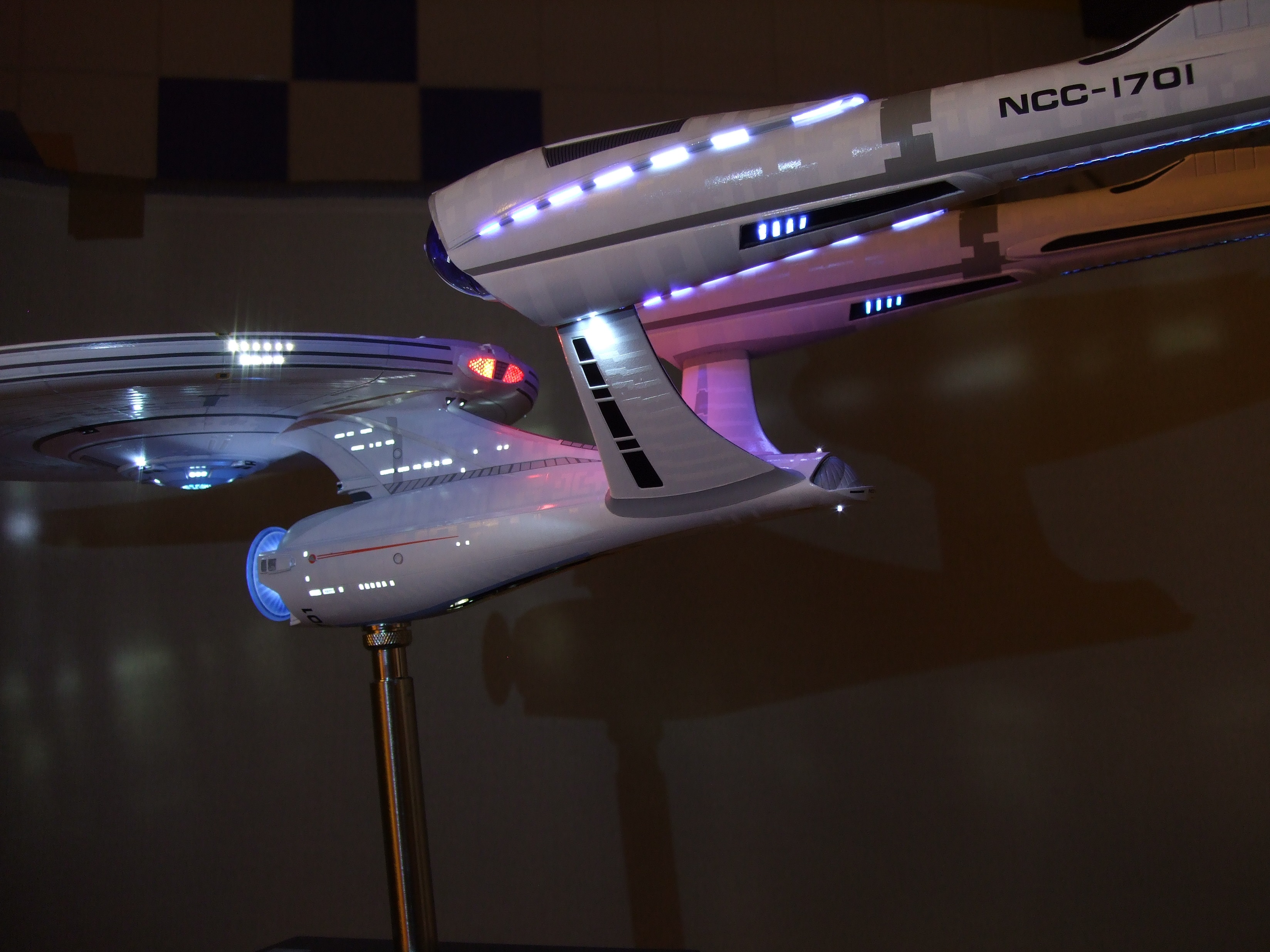

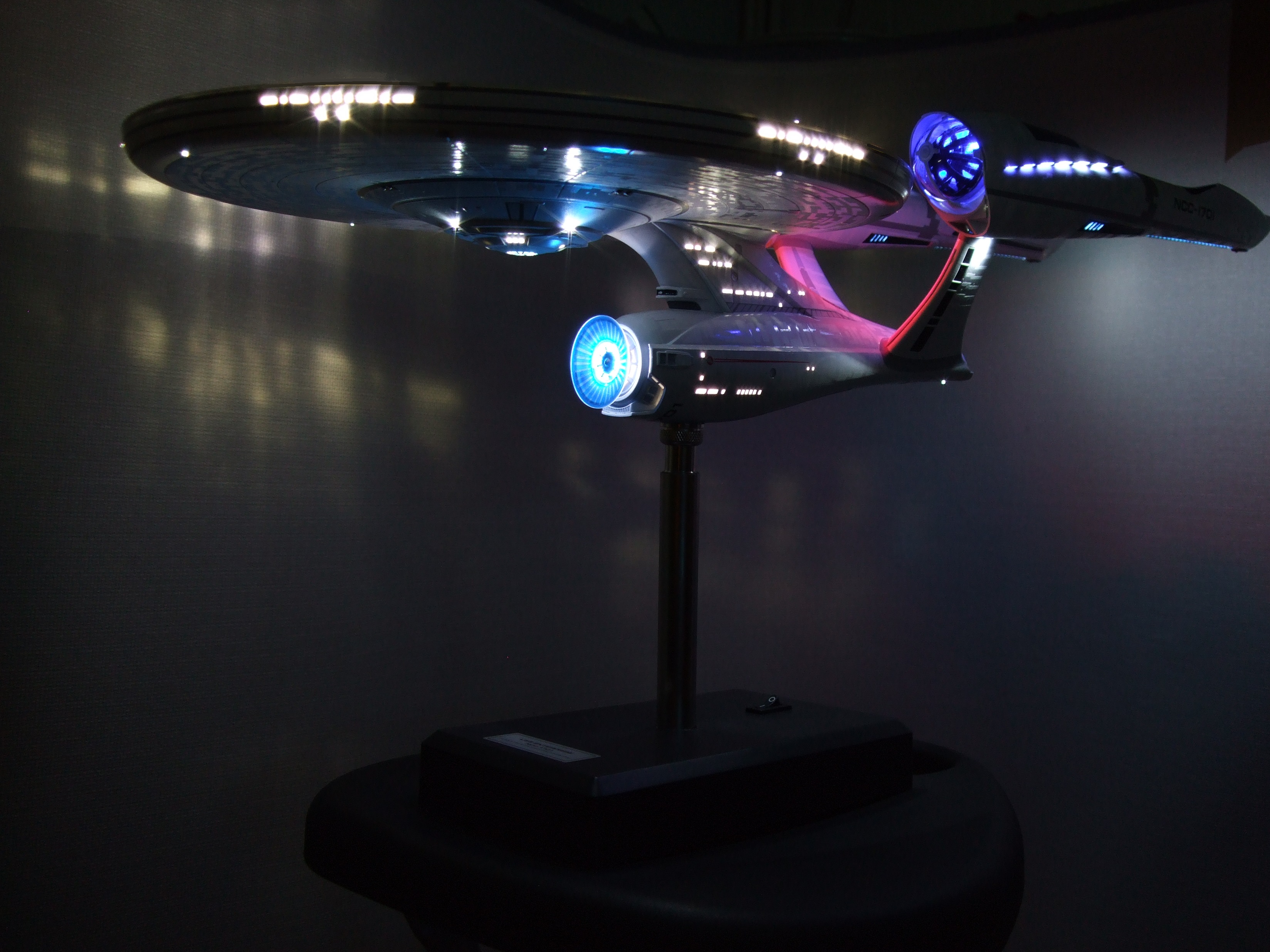

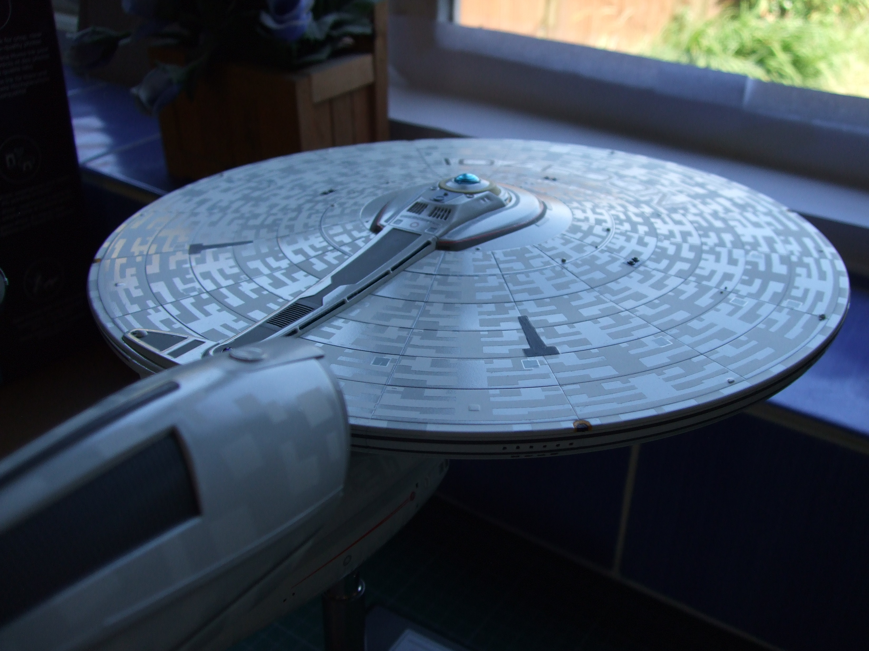

Here is some more pictures, the Aztec panel effect was done using just a gloss base paint then second layer of matt which gives a reasonable effect, in the pictures i have taken photos in different lighting conditions to show what it looks like, the deflector dish did have a copper colour to it but the light did not disperse enough so off it had to come.

Daayuummmm. Did you mask the aztecing off? I'm interested to know a little more about how you did it
Hi I am not sure what you mean by mask everything off? but if you want to how did I do the Aztecing then I painstakingly made up my own Aztec paint masks as there was not any on sale anywhere in the world at the time I built this model which I finished back in June, right onto the effect-I sprayed the entire model in a gloss off white base colour then once fully dry I placed all the Aztecing masks to it then sprayed my second layer which was a matt white again once dry I carefully removed all the Aztecing masks leaving a crisp clean panelling effect, the difference between the gloss off white and the matt white is perfect and not to busy but just enough to make it look the business, and everything that I did not want the Aztecing on was indeed masked off, Hope this answers your question but if you need any help just keep firing away and I will try my best.:)

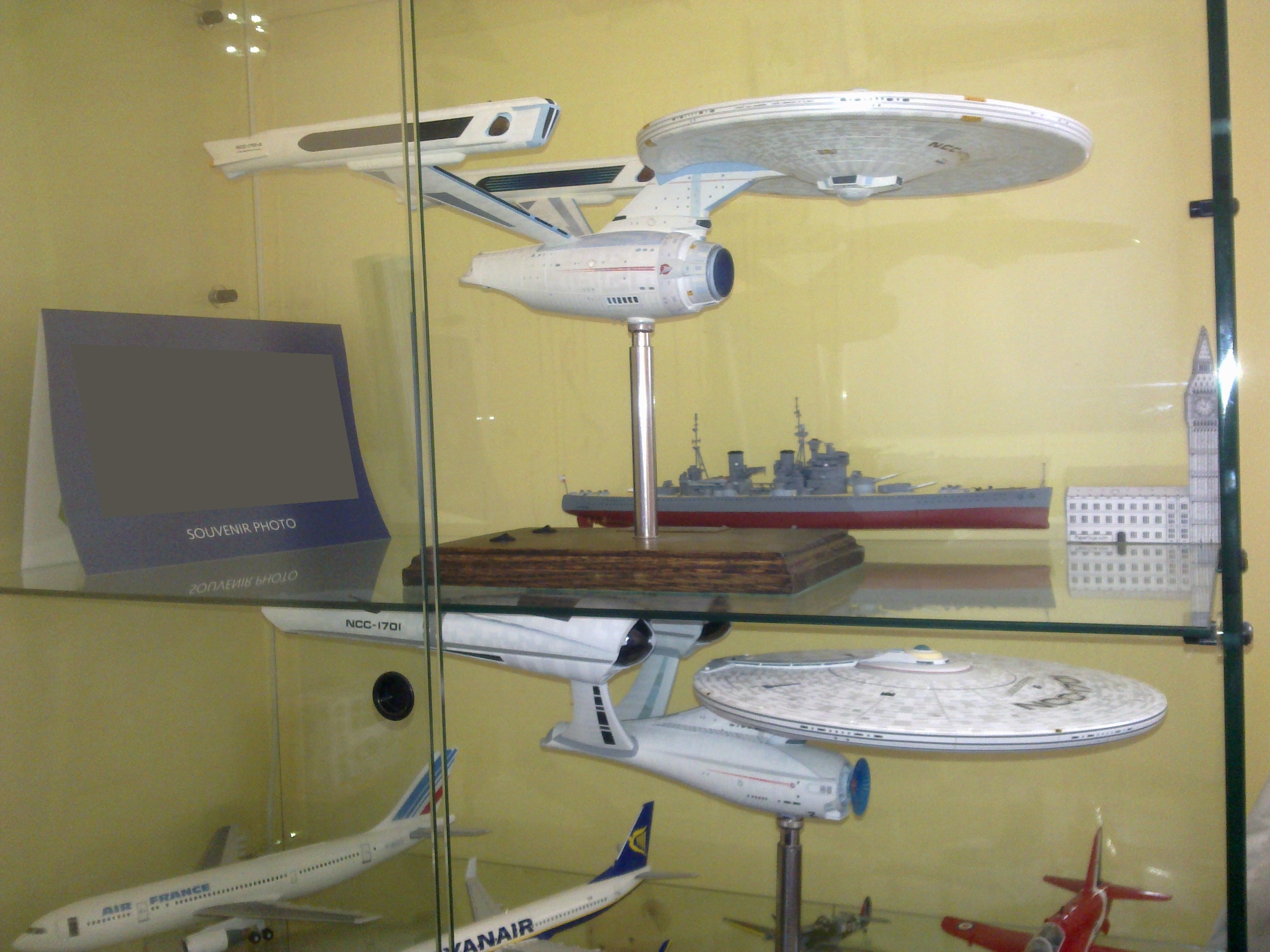

Here was my last photo of it underneath my cherished AMT ERTL Refit Enterprise in my display cabinet.
PS I sold the model to a client and no longer have it but do still have some photos of it.
I do like the fact that you limited the Aztec pattern to two colours. Although there are some incredible Enterprise models on this site i often wonder if all of the different colours used take something away from the quality of the model, despite being fantastically complicated paint jobs. Two colours is fine by me.
I totally agree with you and for this size of a model using different shades of iridescent/pearlescent colours for the Aztec would look to busy for my liking but it does look awesome on the larger 1/350 Polar Lights Refit Enterprise :)

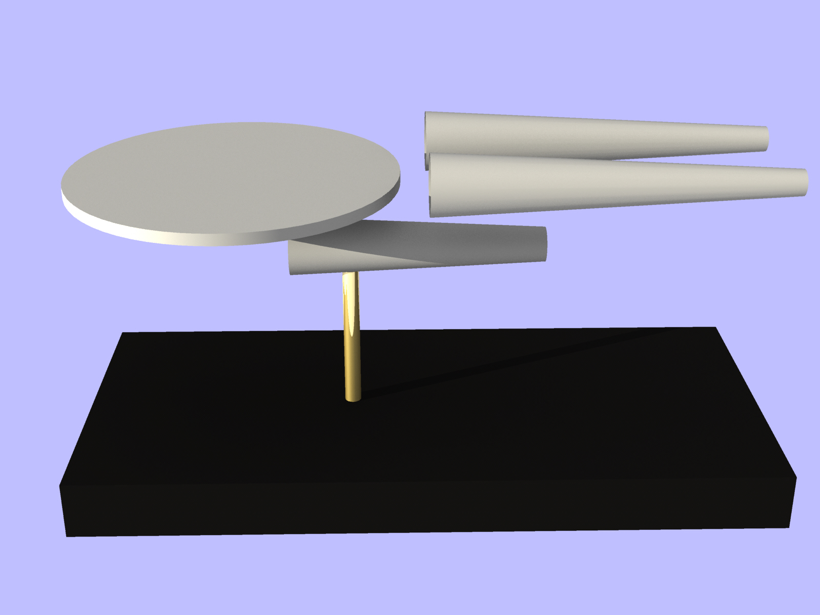

Today I bought the materials for the stand. When completed, I hope that it will look like this:
The buttons will be added in a row on the top surface, the power input on the backside.

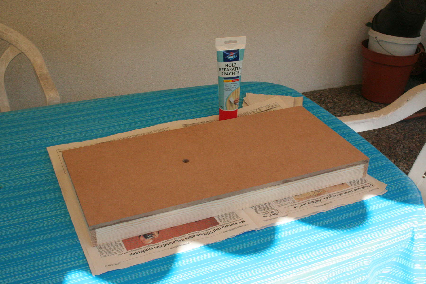

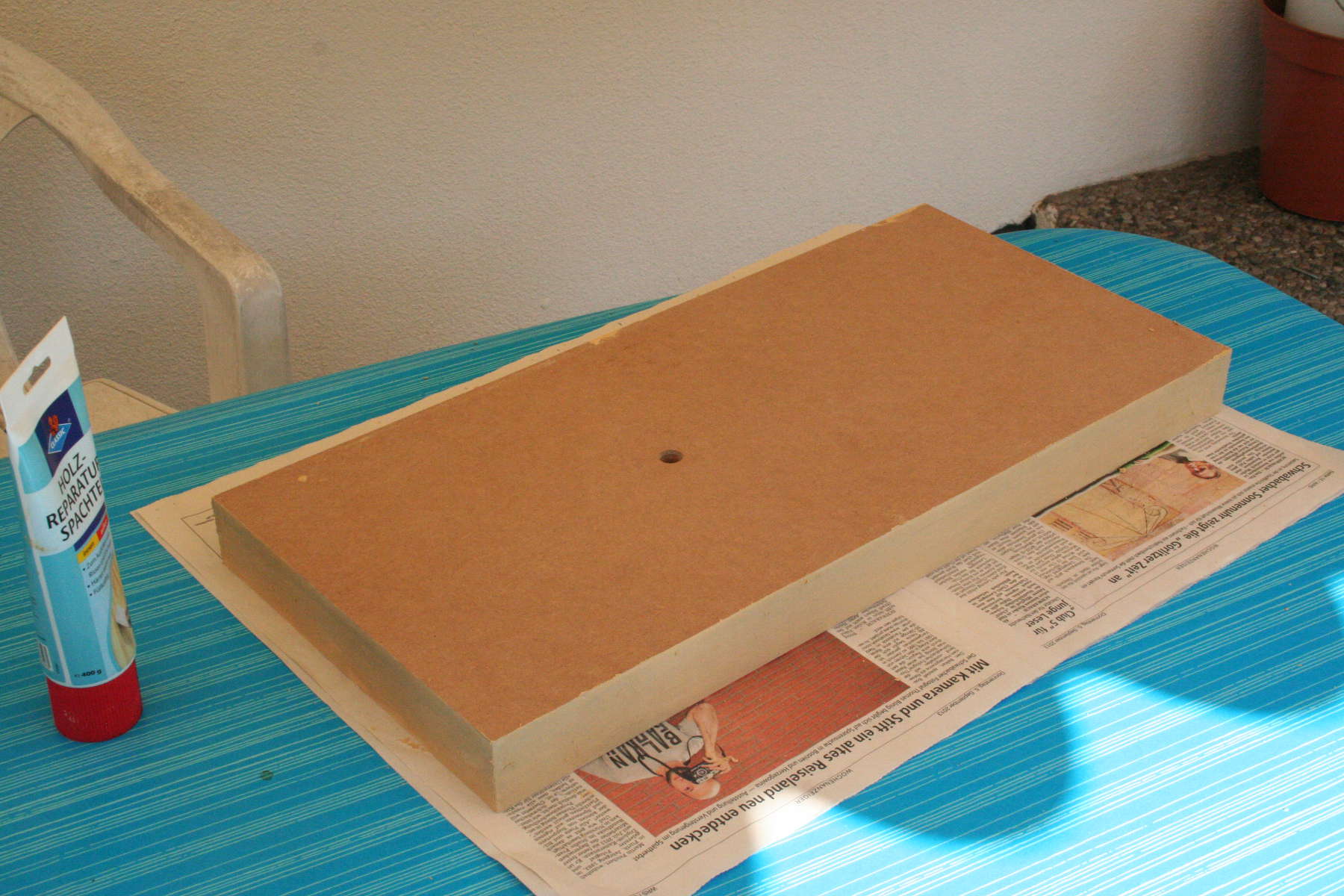

The base is glued together and puttied:

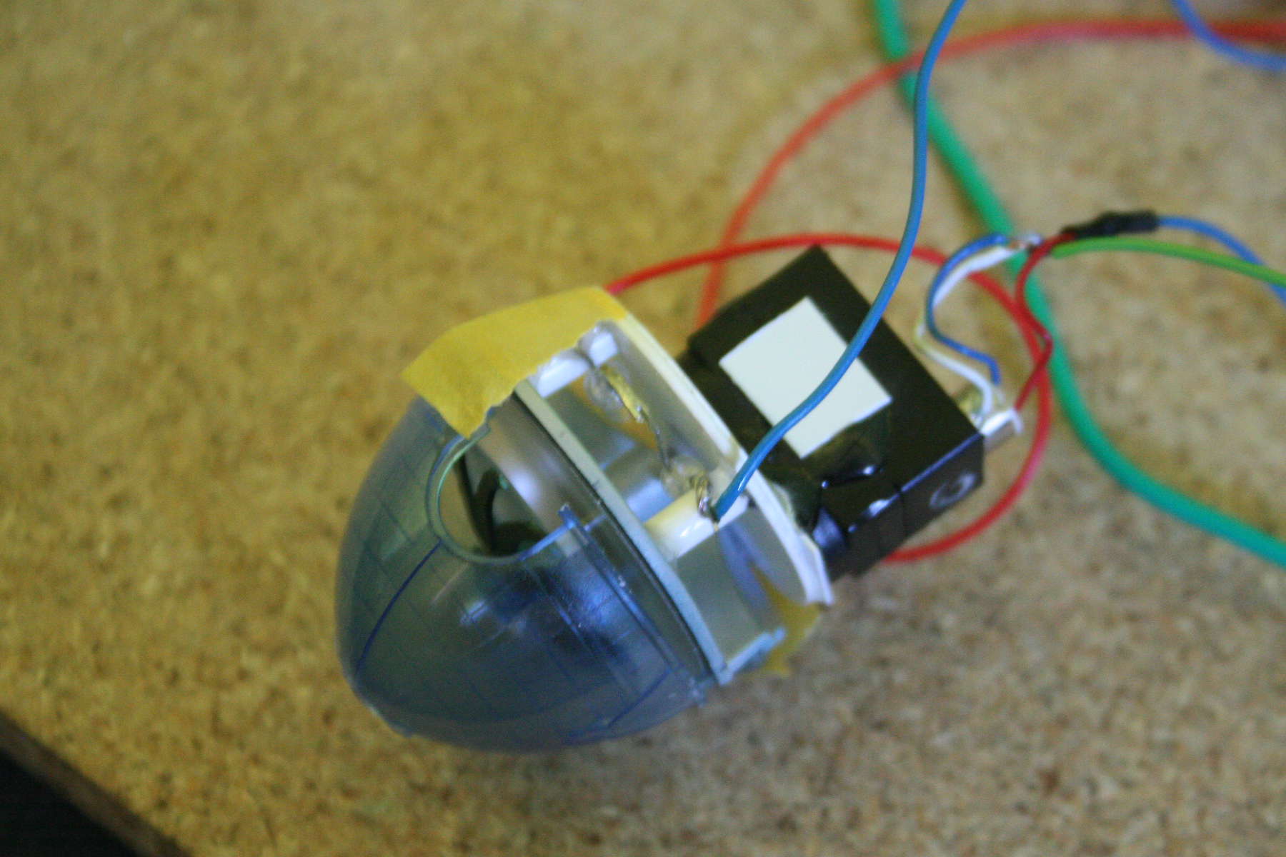

The bussard collectors are nearly finished, I just need to paint the details on the domes. Here are two pictures of the layout:
The light is provided by two white LEDs on each nacelle. They illuminate a light box in front of the motor housing.
View attachment 228771View attachment 228772

Thanks! I hope the base will be just that black cuboid as on the sketch with the switches, I don't want it to distract from the model itself. I have sanded it this afternoon but will need a second round of putty an dsanding tomorrow before I can add the black color to it.
