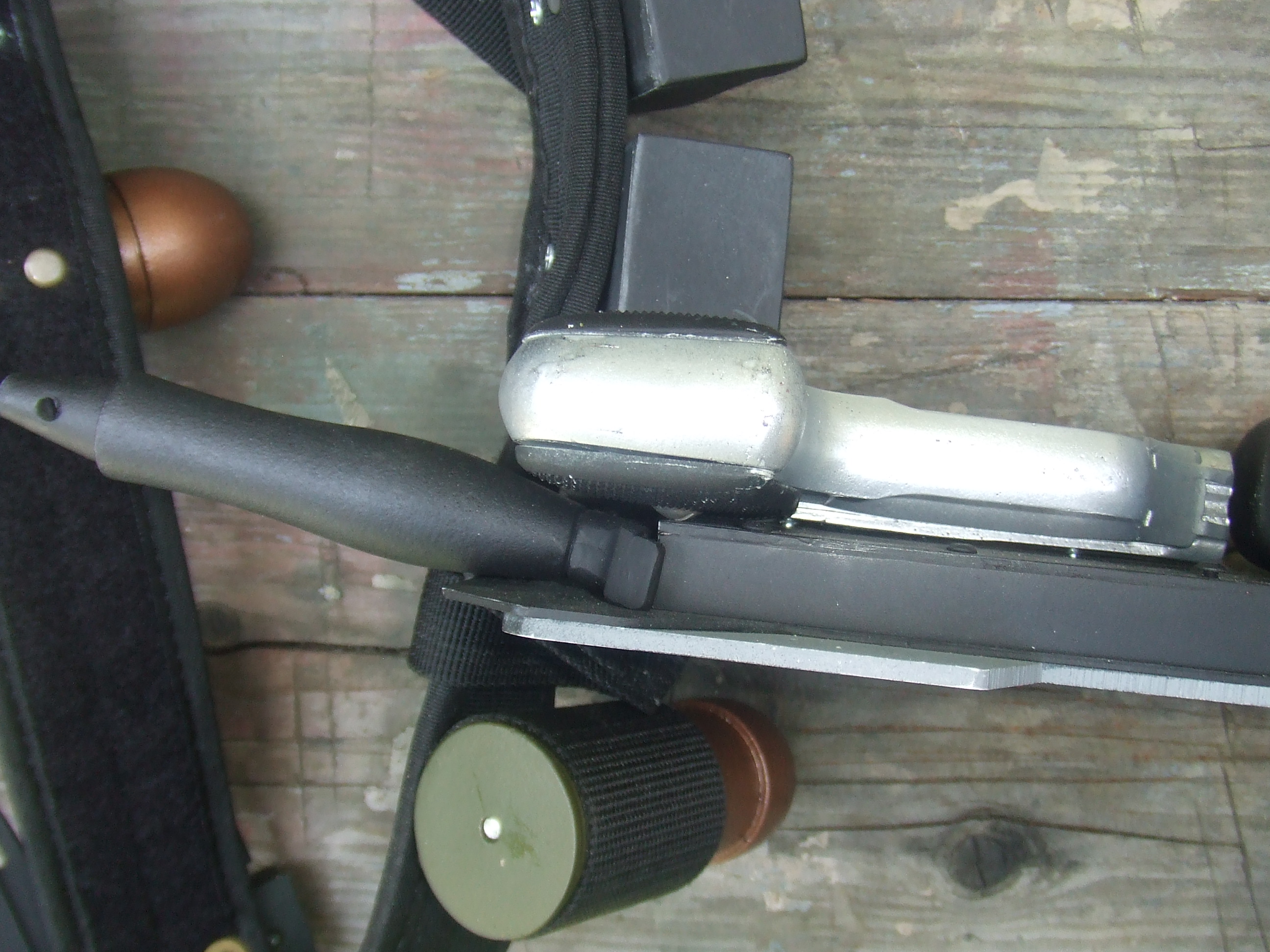

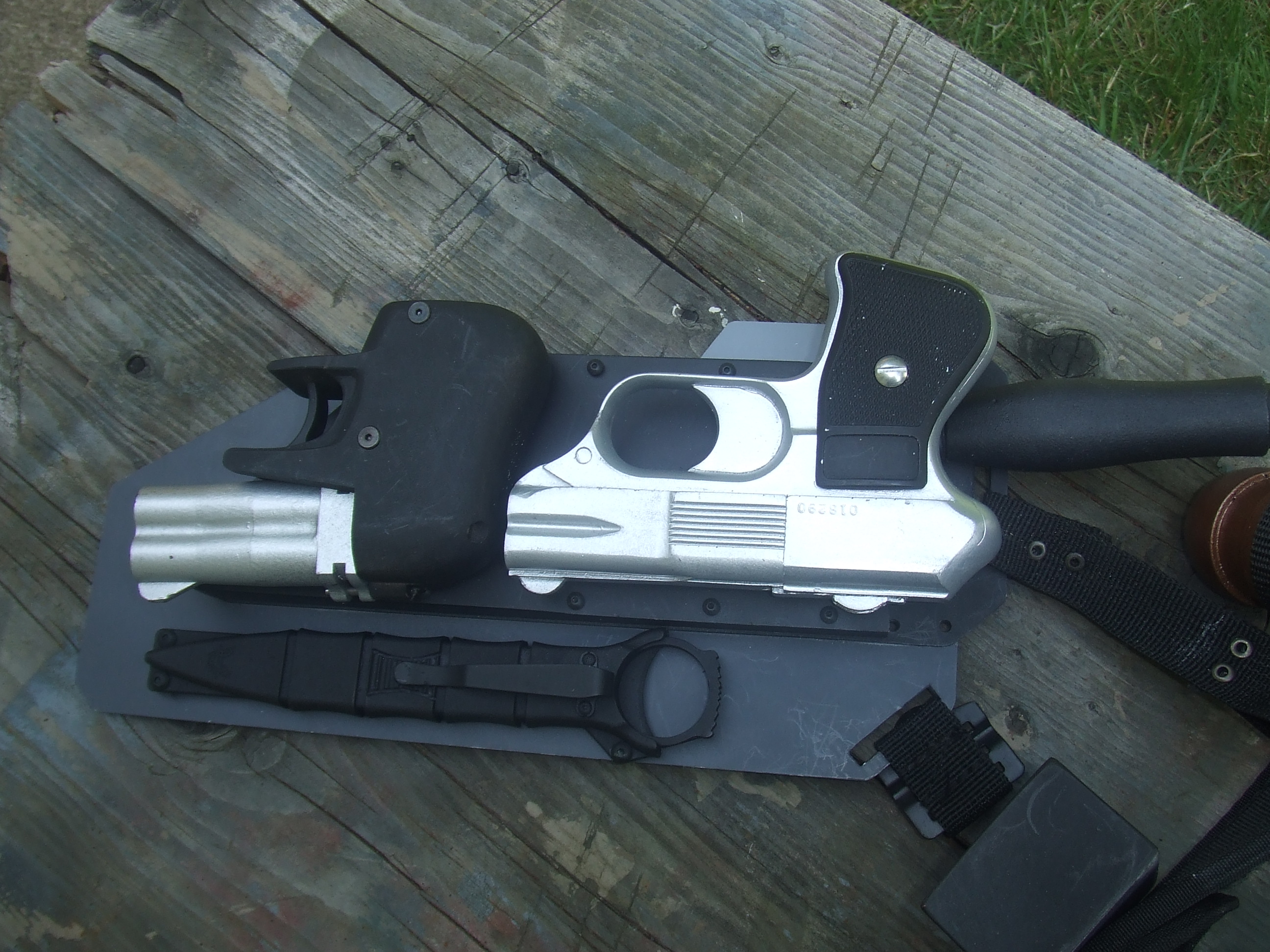

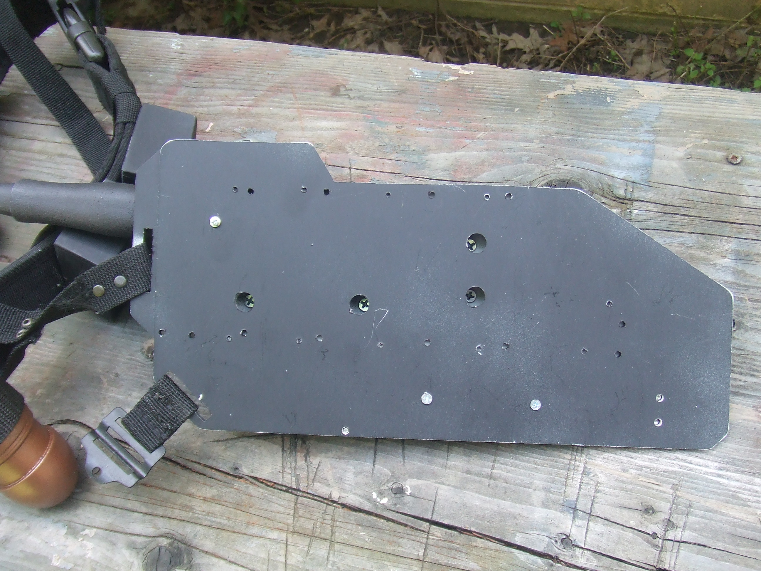

The right side holster is made of .125" plastic sheet. Glued and screwed together. The guns are held on by screws from the back as is the benchmade, because they are all resin.
The gerber fits in a slot behind the COP .357 That I built into the holster during construction. The blade on the gerber casting is only about 1 inch (enough to keep it in the holster) and secured from behind with a screw. 2014_0612ella0010.JPG2014_0612ella0007.JPG2014_0612ella0006.JPG
No. It's resin but I got it on Amazon. It's called "Blade Runner Leon's pistol" or you can search with "cop .357". All I did was paint it and put real screws in the grip panels.

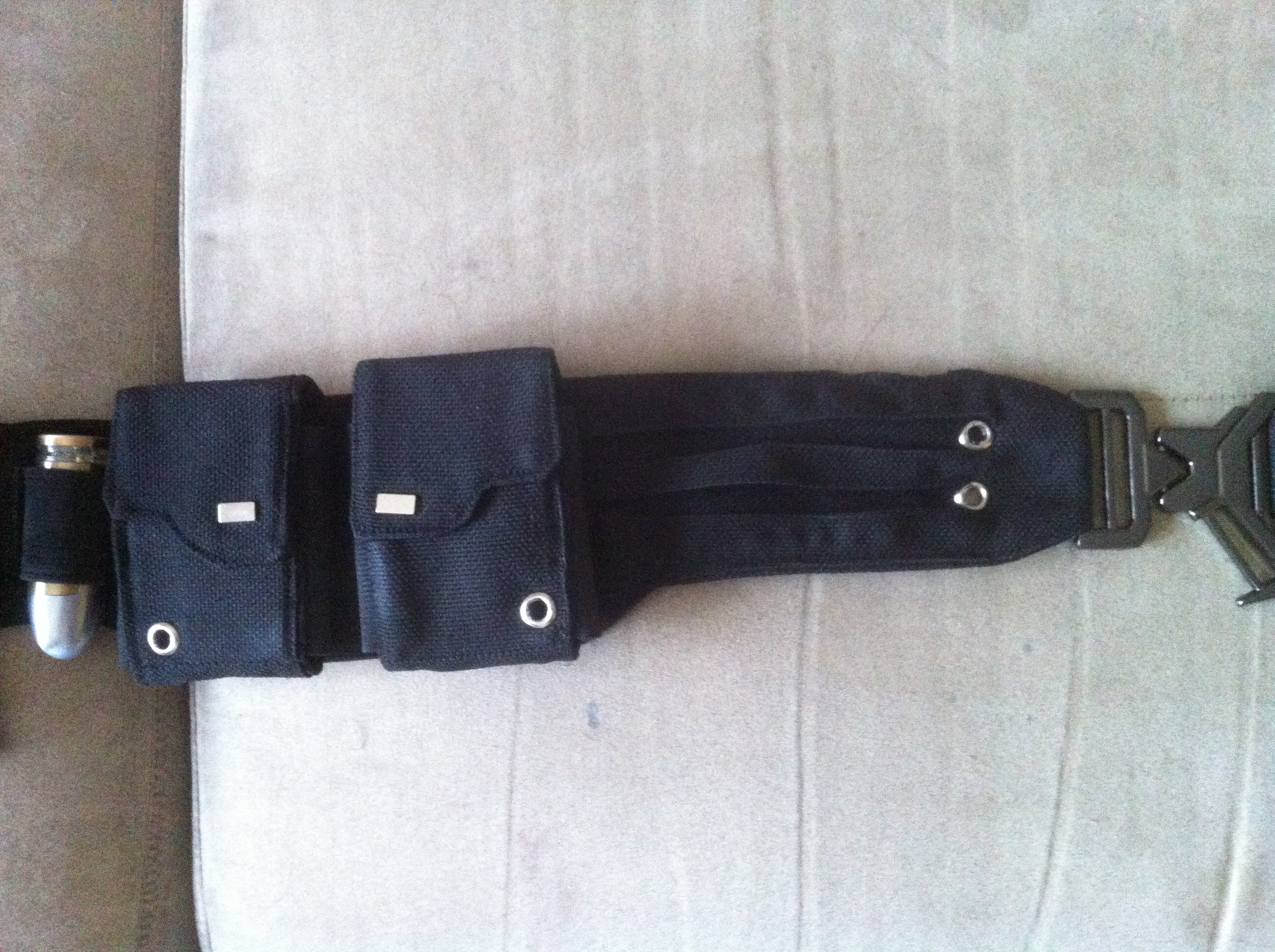

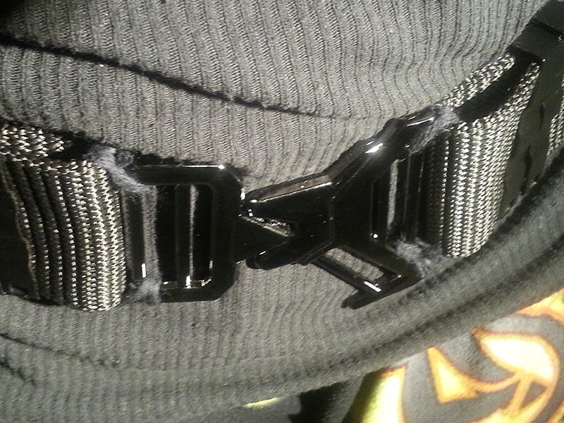

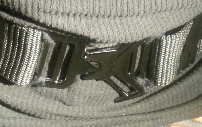

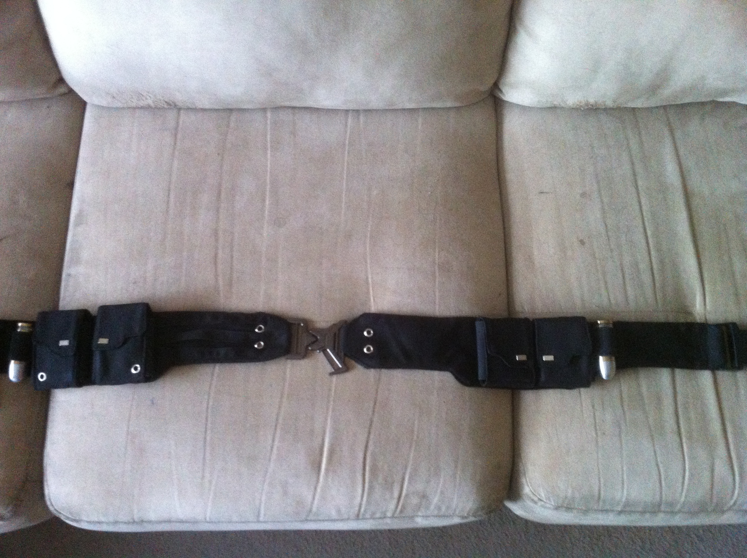

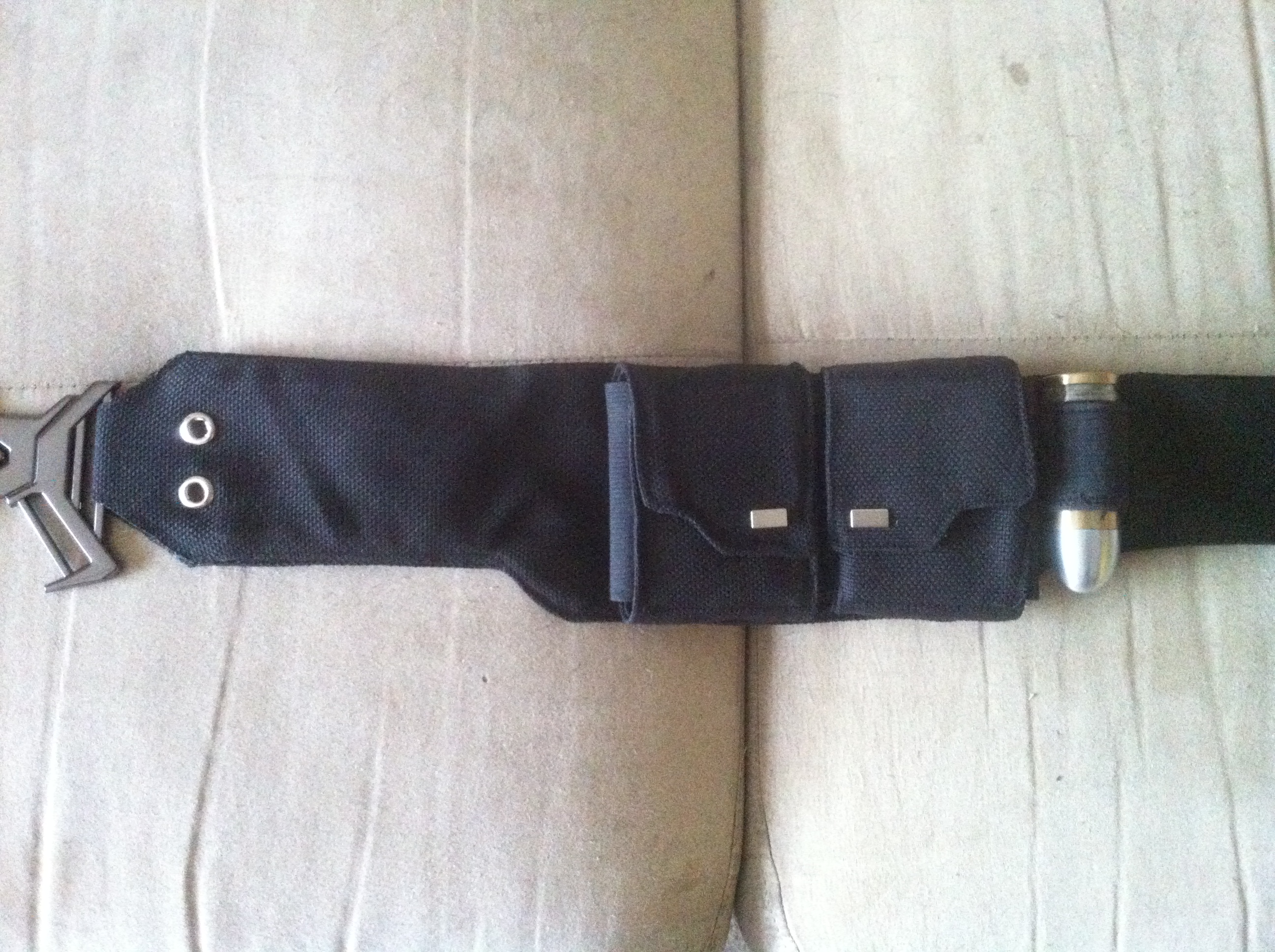

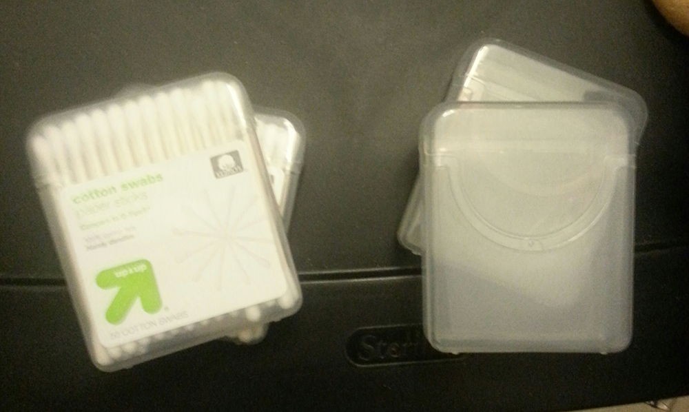

so i also ordered the metal buckle some time ago and it finally arrived yesterday. and also like the previous review, i took photos to try to show that it really is not as light colored as in the stock photos. if there was such a color as "black chrome" then this is it. it is very durable as i have already dropped it several times by accident, however the finish on it is not. as i toyed around with it trying to figure out how to attach it to a MOLLE belt (the buckle is not meant for belts this wide) i managed to nick the surface in some areas and the original (lighter and sort of yellowish) metal underneath shows. however it's not enough to really bother me as it doesn't really seem to show up in the photos. the nicks are very very small.
for the pouches, i am adamant about them actually being functional so i bought some q-tip holders and i am just going to paint those black and attach them to the belt with velcro or elastic. also i ended up attaching the buckle to the belt with yarn. the belt stays on very well but it is not screen accurate, more like "loosely based on it." i am more concerned with it being durable at this point and being made out of "real belt parts" so it could hold up to everything it had to carry (grenades, Y strap holster, tanto knives, etc)

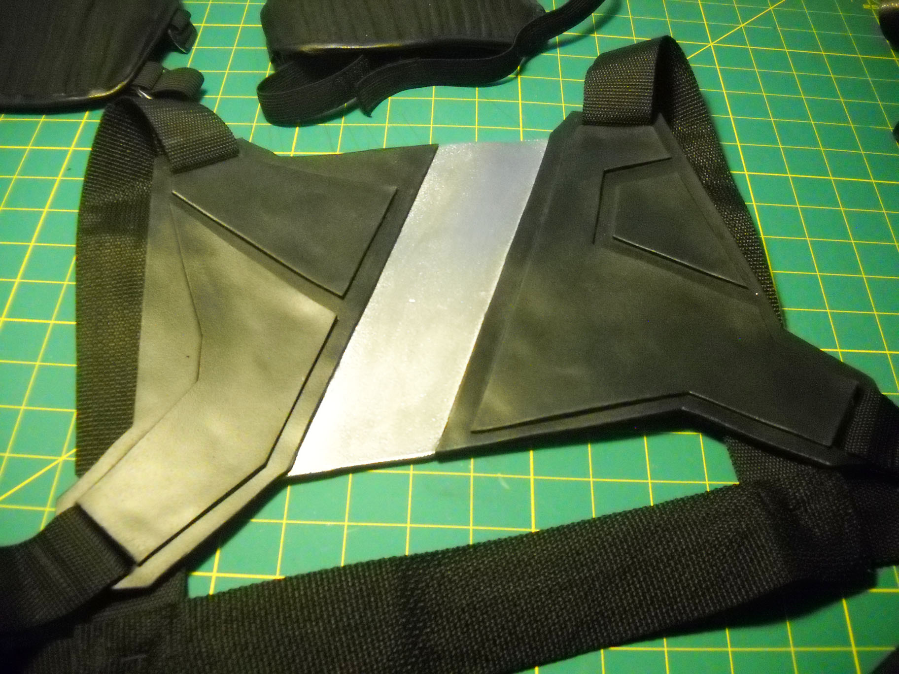

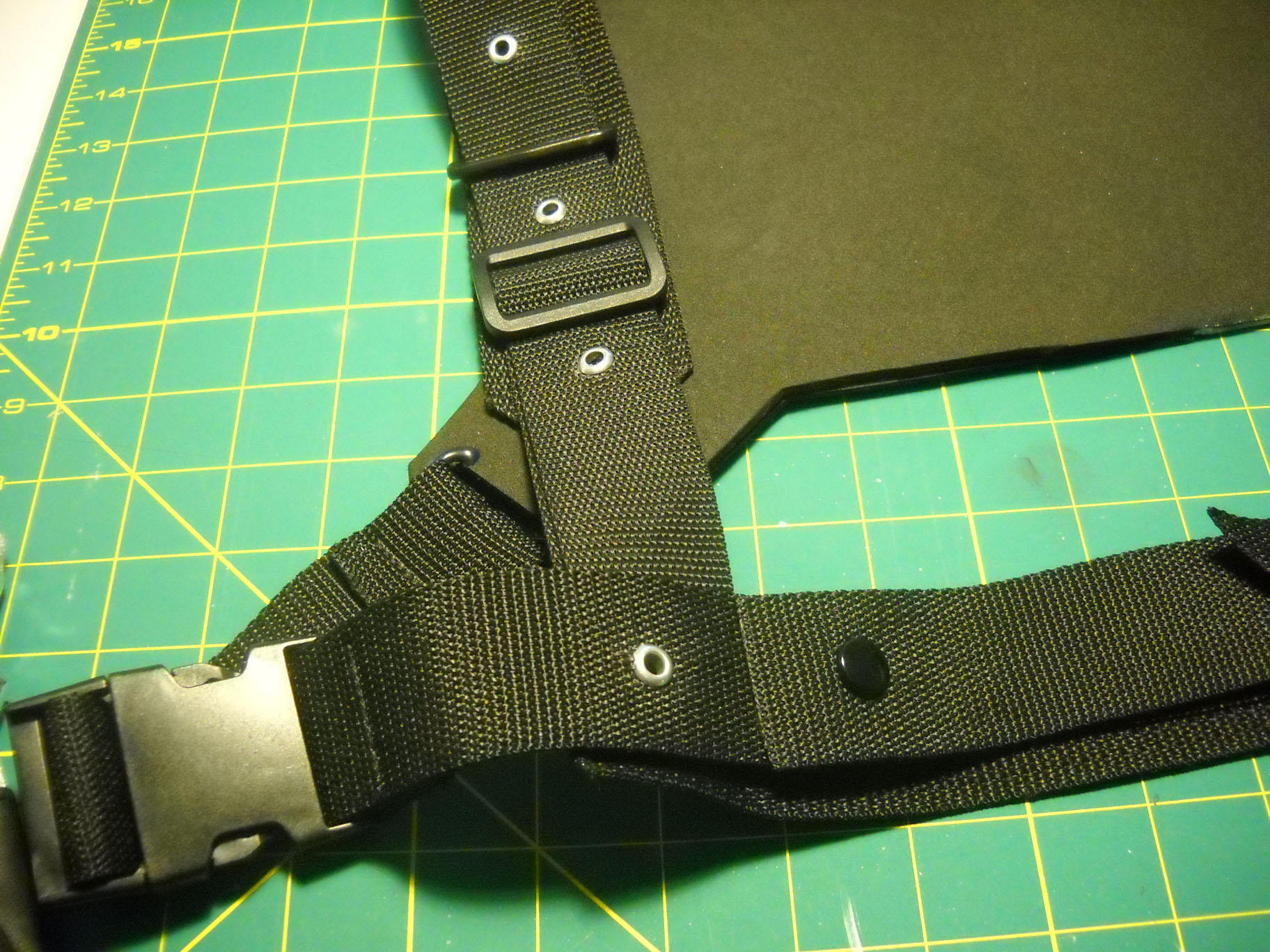

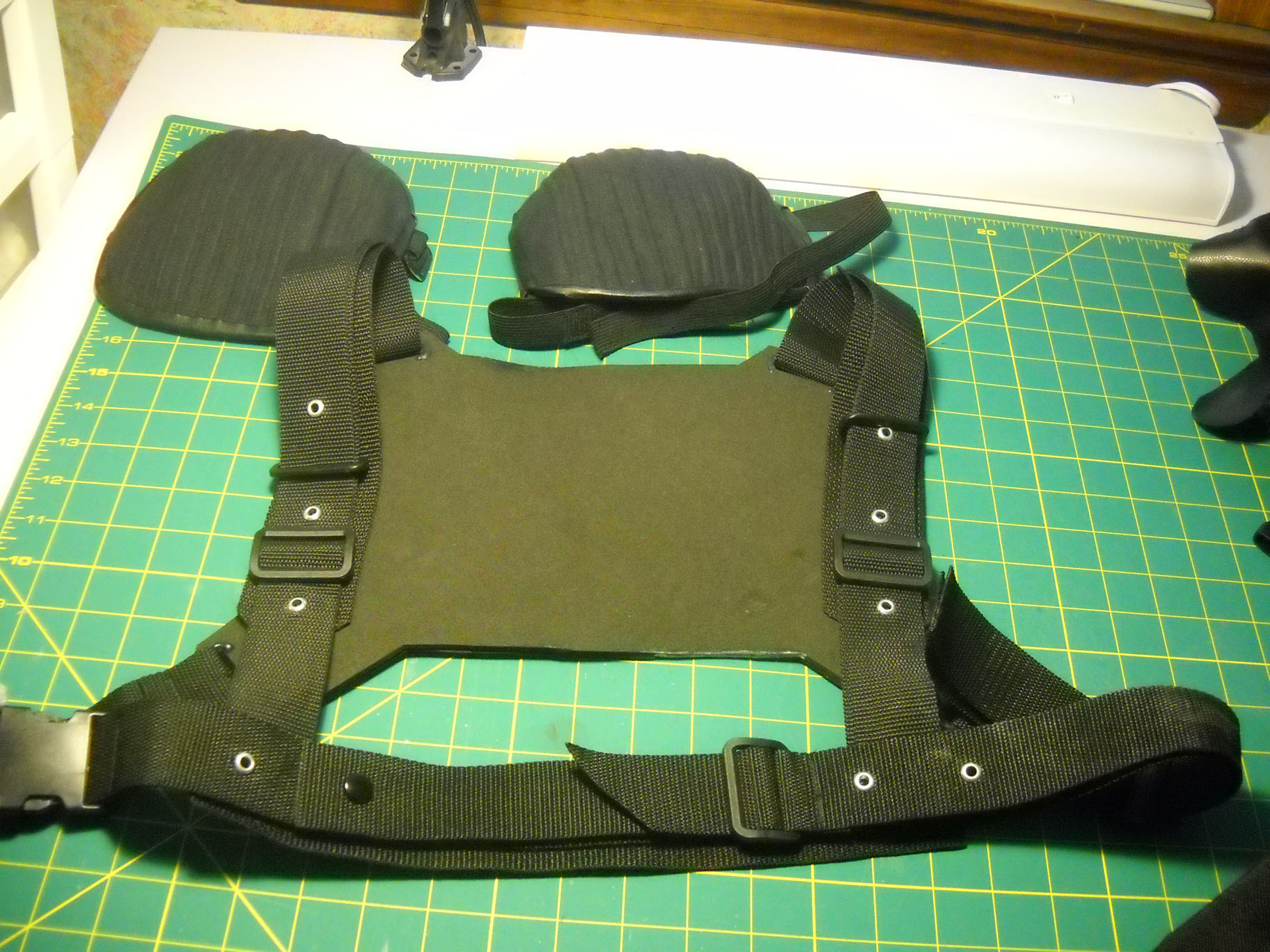

Freakzter - Thanks! Nice review on the buckle! If I ever do some serious upgrades I'll get one. Here are some photos of my finished harness (pre-convention).
*I repainted the silver part black because silver was very jarring to look at. Technically should be a dark grey, but I liked it black. I'll probably remake this out of fabric and foam since the craft foam ripped. :p I sacrificed some screen accuracy so I could make it adjustable and easier to snap on. I used 3/16 silver grommets (couldn't find black in stores near me) and to prevent fraying I used fray stop and or fray check so the cut spots didn't unravel. You will need a setter for the grommets, I used this one. I don't recommend eyelets because they won't secure all the fibers and rip out easier; grommets are 2 parts and hold better. The strap sizes are 1.5" and 2". This took about a full day to measure and rig, half the time I spaced out trying to figure out how to make this functional. @_@ Went though a lot of matches sealing the ends too. I used nearly all of the 5 yrds of 1.5" and maybe over a yard of 2". Hope this helps anyone looking to make the harness!

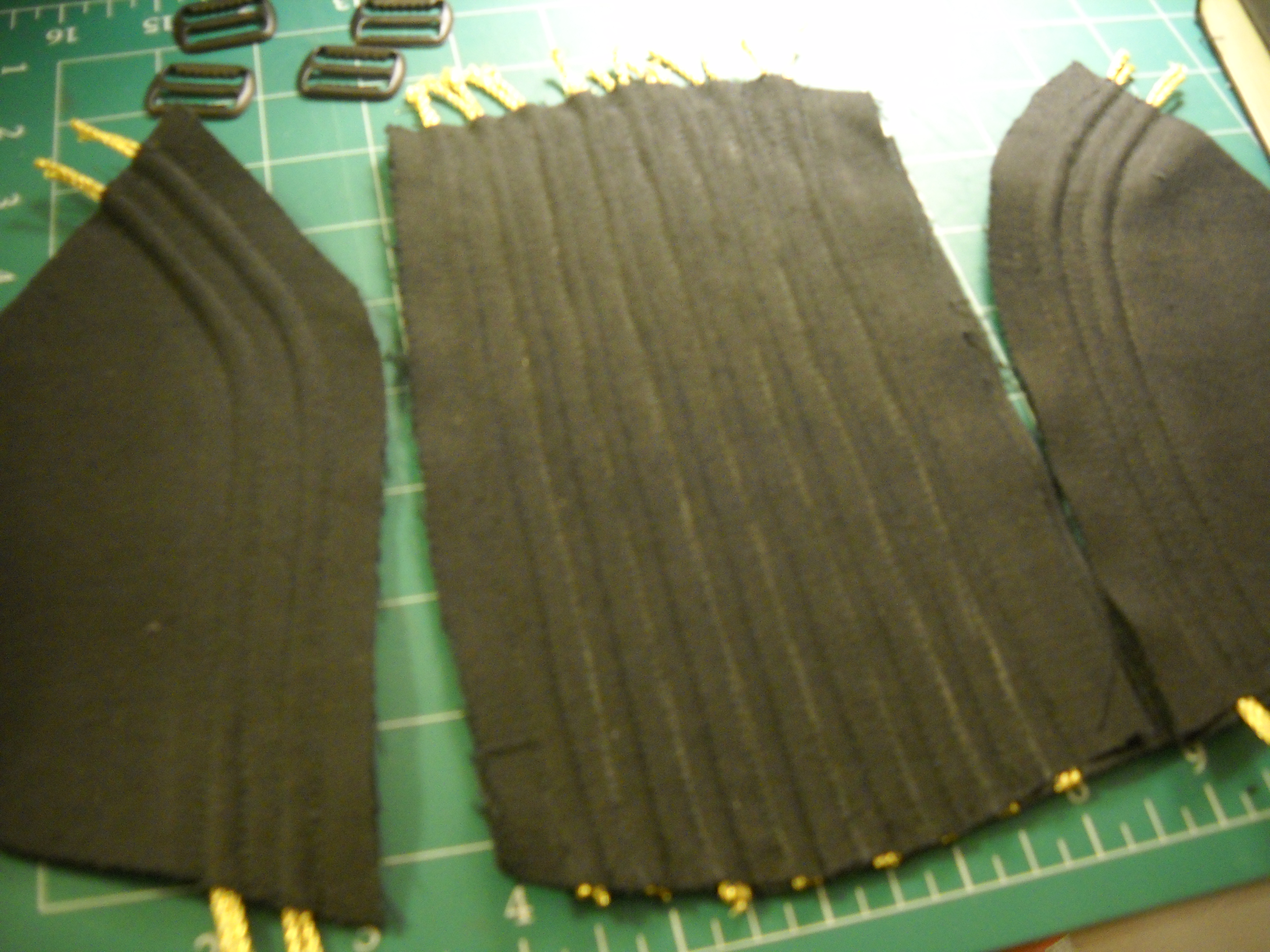

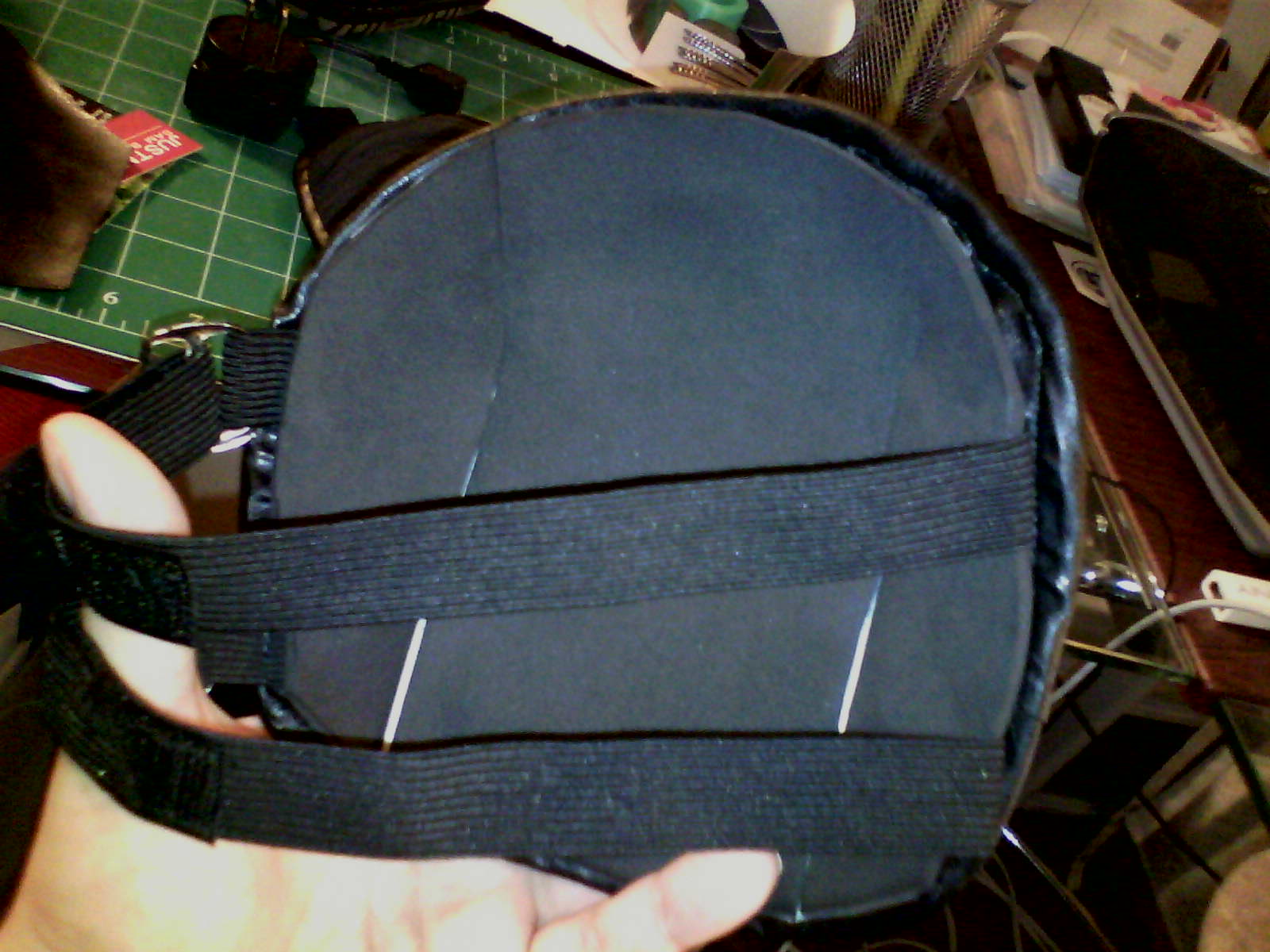

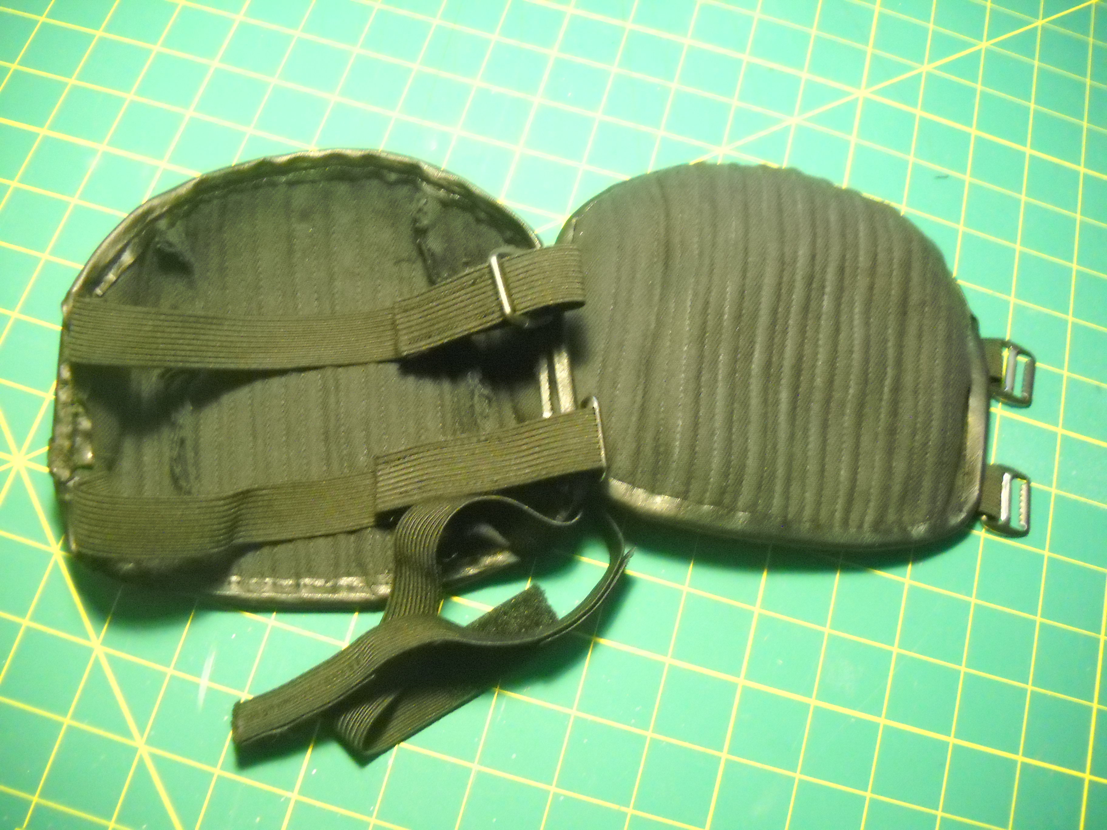

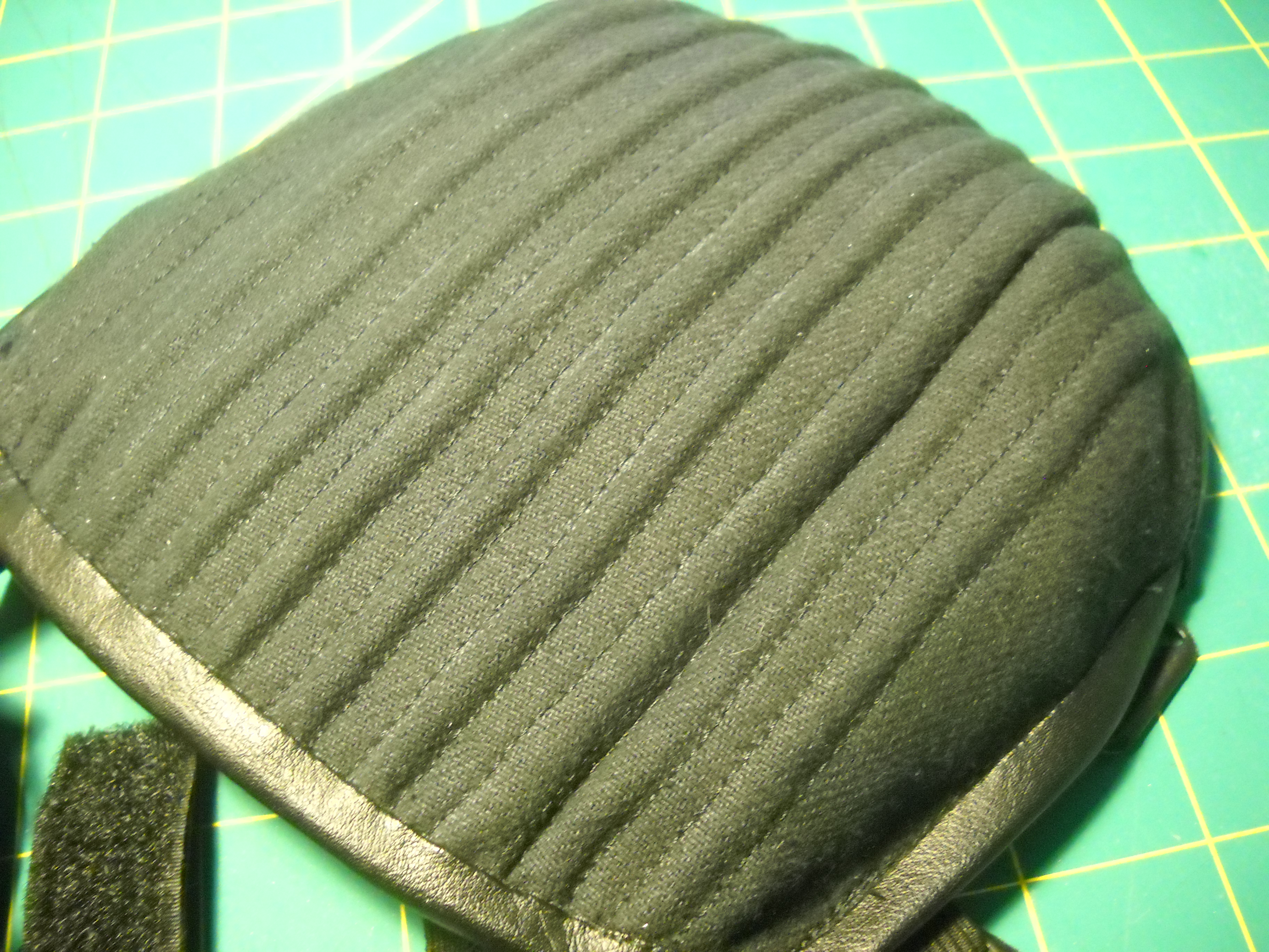

Also kneepads! Used my pattern and they came out pretty good using the cording suggestion.
The cording is 1/16" and I used 2 pieces per rib. I was going to use the cording for Corvo from Dishonored but I keep pushing it off. I used plasti-dip to cover the metal parts (came off again don't recommend), and 3/4" elastic and velcro to secure it. I velcrowed the backs with craft foam to provide actual padding. These came out very comfortable. I used some 10oz. bull denim (again for Corvo, never used it), but if I were to redo this costume I'd use black canvas/duck cloth.

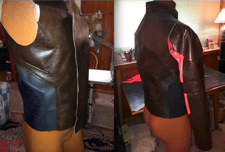

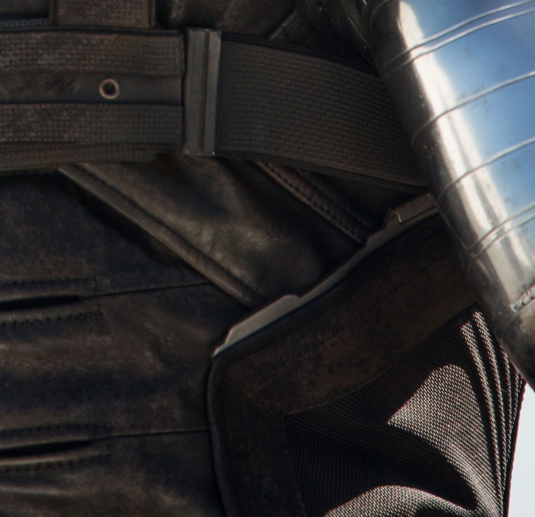

After doing the jacket and sleeve thing I have refs/material suggestions:
The super close up looks kevlar but I think black canvas/duck cloth would be fine.
A lot of the underarm of the sleeve is fabric too:

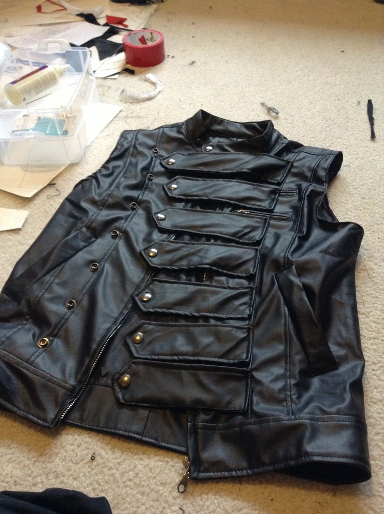

Finished making my vest, so here are the promised pics:
bucky_barnes_winter_soldier_vest_by_timeywimey_007-d7qum1t.jpg(I really love the lighting on my face in this, I look so evil lol)
Custom tag I made:
It's not super accurate, but I think it turned out decently well considering it was my first time sewing with a leather-like material. I made it by taking the sleeves off a cheapo $20 pleather jacket from eBay, hemming the armholes shut, cutting up the sleeves to make straps, and adding snaps.

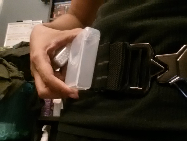

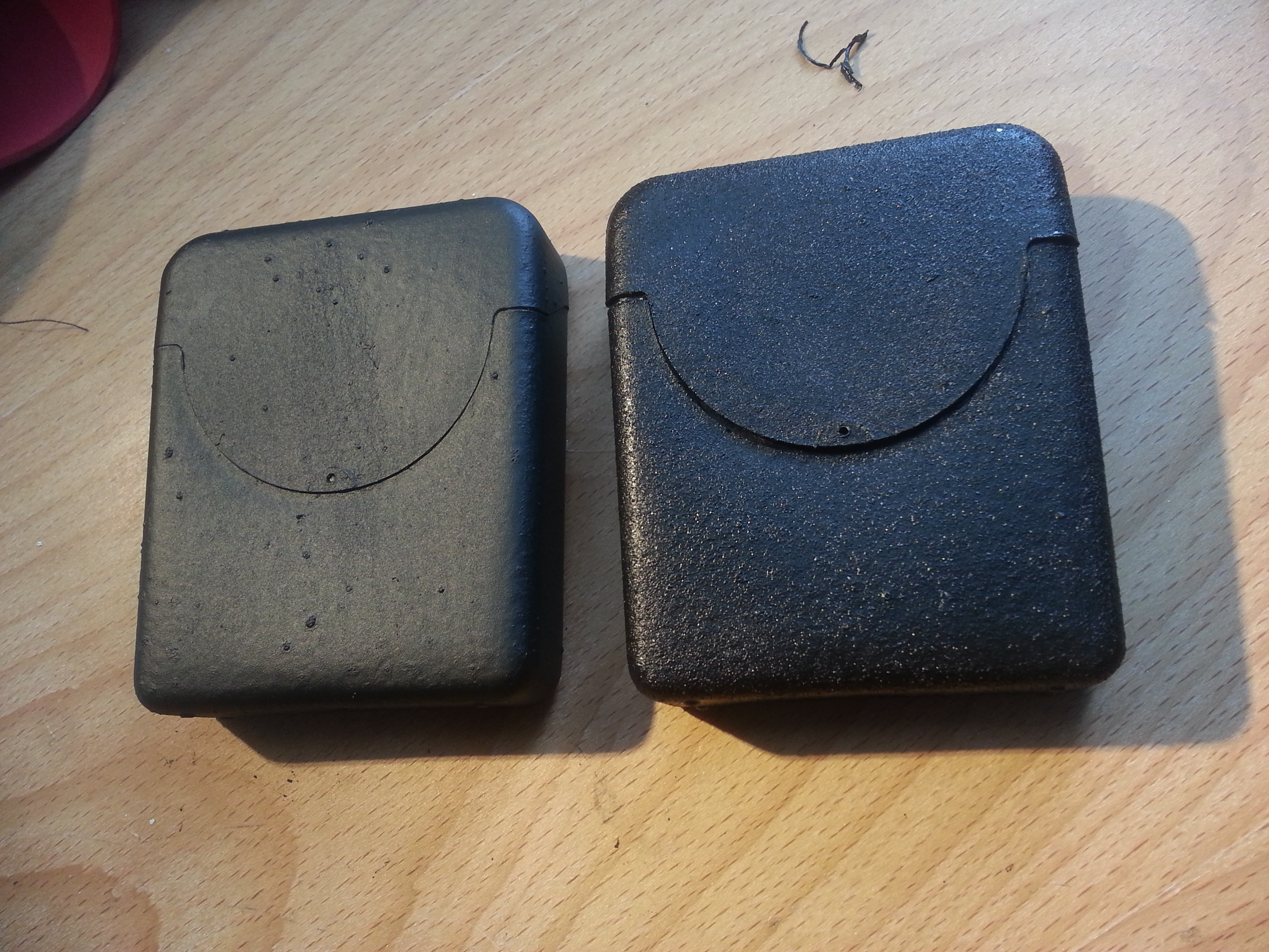

in case anyone is interested in the process of turning plastic containers into utility belt pouches.
first note that i have never painted plastic before. so i assumed it would need primer. i also wanted the end result to have texture to it so it didnt look like smooth plastic. i applied white gesso with a stenciling foam brush and this created the texture i was looking for. unfortunately it also left a lot of small air bubbles.
in the last picture you can see two different methods i used to paint them black. the first one is cheap spray paint. the second one is acrylic paint dabbled on the same way the gesso was. i personally think hand painting it on looked closer to what i had in mind, although it turned out a bit glossier than i wanted. i hope to fix this with a clear matte spray painting finish.
photo 1 (3).JPGphoto 2 (1).JPGphoto 3 (1).JPGphoto 3 (2).JPGphoto 1 (4).JPGphoto 2 (2).JPG

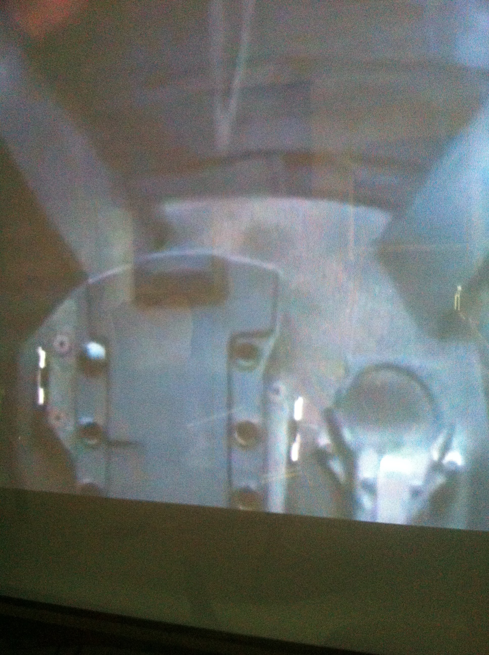

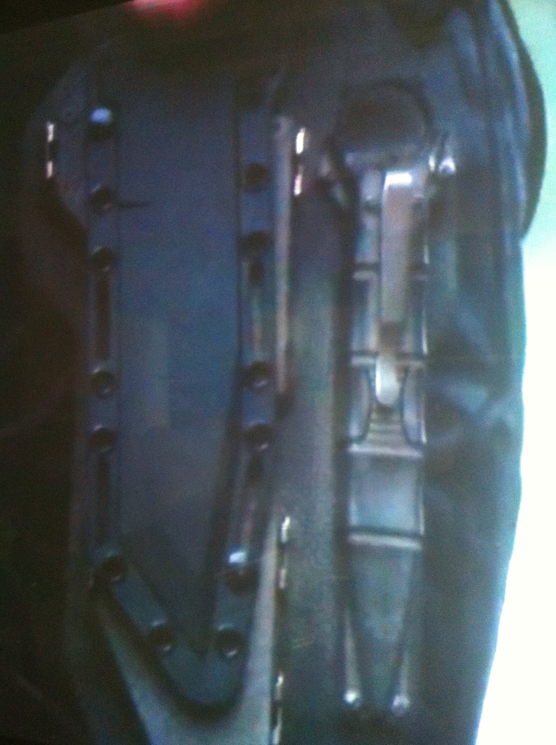

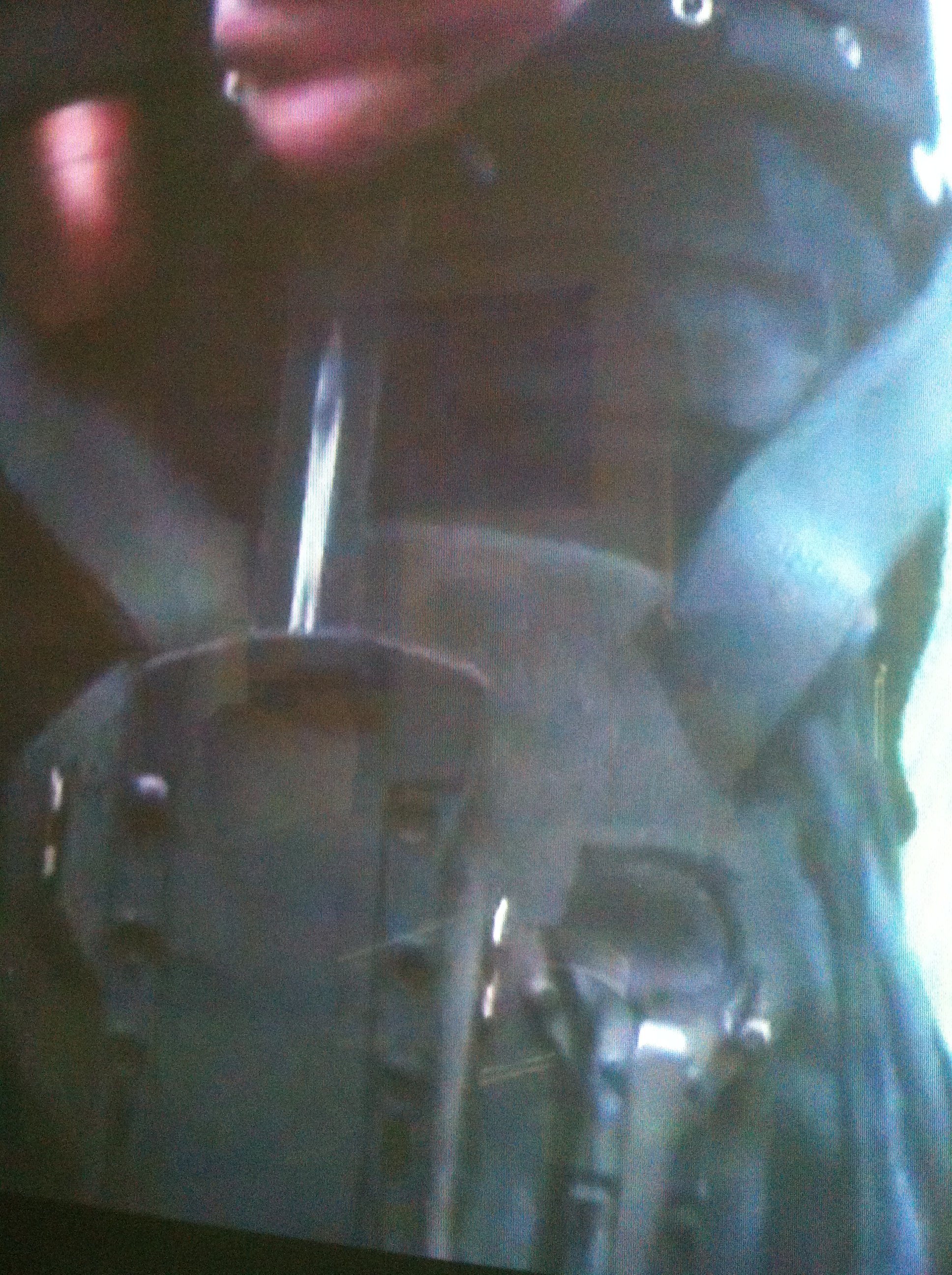

I am just taking this chance to add to this thread here are a couple of screen captures that better answer the question of the two different thigh gun holsters but also raises more questions as to source material. The main gun holster is the same through the entire movie the second one is simply a knife sheath attached to the existing plates. If anyone can identify the sheath maker and blade the would also go with that sheath that would be great!!! I believe there is supposed to be two knives the main that is meant for the sheath and then the Gerber mark II sits right behind it. I also thought i would include progress on my gun belt design. As I have said I am trying to go as screen accurate as possible and if people are interested in me starting a run pm me.
View attachment 350891View attachment 350893View attachment 350895View attachment 350896View attachment 350892View attachment 350894
if you are asking about the knife in the first image, it is a Benchmade 176BK SOCP. also your belt looks AMAZING!!
