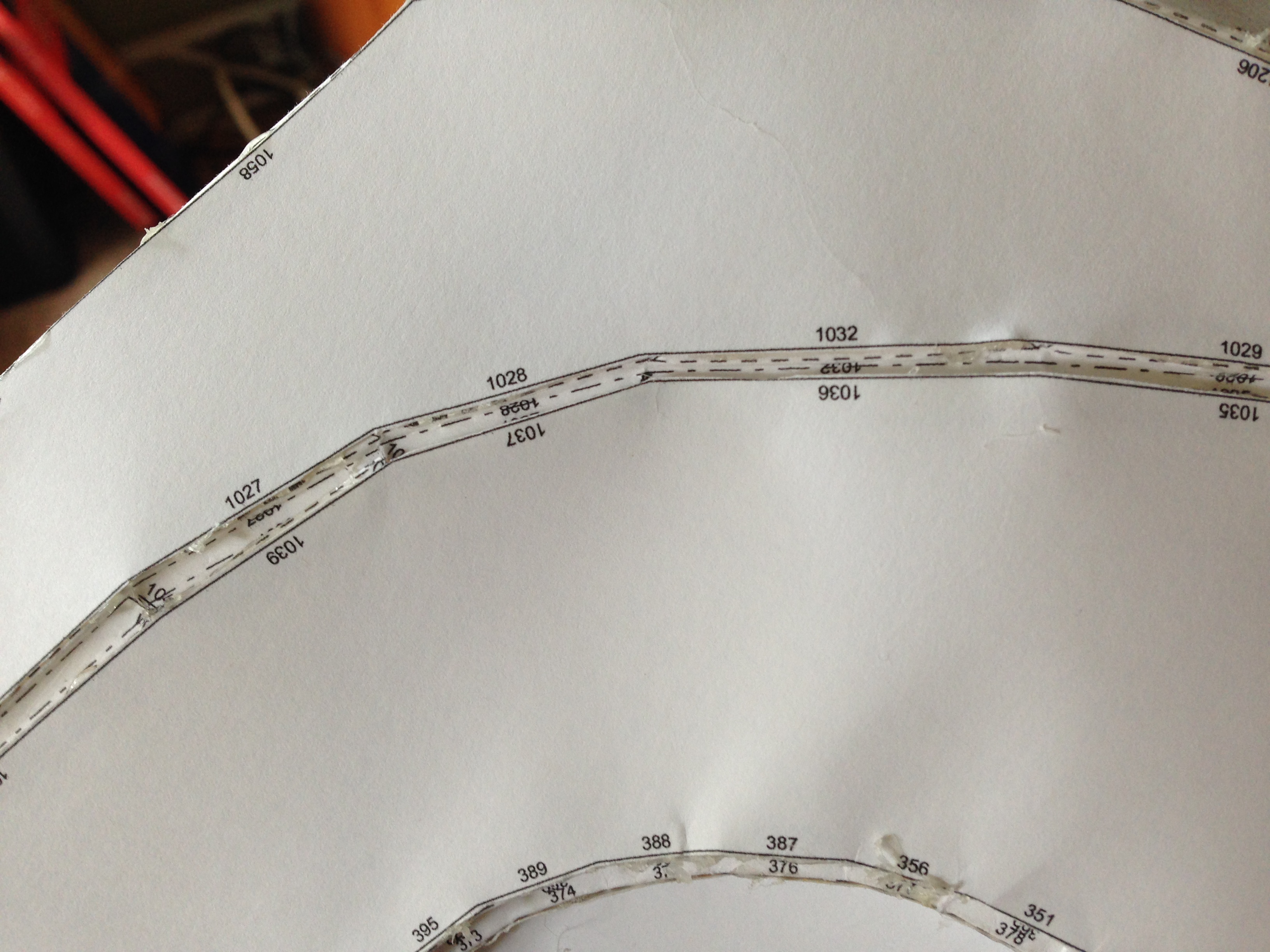

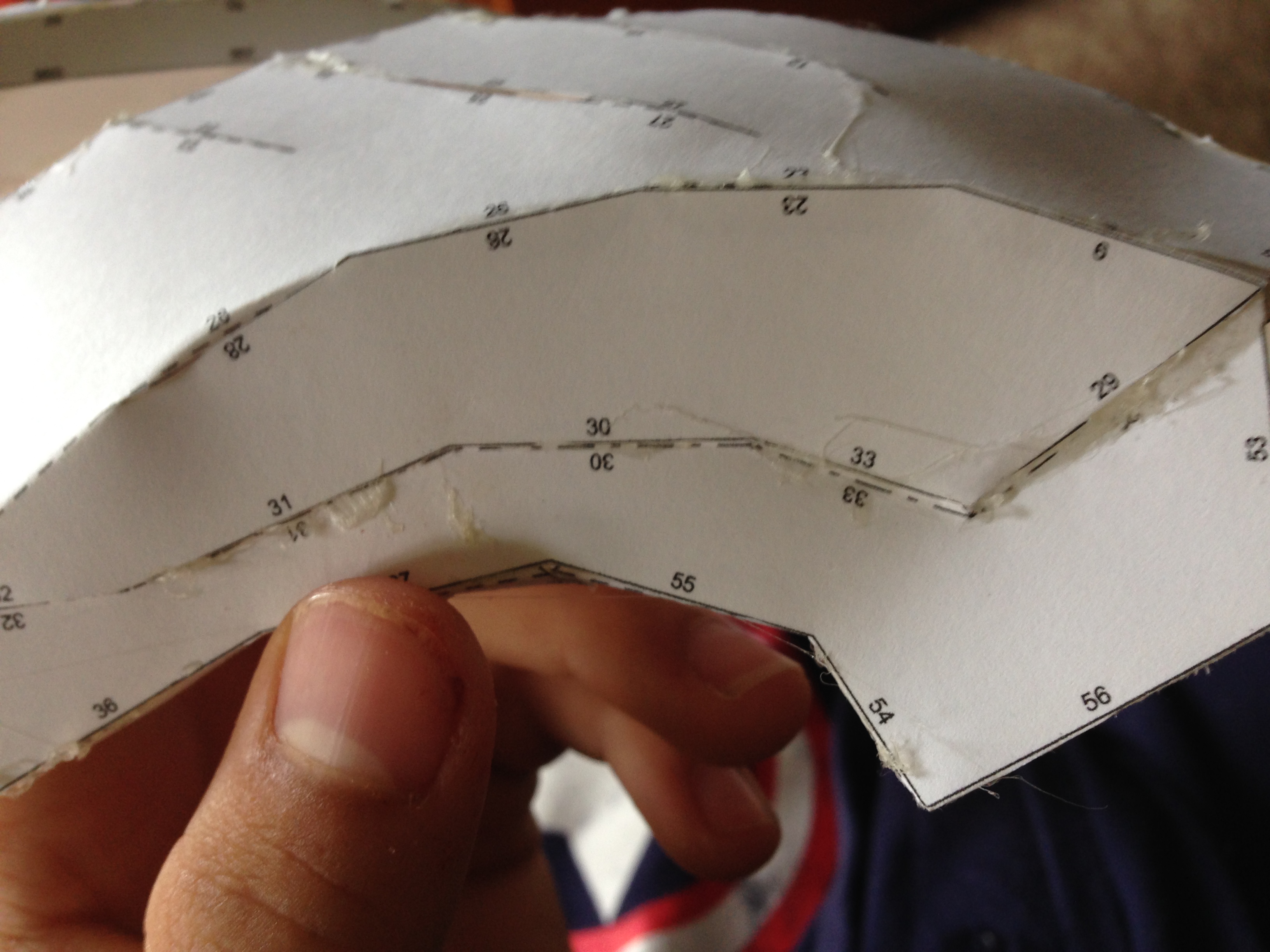

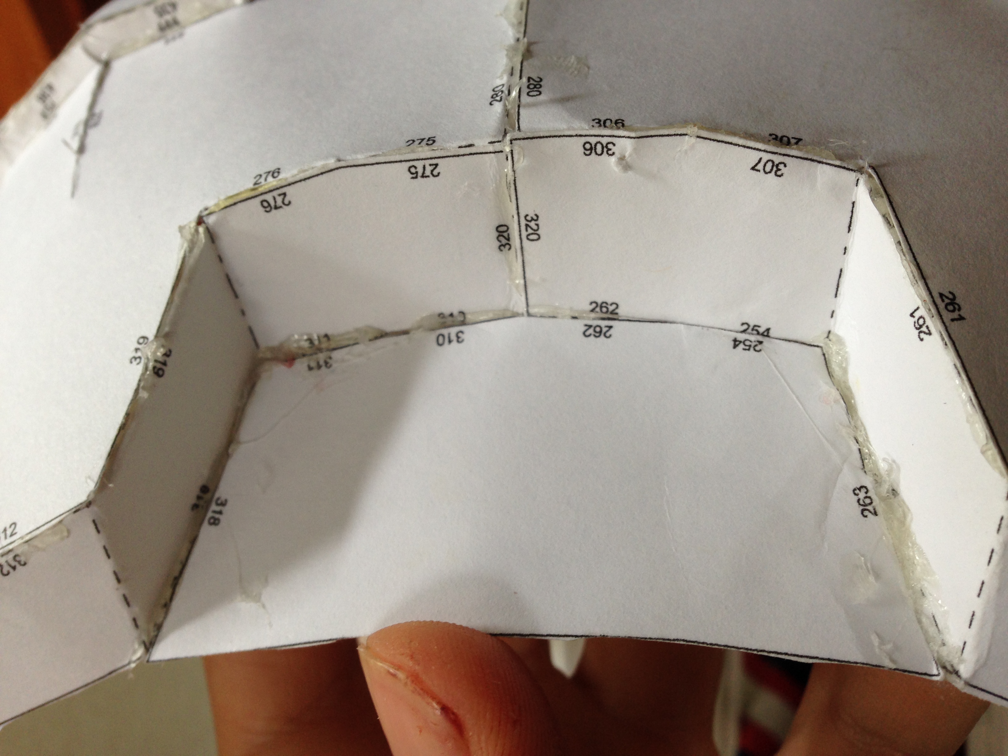

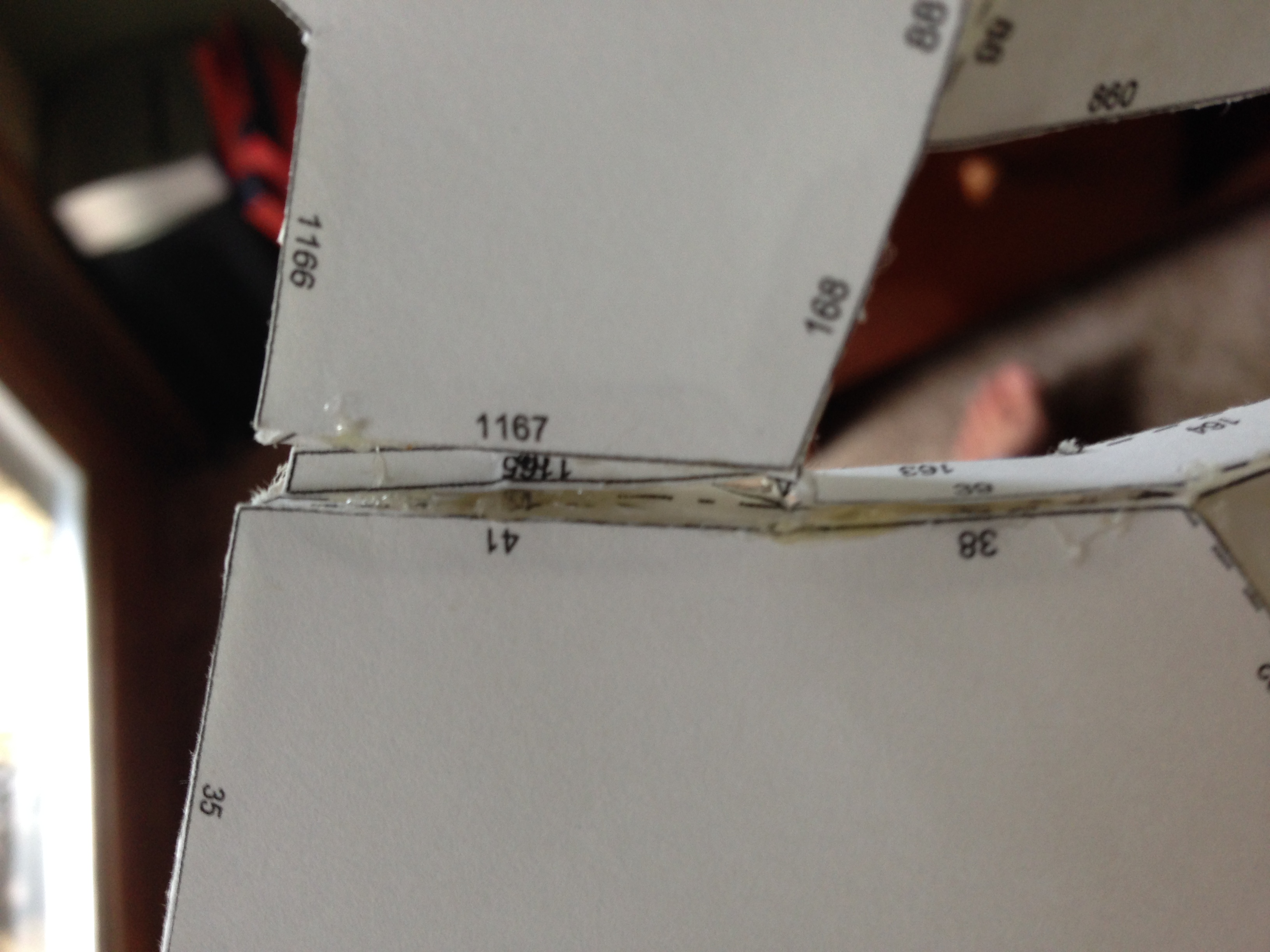

I am a relative newbie to pepakura and I have just pep-ed my first helmet (iron man). I used hot glue to attach the pieces, and my helmet is pretty messy as if right now. So I have two questions
1. Is the hot glue on the outside of the helmet going to become a problem or can I sand it off once I harden it?
2. how accurate does the helmet need to be before hardening? (AKA do the pieces need to be in EXACTLY the right place, or can I sand off minor inaccuracies once I harden the piece)
I've attached pictures to show you what I mean
I just don't want to spend the money to harden this if it's unusable and I need to re-pep it
thanks!

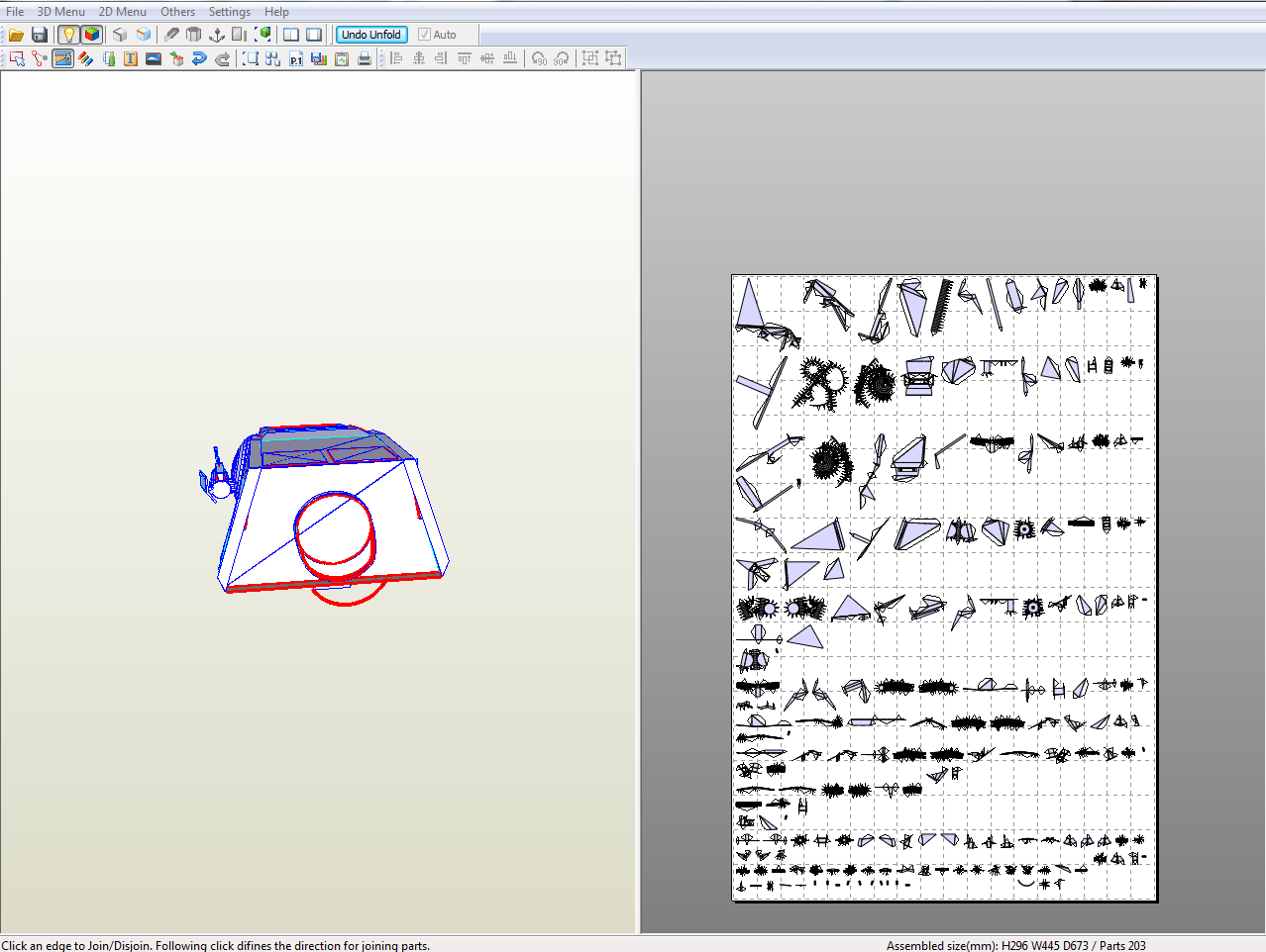

I don't know if this is the right forum section but here goesCapture12323.PNG
I'm trying to make a big costume using pepakura and when I unfold it the parts are to big for the piece of paper and manually disjoining them is way too time consuming. so I was wondering if anyone could point me in the right direction for a auto disjoining program or something like that.
thanks!
Re: auto splitting pepakura files
I don't know if this is the right forum section but here goesView attachment 532853
thanks!
You're pretty much stuck on two options.
1) have the model cut into smaller pieces in modeling software, then re-exported and re-unfolded in more manageable pieces. THis is quite a bit of work, and requires at least some 3d modeling experience to do.
2) Print the large pieces over multiple pages, then cut them out and re-tape them together. A lot of people do this anyways for large parts, I had to on pieces that were well over 3 feet tall but flat planes. Pepakura includes an option under print and paper settings to add alignment marks at each corner of the pages; this helps to line the edges up properly as you tape the pieces together.
Needless to say, #2 is will likely be the easiest to accomplish, good luck with your build!
