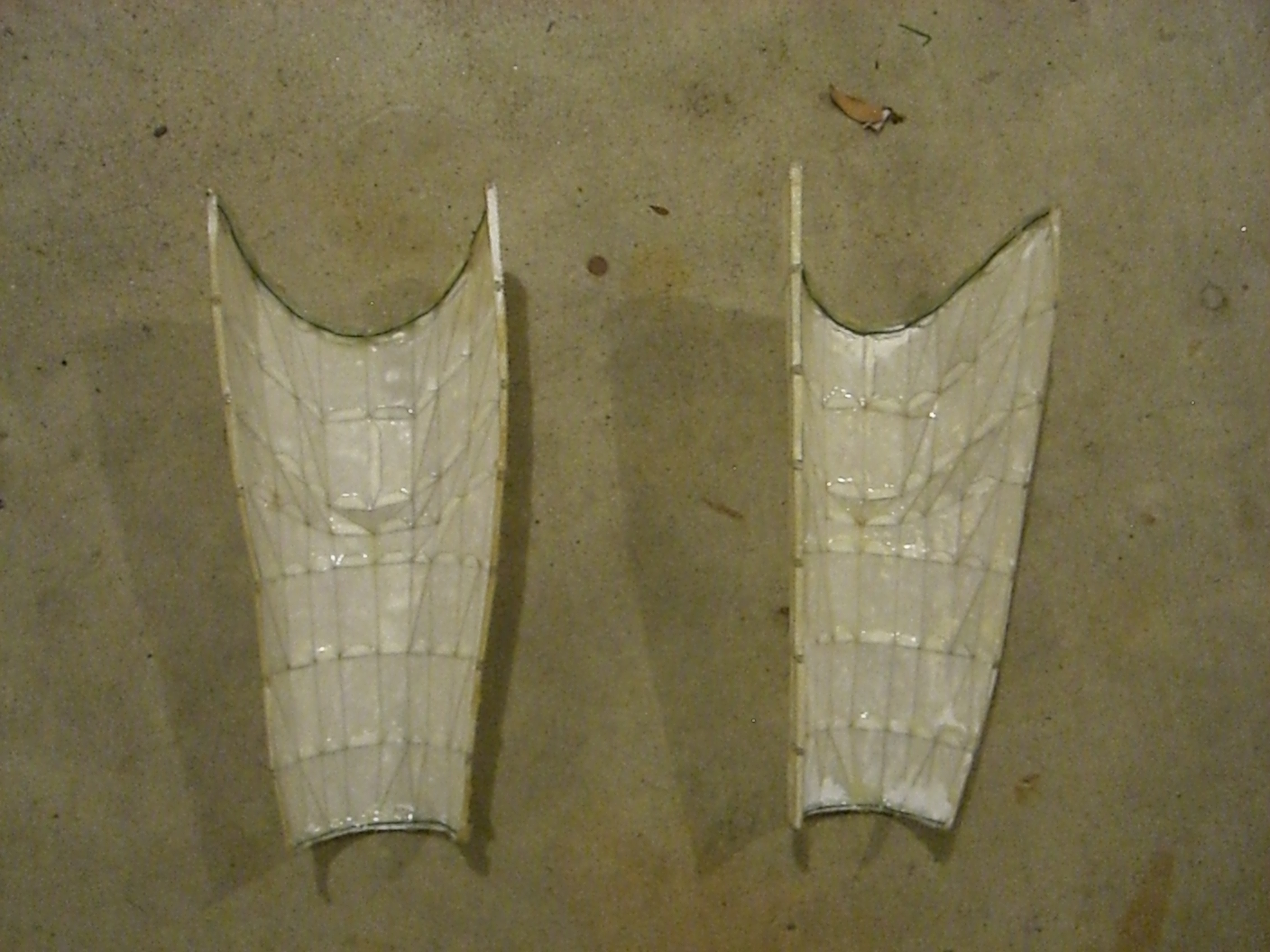

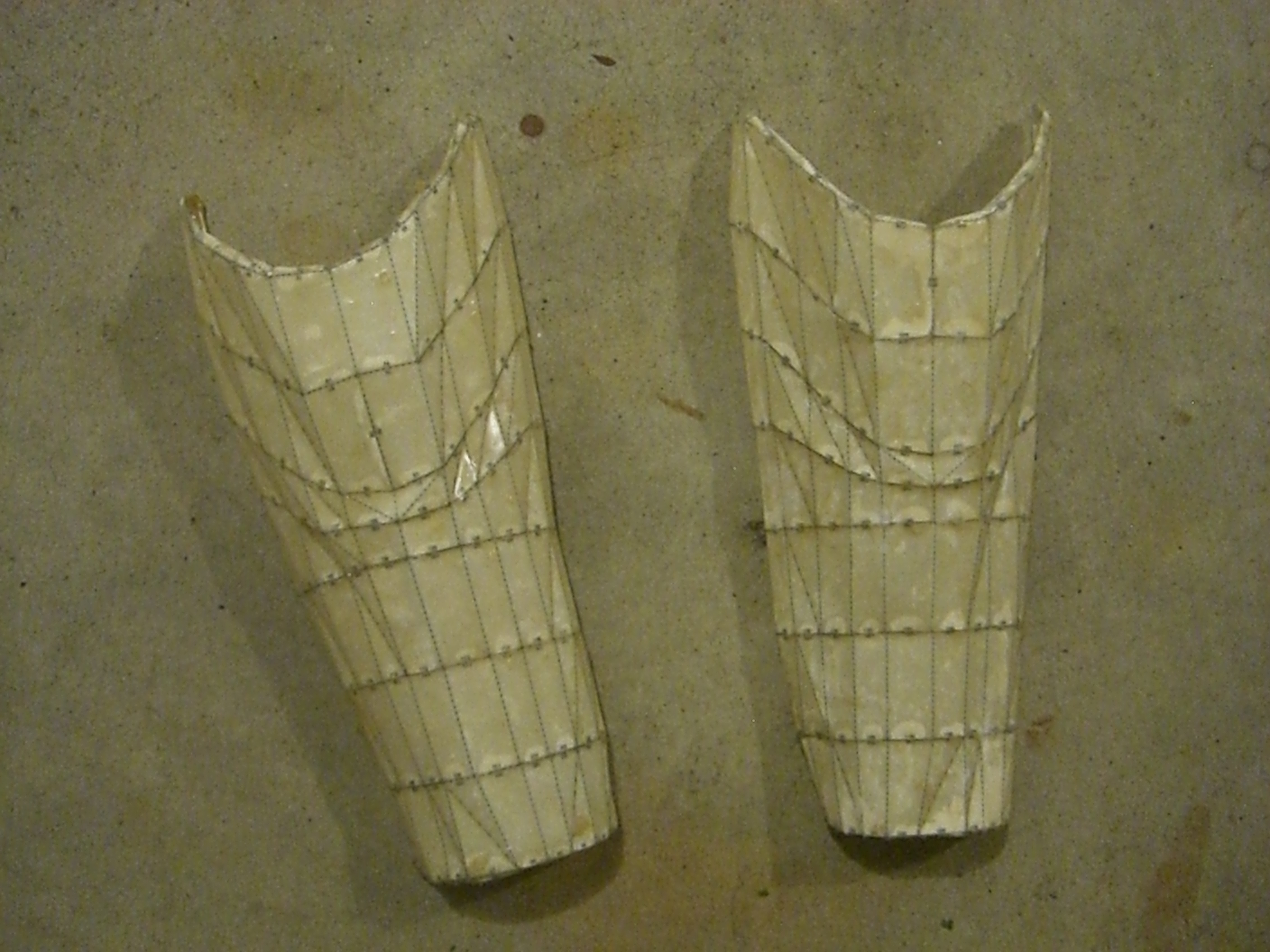

Here are part of the forearms. I did the outside coat with polyester resin a while back and recently did the inside with epoxy resin. They are kinda malformed so I need to reshape them a little bit.

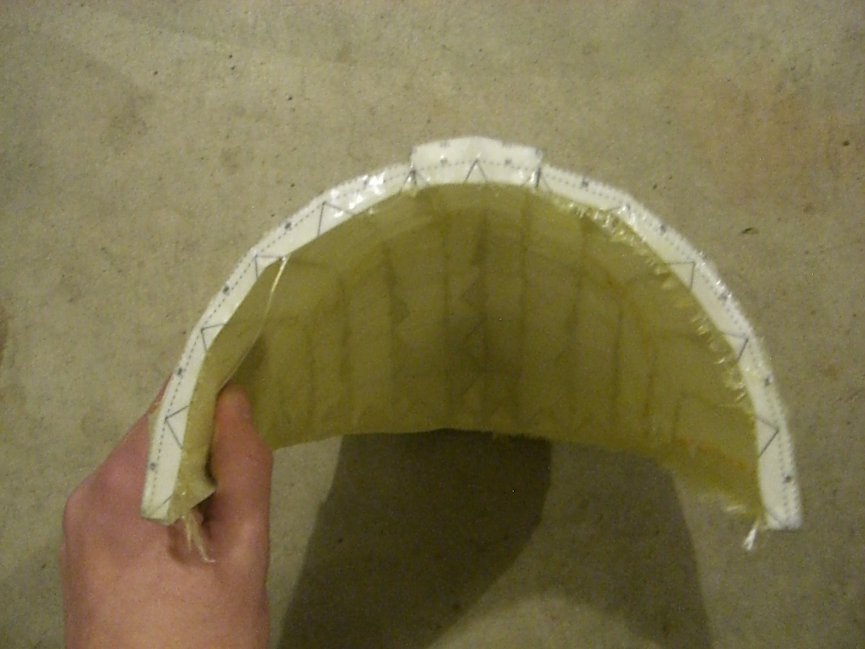

I am rebuilding the biceps because after trying them on i found out that they were smaller than I thought. Here is a size comparison.

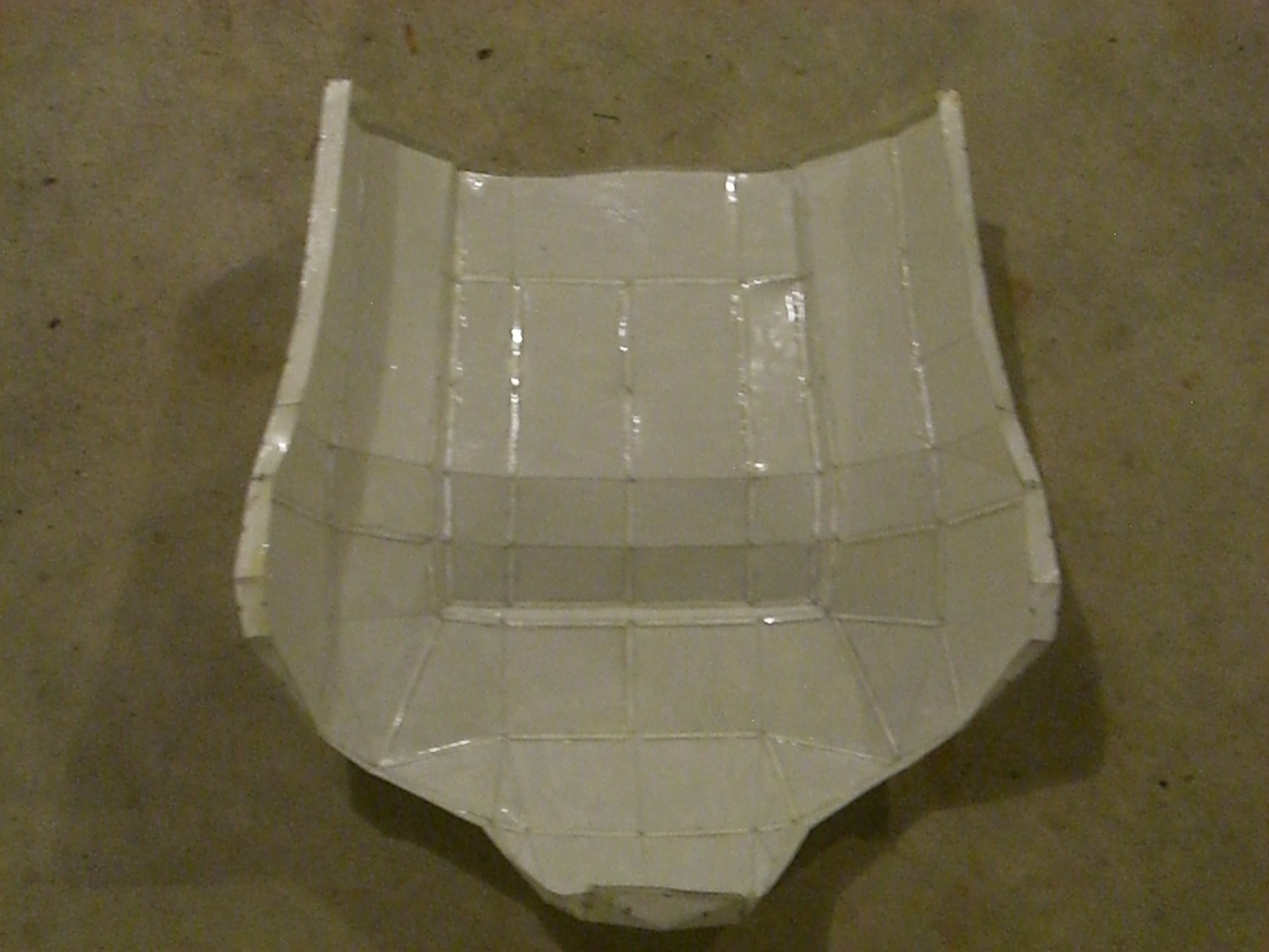

Here is the butt plate. I put a coat of fiberglass on the inside and outside but haven't put the cloth on yet.

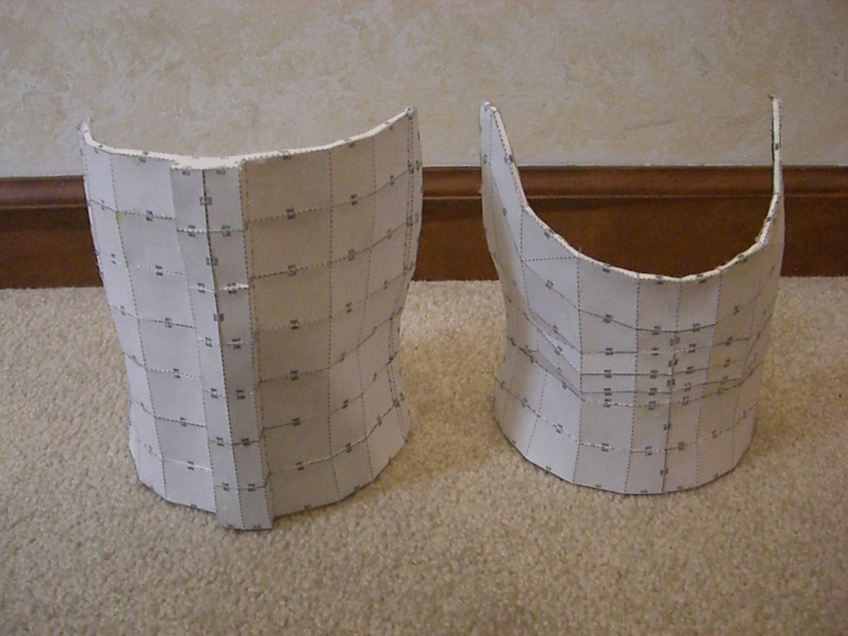

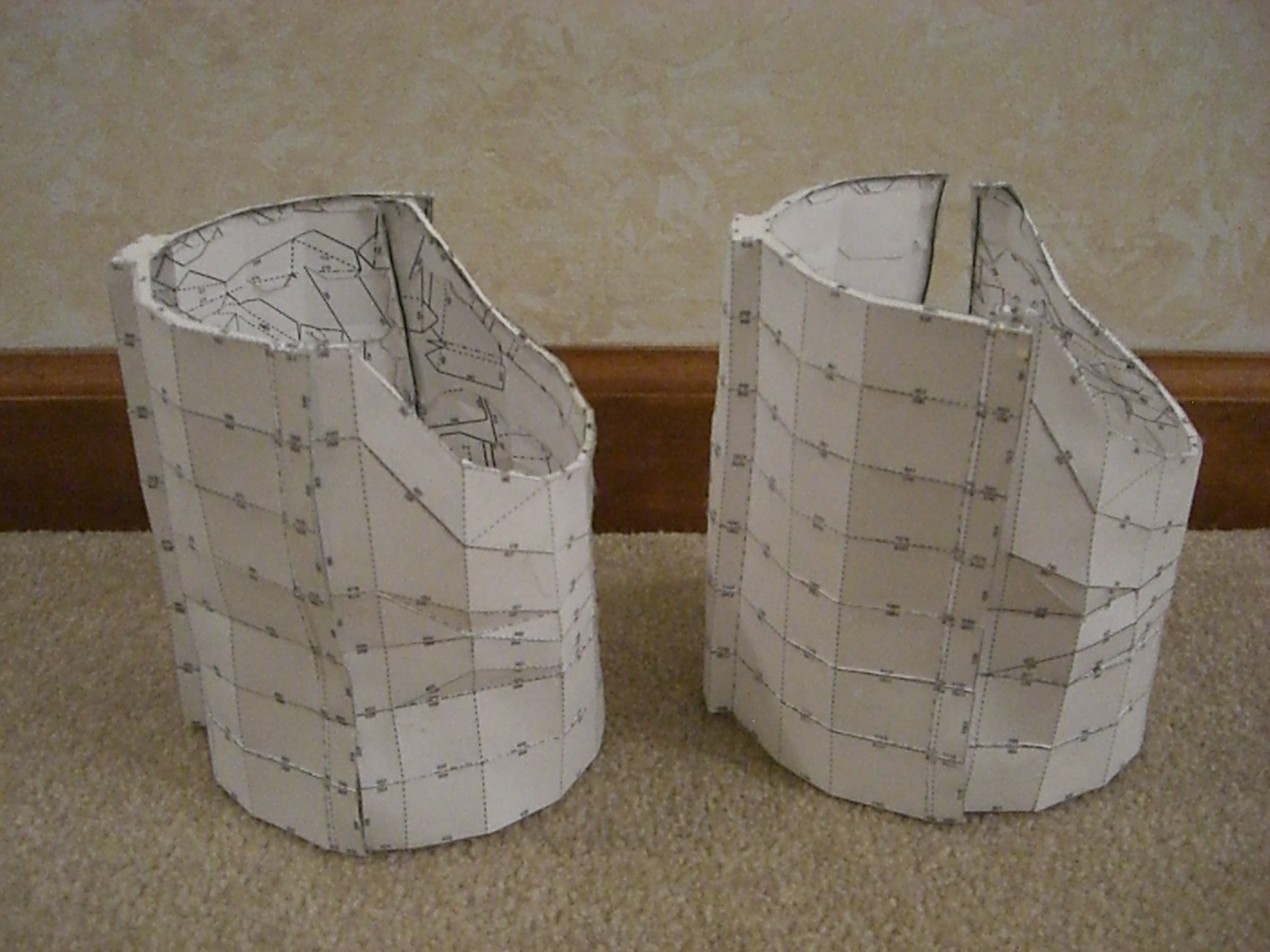

Got a little more progress to show you guys:
I got the other bicep finished

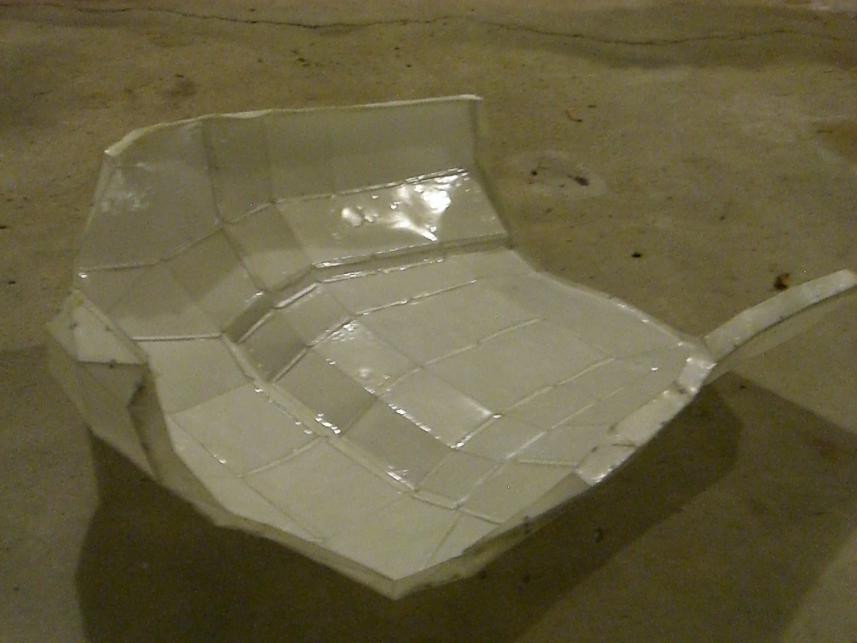

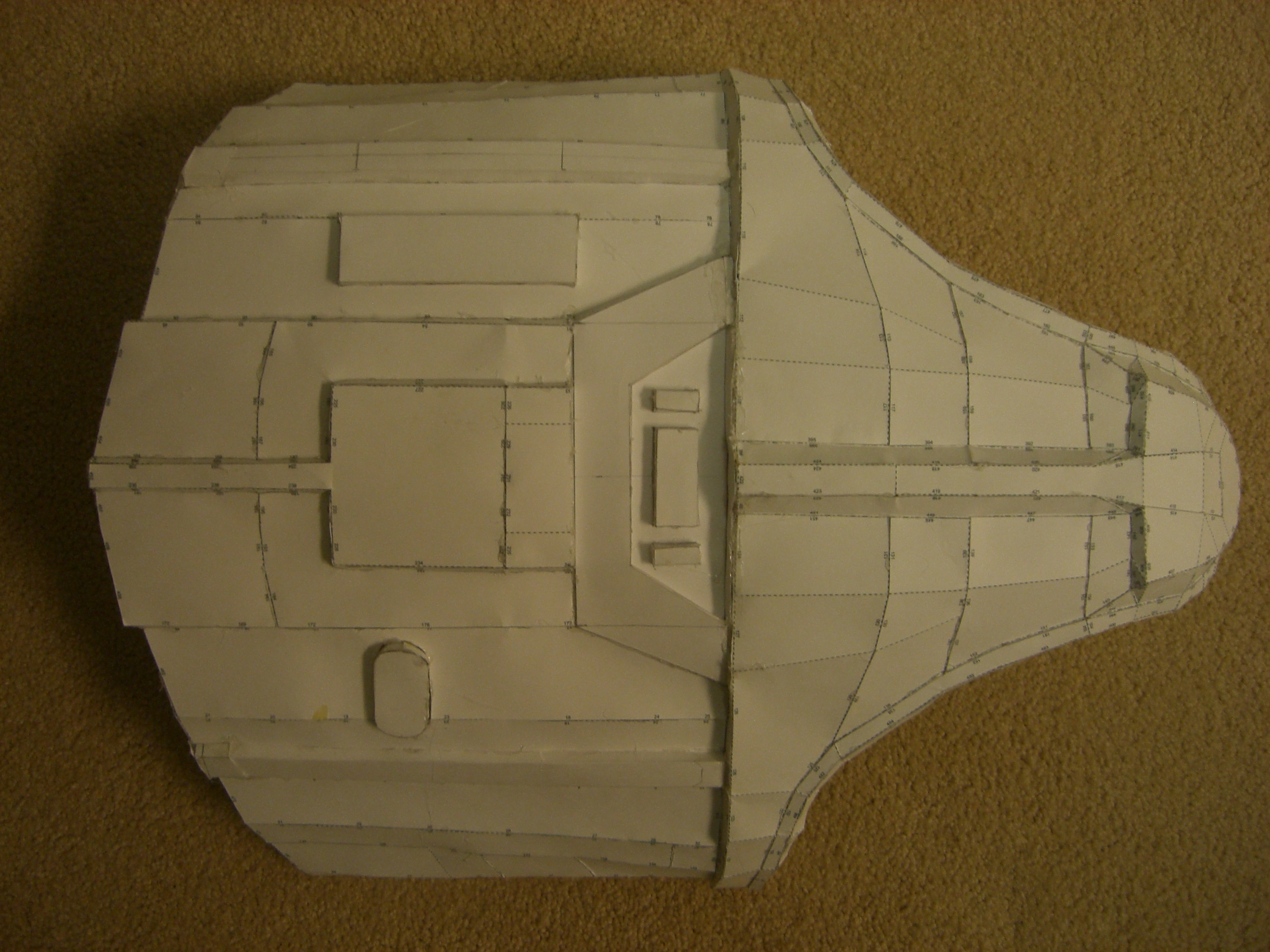

Also, I added some details to the ab/cod plate so it looks closer to the actual armor.
Things that still need to be re-pepped: Chest plate, Thighs, Handplates
Things ready to be resined: biceps, outside of forearms, ab/cod plate, back plate, helmet
