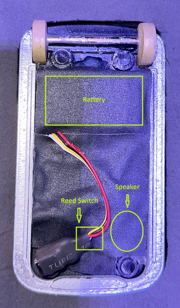

I tried a couple devices out, but the one I found that works the best is the 2.4" landscape video business card. I got mine from Red Paper Plane as a demo unit, It cost about $30 shipped. The screen is not the greatest, I'm sure there are better clones out there, but this got the job done. If you tear it apart carefully, you can salvage everything you need. You'll probably want to clean up the wires shortening and resoldering them. I ended up swapping the speaker from a larger 3" video business card as it sounded and fit a little better. (Sadly as nice as the 3" screen was with color and contrast, it just wouldn't fit in the model with out more modification than I had time for.)
There's a magnetic reed switch that comes with this unit I used that and (poorly) integrated a magnet to the lip of the "antenna" section, it's the out of place half-moon shape. The switch is mounted between the grill and the dials on the model. I thought the speaker (which is mounted behind the grill) would interfere with the reed switch, but it doesn't look like the magnet is strong enough.
All of the electronic components are super professionally... hot glued into place. To hide those crimes I covered the hot glue and circuit mess with fabric gaff tape. Sorry, I didn't take any pics of the guts before they were dressed. (To be clear the wire on top is the charging / data mini USB cable, the reed switch is hidden below the tape.)

so your switch is mounted roughly here?
for my speaker i was going to drill out the "vents" on the back of the body, i might change that and get an actual grill so i dont have to destroy the prop to charge it
Yep, that's where it's at. Glued flat to the body.
The switch is a 10mm PCB, to it's not to hard to find a spot for it.
In the nice metal kits there is a magnet embedded into the side of metal antenna piece. If you're holding out for a second run of those you might wan to do some rearranging.

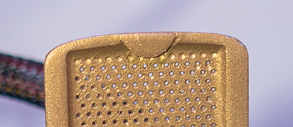

I had trouble printing the grill section, but I used my failed prints of that piece for structure instead. I punched holes through it, then used it as a mount for the speaker and a friction lock for the stainless mesh. I used "Stainless Steel Woven Wire 200 Mesh" in retrospect it's a little too fine. I probably should have gone with something in the 120 or 80 range. (Honestly I have no idea what that number means, microns maybe?) I'm sure someone with a keener eye than I has nailed down the exact screen accurate mesh, but this covered the speaker and still allowed me to hear it well. All that being said, while it's great for the speaker, I think there's supposed to be some sort of notification light that shows up there in some scenes, so depending on how detailed you want to get, you may want to mill out the back and put the speaker there to allow for that light.
